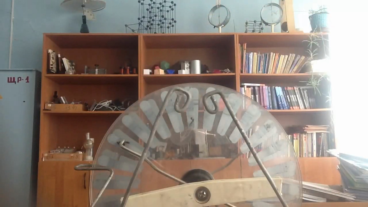

Homemade Wimshurst machine - part 1

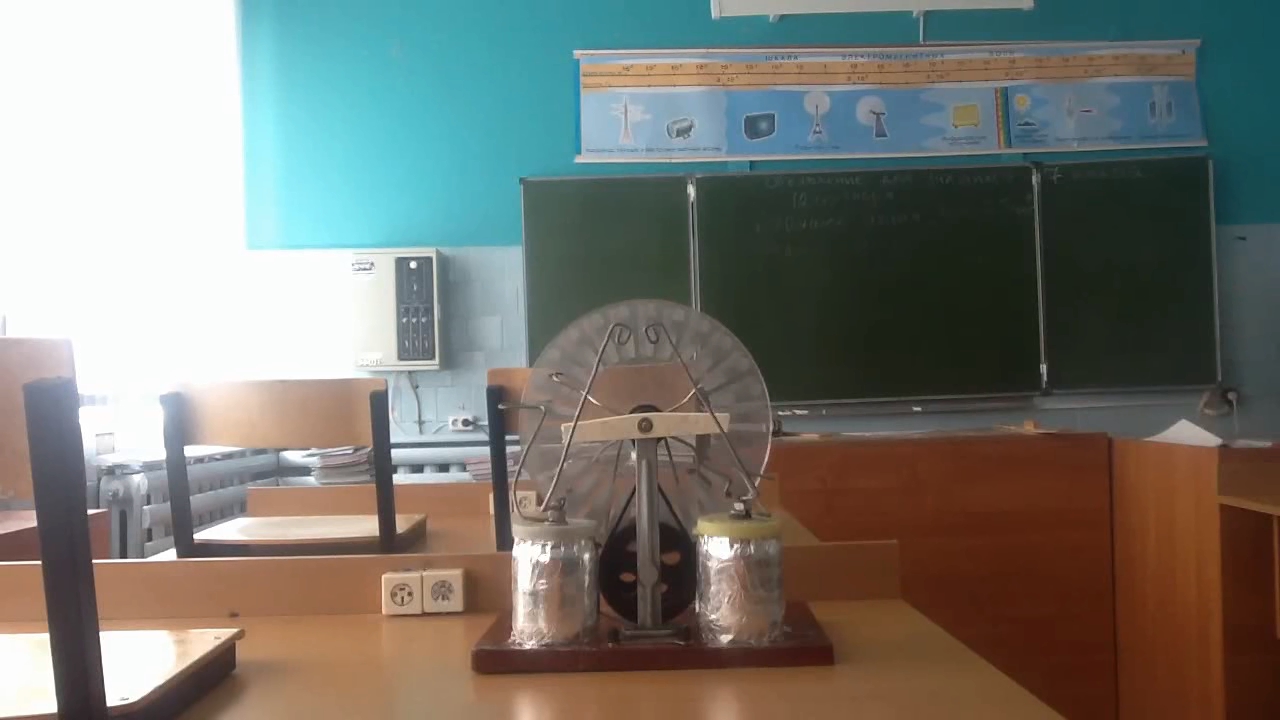

Let me describe how I made the Wimshurst machine at home. This device was constructed practically from improvised materials many years ago. I only asked friends for plexiglass disks. The strips were cut from aluminium tape (used for sealing seams in ventilation equipment, etc.) The body of the Leyden jars was made from sections of PVC pipes. Lids of coffee cans were used as the lids for the Leyden jars. The conductors were soft thin stranded wire. The conductive elements, which were also fastening elements, were thick aluminium wire and tubes from an indoor TV antenna. The main problem was with fastening and holding, and ensuring easy, even movement of the disks. A solution was found. I saw it somewhere on the Internet - wheels from roller skates were used, but always with good bearings. I share photos and videos. The maximum spark length was 3 cm, no more.

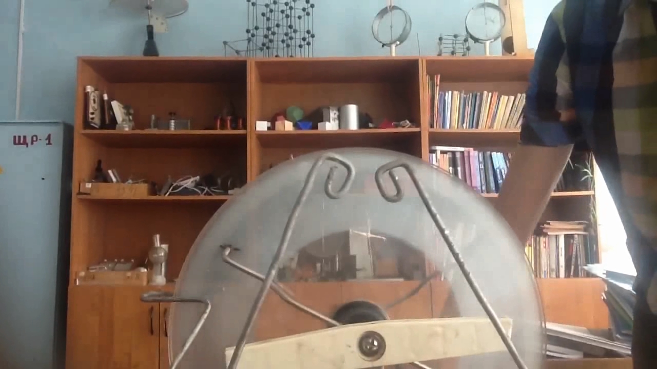

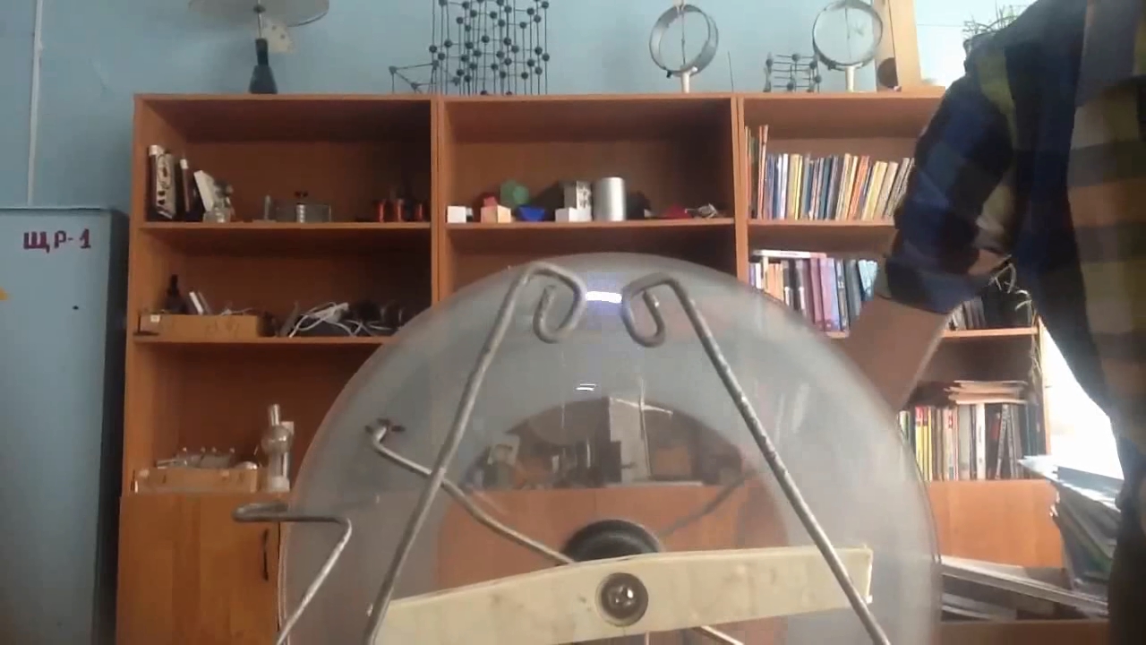

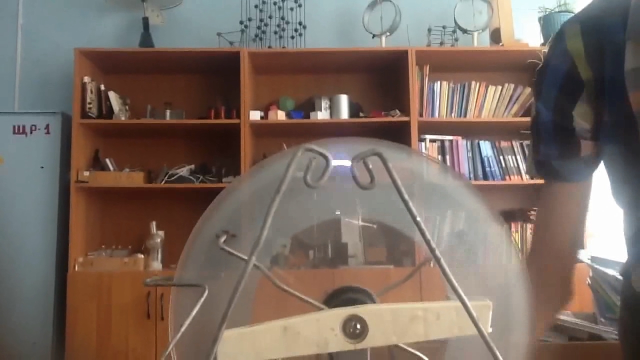

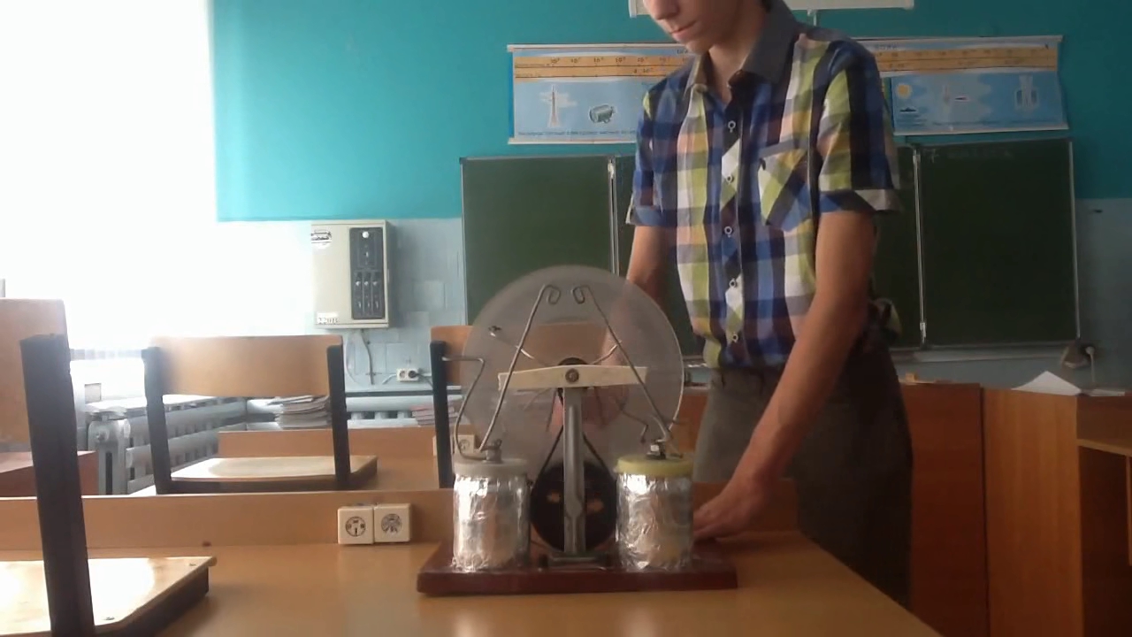

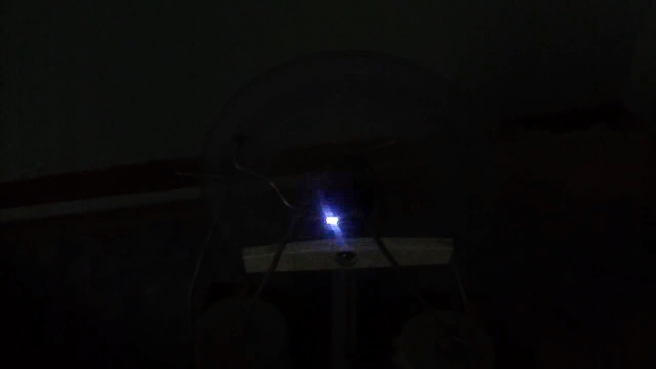

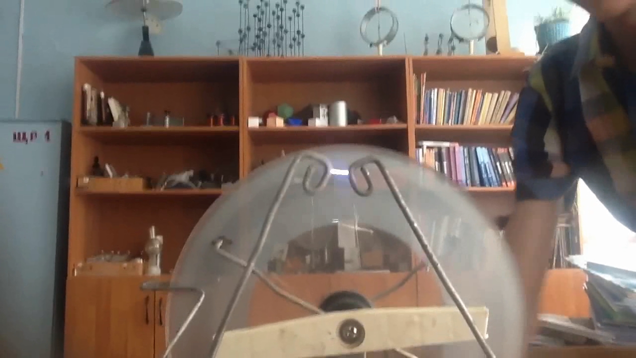

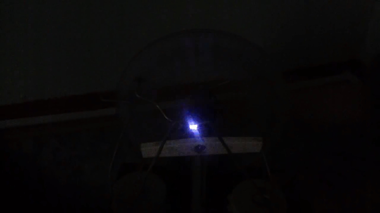

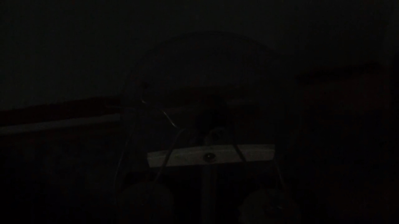

School Wimshurst machine and dynamo - part 2

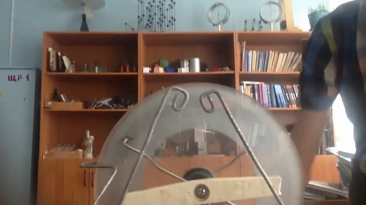

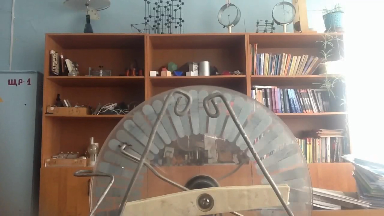

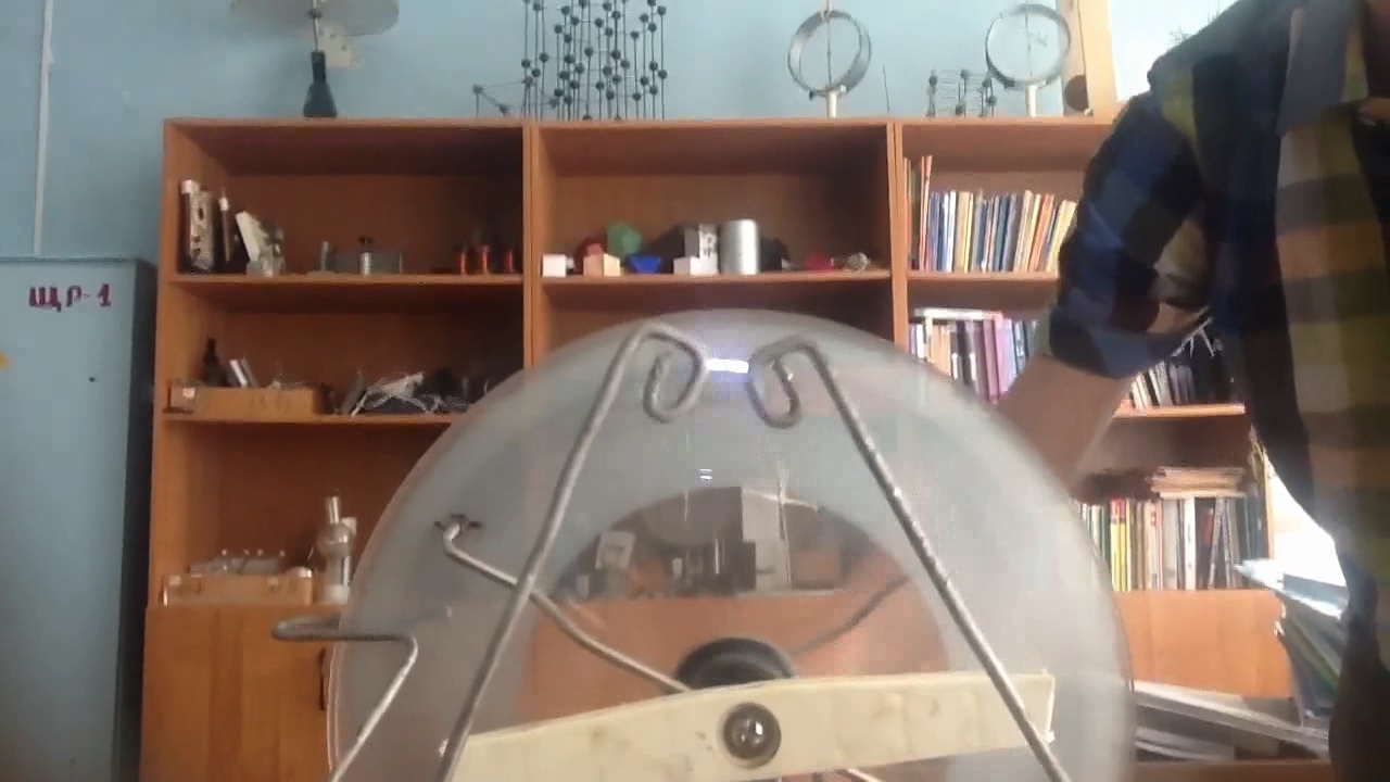

I fixed the Wimshurst machine at our school. In the first video, where the machine is shown in its entirety, I accidentally got into the frame, so I am only posting a fragment from the beginning. The machine produces a discharge up to 2-2.5 cm long. It might be possible to increase the length, but then a discharge occurs somewhere in the capacitors, causing it to "shoot through" (it is unclear exactly where).

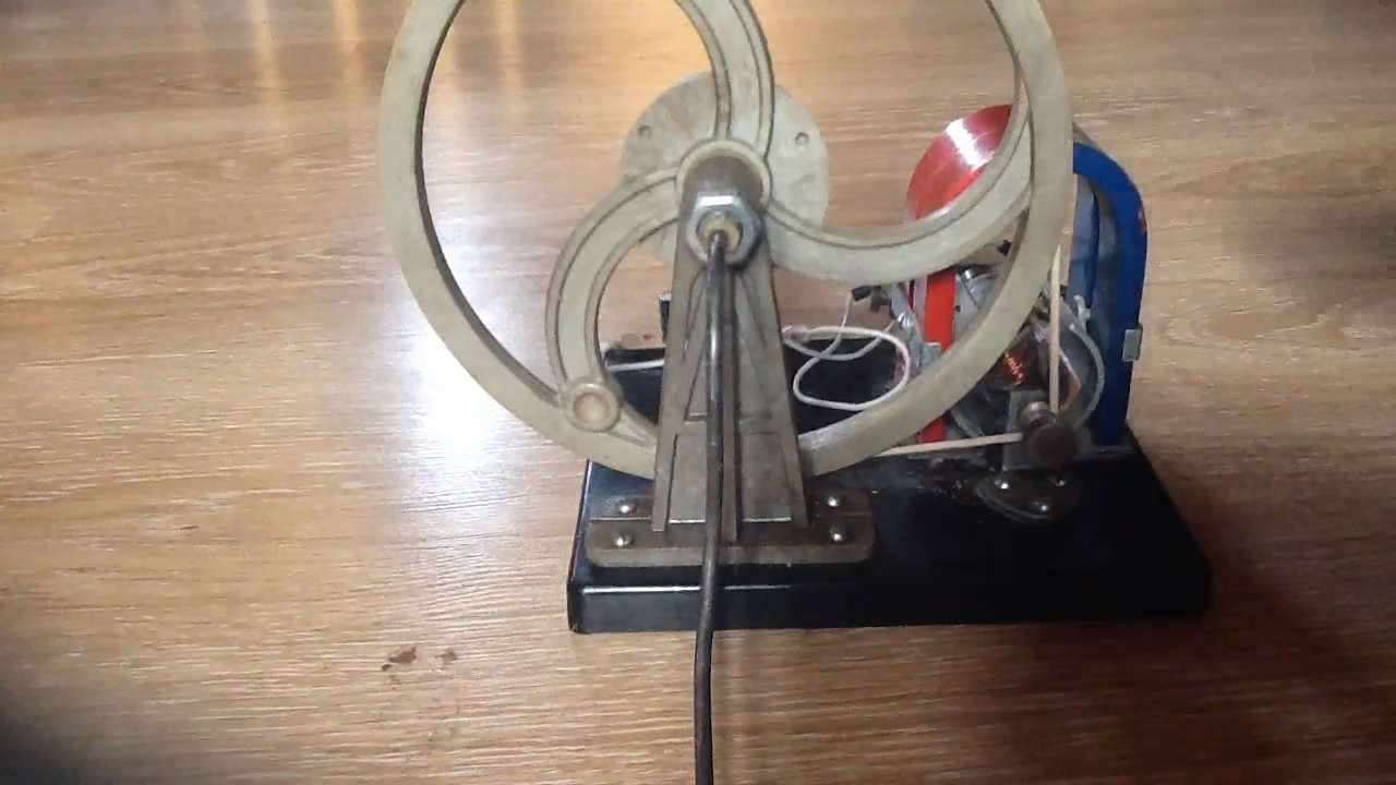

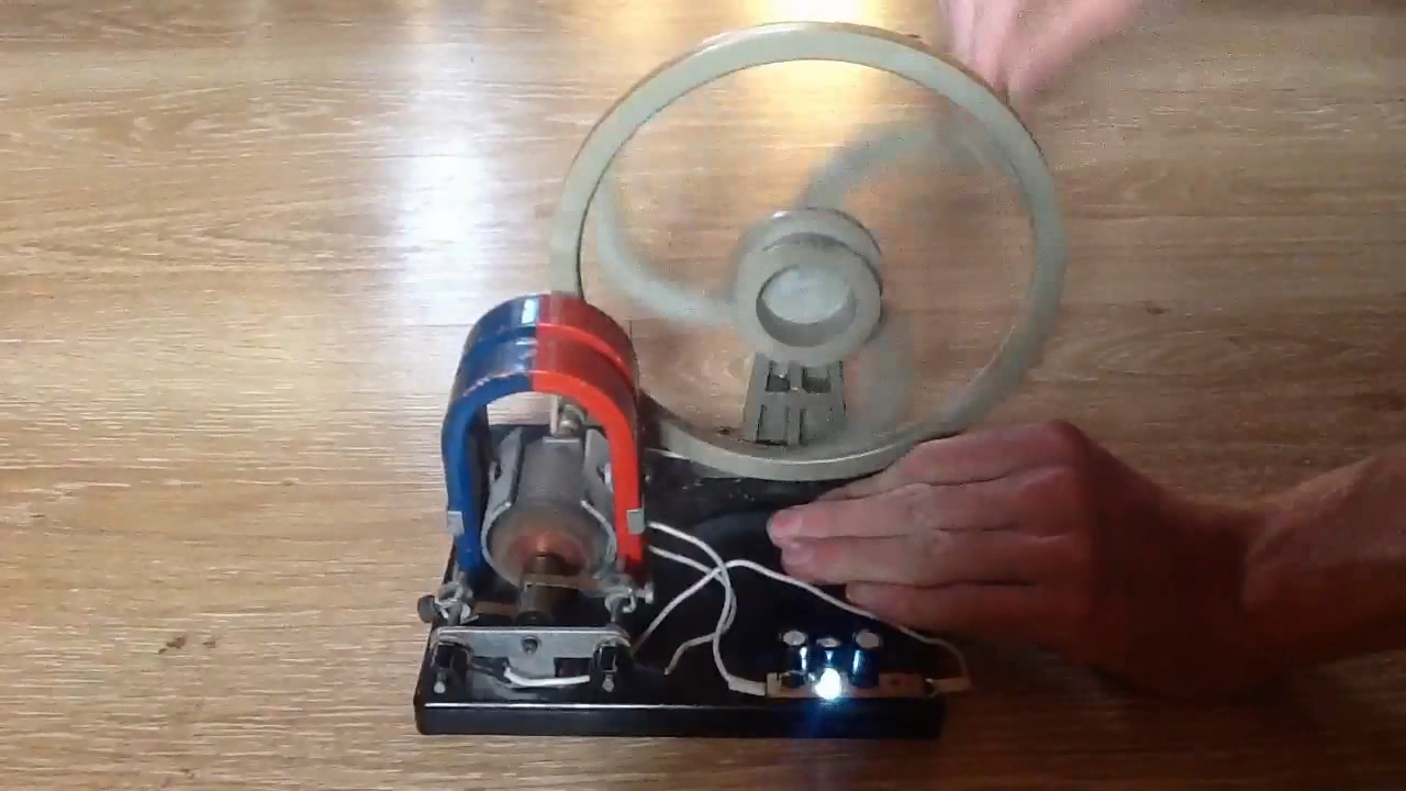

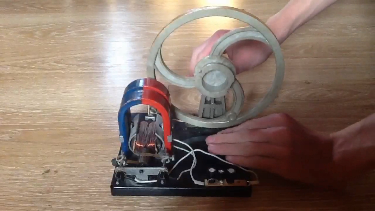

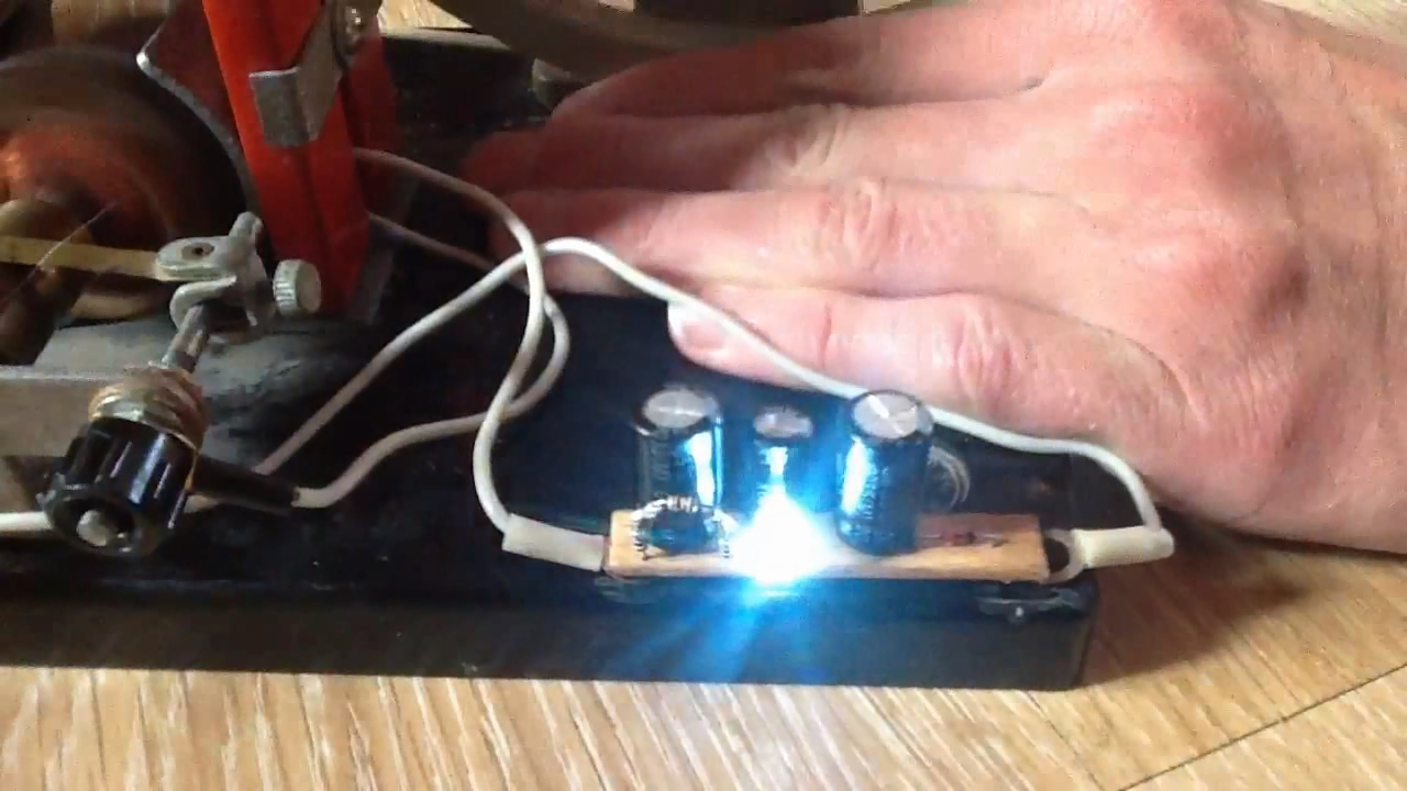

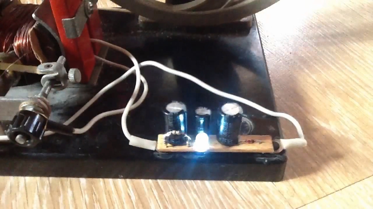

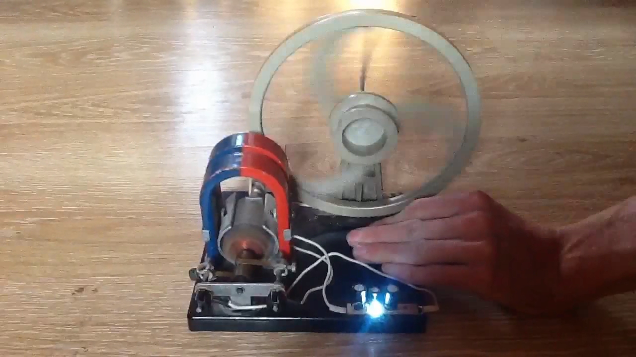

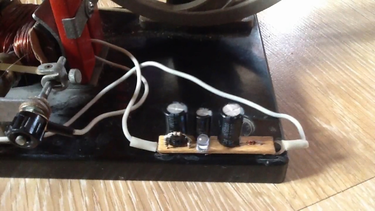

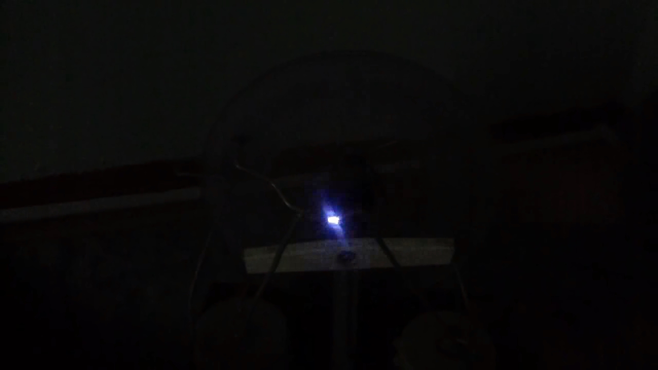

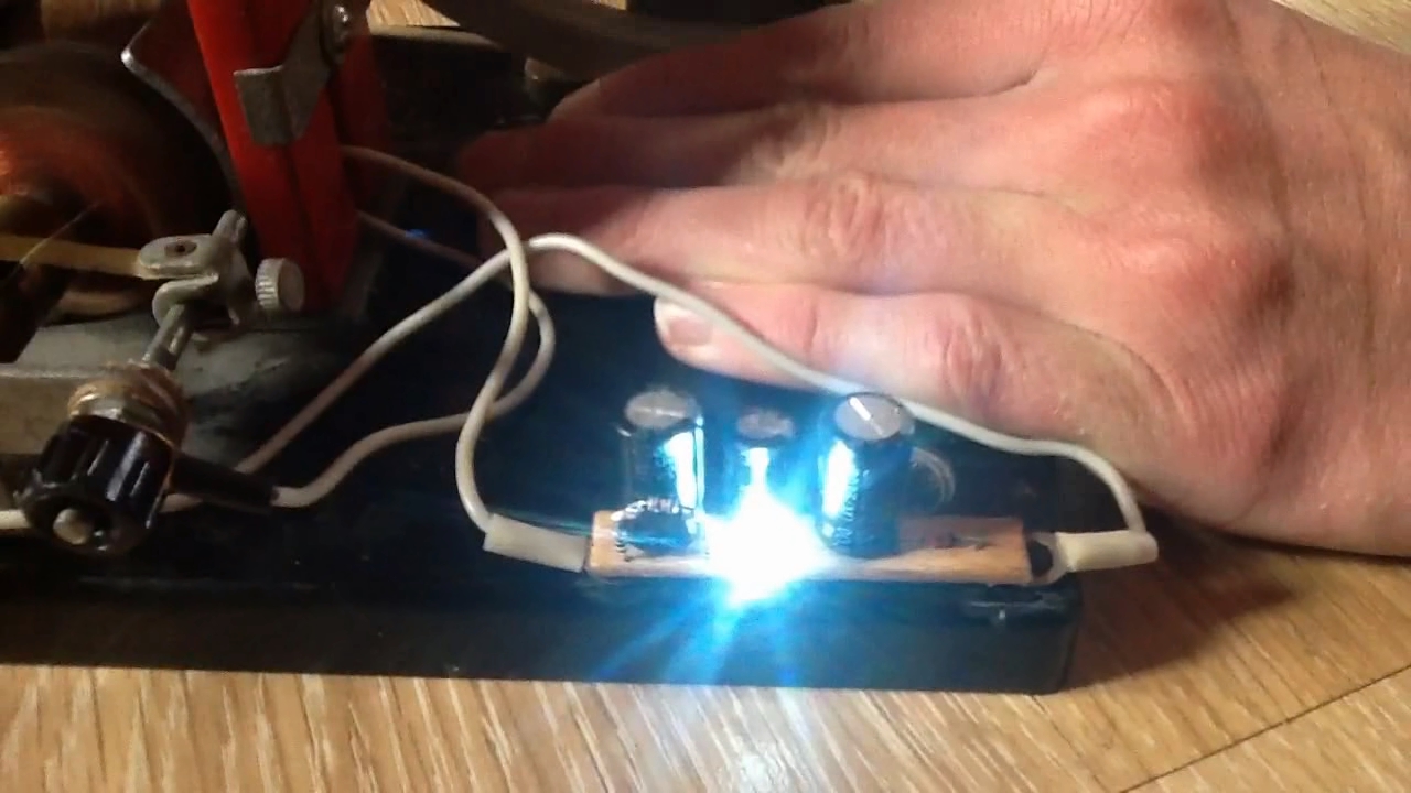

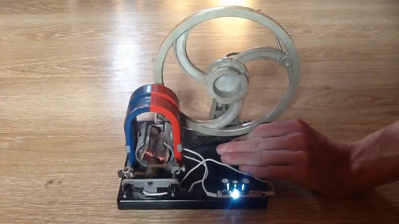

Школьная электрофорная машина и динамо-машина - часть 2 At the end, I decided to film the discharge in the dark and went out into the corridor. There, the chemistry teacher unexpectedly saw me, and you can hear her voice in the background. Interestingly, I did not tell anyone about repairing the machine (in case they forbade me from doing it). After many experiments with the Wimshurst machine at school, I can conclude that I liked this "toy." Later, I fixed the school dynamo. Instead of a light bulb, I installed an LED. I also connected capacitors in parallel to the machine. The diode was at the input. This turned out to be very convenient. |
