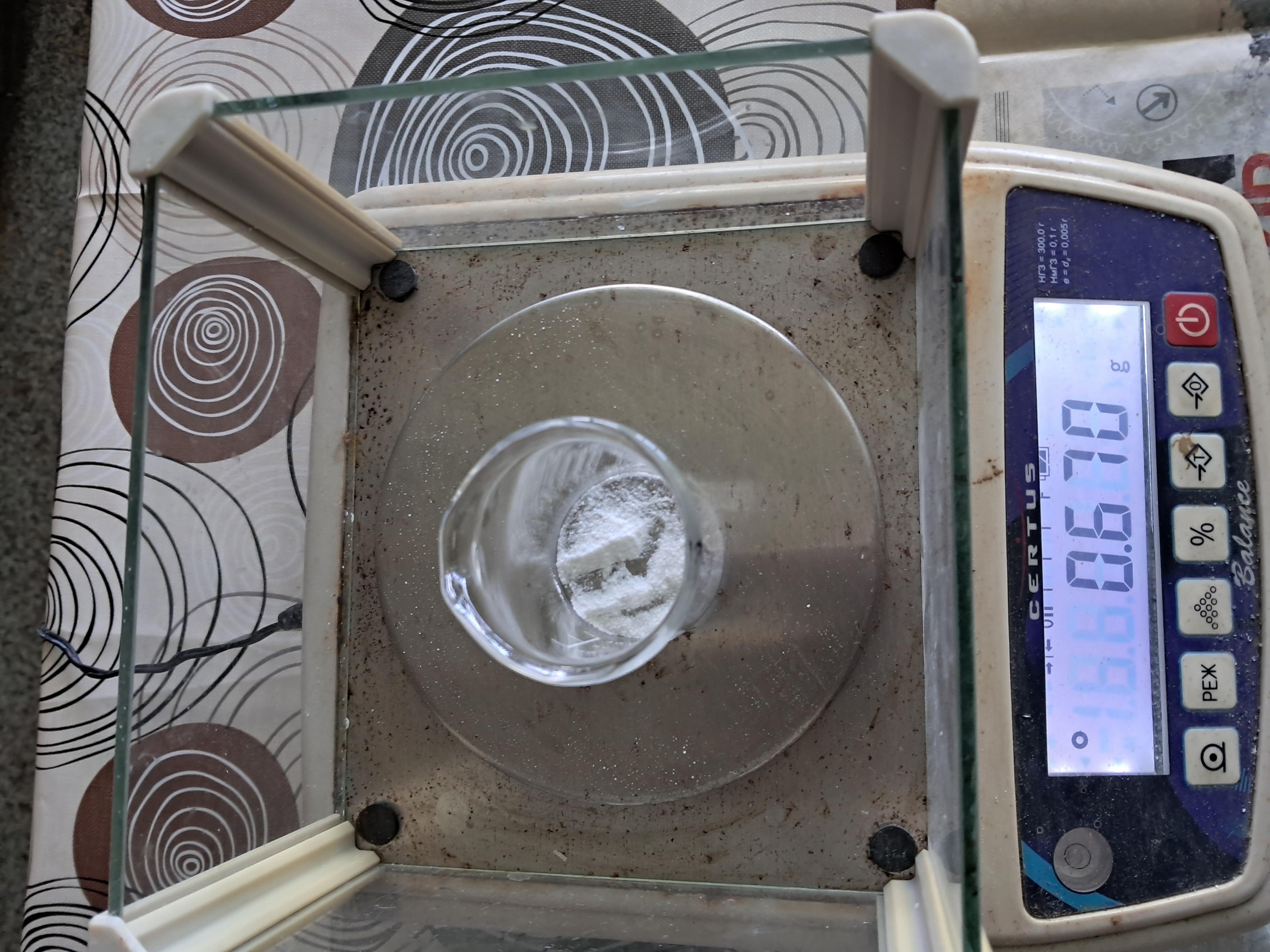

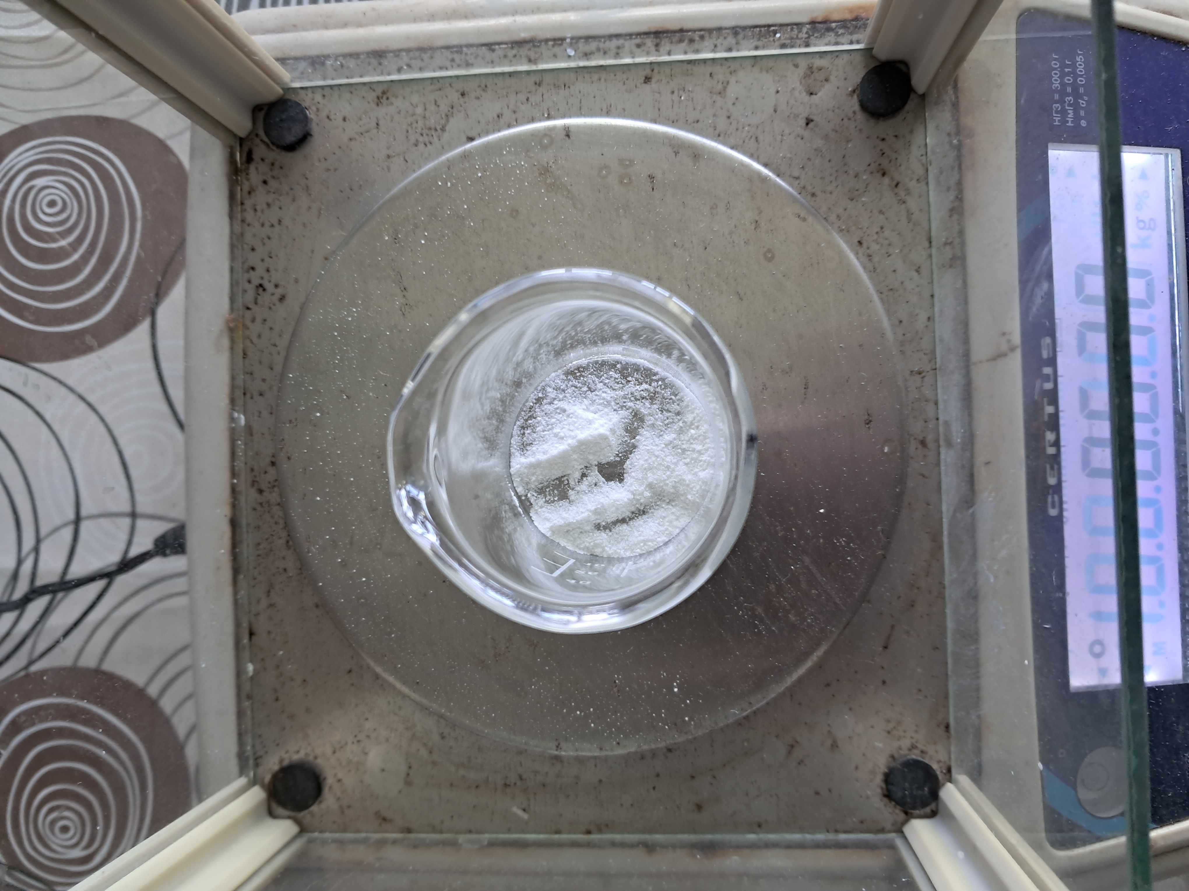

I will tell you how I synthesized ammonium perchlorate a little later. The story turned out to be interesting and revealing. The main part of the story will not be about inorganic synthesis (this procedure is elementary), but rather about the adventures of chemists and the peculiarities of our work.
So, ammonium perchlorate was synthesized. But how could we confirm this? It made no sense to conduct qualitative reactions for perchlorate and ammonium ions. I remembered that ammonium perchlorate is a component of rocket fuels and various pyrotechnic mixtures. You can mix ammonium perchlorate with some reducing agent (fuel) and set it on fire. Of course, only a small amount of the mixture should be used.

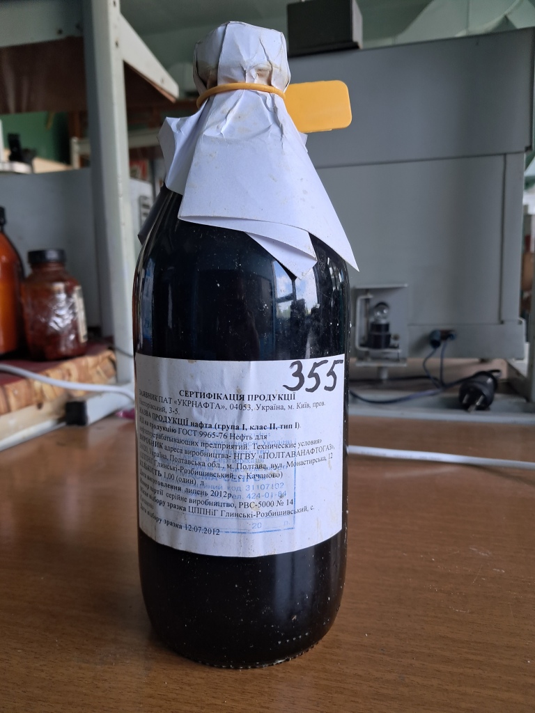

Which reducing agent should I take? We have a laboratory of analytical chemistry, not of "pyrotechnics, explosives and applied terrorism." There was aluminium in granules; the neighbours had granulated zinc and magnesium shavings. There was crude oil in bottles and some sorbents to absorb oil. There was bitumen. There were walnut shells and cellulose (a big bag of each). I decided that none of these substances were suitable.
Crude oil
Crude oil / Petroleum
Crude oil
Crude oil

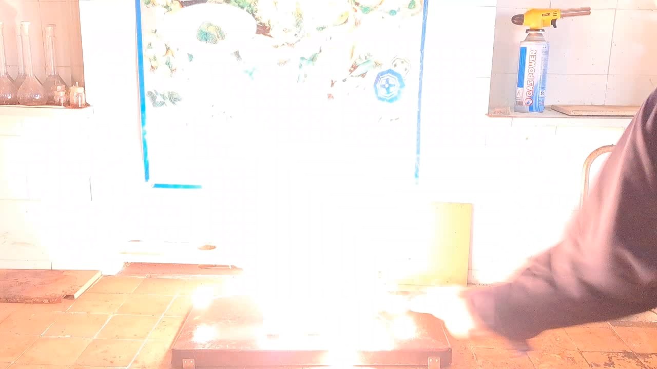

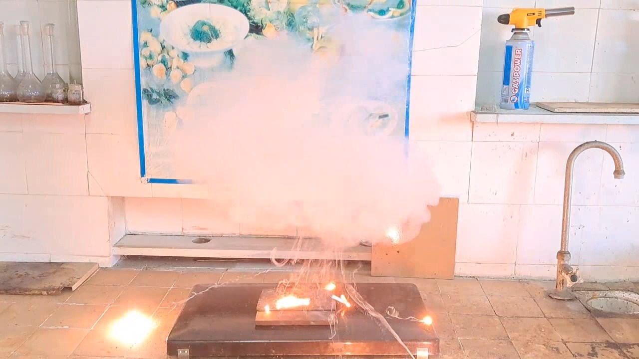

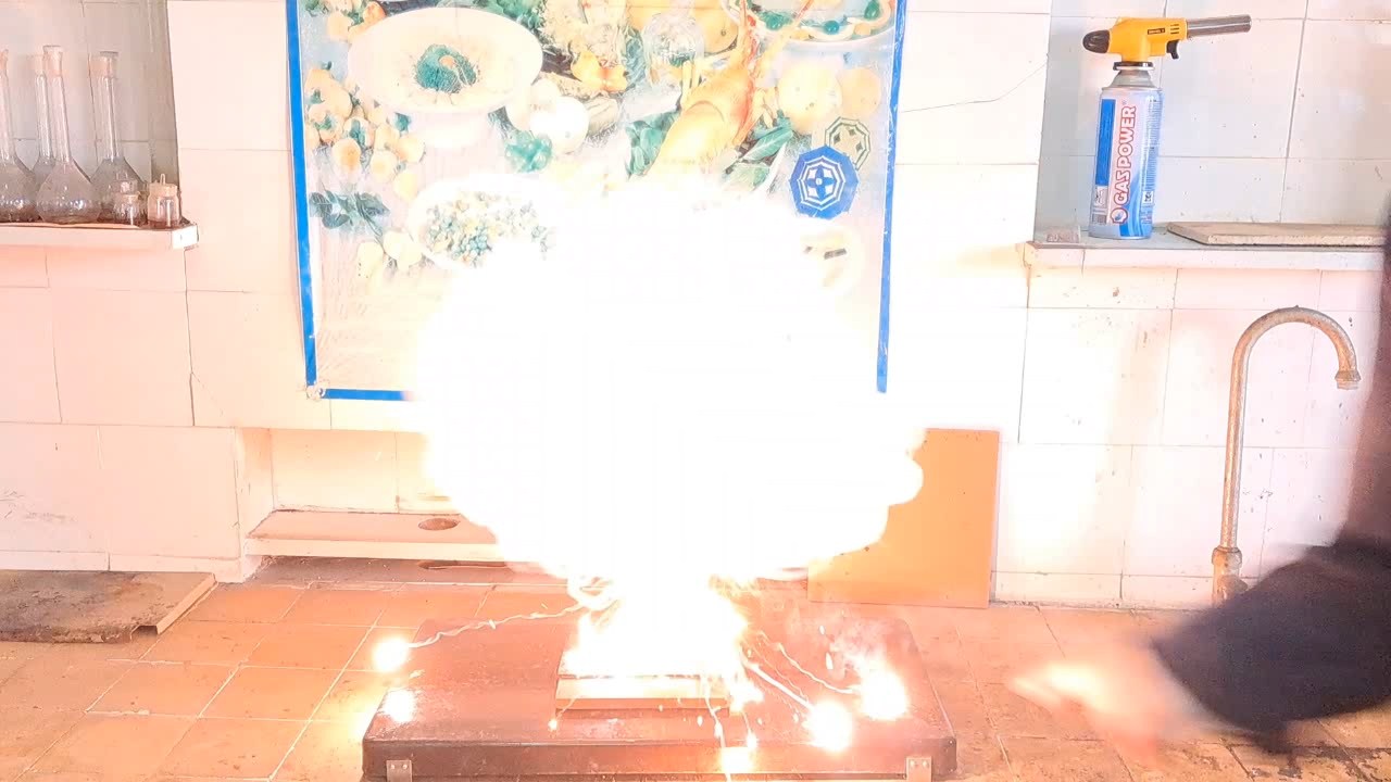

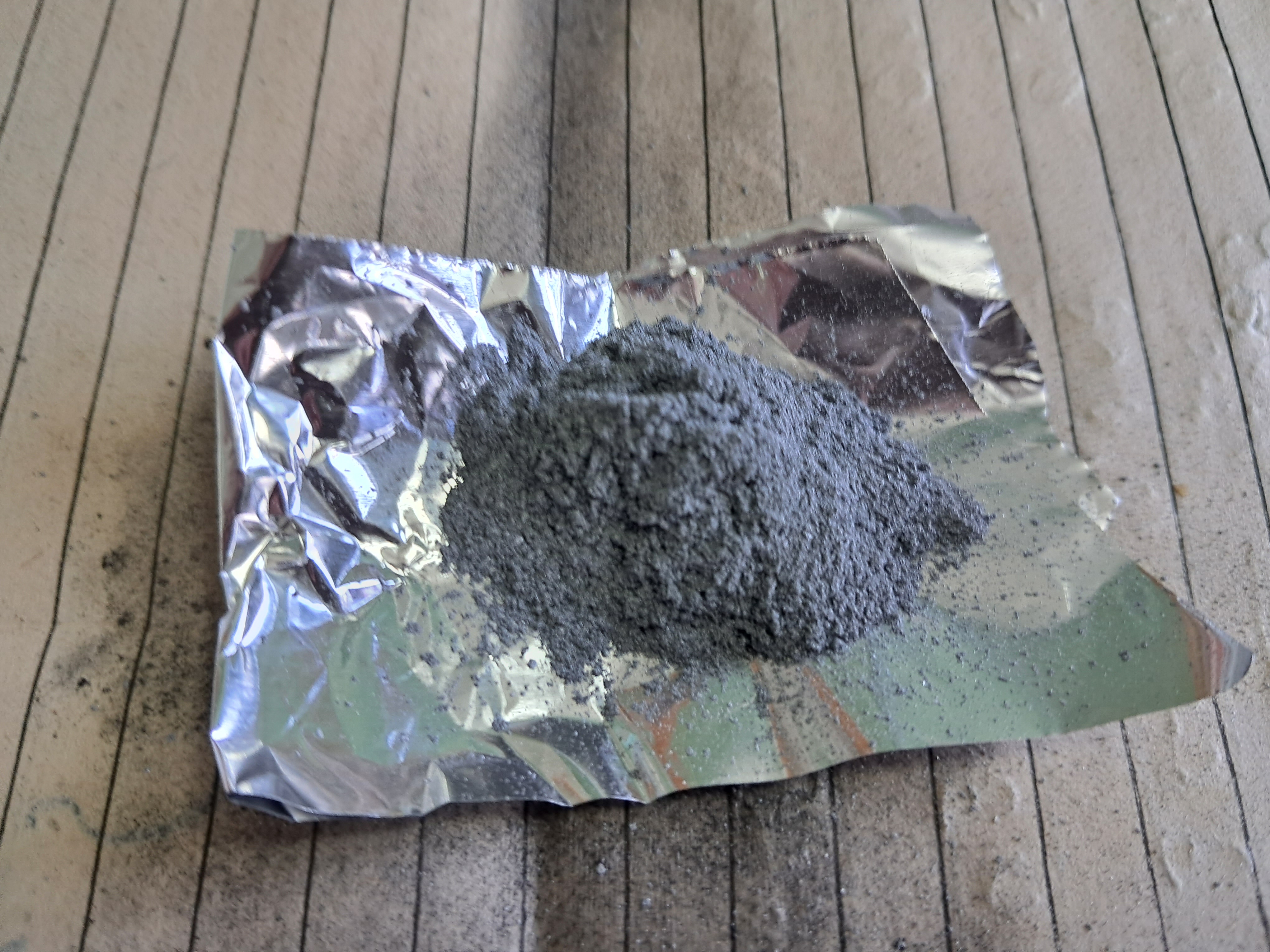

I remembered that at home I have "aluminium powder", an inorganic pigment that is finely dispersed aluminium. In addition to aluminium, this pigment contains a certain amount of aluminium oxide and special additives. I bought this aluminium powder as a child, about 40 years ago. While I was in school, I used most of it to carry out various combustion reactions. As an adult, I also filmed several chemical experiments with finely dispersed aluminium, but I did this infrequently.
Logical question:
- Is my aluminium powder still "alive"? (Did the aluminium oxidized?)
Fine aluminium could oxidize during storage (especially since I stored it for many years). You can check whether aluminium powder has oxidized using ammonium perchlorate. Mix the aluminium powder with ammonium perchlorate and ignite the mixture. If it burns brightly, the aluminium powder and perchlorate are of good quality. Otherwise, at least one of the components does not meet the requirements.

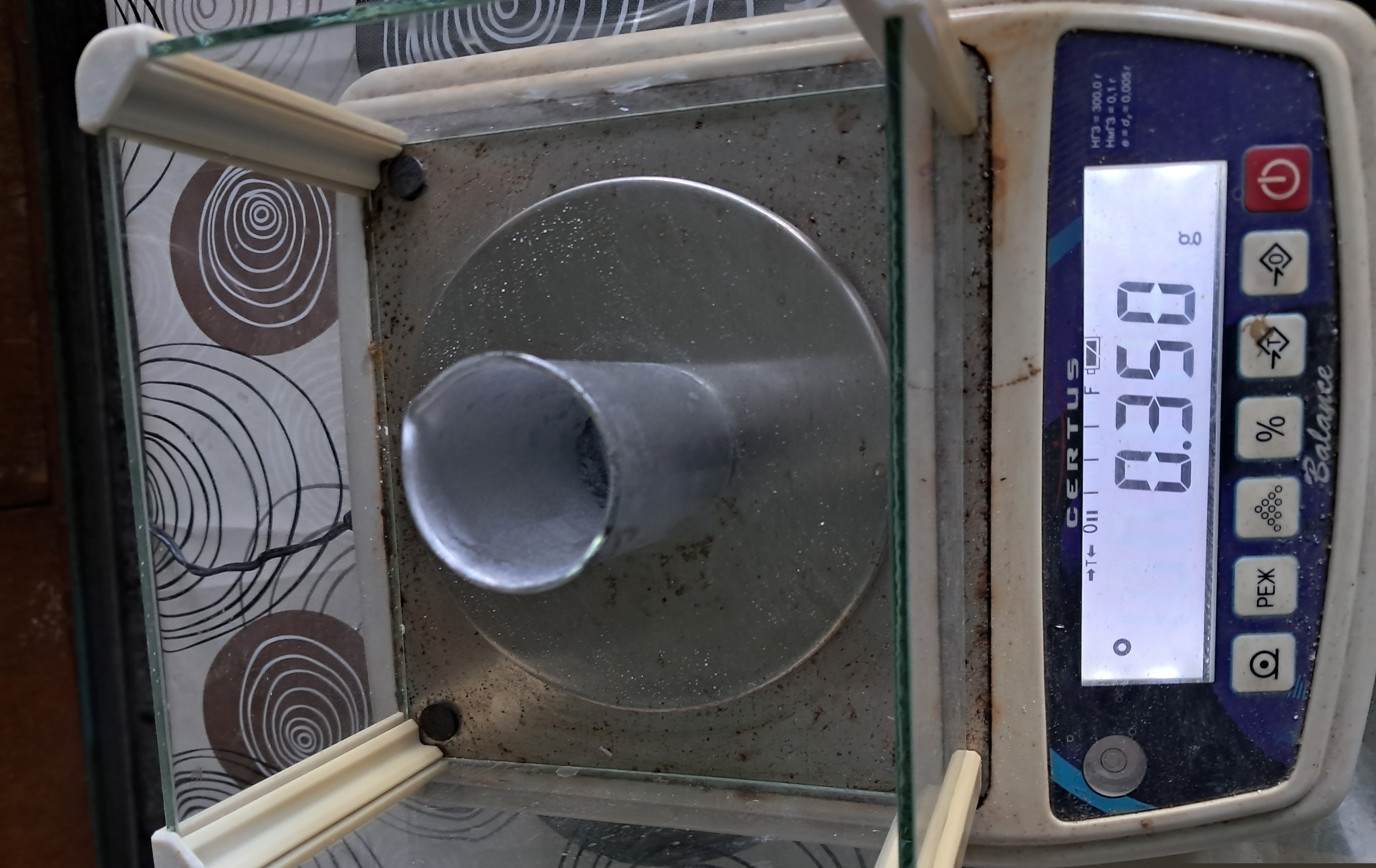

I brought the aluminium powder to the laboratory and asked my colleague how much aluminium and ammonium perchlorate to take. He did the math in his head and said:

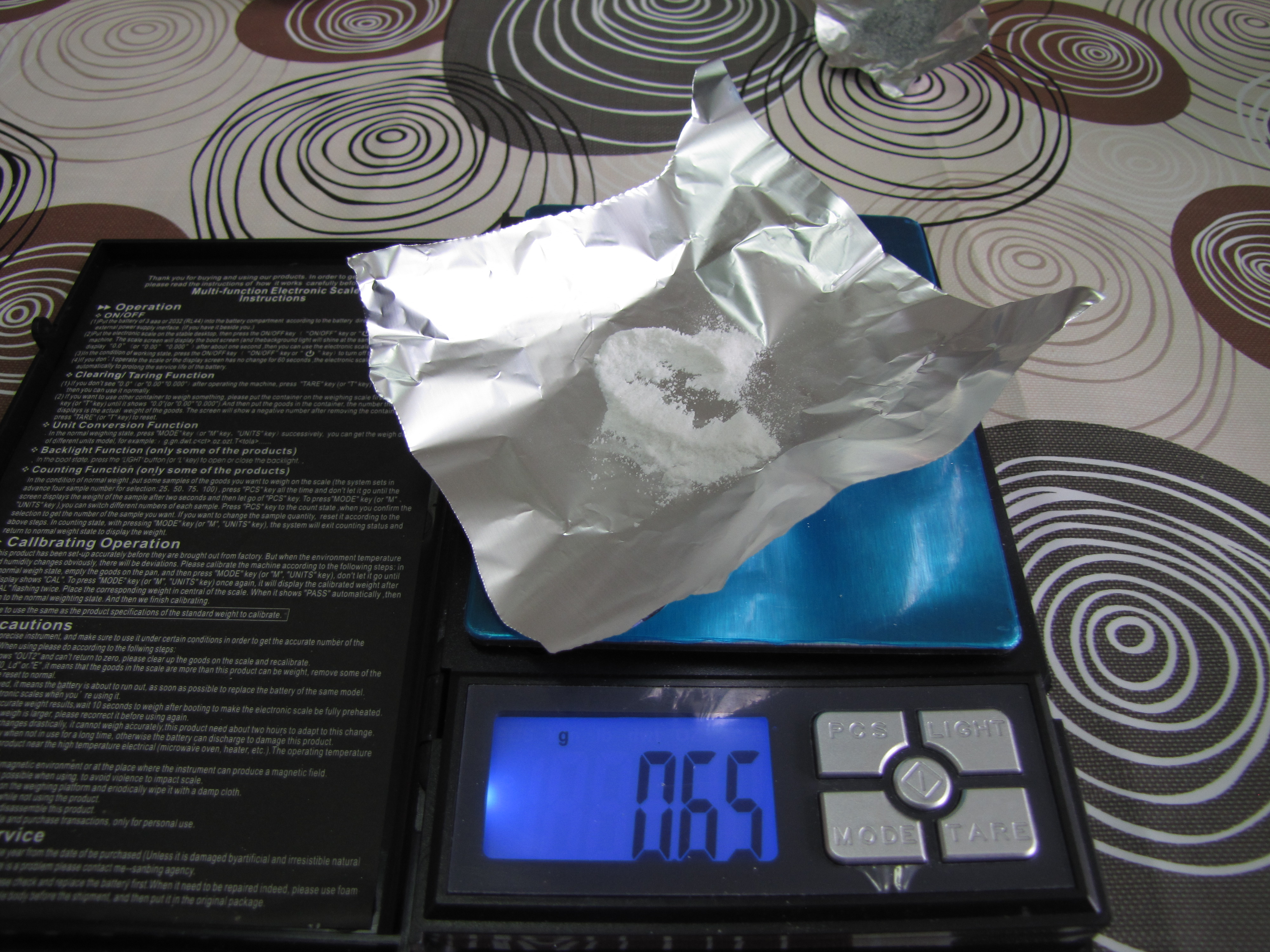

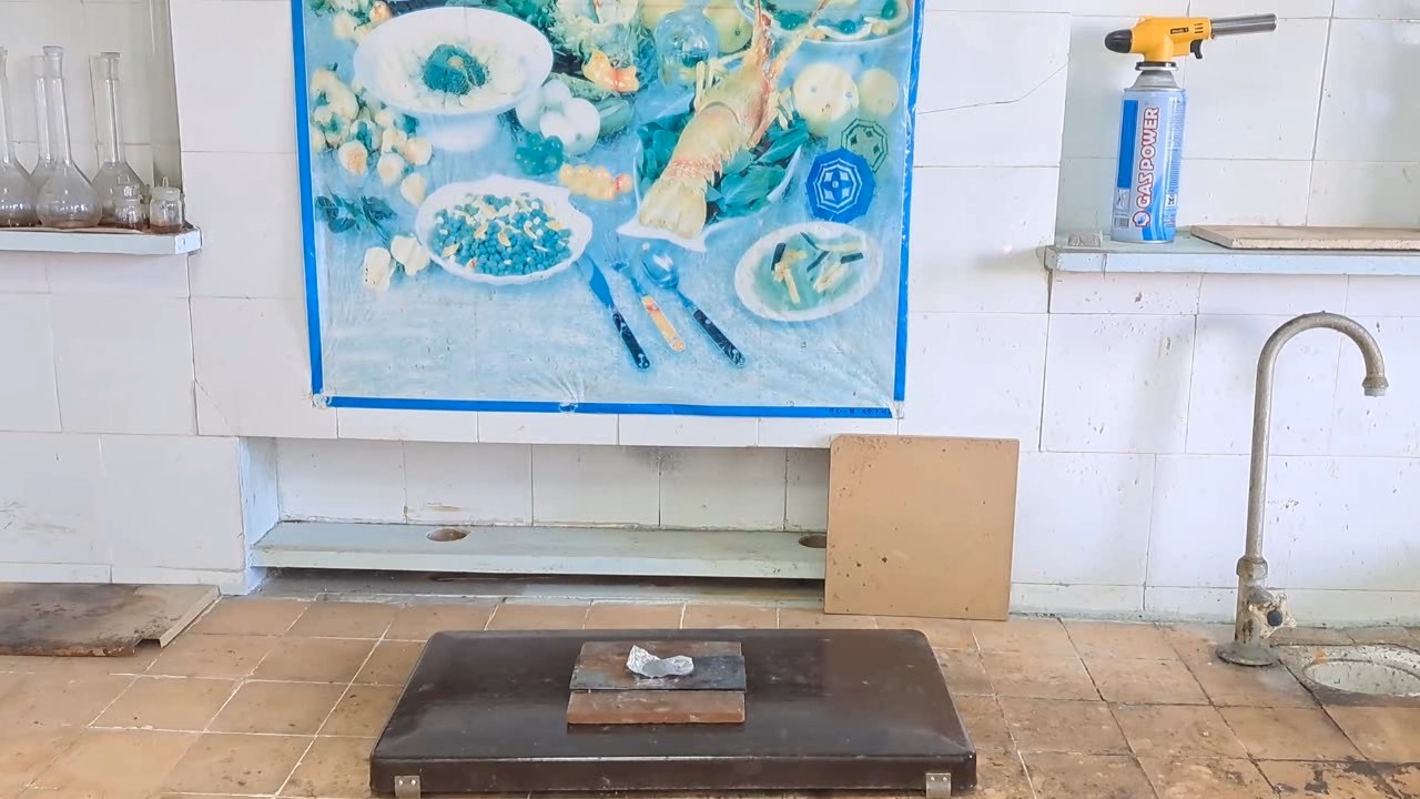

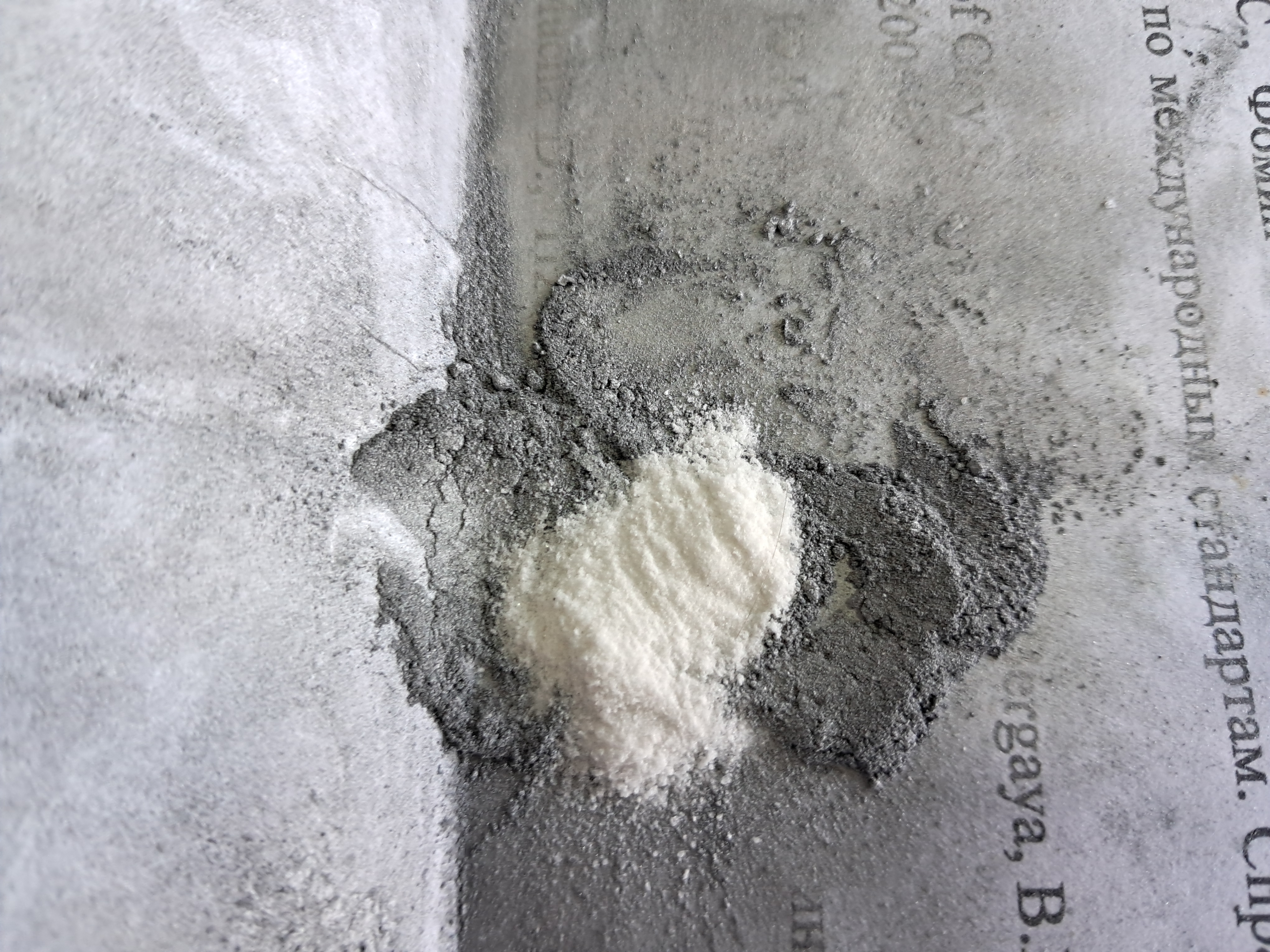

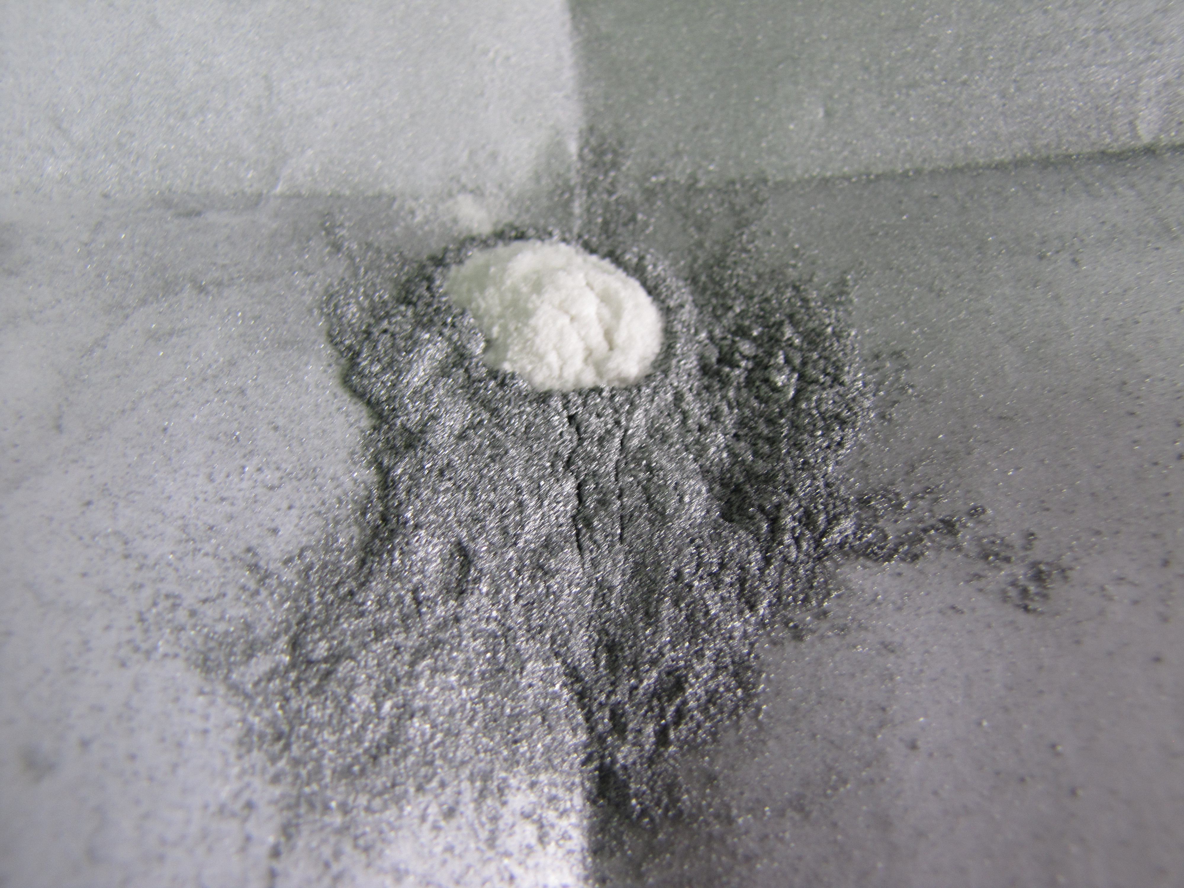

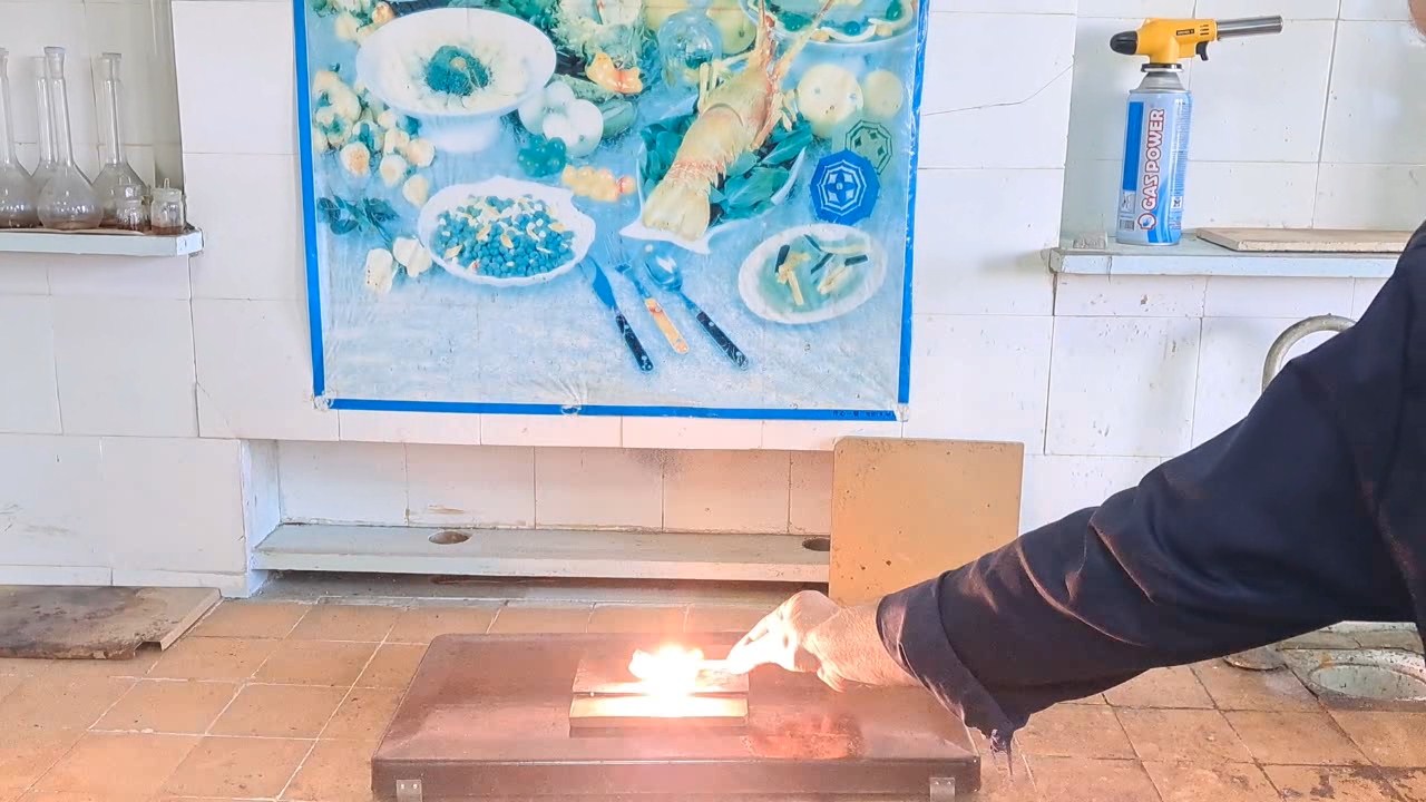

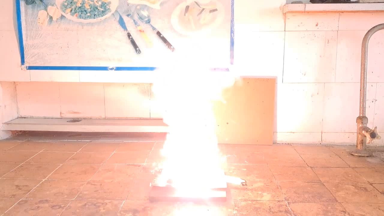

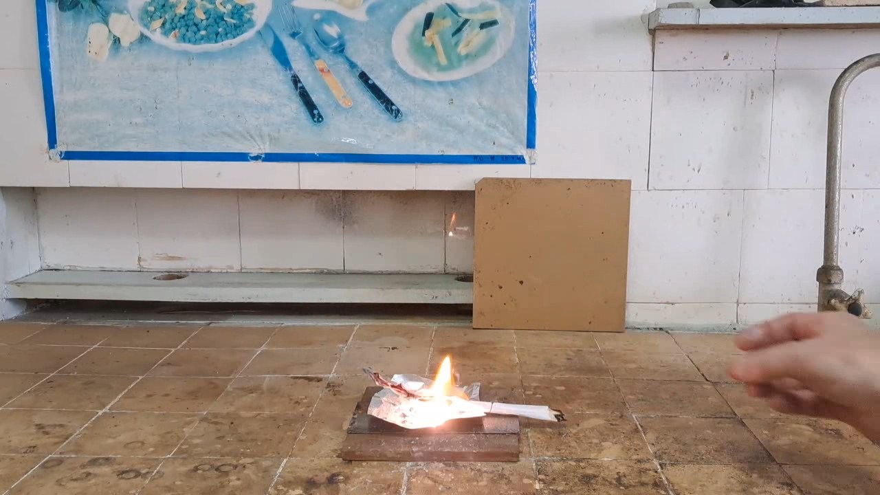

- 0.65 g ammonium perchlorate and 0.35 g aluminium.

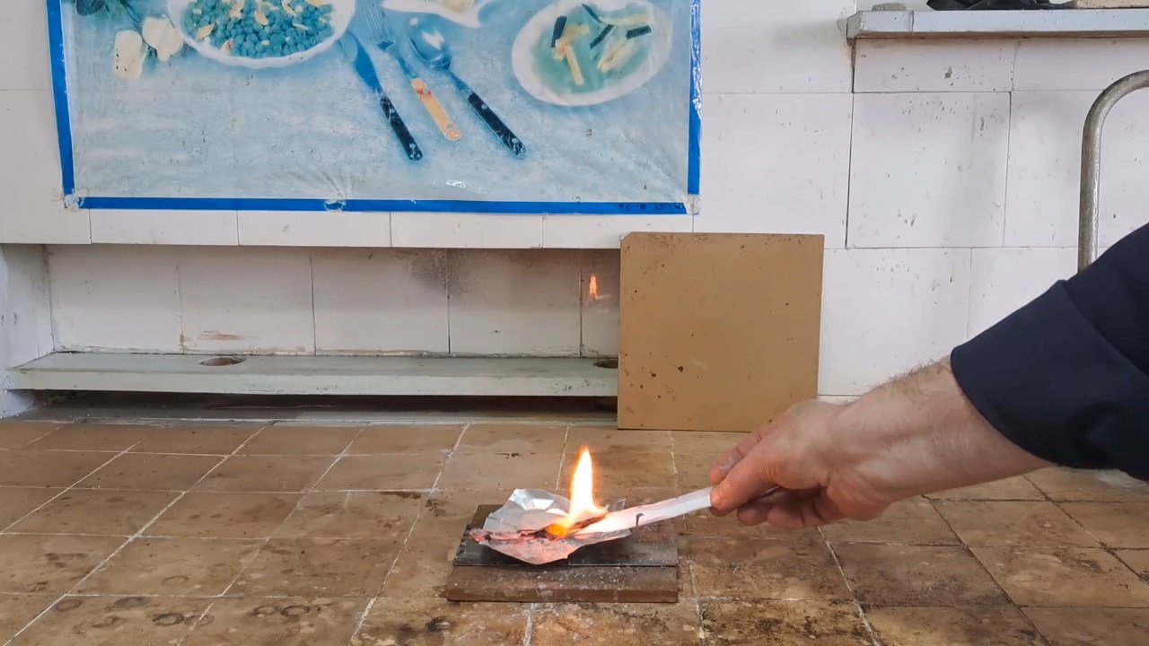

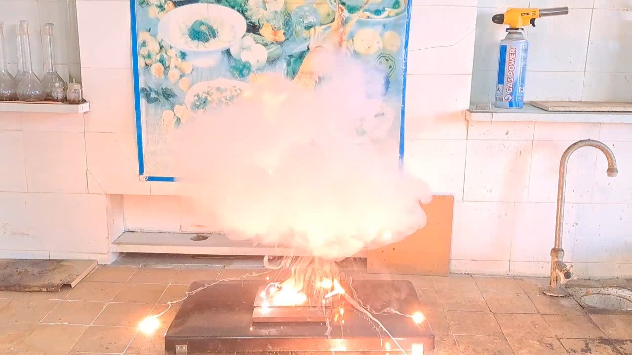

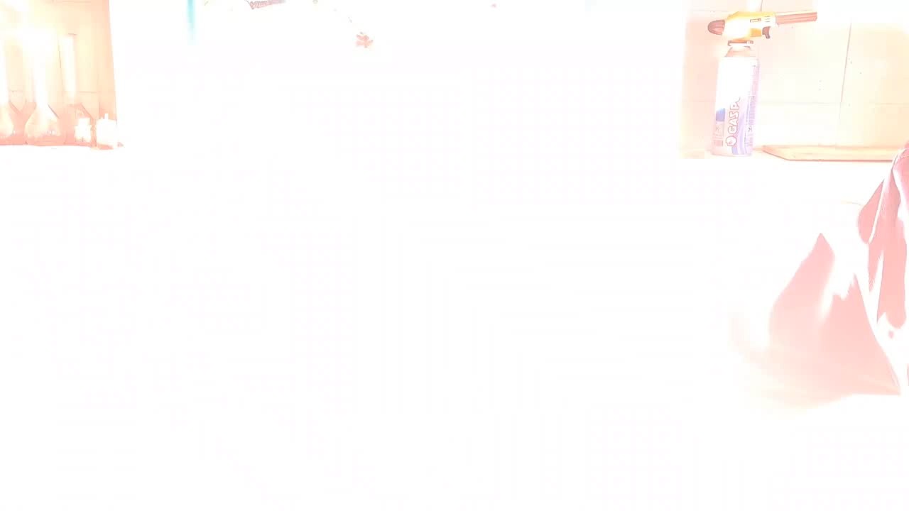

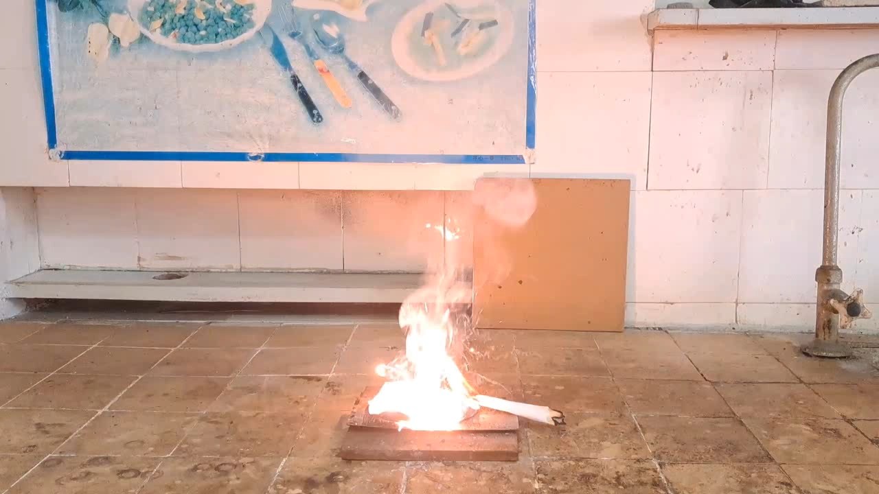

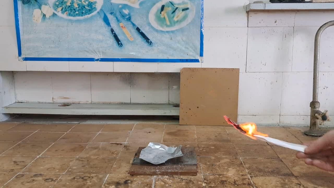

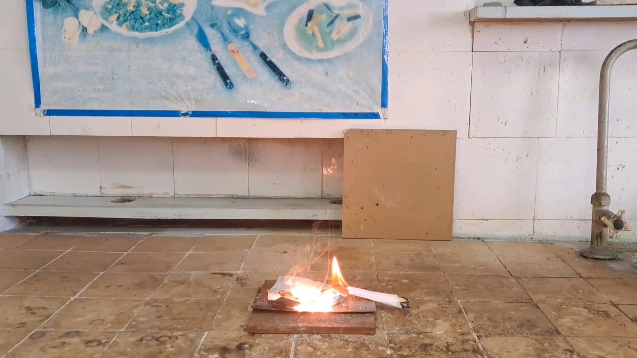

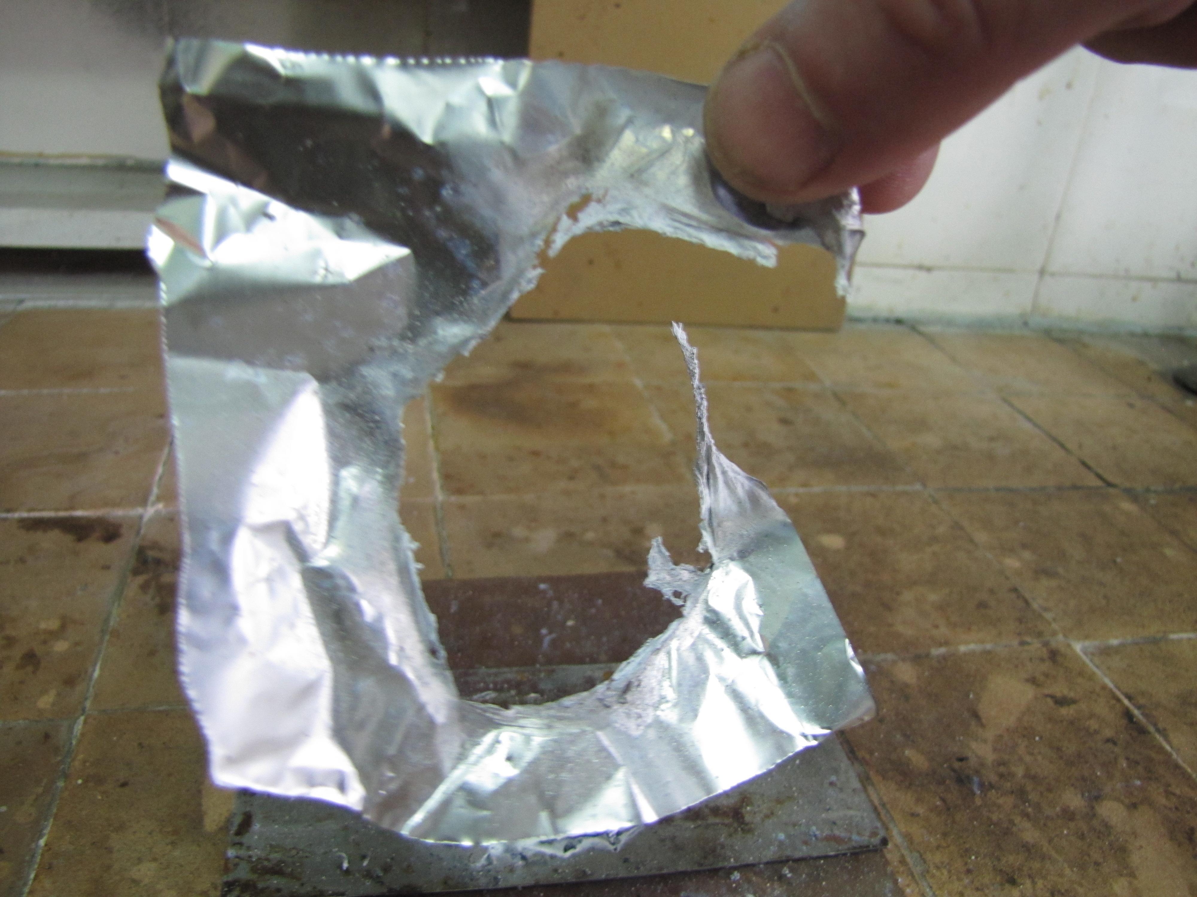

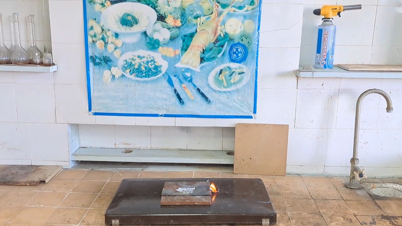

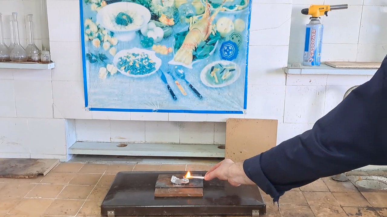

I weighed the substances, carefully mixed them on a piece of paper, and ground the mixture by covering it with paper and rolling a glass bottle on top. Then, I poured the mixture onto aluminium foil and held a burning piece of paper close to it. There was a bright white flash (and quite a long one). The camera was "blinded" (I think it is necessary to place the camera further or use a dark filter).

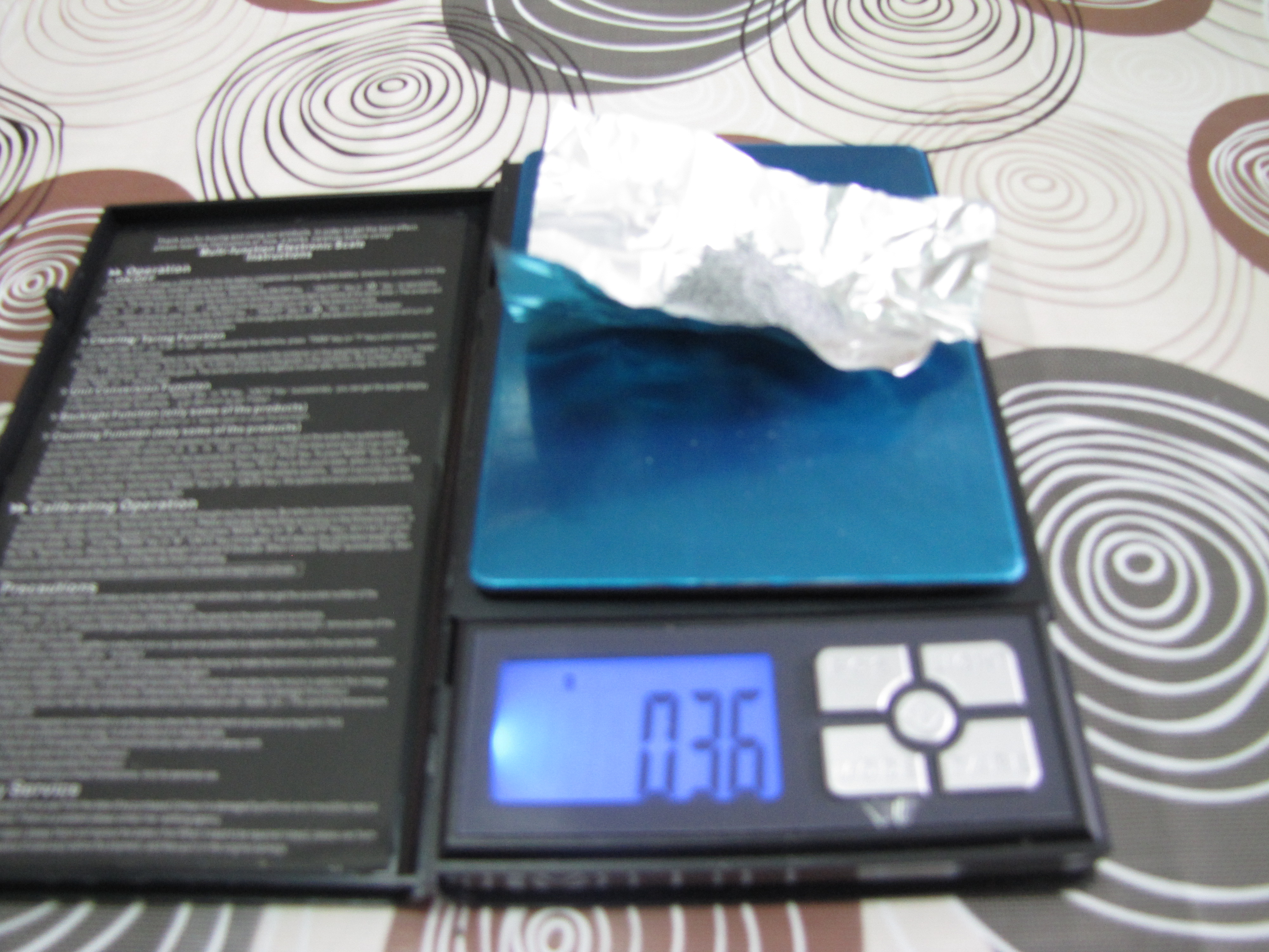

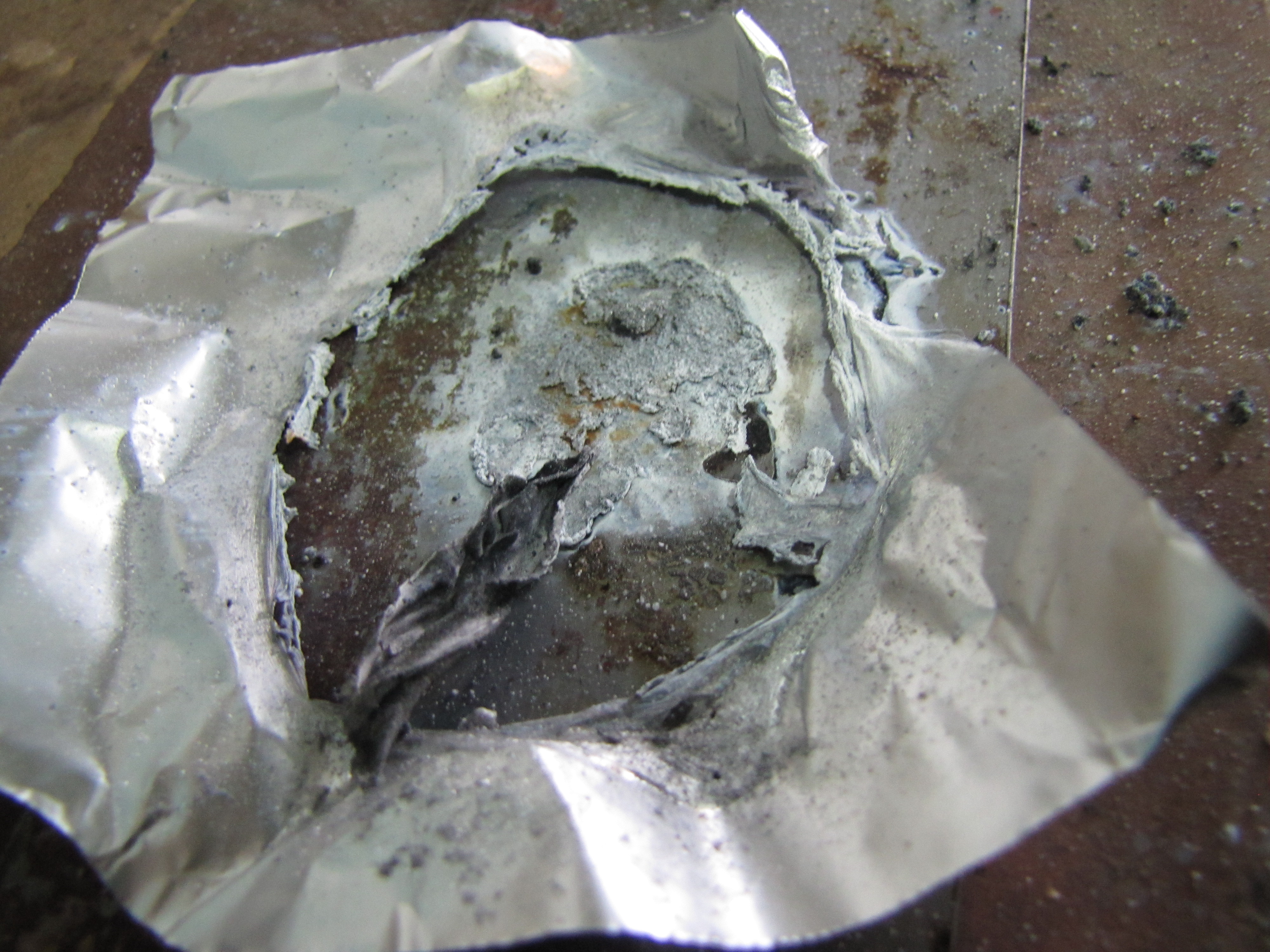

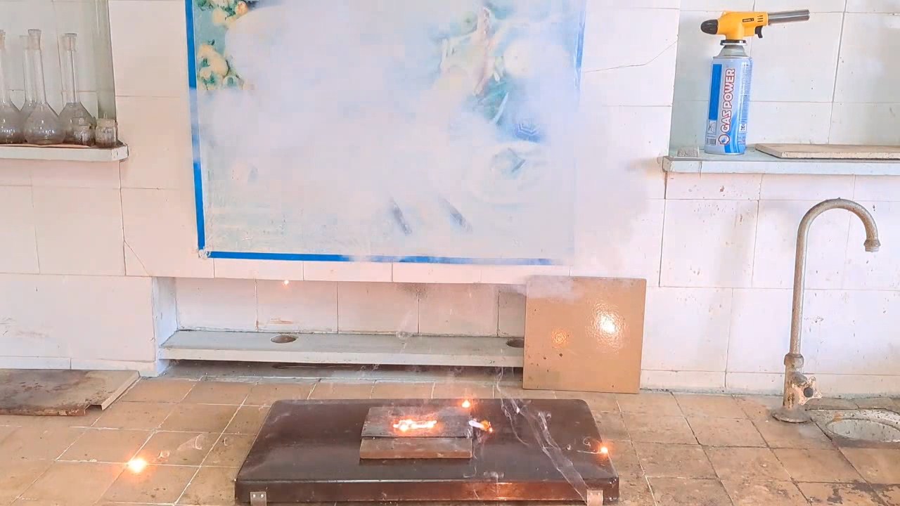

The aluminium foil burned through (a large hole appeared in it). Previously, I used the same foil to burn smokeless powder (1 g) in it. When the smokeless powder burned, no holes were formed in the foil.
After the experiment, I calculated the stoichiometric amount of aluminium in the mixture based on the molar ratio:
(1/3)Al = (1/5)NH4ClO4.
It turned out that the weight ratio of the components should be:
NH4ClO4/Al (wt.) = (117.49/5) / (26.98/3) = 2.61
Therefore, the weight fraction of aluminium in the mixture should be:
1/(2.61 + 1) = 0.28 (wt.).
In other words, I used a mixture with excess aluminium. This was not a problem because the aluminium powder burned by reacting not only with perchlorate but also with oxygen in the air.

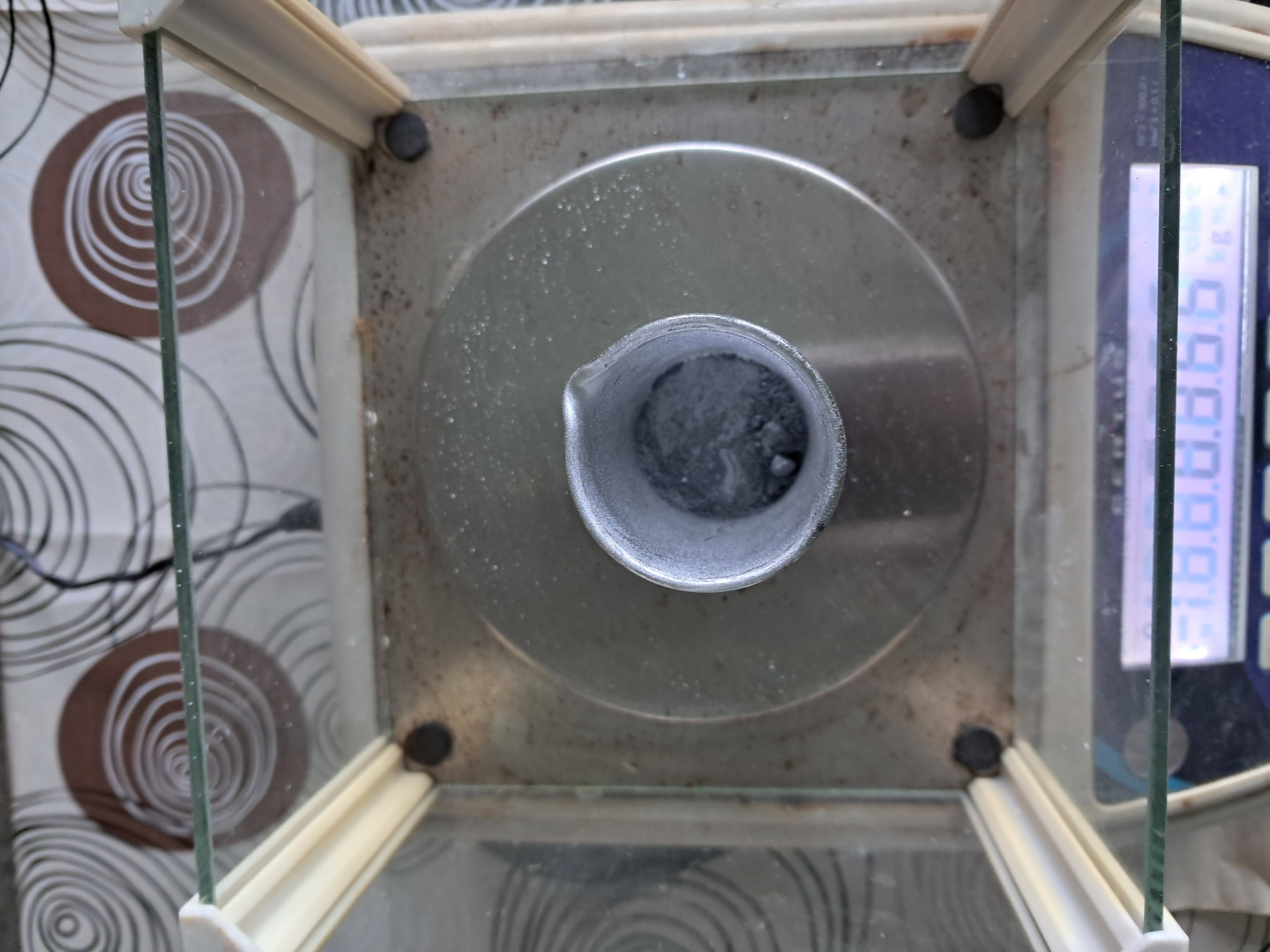

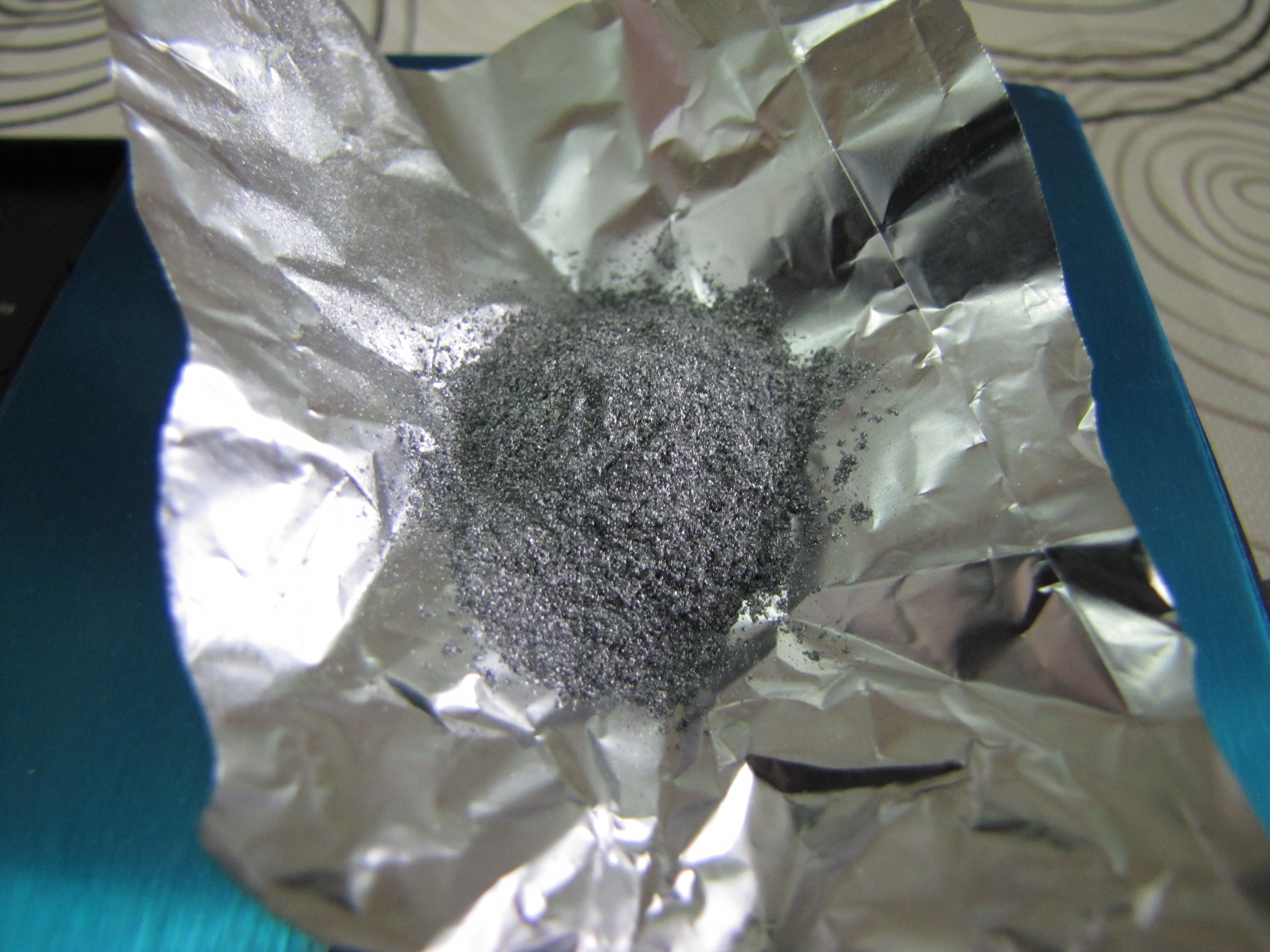

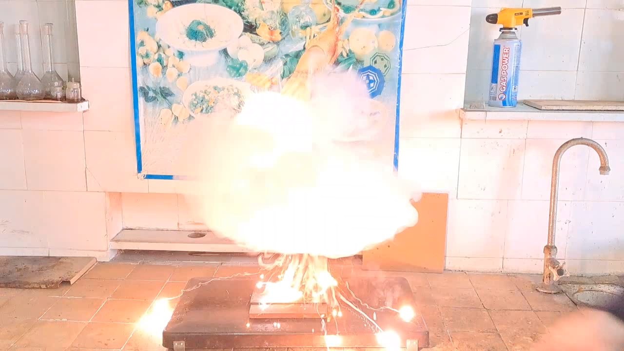

A little later they brought me fine aluminium powder in alcohol. It was obtained from aluminium powder (pigment) using a new disintegration method (unfortunately, I cannot describe the details). The task was to filter the aluminium, dry it and give it to colleagues for research. During drying, the powder began to turn white in places. I suspected that aluminium was oxidizing in the air. The smallest, and therefore the most active, particles likely underwent oxidation. In such cases, drying is carried out in a vacuum, in an inert atmosphere, or in a reducing atmosphere. At that time I did not have such an option. Therefore, I dried the aluminium powder until the smell of alcohol became weak and immediately placed it in a hermetically sealed jar. By the way, when I saw that the aluminium was turning white, I put the tray with the powder on a metal tray (aluminium could ignite due to the heat of reaction with air).
To determine the content of aluminium in a mixture with its oxide, you need to dissolve a sample of aluminium in sulfuric or hydrochloric acid and measure the volume of hydrogen released during the reaction. This analysis is not difficult, but there is one exception: you must set up the method of analysis from scratch. You need to find the components and reagents and assemble the apparatus. Then it is necessary to test the method using standard samples. After this, you can begin the determination of aluminium. I did not have that much time. The task was to dry the sample and immediately transfer it to colleagues for research (or tell them that the sample was unsuitable).
How can you quickly determine whether aluminium has oxidized? Burn its mixture with ammonium perchlorate. The method is rough but fast. So I did. Again I weighed 0.65 g of ammonium perchlorate and 0.35 g of aluminium and mixed the components. The resulting mixture was poured onto aluminium foil and lit. There was a bright white flash. I moved the camera further away this time, but the flash still blinded it.

Aluminium and ammonium perchlorate
