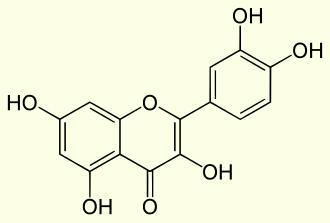

Quercetin
Quercetin

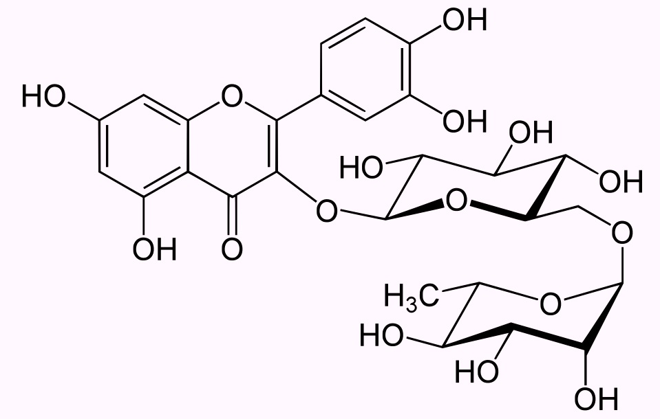

Rutin
Rutin

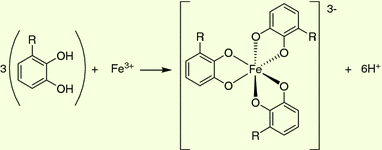

Polyphenol-iron complex resulted from reaction of FeCl3 with the OH groups
In the past, I obtained iron complexes with various phenols. Initially, I used tea tannins, oak gall tannins, and aqueous extracts from other plants. Later, I synthesized iron complexes with reactive tannin and gallic acid. The color of these complexes ranged from violet to nearly black.

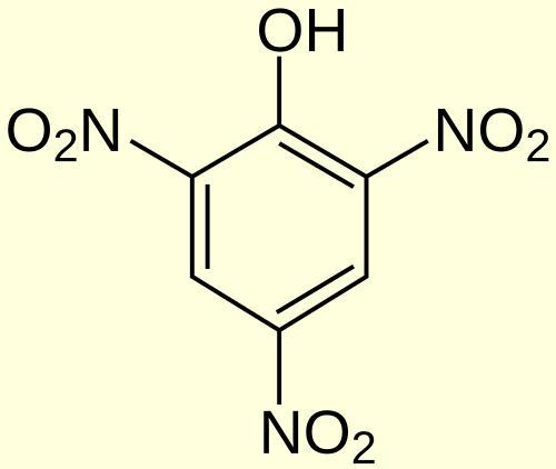

Picric acid
Picric acid
Picric acid
Picric acid

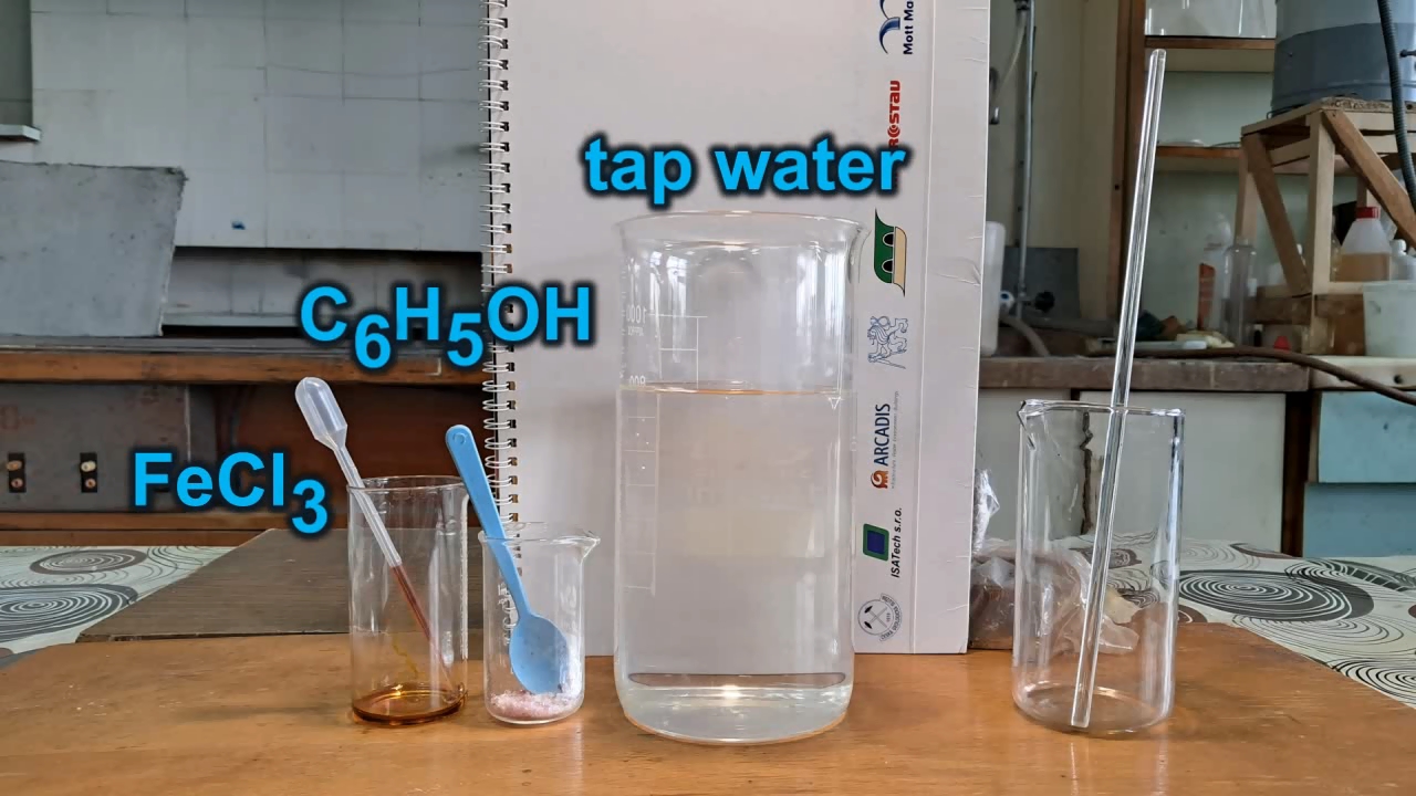

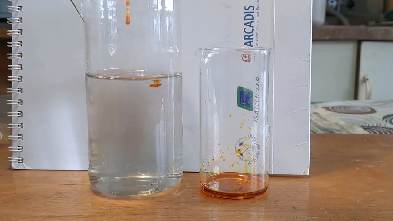

There is a jar of phenol in the lab - and iron(III) chloride as well. I decided to obtain the Fe(III)–phenol complex and film the reaction as it formed. In practice, this task turned out to be not as straightforward as the textbooks suggest. I'll tell you everything in order.
Танины, флавоноиды, пикриновая кислота, сульфосалициловая кислота, флуоресцеин, галловая кислота, дубовая кора, корни, листья и ягоды различных растений... Я проводил данный эксперимент с различными фенолами и их природными смесями. Прошло много лет, и оказалось, что я ни разу не получал комплекс железа с простейшим фенолом - C6H5OH. Я даже не смотрел эту реакцию на видео!
Банка с фенолом есть в лаборатории, хлорид железа (III) - тоже. Решил получить комплекс Fe(III) с фенолом и заснять реакцию между данными веществами на видео. На практике эта задача оказалось не такой простой, как пишут в учебниках химии. Расскажу обо всем по порядку.
The reaction of FeCl3 with phenol
The reaction of iron(III) chloride with phenol

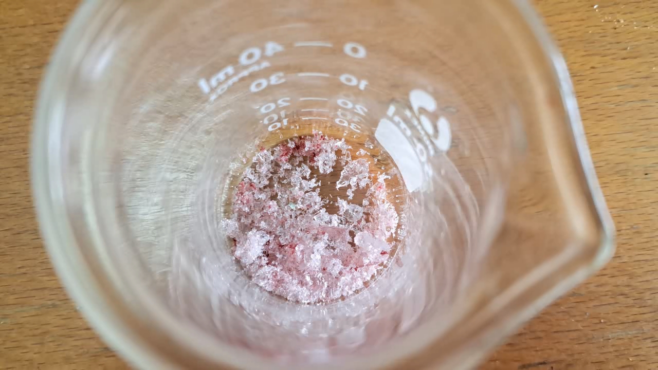

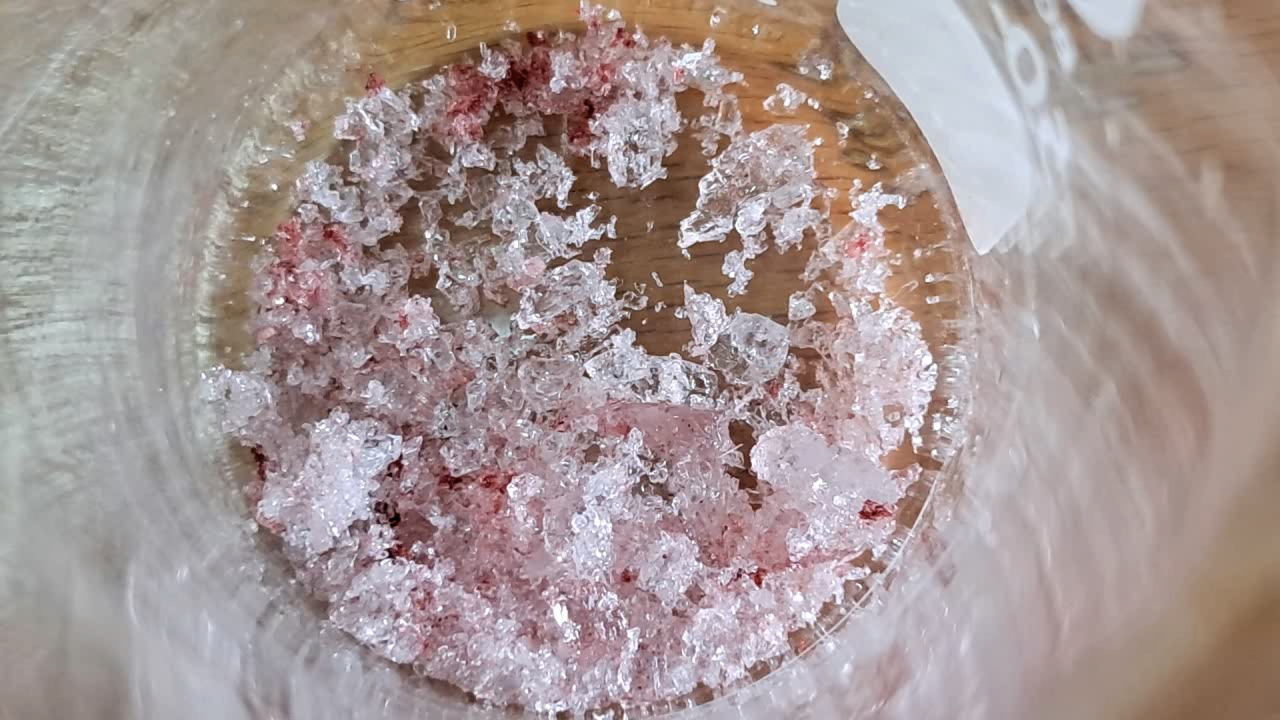

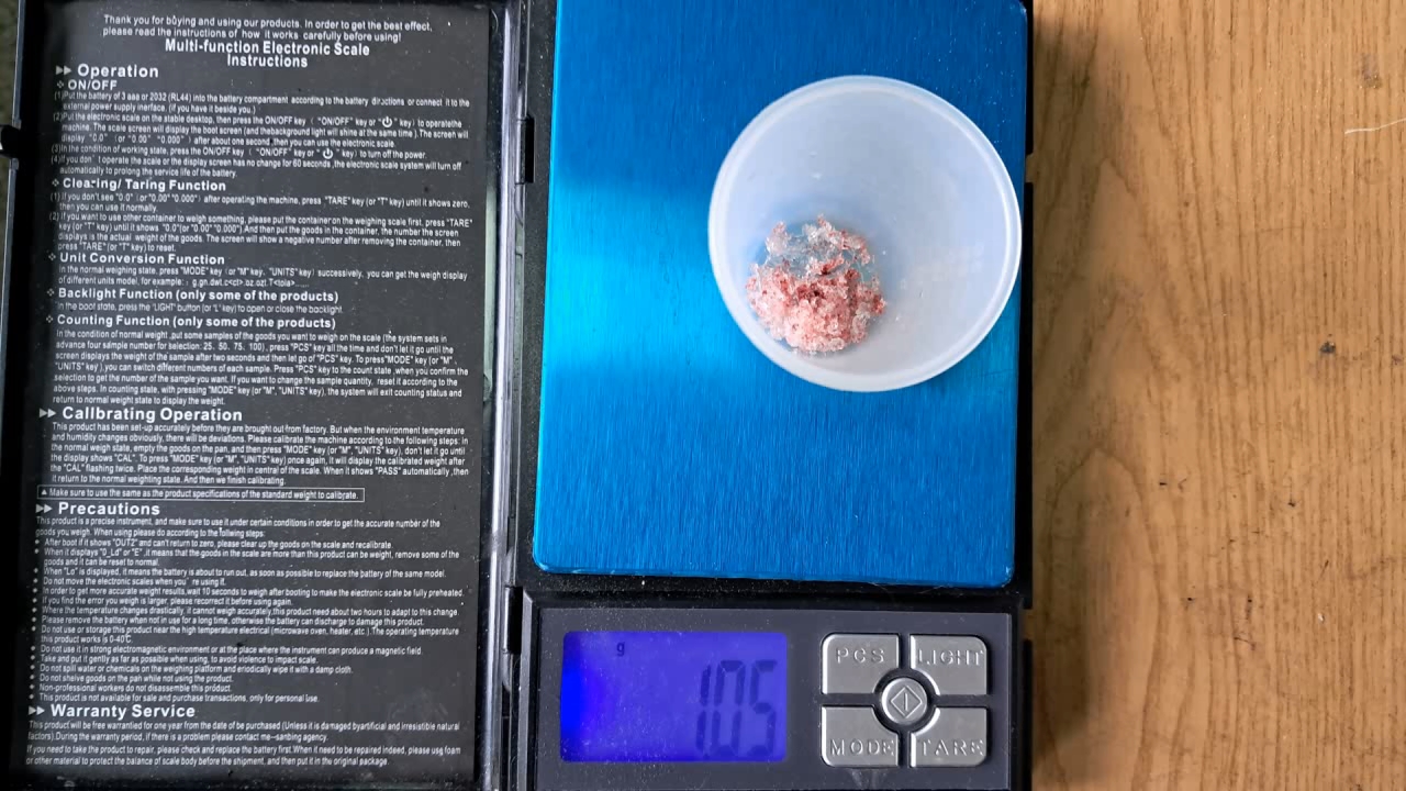

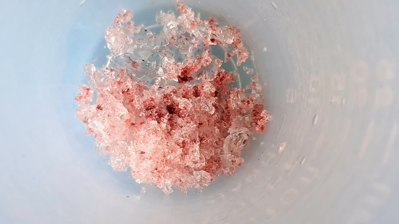

The phenol crystals were caked, making it difficult to extract the substance from the jar. I had to use a steel spoon and apply considerable effort. I collected several grams of phenol but forgot to weigh it. For qualitative analysis, the exact weight (or volume) of substances rarely matters, but it's still better to control the quantities used.
Pure phenol is colorless, but the crystals in the jar were pink due to partial oxidation during long-term storage. For some purposes, phenol must be purified by distillation. However, distilling phenol in the laboratory is not a pleasant process. For the experiments described here, the pink phenol was acceptable.

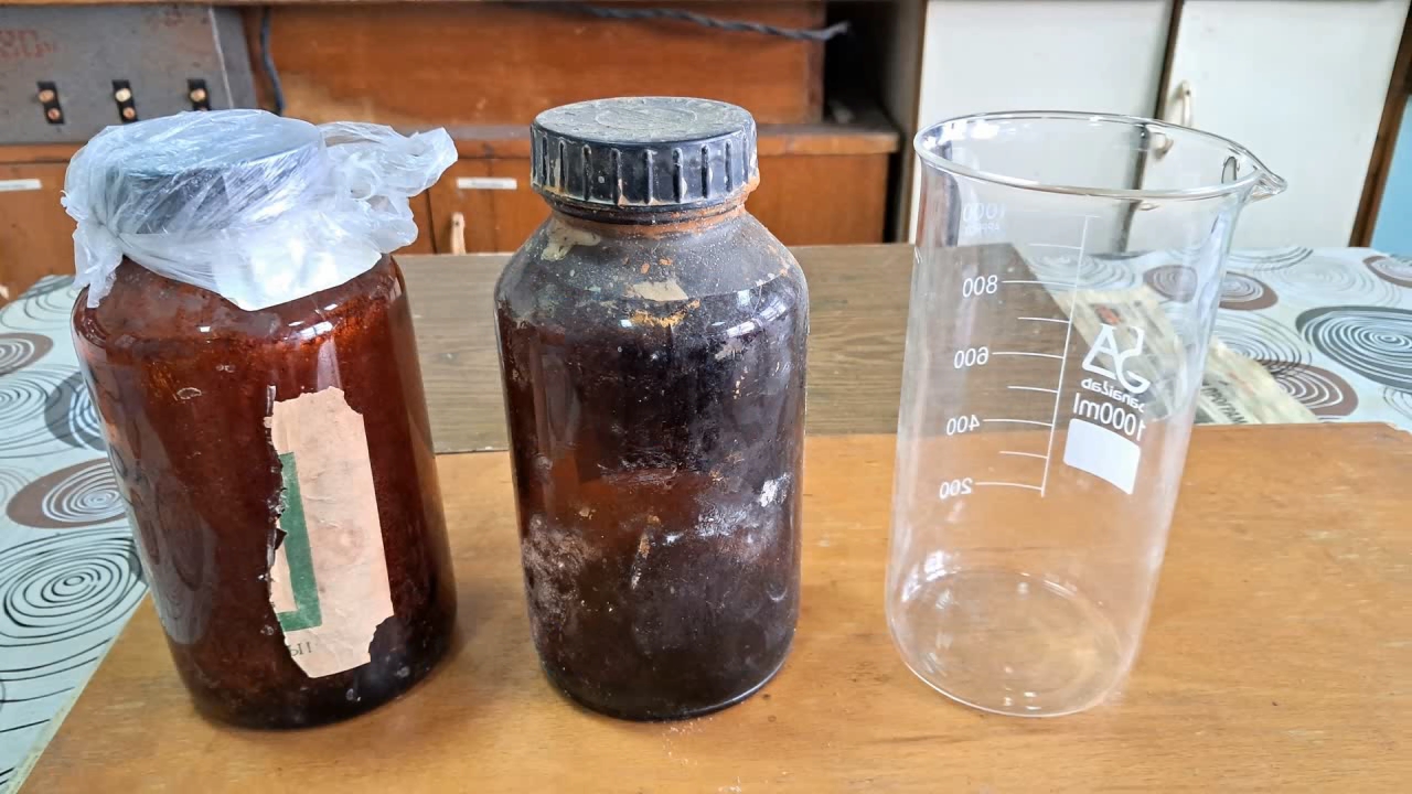

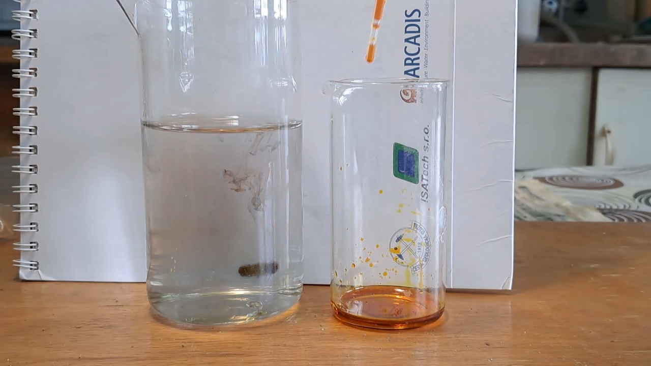

In the jar containing iron(III) chloride, instead of the expected brown crystals, a dark brown liquid was present. Iron(III) chloride is hygroscopic - it absorbs moisture from the air; as a result, the crystals had turned into a solution. This is not a problem for our experiment. It can be assumed that the iron(III) chloride solution was nearly saturated.

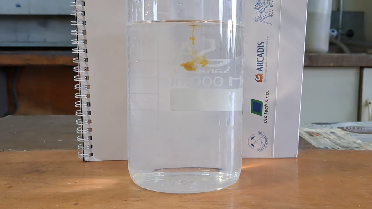

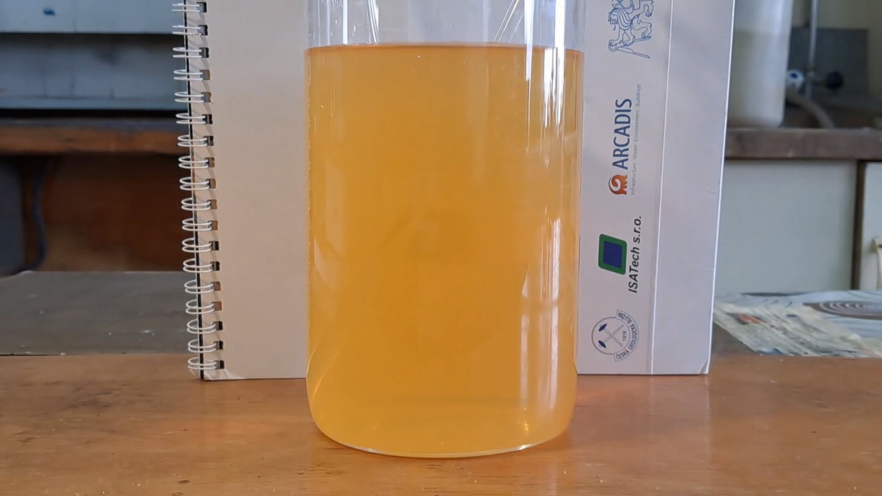

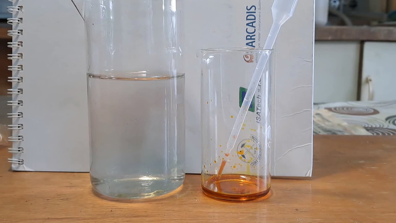

I poured 900 ml of tap water into a one-liter glass. I added phenol crystals and stirred. Most of the phenol dissolved.
Many chemical experiments require distilled water, but I decided that tap water would be acceptable in this case. Unfortunately, on some days, tap water contains so much iron that it turns tea violet. In our case, when the phenol dissolved, the violet color did not appear, so the experiment could proceed.

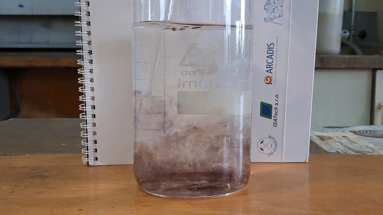

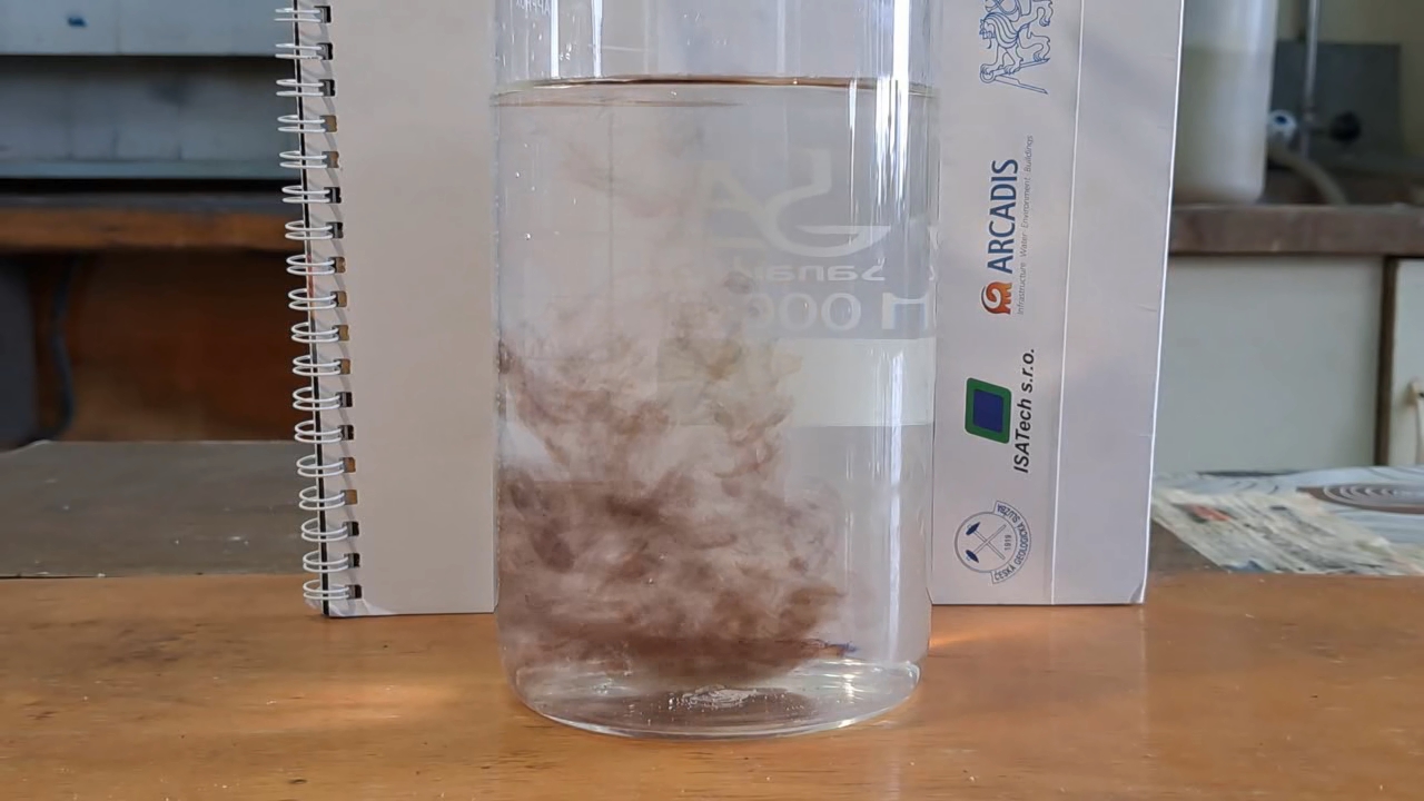

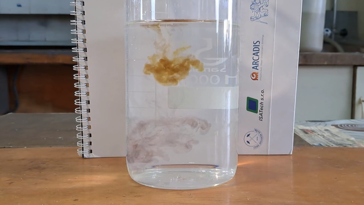

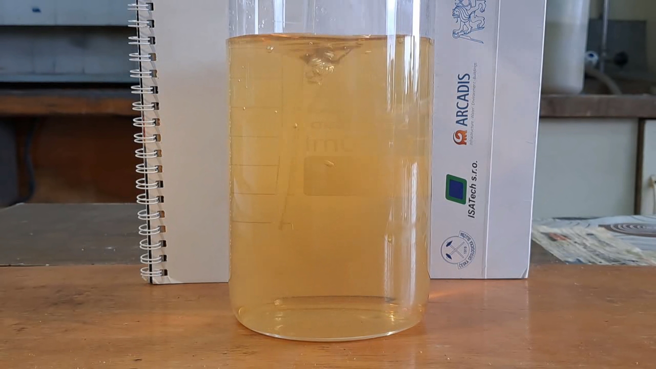

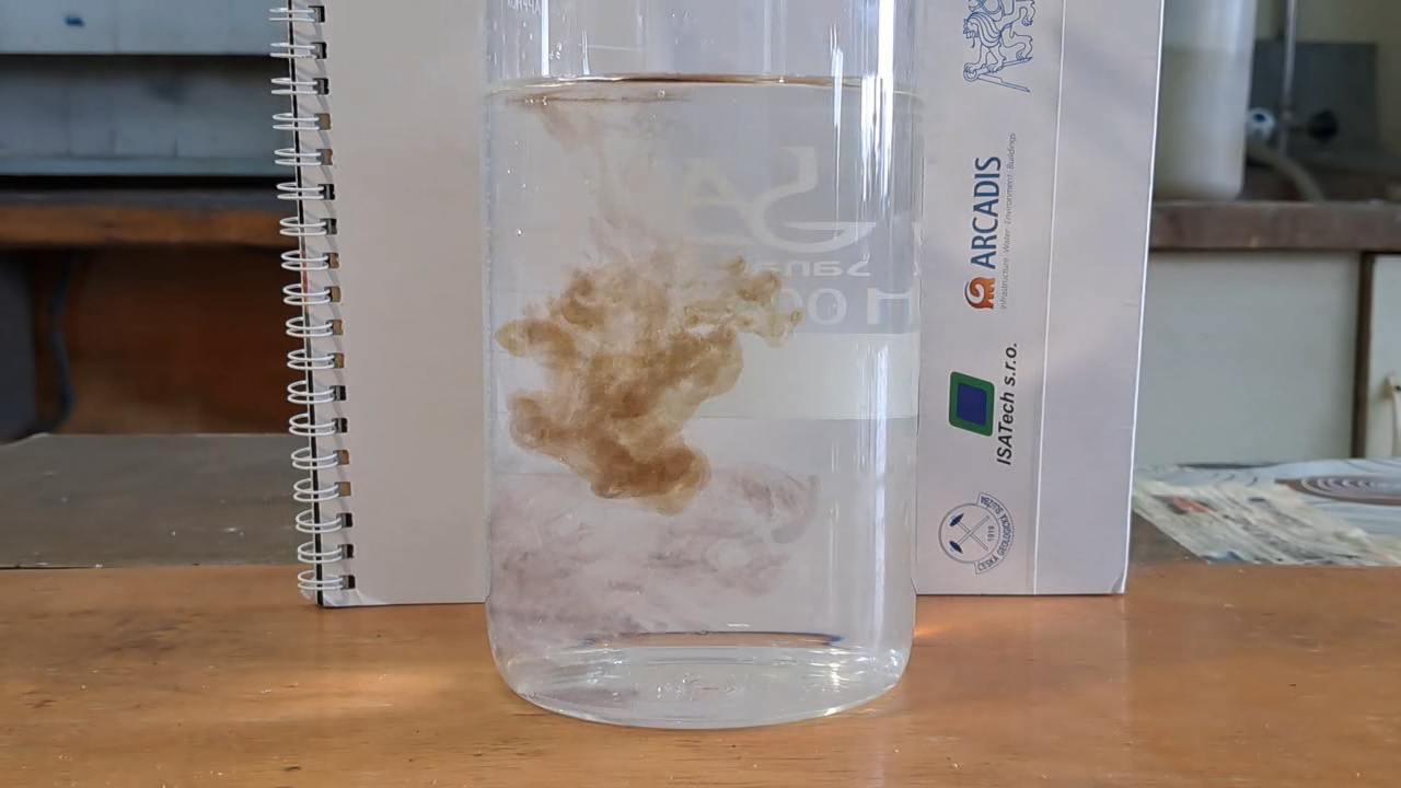

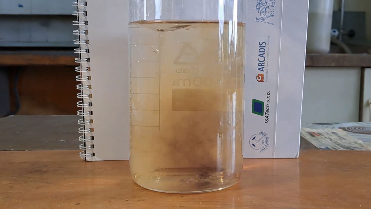

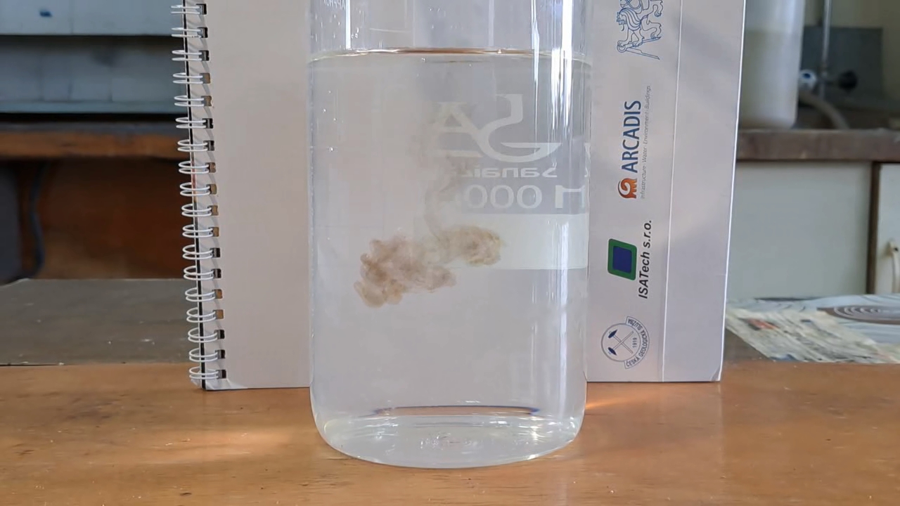

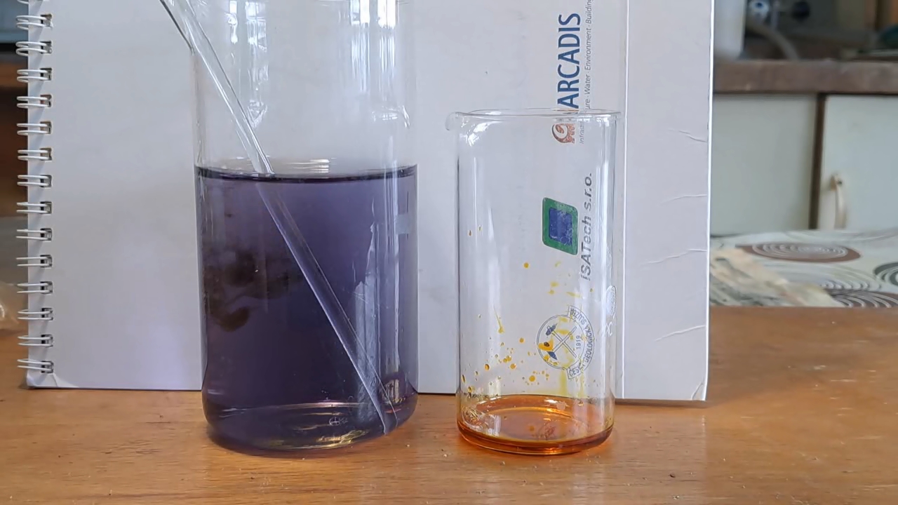

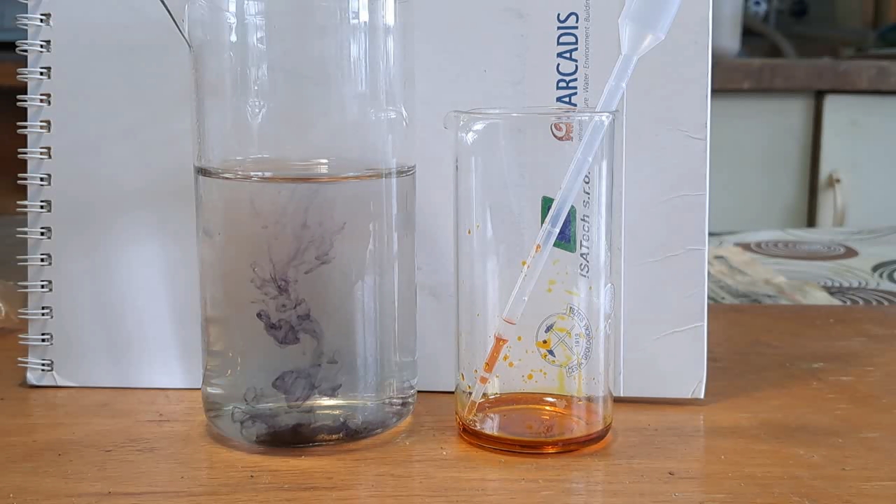

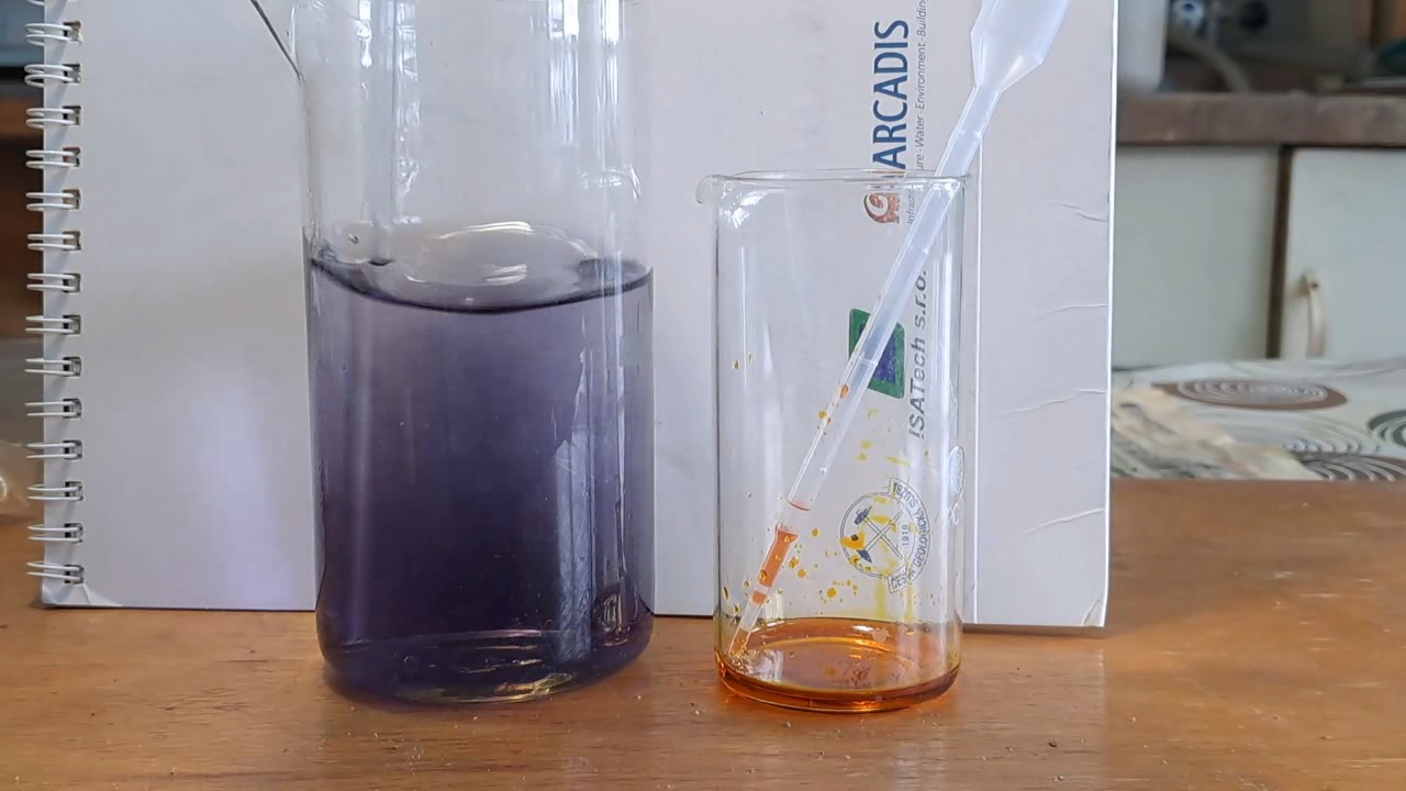

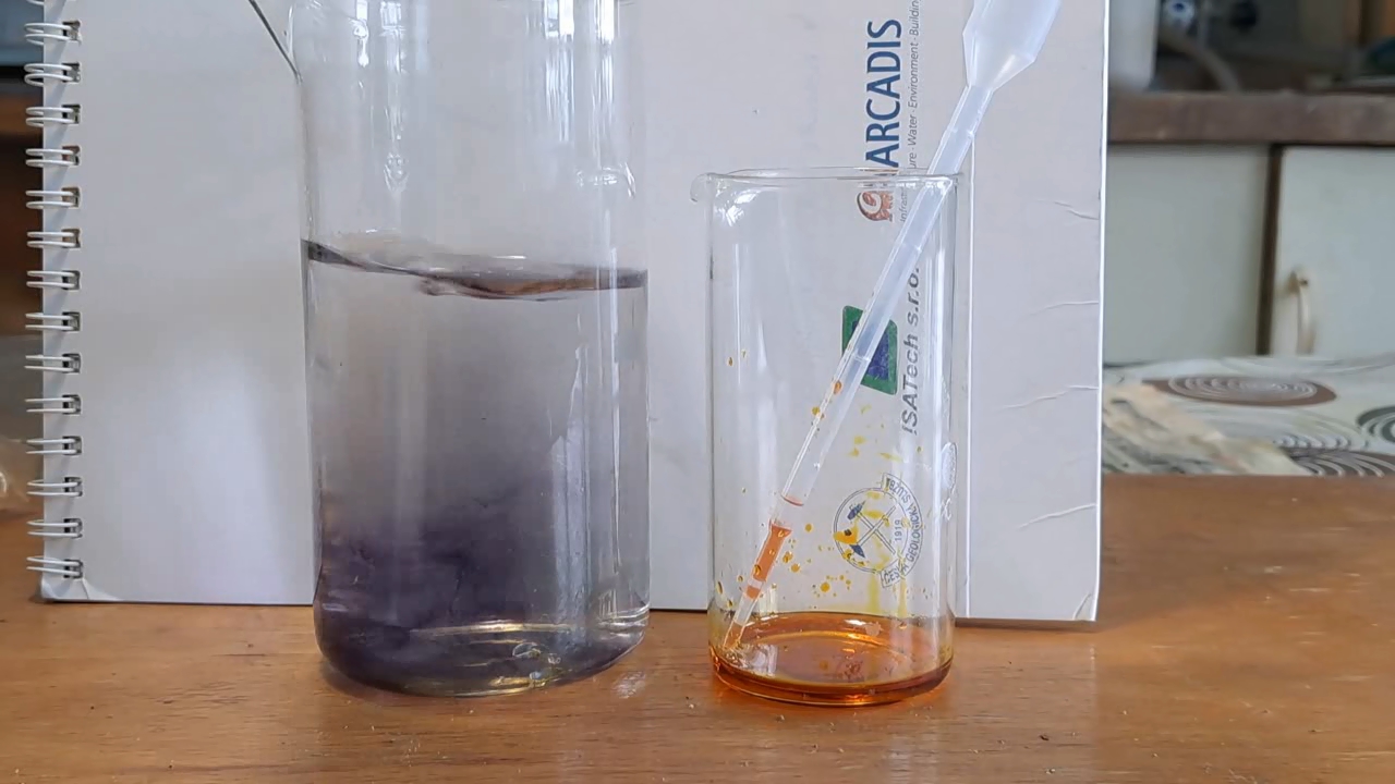

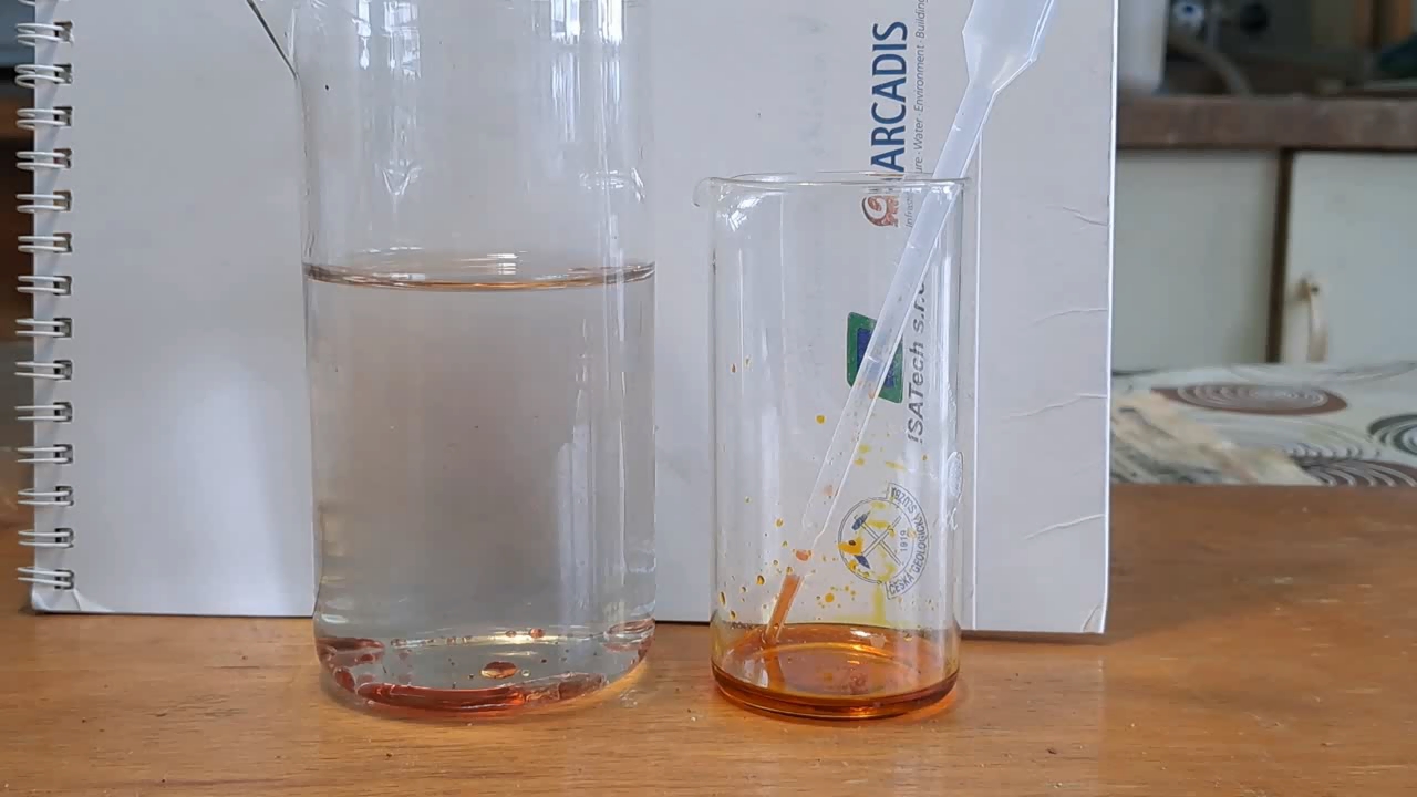

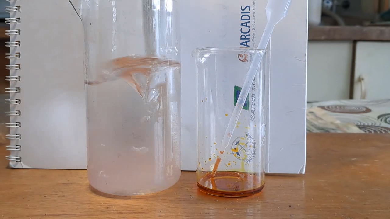

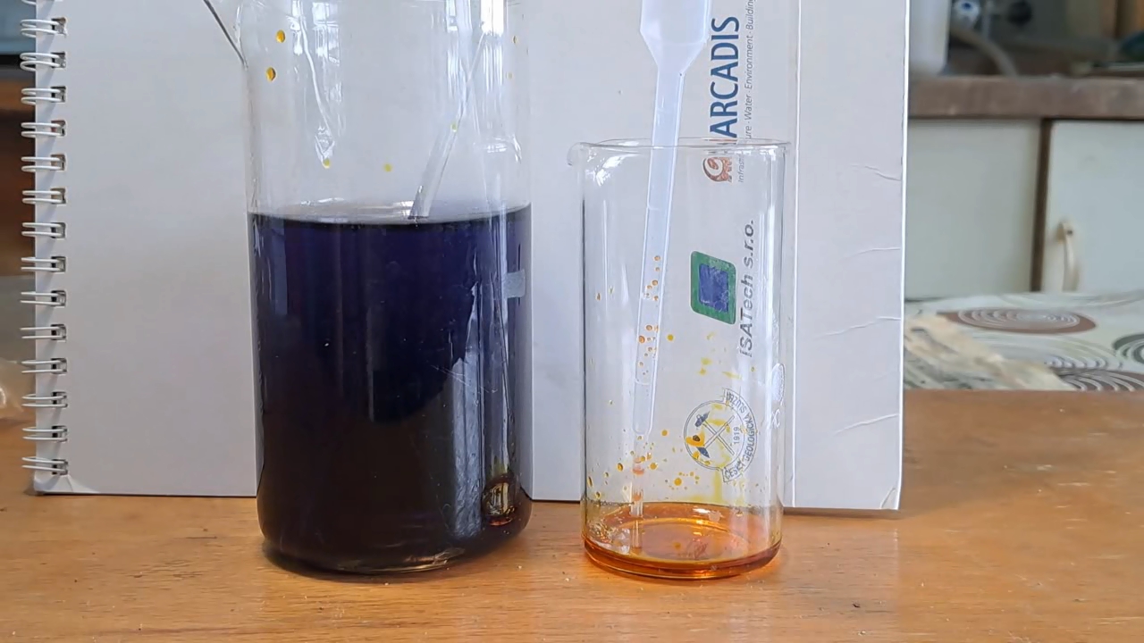

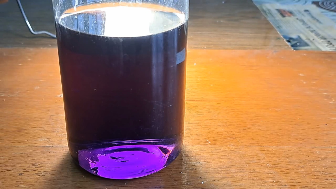

I added the iron(III) chloride solution drop by drop to the glass containing the phenol solution. The first drops caused a violet color to appear. I stirred the contents of the glass - and the liquid turned brown! The violet color disappeared. The solution soon lost its transparency; it became clear that a suspension had formed, resembling a suspension of iron(III) hydroxide. I added more solid phenol and stirred - no violet color appeared. After the liquid stood for a while, a voluminous brown precipitate settled out.

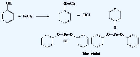

Thus, in the first moments of the interaction between phenol and iron(III) chloride, a violet complex formed, which then broke down, transforming into iron(III) hydroxide (or basic iron salts). Tap water contains carbonates and bicarbonates, which converted the iron(III) into hydroxide, destroying the phenol-iron complex.
The formation of a violet complex with iron(III) chloride is a qualitative test for phenol. However, this reaction turned out to be capricious. For the next experiment, I will use distilled water.

Добавлял в стакан с раствором фенола раствор хлорида железа (III) по капле. Первые капли вызвали появление фиолетовой окраски. Перемешал содержимое стакана - в результате жидкость стала коричневой! Фиолетовая окраска исчезла. Раствор вскоре потерял прозрачность, стало очевидно, что он превратился в суспензию, похожую на суспензию гидроксида железа (III). Добавил еще твердого фенола, перемешал - фиолетовая окраска не появилась. При стоянии жидкости выпал объемный коричневый осадок.
Таким образом, в первые моменты взаимодействия фенола и хлорида железа (III) образовался фиолетовый комплекс, который затем разрушился, превратившись в гидроксид железа (III) (или в основные соли железа). Водопроводная вода содержит карбонаты и гидрокарбонаты, которые перевели железо (III) в гидроксид, разрушив комплекс фенол-железо.
Образование фиолетового комплекса с хлоридом железа (III) - качественная проба на фенол. Тем не менее, данная реакция оказалась капризной. Для проведения следующего эксперимента я использую дистиллированную воду.

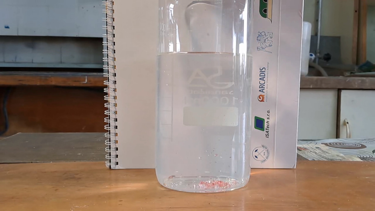

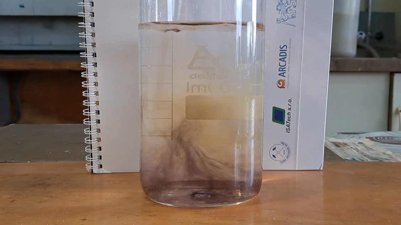

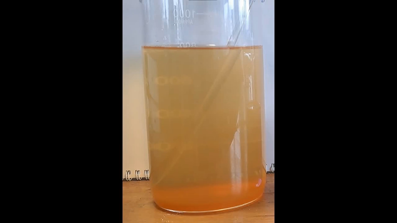

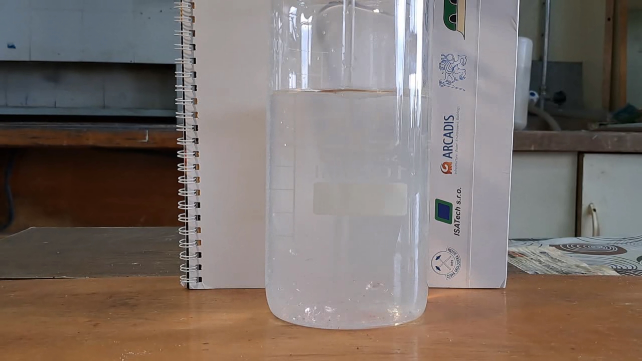

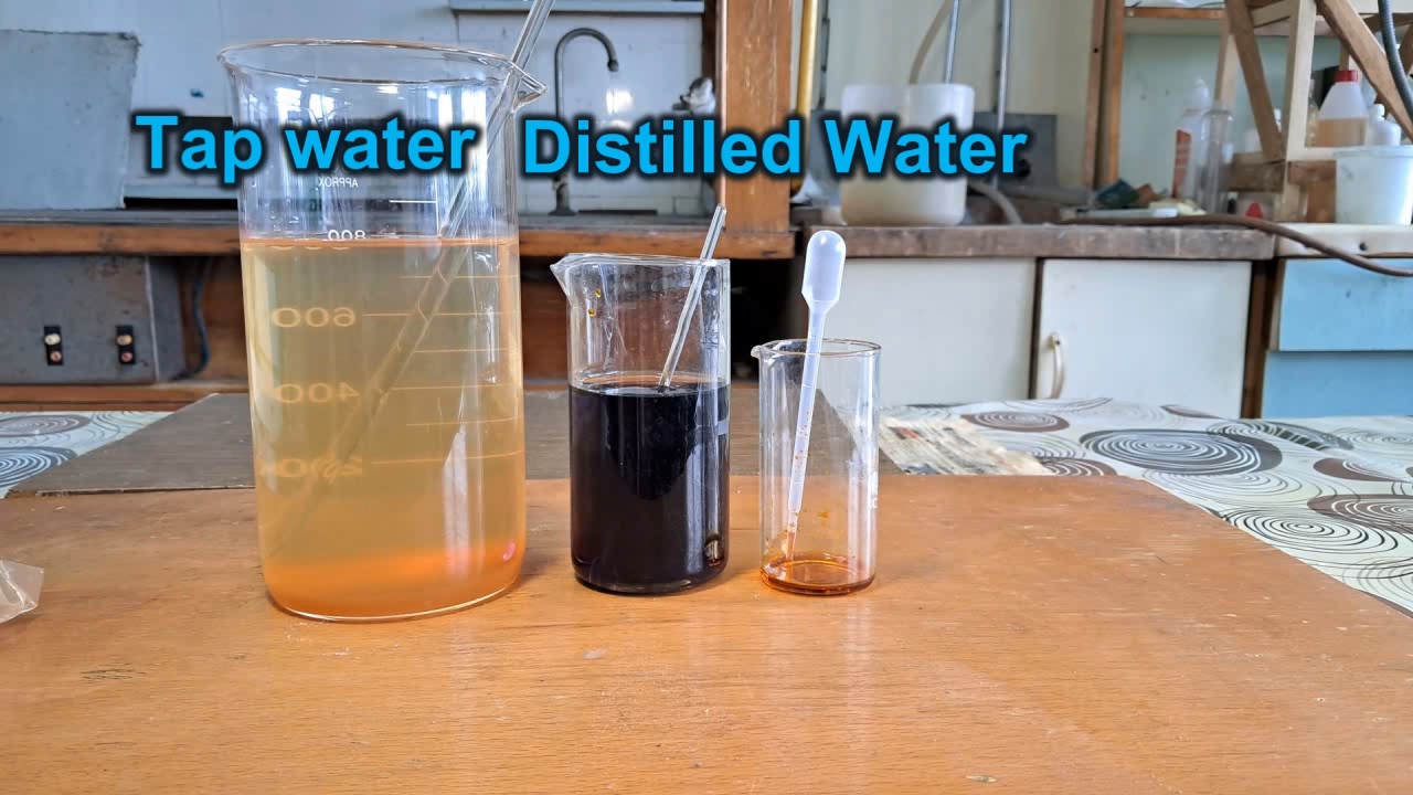

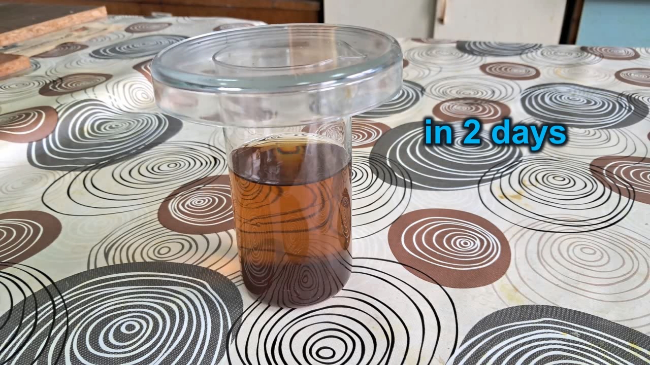

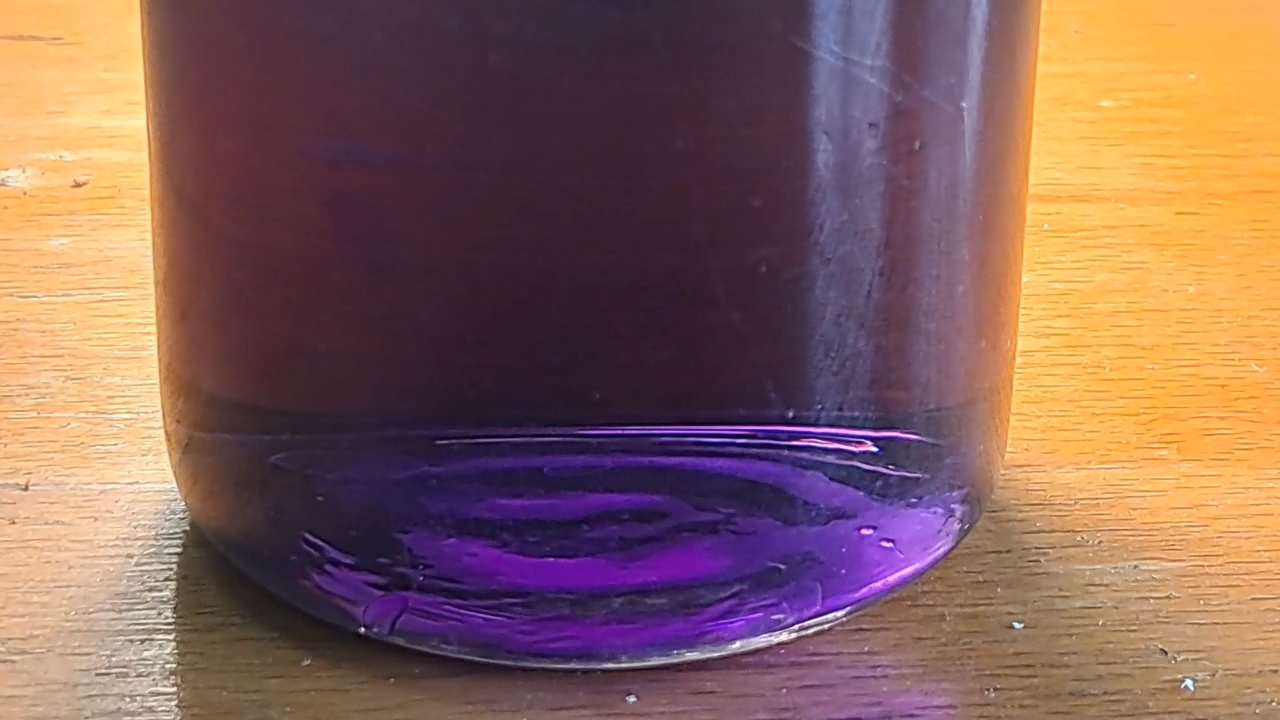

I added 1 g of phenol to 200 ml of distilled water, stirred, and then added a solution of ferric chloride drop by drop. The solution turned violet, resembling school ink. A characteristic iron-phenol complex had formed.

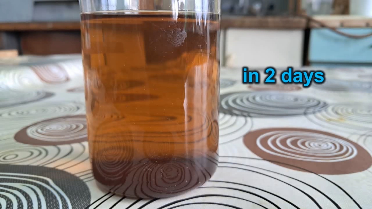

I left the solution over the weekend, intending to conduct experiments with the violet complex on Monday. However, on Monday I discovered that the solution in the beaker had turned brown, and a dark brown precipitate had formed. Phenol is oxidized when exposed to atmospheric oxygen during storage, and the complex was destroyed as a result of this oxidation. Di- and triatomic phenols (hydroquinone, pyrocatechol, pyrogallol, etc.) are oxidized much more readily than phenol.

Добавил 1 г фенола в 200 мл дистиллированной воды, перемешал, затем добавил раствор хлорида железа по капле. Раствор окрасился в фиолетовый цвет, став похож на школьные чернила. Образовался характерный комплекс железа и фенола.
Оставил раствор на выходные, намереваясь провести эксперименты с фиолетовым комплексом в понедельник. А в понедельник я обнаружил, что раствор в стакане стал коричневым, образовался темно-коричневый осадок. Фенол окисляется кислородом воздуха при стоянии раствора - комплекс разрушился в результате его окисления. Двух- и трехатомные фенолы (гидрохинон, пирокатехин, пирогаллол и т.д.) окисляются гораздо легче, чем фенол.
