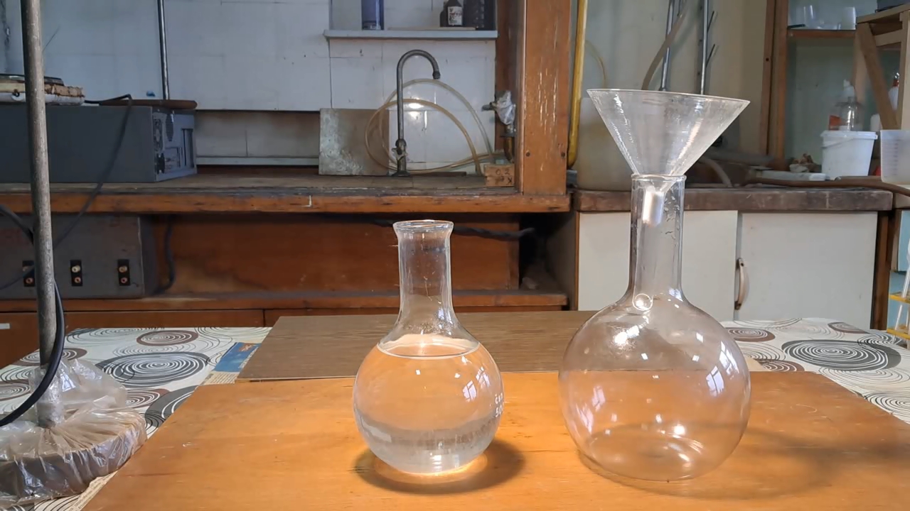

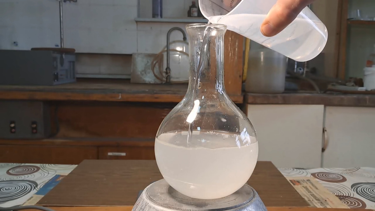

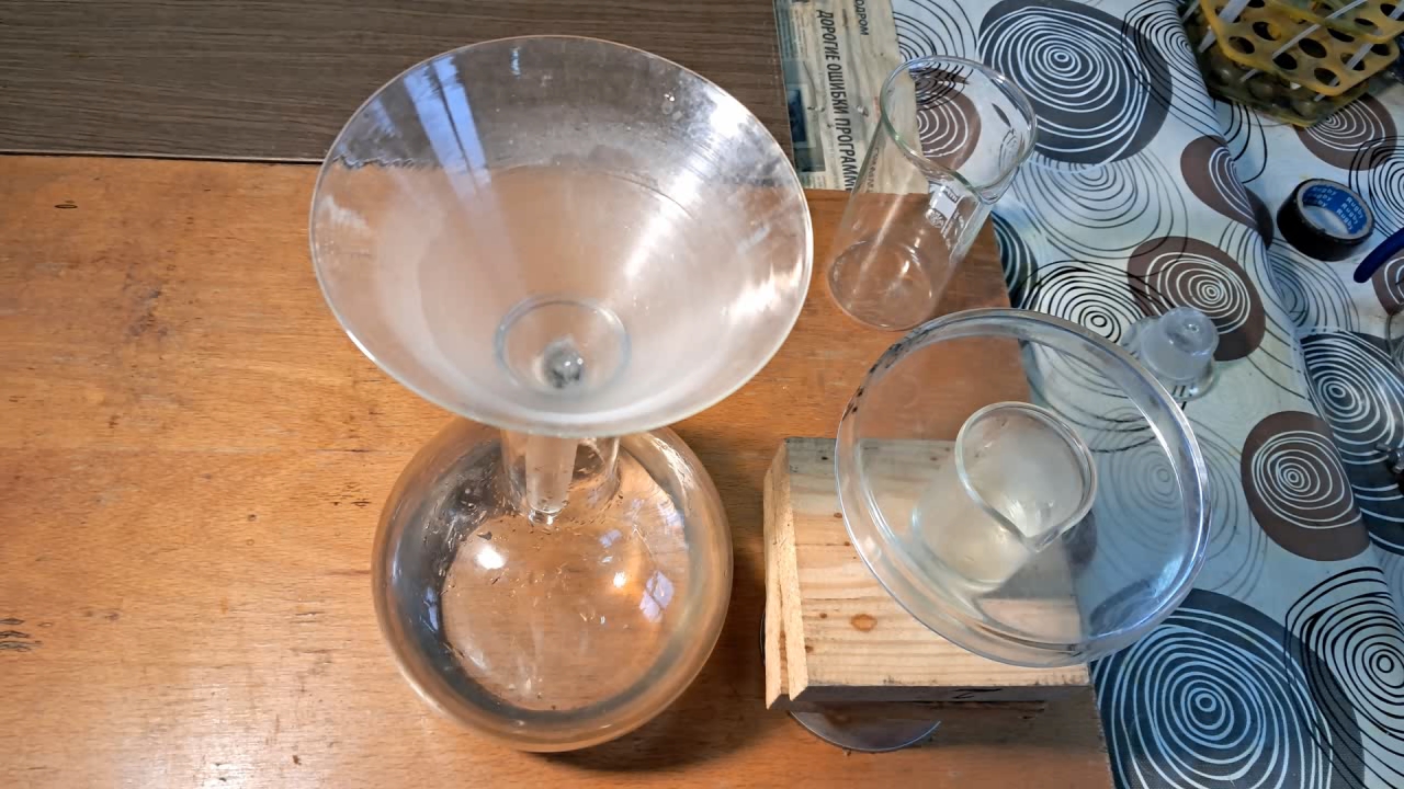

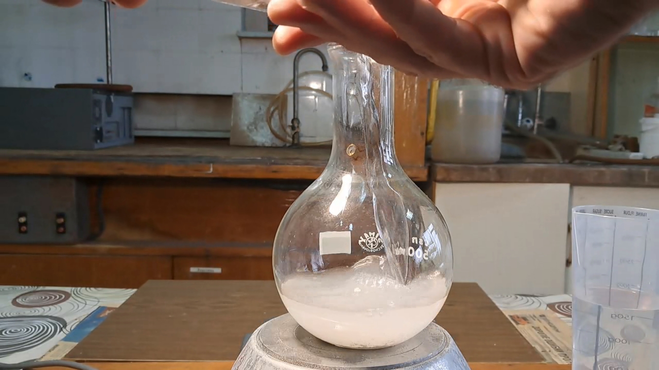

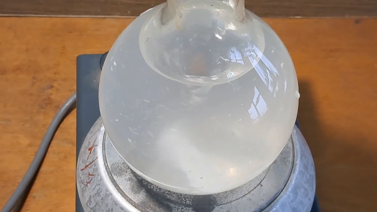

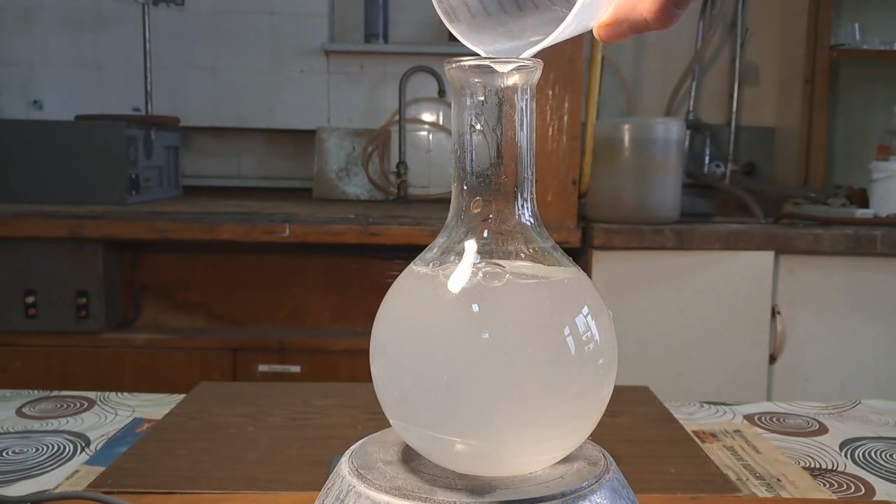

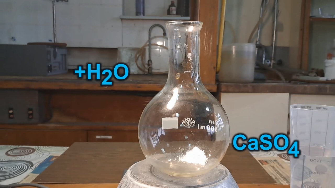

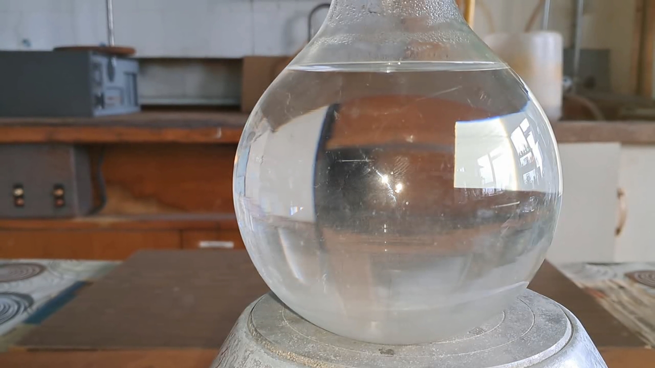

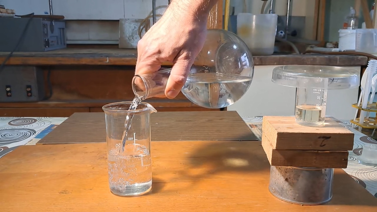

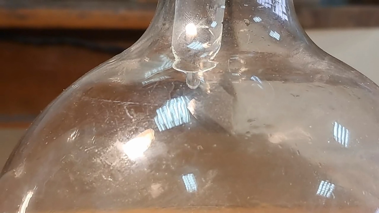

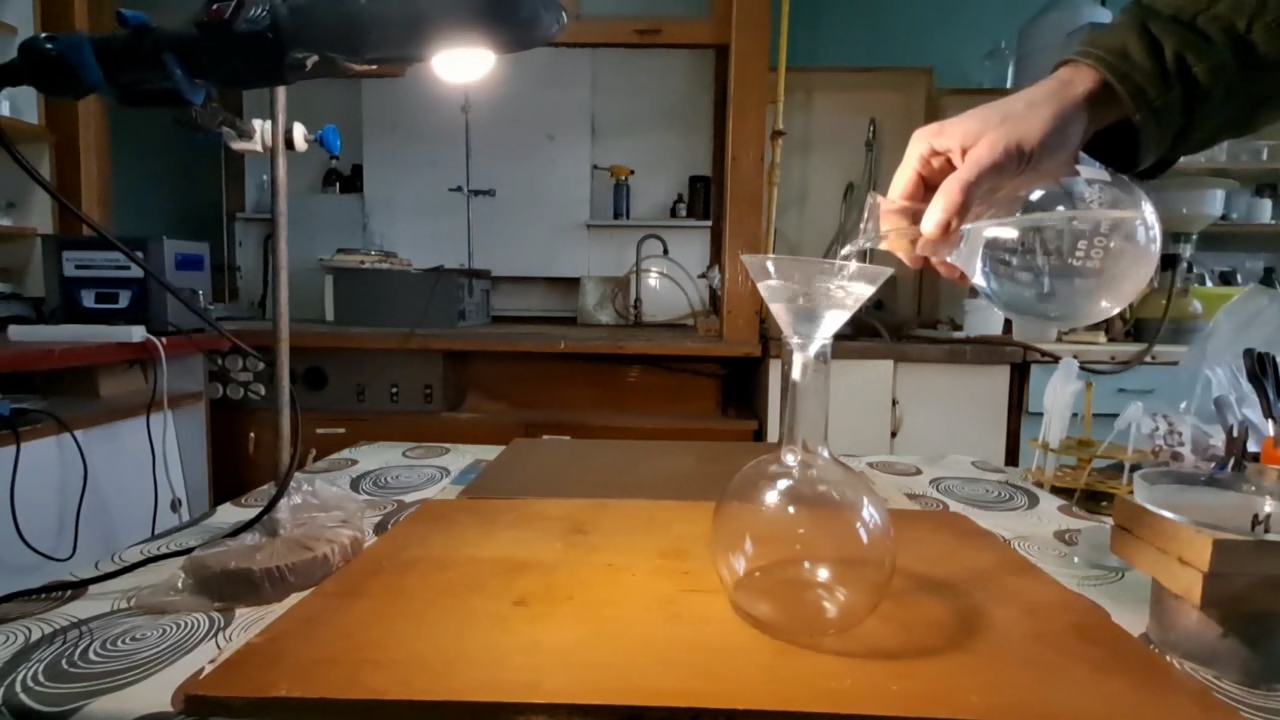

I had some anhydrous calcium sulfate, so I decided to prepare a saturated calcium sulfate solution and experiment with it.

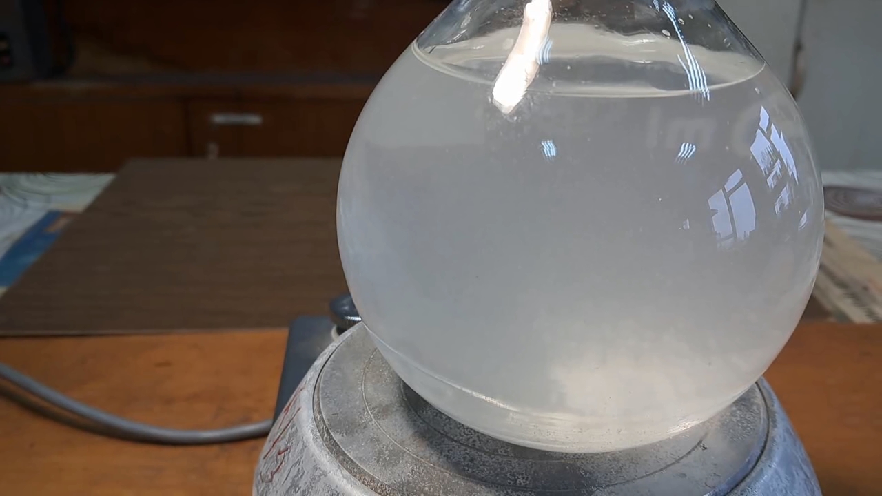

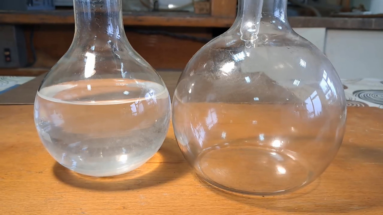

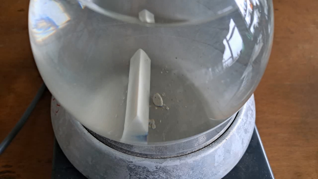

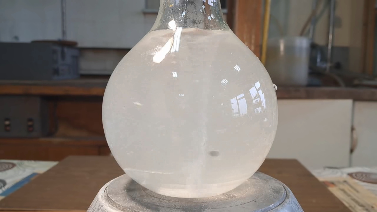

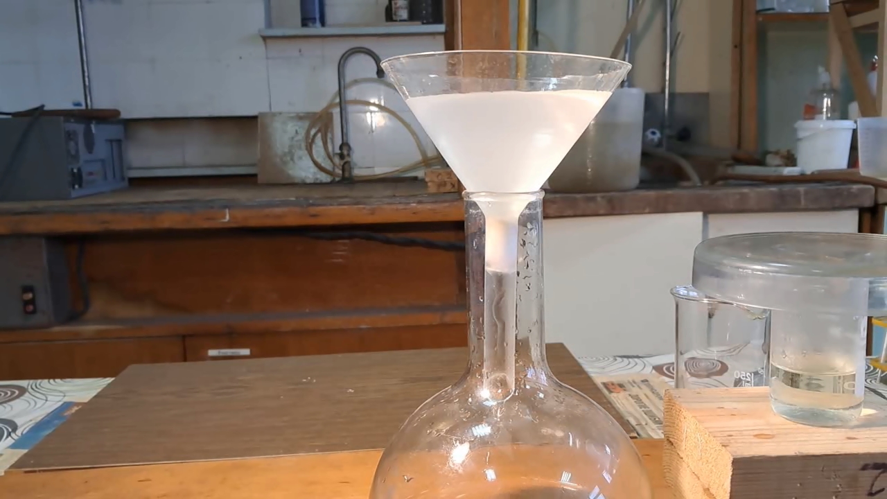

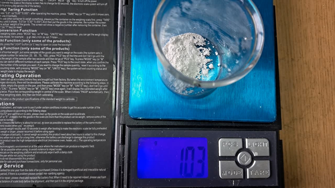

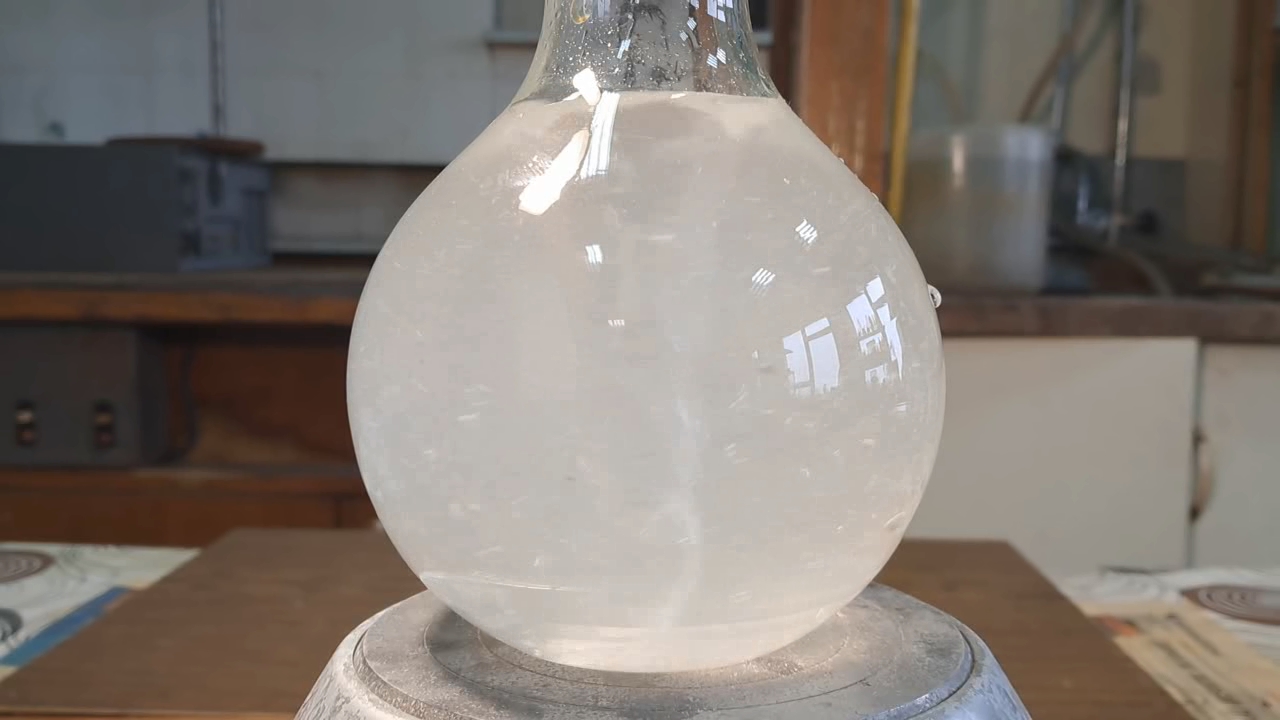

I weighed 1.03 g of calcium sulfate, placed it in a flask, added 500 ml of distilled water, and set it on a magnetic stirrer. I turned on vigorous stirring. A suspension formed, and after a few hours, most of the solid phase dissolved. I continued stirring until the power went out in our area. Without electricity, the magnetic stirrer stopped, so I simply left the flask for the weekend.
When I returned to the lab two days later, I found that the solid phase had not completely dissolved - a small amount of sediment remained at the bottom of the flask. I filtered the solution through a cotton swab. I wanted to begin the gypsum water experiments immediately, but I was running out of time - according to the schedule, the power was supposed to go out again soon.

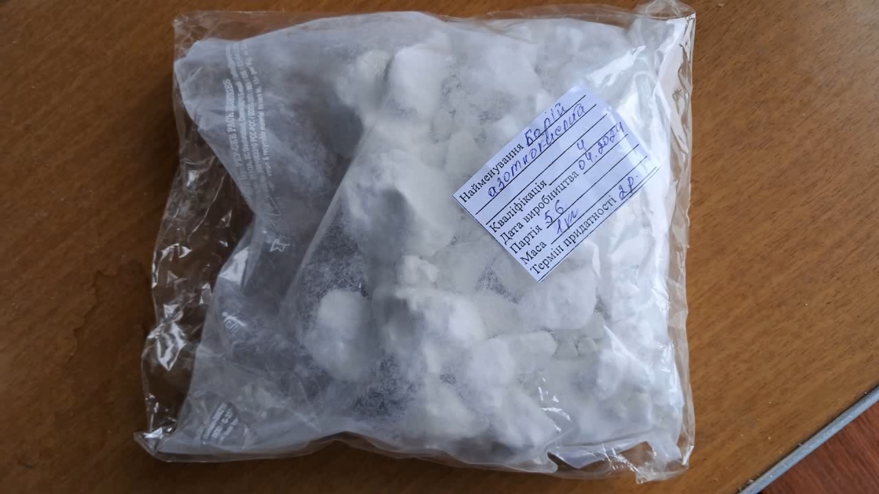

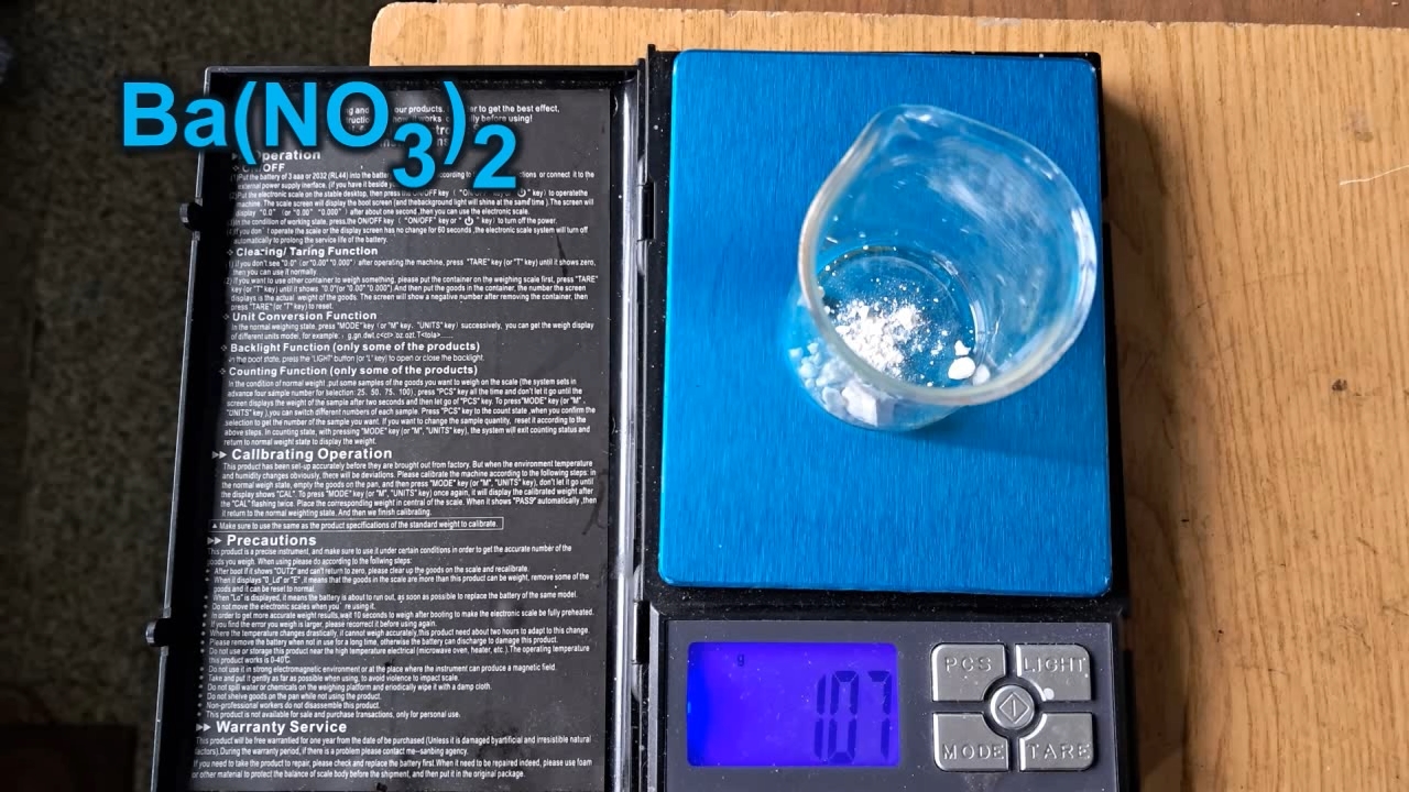

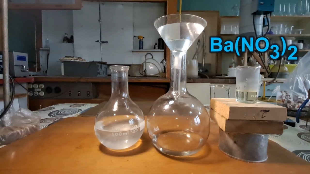

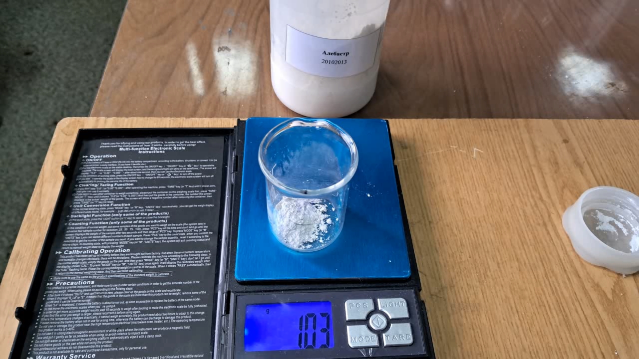

In the remaining time, I prepared a barium salt solution. Barium chloride is typically used in analytical chemistry, but there was none among the reagents available in the lab. Instead, I found some barium nitrate.
I opened the bag. The barium nitrate was in lumps that produced a lot of dust when I tried to grind them (remember, barium salts are poisonous). But the real surprise came when I tried to dissolve the barium nitrate in water. I weighed out 1 g of the salt and added about 10 ml of water. The salt dissolved extremely slowly, so I added more water and heated the solution on a hotplate. Most of the barium nitrate dissolved, but the solution remained cloudy, so I had to filter it.

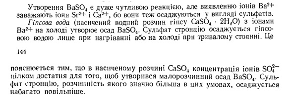

I began to doubt it: "Could it be that this isn't barium nitrate?" I had recently encountered a case where a jar labeled "Benzoic Acid" contained an unknown substance that wasn't an acid at all. There was no time to verify the authenticity of the barium nitrate - the power went out again, so I postponed the experiments until the next day.
1 F.G. Zharovsky, A.T. Pylypenko, I.V. Pyatnytsky Analytical Chemistry / Ф.Г. Жаровський, А.Т. Пилипенко, І.В. П'ятницький - Аналітична хімія [link].

Гипсовая вода (насыщенный раствор сульфата кальция в воде) образует осадок с ионами бария при комнатной температуре. Сульфат-ионов, которые содержатся в растворе гипса, вполне достаточно, чтобы произошло осаждение труднорастворимого сульфата бария. Зато ионы стронция в этих условиях... Про стронций я расскажу чуть позже.
Безводный сульфат кальция у меня был, поэтому я решил приготовить насыщенный раствор сульфата кальция и провести с ним эксперименты.
Взвесил 1.03 г сульфата кальция, поместил его в колбу, добавил 500 мл дистиллированной воды и поставил на магнитную мешалку. Включил интенсивное перемешивание. Образовалась суспензия, а через несколько часов перемешивания большая часть твердой фазы растворилась. Продолжал перемешивание, пока в нашем районе не отключили электроэнергию. Без электричества магнитная мешалка не работала, поэтому просто оставил колбу на выходные.
Пришел через два дня в лабораторию и обнаружил, что полного растворения твердой фазы не произошло - на дне колбы осталось немного осадка. Профильтровал раствор сквозь тампон из хлопковой ваты. Хотел сразу же начать эксперименты с гипсовой водой, однако, времени почти не осталось - согласно графику, скоро снова должны были отключить электричество.
В оставшееся время приготовил раствор соли бария. Обычно в аналитической химии используют хлорид бария, однако, среди реактивов, которые были в лаборатории, хлорида бария не оказалось. Зато я нашел нитрат бария.
Открыл пакет. Нитрат бария был в виде комков, которые сильно пылили при попытке их измельчить (напоминаю, соли бария ядовиты). Но главный сюрприз ждал меня при растворении нитрата бария в воде. Взвесил 1 г соли, добавил около 10 мл воды. Соль растворялась крайне медленно - добавил больше воды, подогрел раствор на плитке. Большая часть нитрата бария растворилась, но раствор остался мутным - его пришлось профильтровать.
Я засомневался: "Возможно это НЕ нитрат бария?" Недавно у меня уже был случай, когда в банке с подписью "Бензойная кислота" оказалось неизвестное вещество, которое кислотой не является. Времени проверить подлинность нитрата бария не осталось - электричество отключили, и я отложил эксперименты до следующего дня.

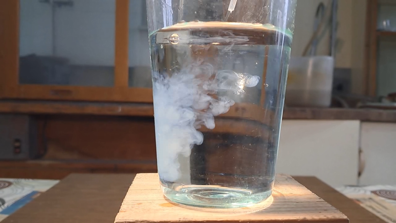

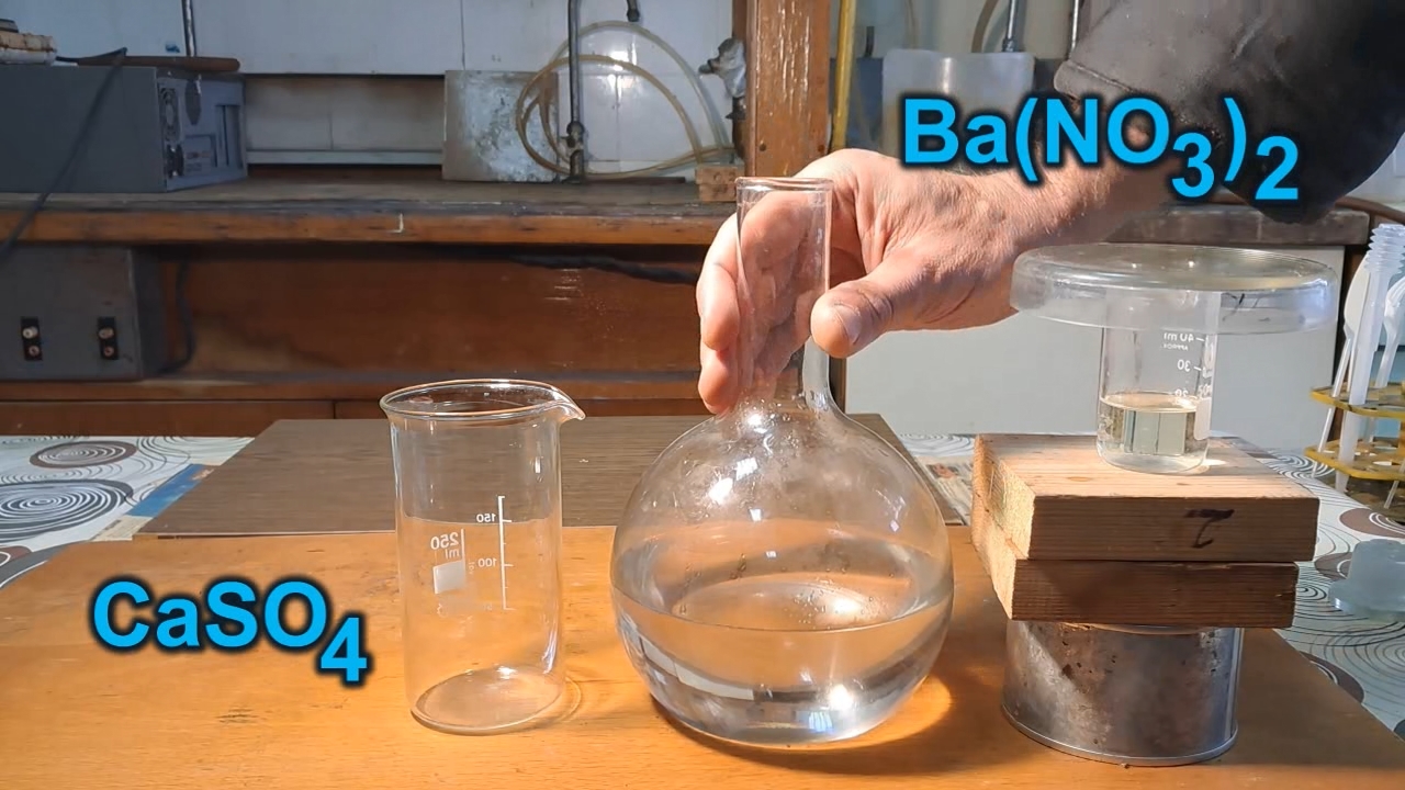

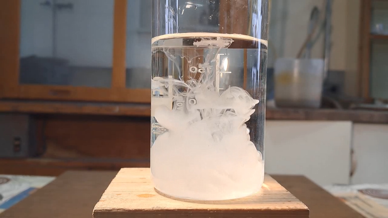

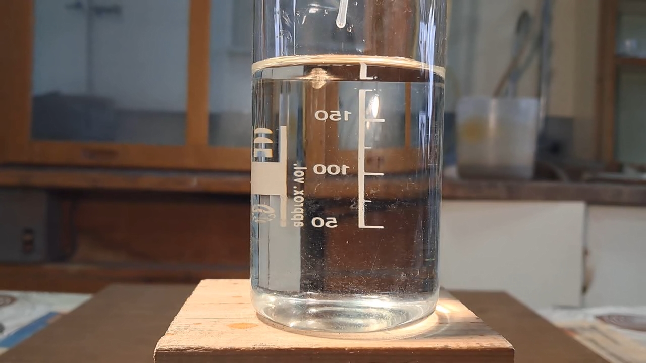

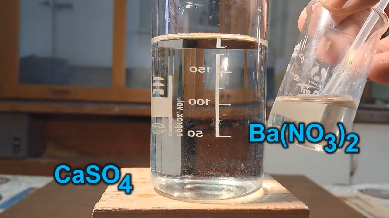

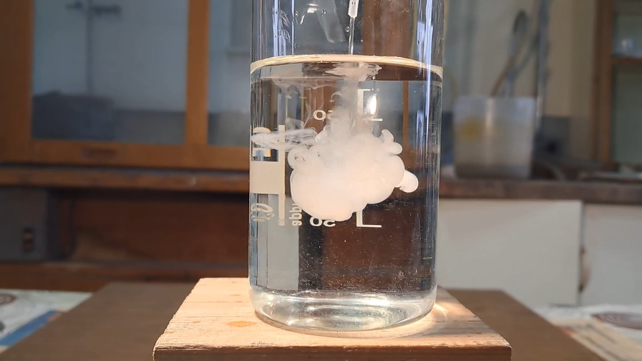

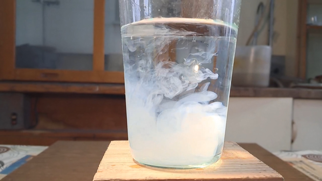

I faced a dilemma: should I immediately carry out the reaction between barium nitrate and the calcium sulfate solution I had prepared the day before, or should I first verify the authenticity of the barium nitrate? I had never observed this reaction before - neither directly nor in any video - so it was important to confirm that the reagent was genuine. For example, I could prepare a copper sulfate solution and add a drop of the barium nitrate solution to it. If the reagent was authentic, barium cations would instantly precipitate with sulfate anions.
After some thought, I decided to keep the procedure simple and perform the reaction right away. If it failed, I could always prepare a fresh saturated calcium sulfate solution and then ask a colleague for barium chloride or a new sample of barium nitrate.

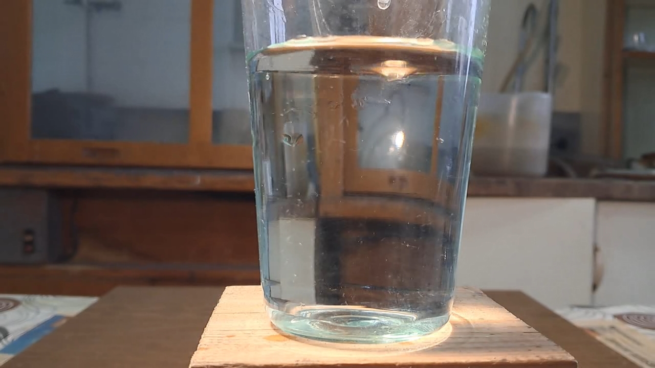

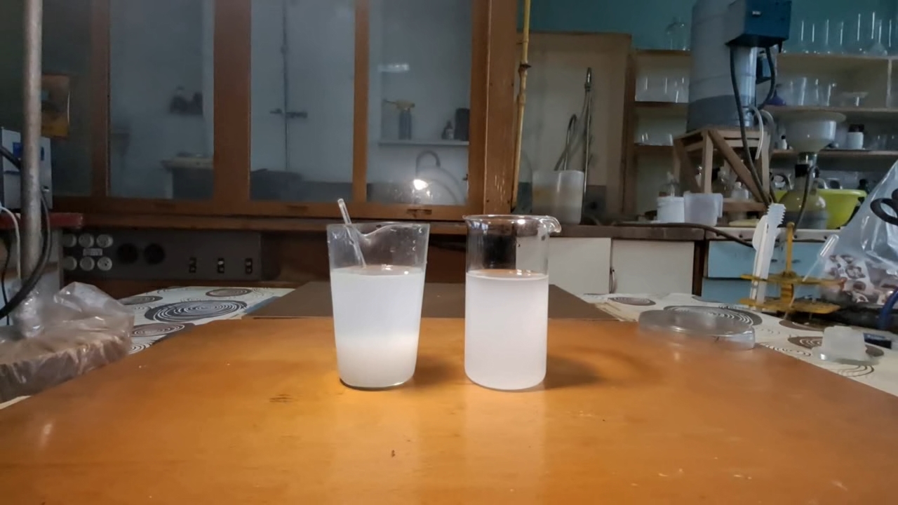

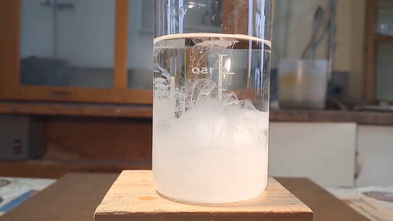

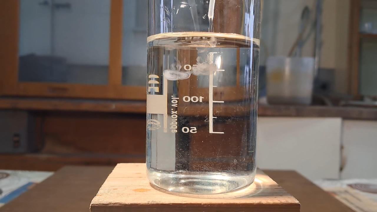

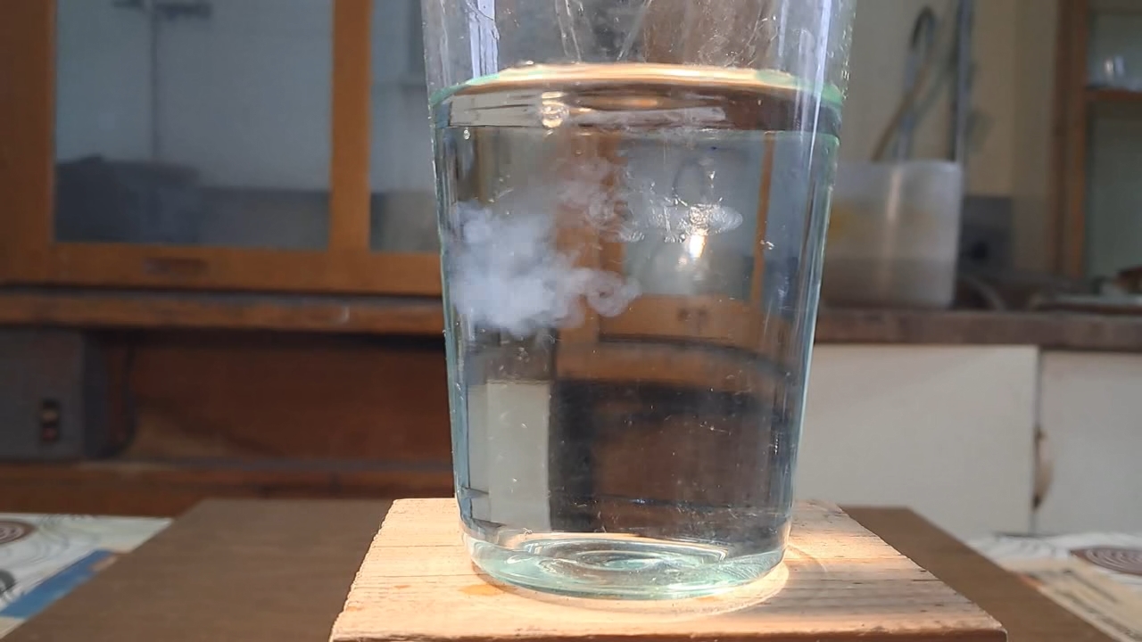

I poured about 200 ml of the saturated calcium sulfate solution into a beaker and added 1 ml of the barium nitrate solution. The latter sank to the bottom, and the lower portion of the liquid immediately turned white and turbid. I stirred the mixture, and the entire solution in the beaker soon looked like milk - a suspension of barium sulfate had formed, and it proved to be relatively stable. When a laser beam (a pointer) passed through the suspension, a clear Tyndall cone was observed.
Thus, upon the addition of barium nitrate, the saturated calcium sulfate solution instantly produced a barium sulfate suspension.

Возникла дилемма: провести реакцию нитрата бария с полученным вчера раствором сульфата кальция сразу, или сначала проверить подлинность нитрата бария? Ранее я не наблюдал данную реакцию ни непосредственно, ни на видео, поэтому было желательно убедиться в подлинности исходного реагента. Например, можно было приготовить раствор сульфата меди и добавить к нему каплю раствора нитрата бария. Если нитрат бария подлинный, катионы бария сразу дадут осадок с анионами сульфата.
После раздумий решил не усложнять процедуру и провести реакцию сразу. В случае неудачи, насыщенный раствор сульфата кальция можно было приготовить заново, а затем попросить у коллеги хлорид бария или новый образец нитрата бария.
Налил в стакан около 200 мл насыщенного раствора сульфата кальция и добавил 1 мл раствора нитрата бария. Раствор опустился на дно, нижняя часть жидкости моментально стала бело-мутной. Перемешал содержимое - вся жидкость в стакане стала похожей на молоко. Образовалась суспензия сульфата бария, которая оказалась сравнительно устойчивой. При прохождении лазерного луча (указка) наблюдался конус Тиндаля.
Таким образом, насыщенный раствор сульфата кальция моментально образовал суспензию сульфата бария при добавлении нитрата бария.

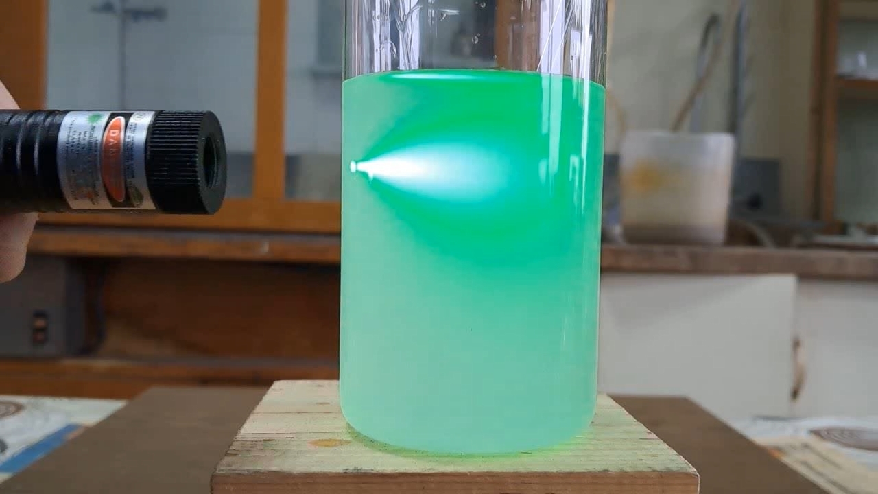

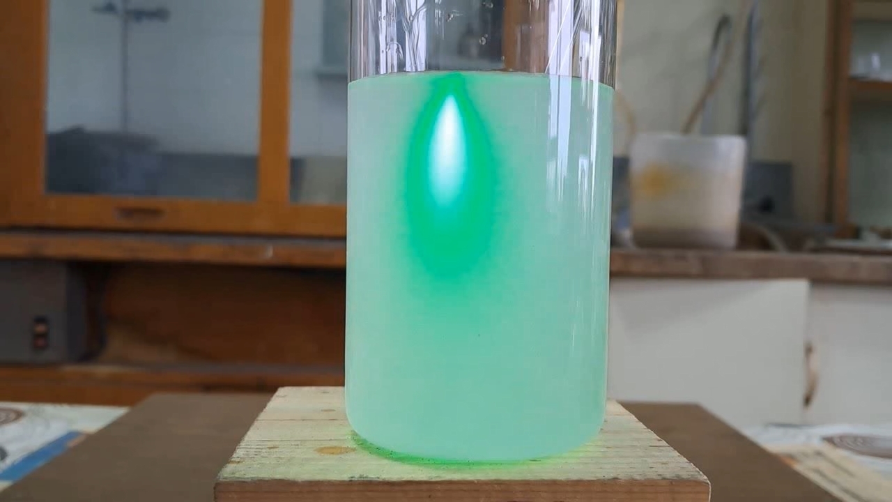

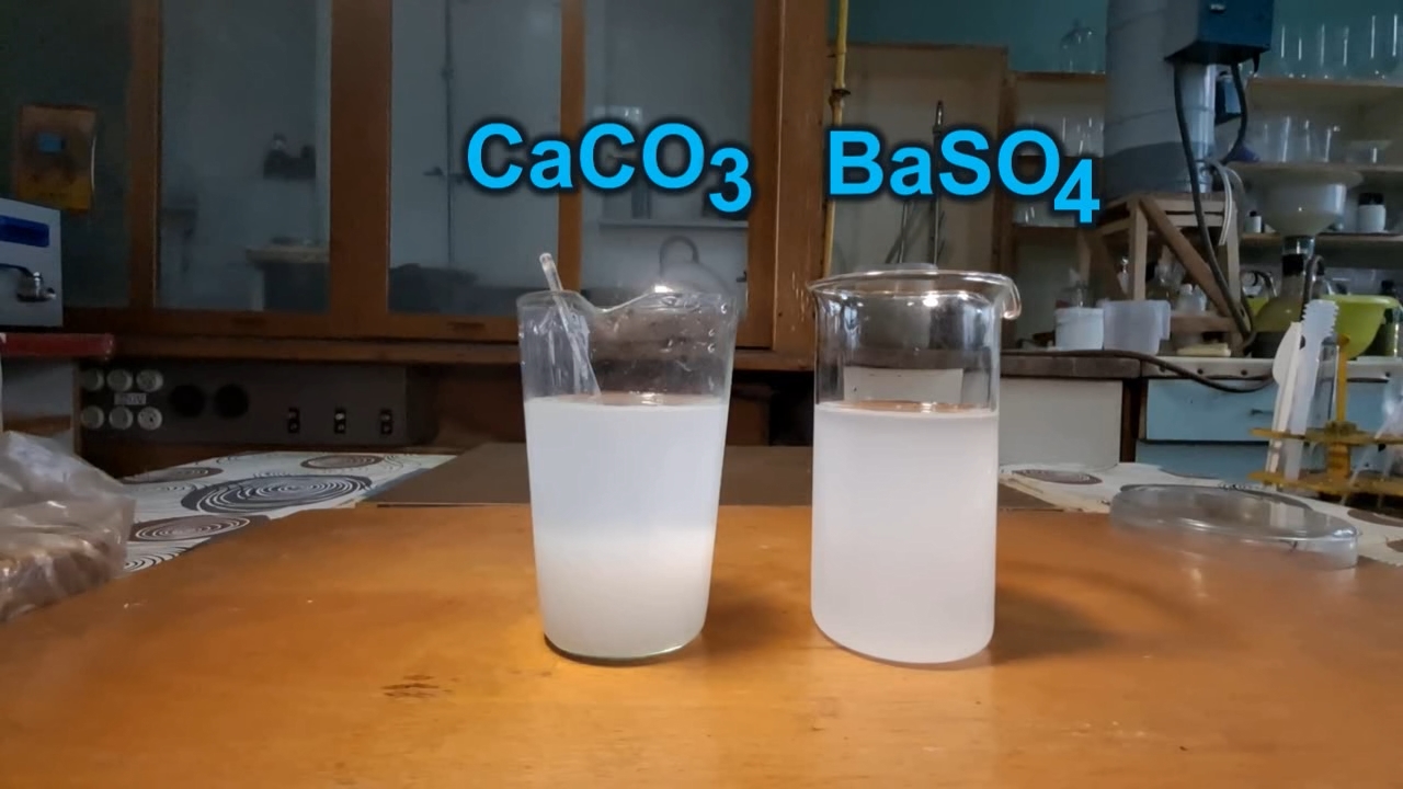

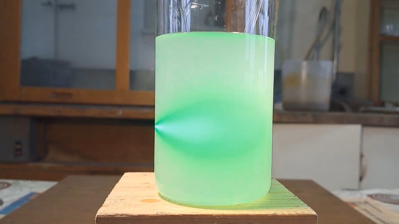

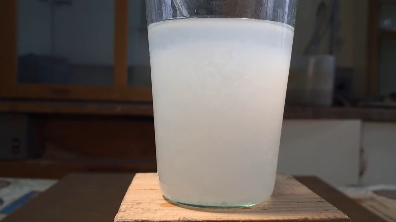

When a barium salt solution is added to a saturated calcium sulfate solution, a barium sulfate precipitate forms. After the previous experiment, I had approximately 300 ml of saturated calcium sulfate solution left, and I continued experimenting with it.

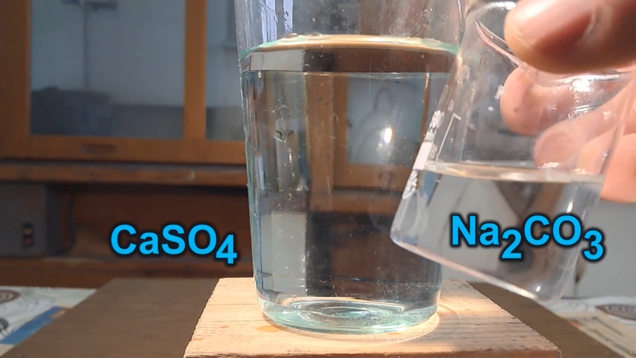

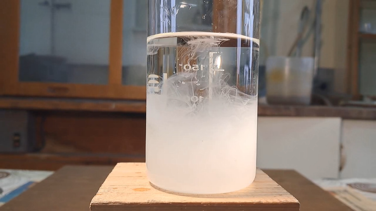

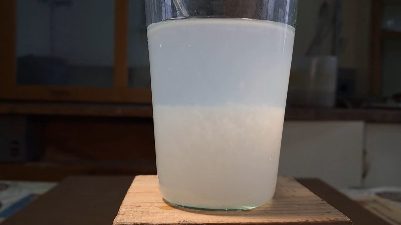

The idea for the next experiment was based on two facts. First, a calcium sulfate solution contains not only sulfate ions but also an equivalent amount of calcium ions. Second, the solubility of calcium carbonate in water is lower than that of calcium sulfate.

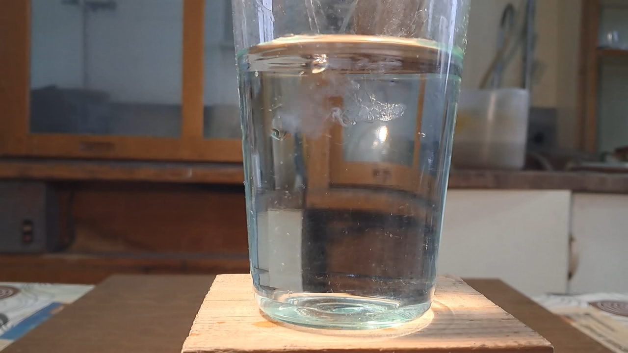

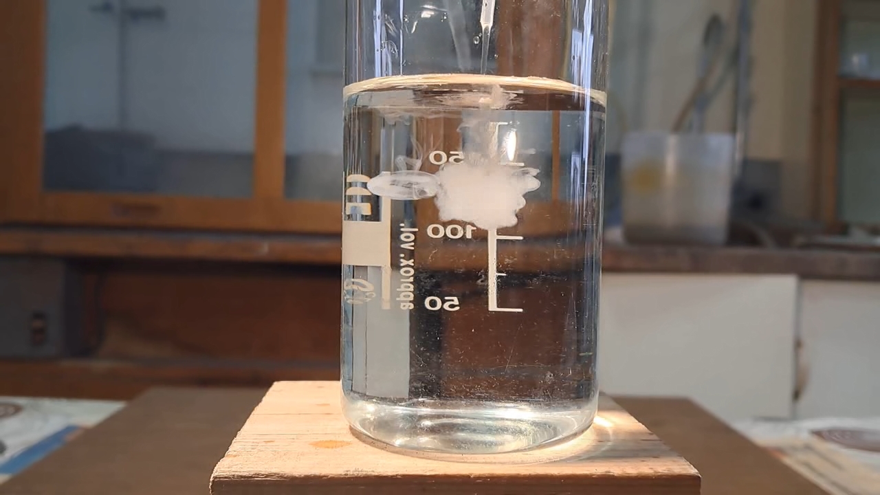

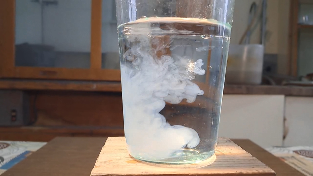

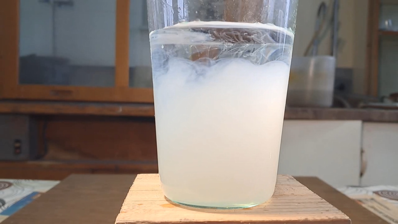

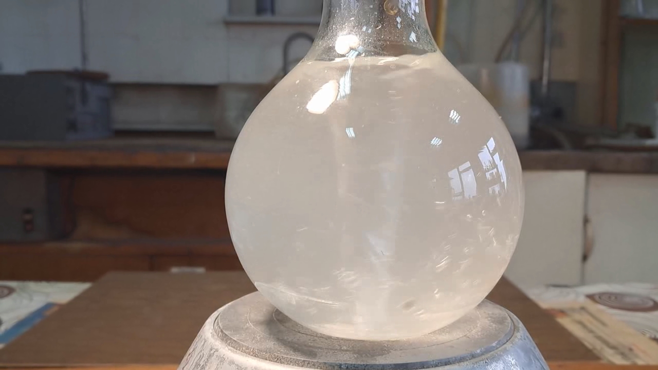

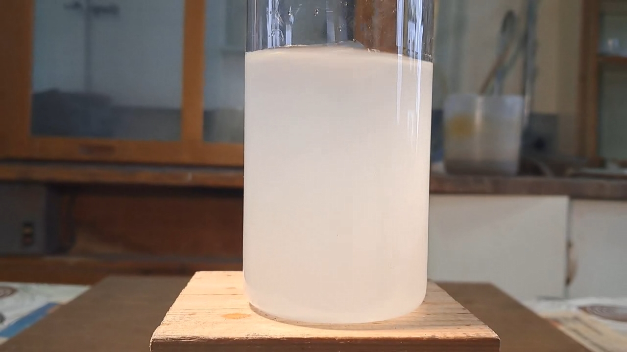

I poured 200 ml of the saturated calcium sulfate solution into a beaker and added 2 ml of a saturated sodium carbonate solution (calcined soda).
I expected a calcium carbonate precipitate to form immediately, although I was not entirely certain.

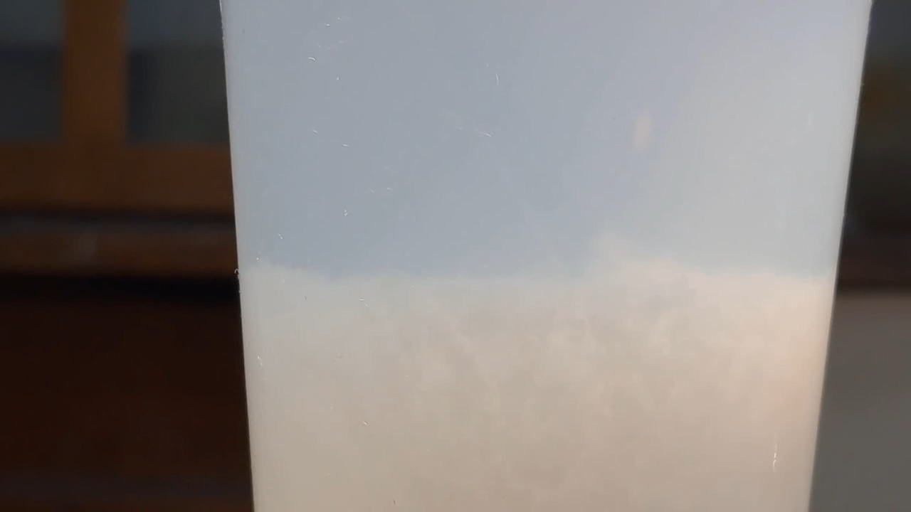

The sodium carbonate solution sank to the bottom, and the lower portion of the liquid instantly turned into a white suspension. I stirred the contents of the beaker, and the mixture began to resemble milk. Unlike the barium sulfate suspension, the calcium carbonate suspension proved to be less stable. After a few minutes, flocs formed, and the solid particles gradually settled to the bottom.
Thus, a saturated solution of calcium sulfate in water forms a precipitate when mixed with a saturated solution of sodium carbonate.
After the experiment, I recalled the method used to convert calcium sulfate into a form soluble in acids. A sodium carbonate solution is added to solid calcium sulfate, and the mixture is boiled. This converts the calcium sulfate into calcium carbonate and sodium sulfate. Because this reaction is reversible, the solution is separated from the precipitate, a fresh portion of sodium carbonate solution is added to the precipitate, and the mixture is boiled again. Repeating this procedure several times results in the conversion of calcium sulfate into calcium carbonate, which is soluble in acids [K1].
Barium sulfate can be converted in a similar manner into acid-soluble barium carbonate, despite the fact that barium sulfate has a lower solubility in water than barium carbonate (unlike the corresponding calcium salts).

Итак, при добавлении раствора соли бария к насыщенному раствору сульфата кальция образуется осадок сульфата бария. После прошлого эксперимента осталось примерно 300 мл насыщенного раствора сульфата кальция в воде, с которым я продолжил экспериментировать.
Идея следующего эксперимента основана на двух фактах. Во-первых, раствор сульфата кальция содержит не только ионы сульфата, но и эквивалентное количество ионов кальция. Во-вторых, растворимость карбоната кальция в воде меньше, чем растворимость сульфата кальция.
Налил в стакан 200 мл насыщенного раствора сульфата кальция и добавил к нему 2 мл насыщенного раствора карбоната натрия (кальцинированная сода).
Я рассчитывал, что сразу образуется осадок карбоната кальция, но не был уверен.
Раствор соды опустился на дно, нижняя часть жидкости моментально превратилась в белую суспензию. Перемешал содержимое стакана - жидкость стала напоминать молоко. В отличие от суспензии сульфата бария, суспензия карбоната кальция оказалась менее стабильной. Через несколько минут образовались хлопья, твердые частицы постепенно оседали на дно.
Таким образом, насыщенный раствор сульфата кальция в воде образует осадок с насыщенным раствором карбоната натрия.
