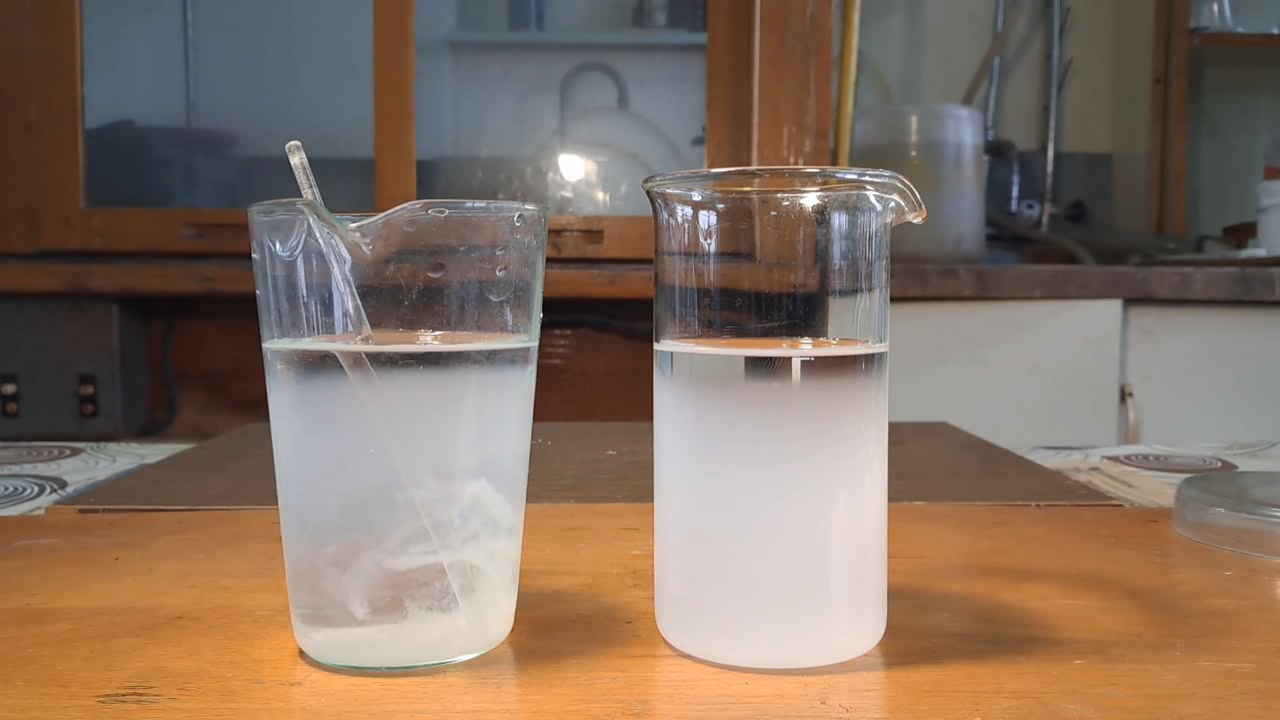

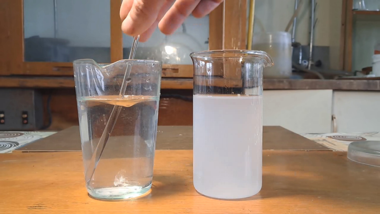

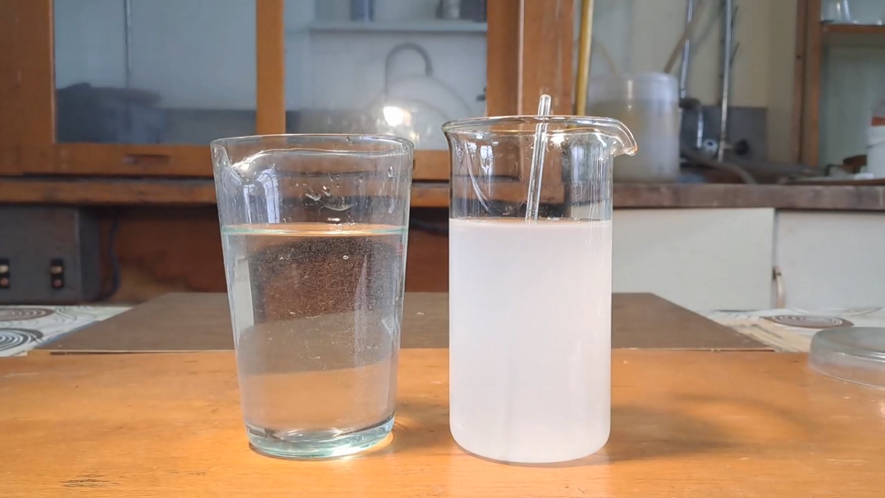

After the previous experiments, I was left with two beakers containing white suspensions of barium sulfate and calcium carbonate. The liquids looked almost identical. Some of the calcium carbonate settled to the bottom, leaving a white suspension, above which a clear layer of solution formed. Some of the barium sulfate also settled over time, and a clear layer appeared above the suspension.

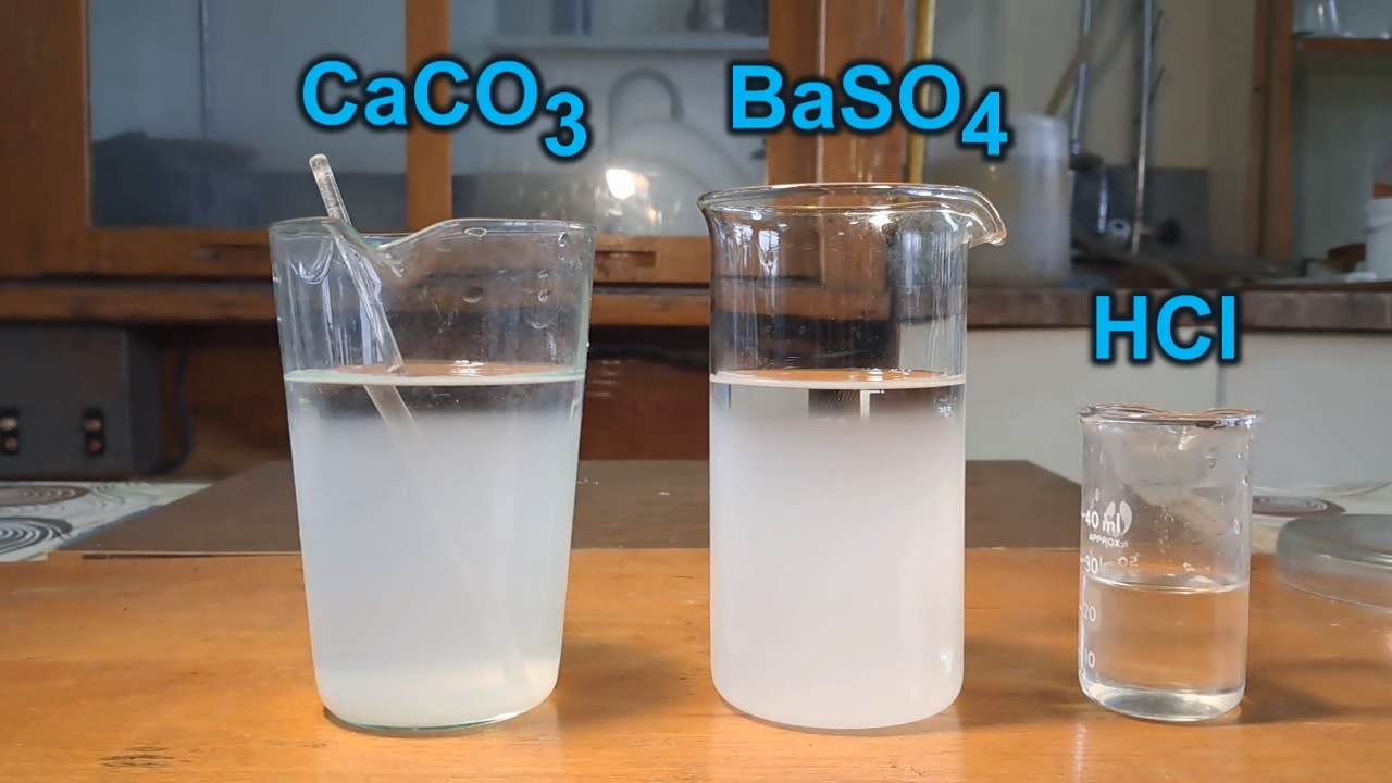

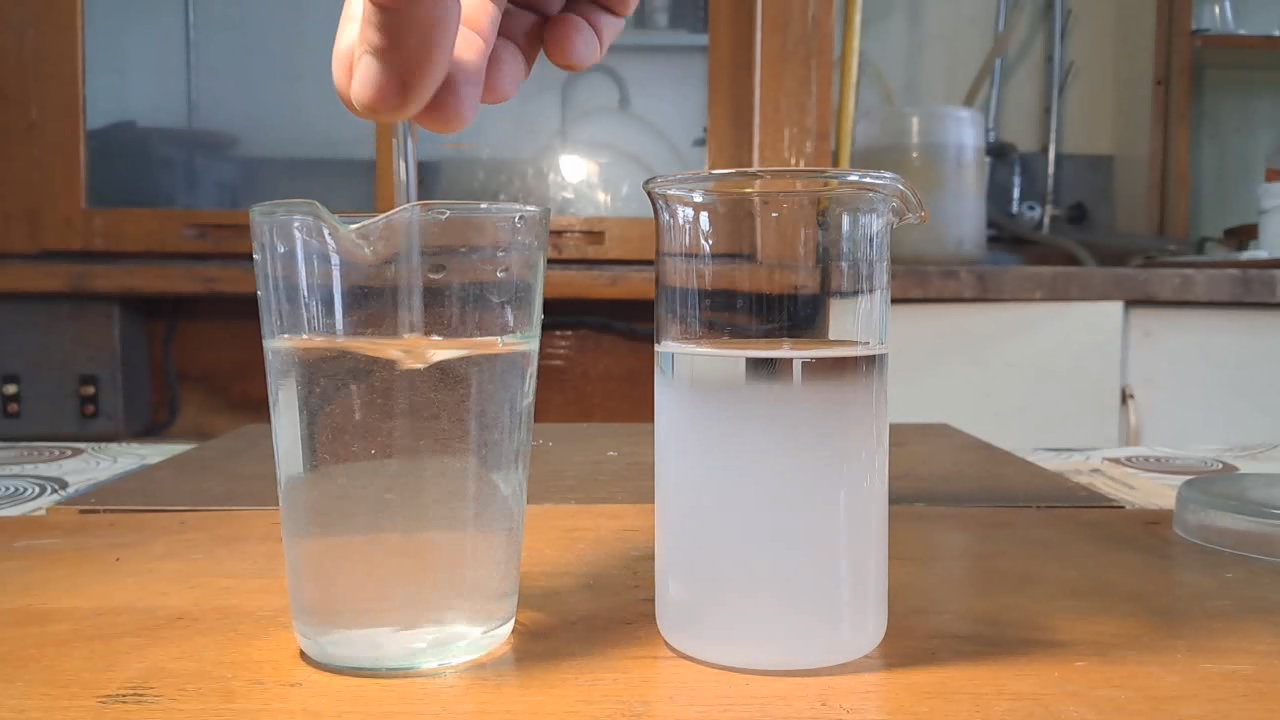

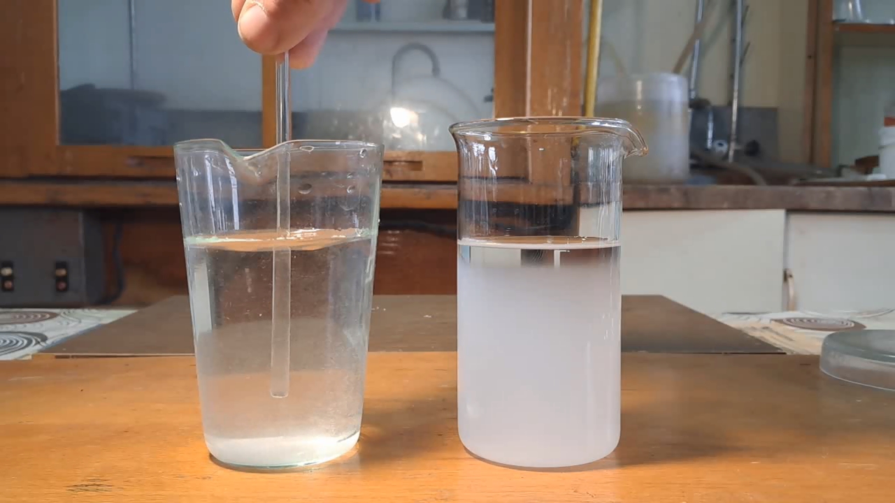

Calcium carbonate and barium sulfate are similar in appearance, but their solubility in acids differs dramatically. I had not originally planned this experiment, but the opportunity arose to clearly demonstrate how these substances behave when treated with hydrochloric acid.

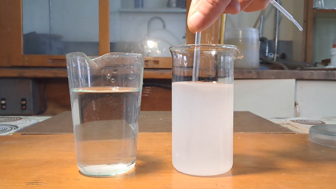

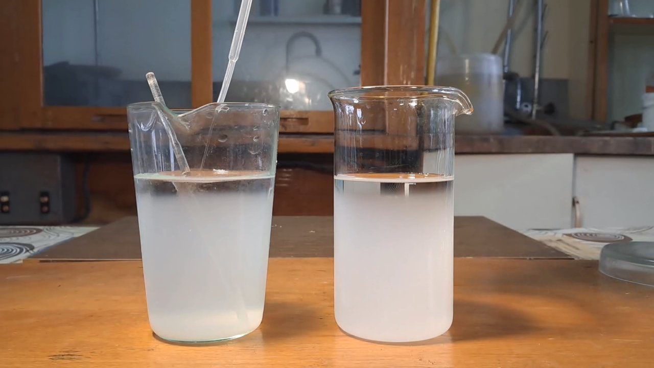

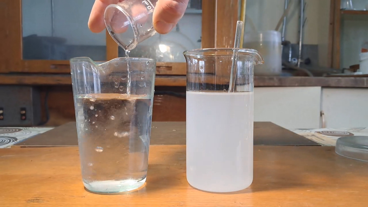

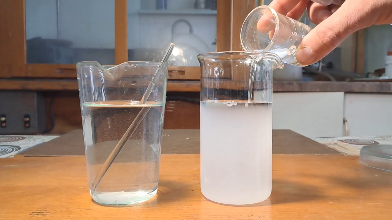

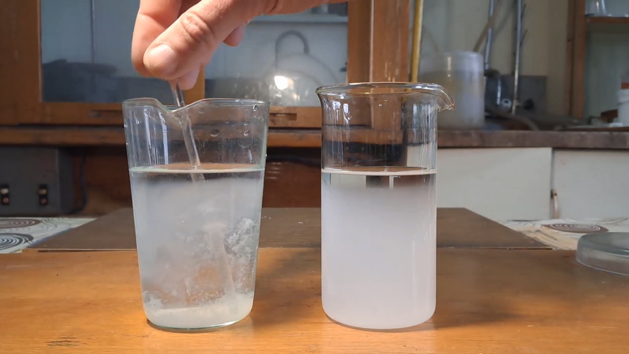

I added 13% hydrochloric acid to the beaker containing calcium carbonate. Bubbles of carbon dioxide appeared, and the fine particles of calcium carbonate dissolved quickly. Dissolving the larger particles at the bottom required additional hydrochloric acid, stirring, and several minutes of time. The result was a clear, colorless solution.
Naturally, the barium sulfate did not dissolve when hydrochloric acid was added - the beaker still contained a white suspension.
Barium sulfate is very poorly soluble not only in water but also in hydrochloric acid solutions. This property allows it to be used for contrast radiography, since gastric juice contains hydrochloric acid.

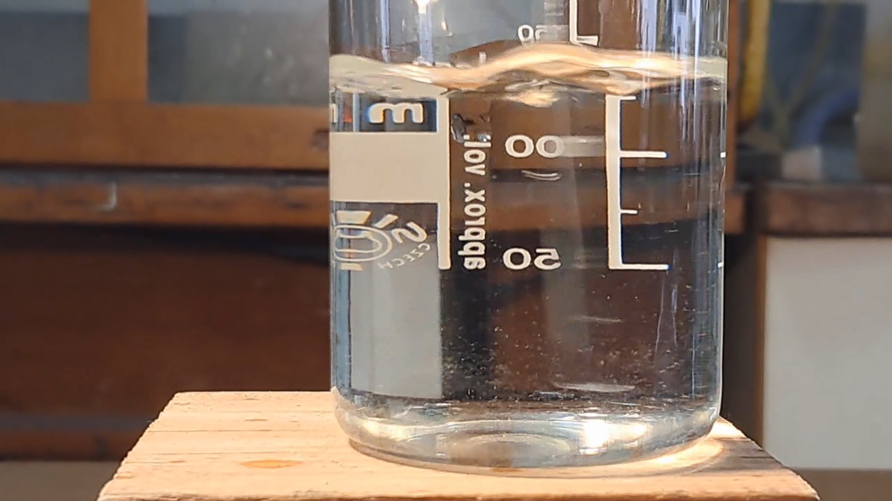

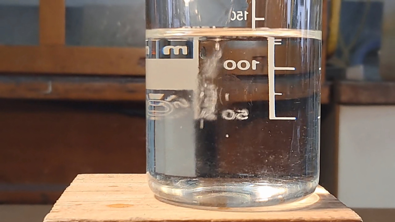

After the previous experiments, I had approximately 120 ml of saturated calcium sulfate solution left. I decided to test how this solution would interact with a strontium salt. As already noted, the solubility of strontium sulfate is intermediate between that of calcium sulfate and barium sulfate.
Had I read the section on barium in my analytical chemistry textbook [1] beforehand, I would have avoided some unpleasant moments during the experiment. However, I only read that section while preparing this article, not before working with strontium salts.

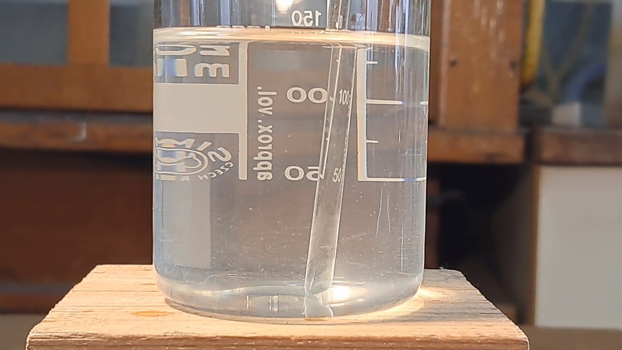

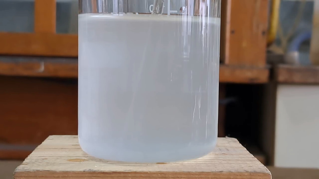

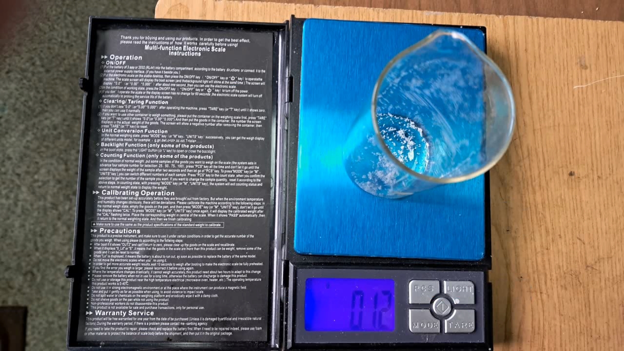

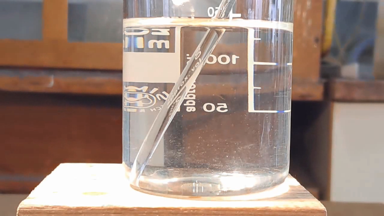

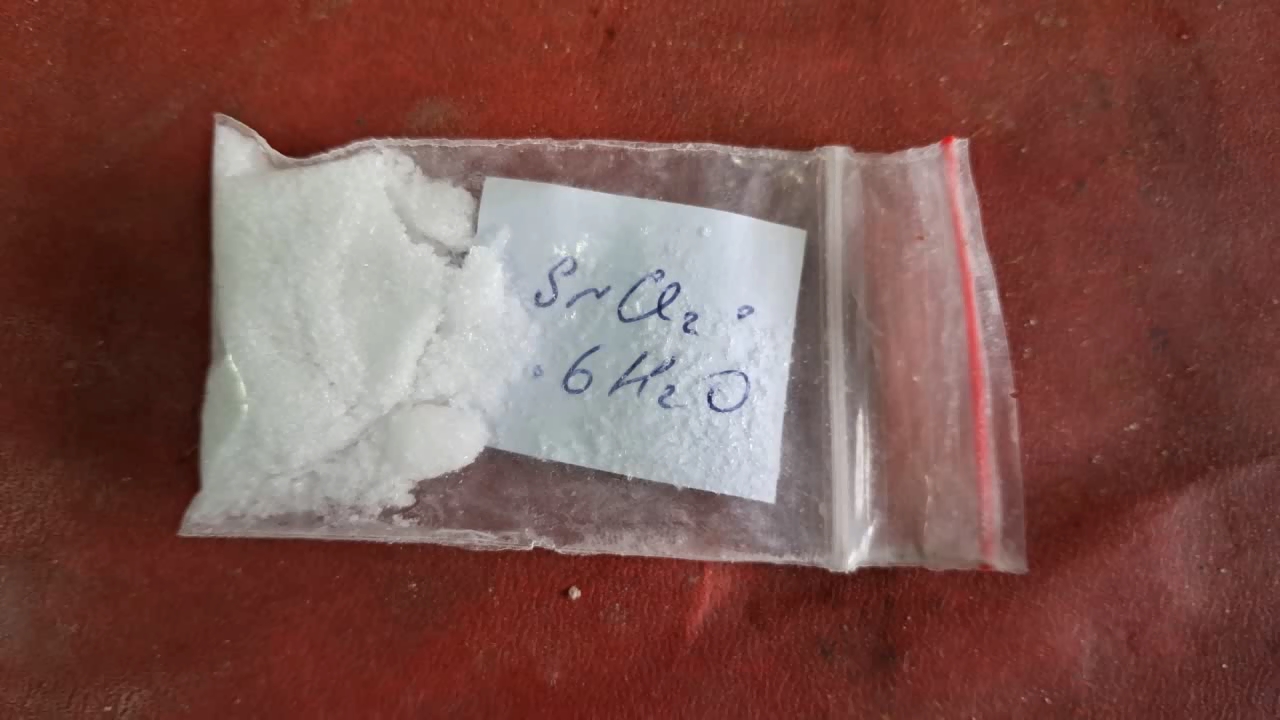

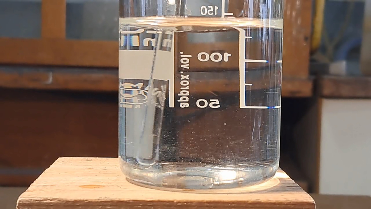

I found a small packet of strontium chloride hexahydrate and dissolved 0.12 g of the salt in a few milliliters of water. I poured the remaining calcium sulfate solution into a beaker and added the strontium chloride solution. It sank to the bottom; I stirred the contents of the beaker. No precipitate formed, and the liquid did not turn cloudy. Even after three minutes of standing, no visible changes occurred.

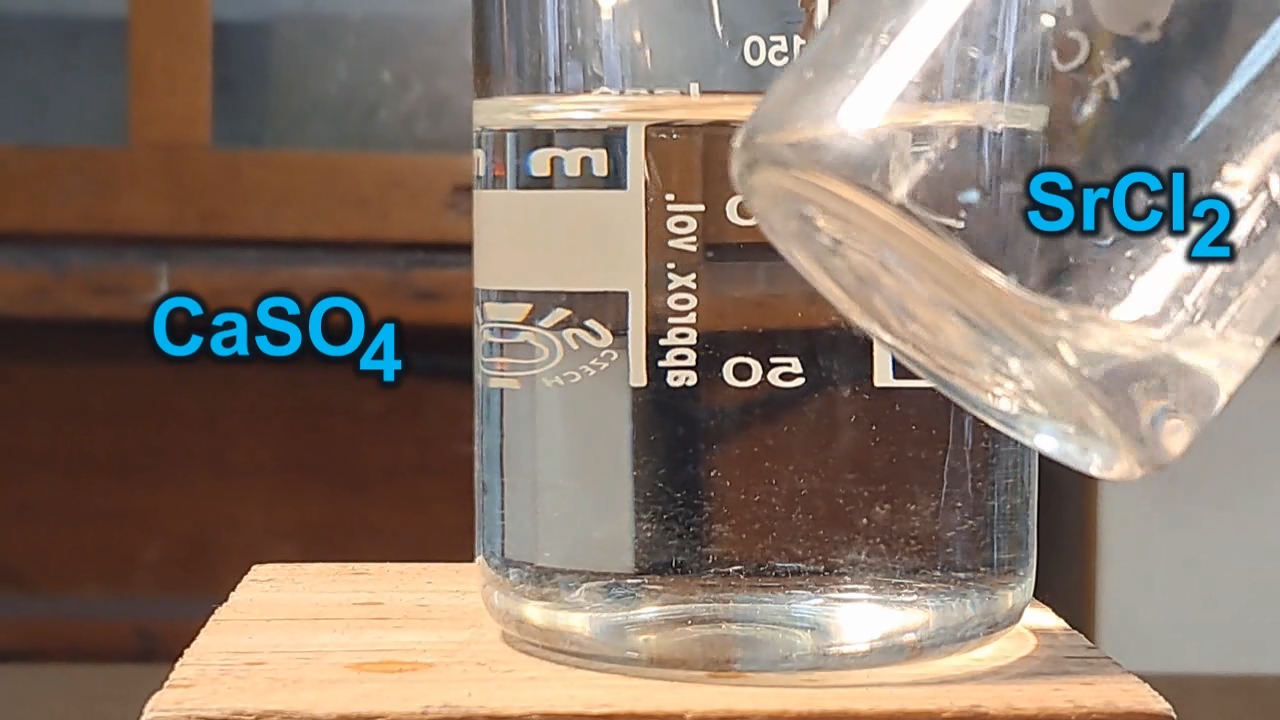

The precipitation of strontium sulfate did not take place. More strontium chloride needed to be added. I dissolved 0.52 g of strontium chloride in a minimal amount of water and added this solution to the beaker containing the calcium sulfate solution.

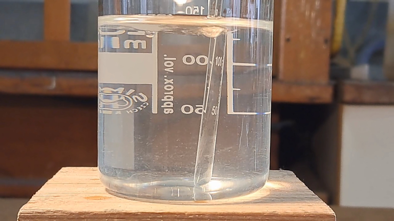

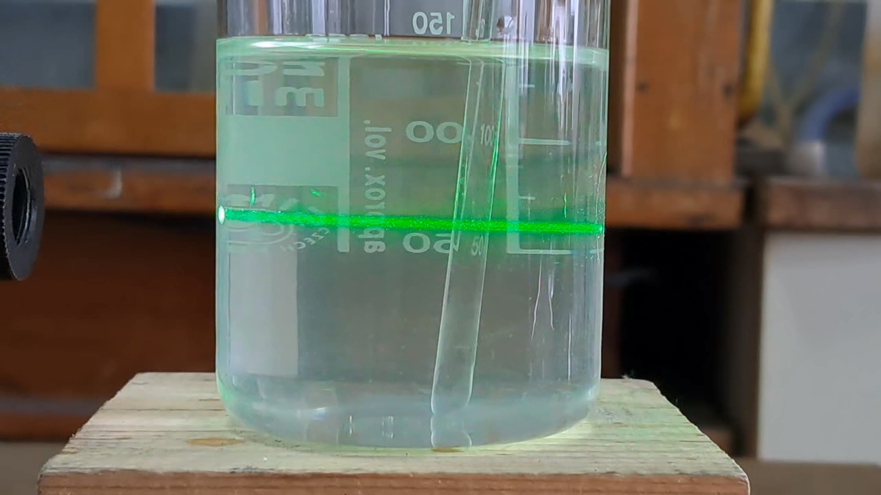

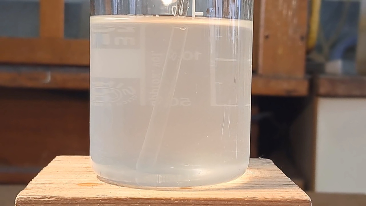

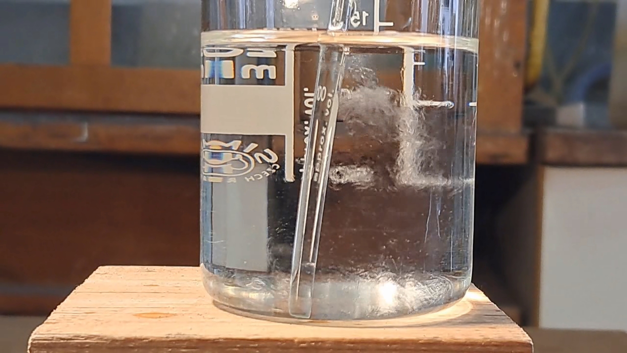

The strontium chloride solution again sank to the bottom. I stirred the liquid. Initially, the solution did not become cloudy - no strontium sulfate precipitate had formed. Could it be that strontium sulfate would not precipitate at all?

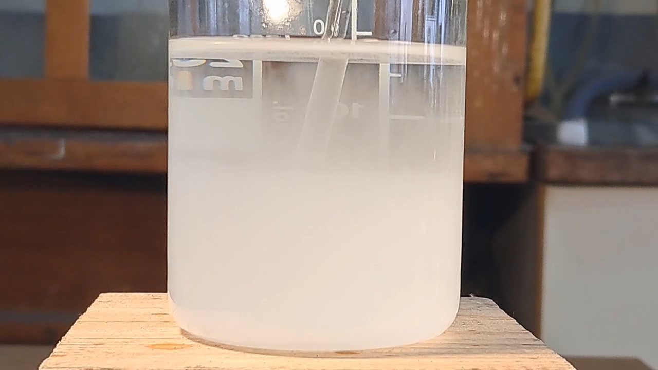

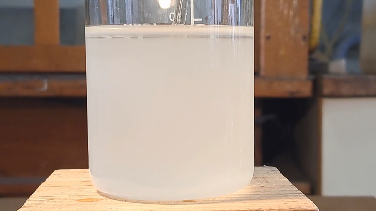

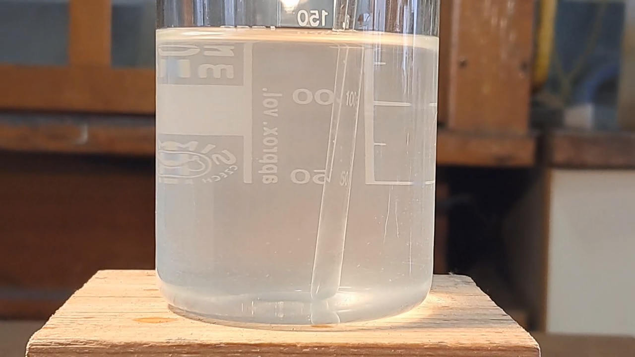

After about half a minute, the liquid in the beaker became slightly cloudy. Gradually, the cloudiness increased, and later a white precipitate of strontium sulfate appeared on the bottom and along the walls of the beaker.
Thus, the reaction between a saturated calcium sulfate solution and a strontium chloride solution resulted in the formation of a white precipitate of strontium sulfate. Unlike the analogous reaction with barium nitrate, the formation of the precipitate was noticeably delayed and required a relatively high concentration of strontium cations.
Later, while working on the article, I read in the textbook that after adding a saturated calcium sulfate solution, precipitation of strontium sulfate occurs only upon heating or after prolonged standing. This is the key difference between strontium and barium.

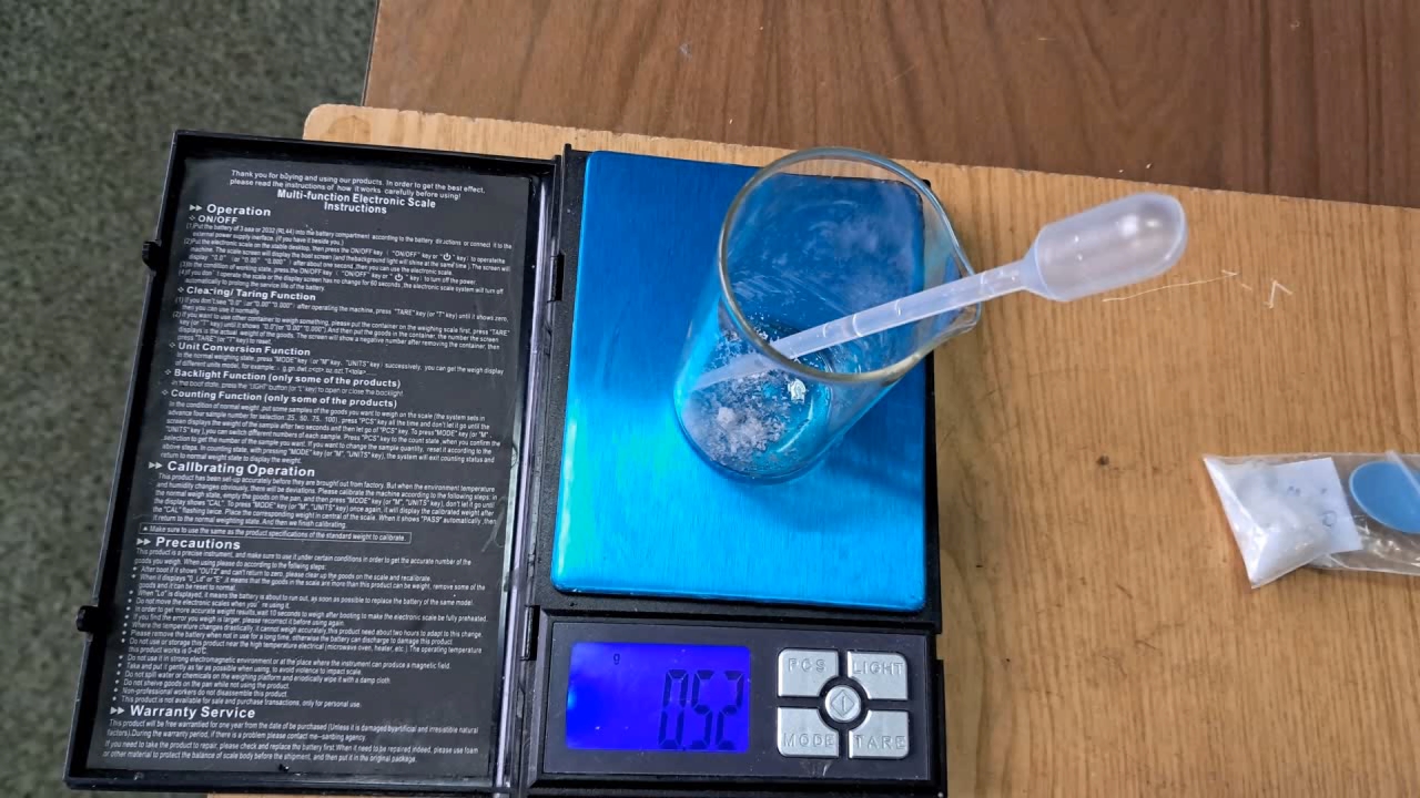

Осаждения сульфата стронция не произошло. Нужно добавить больше хлорида стронция. Растворил 0.52 г хлорида стронция в минимальном количестве воды и добавил этот раствор в стакан с раствором сульфата кальция.
