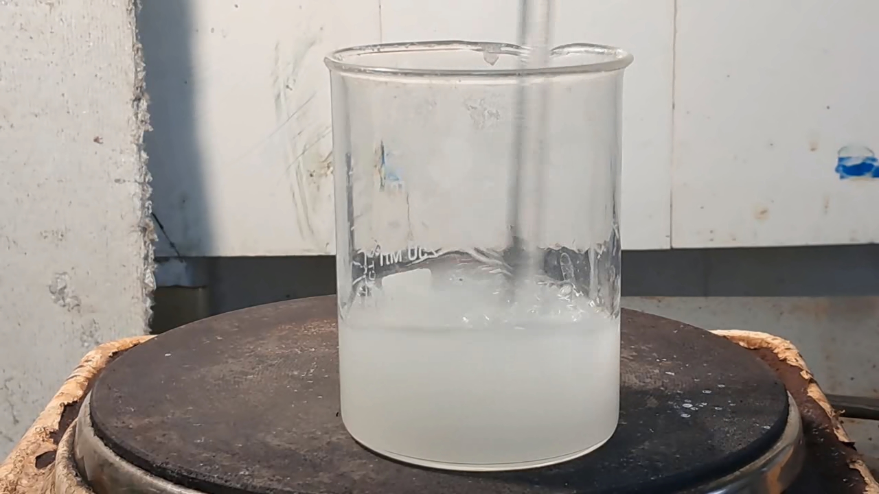

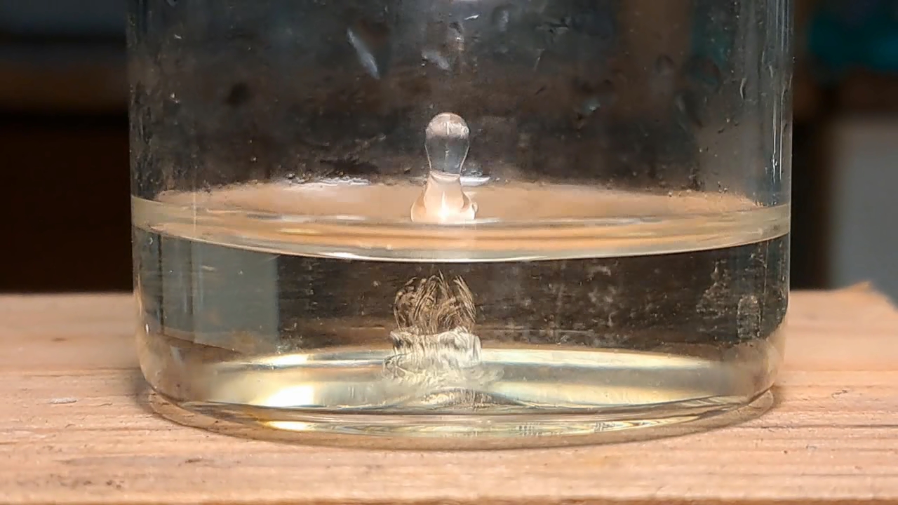

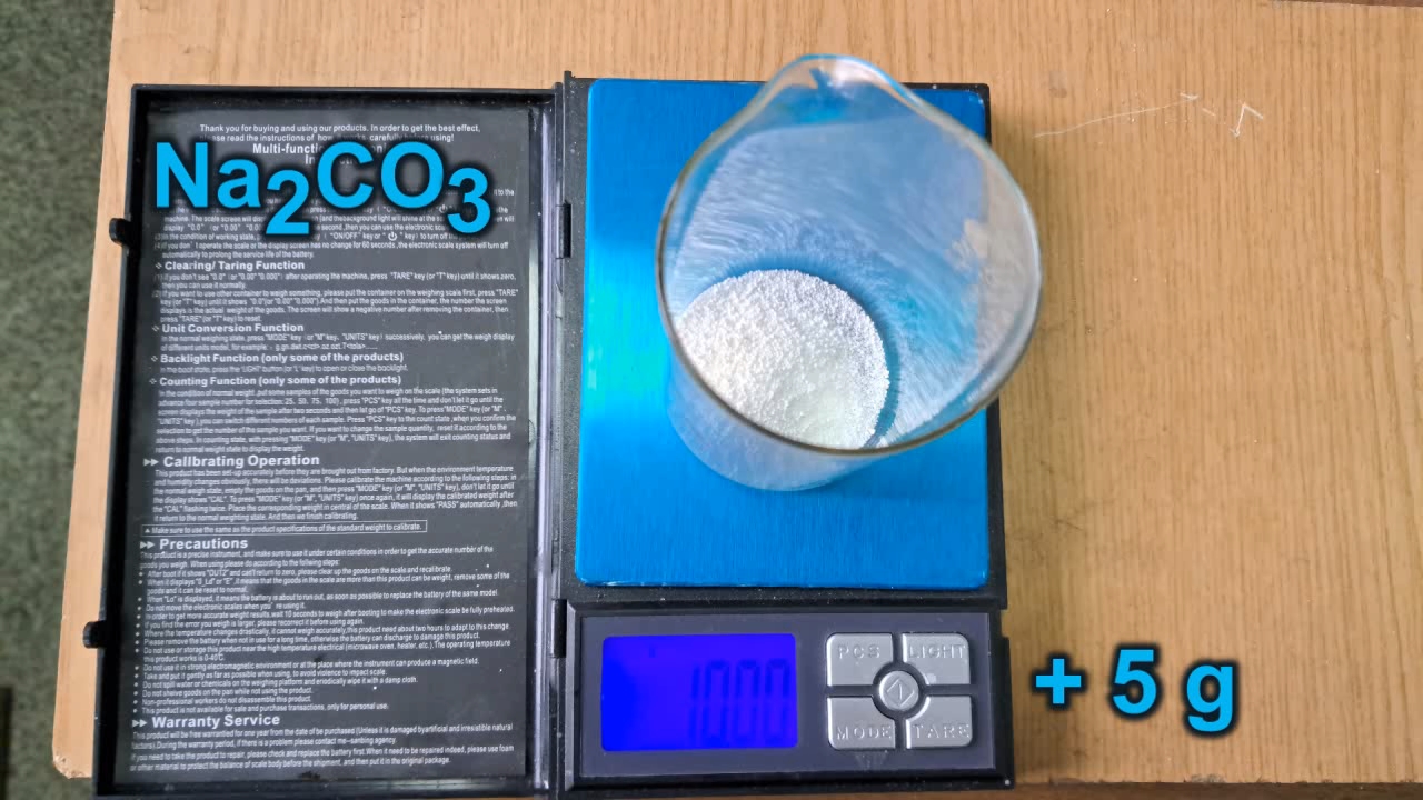

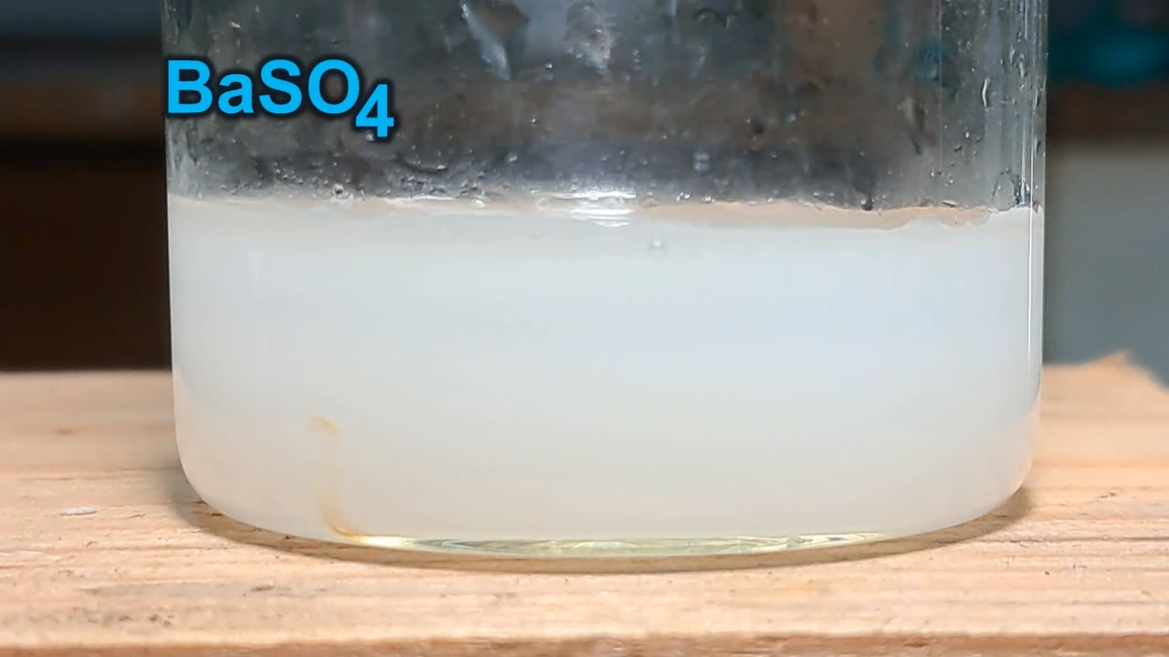

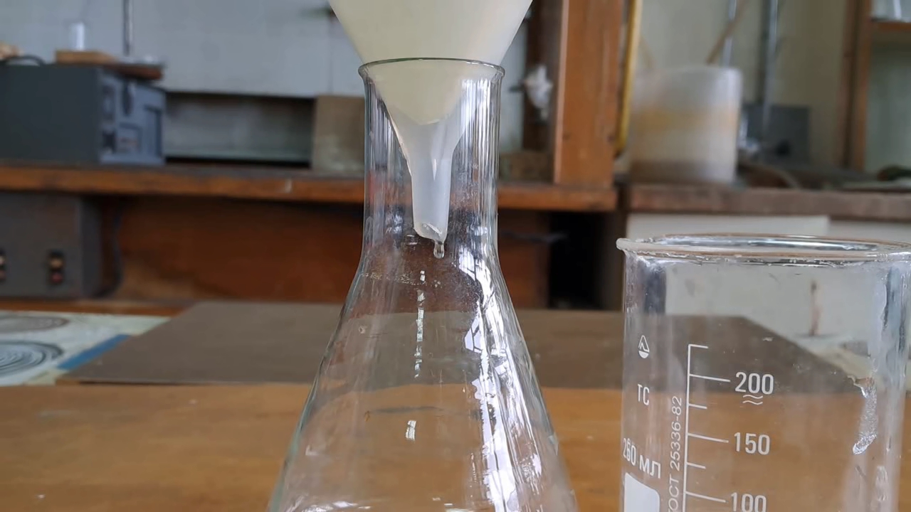

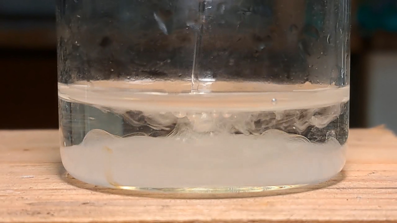

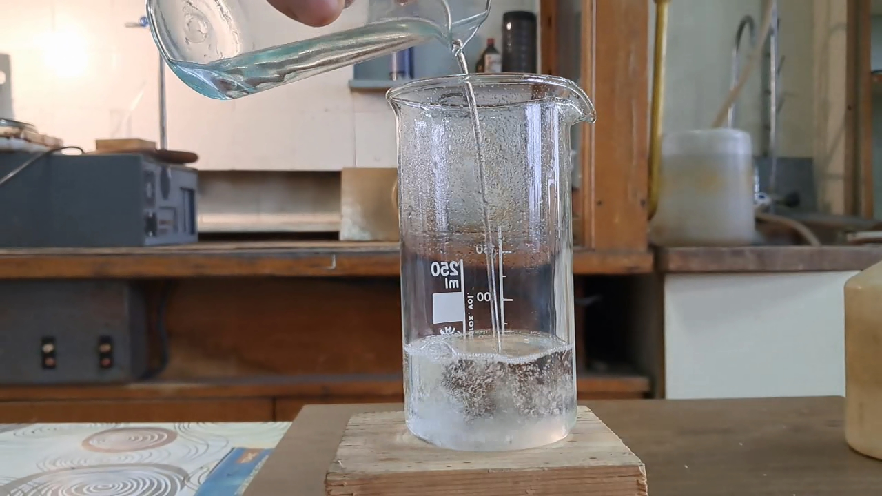

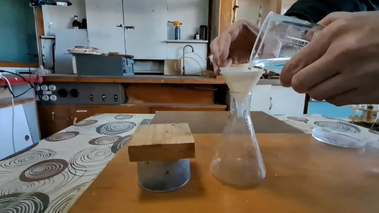

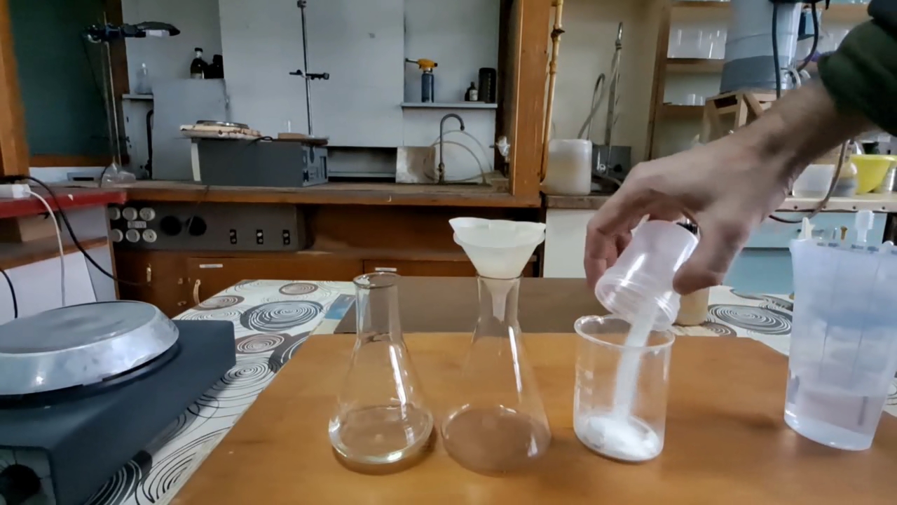

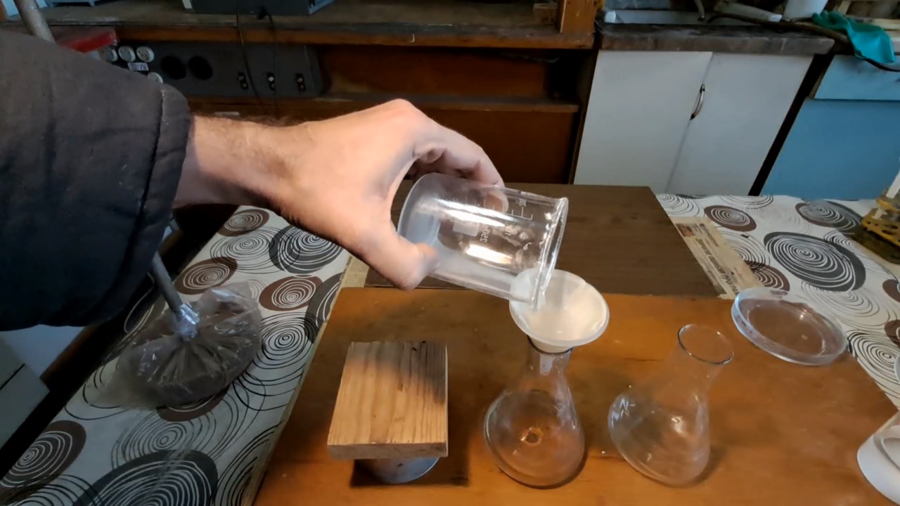

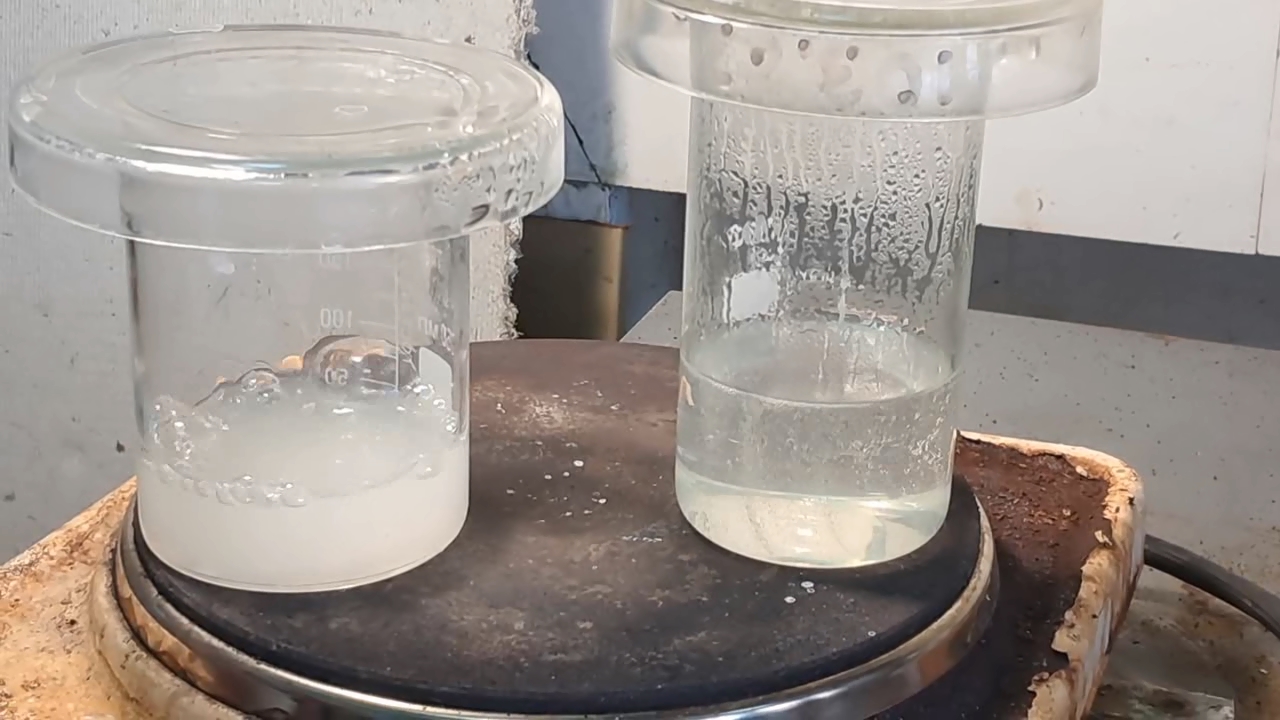

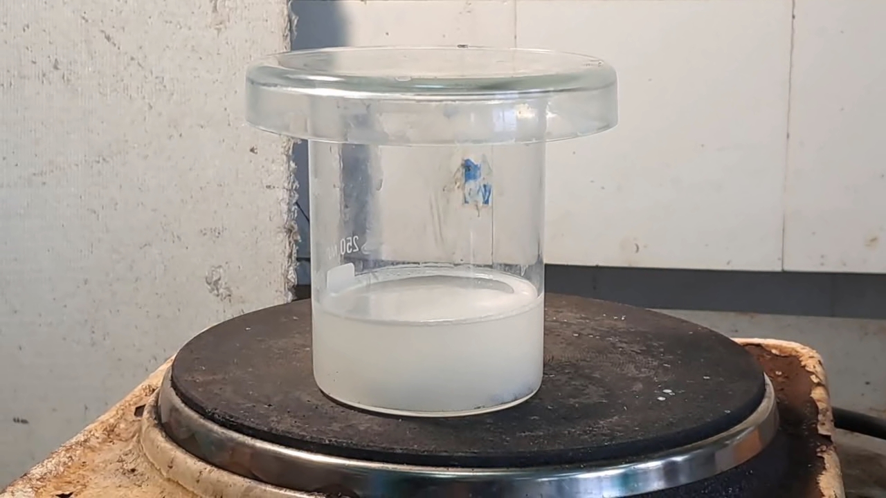

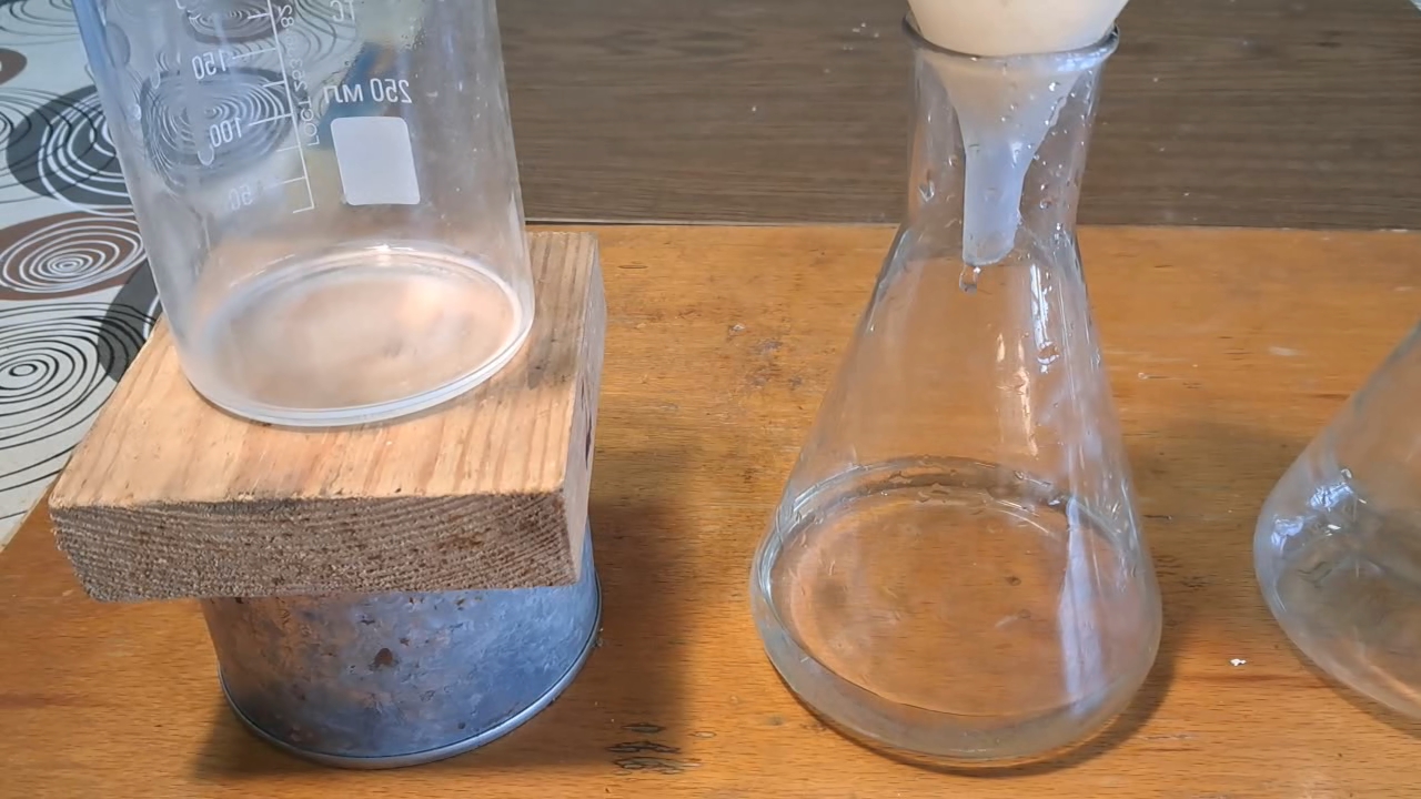

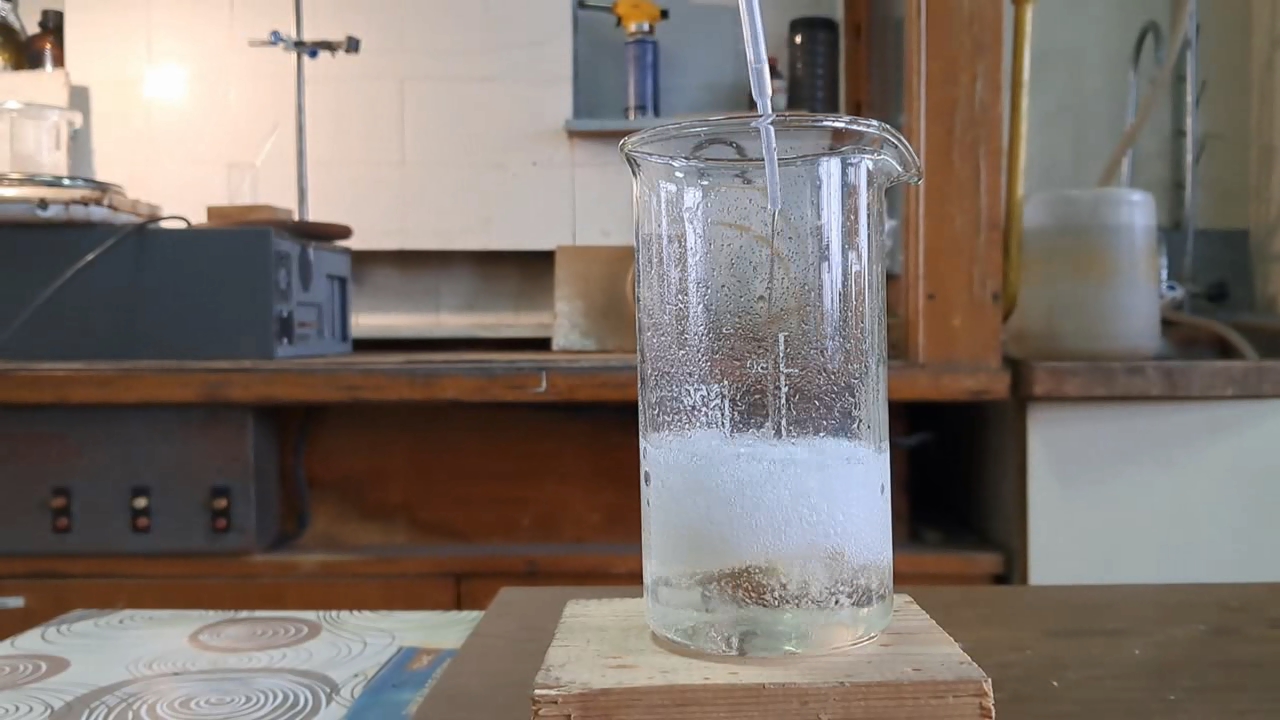

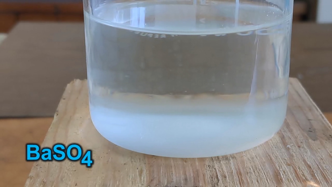

I weighed 0.2 g of technical-grade barium sulfate and added 10 g of anhydrous sodium carbonate along with 100 ml of distilled water. After some consideration, I added another 5 g of sodium carbonate (15 g in total). I covered the beaker and placed it on a hot plate to boil. The mixture boiled for 2.5 hours, with additional water added periodically to compensate for evaporation. Then the power went out at the institute, so I left the beaker with the solution and precipitate overnight.

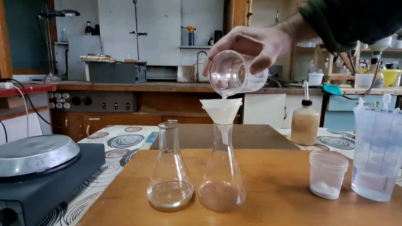

In the morning, I planned to quickly decant the solution from the sediment, add a fresh portion - 15 g of sodium carbonate and 100 ml of water - and return the mixture to the hot plate. I was in a hurry because another power outage was expected soon. However, the fine precipitate particles formed a stable suspension, making decantation impractical. As a result, I had to filter the mixture through a paper filter and then wash the precipitate on the filter, which took quite a long time.

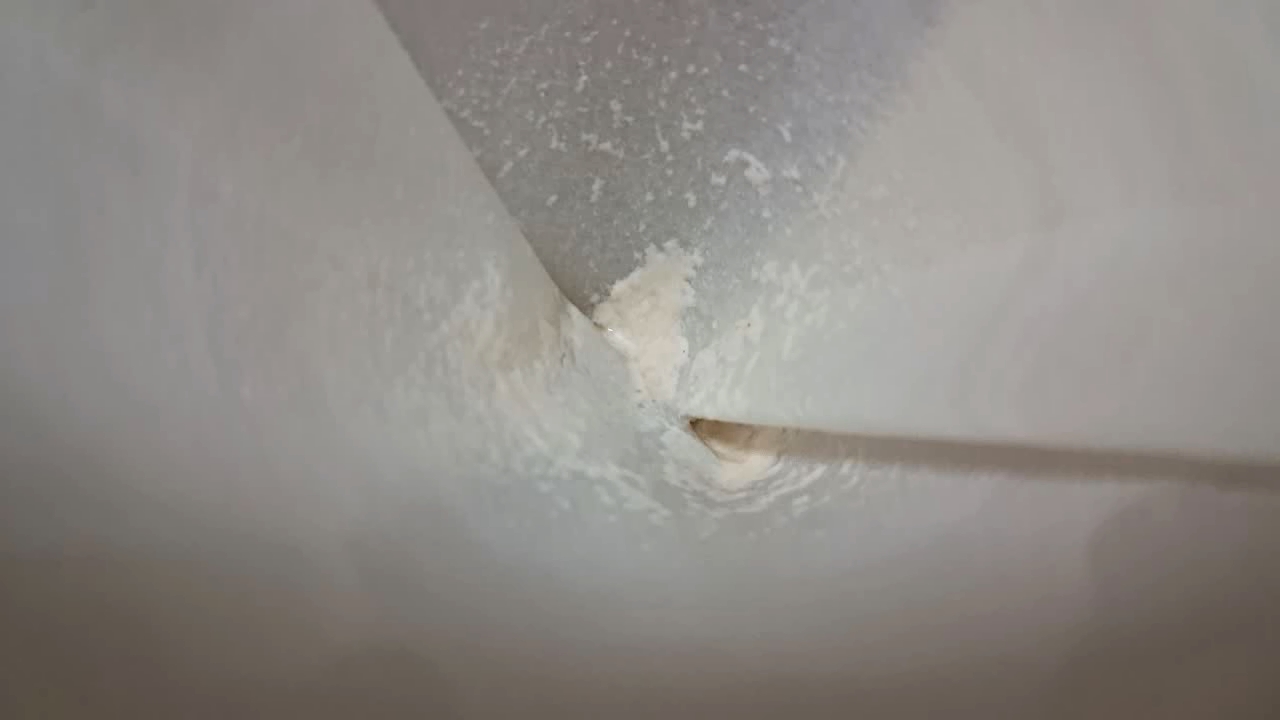

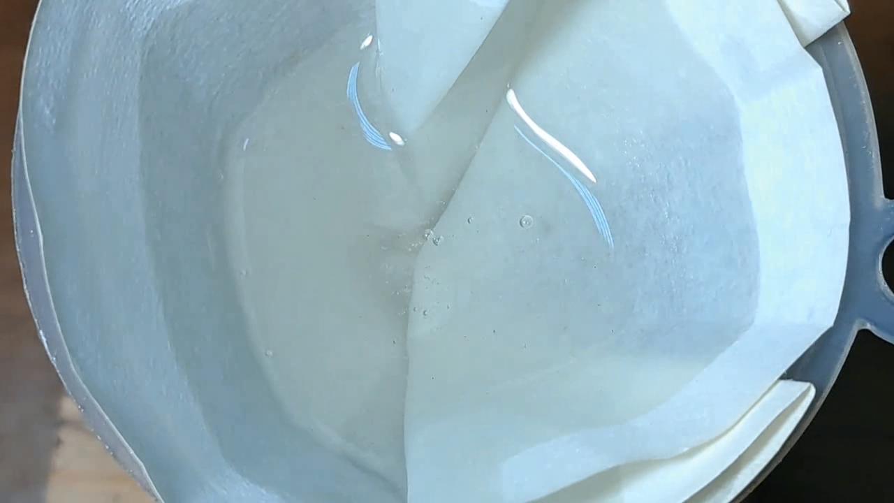

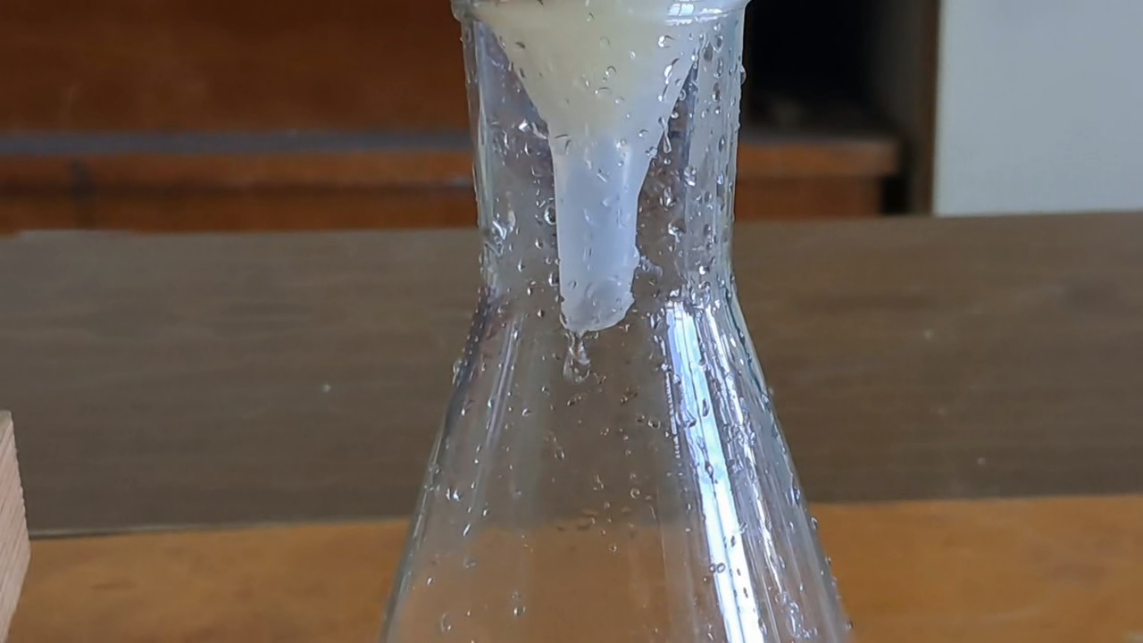

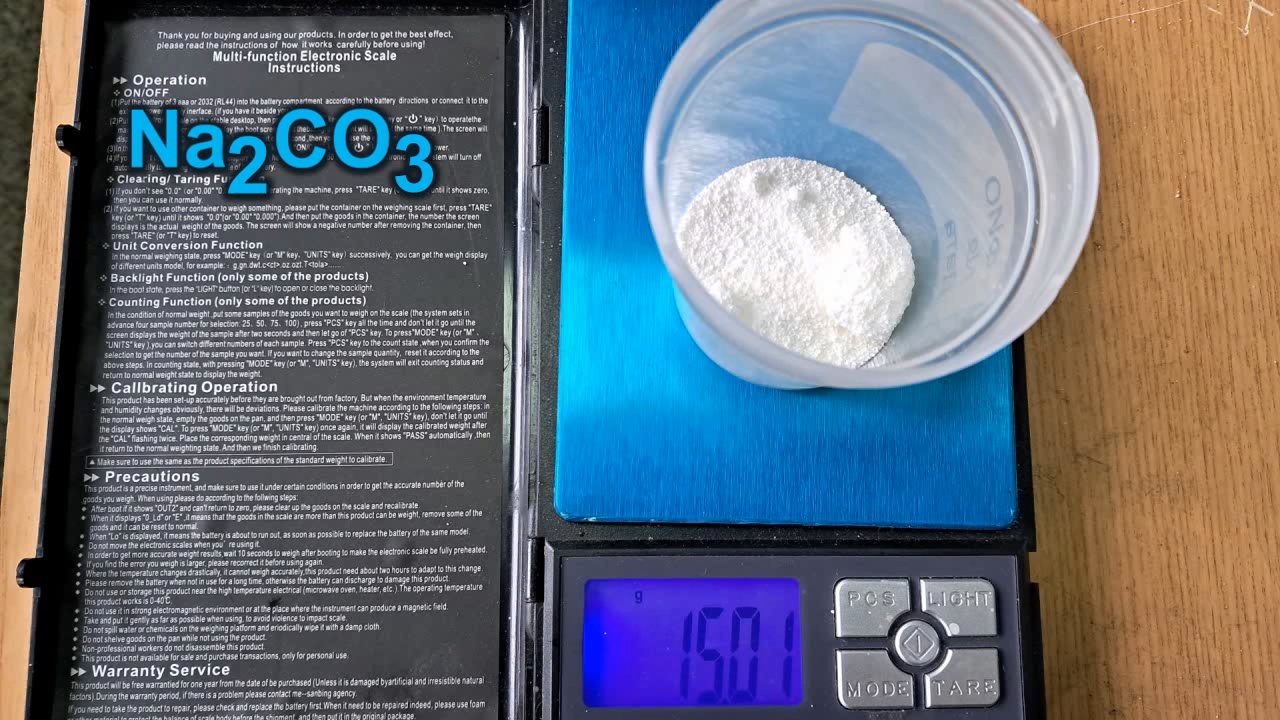

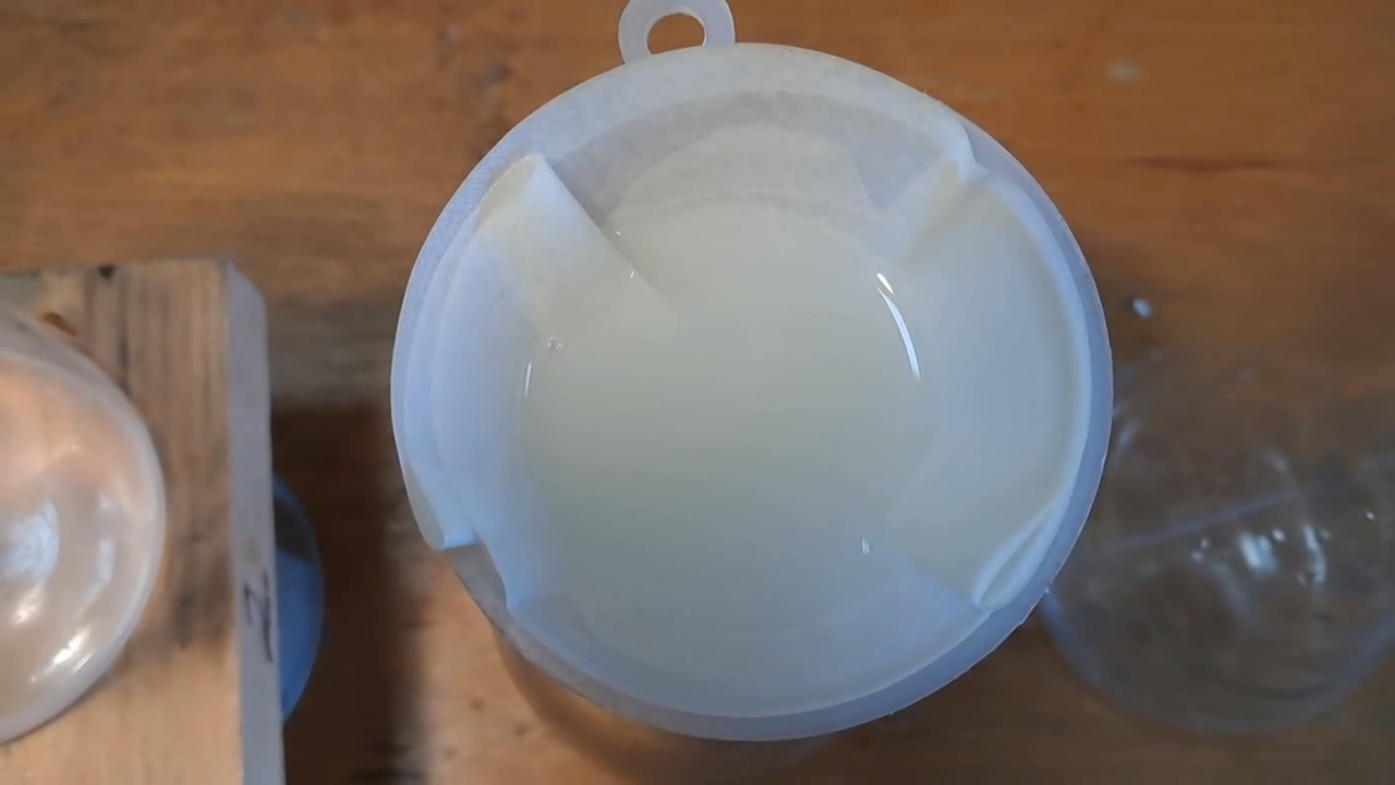

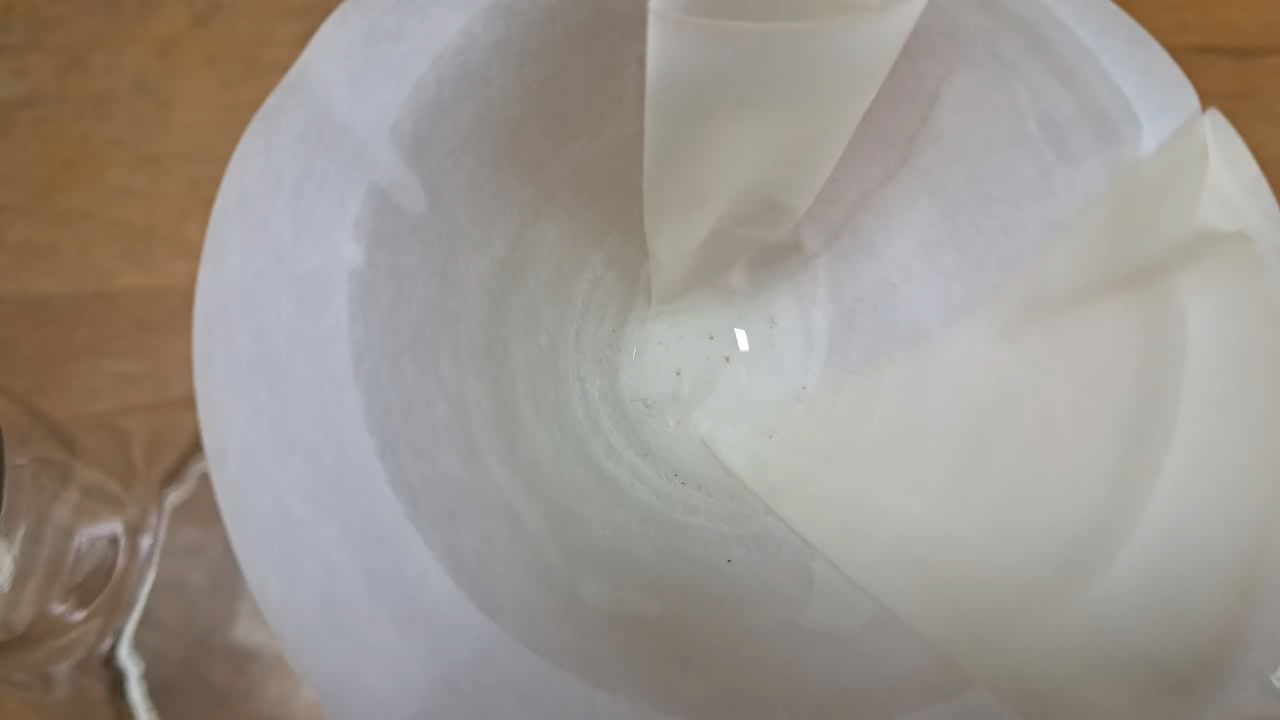

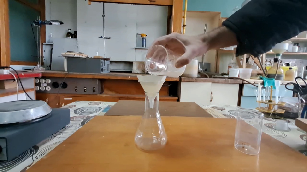

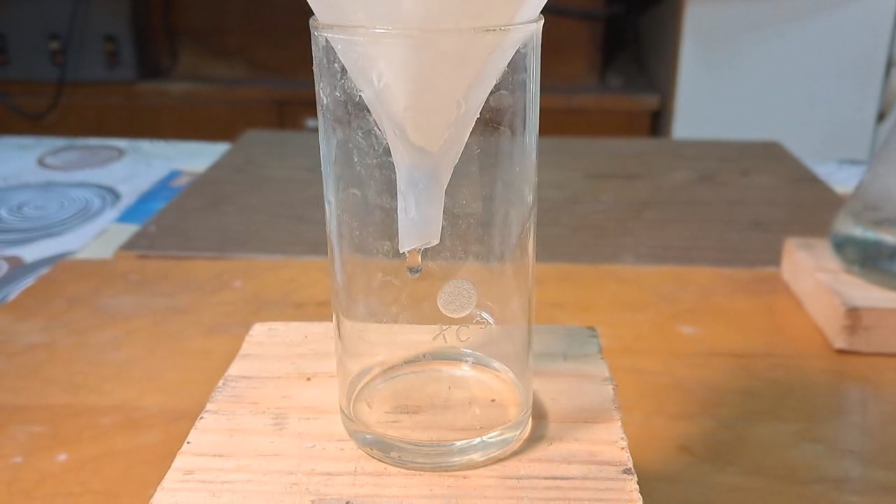

After filtration, I transferred the precipitate into a beaker, added sodium carbonate and water, and brought the mixture to a boil. Unfortunately, the power went out again after just half an hour of boiling, so once more the beaker was left standing overnight.

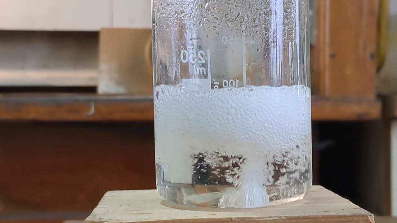

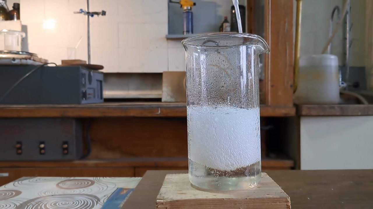

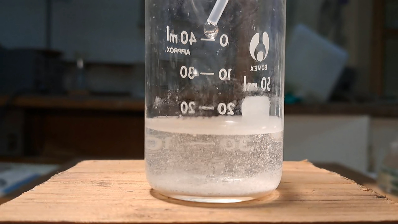

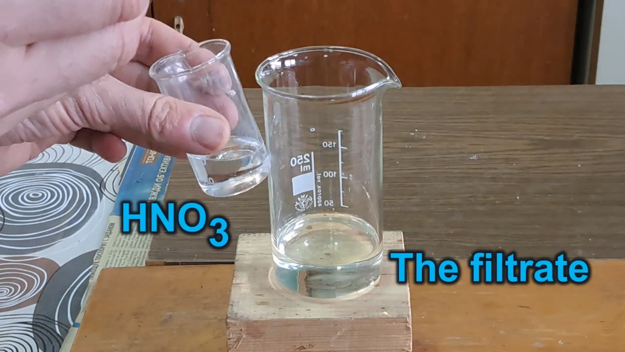

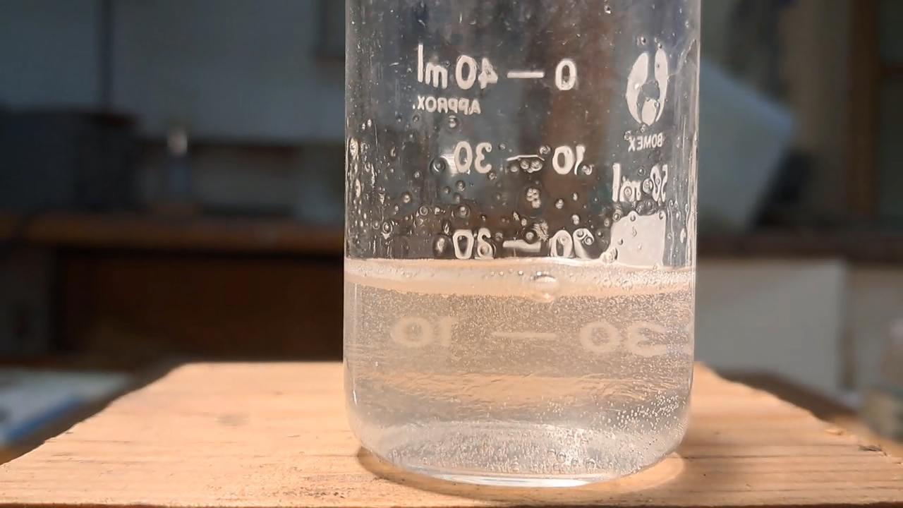

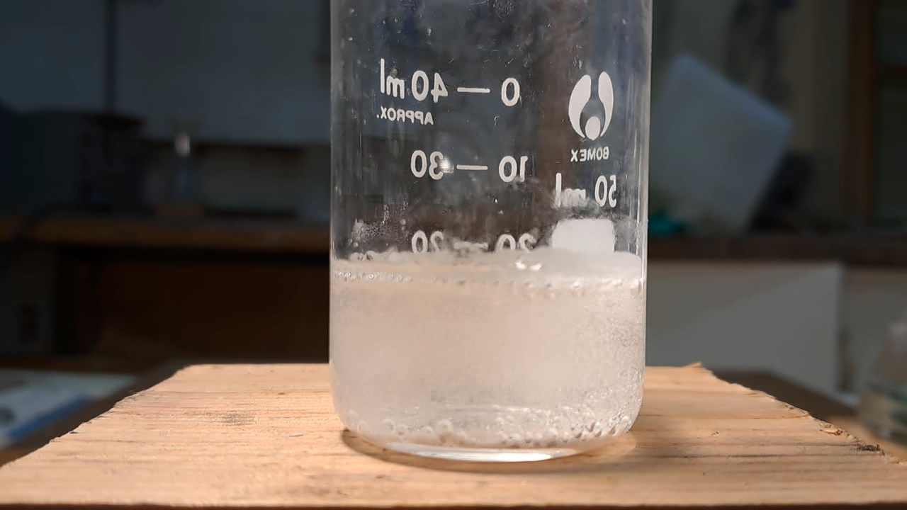

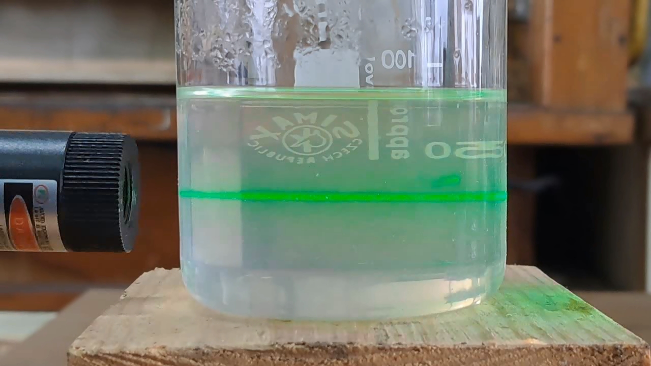

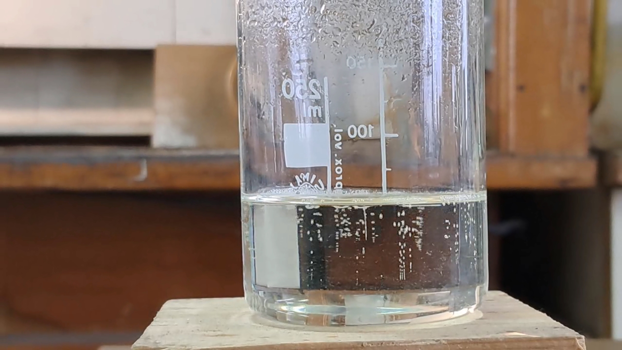

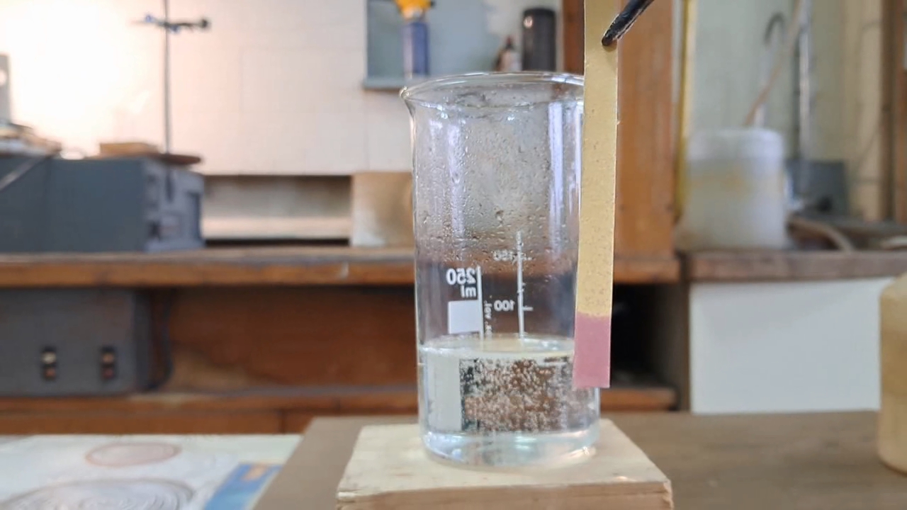

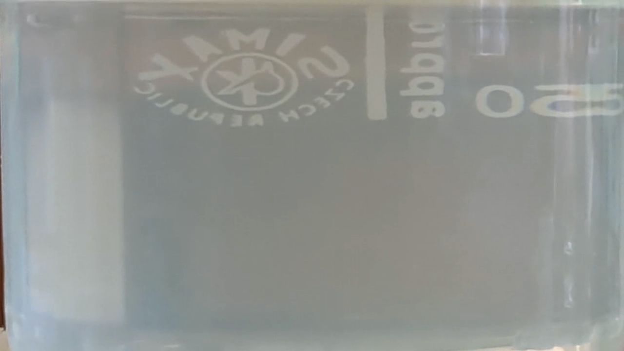

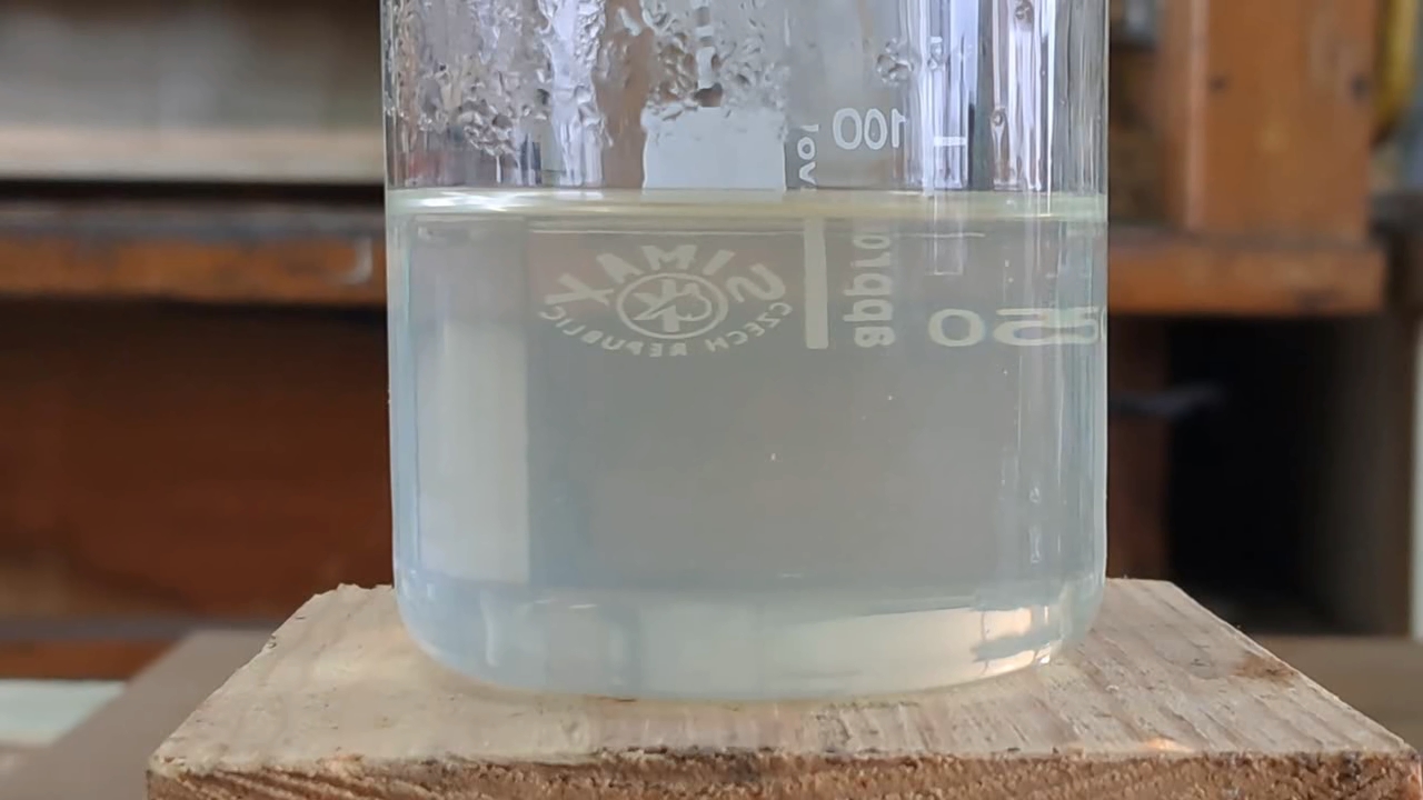

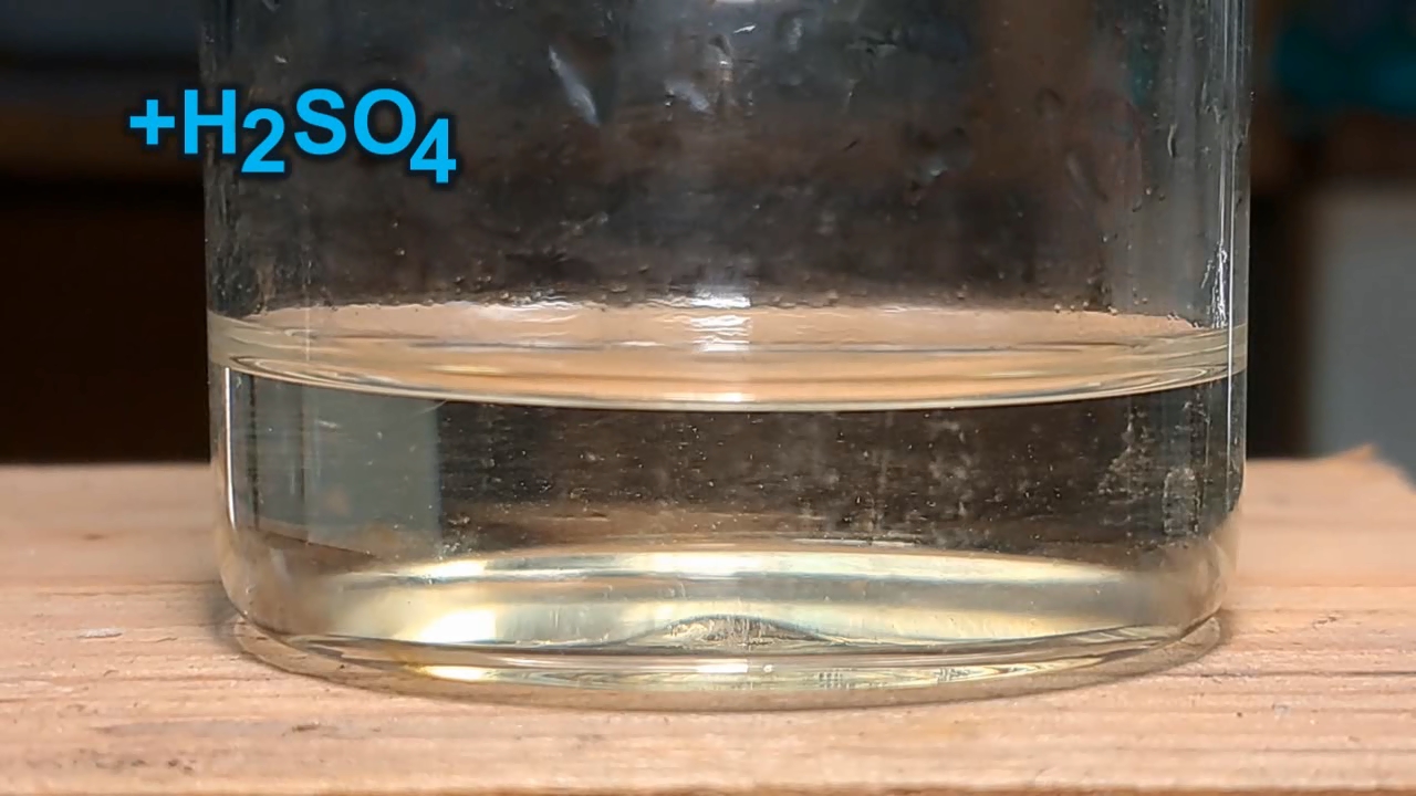

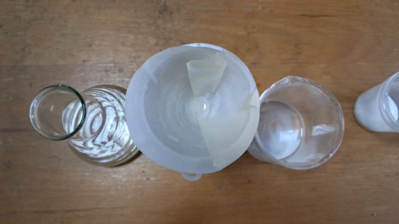

In parallel, I began testing the filtrate. I added 56% nitric acid in small portions until the vigorous evolution of carbon dioxide ceased. A test with indicator paper showed that the solution was strongly acidic. I then added 3 ml of ~5% barium nitrate solution. I expected the liquid to turn white and turbid immediately.

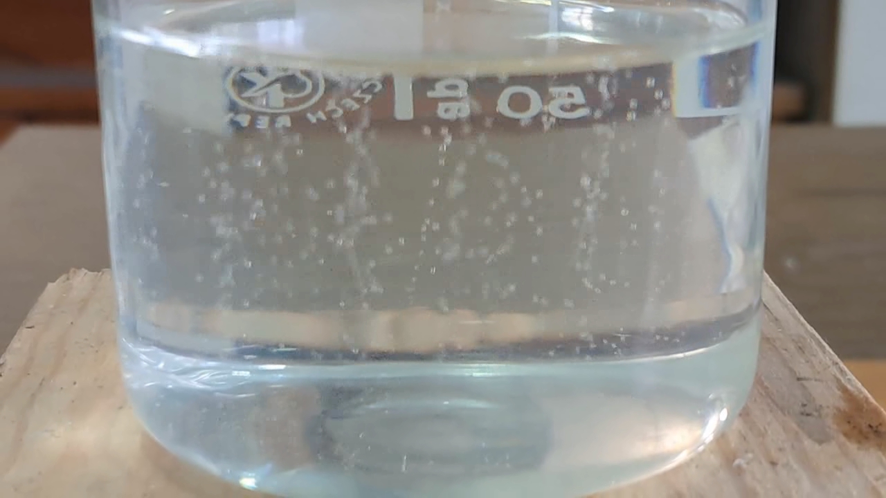

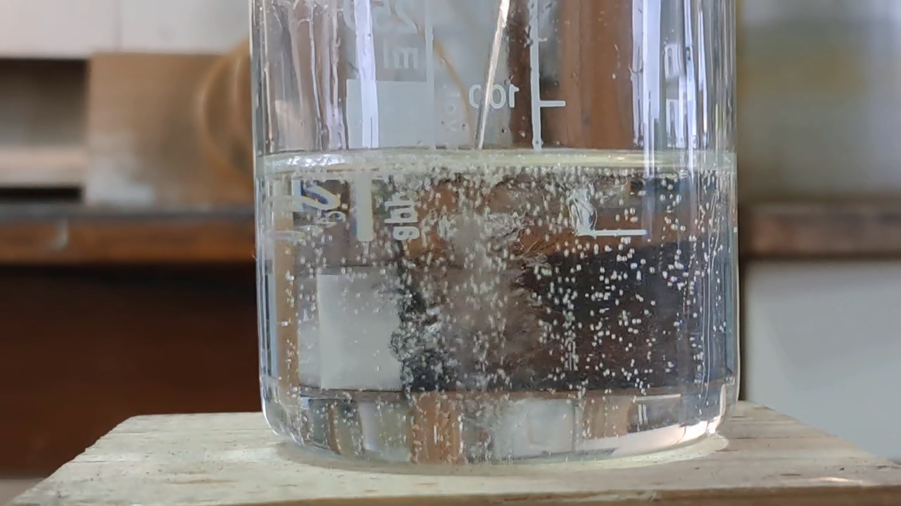

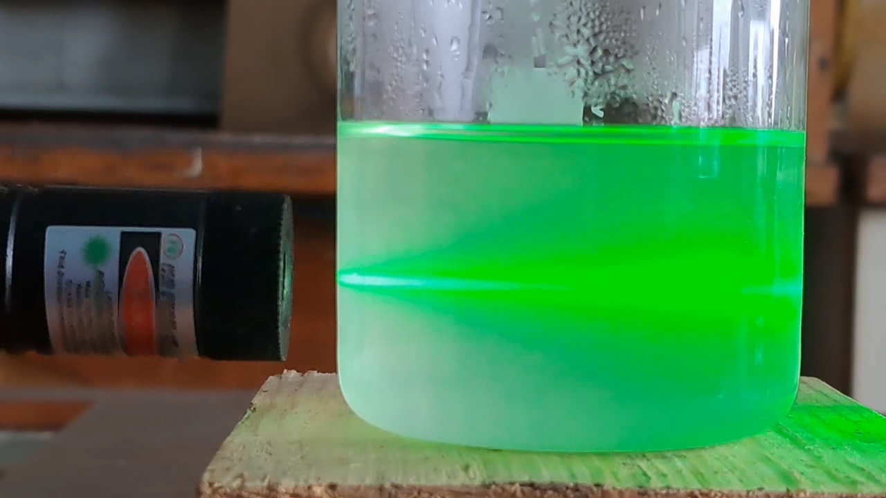

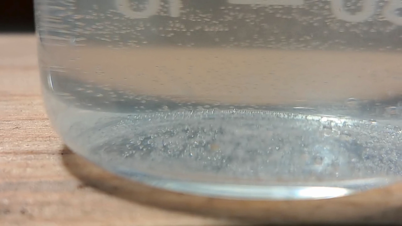

However, no noticeable turbidity appeared at first. The solution remained clear, and carbon dioxide bubbles continued to form. After a few minutes, a slight cloudiness became visible. Sulfate anions were indeed present, but their concentration was low, which slowed the formation of barium sulfate.

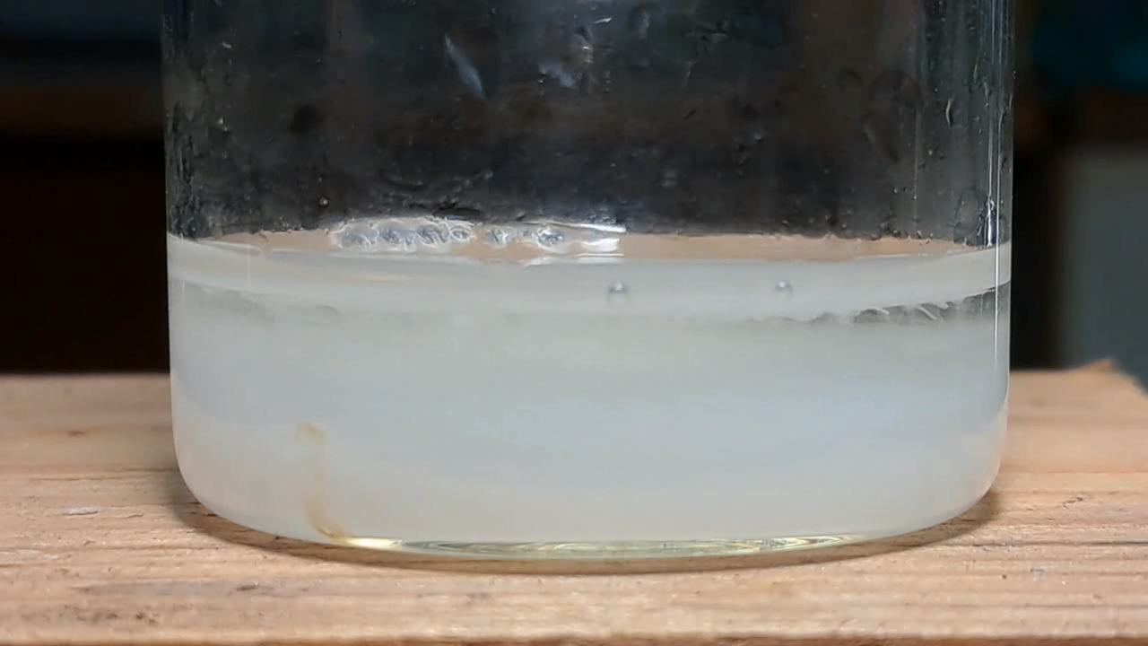

A similar phenomenon had previously been observed in an experiment involving calcium sulfate and strontium chloride solutions: precipitation required either heating or prolonged standing.

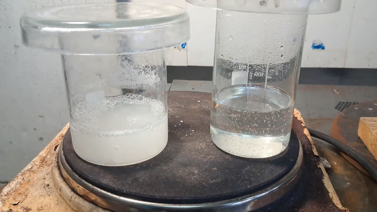

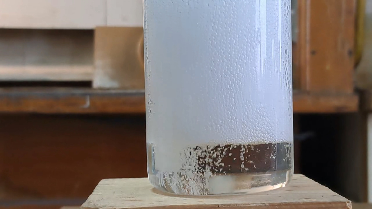

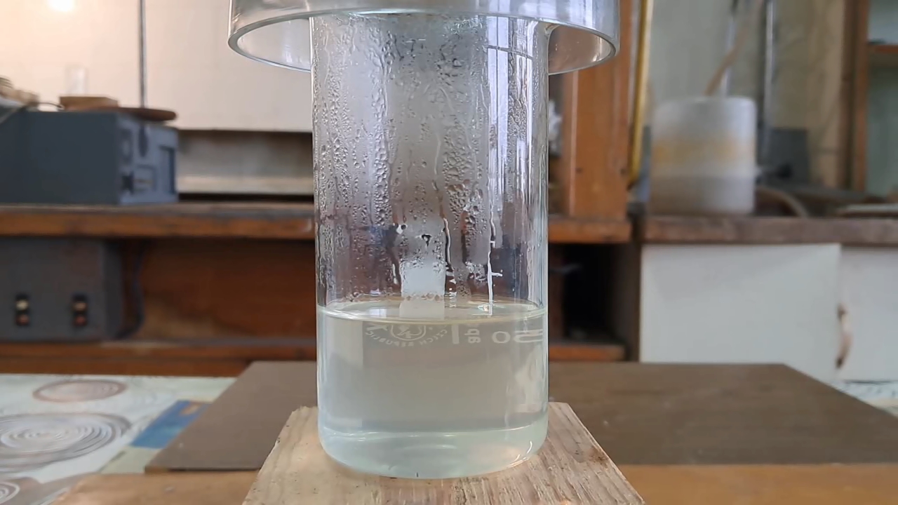

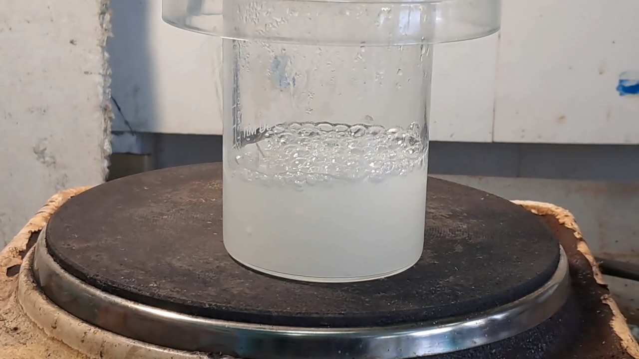

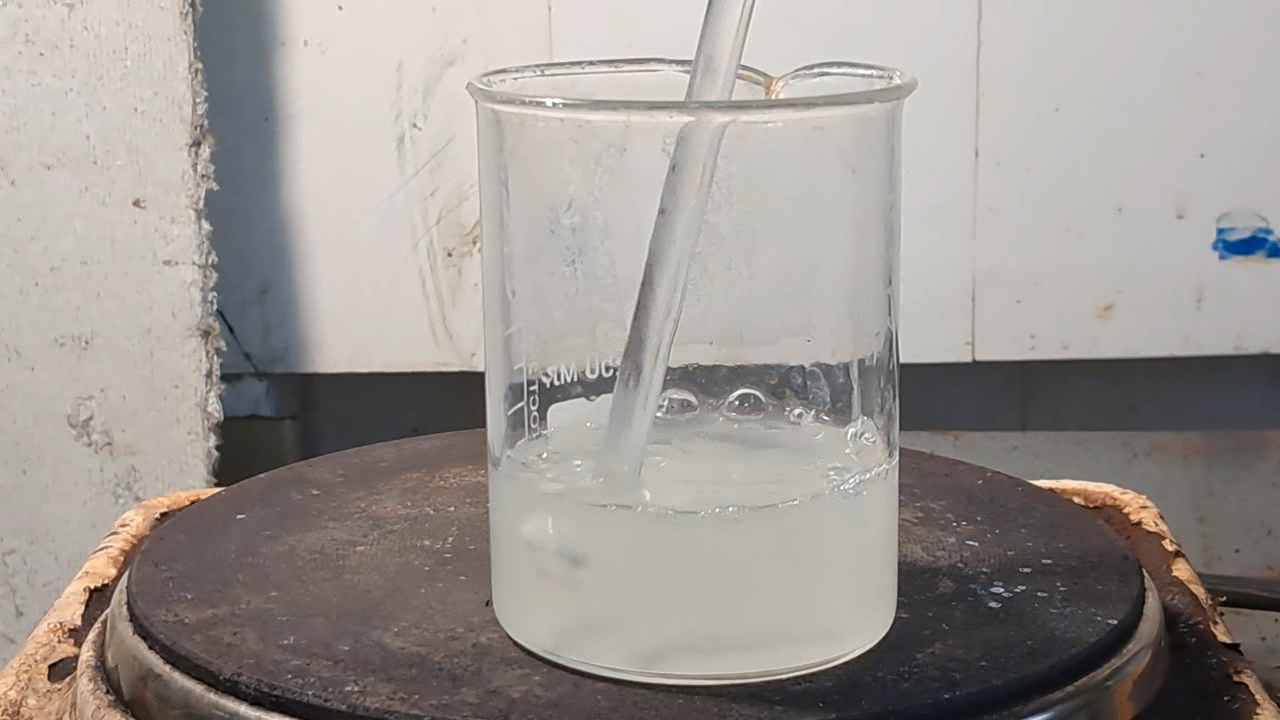

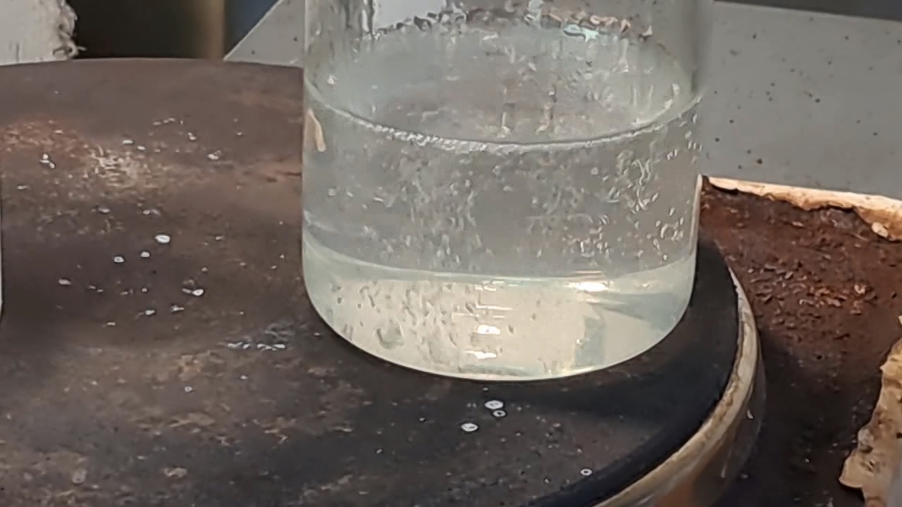

I placed the beaker on a hot plate and heated it to boiling. The turbidity increased significantly. I left the beaker overnight, and by morning a white precipitate of barium sulfate had settled at the bottom.

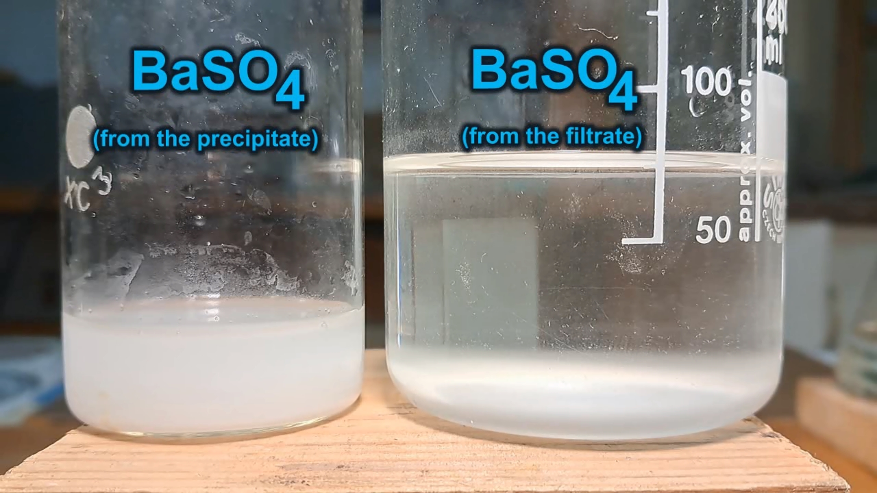

Thus, after boiling the barium sulfate with sodium carbonate, sulfate anions were detected in the solution, confirming the conversion of barium sulfate into barium carbonate.
A control experiment would also be prudent: repeat the entire procedure using the same substances and quantities, but without barium sulfate. This ensures that any observed barium sulfate precipitate is not due to sulfate impurities in the original reagents. If the reagents are pure, no barium sulfate precipitate forms at the end of the control experiment.

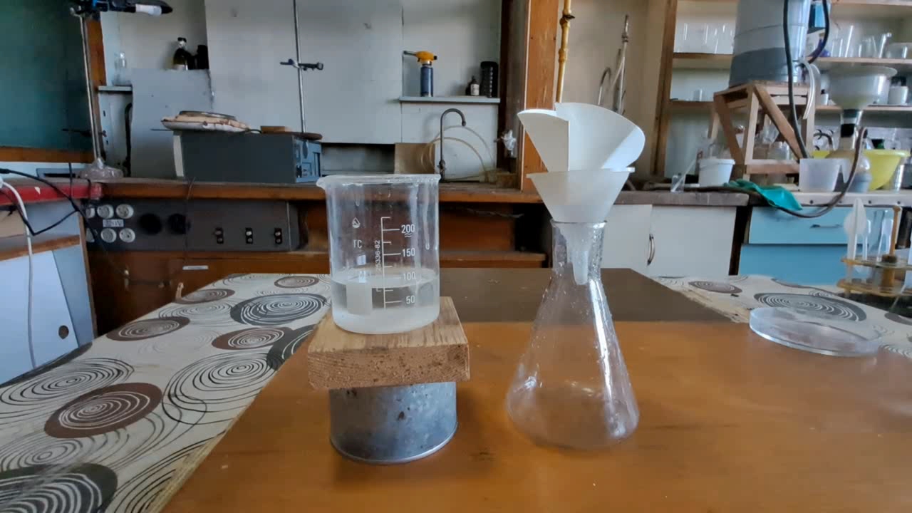

I did not intentionally perform a control experiment, but I unintentionally conducted one the following day. After re-boiling the precipitate with sodium carbonate, I filtered it again and analyzed the second filtrate using the same method as before. In this case, after adding barium nitrate solution and heating, only a very slight turbidity was observed - if any at all. It is possible that I merely imagined it because I expected to see it.
The starting reagents were therefore pure: no sulfate anions were detected in the filtrate obtained after the second boiling of the precipitate with sodium carbonate.

Взвесил 0.2 г сульфата бария технической квалификации. Добавил 10 г безводного карбоната натрия и 100 мл дистиллированной воды. Подумав, добавил еще 5 г карбоната натрия (всего 15 г). Накрыл стакан и поставил его на электрическую плитку кипятиться. Кипятил 2.5 часа, добавляя воду по мере испарения. Потом в институте отключили электричество. Оставил стакан с раствором и осадком на ночь.
Утром я планировал быстро декантировать раствор с осадка, затем добавить к осадку новую порцию - 15 г карбоната натрия, 100 мл воды и поставить раствор на плитку кипятиться. Спешил, поскольку согласно графику скоро опять должны были отключить электричество. Однако, мелкие частички осадка образовали устойчивую суспензию, поэтому раствор пришлось фильтровать сквозь бумажный фильтр, затем промывать осадок на фильтре, что заняло много времени.
После завершения фильтрования перенес осадок в стакан, добавил карбонат натрия и воду, поставил кипятиться. Успел прокипятить раствор только полчаса - электричество отключили - оставил стакан на ночь.

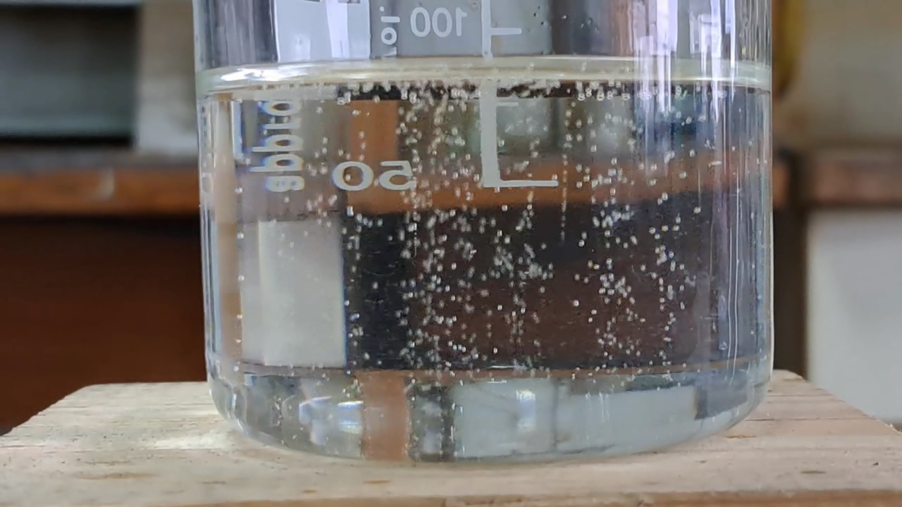

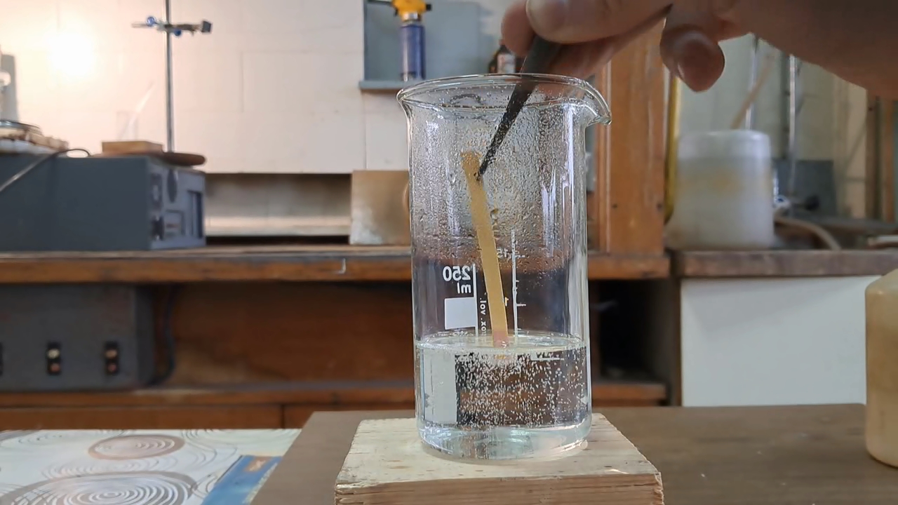

Параллельно приступил к испытанию фильтрата. Добавлял к фильтрату небольшими порциями 56% азотную кислоту до прекращения бурного выделения углекислого газа. Проверил индикаторной бумагой - среда была сильнокислой. Прилил 3 мл раствора нитрата бария (~5%). Ожидал, что раствор сразу же станет бело-мутным.
Однако, заметного помутнения не произошло. Жидкость осталась прозрачной, в ней продолжили образовываться пузырьки углекислого газа. Через несколько минут стало заметно легкое помутнение раствора. Анионы сульфата присутствовали в растворе, однако их концентрация была низкой, что замедляло образование осадка сульфата бария.
Подобное явление уже наблюдалось в эксперименте с растворами сульфата кальция и хлорида стронция. Чтобы образовался осадок, раствор необходимо было нагреть или оставить стоять на длительное время.

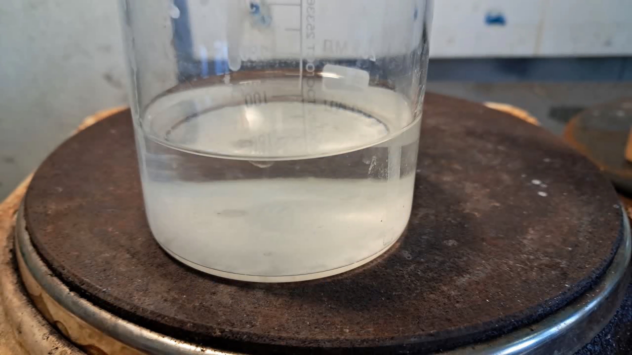

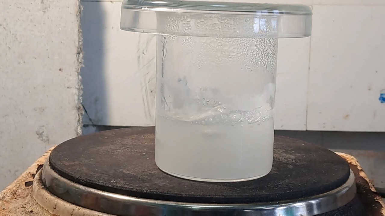

Поставил стакан на электрическую плитку, нагрел до кипения. Мутность раствора значительно усилилась. Оставил стакан на ночь. Утром на дне был белый осадок сульфата бария.
Таким образом, после кипячения раствора карбоната натрия с осадком сульфата бария, в растворе присутствовали анионы сульфата, что свидетельствует о превращении сульфата бария в карбонат бария.
Желательно было также провести контрольный эксперимент. Точно повторить описанную процедуру, используя те же вещества в тех же количествах, за исключением сульфата бария. Это было необходимо, чтобы доказать, что исходные реагенты не содержали примесь сульфата. Если реактивы чистые, в конце контрольного эксперимента не образуются осадок сульфата бария.
Целенаправленно контрольный эксперимент я не делал, однако, я провел его мимо воли на следующий день. После повторного кипячения осадка с карбонатом натрия, я отфильтровал осадок и исследовал второй фильтрат аналогично первому. В результате после добавления раствора нитрата бария и кипячения наблюдалось лишь слабое помутнение жидкости (возможно, помутнения не наблюдалось вовсе, и я увидел его потому, что ожидал увидеть).
Исходные реактивы оказались чистыми, а анион сульфата в фильтрате после повторного кипячения осадка с карбонатом натрия не обнаружен.

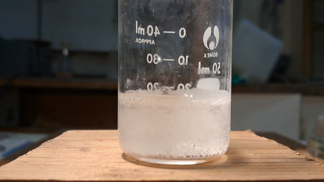

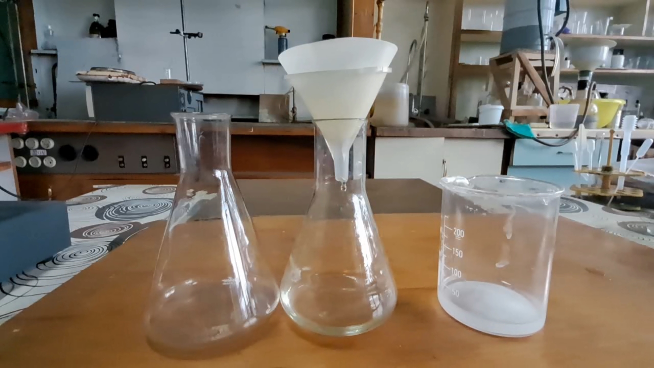

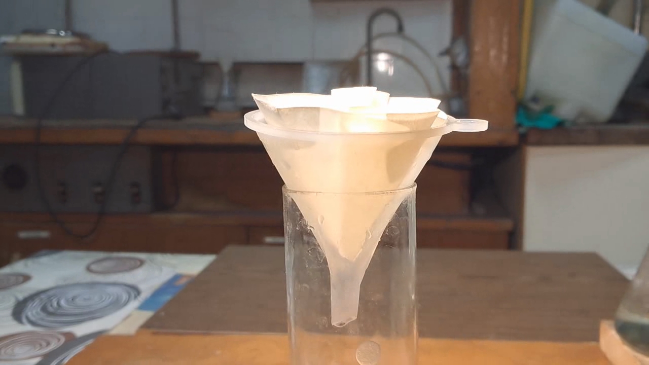

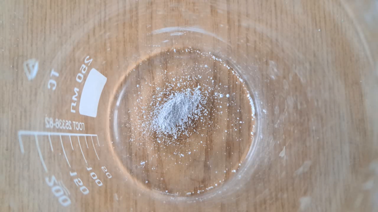

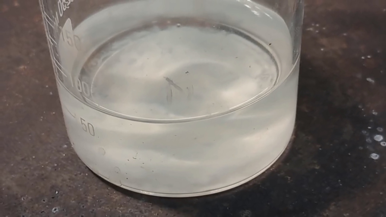

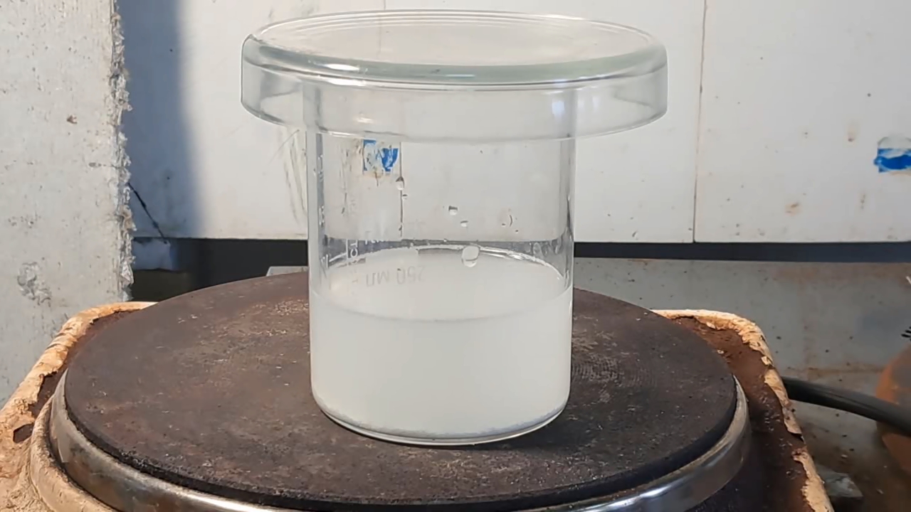

After boiling the precipitate with a fresh portion of sodium carbonate, I left the beaker overnight. In the morning, I filtered the precipitate through a paper filter and rinsed it thoroughly with distilled water. Using a wash bottle, I transferred the washed precipitate from the filter into a small beaker.

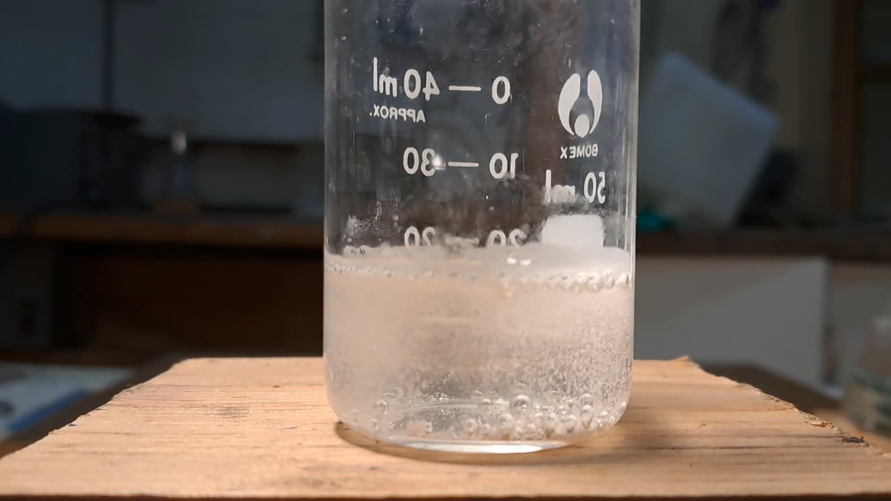

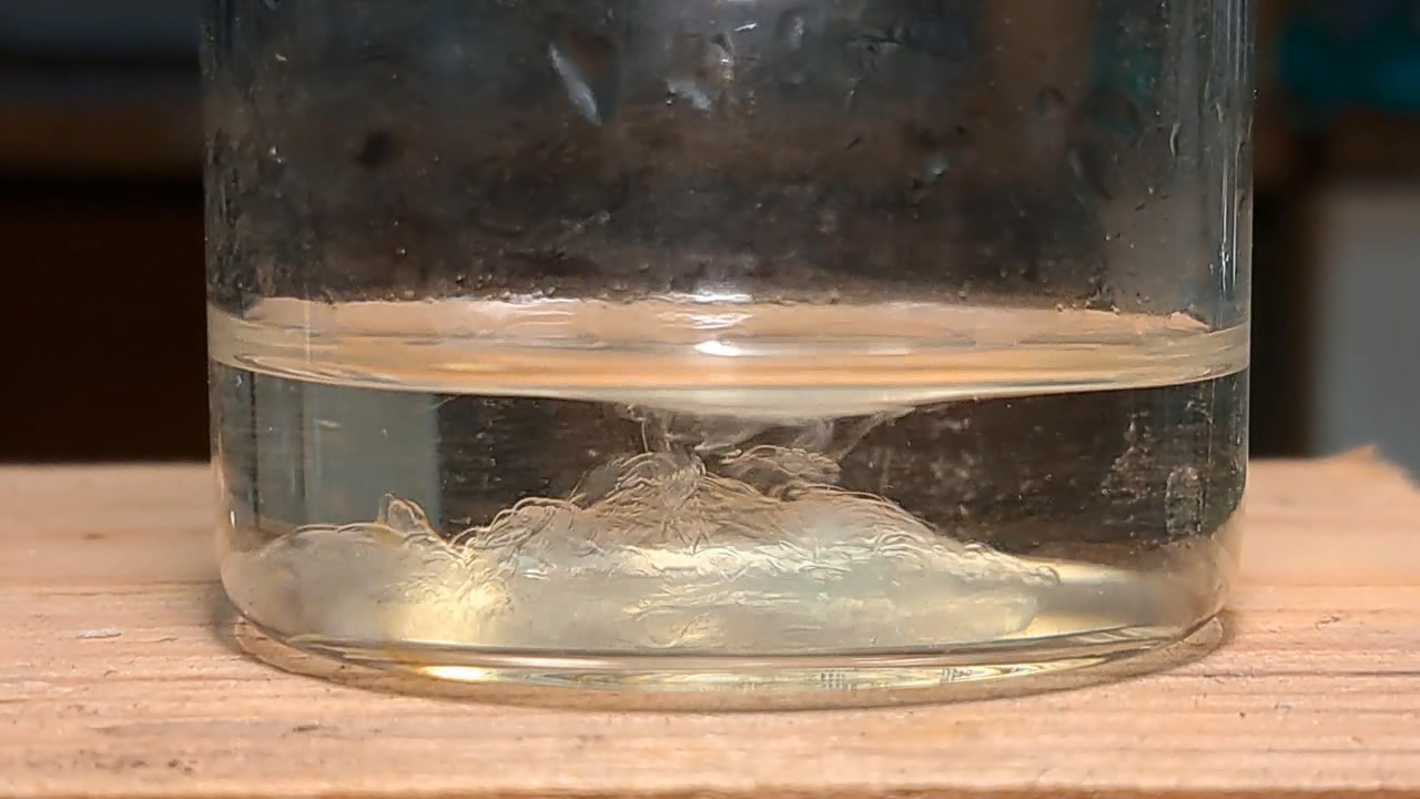

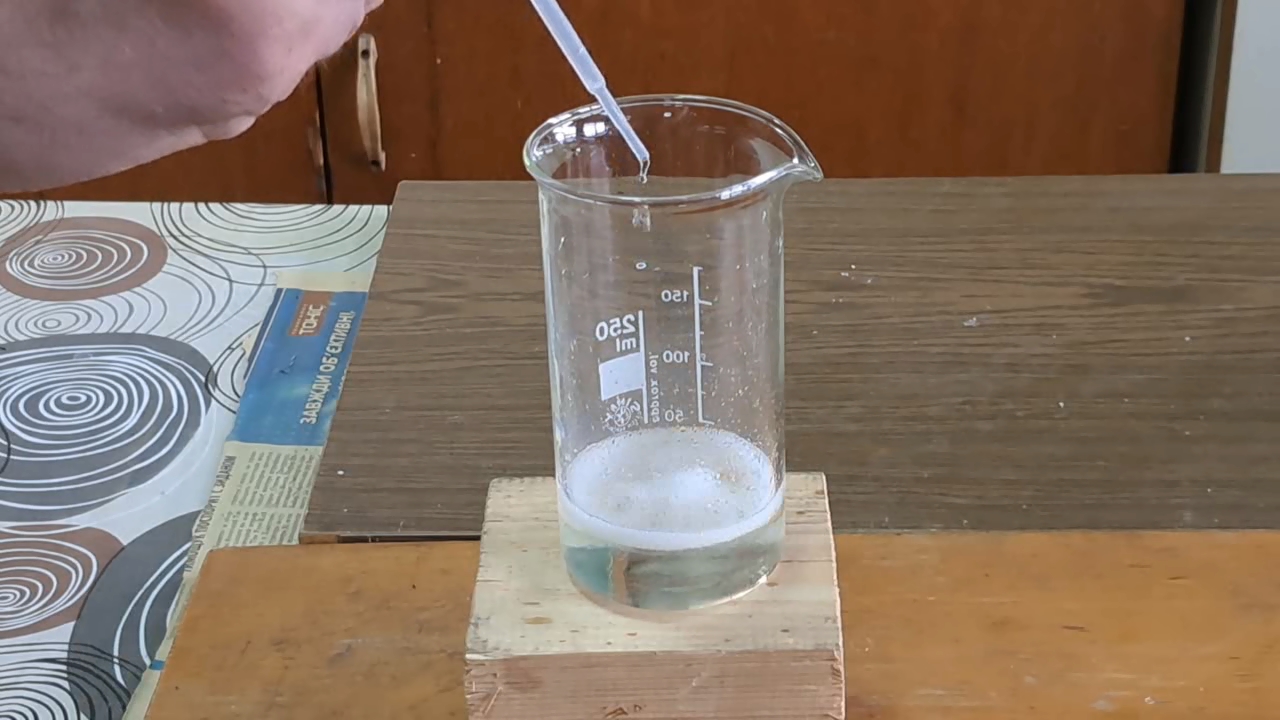

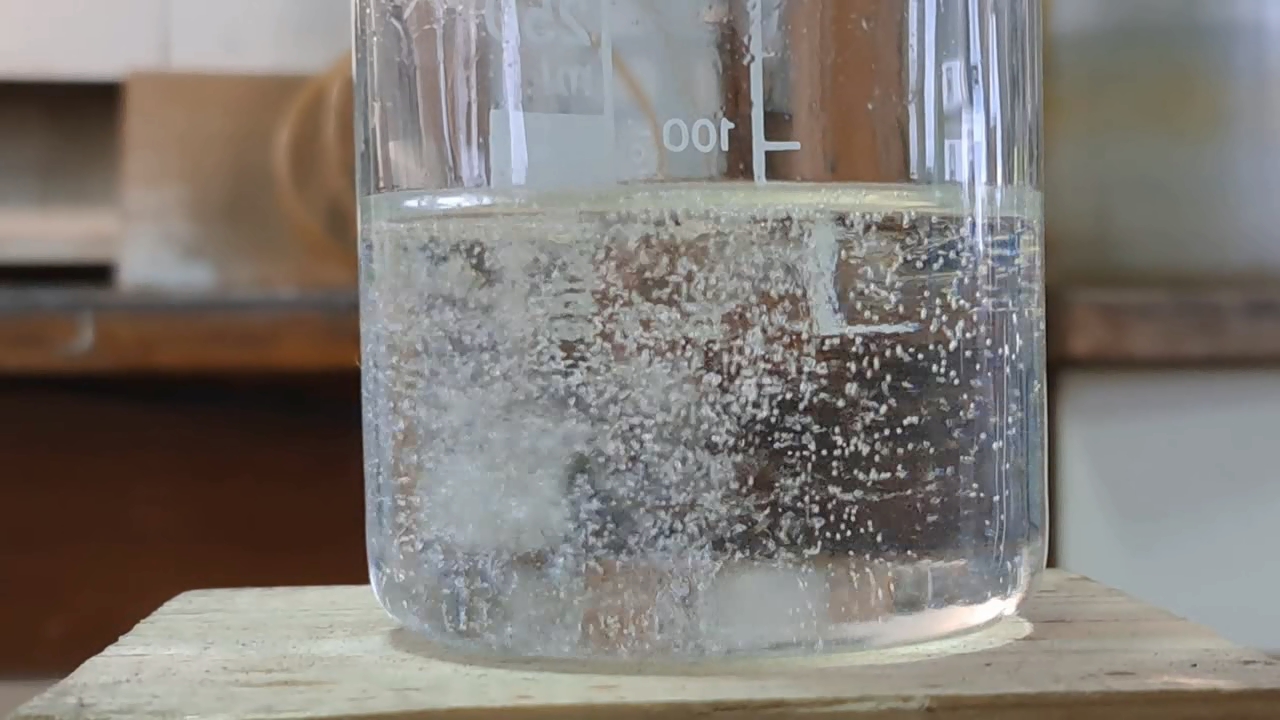

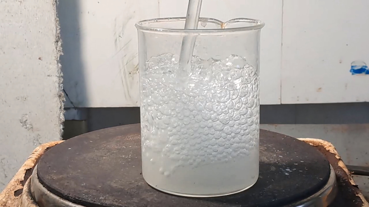

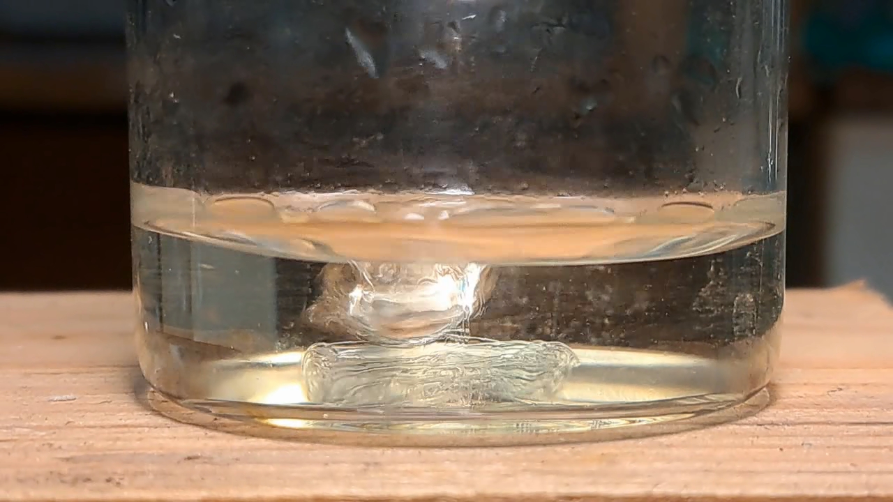

I added 56% nitric acid to the precipitate drop by drop. Carbon dioxide bubbles immediately began to evolve. Most of the solid phase dissolved, and the gas evolution gradually ceased. However, the solution remained cloudy, and white particles floated on the surface; these did not dissolve even after additional portions of nitric acid were added. This indicated that, during boiling with the sodium carbonate solution, most of the barium sulfate had been converted to barium carbonate. The barium carbonate dissolved in the nitric acid to form barium nitrate. Meanwhile, a portion of the original barium sulfate did not react with the sodium carbonate. Unlike barium carbonate, barium sulfate did not dissolve when treated with nitric acid, leading to incomplete dissolution of the solid.
Thus, the undissolved residue consisted of barium sulfate that had not participated in the reaction with sodium carbonate during boiling. The solution contained barium nitrate.

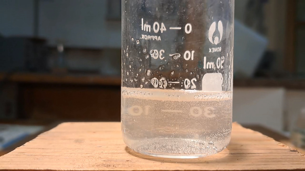

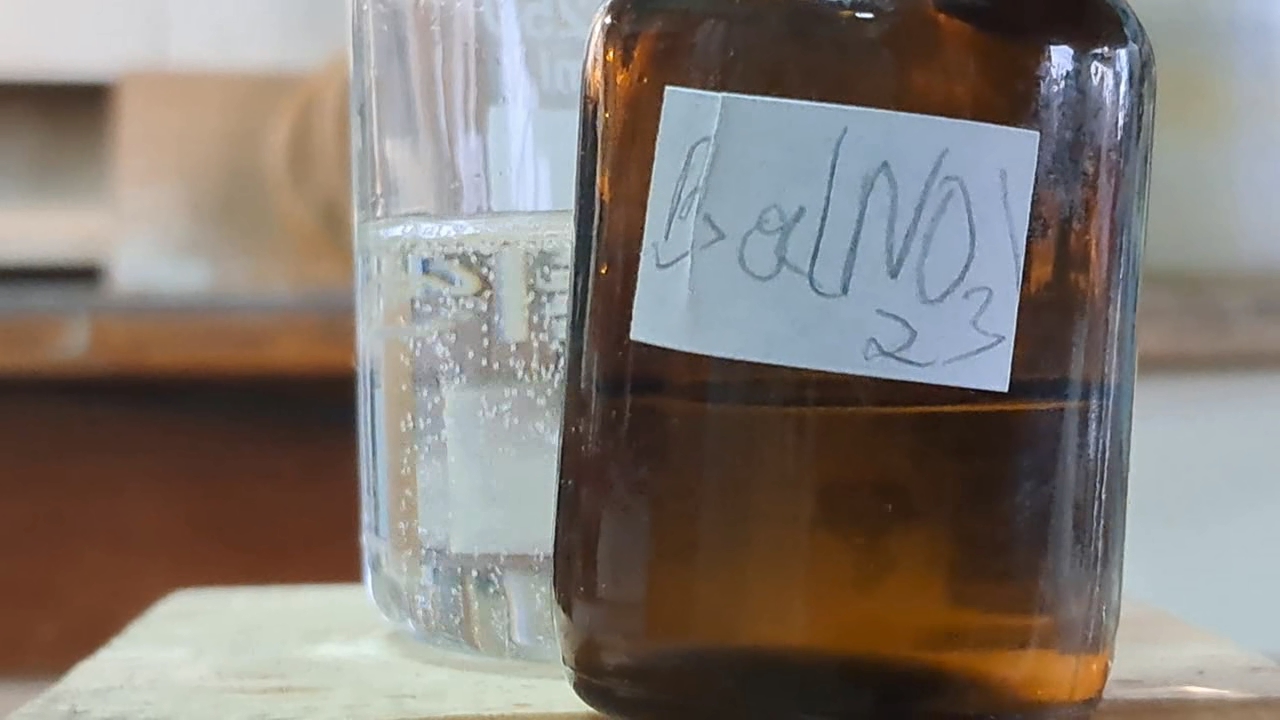

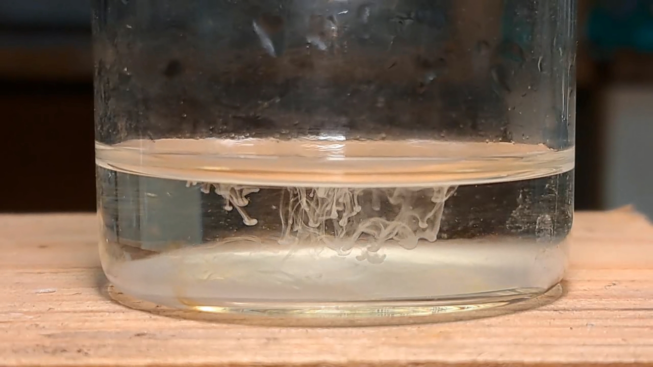

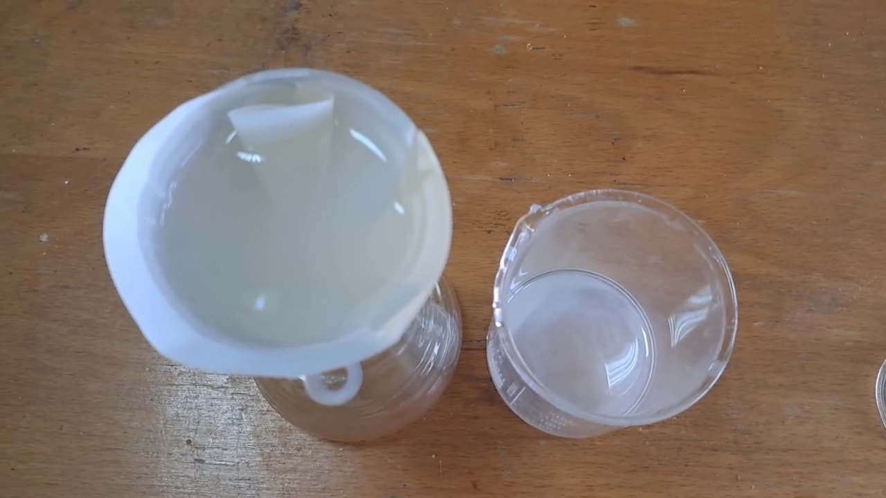

To confirm the presence of barium cations, I filtered the liquid through paper and collected the filtrate in a beaker. A 35% sulfuric acid solution (an electrolyte for lead-acid batteries) was added dropwise. The solution immediately turned white and opaque due to the formation of barium sulfate, confirming the presence of barium ions.
Therefore, when barium sulfate is boiled with an excess of sodium carbonate solution, most of it converts to barium carbonate.
The boiling was carried out without additional stirring. I believe that using a magnetic stirrer with heating would have significantly accelerated the reaction.

После кипячения осадка со свежей порцией карбоната натрия, оставил стакан на ночь. Утром отфильтровал осадок сквозь бумажный фильтр, тщательно промыл его дистиллированной водой. Промытый осадок перенес с фильтра в маленький стаканчик с помощью промывалки.
К осадку прибавил 56% азотную кислоту по капле. Сразу же началось выделение пузырьков углекислого газа. Большая часть твердой фазы растворилась. Выделение газа прекратилось. Однако, раствор остался мутным, а на поверхности жидкости плавали белые частицы, которые не растворились при добавлении новых порций азотной кислоты.
Таким образом, при кипячении с раствором карбоната натрия, большая часть сульфата бария перешла в карбонат бария. Карбонат бария растворился в азотной кислоте, образуя нитрат бария. Однако, часть сульфата бария не прореагировала с карбонатом натрия. В отличие от карбоната бария, сульфат бария не перешел в раствор при обработке осадка азотной кислотой - следовательно, растворение осадка было неполным.
Итак, не растворившийся осадок представлял собой сульфат бария, который не вступил в реакцию с карбонатом натрия при кипячении. Раствор содержал нитрат бария.
Чтобы подтвердить наличие катионов бария в растворе, профильтровал жидкость сквозь бумажный фильтр. Фильтрат собрал в стакан и добавил к нему по каплям 35% раствор серной кислоты (электролит для свинцовых аккумуляторов). Раствор сразу стал белым и непрозрачным из-за образования сульфата бария - наличие бария в растворе доказано.
Таким образом, при кипячении сульфата бария с избытком раствора карбоната натрия, большая часть сульфата бария превратилась в карбонат.
