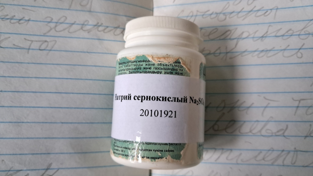

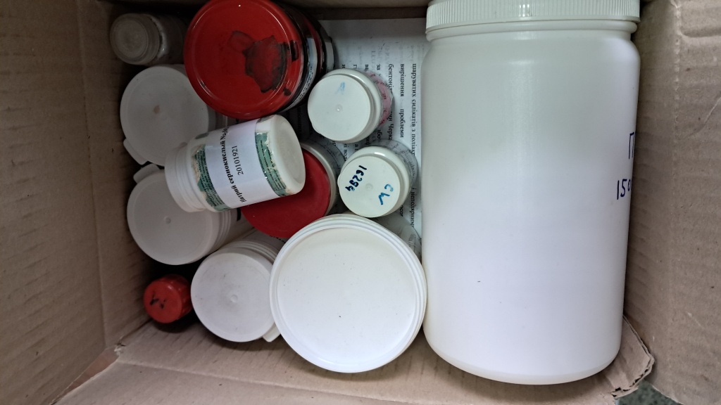

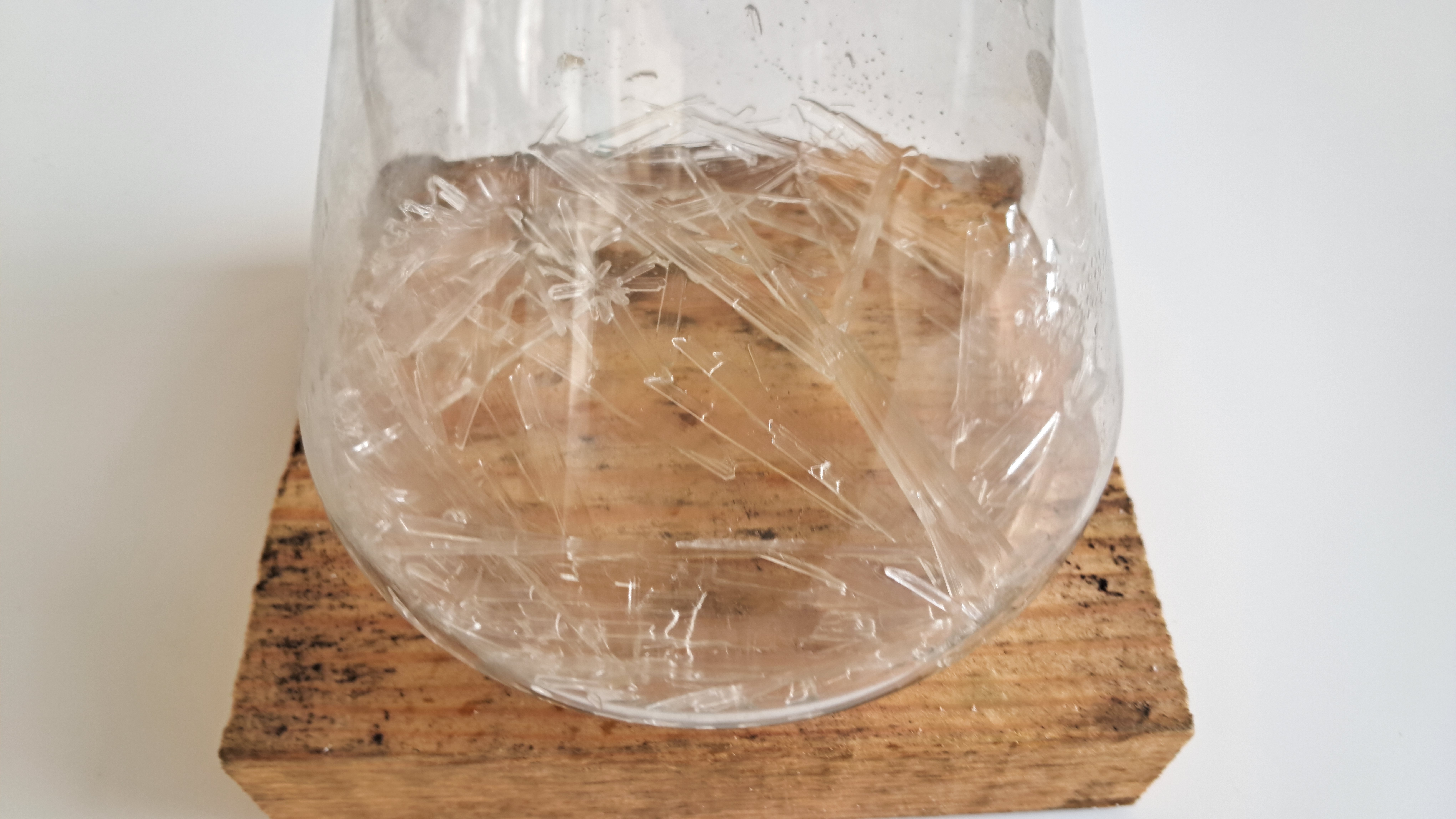

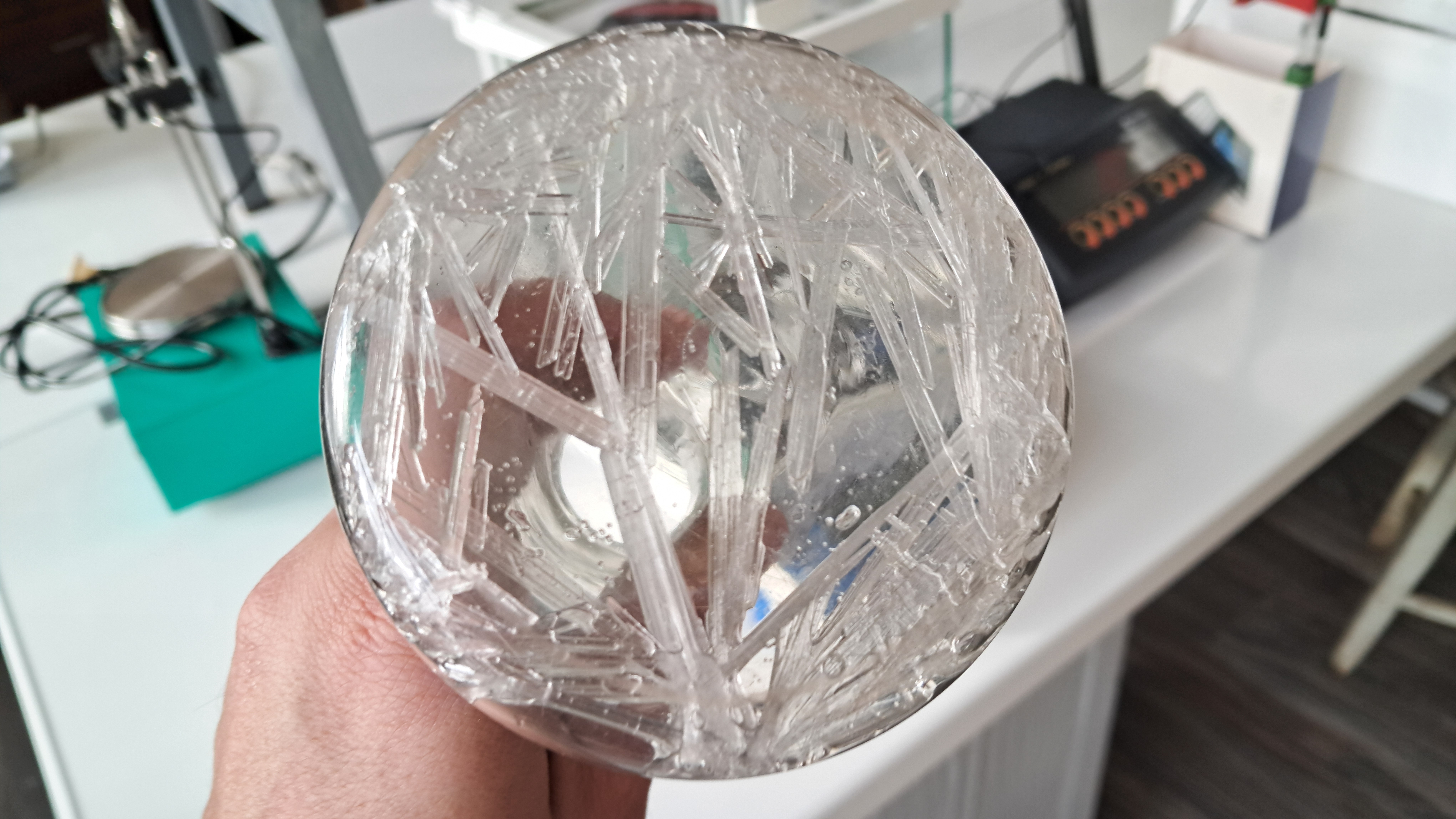

I arrived at the lab even though the power in the area was about to go out. I wanted to start the experiment quickly so I could boil the mixture for as long as possible. My first problem was finding the reagents. I found the calcium carbonate quickly, and then began looking for sodium sulfate. It is cheap and commonly available, but I did not have any on hand. I reviewed all the reagent lists in the lab but did not see sodium sulfate. Perhaps we did not have it? I wanted to ask a colleague, but he had not come to work because the power was expected to be shut down.
I carefully checked the lists again and found sodium sulfate on the last page. I opened the box where it was supposed to be stored and began removing bottles one by one, reading the labels. I found several rare and expensive substances, but still no sodium sulfate. Then I found ammonium sulfate, but it was unsuitable for this experiment because it partially hydrolyzes, forming sulfuric acid, which reacts with carbonates. With similar success, one could simply react calcium carbonate with sulfuric acid.
The sodium sulfate was in the last jar I pulled from the box. Since the search had taken longer than expected, I now had to work against the clock.

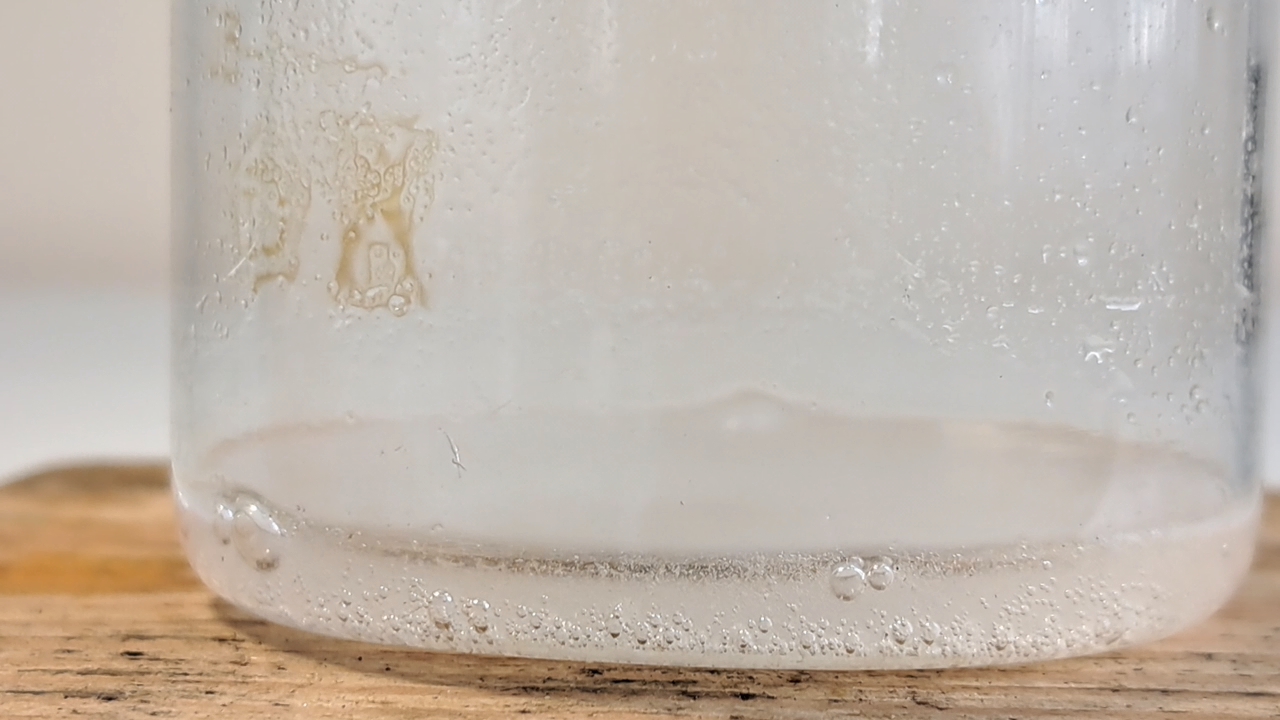

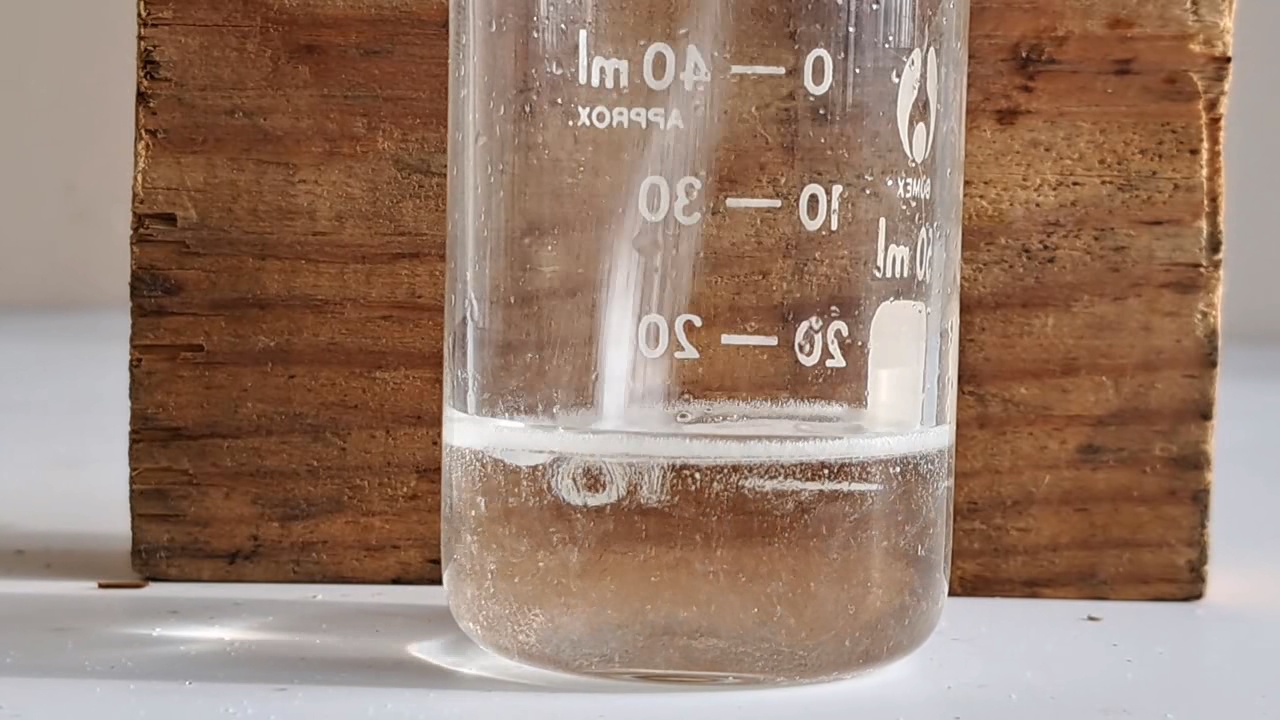

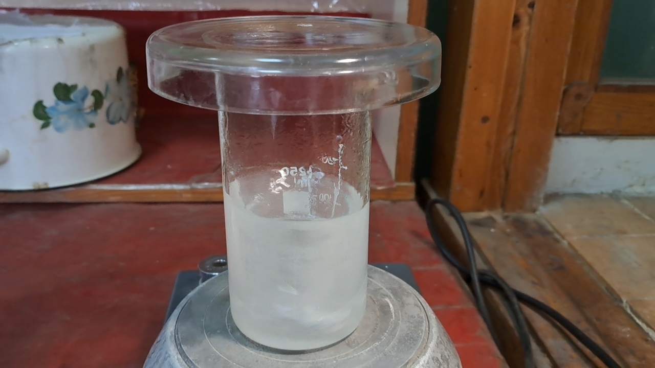

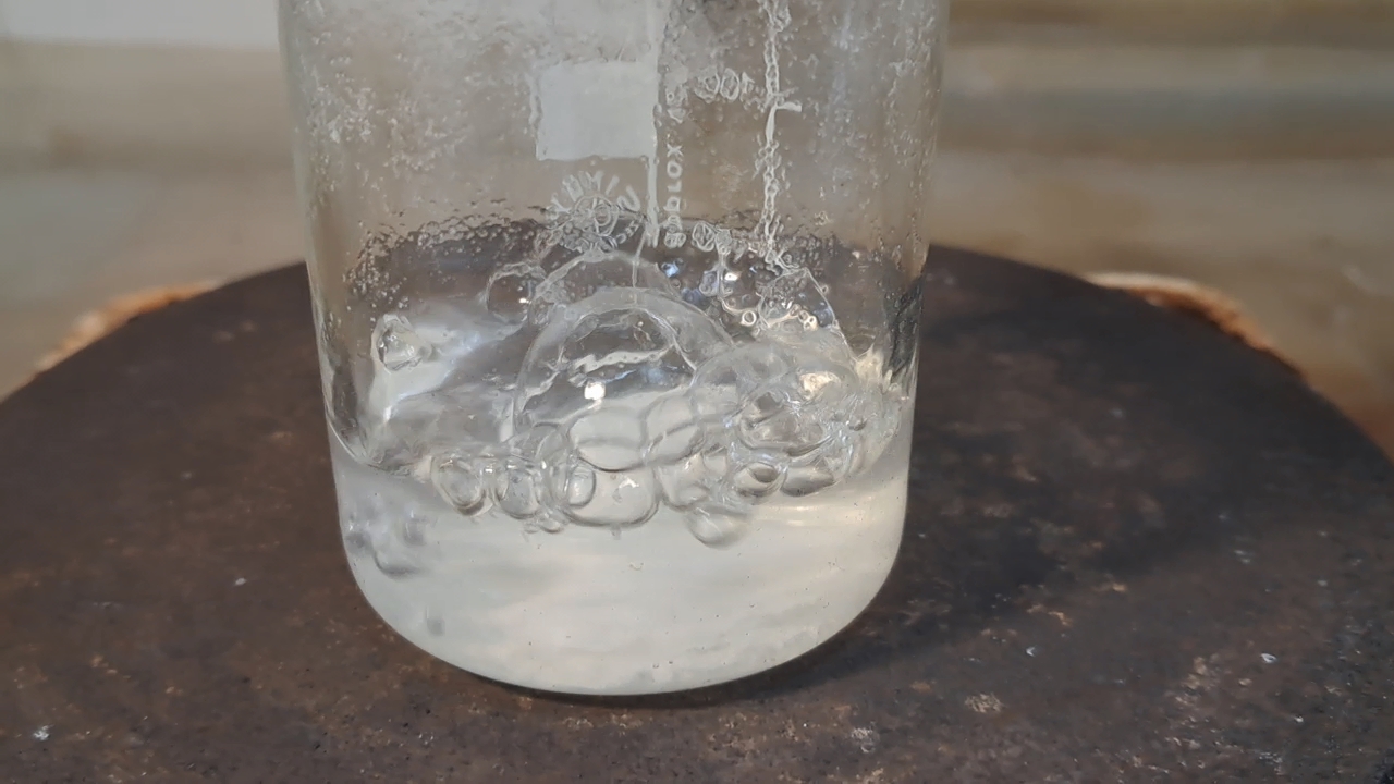

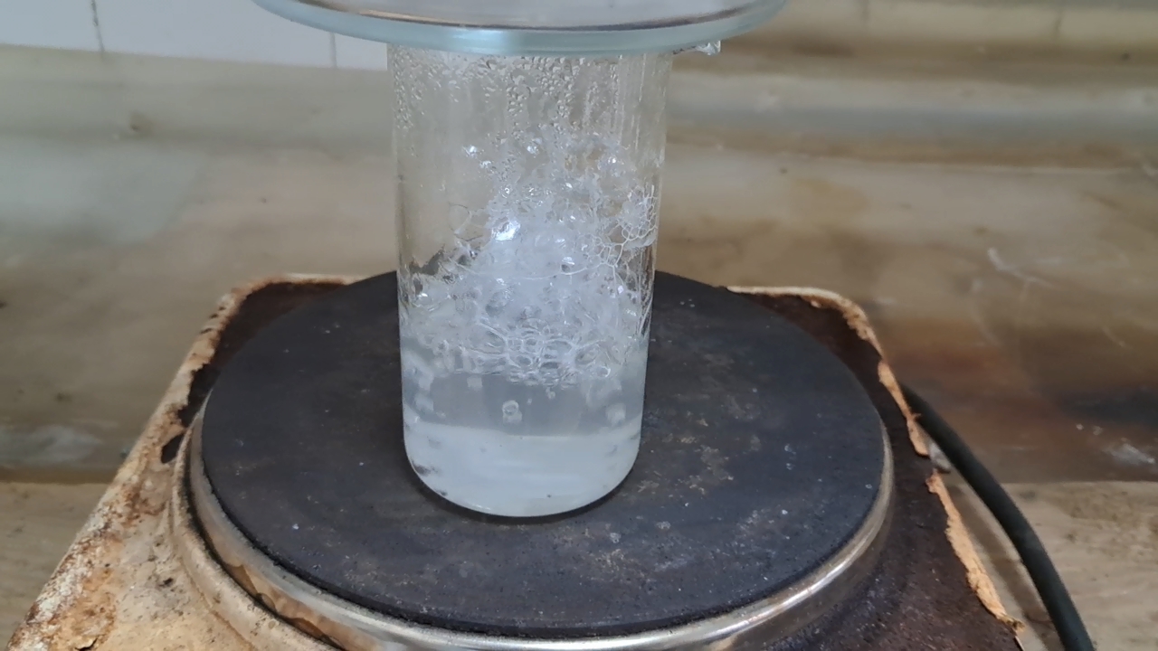

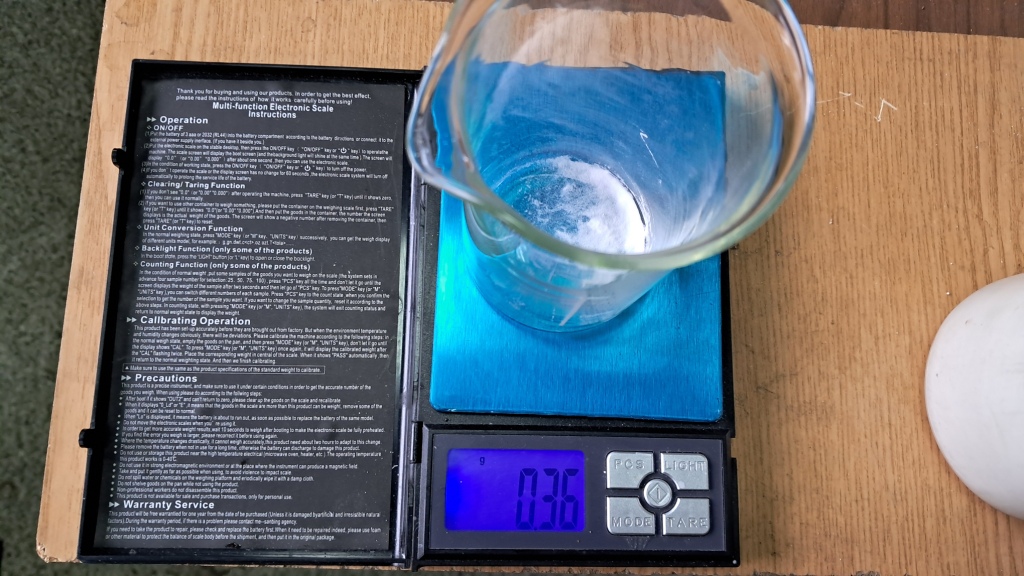

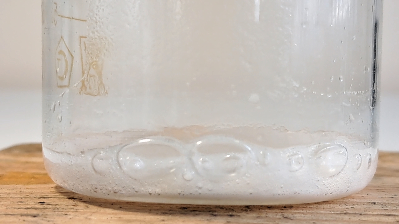

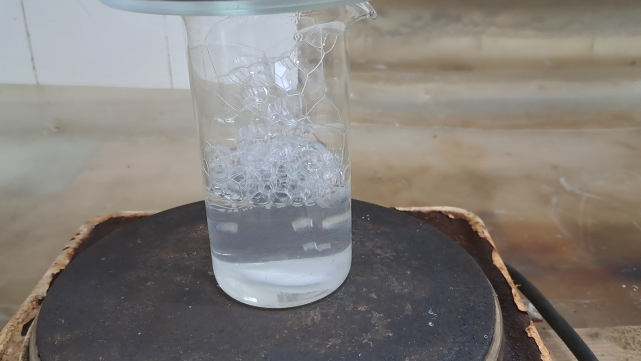

I weighed 0.36 g of calcium carbonate into a beaker, added 10 g of anhydrous sodium sulfate and 100 ml of water. I placed the beaker on a hot plate and covered it with a Petri dish. Then I became distracted with other work. A little later, I returned to the hot plate - the solution was boiling, the calcium carbonate had gathered mostly at the bottom, and the Petri dish… had disappeared. Had it fallen from the beaker because of vigorous boiling? I searched for the dish - it was nowhere to be seen. Then I noticed it on the floor about a meter and a half away from the beaker; to my surprise, the glass dish had not broken.

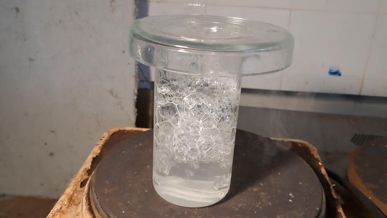

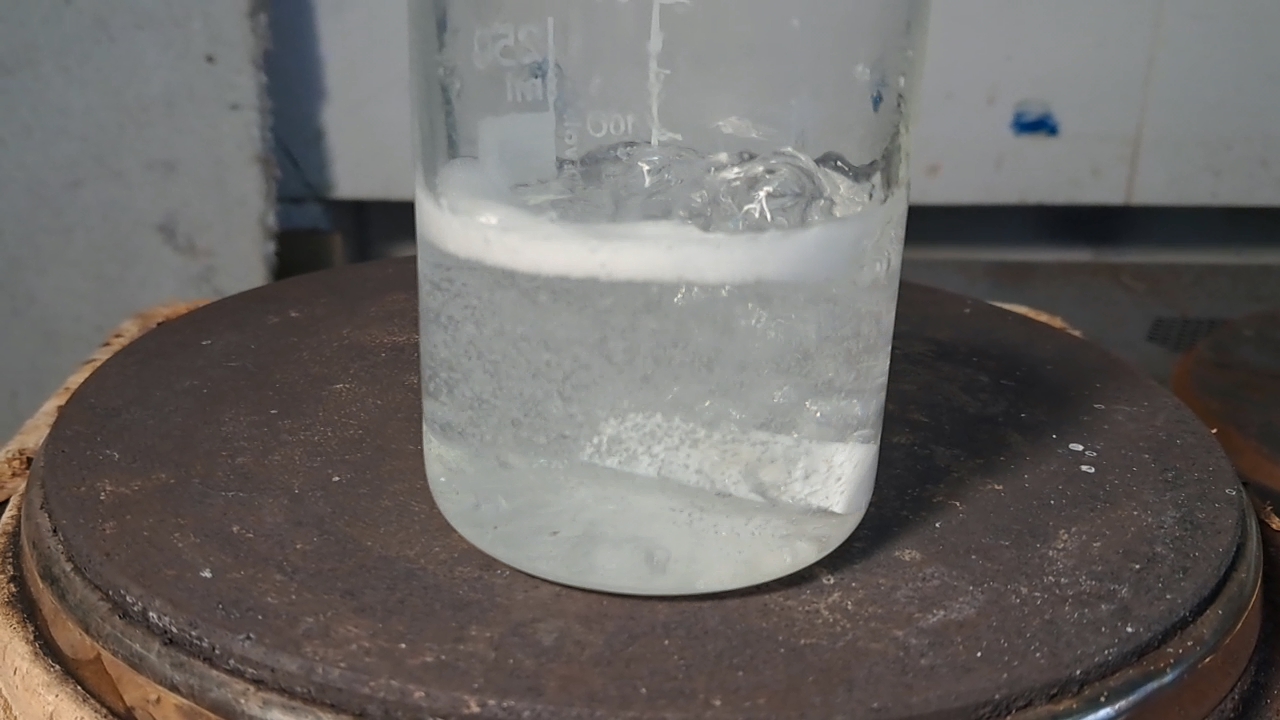

I covered the beaker with another, heavier Petri dish. The liquid boiled and foamed vigorously. To improve mixing, I placed a magnetic stir bar into the beaker and periodically moved the beaker from the hot plate to the magnetic stirrer. As the liquid evaporated, I added more distilled water. I managed to boil the mixture for an hour and then left it to stand overnight.

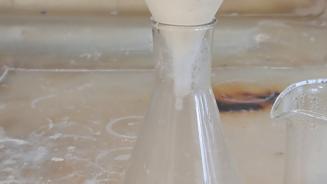

**What was my plan next?** If calcium carbonate partially converts to calcium sulfate in the solid phase, then a small portion of the sodium sulfate in the solution converts to sodium carbonate. The solid phase should then be filtered, and the filtrate collected in a separate beaker. Afterward, the solid should be rinsed thoroughly on the filter and transferred to a small beaker.
Then the filtrate should be analyzed. First, measure its pH; if sodium carbonate is present, the solution will be slightly alkaline. Next, add nitric acid to the filtrate. If sodium carbonate is present, carbon dioxide will be released.
Next, analyze the solid phase. Add an excess of nitric acid dropwise. Carbon dioxide will be released, and the calcium carbonate will dissolve. If some of the calcium carbonate converted to sulfate, a white suspension will appear, since calcium sulfate does not dissolve in nitric acid. If the solid dissolves completely, no calcium sulfate is present.

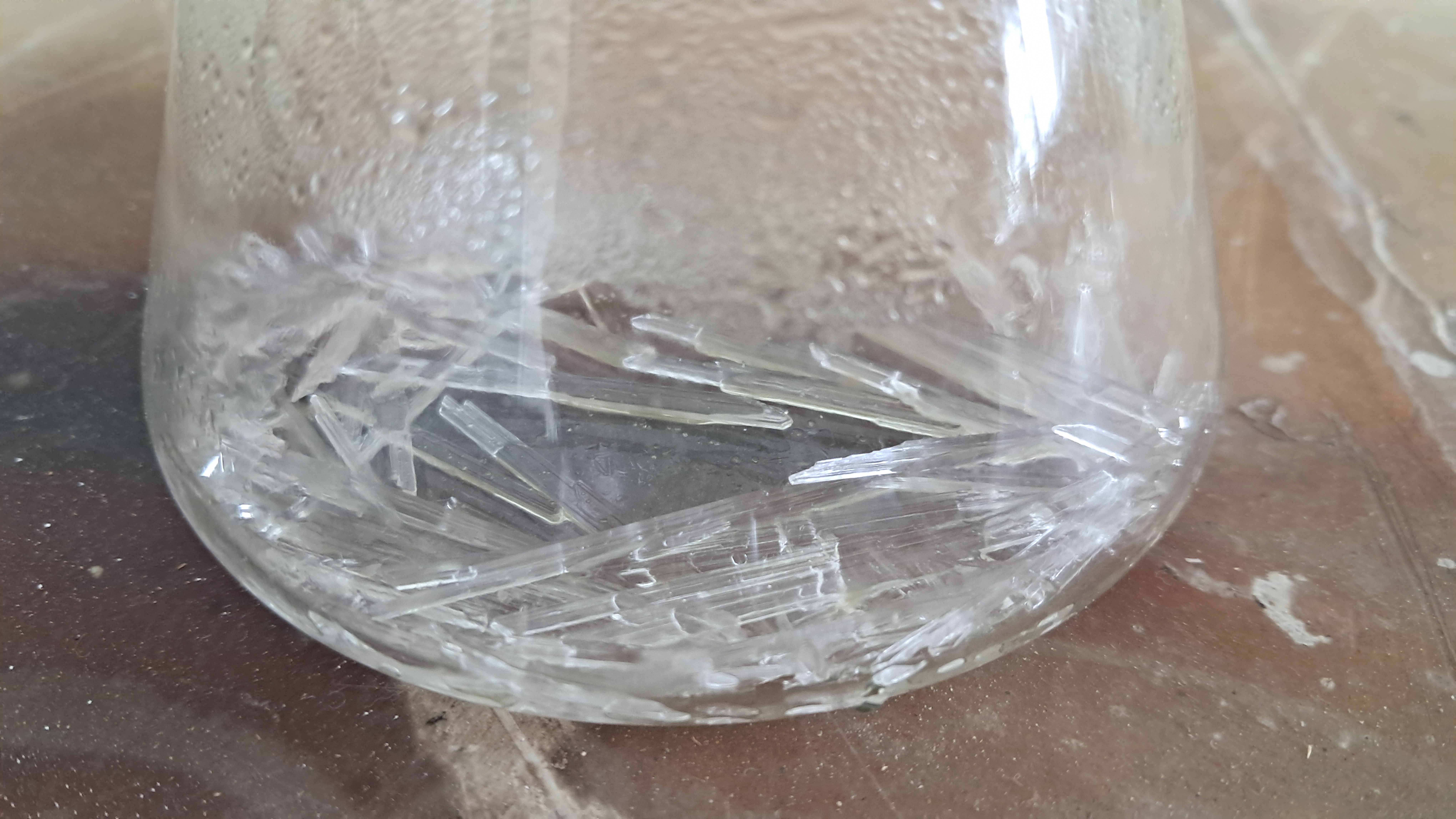

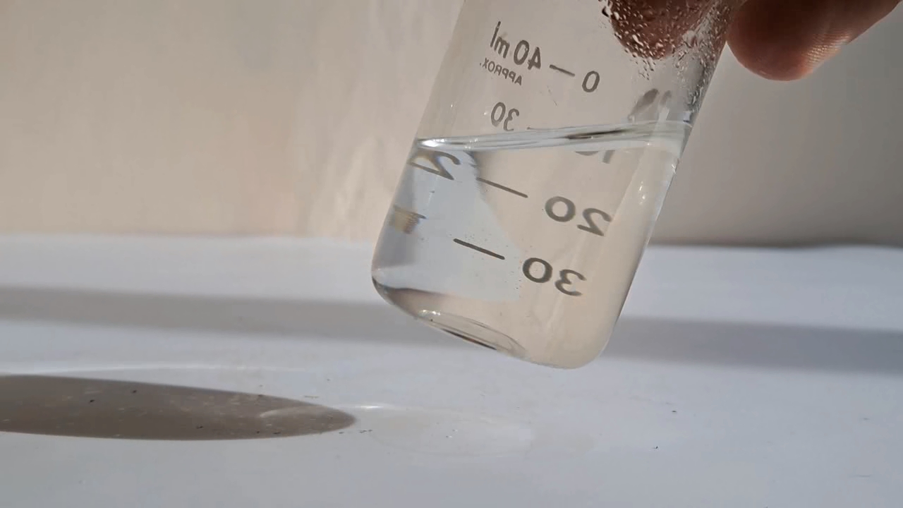

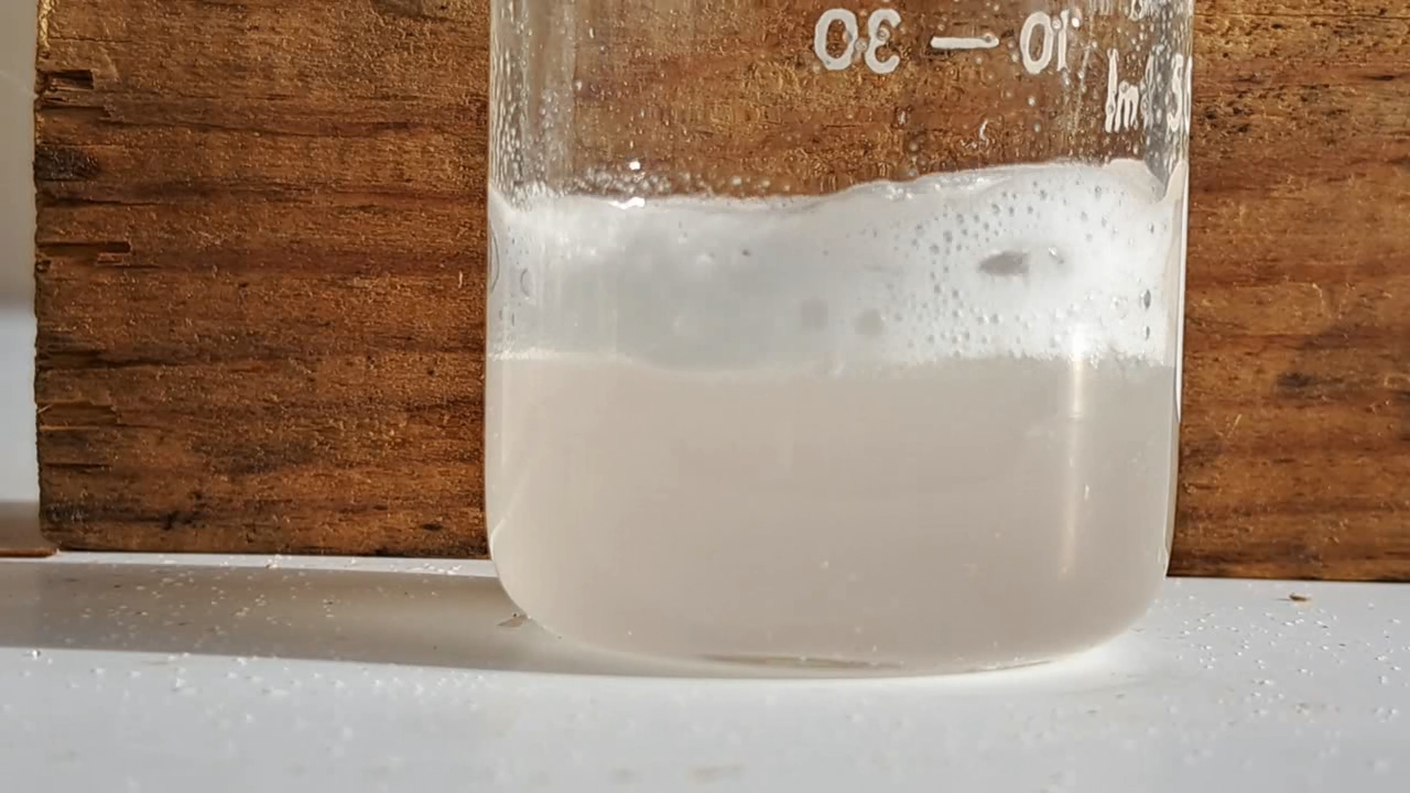

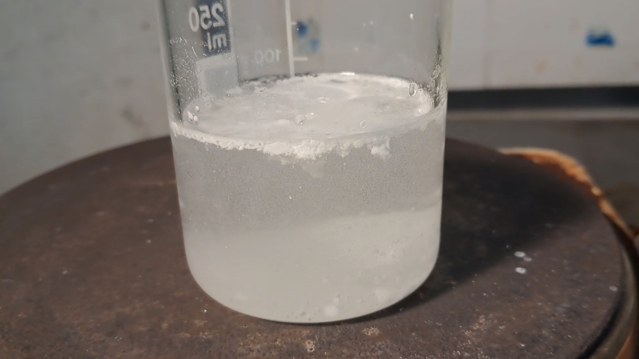

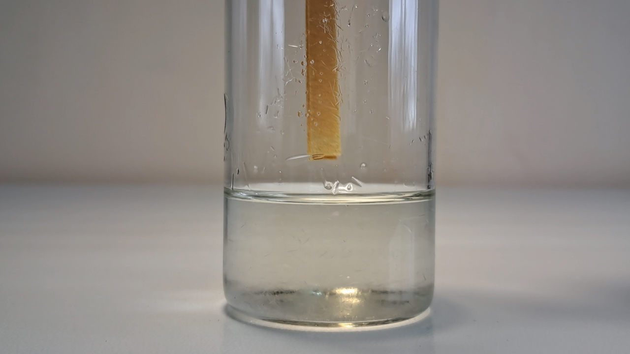

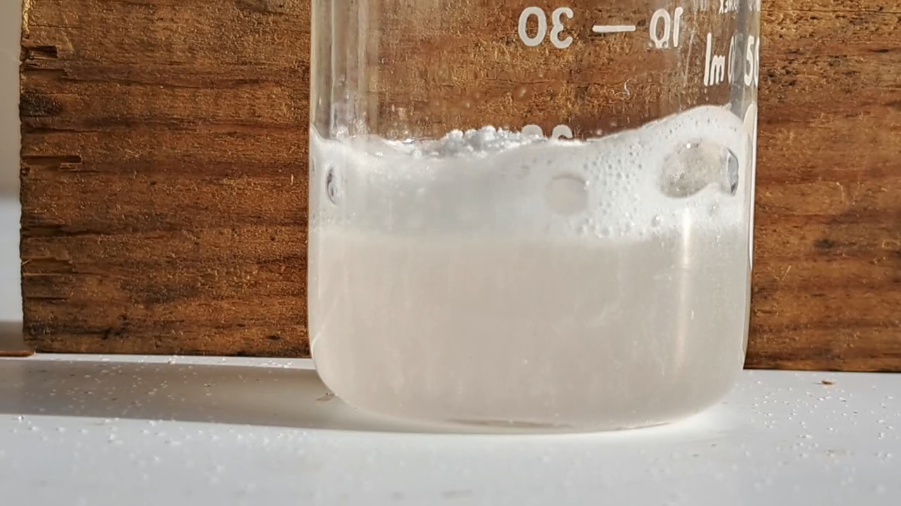

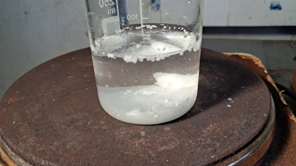

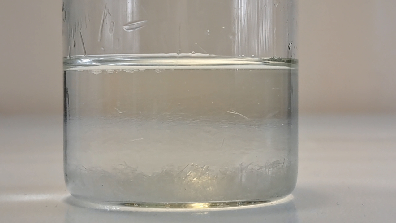

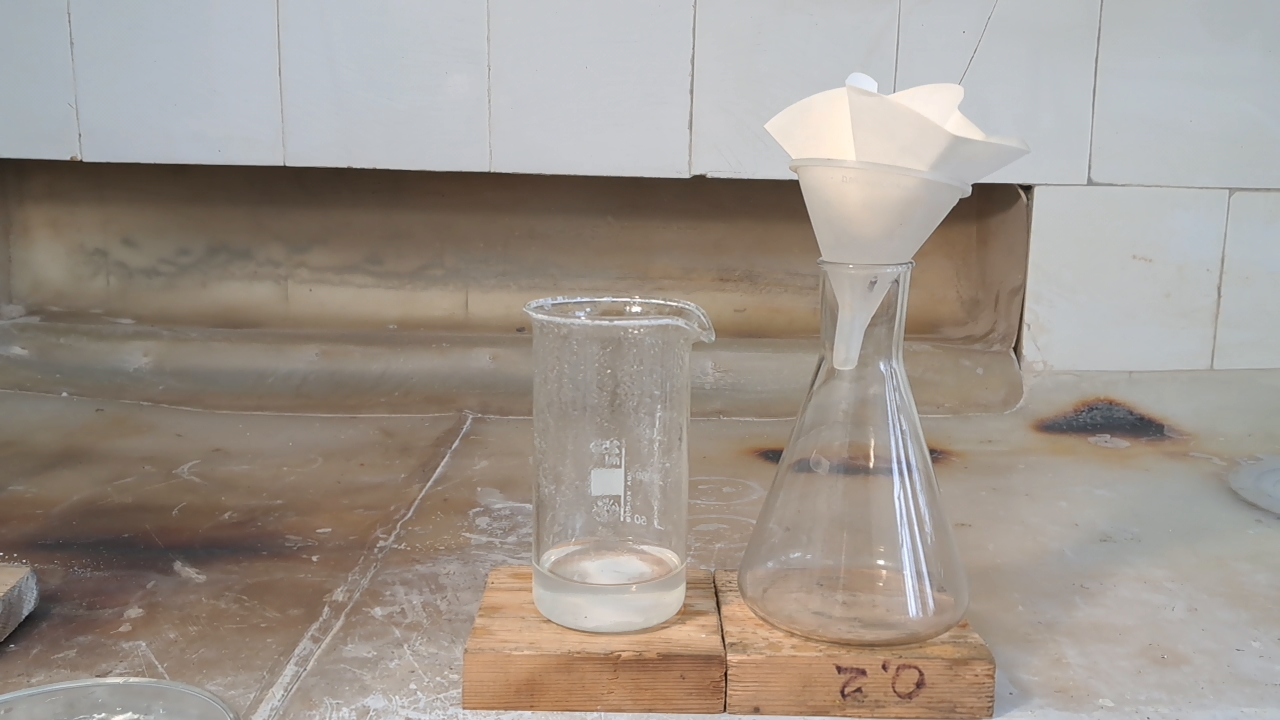

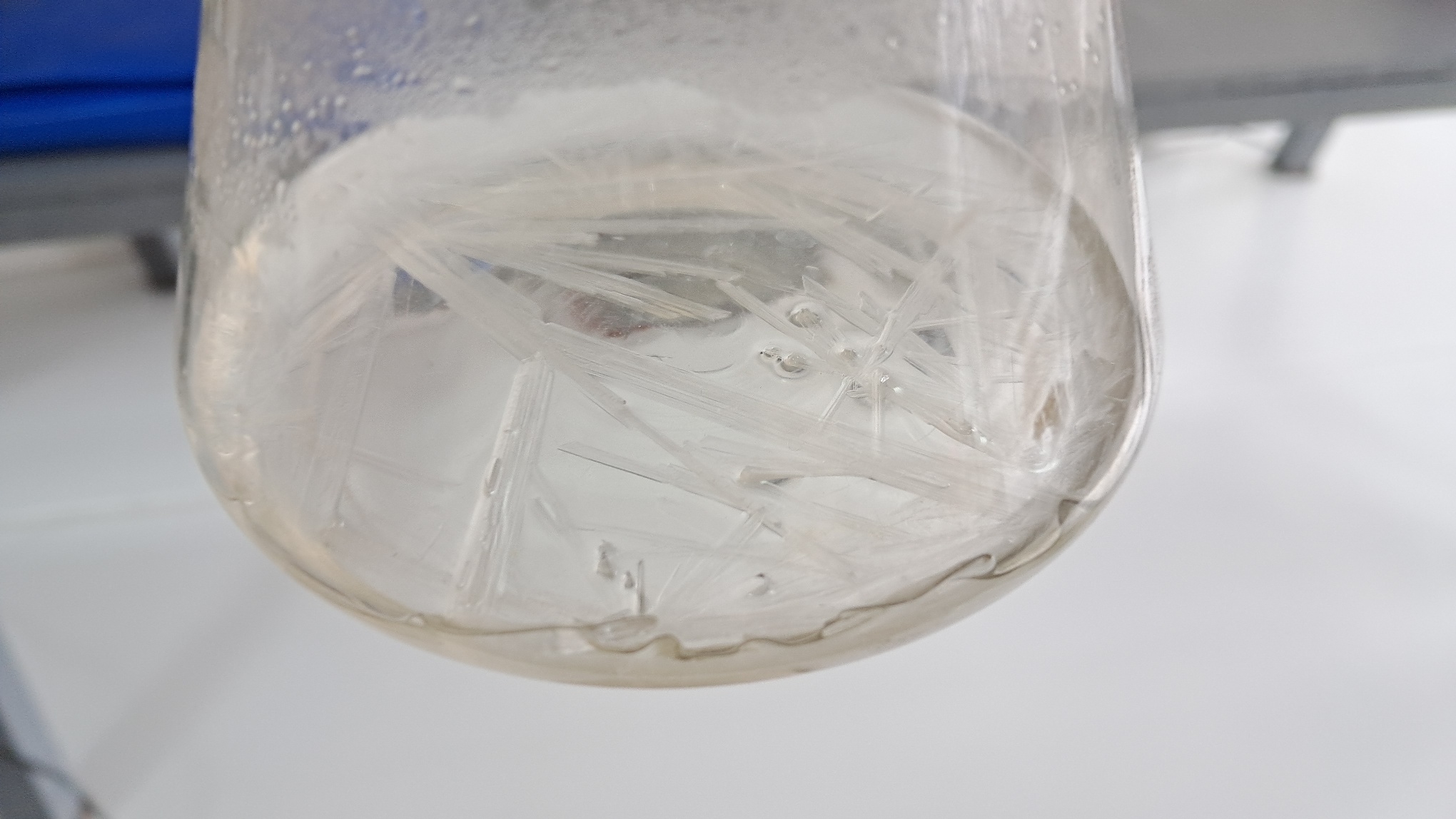

The next day, I gradually heated the contents of the beaker to boiling, boiled it for about an hour, and then filtered the solution without letting it cool. A pleasant surprise occurred: large, rod-shaped crystals of sodium sulfate formed in the flask containing the filtrate. Some of them were as long as the diameter of the flask (8 cm).

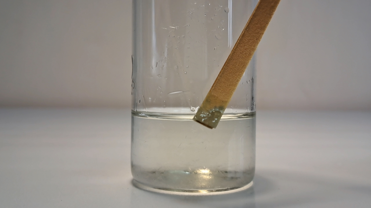

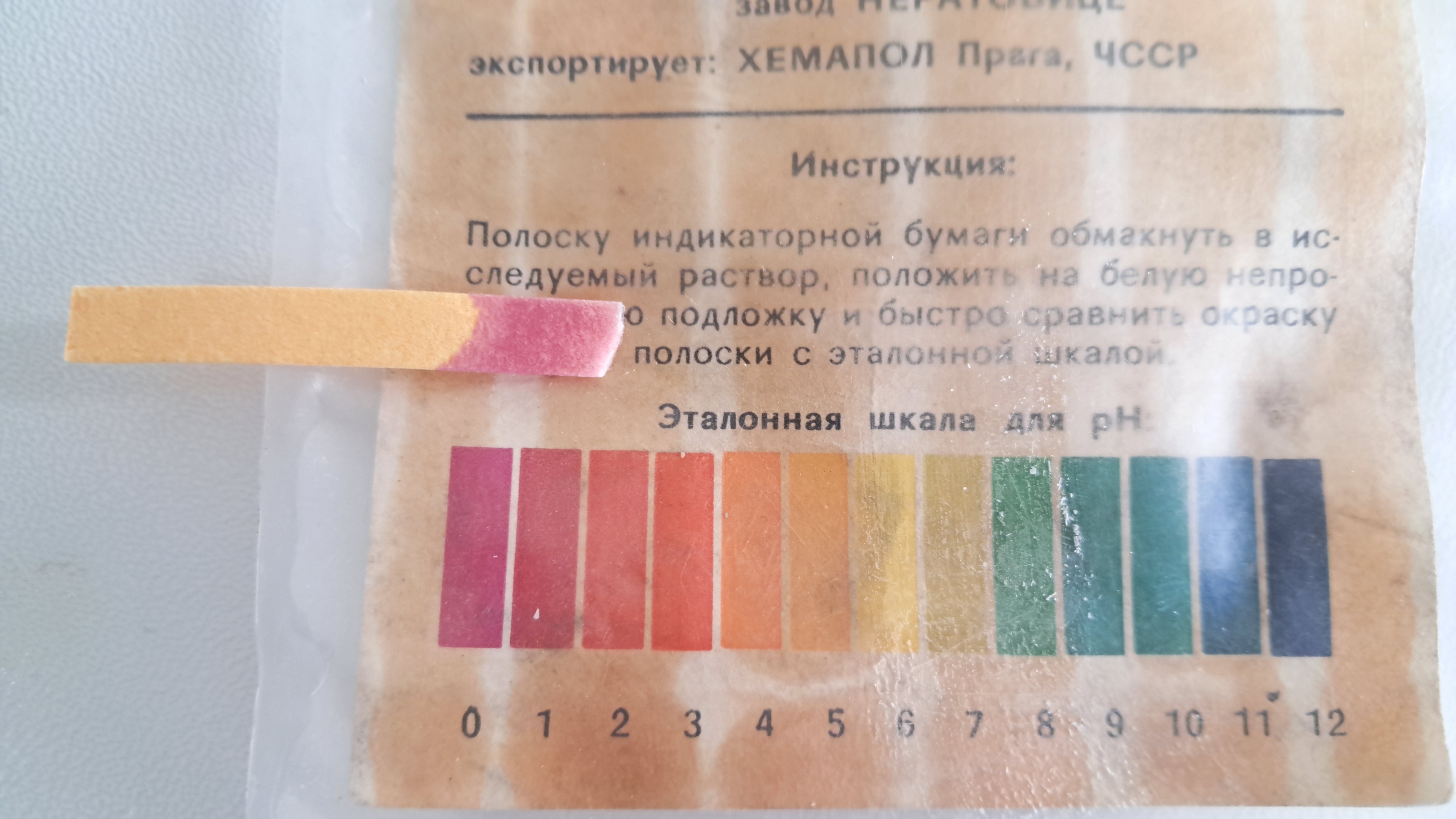

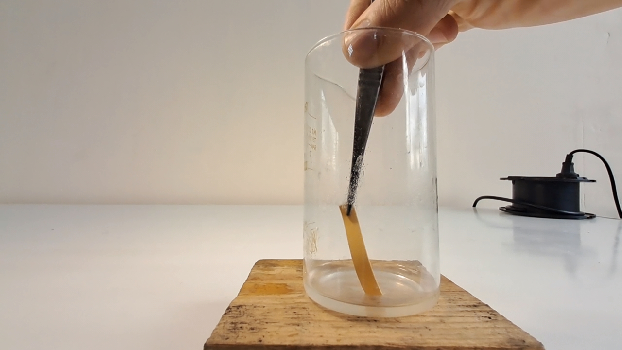

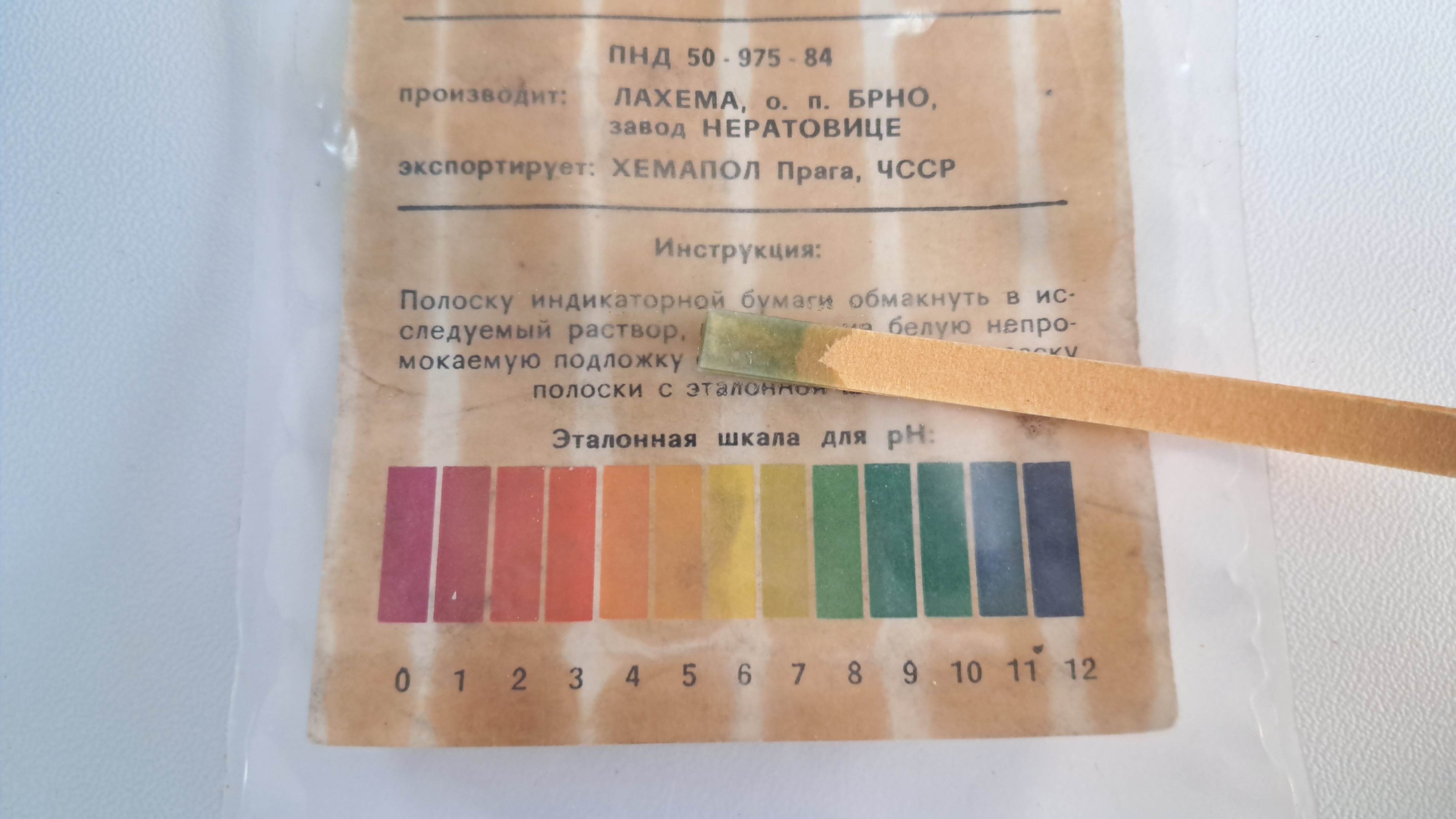

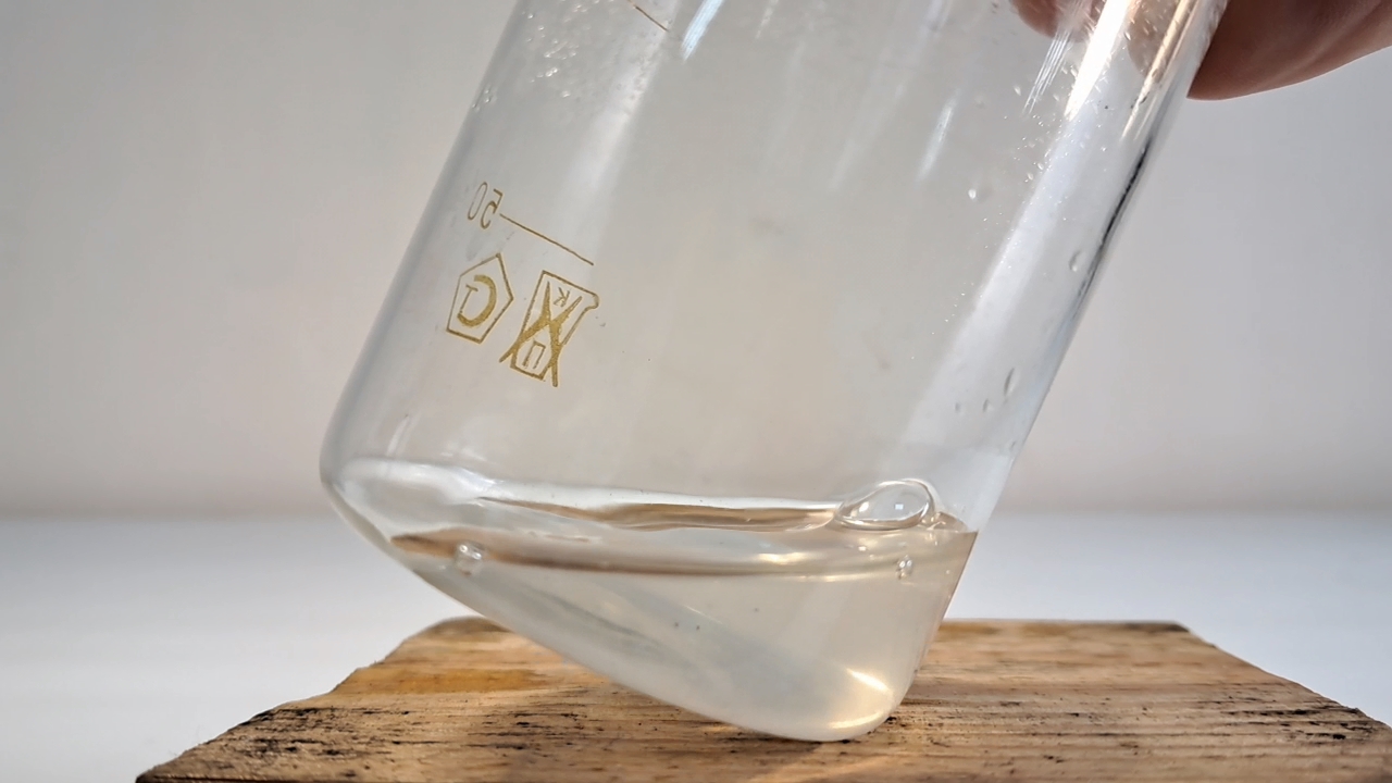

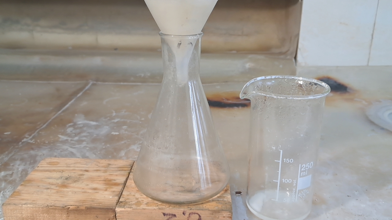

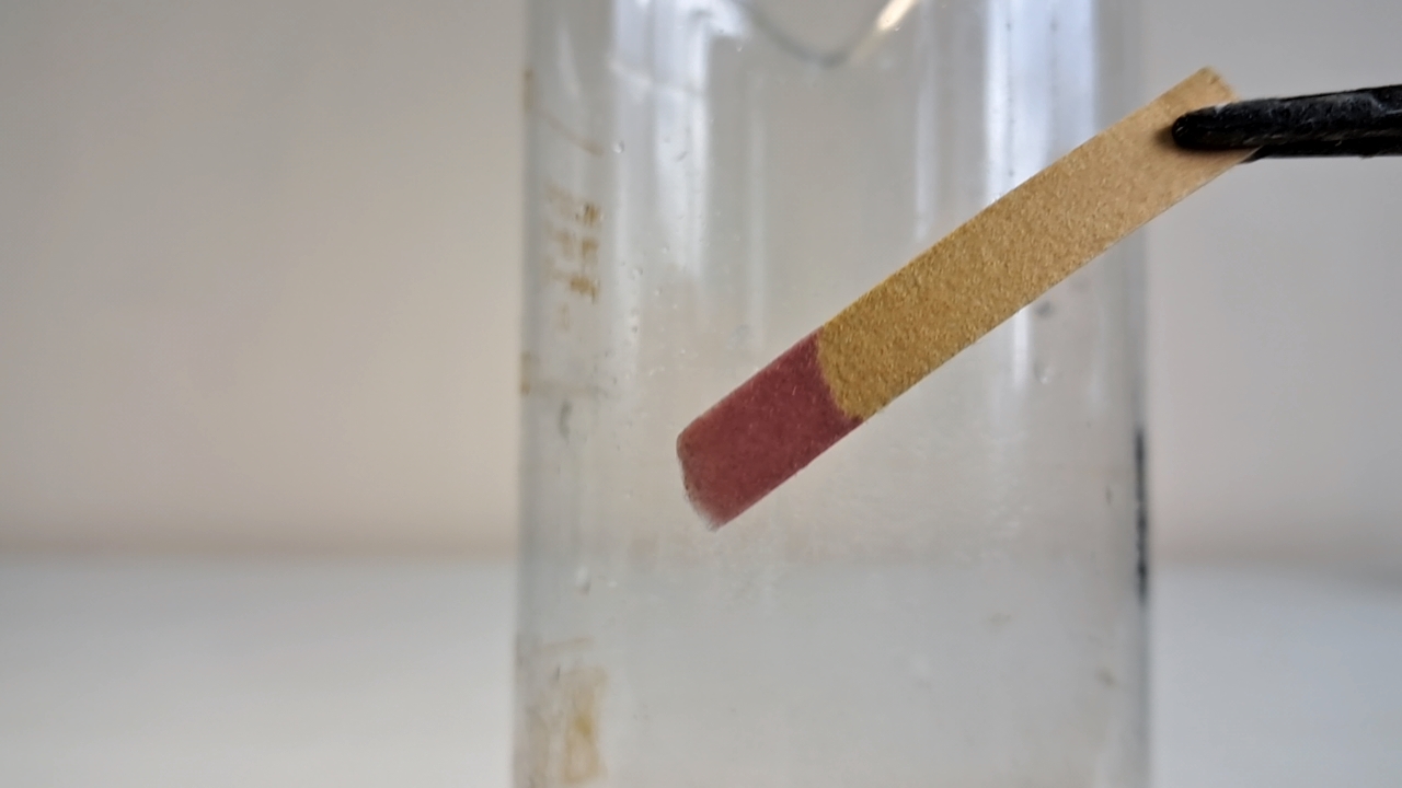

I decanted the solution from the crystals and measured its pH with indicator paper. The solution was slightly alkaline, with a pH of about 8. This indirectly confirmed the presence of sodium carbonate in the solution. Meanwhile, sodium sulfate crystals continued to form.

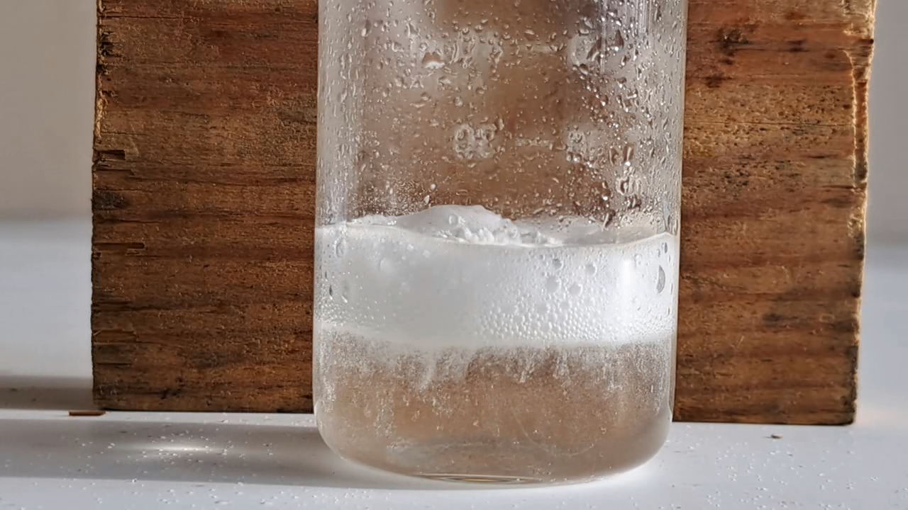

I added 56% nitric acid to the solution. No carbon dioxide evolution was observed. Carbonate ions were not detected. This result contradicts the possibility of a reaction between calcium carbonate and sodium sulfate during boiling. However, if the carbonate concentration is very low, carbon dioxide evolution may not be noticeable.

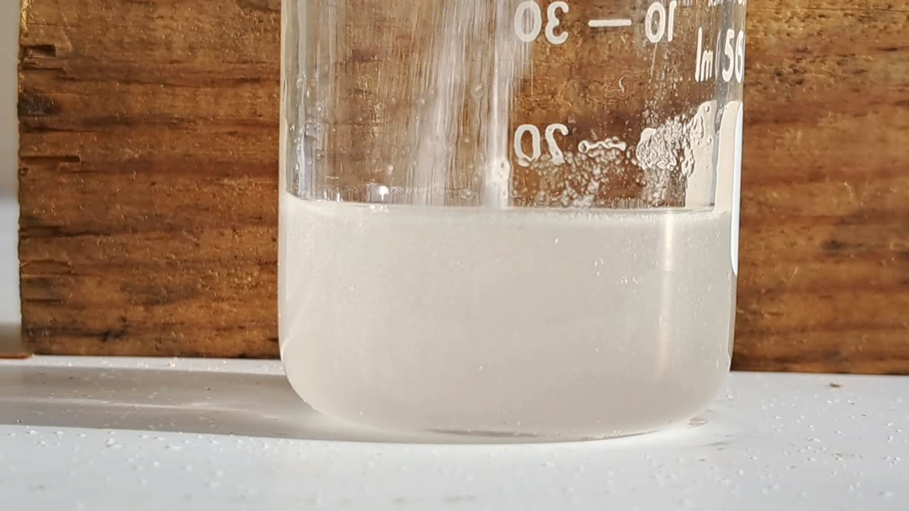

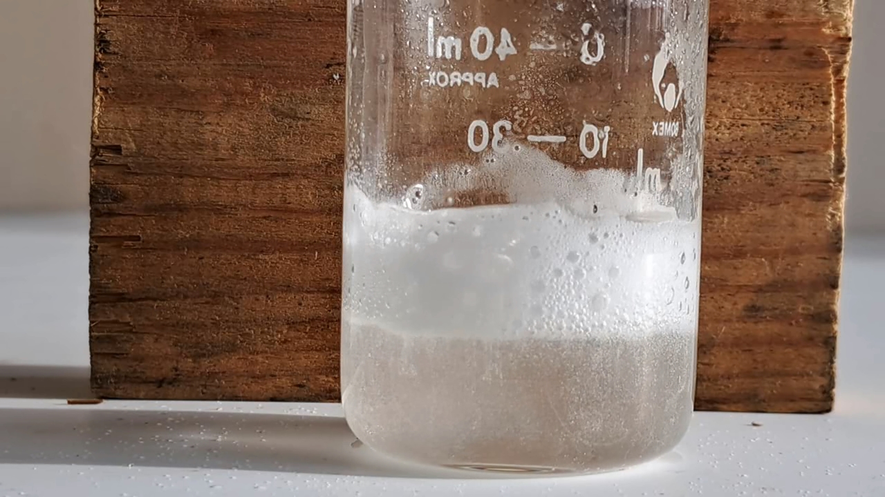

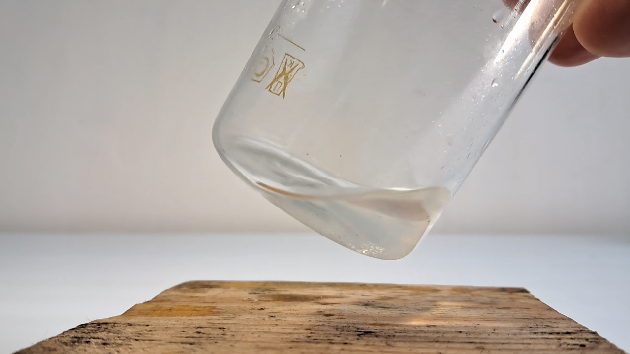

I then examined the precipitate. I added 56% nitric acid dropwise to the solid transferred to the beaker. Carbon dioxide was released, and the calcium carbonate dissolved. However, despite the excess nitric acid, some of the solid remained suspended. These particles did not dissolve even when the pH reached 0. **Conclusion:** the undissolved residue was calcium sulfate.
Thus, when boiling calcium carbonate with an excess of sodium sulfate solution, part of the calcium carbonate converted to calcium sulfate, which did not dissolve in nitric acid.

Взвесил в стакане 0.36 г карбоната кальция, добавил к нему 10 г безводного сульфата натрия и 100 мл воды. Поставил стакан греться на плитку, накрыл чашкой Петри. Вынужденно отвлекся, поскольку одновременно была другая работа. Чуть позже подошел к плитке - раствор кипел, карбонат кальция сосредоточился преимущественно на дне, а чашка Петри... исчезла. Упала из-за бурного кипения жидкости? Ищу чашку - ее нигде нет. Потом обнаружил чашку на полу на расстоянии полтора метра от стакана, к моему удивлению стеклянная чашка Петри не разбилась.
Накрыл стакан другой - более массивной - чашкой Петри. Жидкость кипела и активно пенилась. Для улучшения перемешивания поместил в стакан магнитный якорь и время от времени переставлял стакан с плитки на магнитную мешалку. По мере испарения, добавлял в стакан новые порции дистиллированной воды. Успел прокипятить стакан в течение часа. Оставил стоять на ночь.
**Что я планировал дальше?** Если в твердой фазе карбонат кальция частично превращается в сульфат кальция, это значит что, в растворе небольшая часть сульфата натрия превращается в карбонат натрия. Твердую фазу необходимо отфильтровать, фильтрат собрать в отдельный стакан. Далее, твердую фазу тщательно промыть на фильтре и перенести в маленький стаканчик.
Затем исследовать фильтрат. Сначала измерить рН фильтрата: если присутствует карбонат натрия, раствор будет слабощелочным. Далее добавить к фильтрату азотную кислоту. Если в растворе присутствует карбонат натрия, выделится углекислый газ.
После этого исследовать твердую фазу. Добавить к ней по капле избыток азотной кислоты. Выделится углекислый газ, карбонат кальция растворится. Если часть карбоната кальция превратилась в сульфат, образуется белая суспензия, поскольку сульфат кальция в азотной кислоте не растворится. Если твердая фаза растворяется полностью, сульфат кальция в ней отсутствует.

На следующий день повторно нагрел раствор в стакане до кипения, кипятил примерно час, затем профильтровал раствор, не дав ему остыть. Произошла приятная неожиданность - в колбе с фильтратом образовались огромные кристаллы сульфата натрия в форме палочек. Длина некоторых из них была равна диаметру колбы (8 см).
Декантировал раствор с кристаллов, измерил его рН индикаторной бумагой. Раствор оказался слабощелочным с рН около 8. Это косвенно подтверждало наличие в растворе карбоната натрия. Тем временем из раствора продолжали выпадать кристаллы сульфата натрия.
Добавил к раствору 56% азотную кислоту. Выделение углекислого газа не наблюдалось. Ионы карбоната в растворе не обнаружены. Данный факт отрицает протекание реакции между карбонатом кальция и сульфатом натрия при кипячении. Однако, если карбоната в растворе мало, выделения углекислого газа можно не заметить.

Boiling of calcium carbonate with sodium sulfate

Filtration

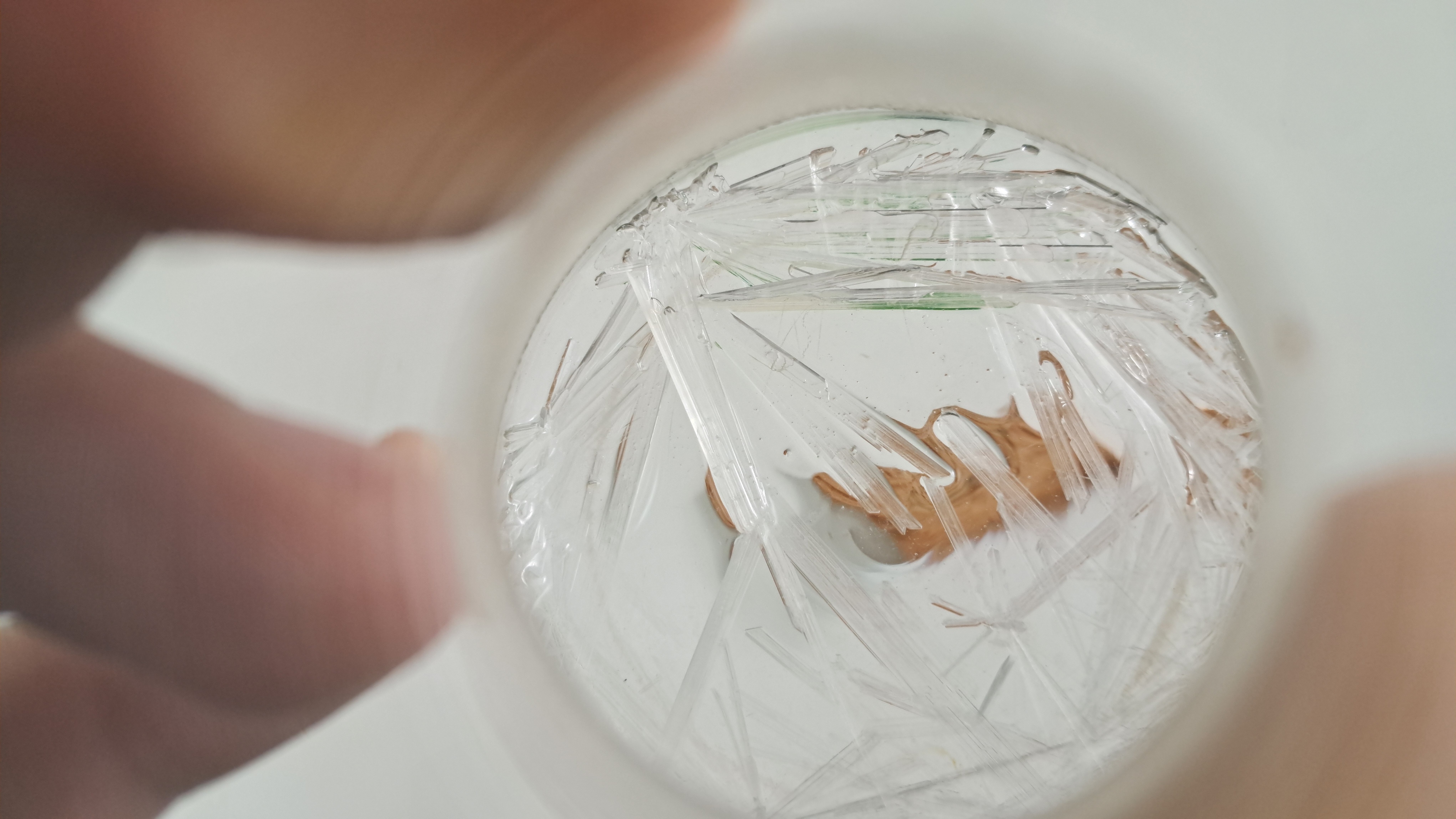

Sodium sulfate crystals

The pH of the filtrate was ~8
Does Calcium Carbonate React with Sodium Sulfate?
I added 56% nitric acid to the filtrate. No carbon dioxide evolution was observed

I added 56% nitric acid dropwise to the solid transferred from the filter to the beaker. Carbon dioxide was released, and the calcium carbonate dissolved. However, despite the excess nitric acid, some of the solid remained suspended
The solid particles did not dissolve even when the pH reached 0

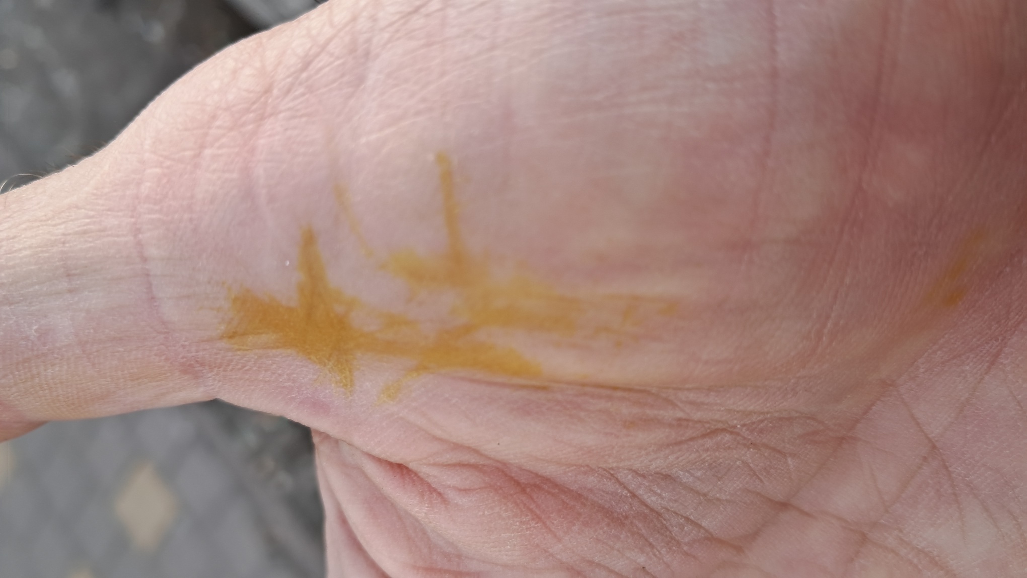

A small amount of nitric acid came into contact with my hand

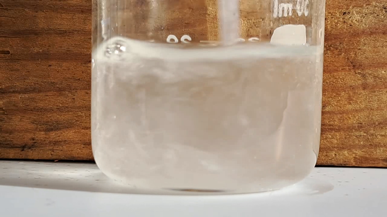

In the previous experiment, calcium carbonate was treated with a boiling solution of sodium sulfate, then filtered and dissolved in 56% nitric acid. The dissolution was incomplete, leading to the conclusion that some of the calcium carbonate had converted into calcium sulfate.
What did we overlook? I should have performed a control experiment. It is necessary to ensure that the starting materials do not contain impurities that could distort the results. Only then can a conclusion be drawn about the possibility of a reaction between calcium carbonate and sodium sulfate.
A residue insoluble in nitric acid could be due to impurities present in the starting materials. In particular, the calcium carbonate may contain substances that do not dissolve in acid. To rule out this possibility, the starting calcium carbonate should be treated with an excess of nitric acid to verify that it dissolves completely.
Next, it is necessary to check whether the sodium sulfate dissolves in distilled water without forming a solid residue.

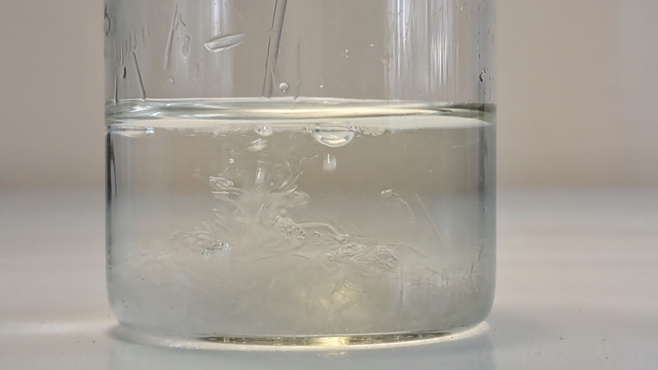

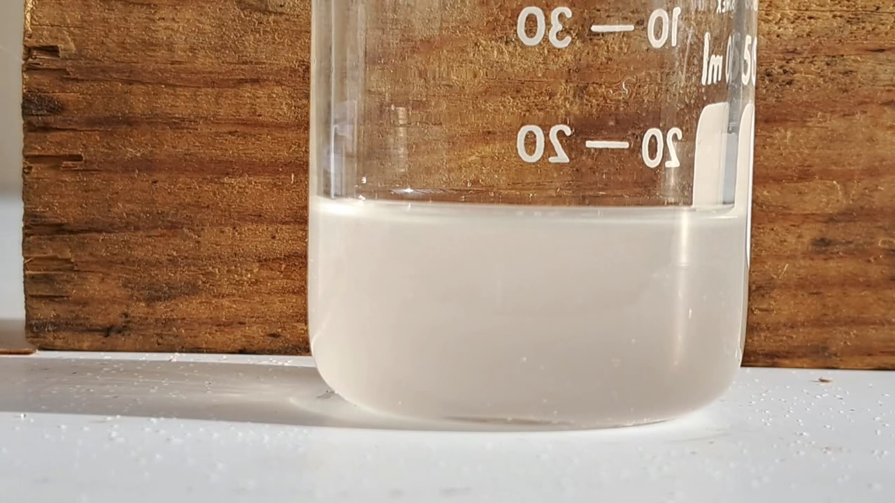

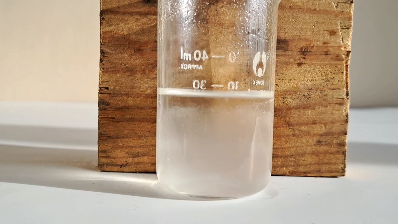

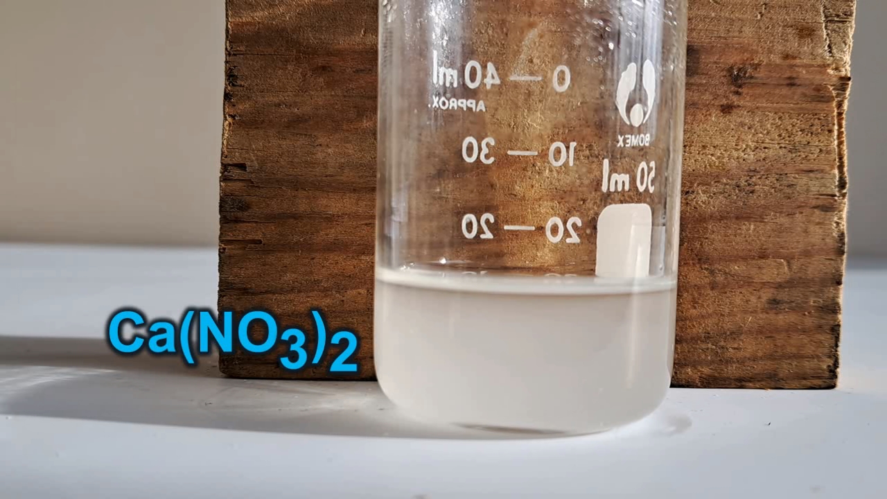

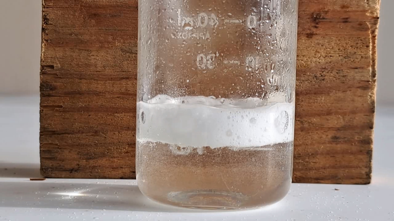

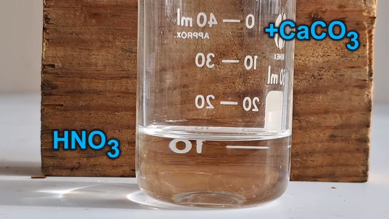

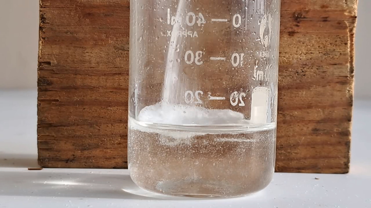

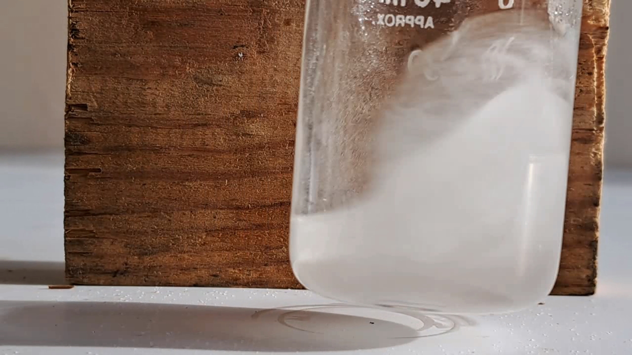

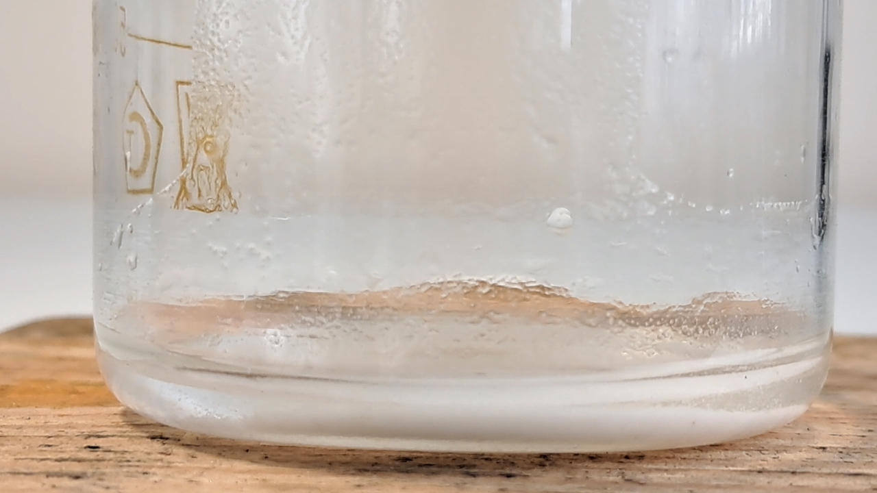

I weighed 0.4 g of calcium carbonate in a small beaker and added 56% nitric acid to it in small portions. Vigorous evolution of carbon dioxide began immediately and soon ceased. I expected a clear, colorless solution to form. However, once the reaction had stopped, the liquid remained cloudy. I added more nitric acid, even though the pH of the solution was already 0. Nevertheless, the solid phase did not dissolve - the solution remained cloudy.
A similar result was obtained in the previous experiment, where the pre-treated calcium carbonate, rather than the original calcium carbonate, was dissolved in nitric acid. At that time, I concluded that some of the chalk had converted to gypsum as a result of the reaction with sodium sulfate, and that the resulting calcium sulfate did not dissolve in nitric acid. However, the original calcium carbonate, when reacted with nitric acid, also left an insoluble residue.
It is reasonable to conclude that the original calcium carbonate contained an impurity insoluble in nitric acid. In the previous experiment, after dissolving the chalk in the acid, it was this impurity - not calcium sulfate - that formed the suspension.
Seeing that the chalk had not completely dissolved in nitric acid, I took an illogical step: I added distilled water to the suspension and stirred. Why was this illogical? If the substance did not dissolve in 56% nitric acid, it seemed unlikely that it would dissolve in water.

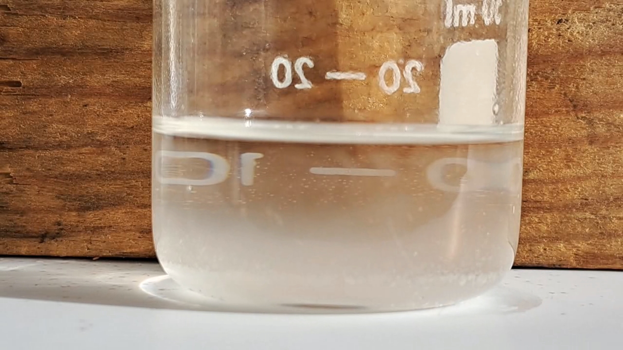

Unexpectedly, the white suspension turned into a clear solution - the solid phase had dissolved.
Therefore, the white precipitate was a substance highly soluble in water but poorly soluble in nitric acid. I assumed it was calcium nitrate. I remembered that calcium nitrate is highly soluble in water (121.2 g per 100 ml at 20°C). However, I had never considered whether calcium nitrate dissolves in nitric acid. I assumed that this salt is poorly soluble in nitric acid, because I remembered a similar example.
Sodium chloride dissolves well in water, but it is poorly soluble in concentrated hydrochloric acid. If concentrated hydrochloric acid is added to a saturated aqueous solution of sodium chloride, the salt precipitates. One book even claims that weak luminescence is observed during the crystallization of sodium chloride.
Another example: sodium reacts violently with water - small pieces ignite, and larger pieces explode. However, sodium reacts with concentrated hydrochloric acid without flame or explosion. The metal floats on the surface of the acid, releasing hydrogen and producing occasional sparks. A film of poorly soluble sodium chloride forms on the surface of the metal, inhibiting a violent reaction.
[Warning: I used pieces of sodium approximately half a centimeter in size for this experiment. If a larger piece is used, an explosion cannot be ruled out. Moreover, potassium metal explodes under these conditions, even though potassium chloride is also poorly soluble in concentrated hydrochloric acid.]

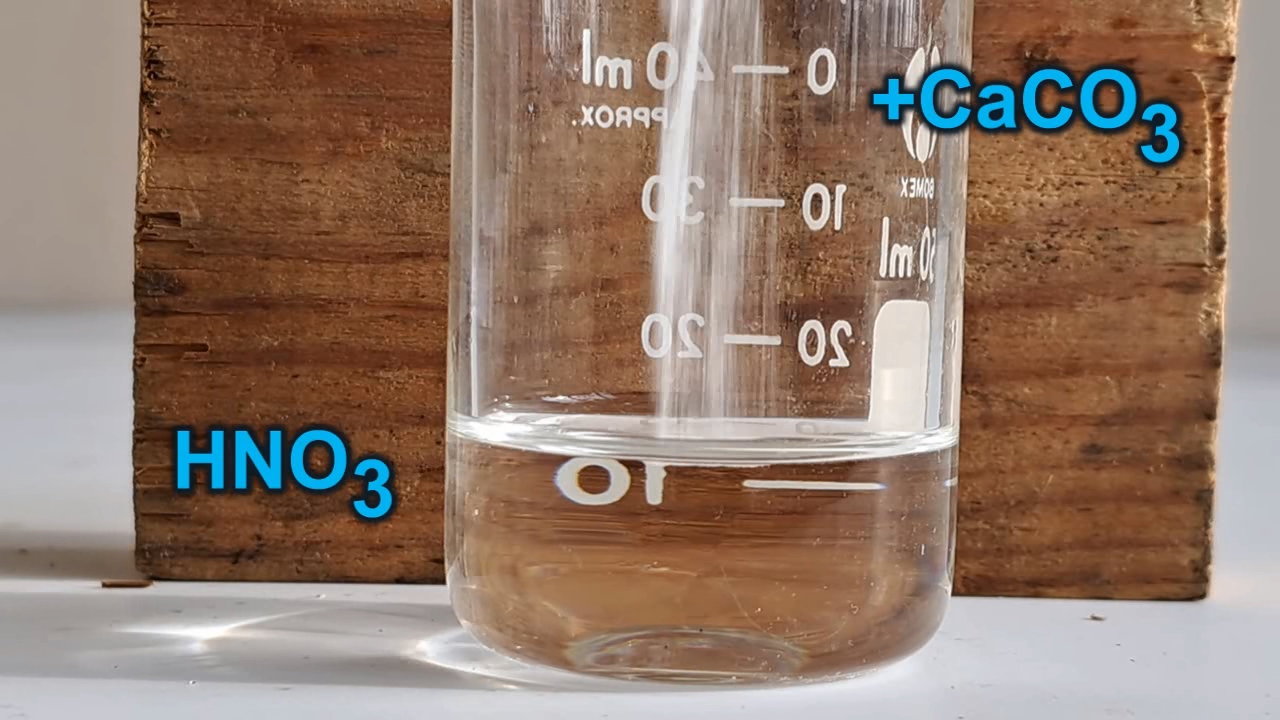

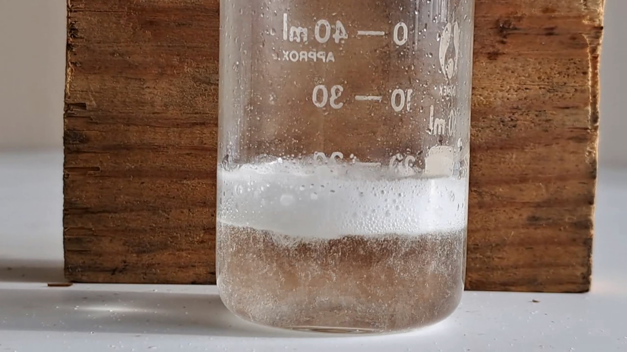

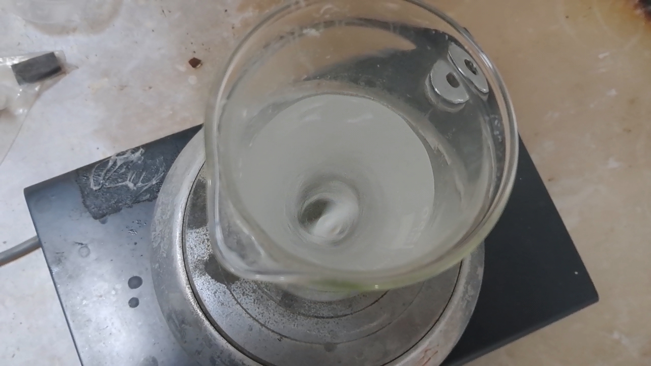

A literature search confirmed that calcium nitrate is poorly soluble in nitric acid. Its solubility in aqueous nitric acid solutions is intermediate between its solubility in pure water and in pure nitric acid.
Therefore, when dissolving chalk in 56% nitric acid, a precipitate of calcium nitrate formed - another poorly soluble calcium salt. When distilled water was added, the precipitate dissolved.
Thus, the conclusion reached at the end of Part 9 was incorrect. The formation of a white precipitate after dissolving calcium carbonate in the acid was not due to the conversion of some of the chalk to gypsum, but rather to the poor solubility of calcium nitrate in nitric acid.

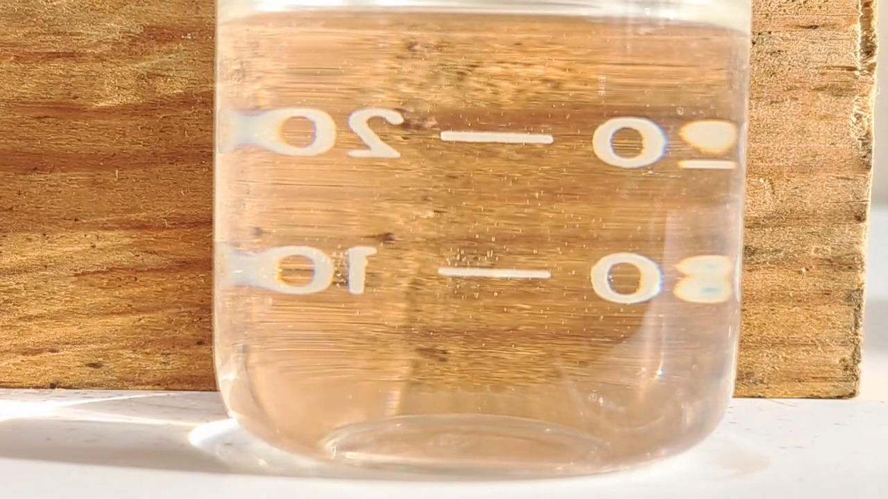

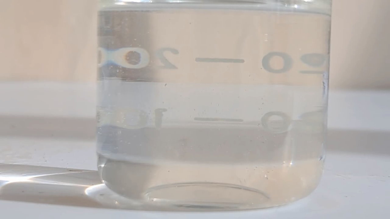

To record a video of the reaction, I poured approximately 15 ml of 56% nitric acid into a beaker and added calcium carbonate in small portions (the nitric acid was in excess). Gas was released, and the solution soon became white and turbid. As the mixture stood, a white precipitate of calcium nitrate formed.
I added distilled water to the beaker, increasing the volume to 30 ml, and stirred. The precipitate dissolved, forming a clear, colorless solution.

Чтобы снять видео реакции, налил в стакан примерно 15 мл 56% азотной кислоты и добавлял карбонат кальция небольшими порциями (азотная кислота была в избытке). Выделился газ, вскоре раствор стал бело-мутным. При стоянии жидкости выпал белый осадок нитрата кальция.
Добавил в стакан дистиллированную воду, доведя объем жидкости до 30 мл, перемешал. Осадок растворился, образуя прозрачный и бесцветный раствор.

Reaction of 56% nitric acid with calcium carbonate
