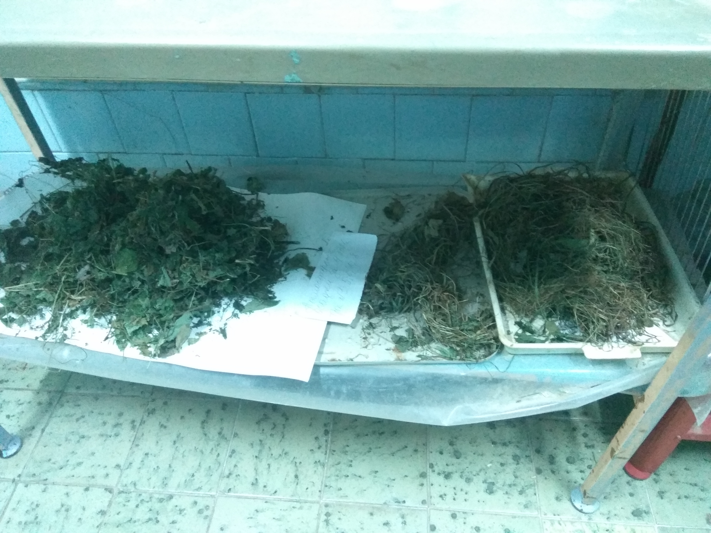

Six months later, the former boss called again. He had won an IAEA project to monitor tritium levels in the air near the radioactive waste storage facility where I had recently worked. He again asked my colleague to perform the work, once more promising payment.
The task was to place traps containing anhydrous calcium chloride at designated points along the perimeter of the waste storage site. The calcium chloride would absorb moisture from the air. After 24 hours, the traps were to be collected, the absorbed water distilled, and the tritium analyzed.
Although the facility was within city limits, the surrounding terrain was difficult: forested, with fallen trees, dense bushes, and swamps in some places. Mosquitoes and other unpleasant insects were abundant.
I said to my colleague,
"I hope you refused? He cheated you once - he'll cheat you again."
"Of course I refused," he replied. "I'm not going to set the traps; two other employees will."
The next day, I went to see my colleague - he was sitting in his lab. I was overjoyed to see him. At first, I was sure he had told me he wouldn't do the project just so I wouldn't feel bad for him, while actually planning to go set the traps. However, since he was in the lab, I assumed he hadn't gone into the forest after all.
When I looked at him, all my joy vanished. His face was swollen, and he looked very ill. It turned out that he had gone into the forest with two other employees to set the calcium chloride traps - he had lied to me.
They arrived by car and notified security. To protect their legs from moisture, they pulled plastic bags over their jeans and shoes. They took the necessary equipment and headed into the forest.
Along the way, my colleague felt a sharp pain on the top of his head. When he touched the spot, the pain struck again. A wasp had gotten into his hair and stung him twice. He had been stung by wasps many times before - it was unpleasant, but never serious - so he ignored it and went on.
When they reached the site, he was about to set the first trap when he suddenly lost consciousness. He fell and regained awareness lying on the ground, surrounded by worried coworkers. He tried to stand, but his head was spinning, and his legs were buckling. The wasp stings had caused a severe allergic reaction.
The trap was supposed to be attached to a tree at a height of four meters (!) - fortunately, my colleague had not yet begun to climb.
The others told him:
"Rest. We'll do everything ourselves. If you can't walk, we won't be able to carry you to the car."
The two finished the work themselves. Then they had to reach the car. One was young; the other was elderly and barely able to walk. One carried all the equipment, while the other supported my weakened colleague. Slowly and with great difficulty, they made it back to the car.
The next day, the two returned and collected the calcium chloride traps. When my colleague recovered, he was supposed to distill the water from the solid calcium chloride.

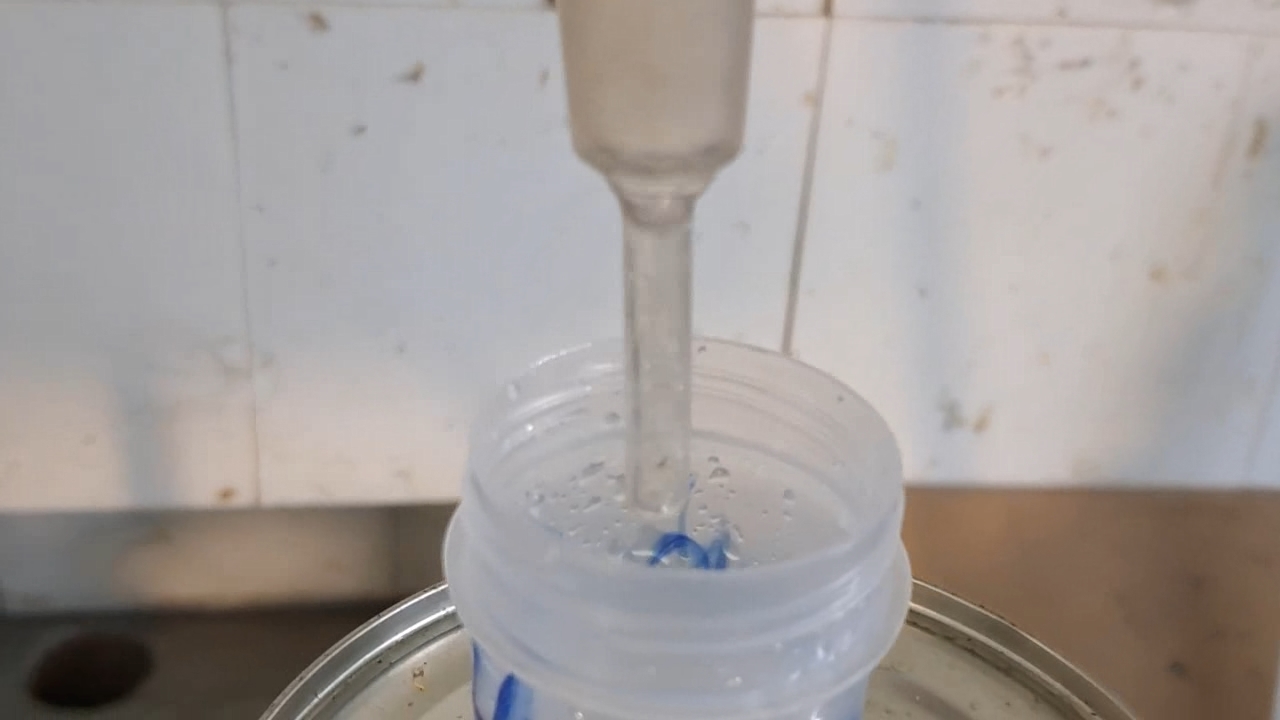

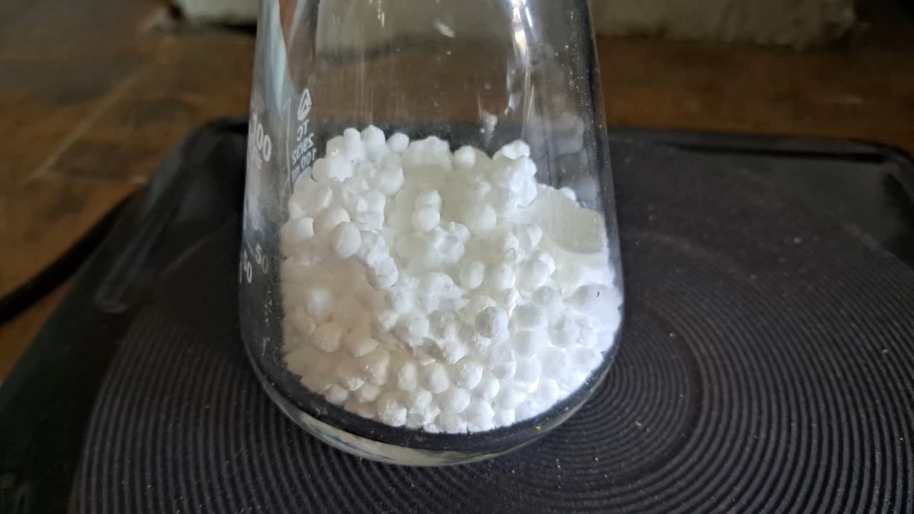

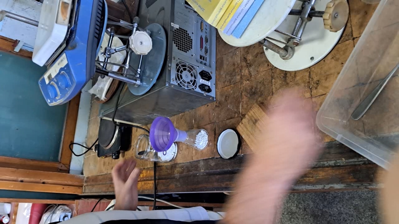

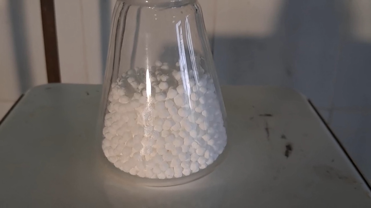

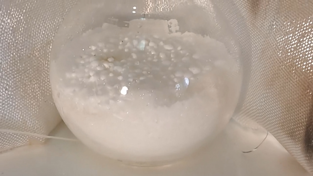

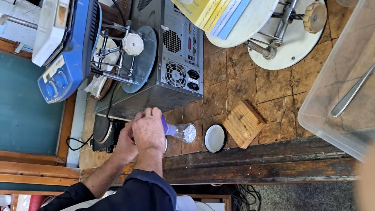

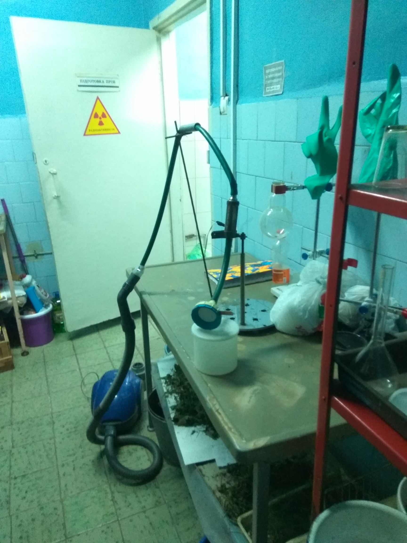

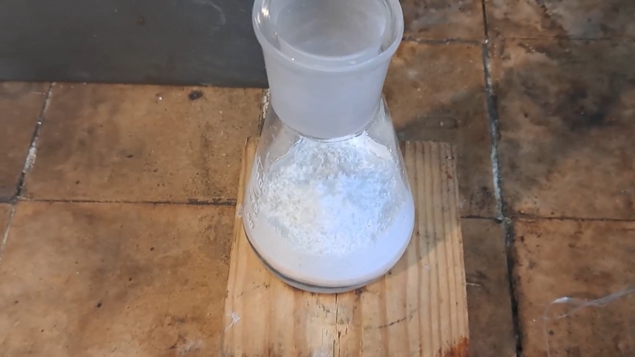

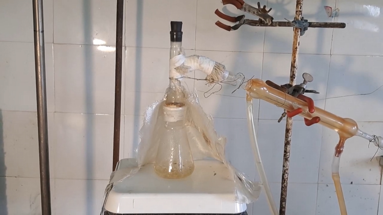

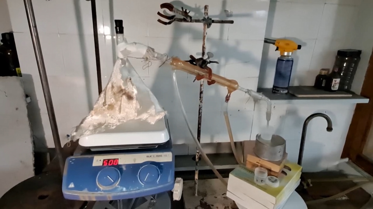

It was necessary to distill water from eight calcium chloride samples that had been exposed to air for 24 hours near the radioactive waste storage facility. The samples were expected to have low activity (below the limit for tritium in drinking water), but the distillation had to be carried out in a fume hood.

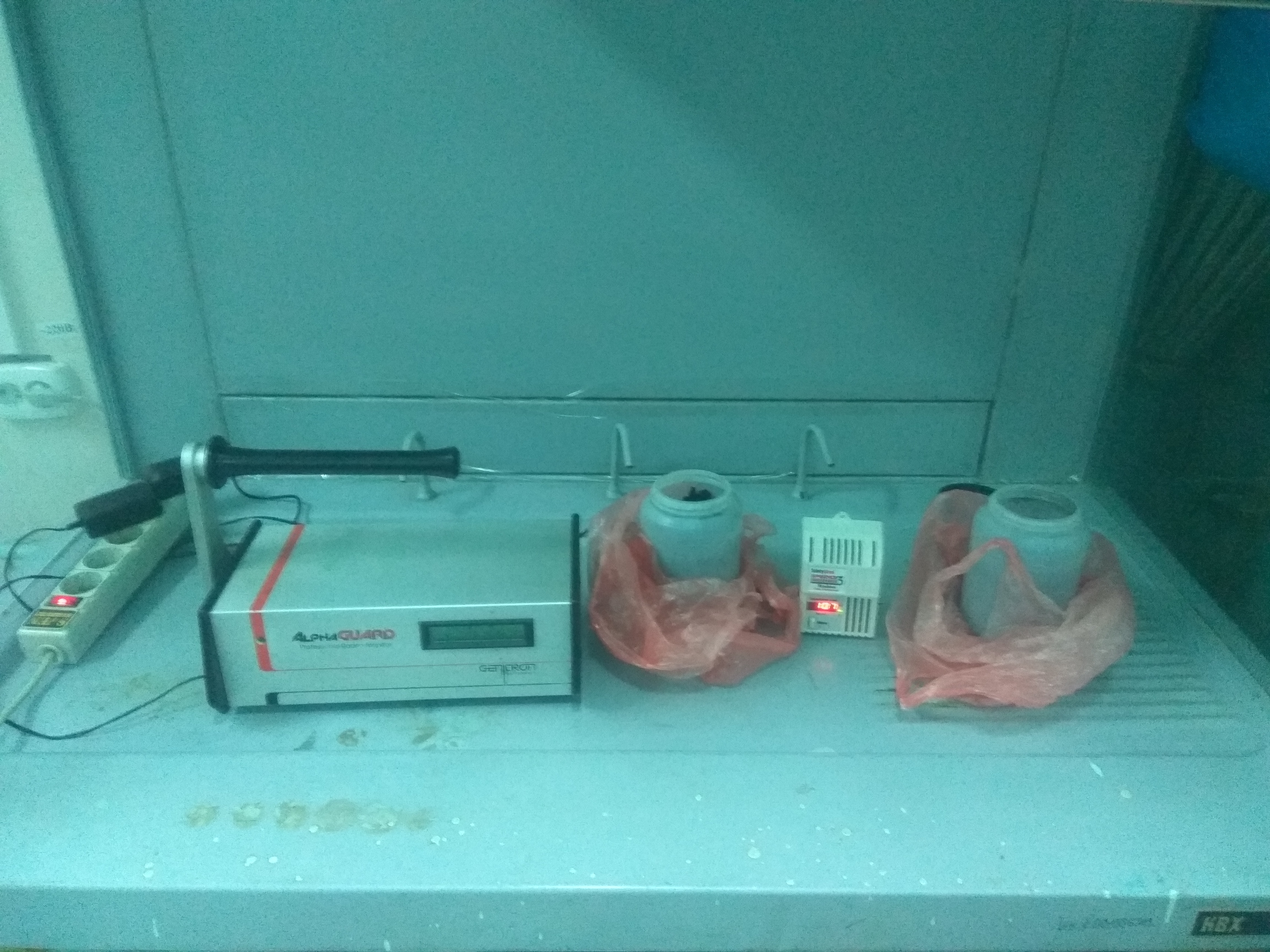

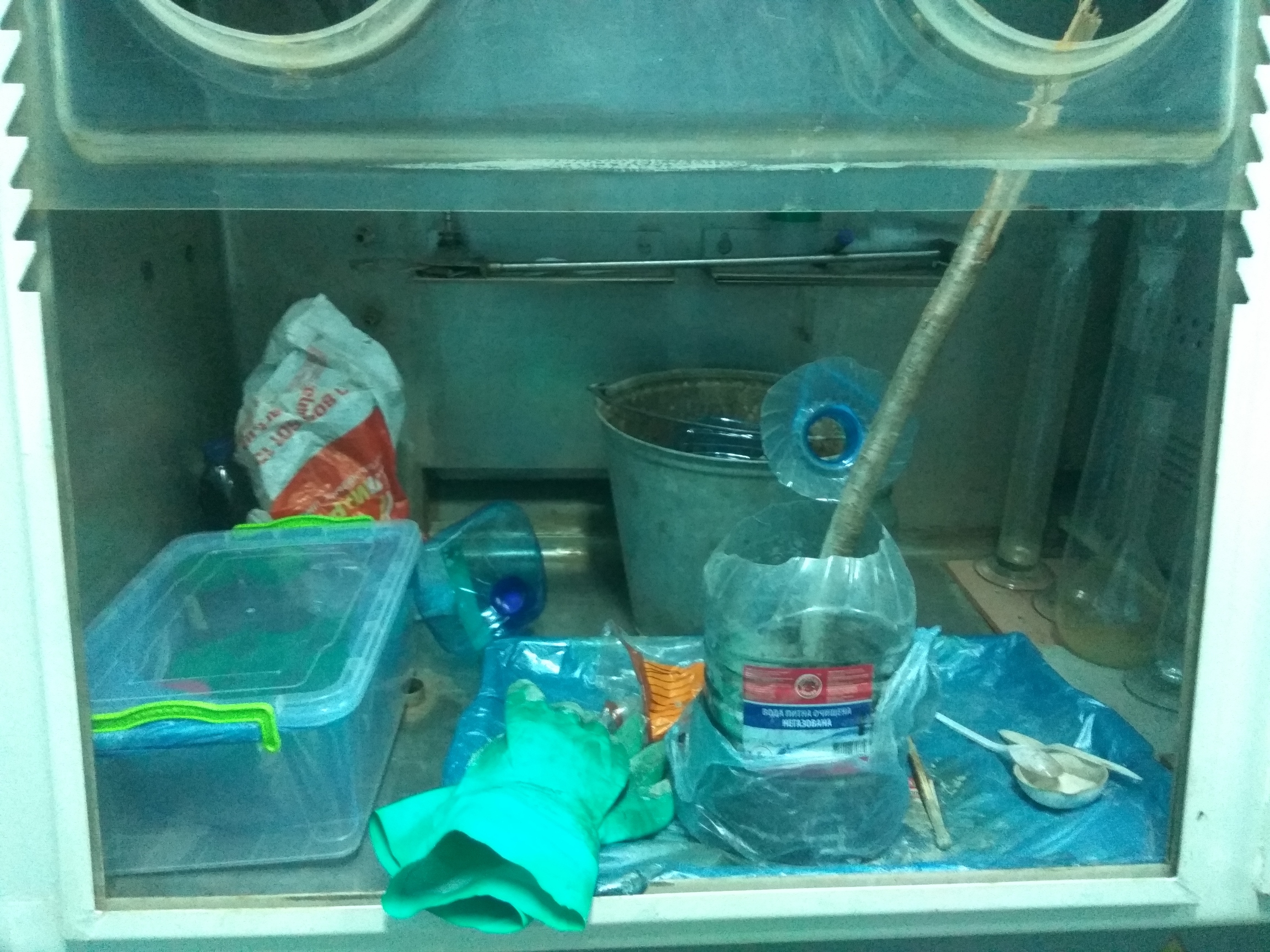

My colleague's two labs had three fume hoods in total, but he had managed to block them completely with various things. So, he asked me to provide a fume hood for the distillation.
At the time, I had only one room with a single fume hood. The project I was working on had just been put on hold, so I cleared the hood to let him assemble the distillation apparatus. I asked my colleague just one question:
"Did your former boss pay you for your work this time?"
"Yes, he did."
He named the amount he had received - minus taxes - and it was a paltry sum, even by the standards of our war-torn country. Not to mention that tritium analysis requires an expensive liquid scintillator, which is purchased at the institute's expense.
"If you agreed, then do the analysis. After that, I recommend you have no further dealings with this individual."
Whether my colleague told me the truth - that his former boss had paid him for the work - I don't know, and probably never will. Given past experience, he might have deceived me again.

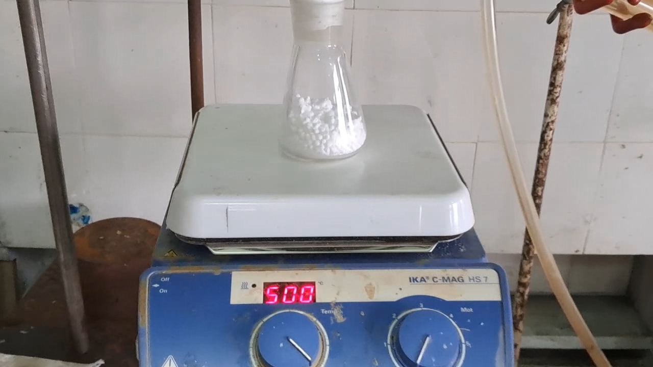

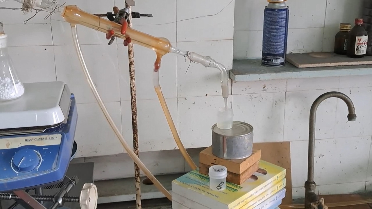

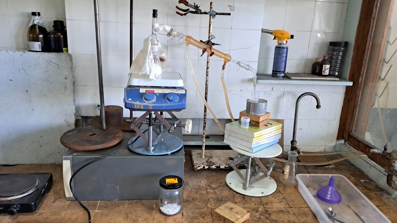

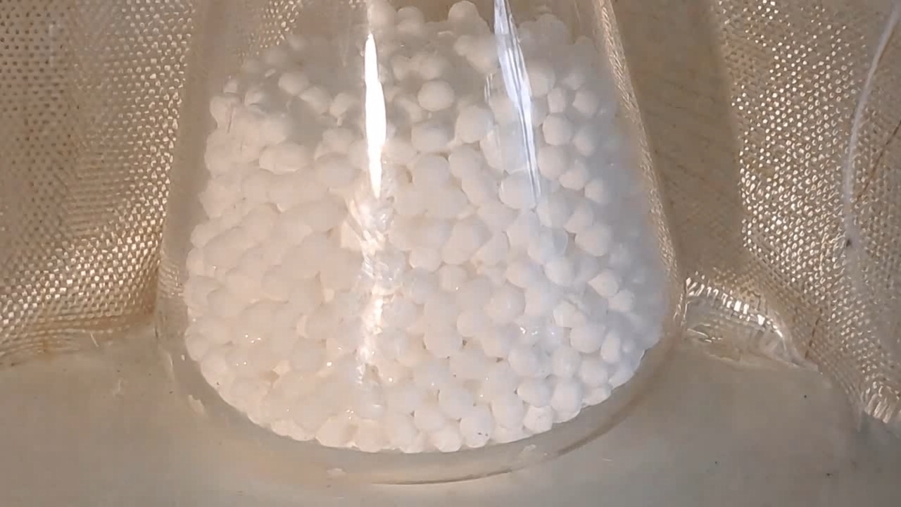

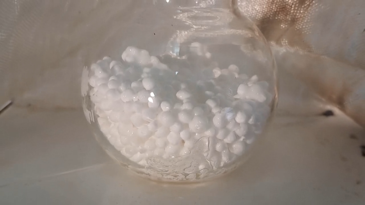

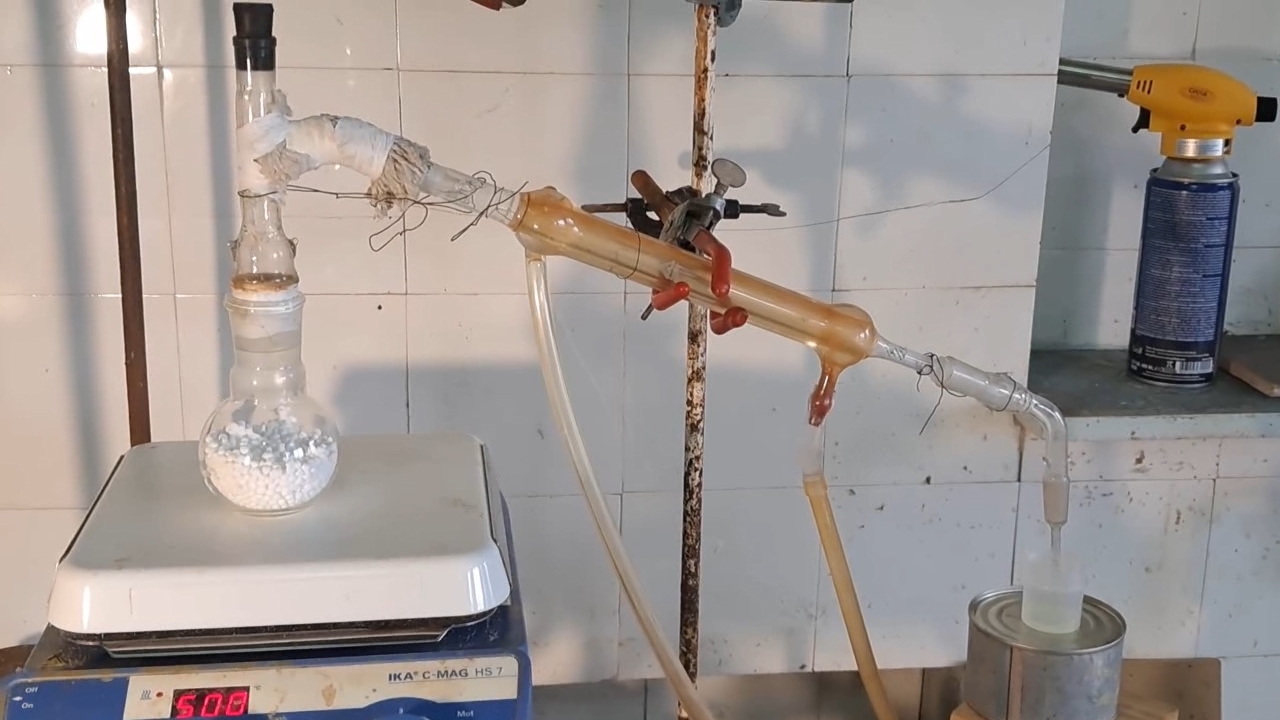

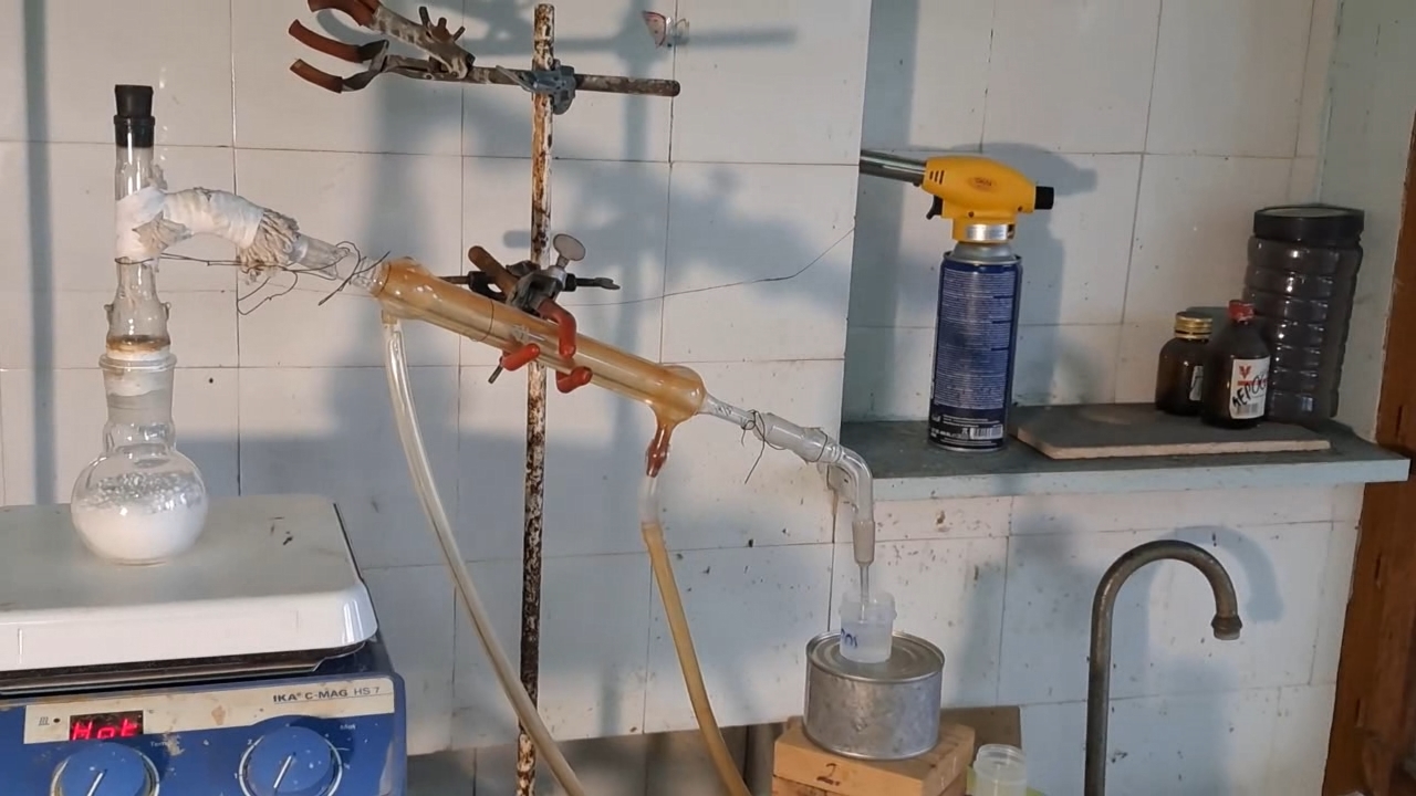

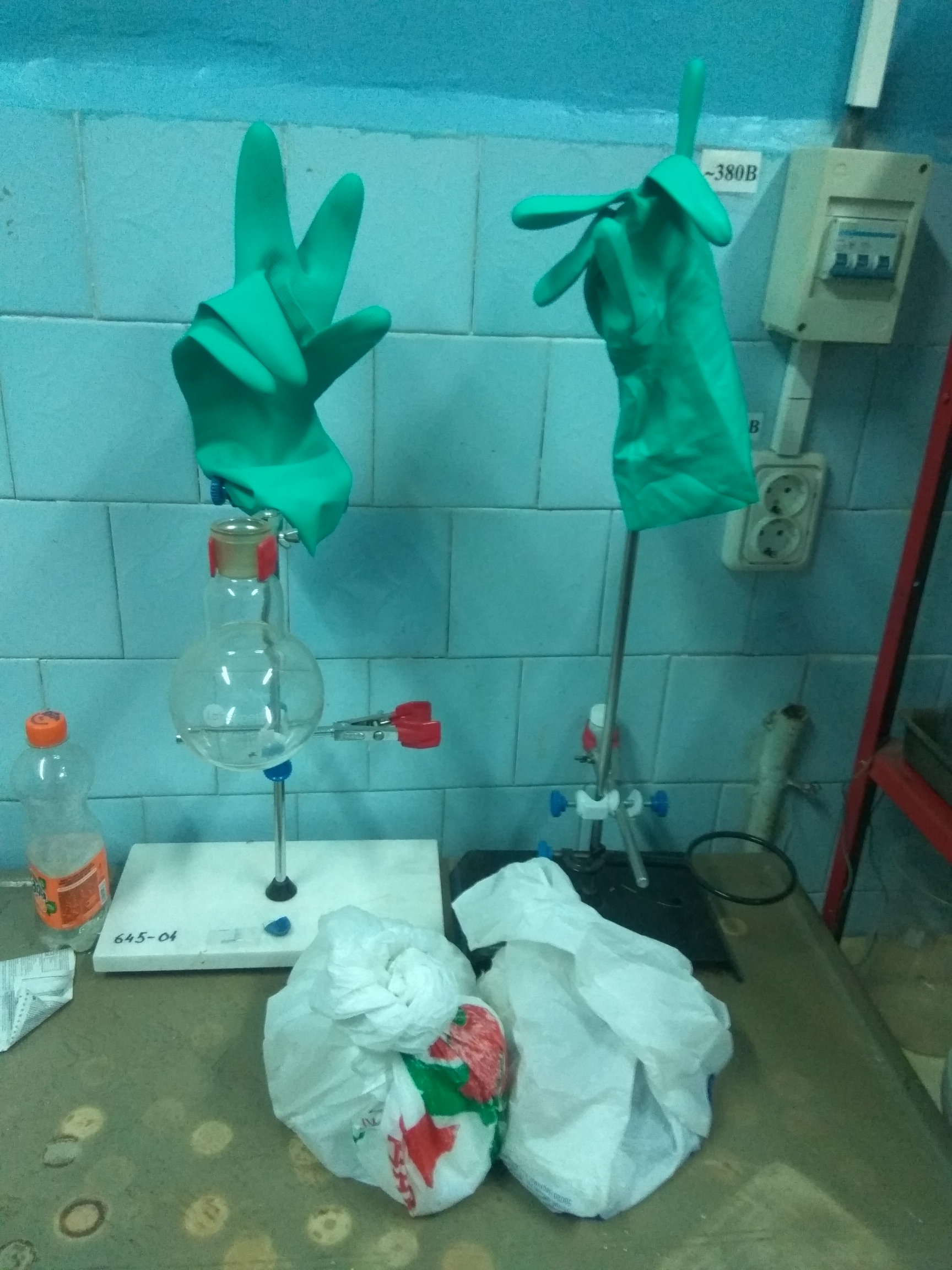

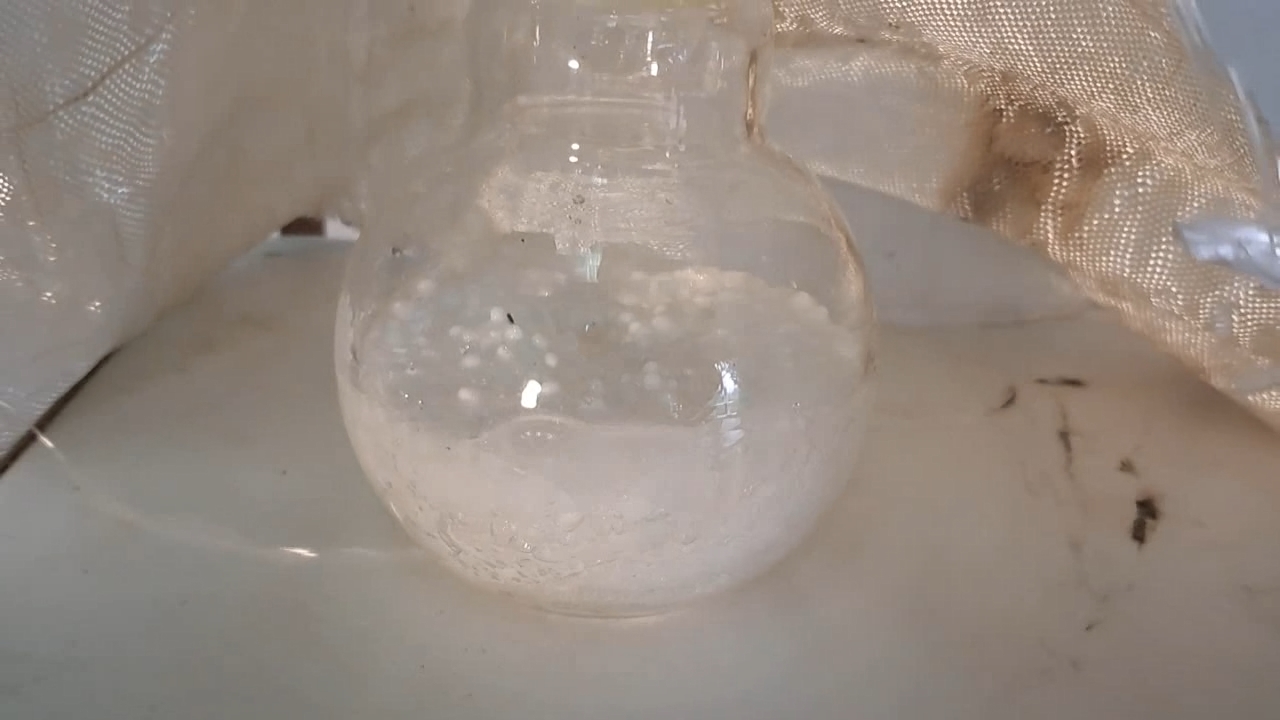

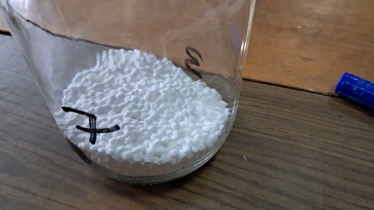

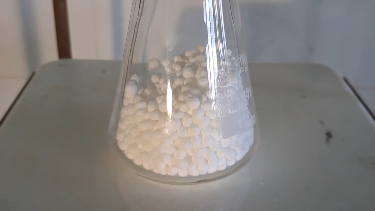

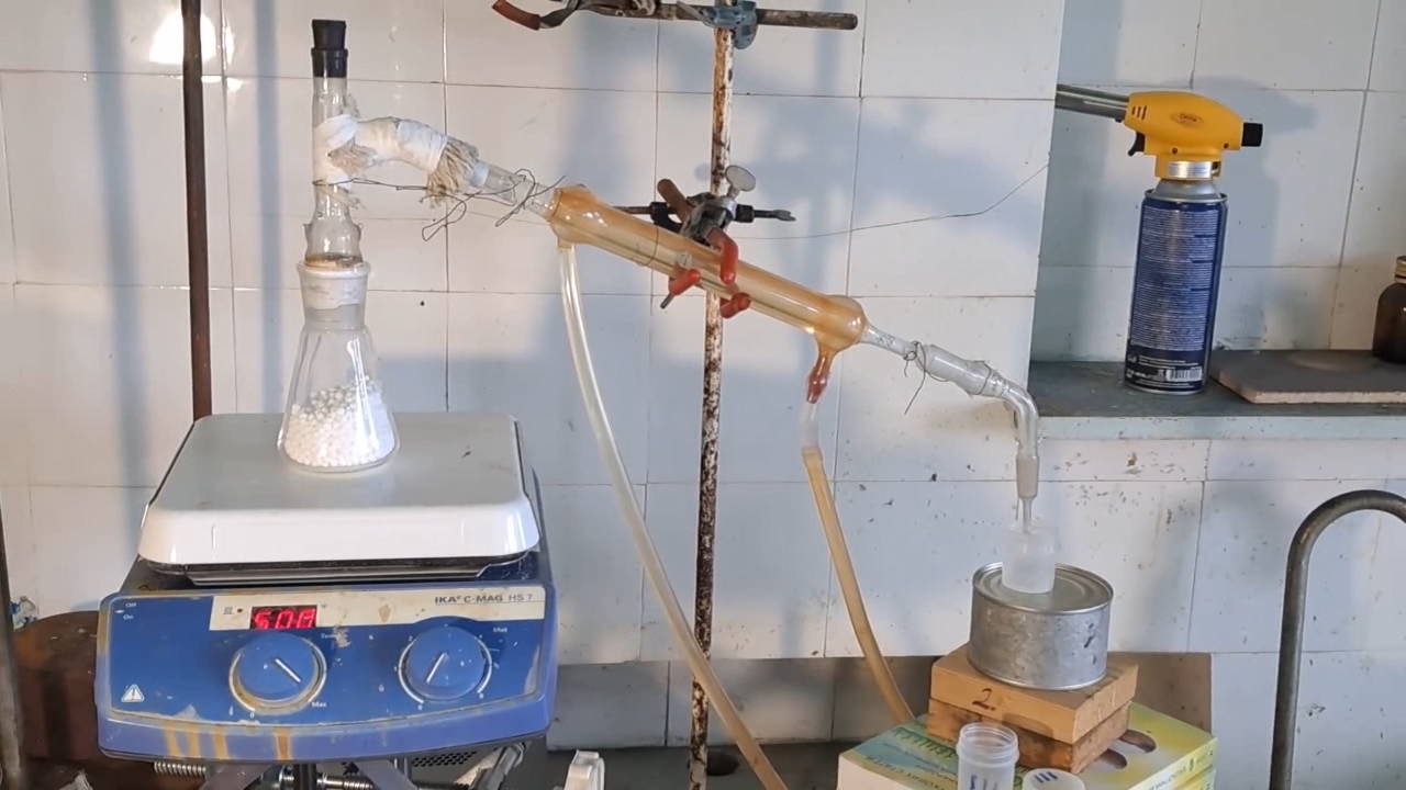

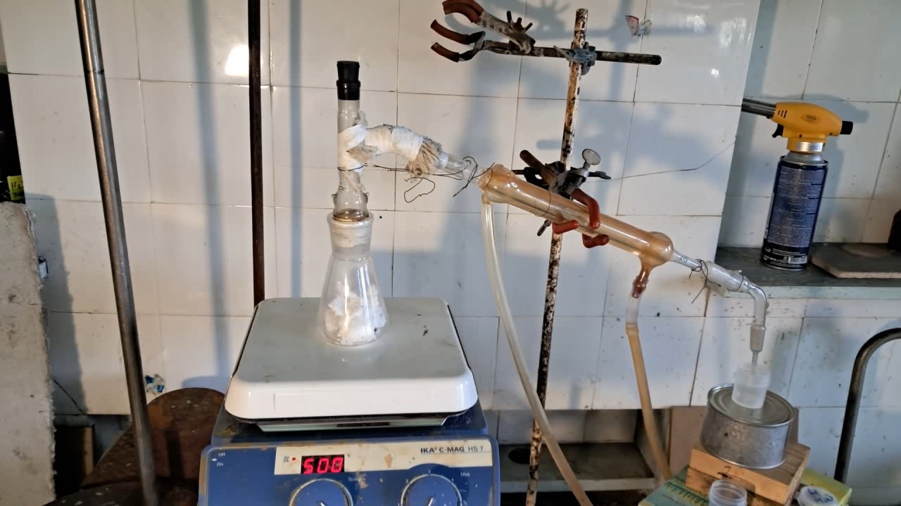

My colleague assembled the apparatus and placed the first sample of calcium chloride into the distillation flask - without weighing it. I asked:

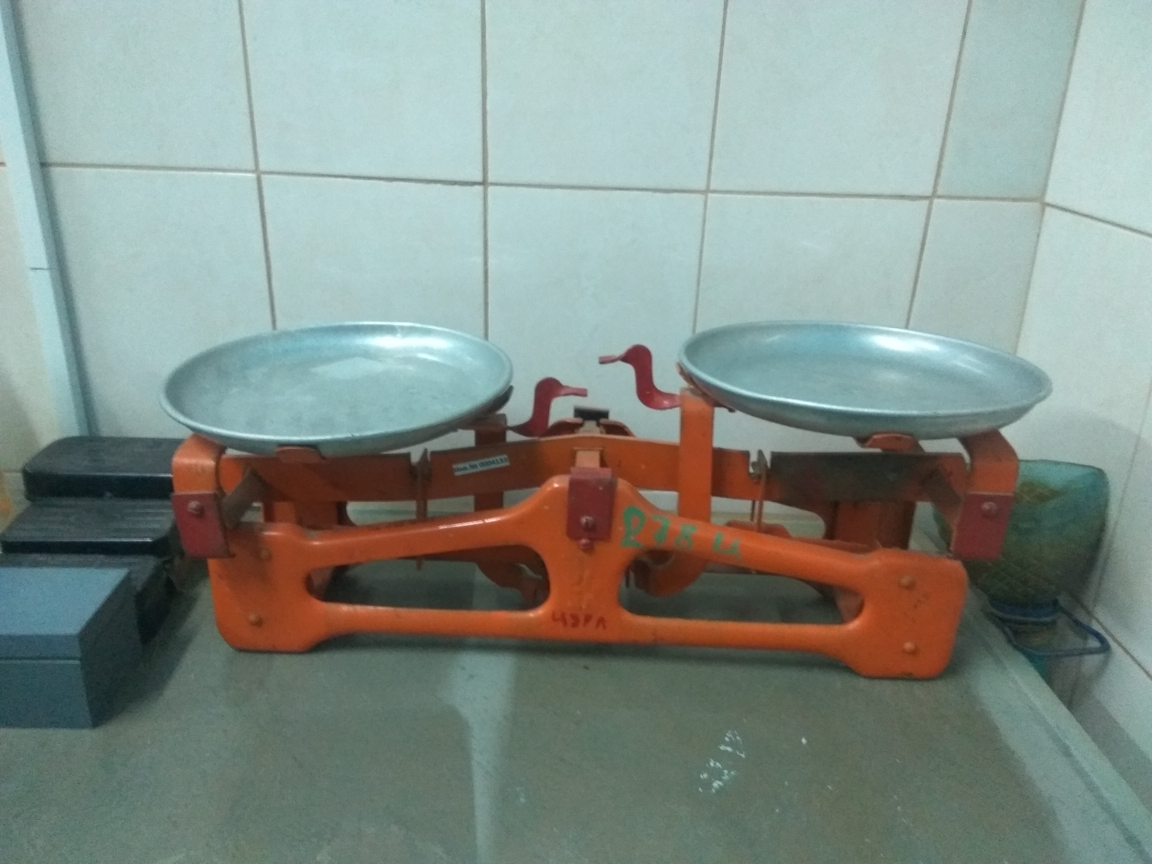

"Perhaps the sample should have been weighed before distillation?"
"No. We determine the tritium content in the absorbed water, not the water content in the sample."
I agreed.

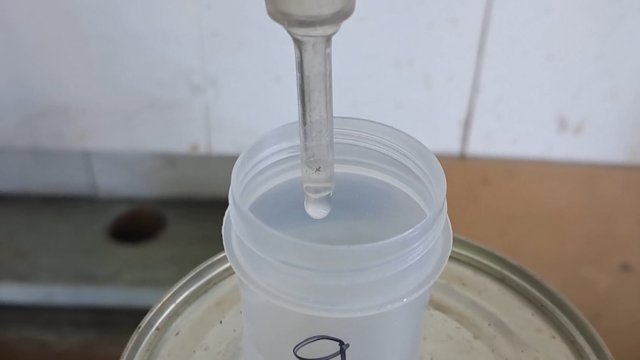

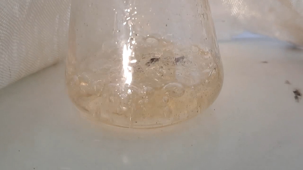

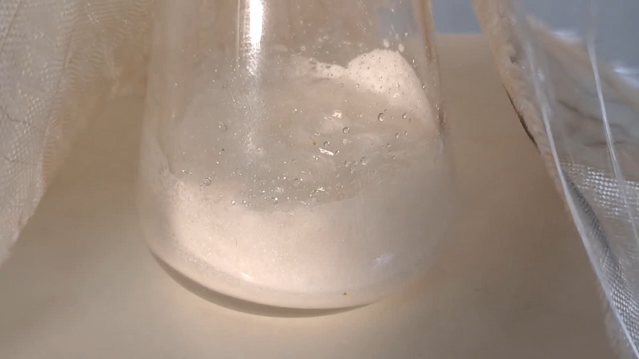

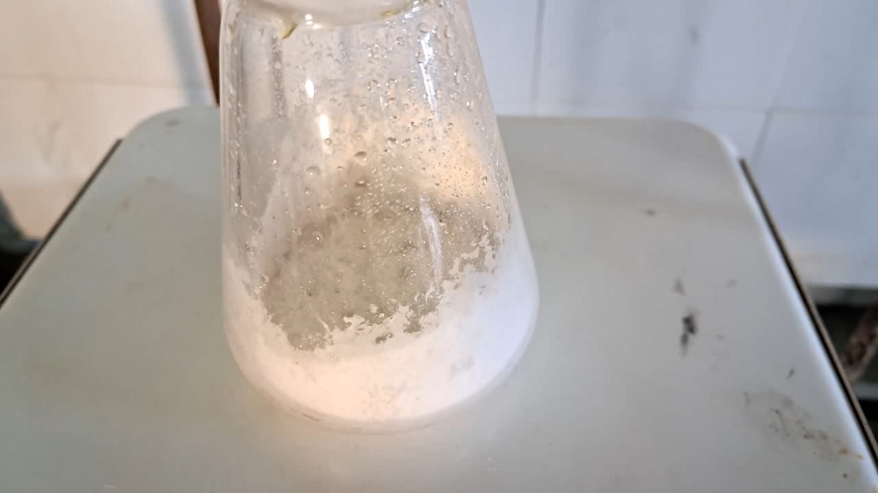

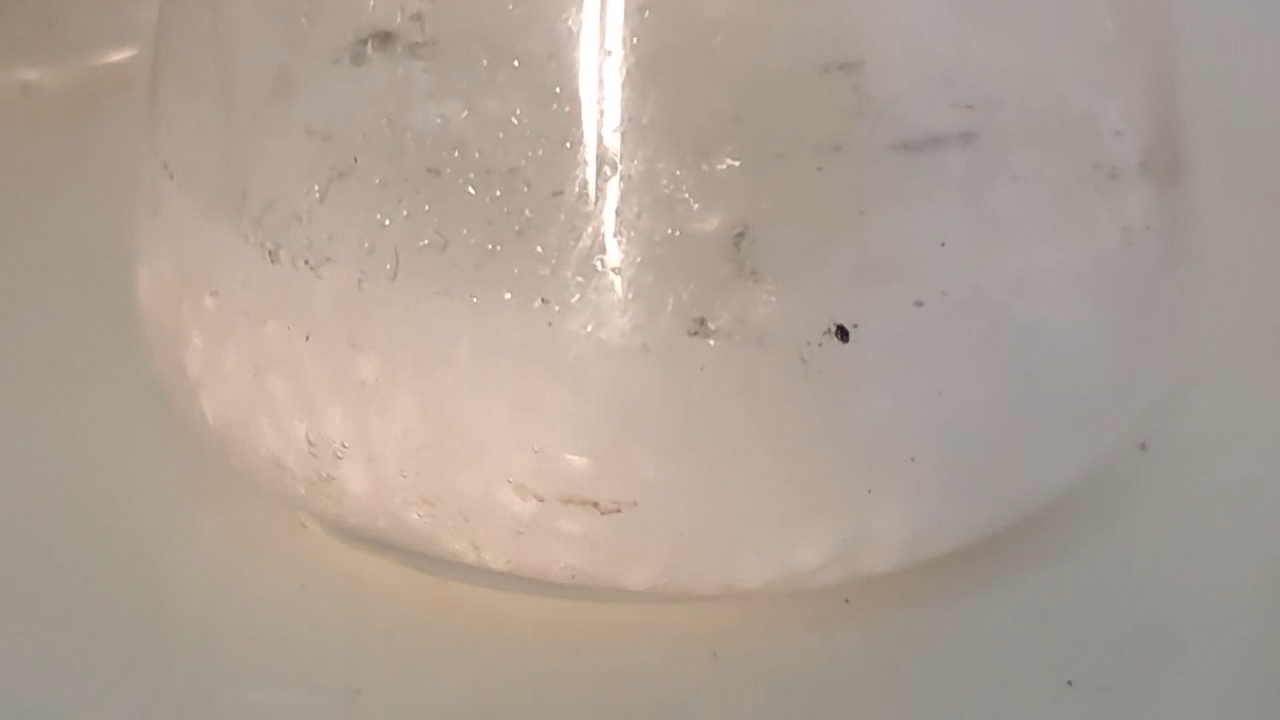

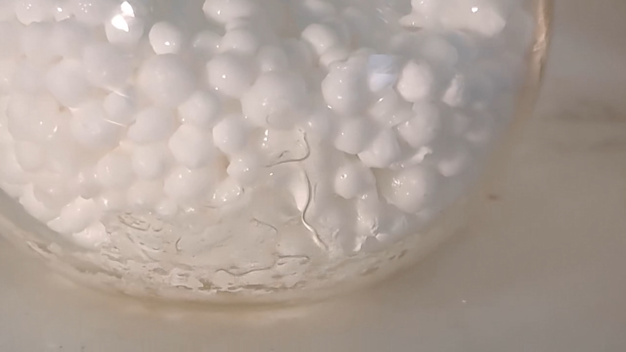

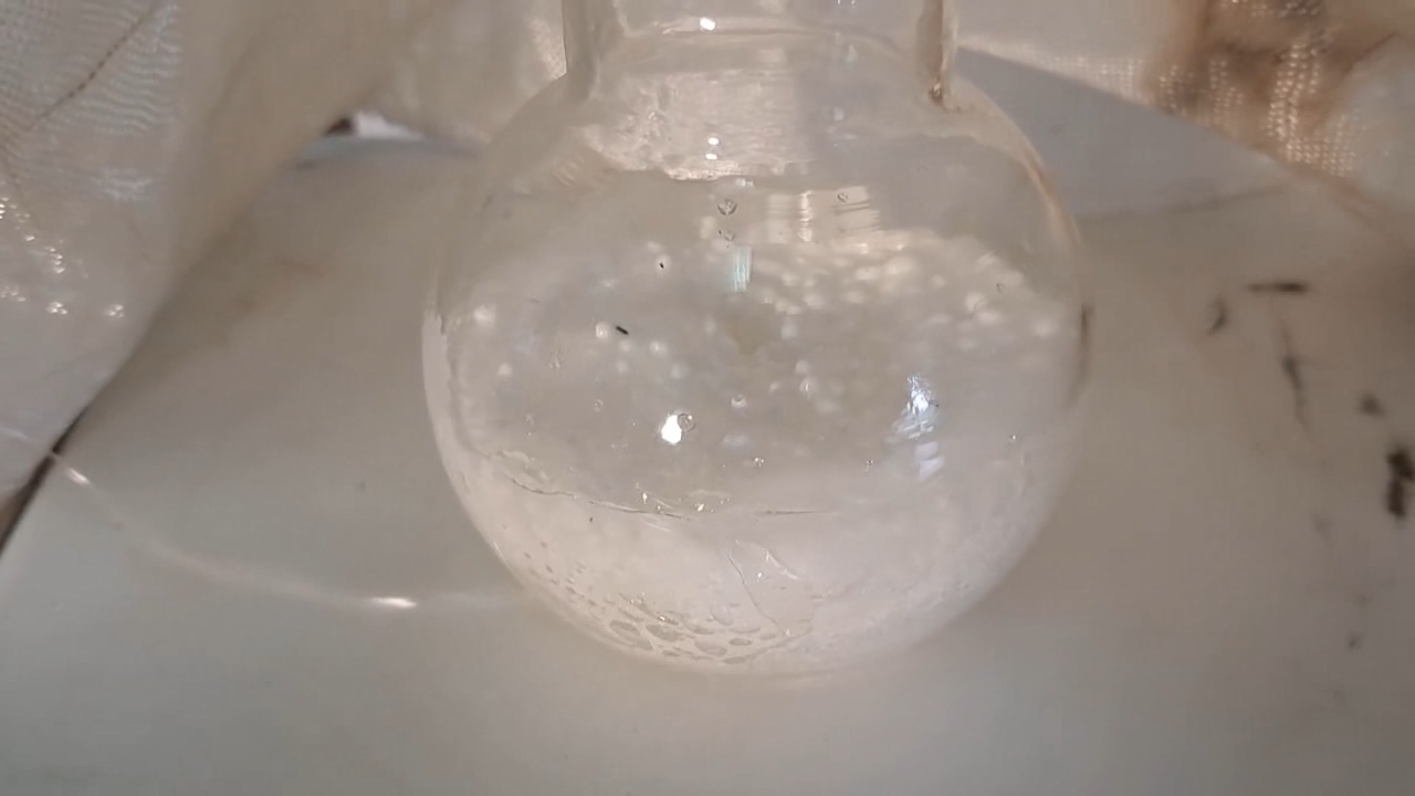

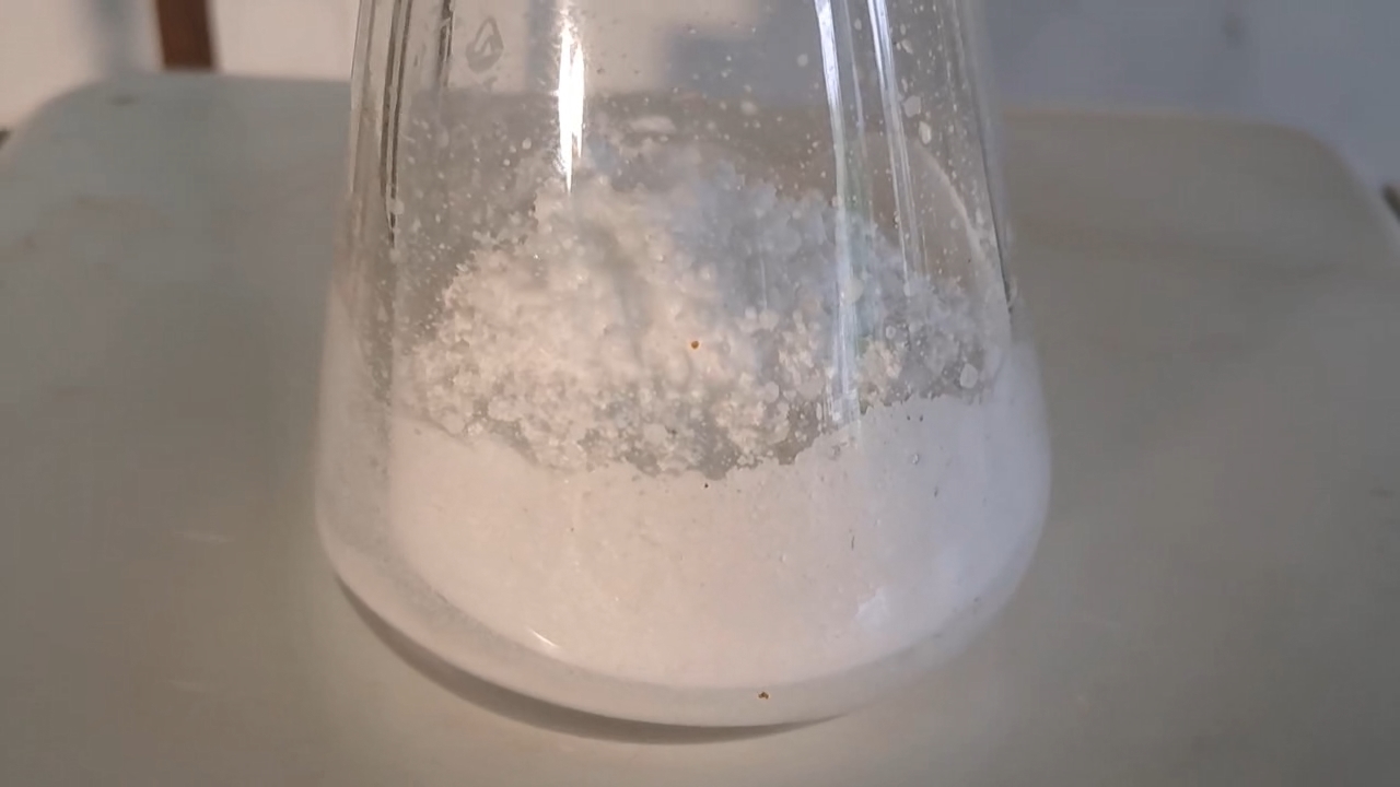

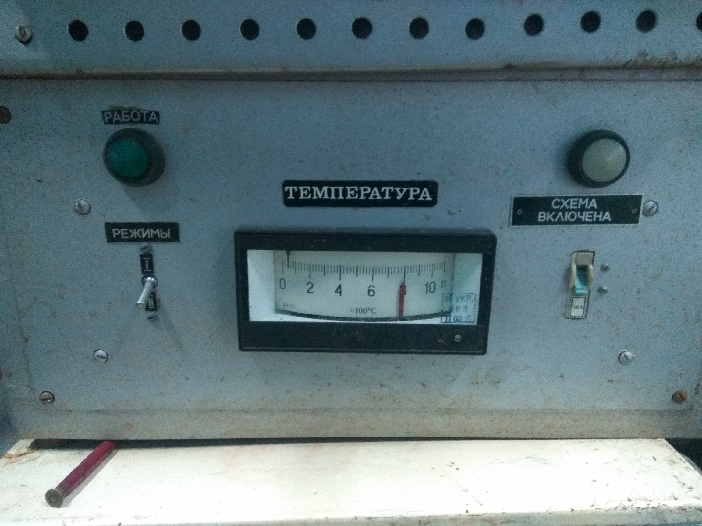

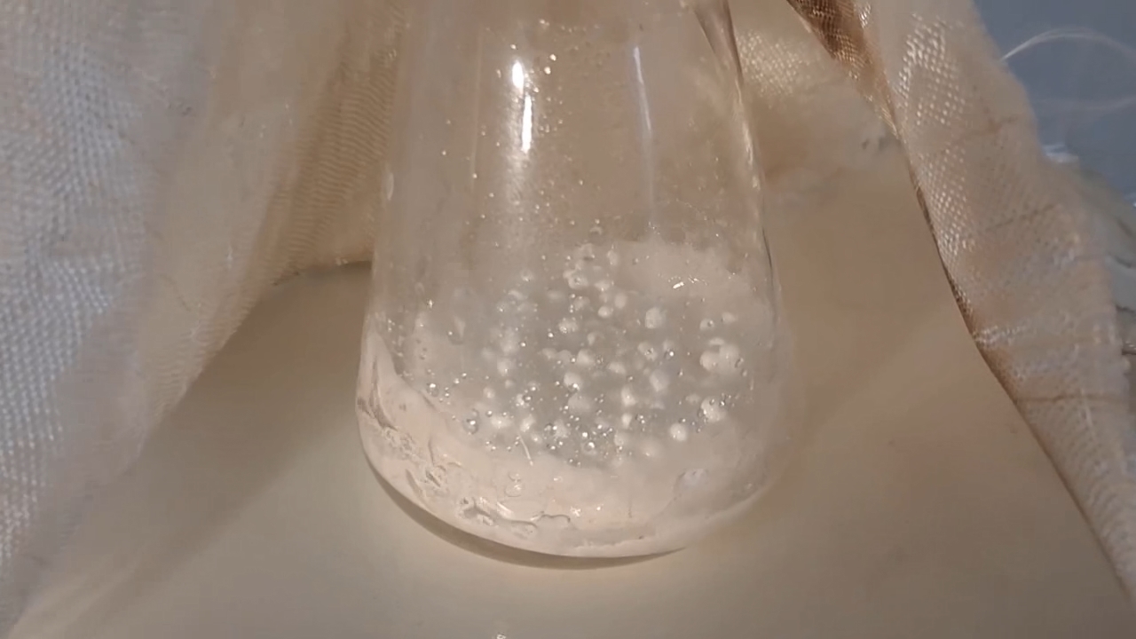

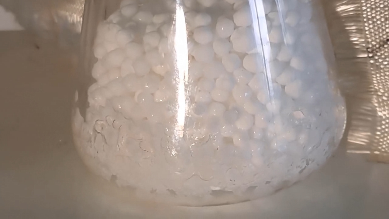

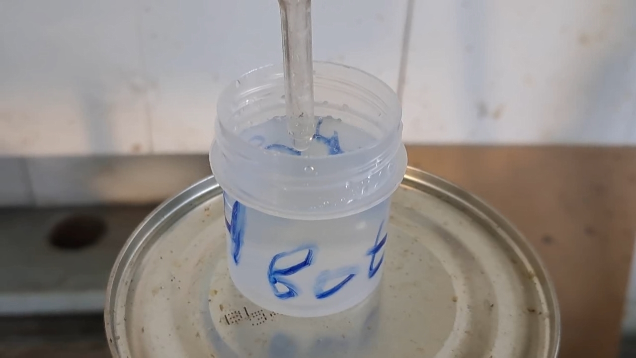

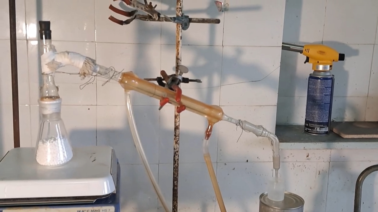

My colleague directed the water flow into the condenser and turned on the hotplate. To speed up the heating, he wrapped the flask in fiberglass. I expected the calcium chloride granules in the flask to melt, forming an aqueous calcium chloride solution; then this solution would boil, and water would begin to distill.

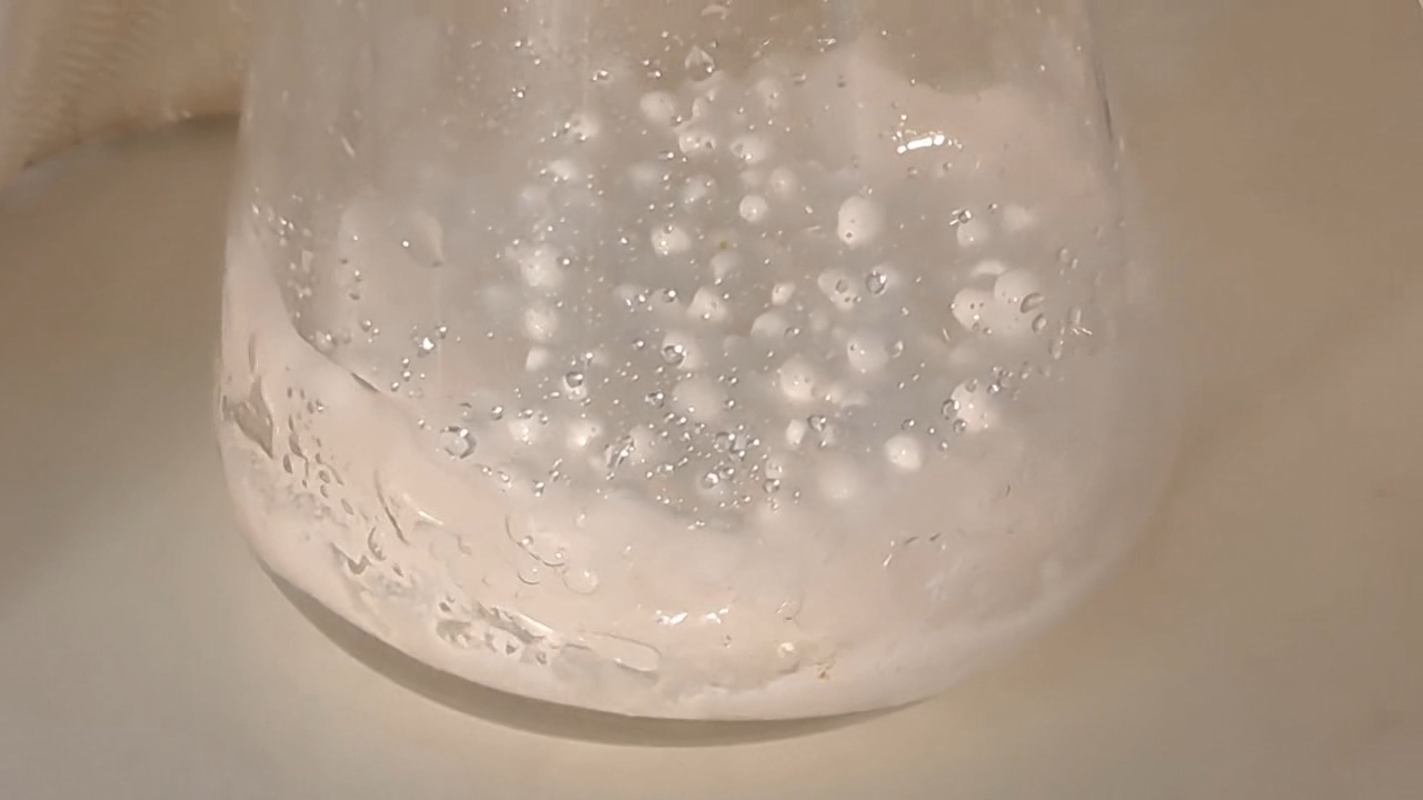

However, the granules did not turn into a solution. Only a small amount of liquid appeared in the flask, which boiled and evaporated.

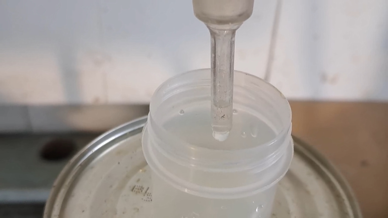

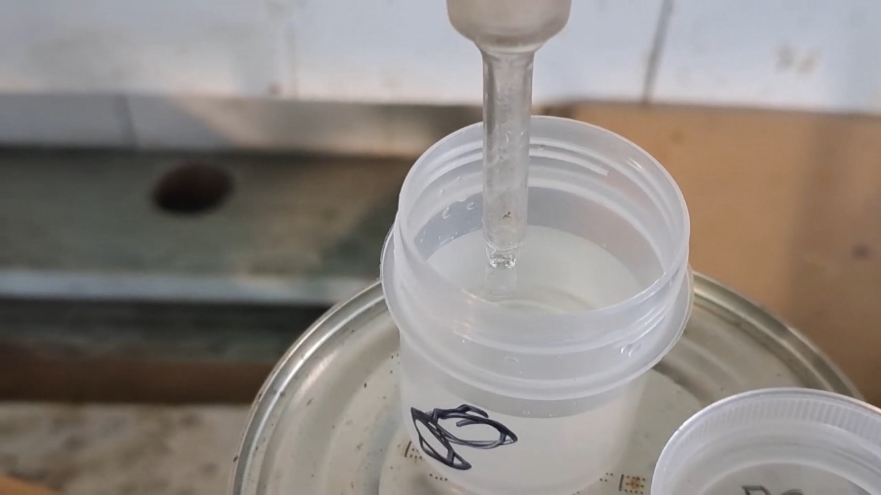

The distillation process began: distilled water started dripping into the receiver. We discarded the first portion, then began collecting the main fraction. For analysis, it was necessary to collect at least 8 mL of distillate, which we successfully managed to do. I asked:
"Shall we distill the next sample?"
"No - let's do it tomorrow. Or better yet, the day after tomorrow!"
A colleague cannot refuse when asked to do a job, even if he knows he will be deceived. However, once deceived, he delays the work as much as possible. What deadline can there be when the pay is minimal - or not paid at all?
I understood my colleague perfectly. The problem was that I needed the fume hood for other work, so I didn't want to drag out the distillation for several weeks. The next morning, I began distilling the samples myself, without even telling my colleague.

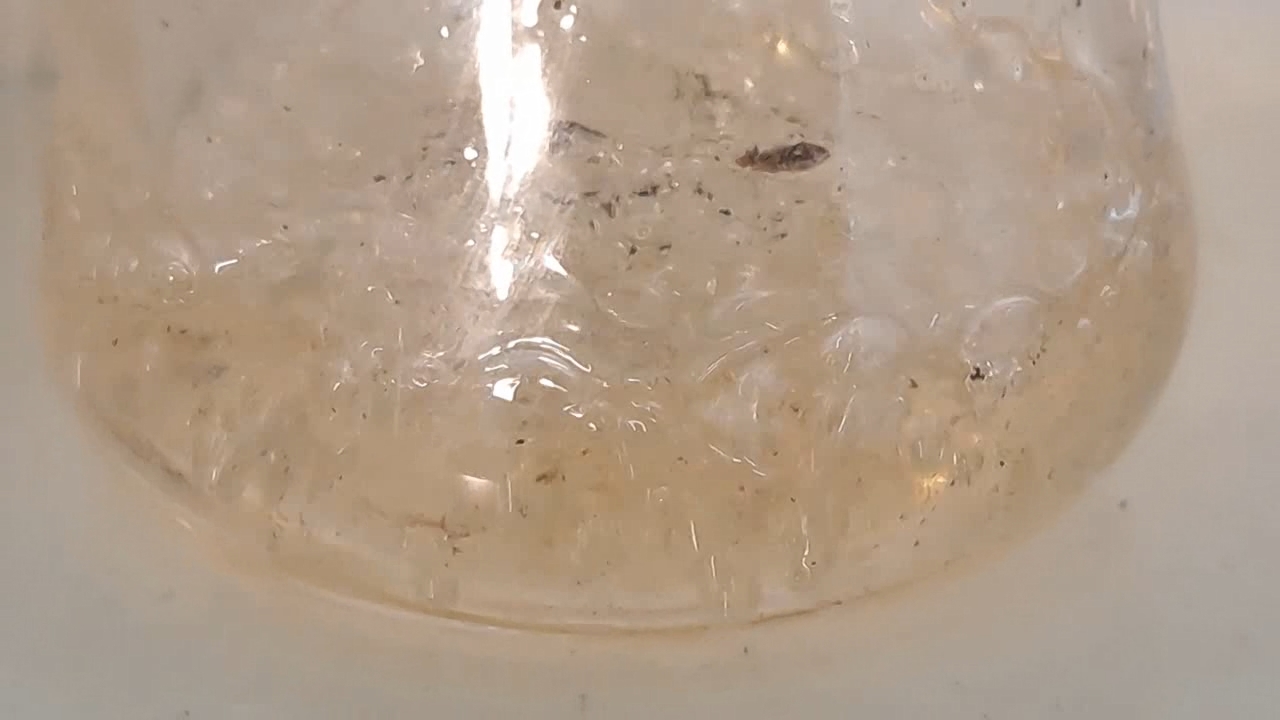

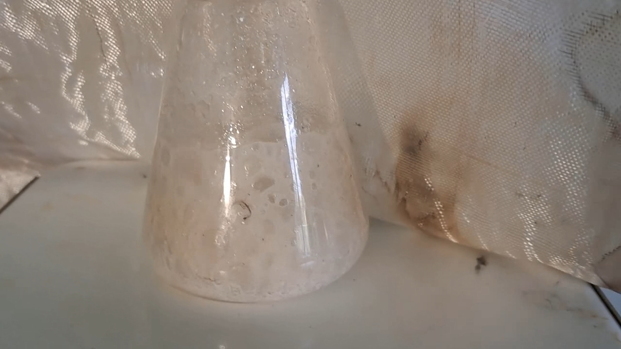

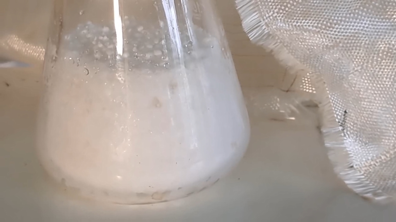

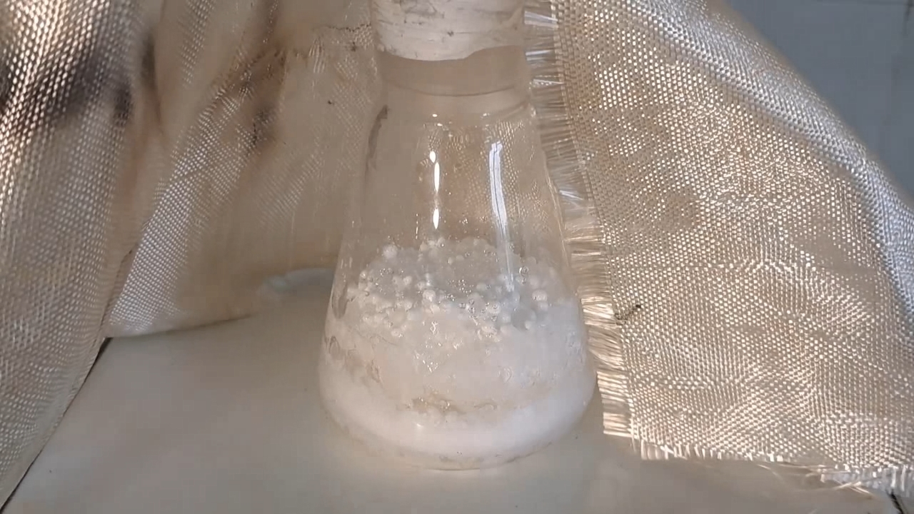

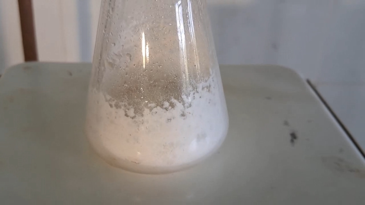

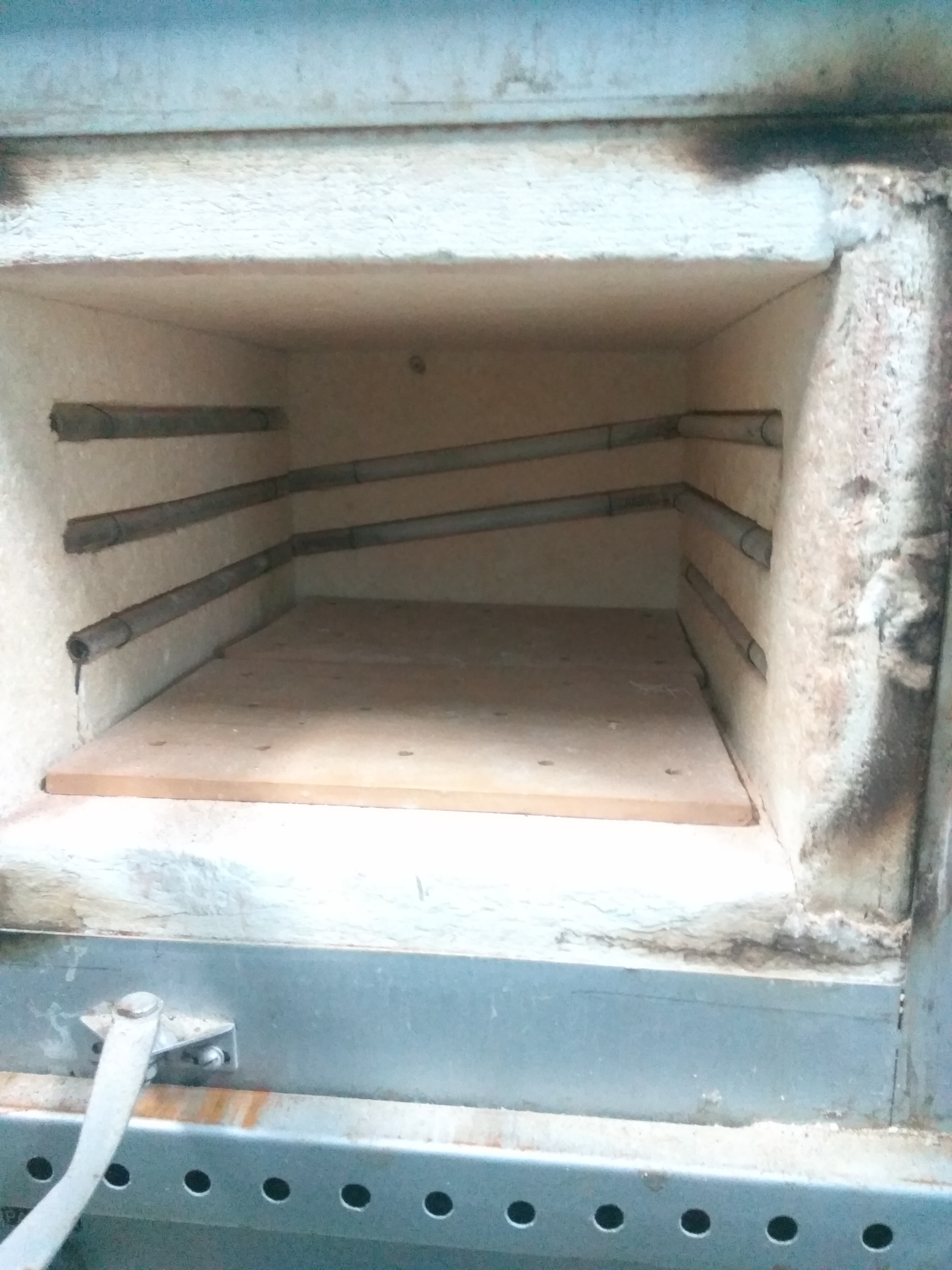

Some samples completely melted when heated, and the resulting solution boiled vigorously - I had to reduce the heat to prevent the liquid from bumping from the distillation flask into the condenser. Conversely, other samples behaved calmly (like the very first one), forming only a small amount of the liquid phase that gradually boiled away. It was logical to assume that one group of calcium chloride samples had absorbed a lot of water, while the other had absorbed only a moderate amount.
My colleague, seeing me distilling his samples, turned to other tasks (two people were not needed to maintain the distillation apparatus). Within two days, I had distilled all the samples and handed the distilled water to my colleague for tritium analysis.
I forgot to mention: on the evening of the first day, when I had already distilled most of the samples, my colleague brought me...
Отгонка тритиевой воды из твердого хлорида кальция - Часть 2
Итак, было необходимо отогнать воду из восьми образцов хлорида кальция, которые контактировали 24 часа с воздухом возле хранилища радиоактивных отходов. Прогнозируемая активность образцов была невысокой (ниже нормы, регламентирующей содержание трития в питьевой воде), однако, перегонку в любом случае следует проводить в вытяжном шкафу. В двух лабораториях, в которых работает коллега, есть аж три вытяжных шкафа, однако он умудрился их полностью заблокировать посторонними вещами. Следовательно, коллега попросил меня предоставить вытяжку для перегонки.
На тот момент у меня была всего одна комната с одним вытяжным шкафом. Проект, над которым я работал, как раз был заморожен, поэтому я освободил вытяжку, чтобы он смог собрать перегонную установку. Задал коллеге только один вопрос:
- Хоть в этот раз, бывший начальник заплатил тебе за работу?
- Да, заплатил.
Он назвал полученную сумму, минус - налоги, в результате получилась мизерная цифра - даже по меркам нашей воюющей страны. Не говоря уже, что для анализа трития требуется дорогой жидкий сцинтиллятор, который покупают за счет института.
- Раз согласился - значит делай анализ. После этого рекомендую тебе не иметь с этой личностью больше никаких дел.
Сказал ли мне коллега правду - что бывший начальник заплатил ему за работу - я не знаю, и не узнаю. Учитывая прошлый опыт, коллега мог меня в очередной раз обмануть.
Коллега собрал установку и поместил первый образец хлорида кальция в перегонную колбу, не взвесив образец. Я спросил:
- Может, образец следовало перед перегонкой взвесить?
- Нет. Мы определяем содержание трития в поглощенной воде, а не содержание воды в образце.
Я согласился.
Коллега направил поток воды в холодильник и включил электрическую плитку. Для ускорения нагрева он обернул колбу стеклотканью. Я ожидал, что гранулы хлорида кальция в колбе расплавятся, превратившись в водный раствор хлорида кальция, затем этот раствор закипит и начнется отгонка воды.
Однако, гранулы не превратились в раствор. В колбе появилось только небольшое количество жидкости, которая кипела и испарялась.
Процесс отгонки начался - в приемник стала капать перегнанная вода. Первую порцию мы отбросили, затем стали обирать основную фракцию. Для анализа было необходимо собрать хотя бы 8 мл дистиллята, что удалось. Спросил:
- Перегоняем следующую пробу?
- Нет - давай завтра... А лучше - послезавтра!
Коллега не может отказать, когда его просят сделать работу, даже, если он точно знает, что его обманут. Однако, когда его обманывают, он максимально затягивает выполнение работы. Какой может быть дедлайн, если за работу не платят или платят мизер?
Я отлично понимаю коллегу. Проблема была в том, что мне будет нужен вытяжной шкаф для других работ, поэтому я не хотел затягивать перегонку на несколько недель. Утром следующего дня я начал перегонять образцы сам, даже не сообщив коллеге.
Некоторые из образцов при нагревании полностью расплавились, а образовавшийся раствор бурно кипел - приходилось уменьшить нагрев, чтобы избежать выброса жидкости из перегонной колбы в холодильник. Наоборот, другие образцы вели себя при нагревании спокойно (как самый первый образец), образуя лишь немного жидкой фазы, которая постепенно кипела. Логично было предположить, что одна группа образцов хлорида кальция поглотила много воды, а другая - лишь умеренное количество.
Коллега, увидев, что я перегоняю его образцы, занялся другими делами (присутствие двух человек возле перегонной установки не требовалось). За два дня я перегнал все образцы. Отдал отогнанную воду коллеге, чтобы он проанализировал содержание трития.
Забыл сказать: вечером первого дня, когда я уже перегнал большую часть образцов, коллега мне принес...
