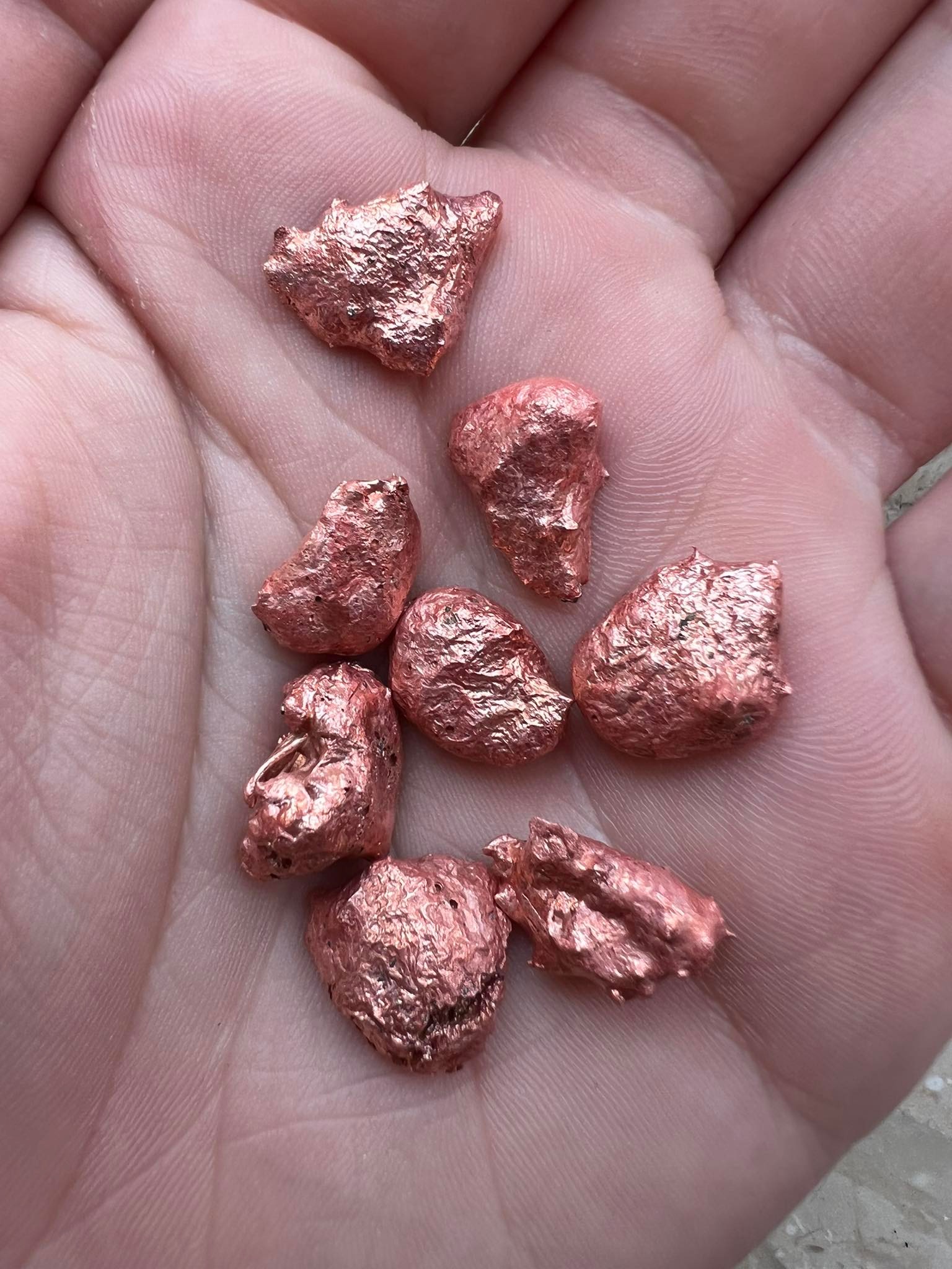

PostPosted: 29 Aug 2022 13:55
Joined: 14 Jul 2021 12:13
Posts: 333
Location: Georgia
granules i made from wires with my torch, just for fun. have more but still in dilute nitric acid to remove oxide layer.
299448615_1115043666088921_4049329860081995450_n.jpg [ 445.2 KiB | Viewed 13855 times ]
