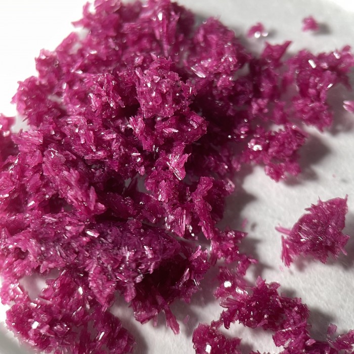

[Ni(phen)₃]Cl₂·7H₂O

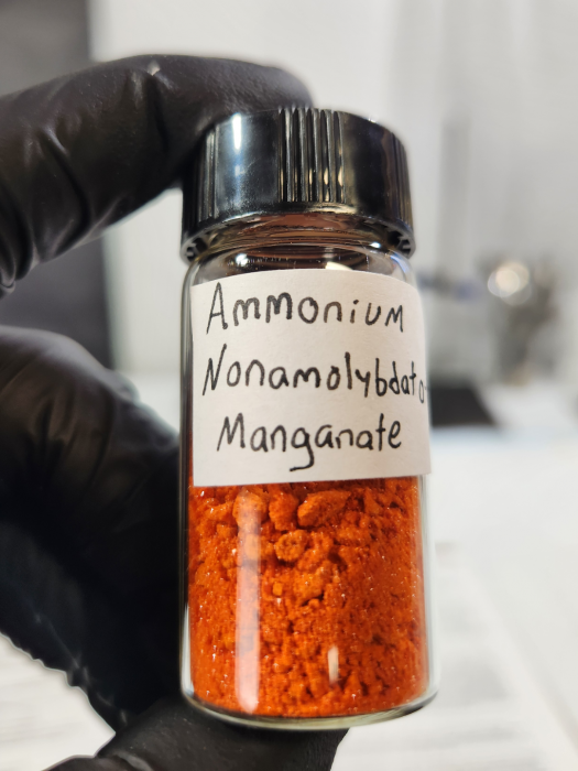

Ammonium Nonamolybdatomanganate
Ammonium nonamolybdatomanganate is a polyoxometalate compound containing ammonium, molybdenum, and manganese ions. It is prepared using ammonium heptamolybdate, potassium permanganate, and hydrogen peroxide, resulting in orange-colored crystals. This compound is an example of a polyoxometallate, which are metal-oxide clusters with diverse structures and applications
