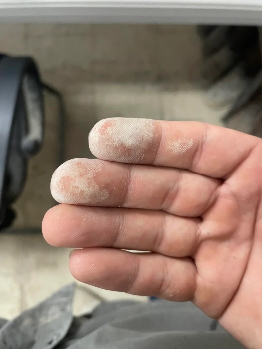

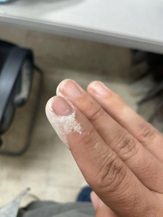

I just found out what Hydrogen Peroxide does to skin
What a way to find out my chemical gloves what holes in them. Slight stinging sensation. Was mixing Peroxide with Acetic acid to use as a cleaning solution for a heat exchanger on a distillation system
