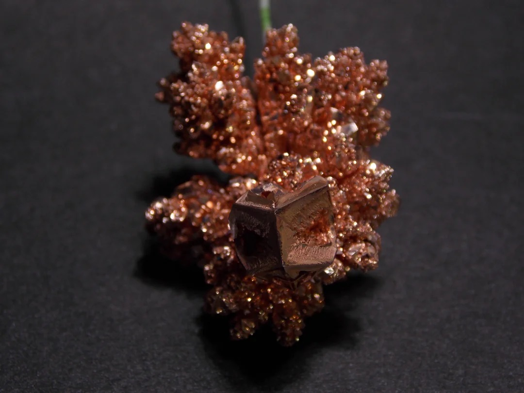

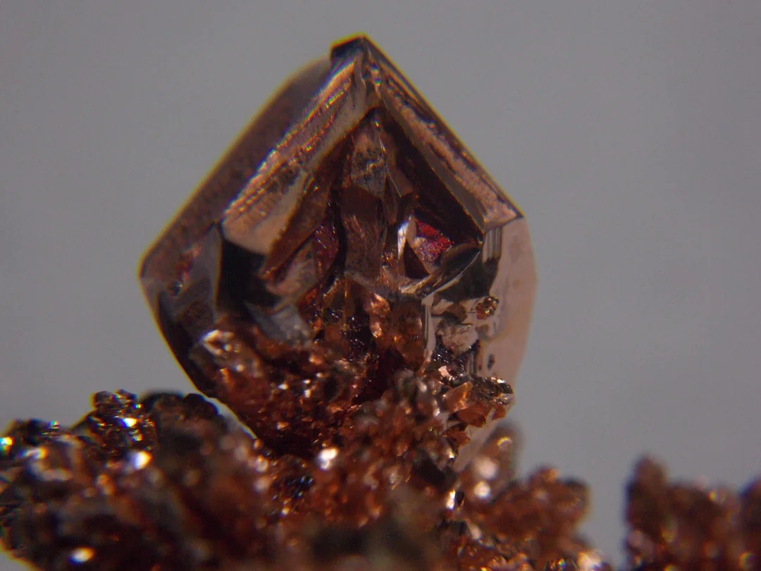

The biggest copper crystal I've grown so far
The electrolyte has 50 g/L of copper sulphate pentahydrate, ~50 mg/L of chloride, and some acetic acid every so often to prevent tarnishing. The current was around 10 mA in the beginning, and then slowly increased to 40 mA.
