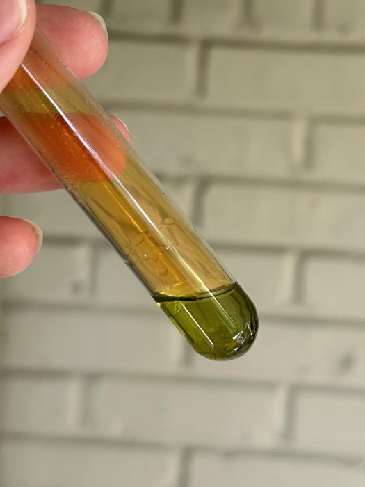

Dissolved nitrogen oxides after dissolution of rhenium in nitric acid as part of the ammonium perrhenate prep
