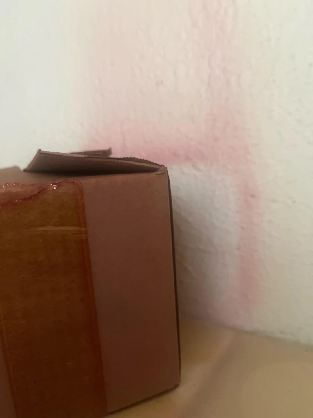

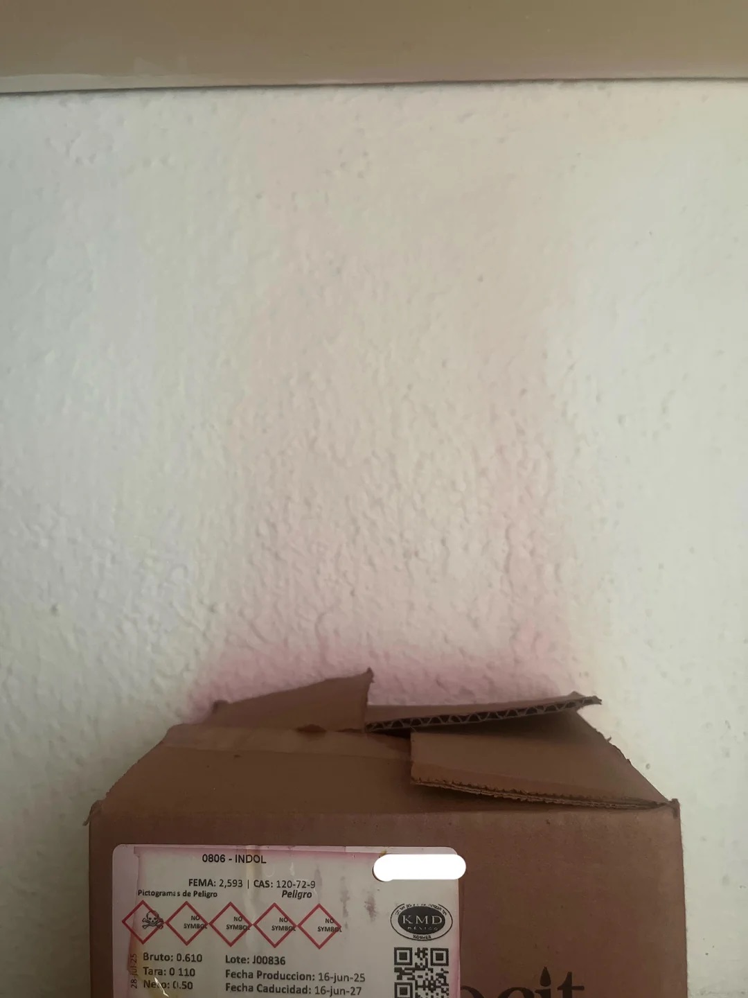

Box contains Indole crystals. They are inside a thick plastic bag, inside a plastic box with a screw lid on.
Just noticed this pink/magenta marks on the wall and all around the box.
