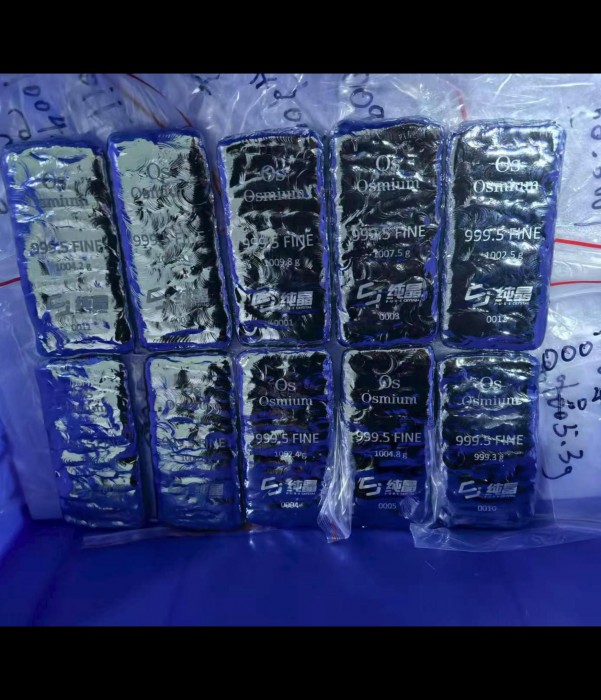

Osmium

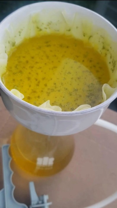

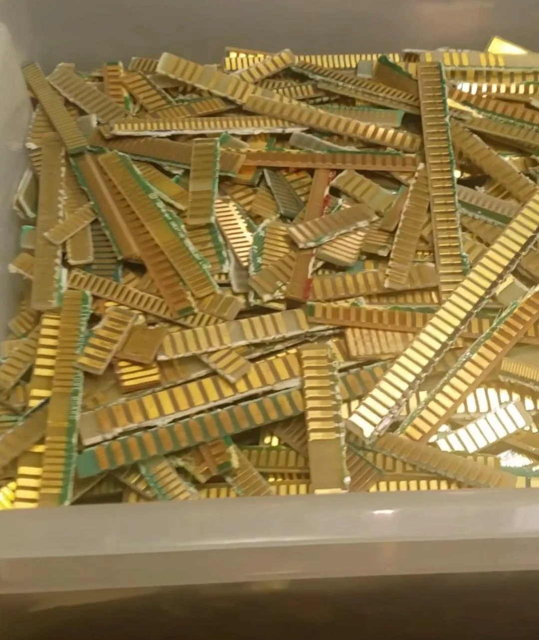

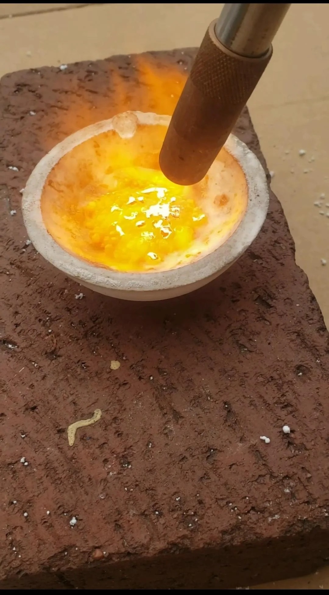

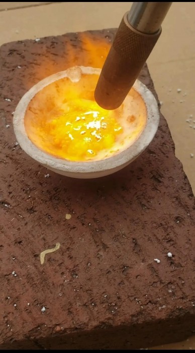

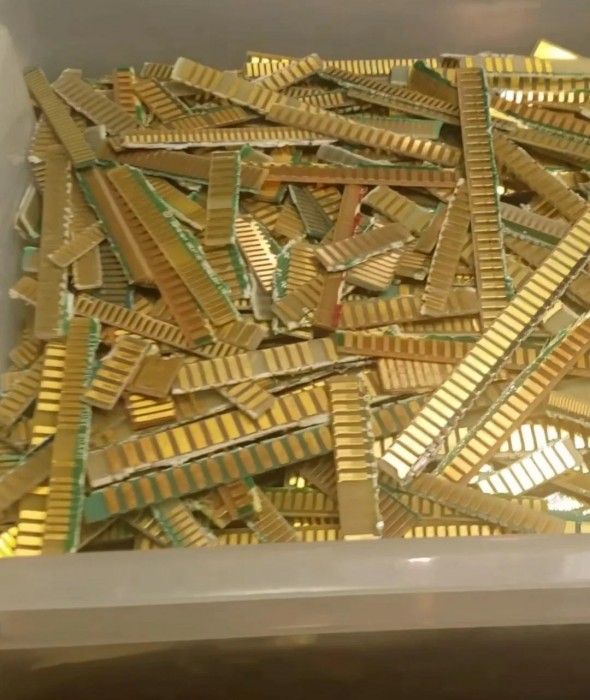

Gold recovery from computer parts
I took a stab at recovering the gold from computer scrap. I used the acid peroxide method (hydrochloric acid and peroxide) to dissolve the base metals holding the gold foils to the scrap boards, then used hydrochloric acid and bleach to dissolve the gold foils. I was pleased with the results. I attached the video in case anyone would like to see.
