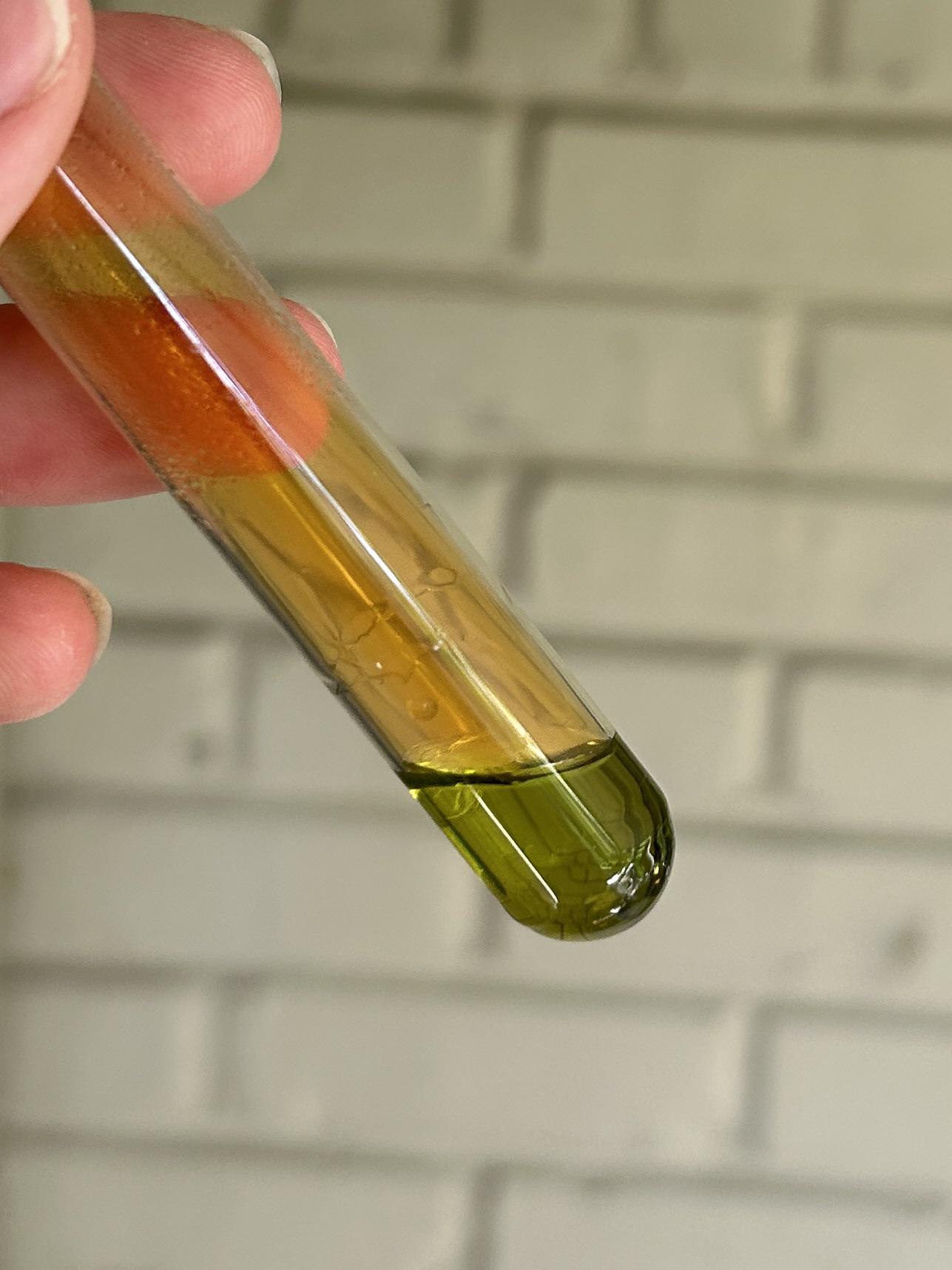

Dissolved nitrogen oxides after dissolution of rhenium in nitric acid as part of the ammonium perrhenate prep

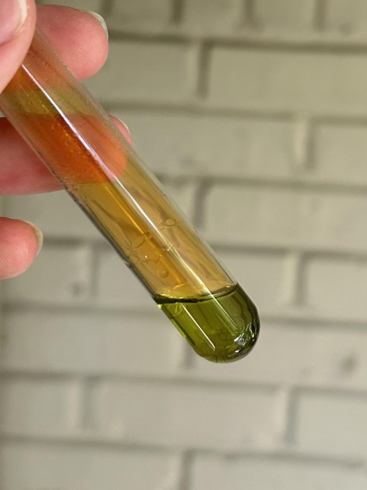

Some freshly prepared ammonium perrhenate

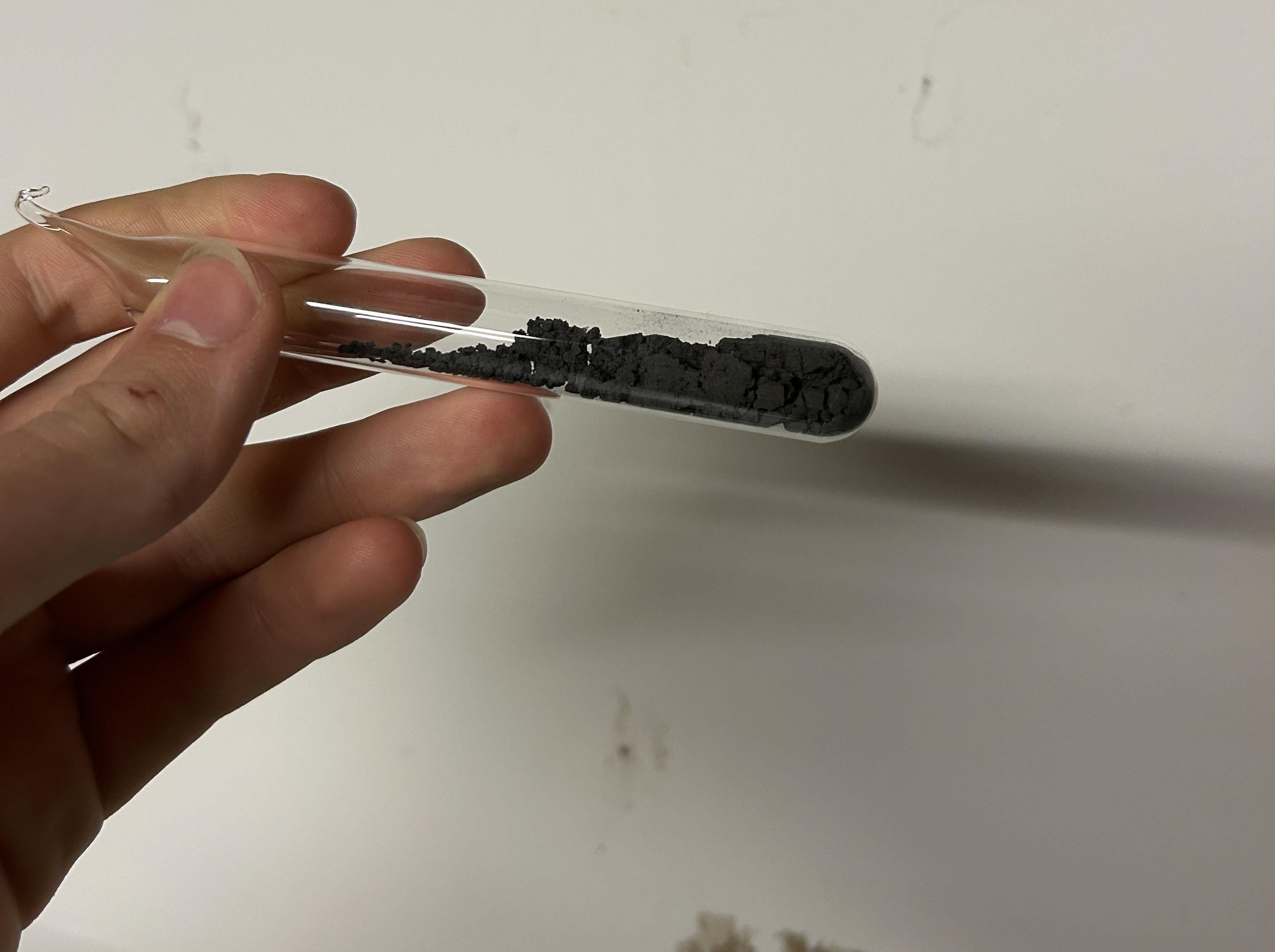

9.591g of ~99.95% Rhenium powder
