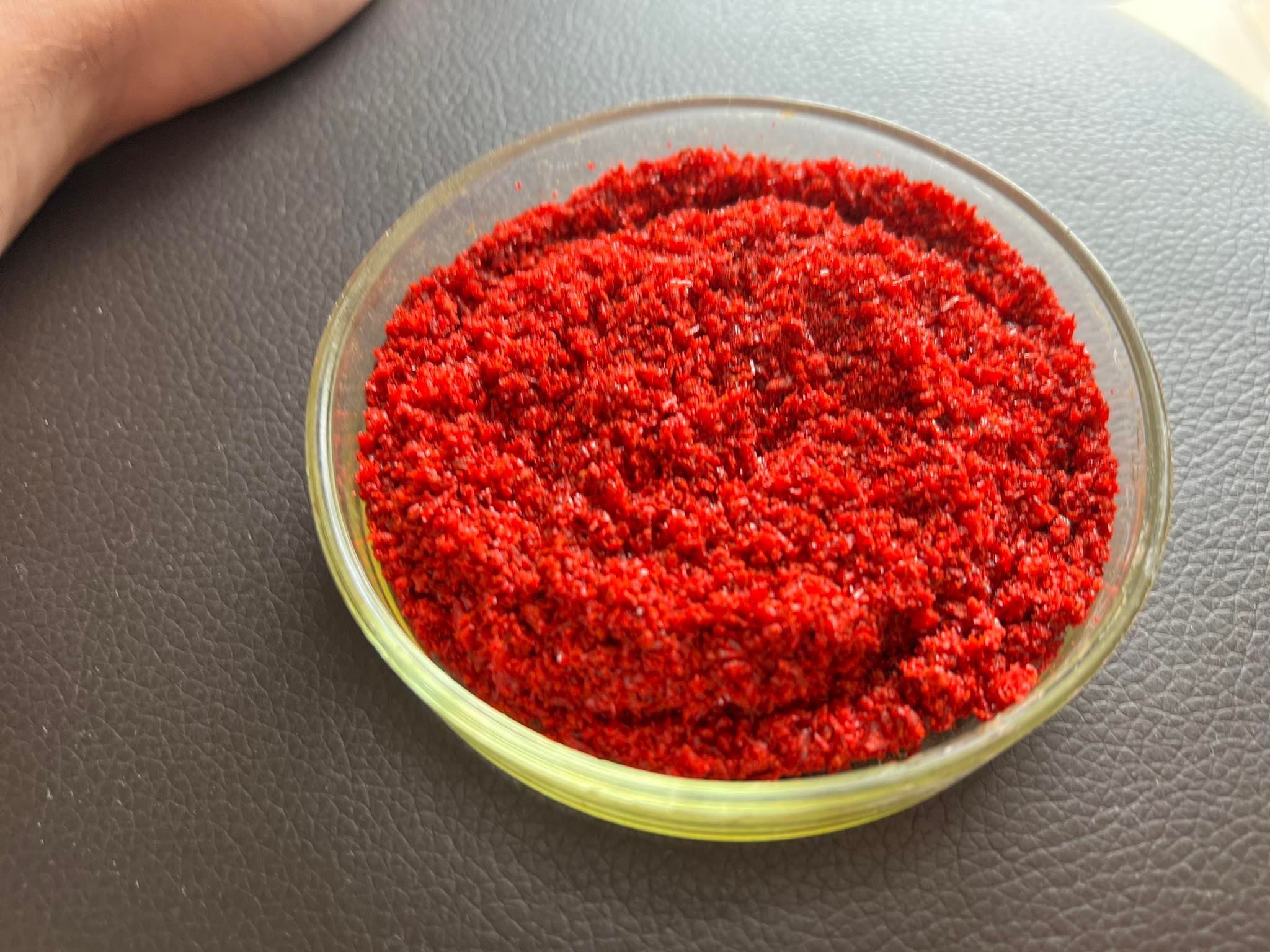

Ammonium trichromate - (NH4)2Cr3O10.
286117620_479692210585306_3314813265698980605_n.jpg [ 423.99 KiB | Viewed 15868 times ]

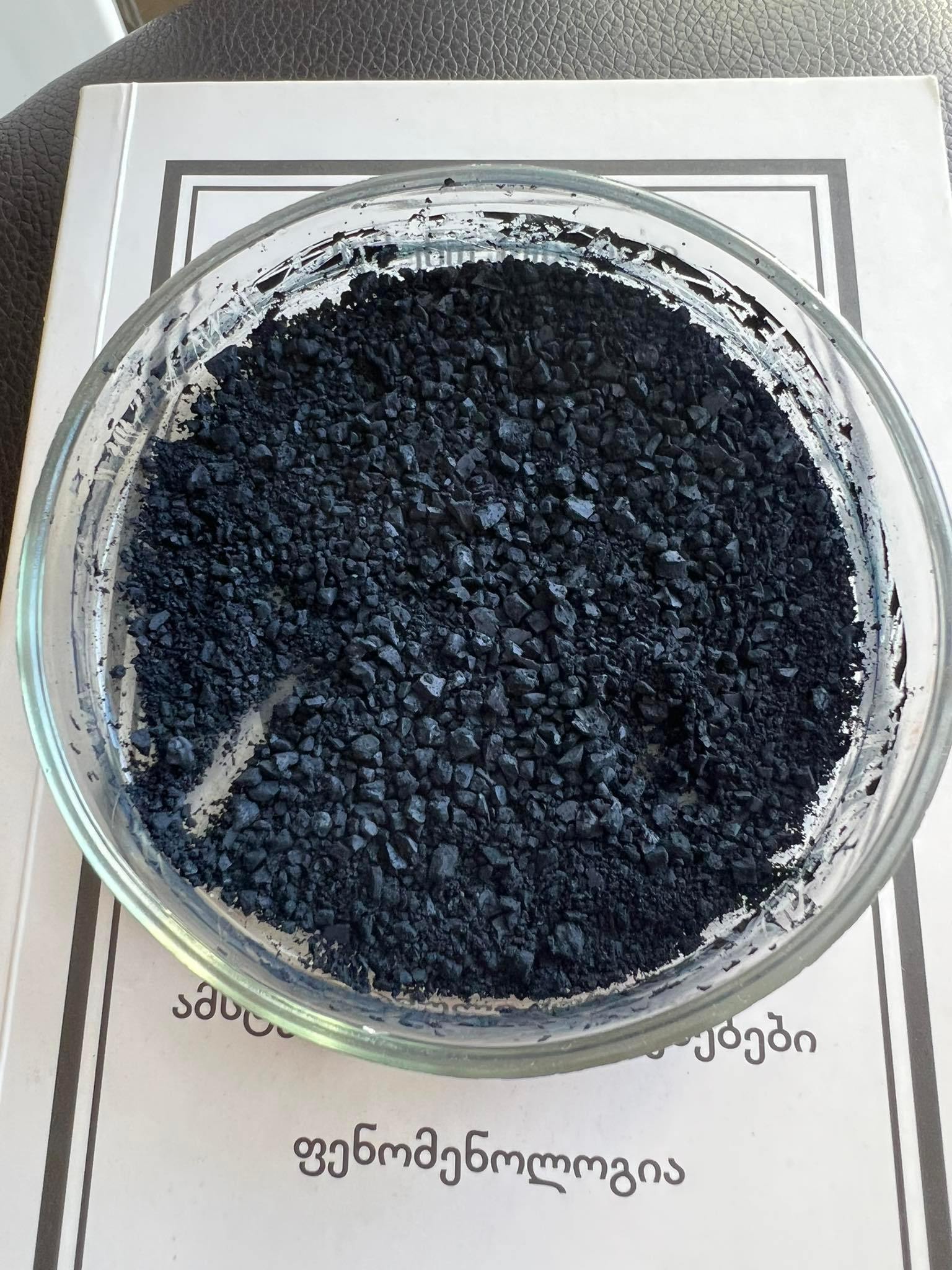

kind of molybdenum blue. made from reducing MoO3 with atomic hydrogen. contains for example Mo8O23·xH2O Mo4O11·xH2O.
290139379_5062703130495115_4096509170757317000_n.jpg [ 414.19 KiB | Viewed 15750 times ]
Now it is believed that the reducing agent is the surface of the metal (for example, zinc), not atomic hydrogen.

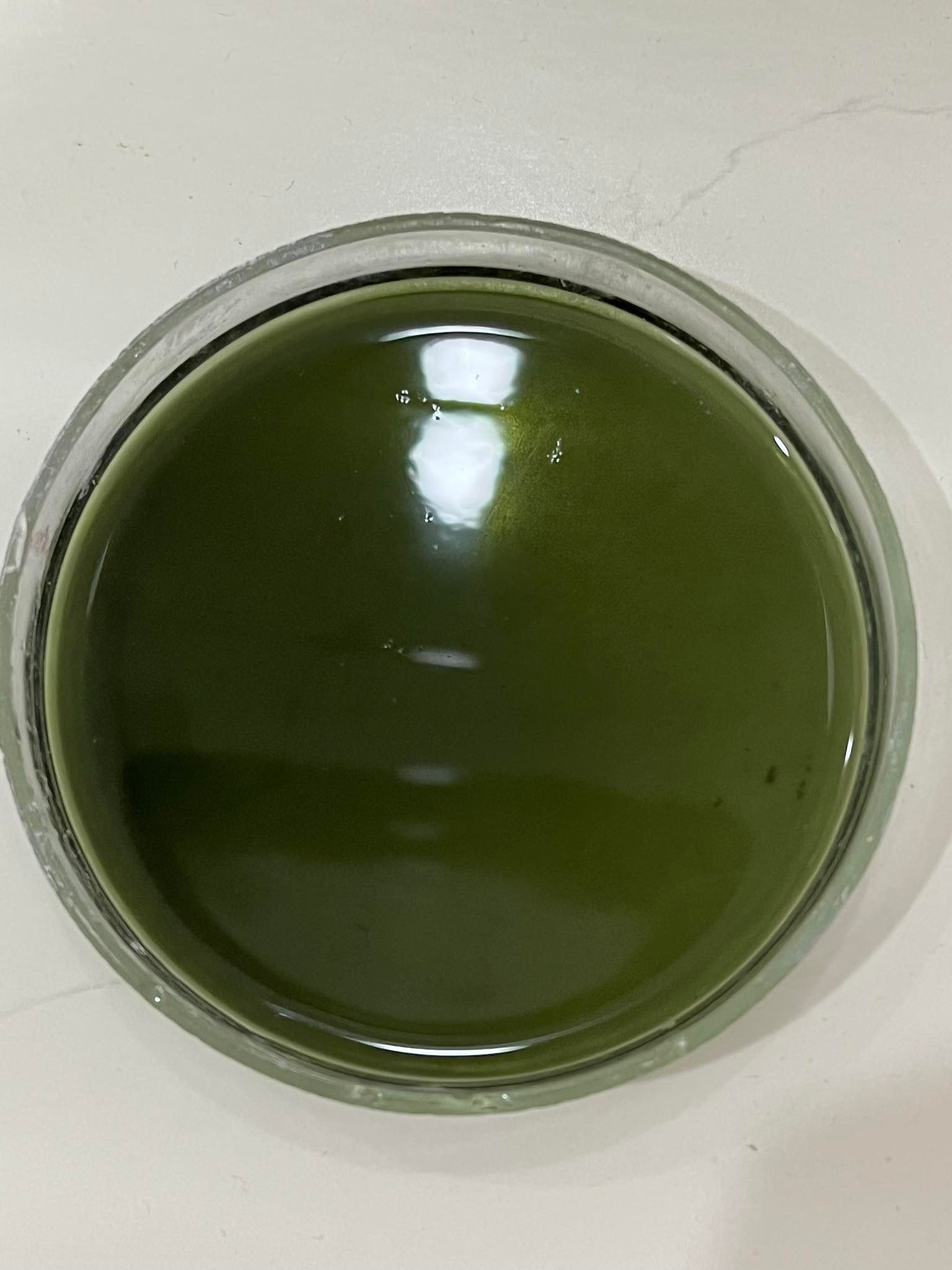

Hello! weeks ago I made molybdenum metal from trioxide thermite. I washed the metal with hydrochloric acid, there was some aluminum. then maybe a week ago I made powder from larger pieces. it was easy to crack them. when I made powder again I washed it with hydrochloric acid. I am just interested in the valence of molybdenum in this green solution. it's hard to see the color in a beaker because it's opaque, it has a very dark green almost black color.
the second photo is just this molybdenum, I just added a few drops of 1,10-phenanthroline solution and made a complex.
293868638_396495202355687_7401033927784387742_n.jpg [ 182.78 KiB | Viewed 15474 times ]
293674762_1653934661637892_4953288398142648209_n.jpg [ 146.01 KiB | Viewed 15474 times ]
Compounds of Mo(III) may be green.
