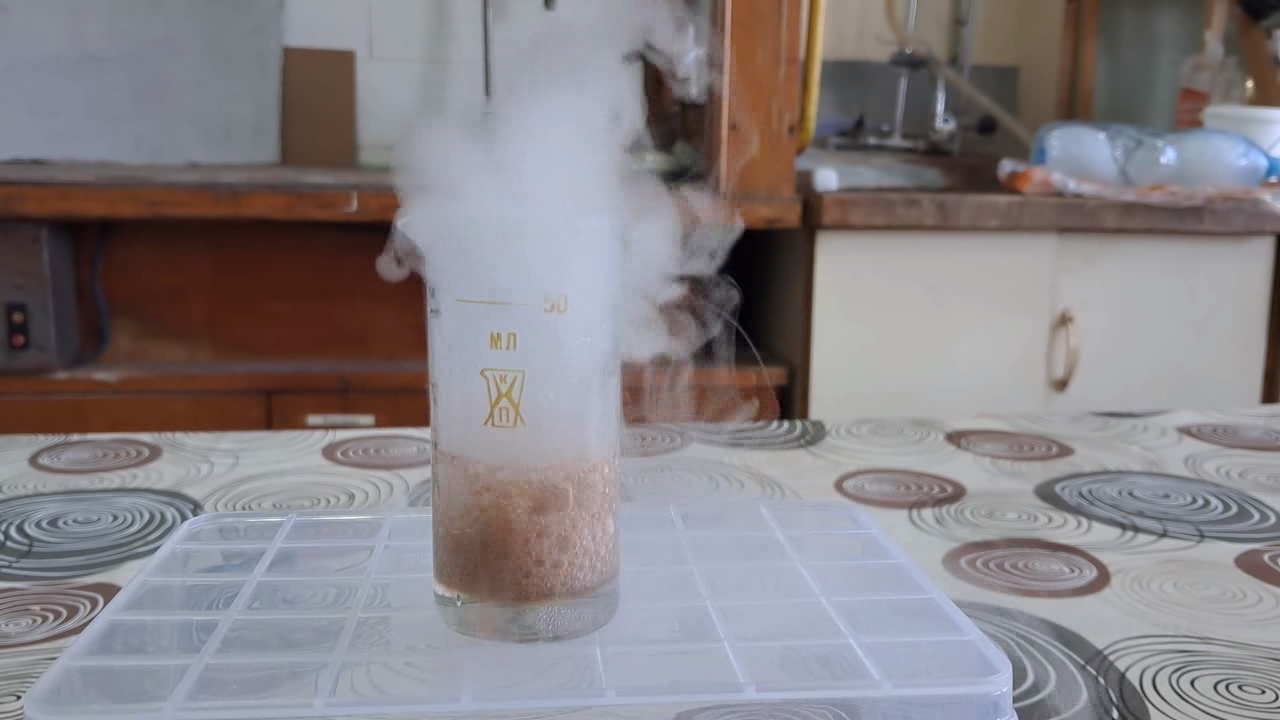

Didn't the Hydrogen Peroxide Decompose? (part 2)
http://chemistry-chemists.com/N1_2025/C ... .html#1002
Hydrogen_peroxide_and_potassium_permanganate-13.jpg [ 316.21 KiB | Viewed 5762 times ]

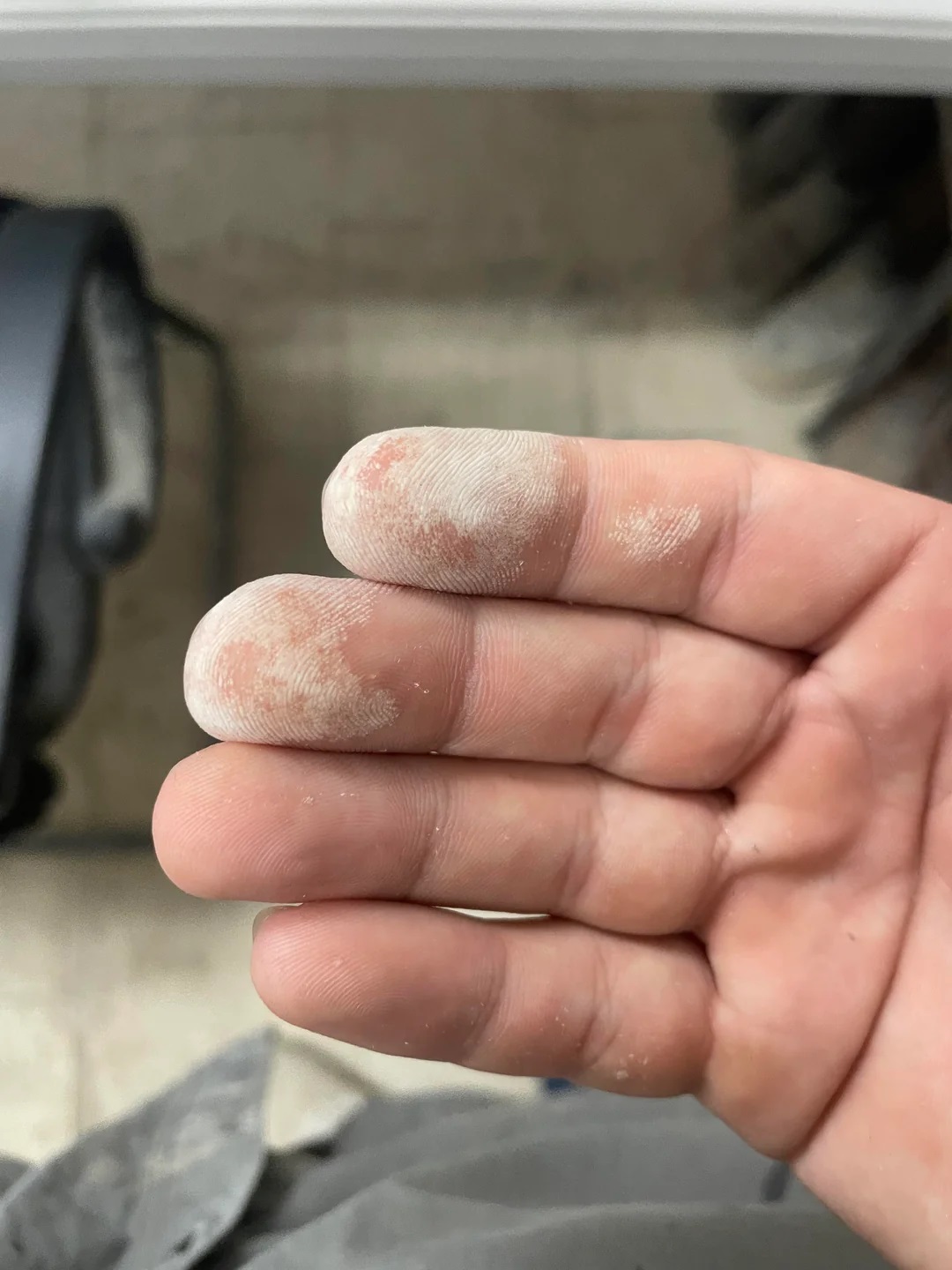

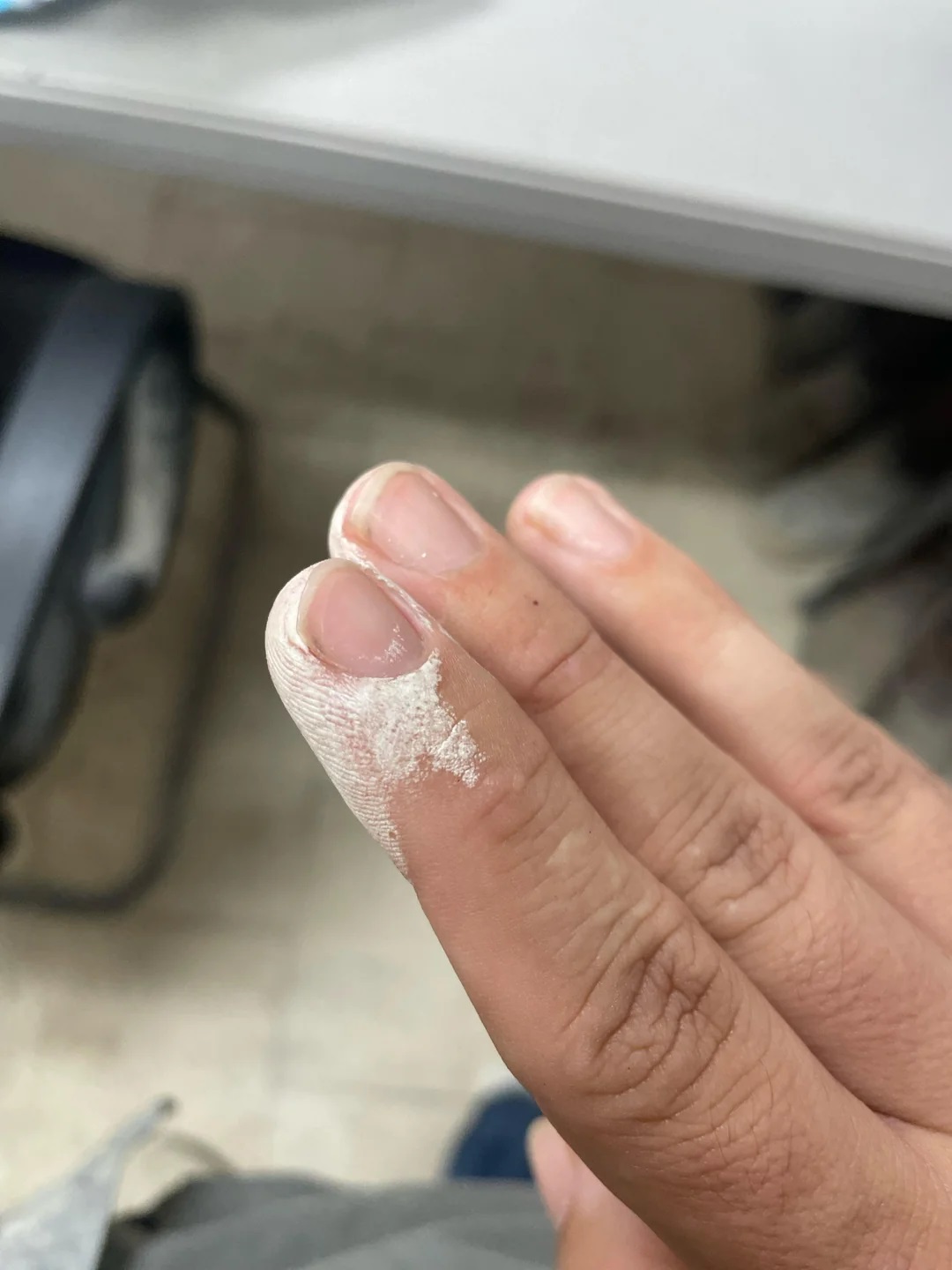

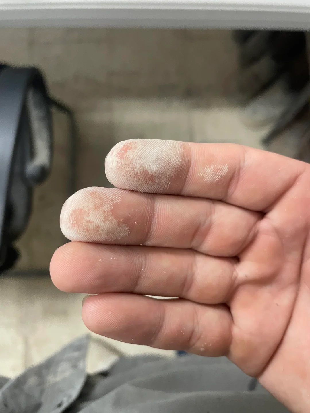

I just found out what Hydrogen Peroxide does to skin
What a way to find out my chemical gloves what holes in them. Slight stinging sensation. Was mixing Peroxide with Acetic acid to use as a cleaning solution for a heat exchanger on a distillation system
