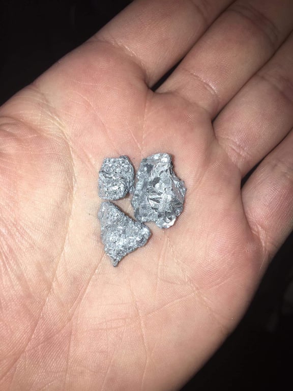

my antimony crystals.

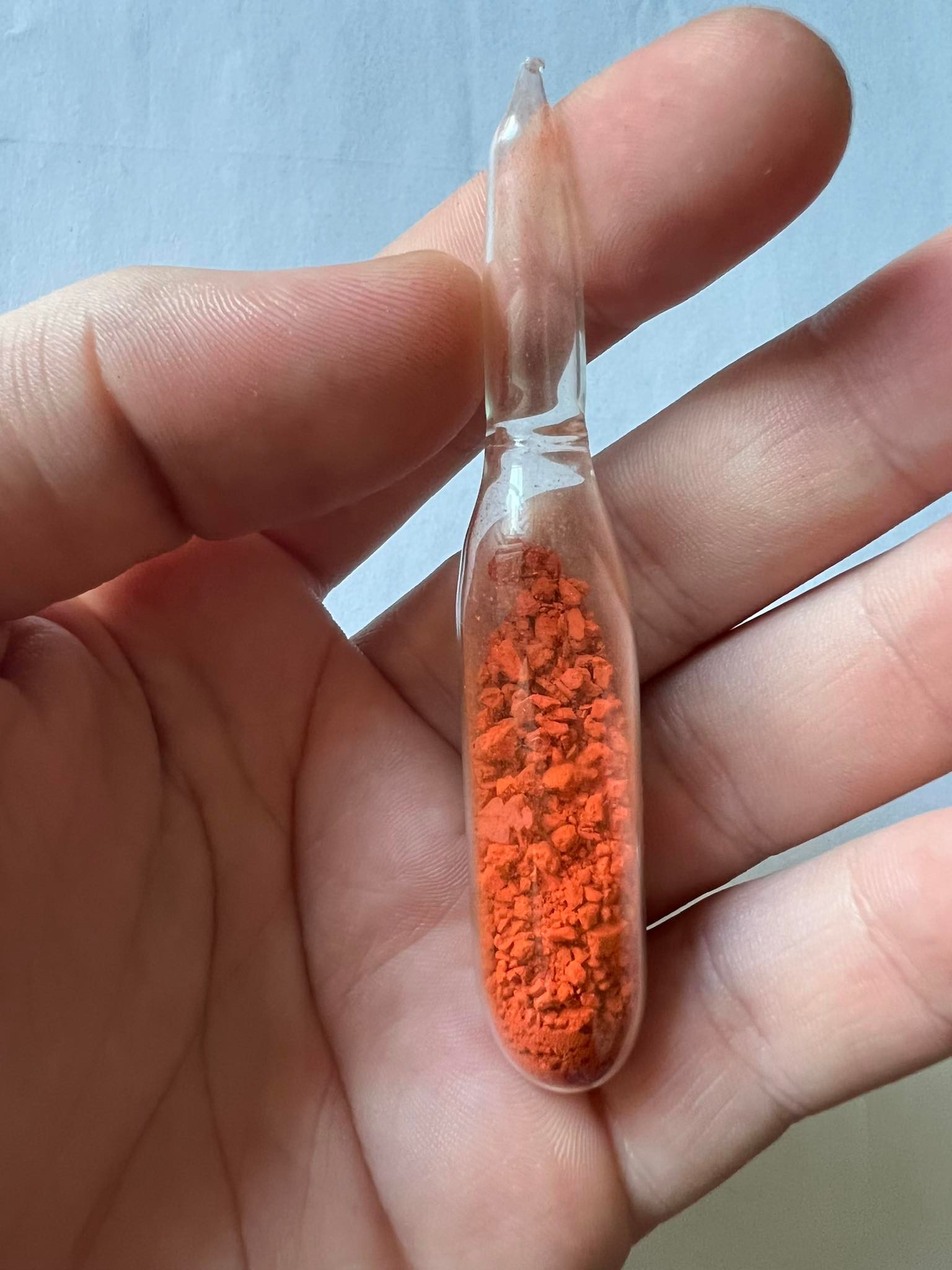

Oripment from Georgia mine. Photo from my lab.

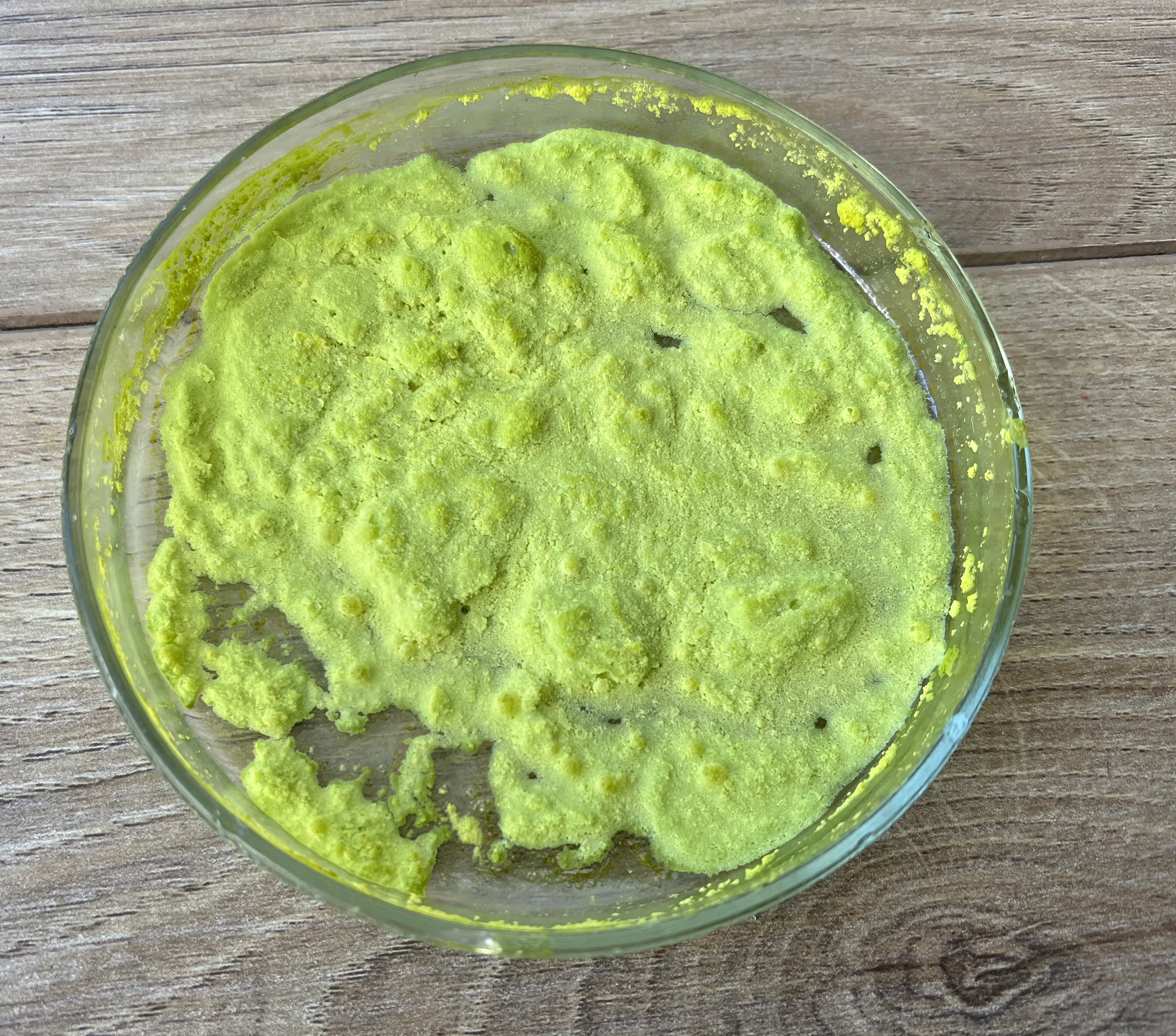

Hello! today I made Toluene-3,4-Dithiol and antimony(III) complex. I made a dichloroethane solution of dithiol and add antimony trichloride, then this complex precipitate.

after 1 hour drying.

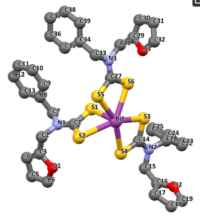

now I'm making bismuth complex. let's see what I will get. maybe it has a structure like in the photo. here on the link, there are dithiol-chloro complexes of bismuth, but I use nitrate because nitrate is a different ligand from halogens, I think bismuth doesn't has bonded with inorganic anion.
https://www.mdpi.com/1420-3049/25/2/305/htm

The nitrate anion can be an oxidizing agent, the halogen anions cannot.

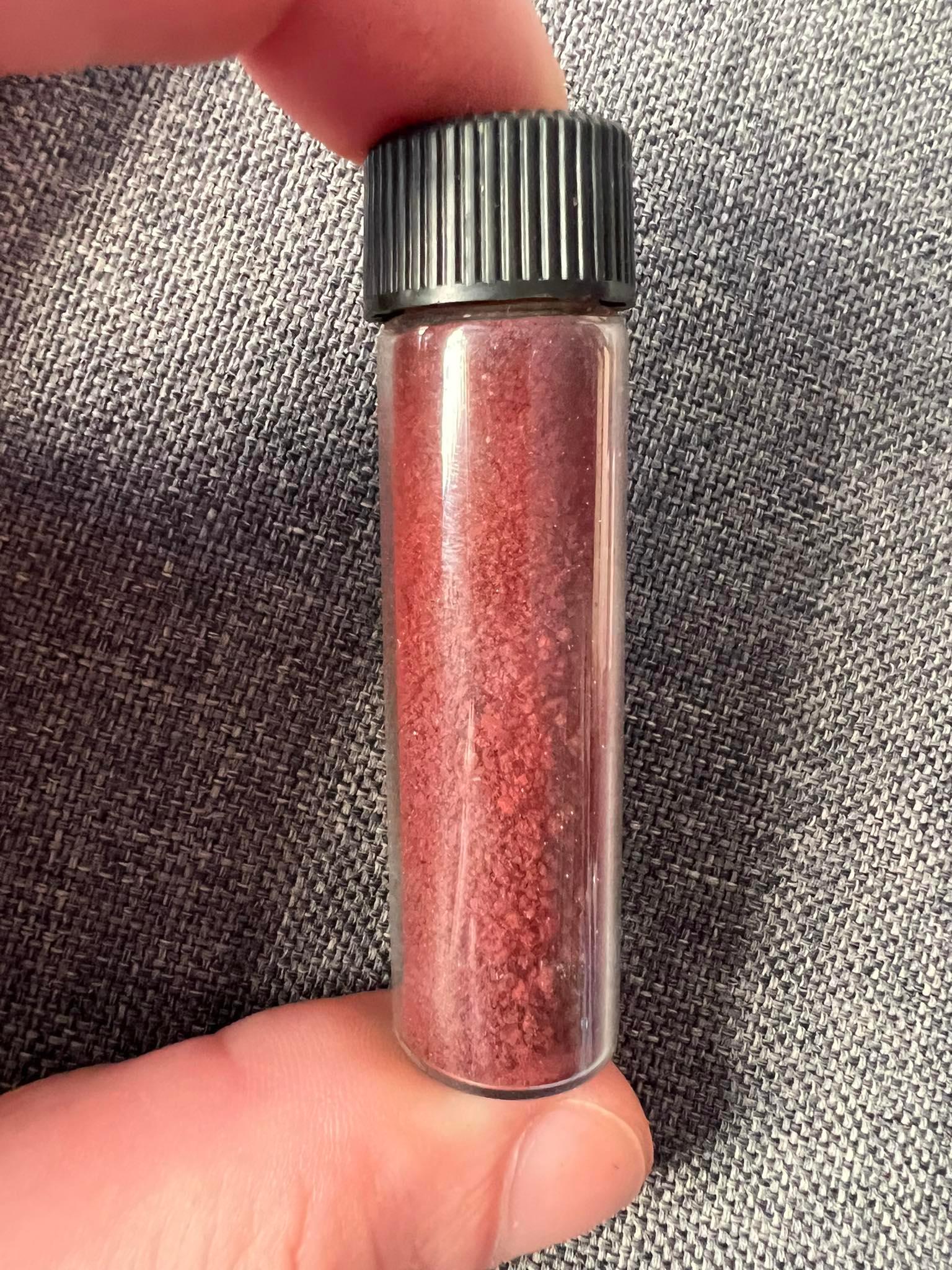

 Post subject: Re: Мышьяк, Сурьма и Висмут
PostPosted: 09 Sep 2022 17:47
Joined: 14 Jul 2021 12:13
Posts: 333
Location: Georgia

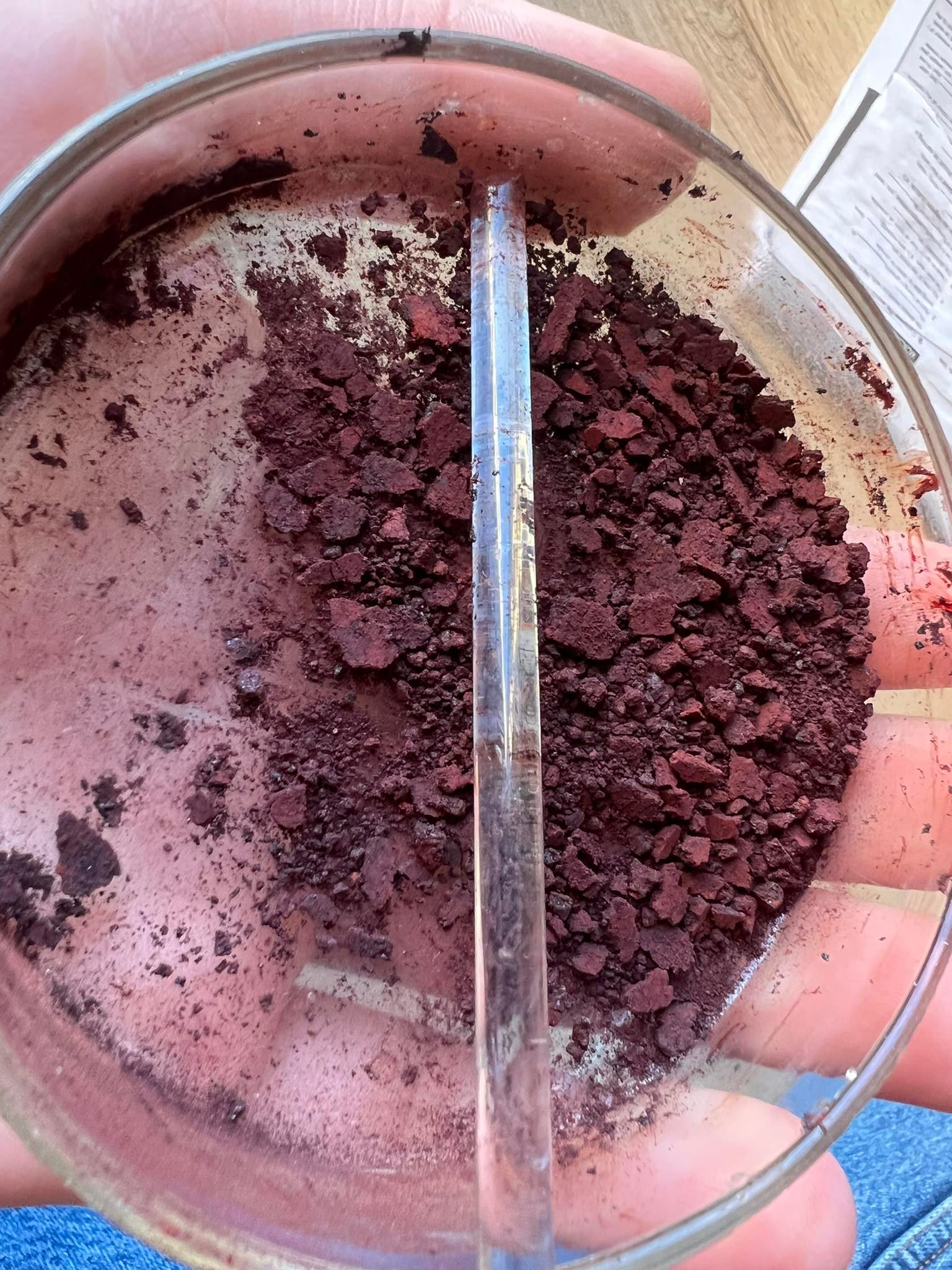

here are some photos. also when it was dry I saw that surface of the complex peace was black and inside it was red. as research said, which Volodymyr gave to me months ago has red color. so I think it decomposes in the atmosphere and produces black bismuth sulfide, now powder is in a vial and it has a red color, no more black.

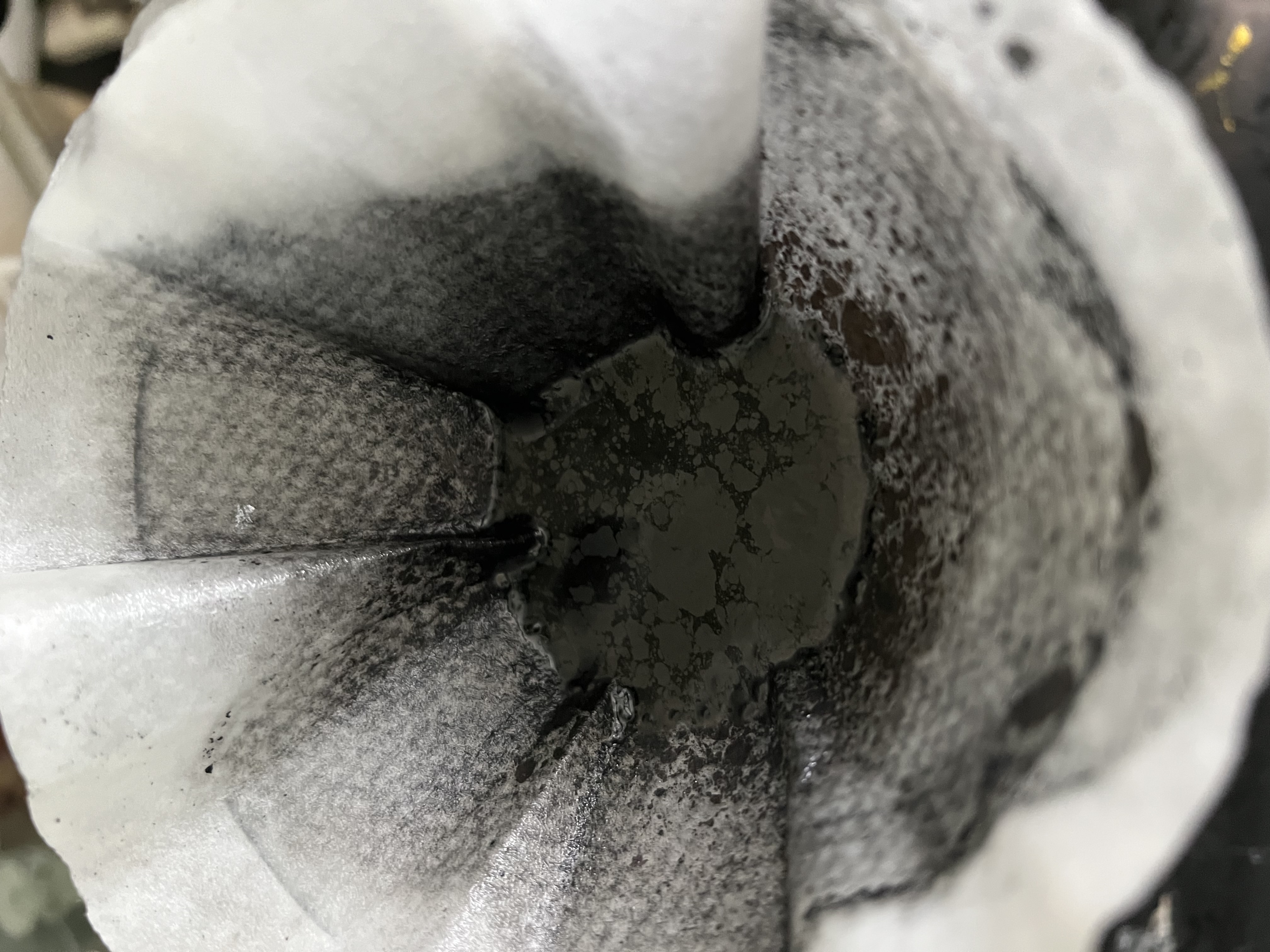

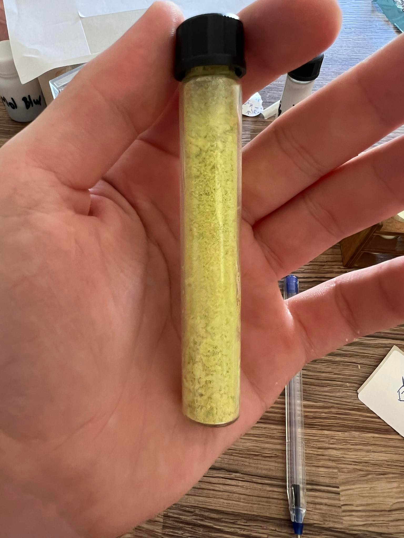

Location: Georgia

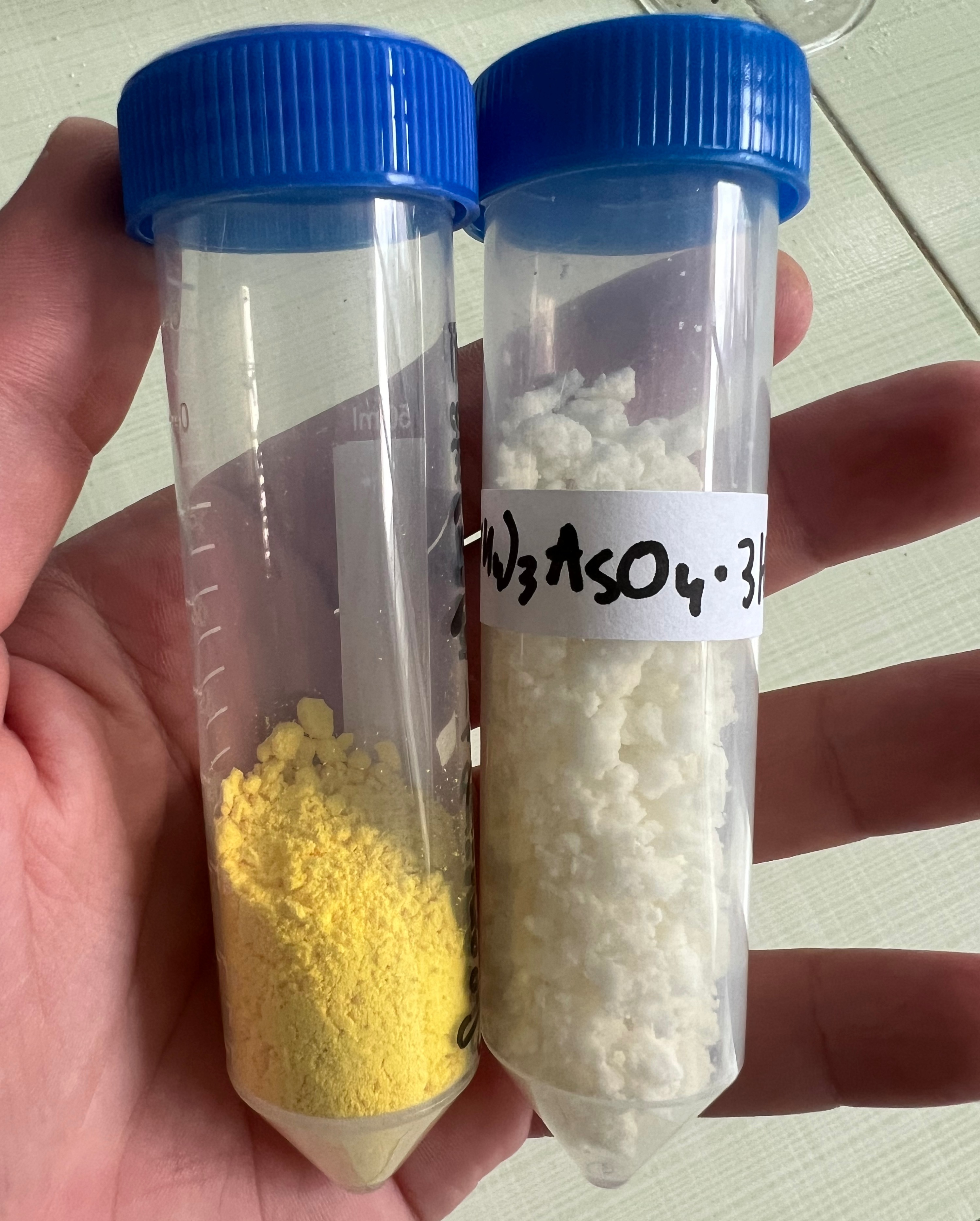

I made 12-molybdenic acid arsenate and ammonium arsenate trihydrate. Also I'm trying to make amorphous arsenic(filter paper)

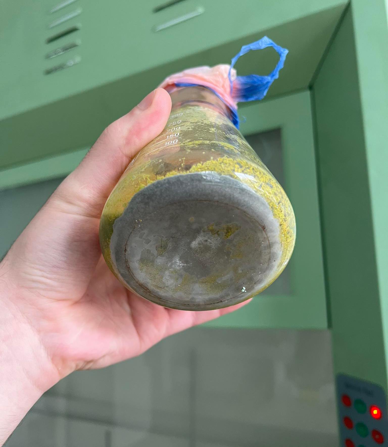

PostPosted: 10 Oct 2022 19:05
Posts: 333
Location: Georgia
after mentioned reaction: the undissolved silicate mineral, looks like sand now.
