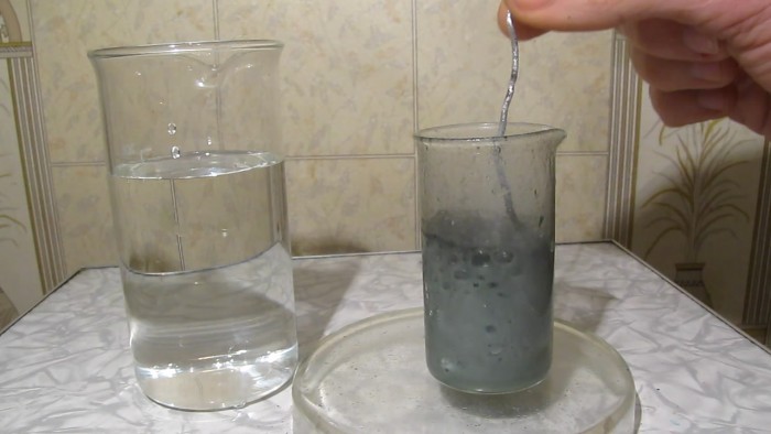

Осаждение металлического железа из раствора хлорида железа (III)
The precipitation of metallic iron from a solution of iron (III) chloride
http://chemistry-chemists.com/N3_2016/C ... P12-1.html
precipitation_of_metallic_iron_from_solution_of_iron_III_chloride-12[1].jpg [ 137.08 KiB | Viewed 15972 times ]

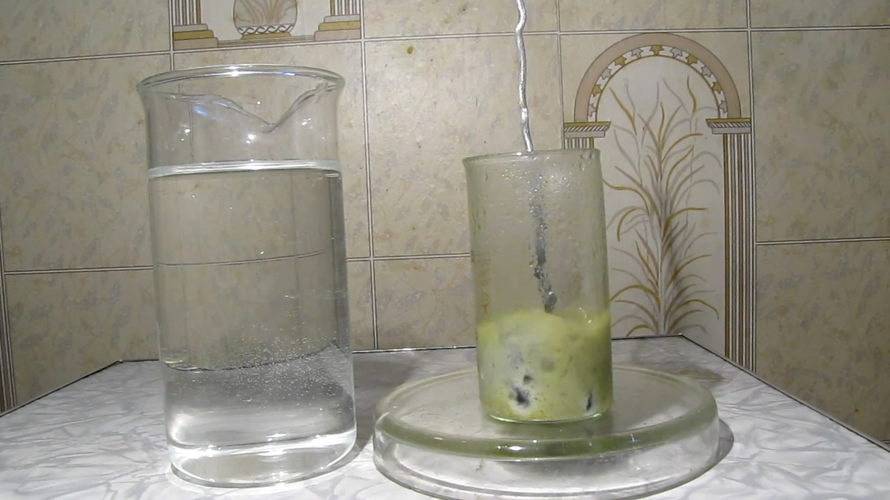

Украинская монета 5 копеек и соляная кислота
Ukrainian coin of 5 kopecks (stainless steel) and hydrochloric acid
http://chemistry-chemists.com/N3_2016/C ... P14-1.html
Ukrainian_coin_of_5_kopecks_stainless_steel_and_hydrochloric_acid-12[1].jpg [ 127.65 KiB | Viewed 15938 times ]

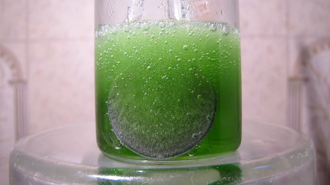

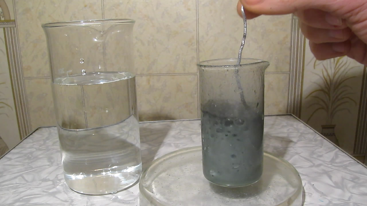

Осаждение металлического железа из раствора хлорида железа ч.2
Precipitation of metallic iron from solution of iron chloride
Precipitation-of-metallic-iron-from-solution-8[1].jpg [ 117.82 KiB | Viewed 15836 times ]
