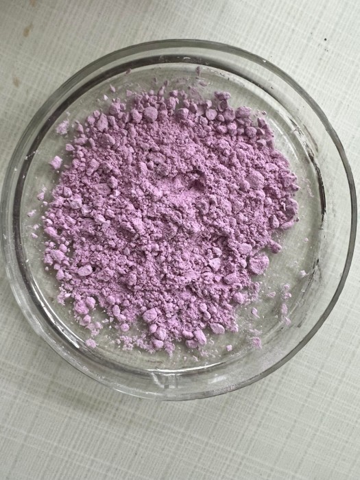

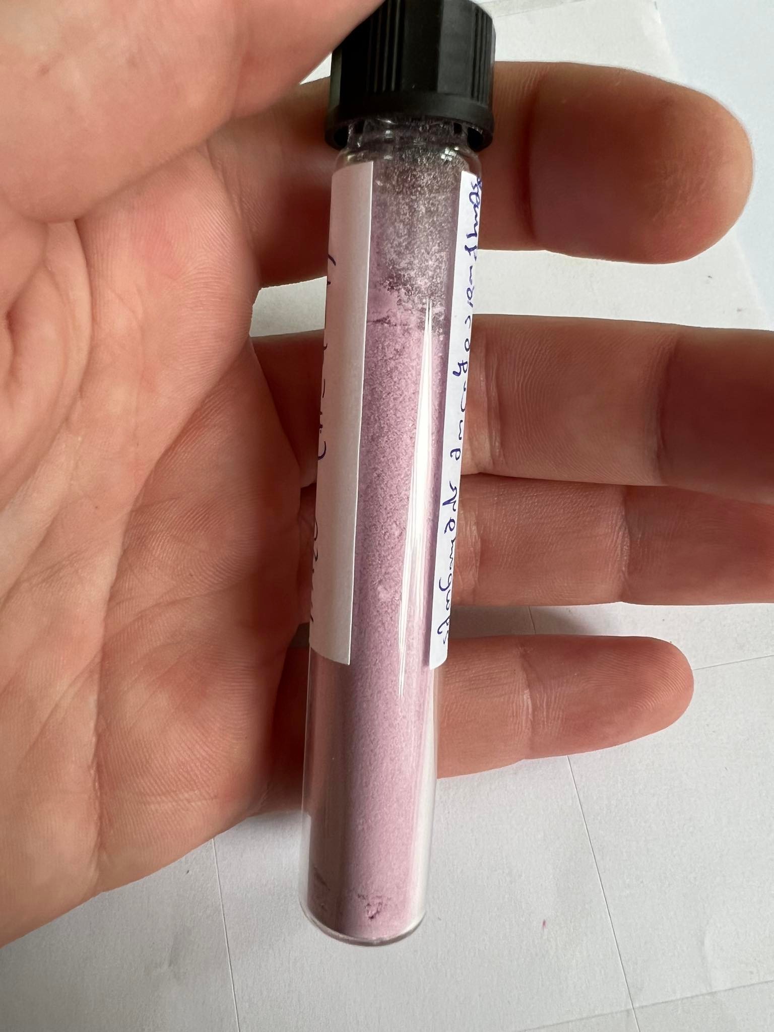

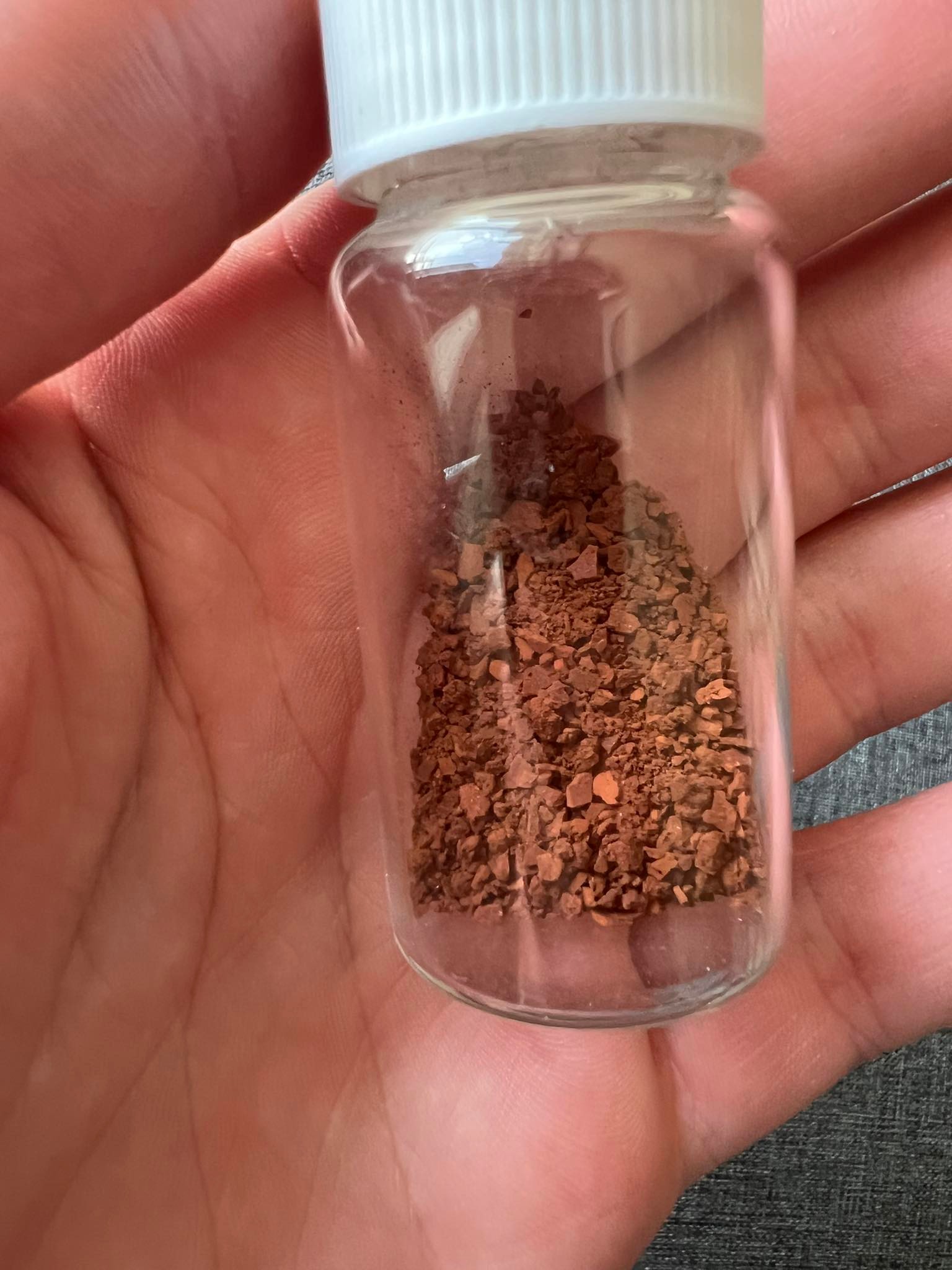

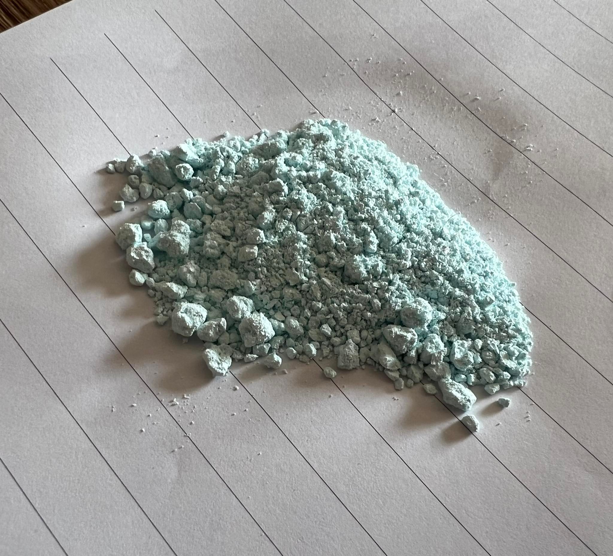

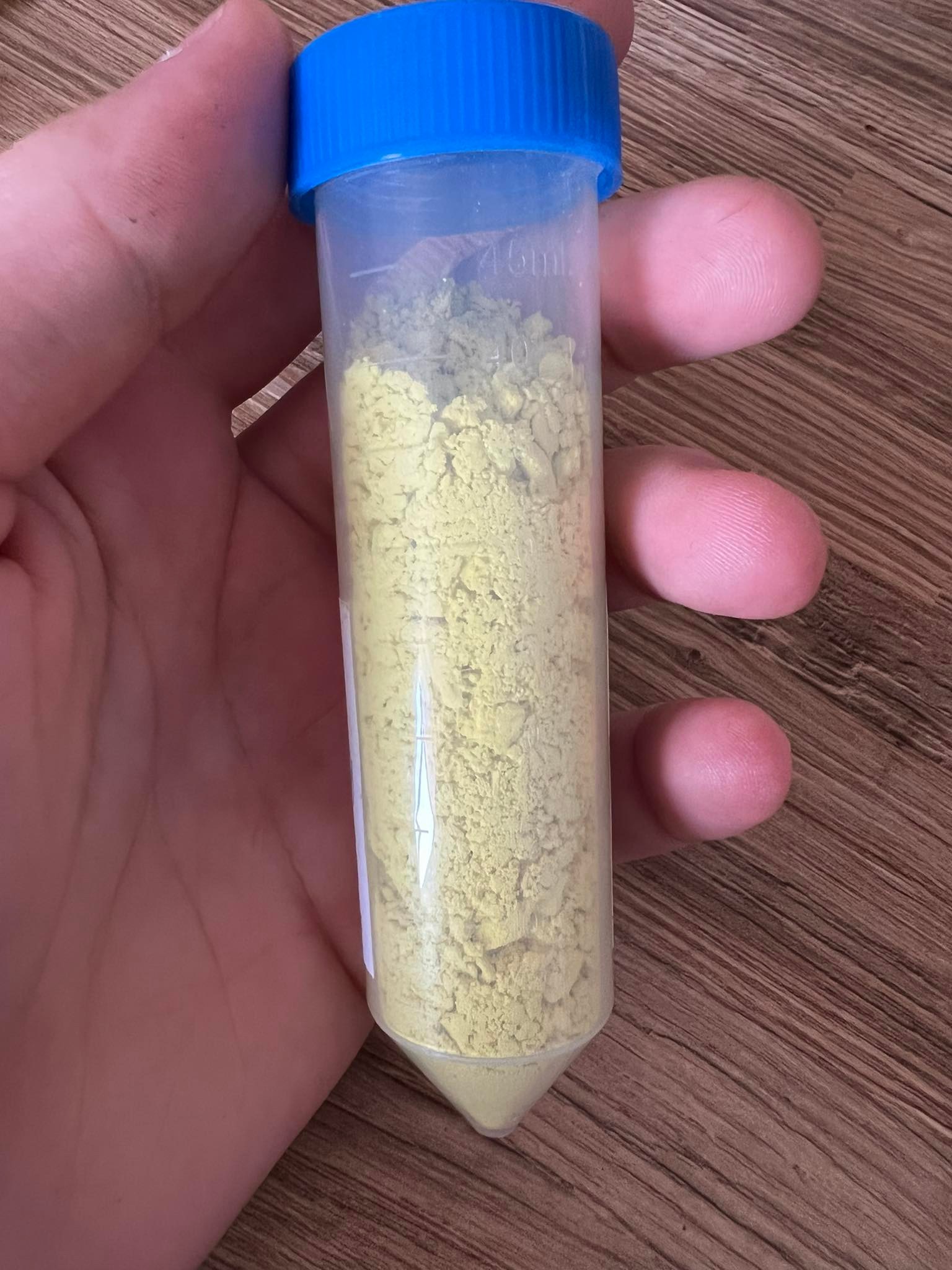

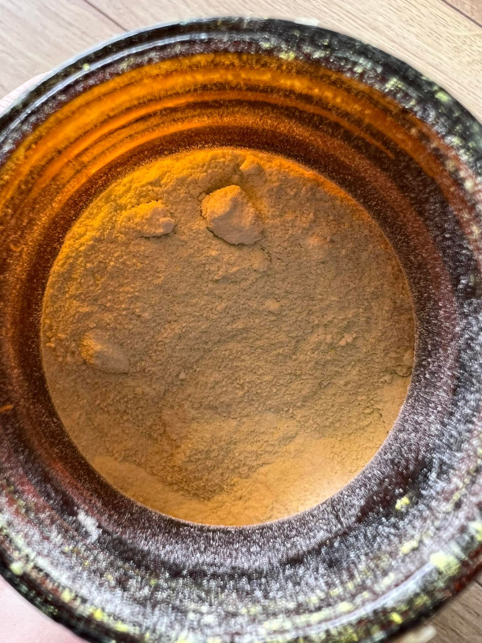

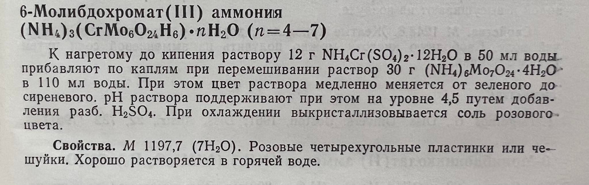

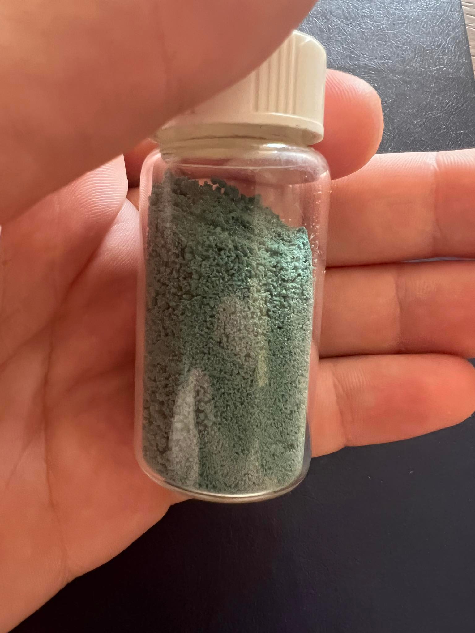

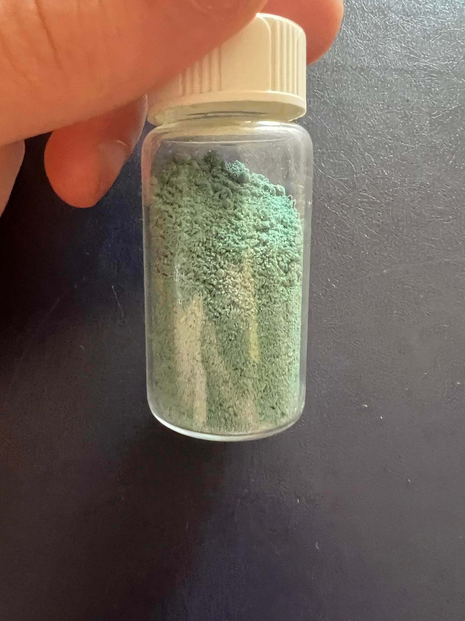

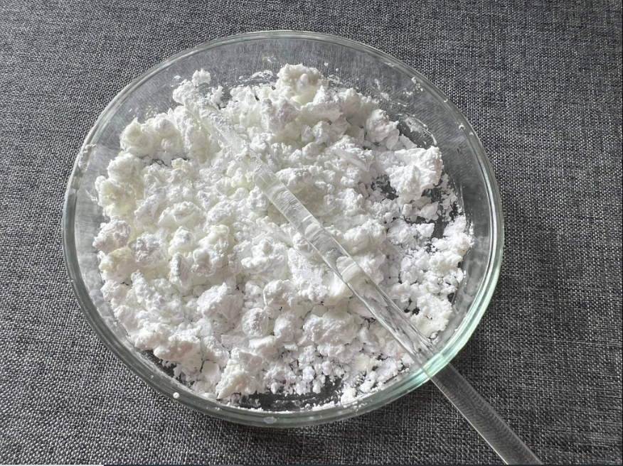

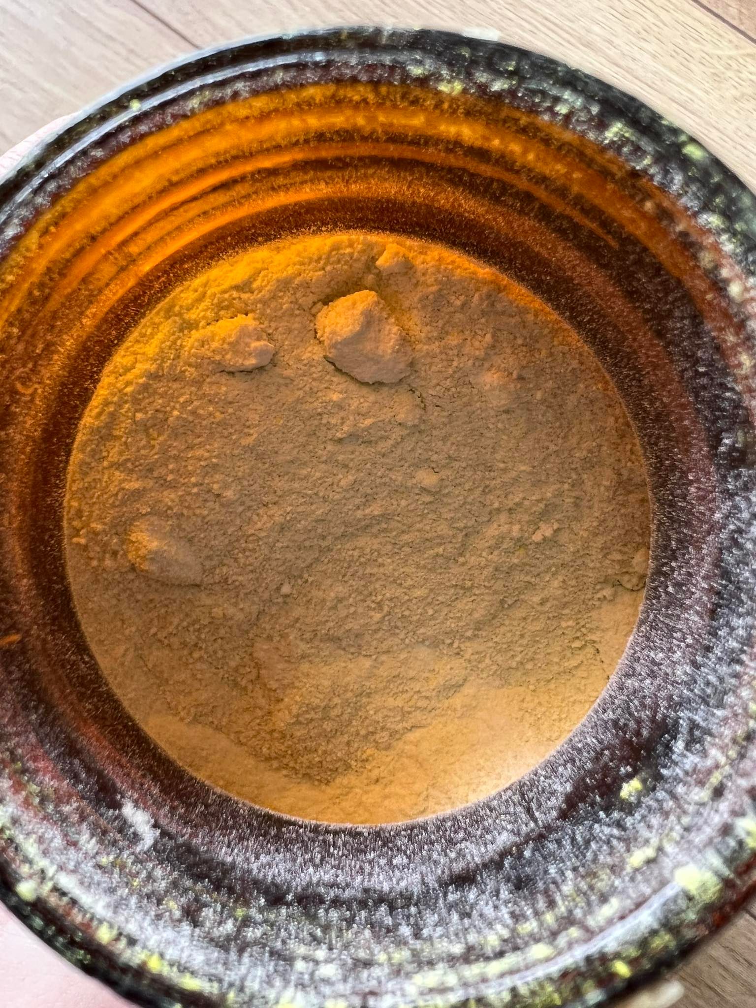

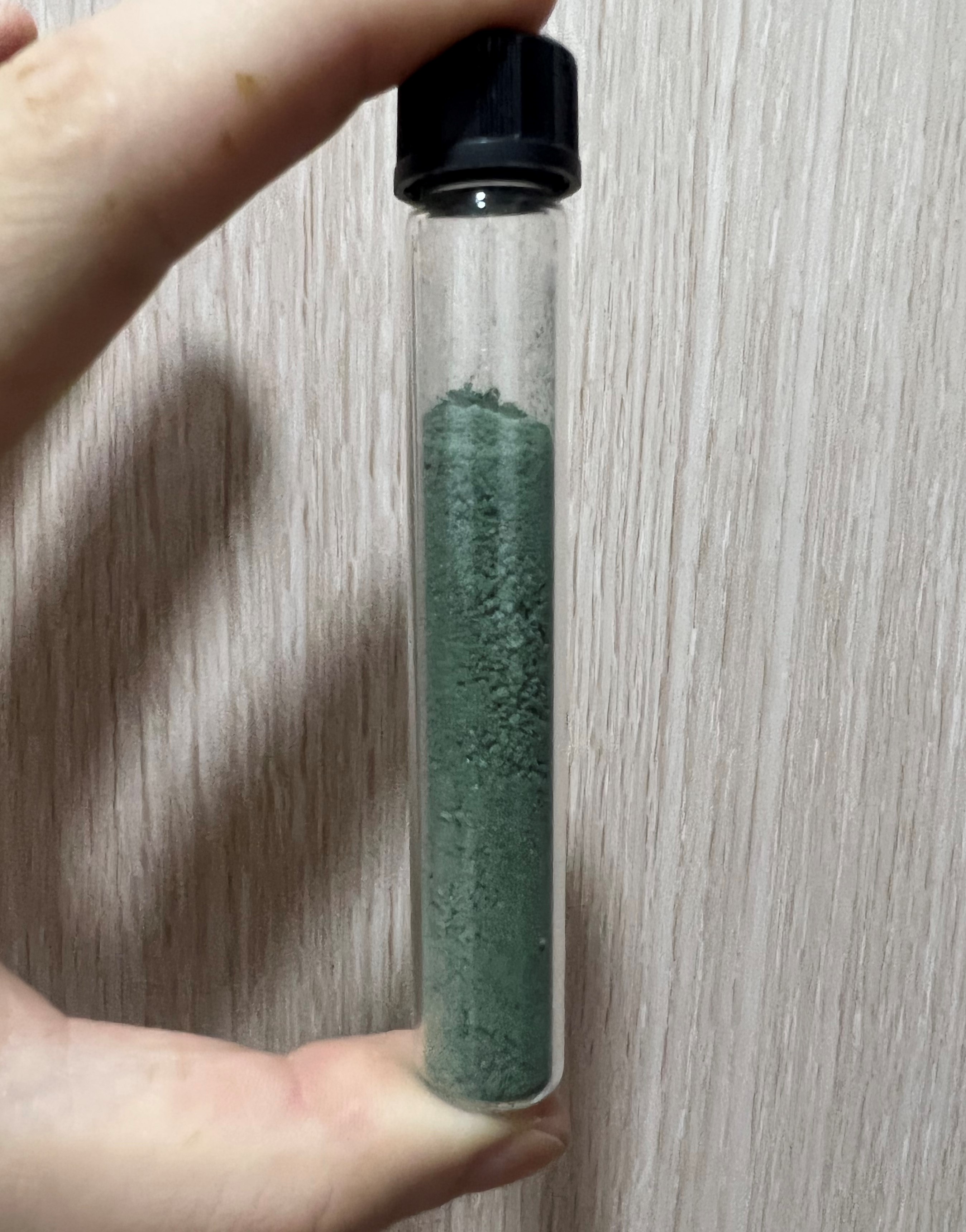

Ammonium 6-molybdochromate(III) - (NH4)3[CrMo6O24H6] •nH2O. n= 4-7.
286838293_385957593511246_2819810650398474445_n.jpg [ 217.41 KiB | Viewed 23632 times ]
288295846_600554554745410_5183079629817899677_n.jpg [ 514.57 KiB | Viewed 23633 times ]
286916406_751791052490400_7387321403692789358_n.jpg [ 285.65 KiB | Viewed 23633 times ]

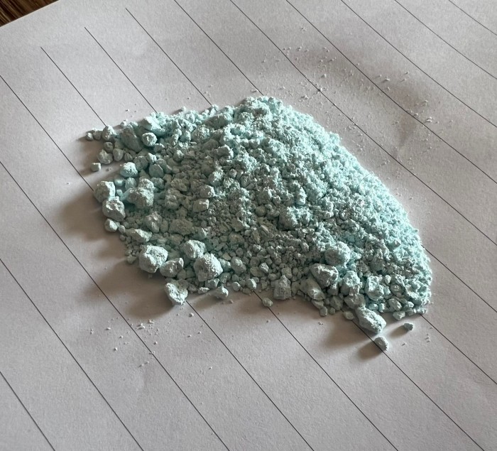

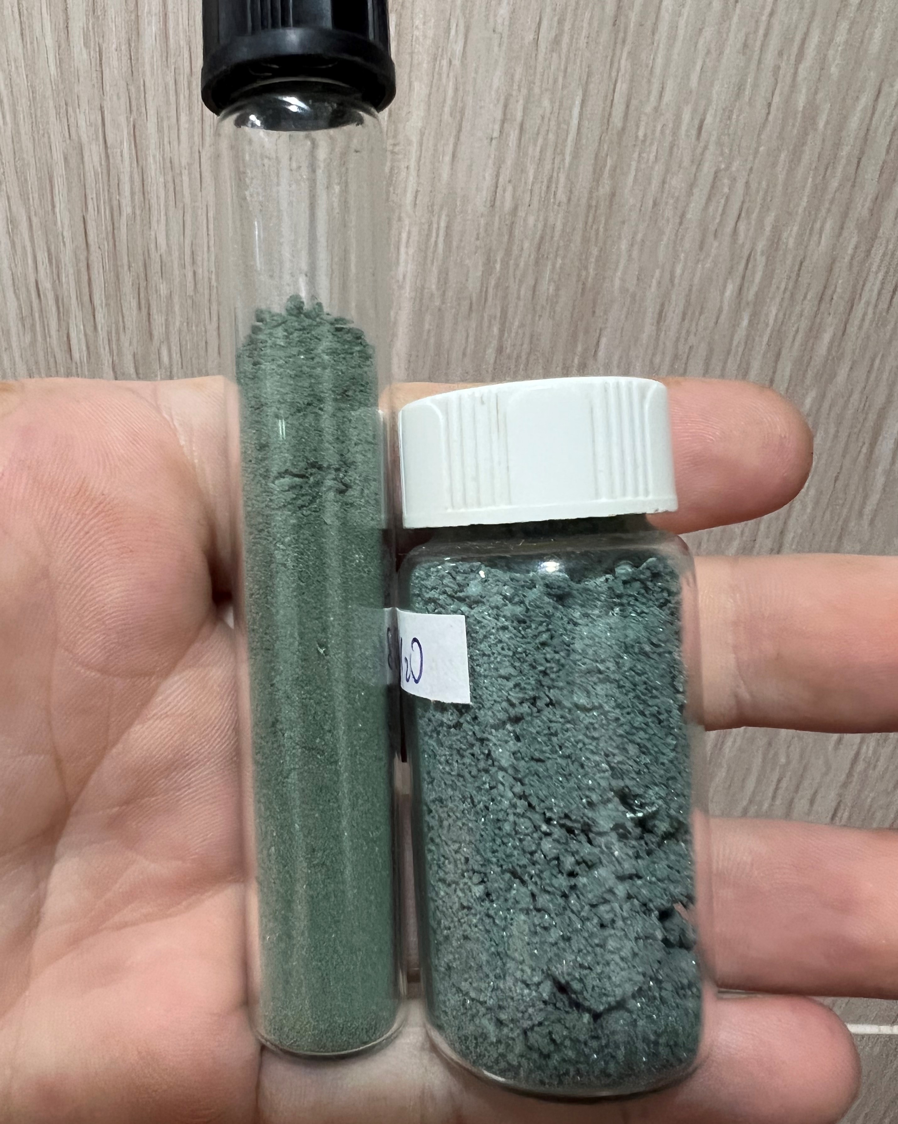

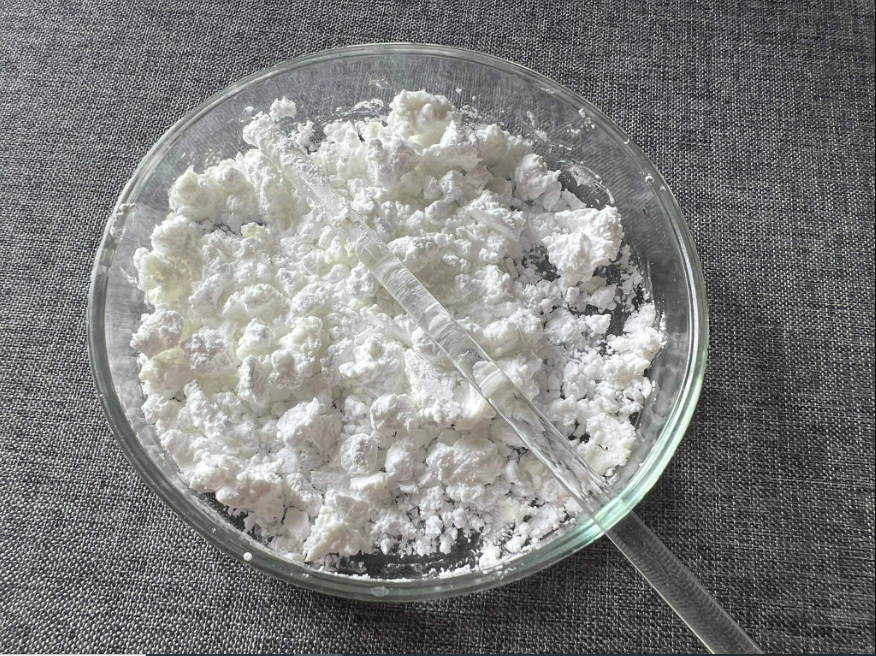

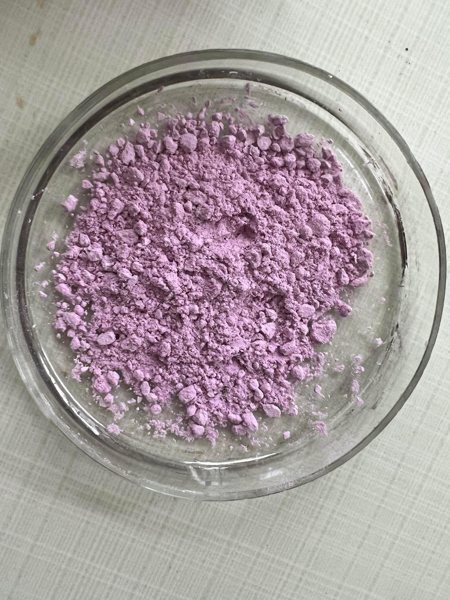

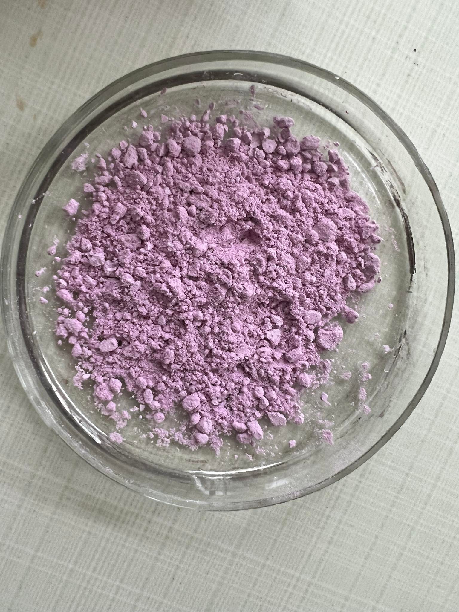

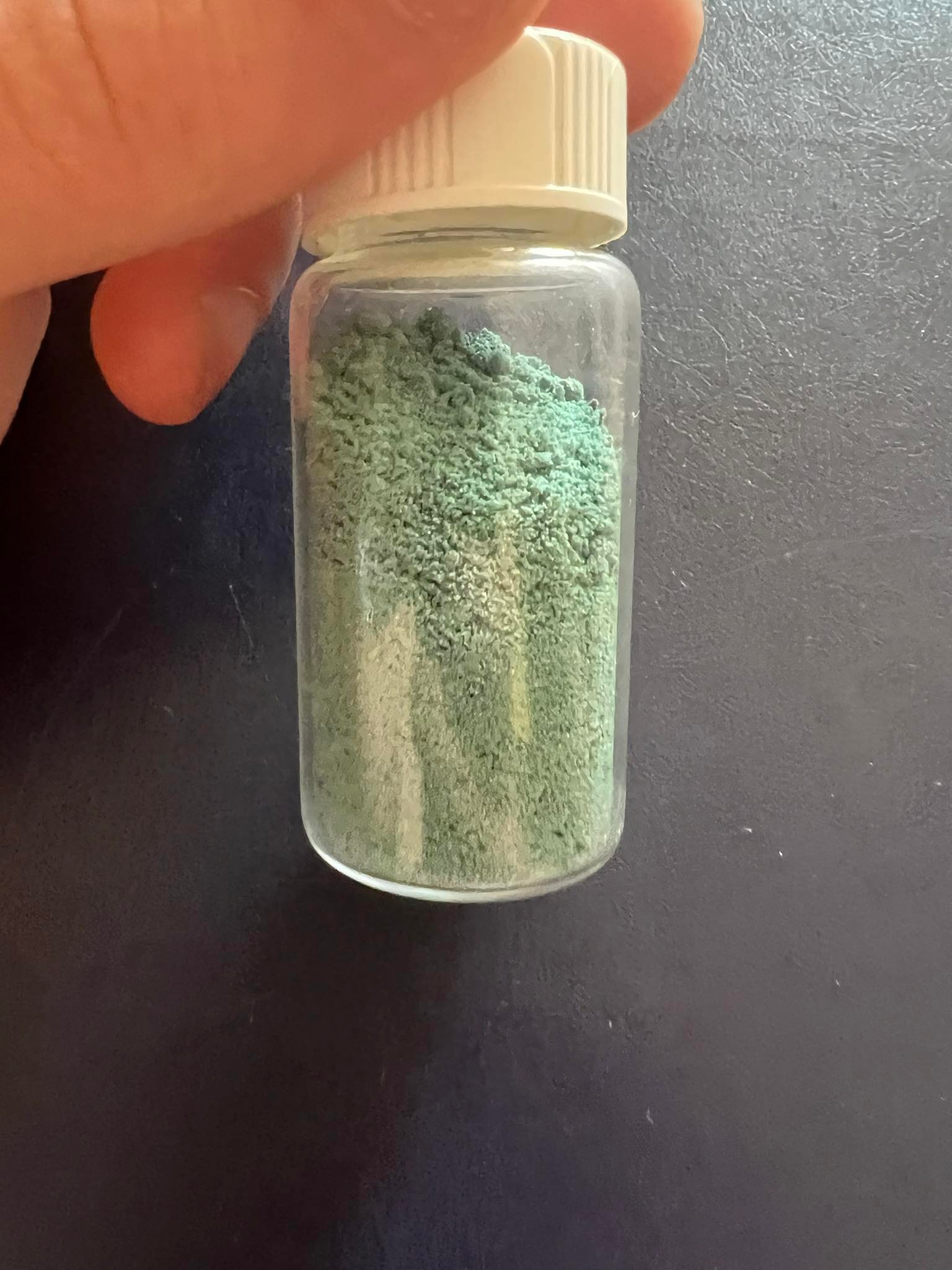

Ammonium 6-molybdonickelate(II) - (NH4)4[NiMo6O24H6]•5H2O
287855269_599924571353594_9105138913854967542_n.jpg [ 411.07 KiB | Viewed 23633 times ]
286974192_1598903003824275_2072294959324243138_n.jpg [ 538.05 KiB | Viewed 23633 times ]

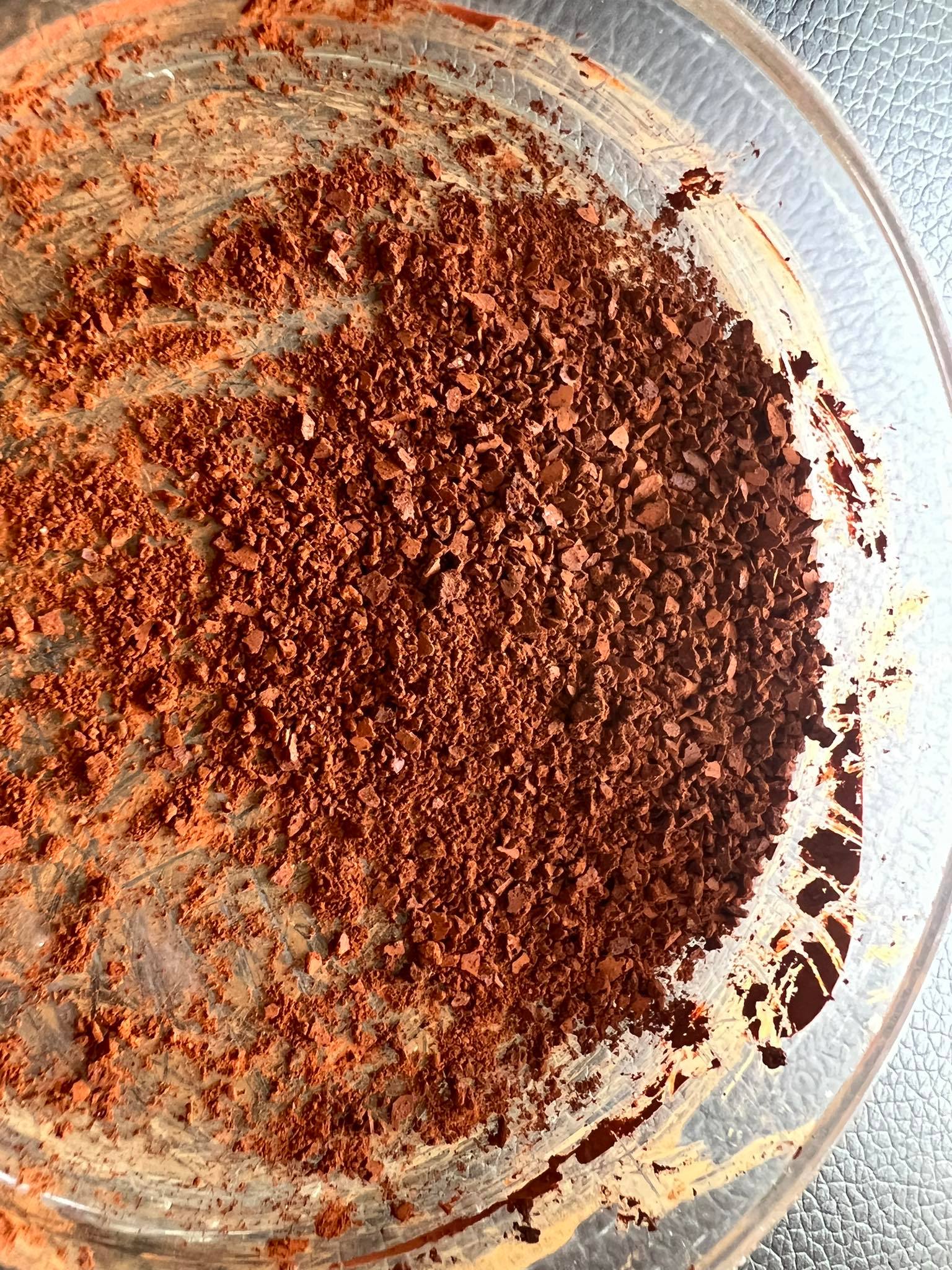

ammonium 12-molybdatocerate(IV) - (NH4)8CeMo12O42*8H2O
287314875_553830176185825_4086784569747286486_n.jpg [ 190.31 KiB | Viewed 23632 times ]
289058992_5507888449235187_7353725371819537697_n.jpg [ 338.11 KiB | Viewed 23633 times ]

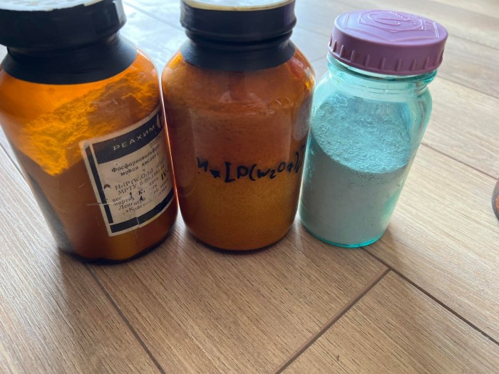

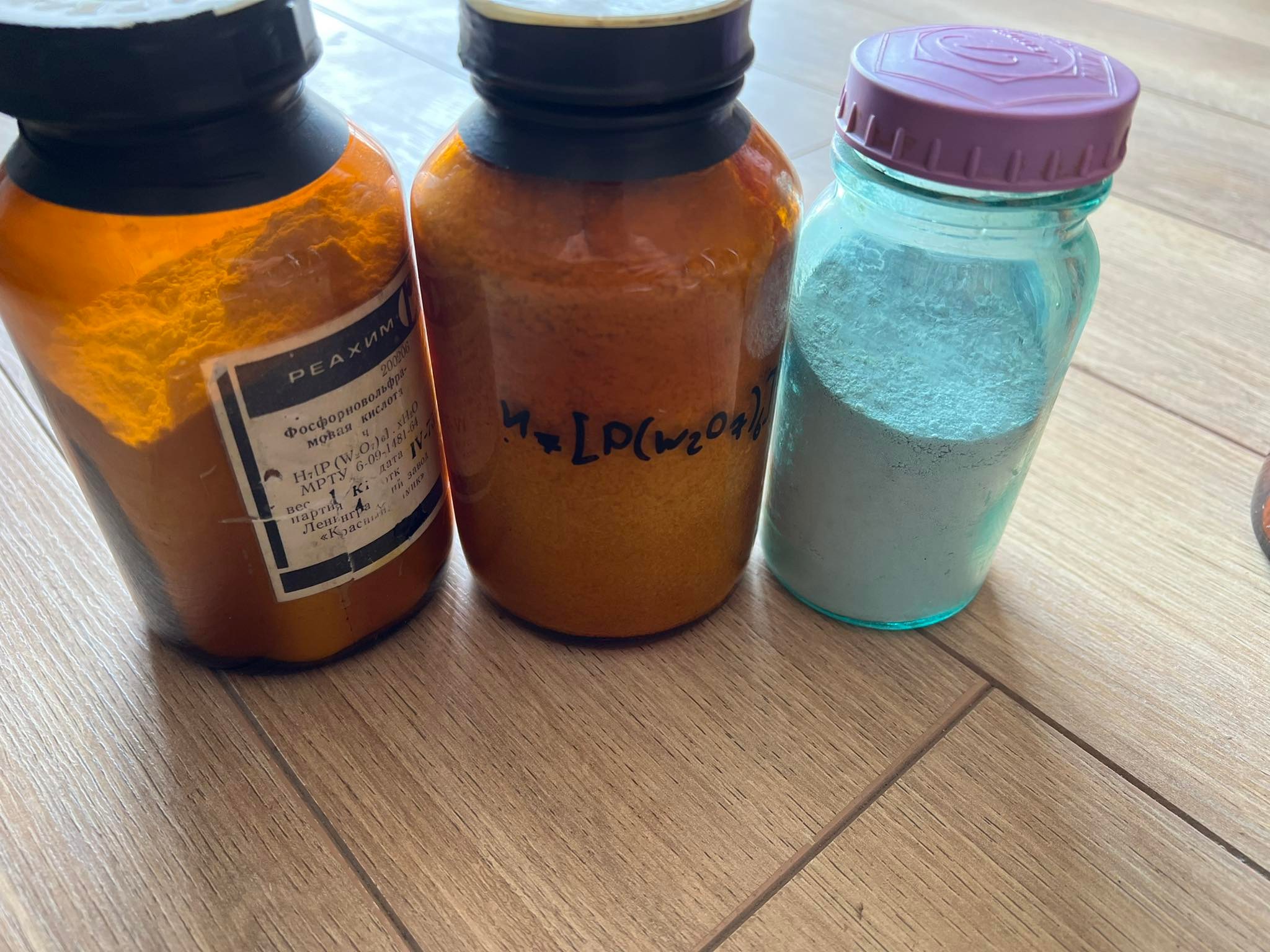

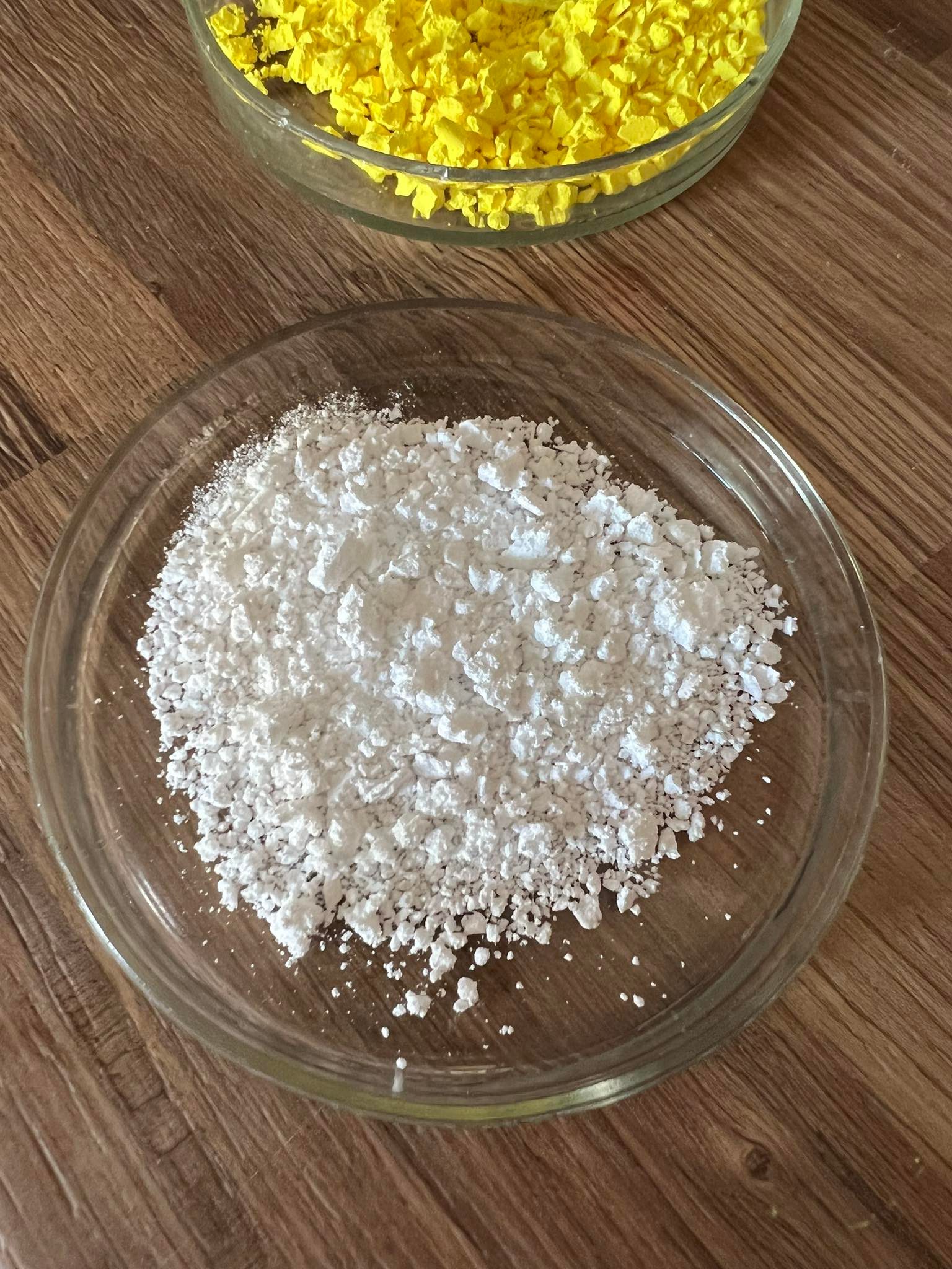

three jars of phosphotungstic acid.
287313659_710989460195266_3858836210957485054_n.jpg [ 419.54 KiB | Viewed 23626 times ]

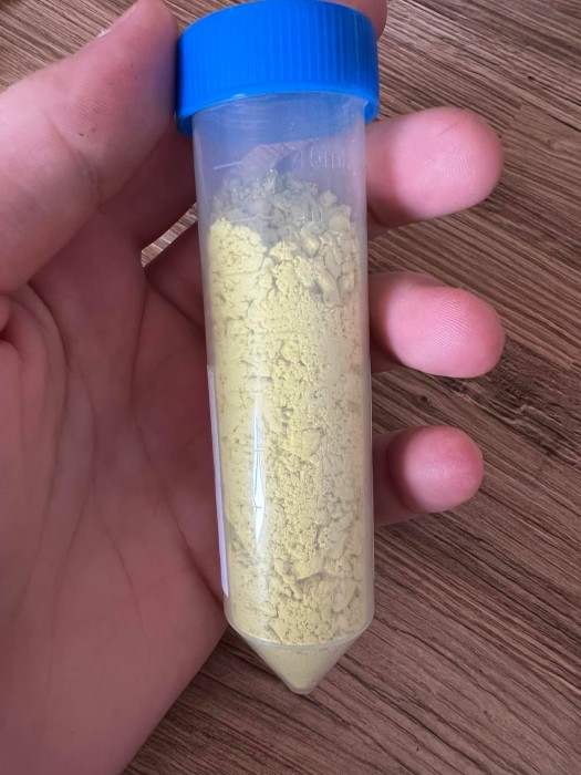

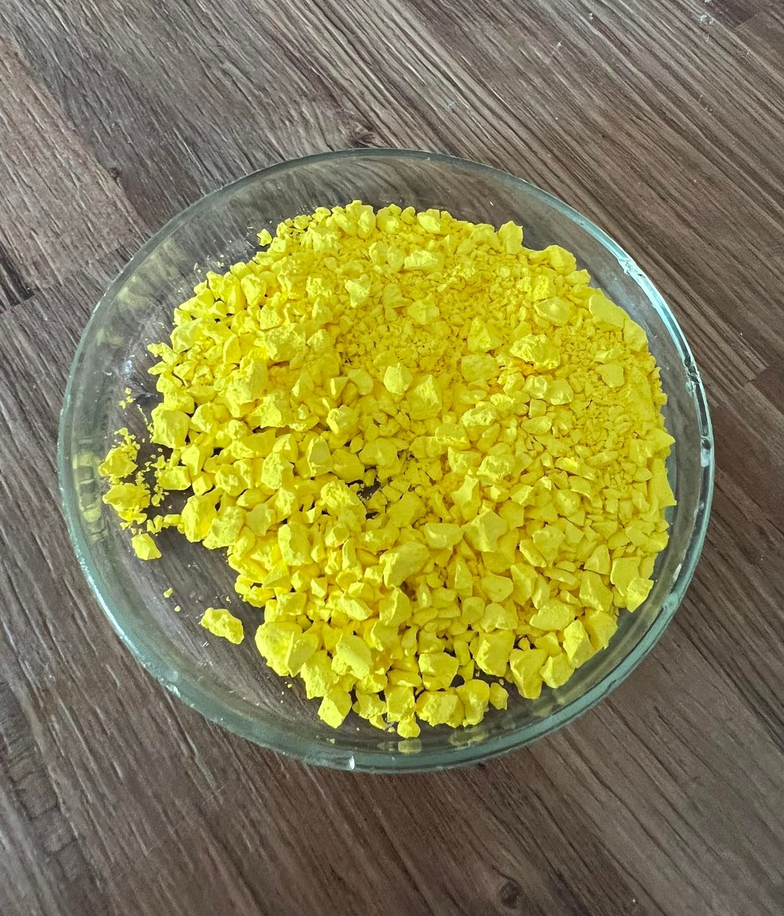

1L jar of phosphomolybdic acid.
287749860_526849902512331_1274553159076686319_n.jpg [ 532.59 KiB | Viewed 23626 times ]

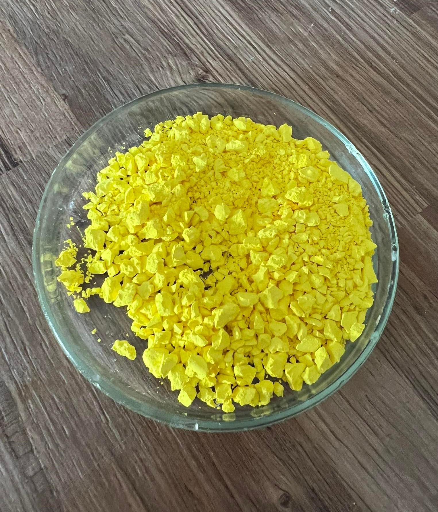

silver 12-vanadophosphate Ag7(PV12O36)•nH2O
289036884_813754186259846_7437827010735913754_n.jpg [ 693.42 KiB | Viewed 23456 times ]

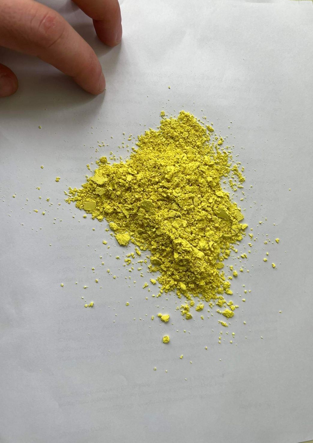

Sodium 6-molybdoiodate. Na5(IMo6O24)•nH2O (n=26,34).

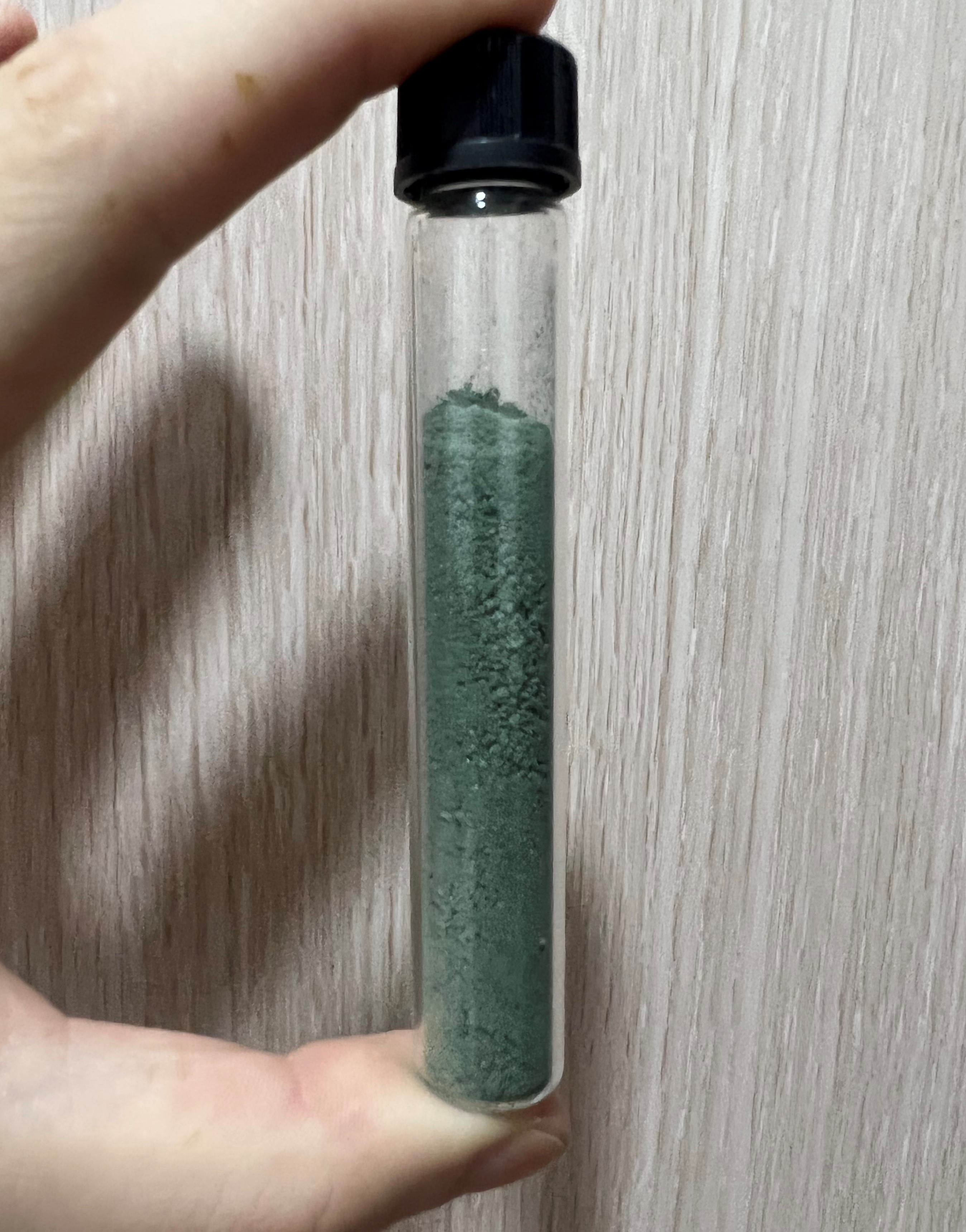

also new one. Sodium 6-molybdocobaltate(III) - Na3(CoMo6O24H6)*8H2O
291001683_627837428252778_4182576376802180482_n.jpg [ 271.57 KiB | Viewed 23246 times ]
290697578_417394350336447_6362229316556600263_n.jpg [ 317.19 KiB | Viewed 23246 times ]

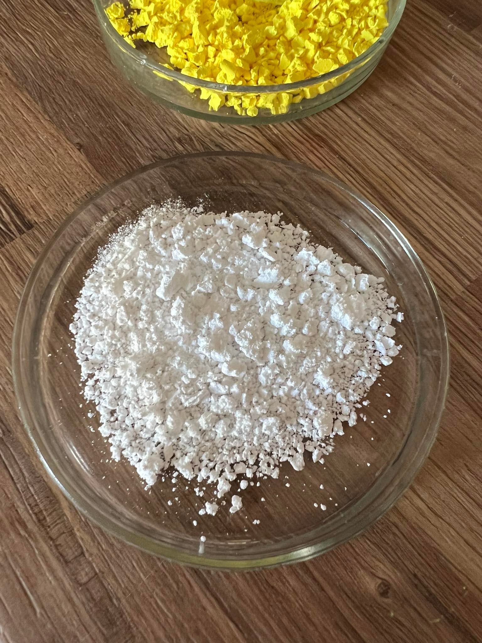

Na9[α-SbW9O33]*27H2O

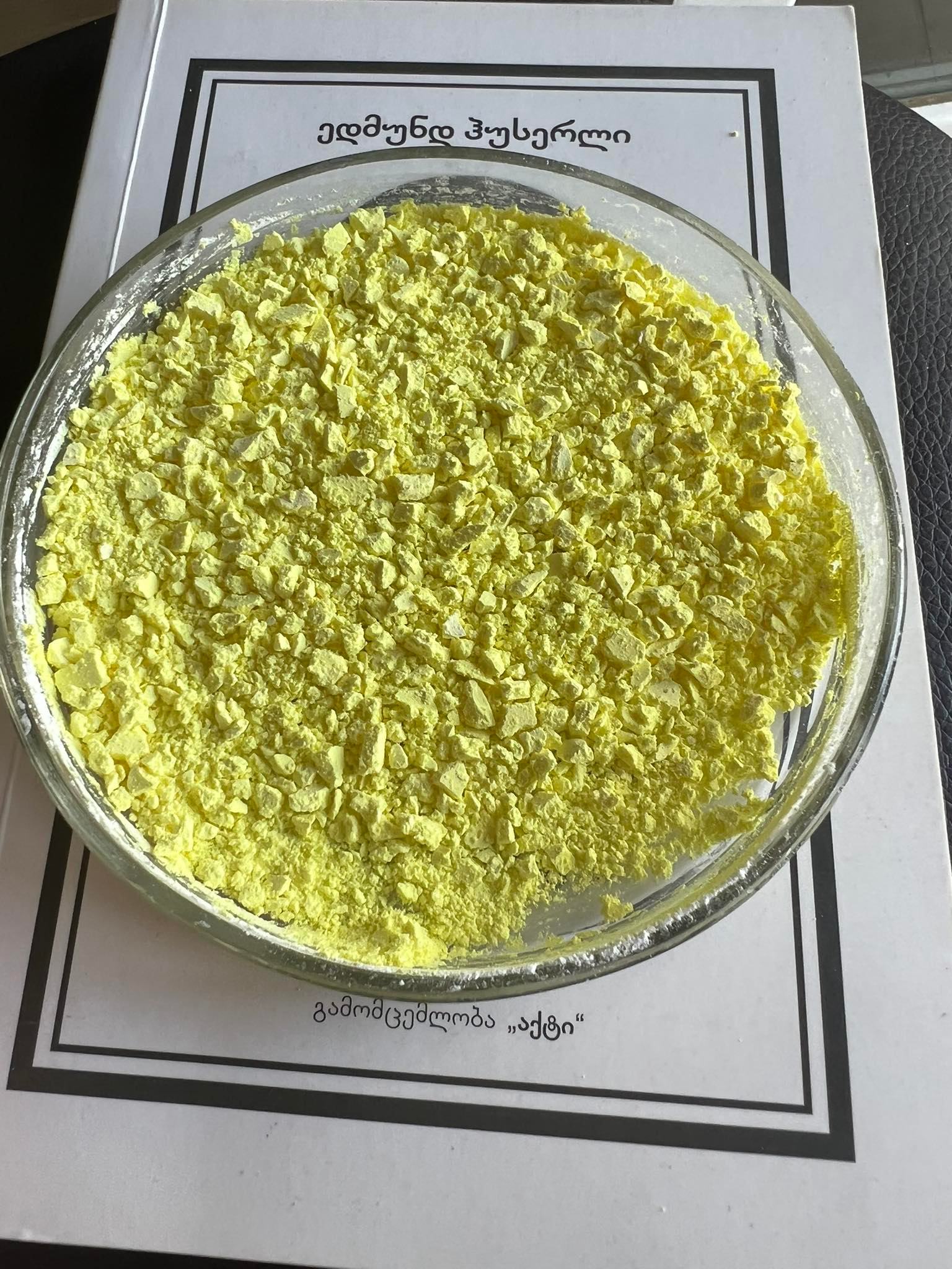

Ammonium 12-molybdophosphate - (NH4)3[PMo12O40] *nH2O.
290777898_564228008676864_7144083088687137029_n.jpg [ 764.18 KiB | Viewed 23215 times ]

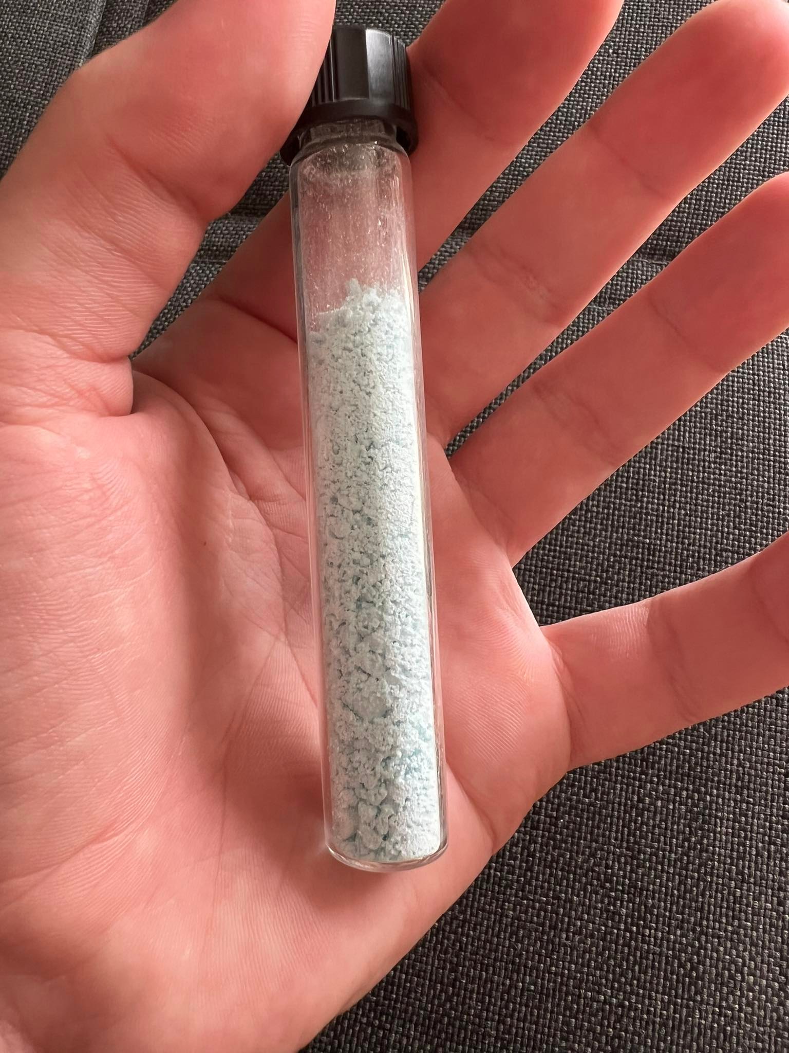

Ammonium 10-molybdodicobaltate(III) - (NH4)6(Co2Mo10O30)*10H2O
color isn't very different from Na3(CoMo6O24H6)*8H2O.
