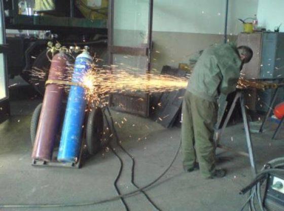

PostPosted: 08 Apr 2015 15:17
Posts: 69235
