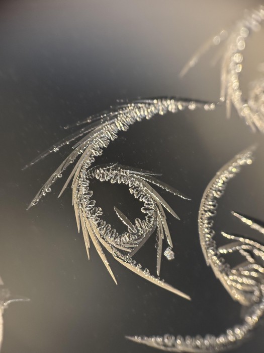

Camphor crystallization in borosilicate bulb
