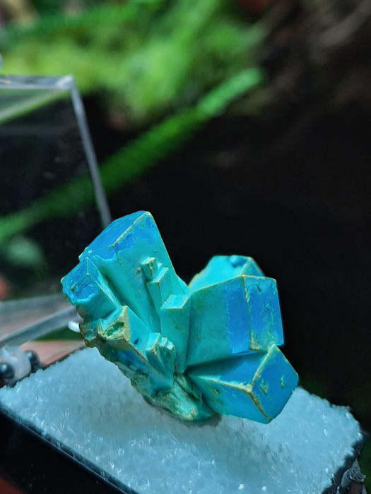

Copper-iron sulfate crystal after a year
The crystal was coated in acrylic varnish and in a plastic box. The dehydration started at the base and progressed upwards. This is probably because the lower you go on the crystal, the more little nooks and cranies there is so the varnish probably didn't go everywhere.

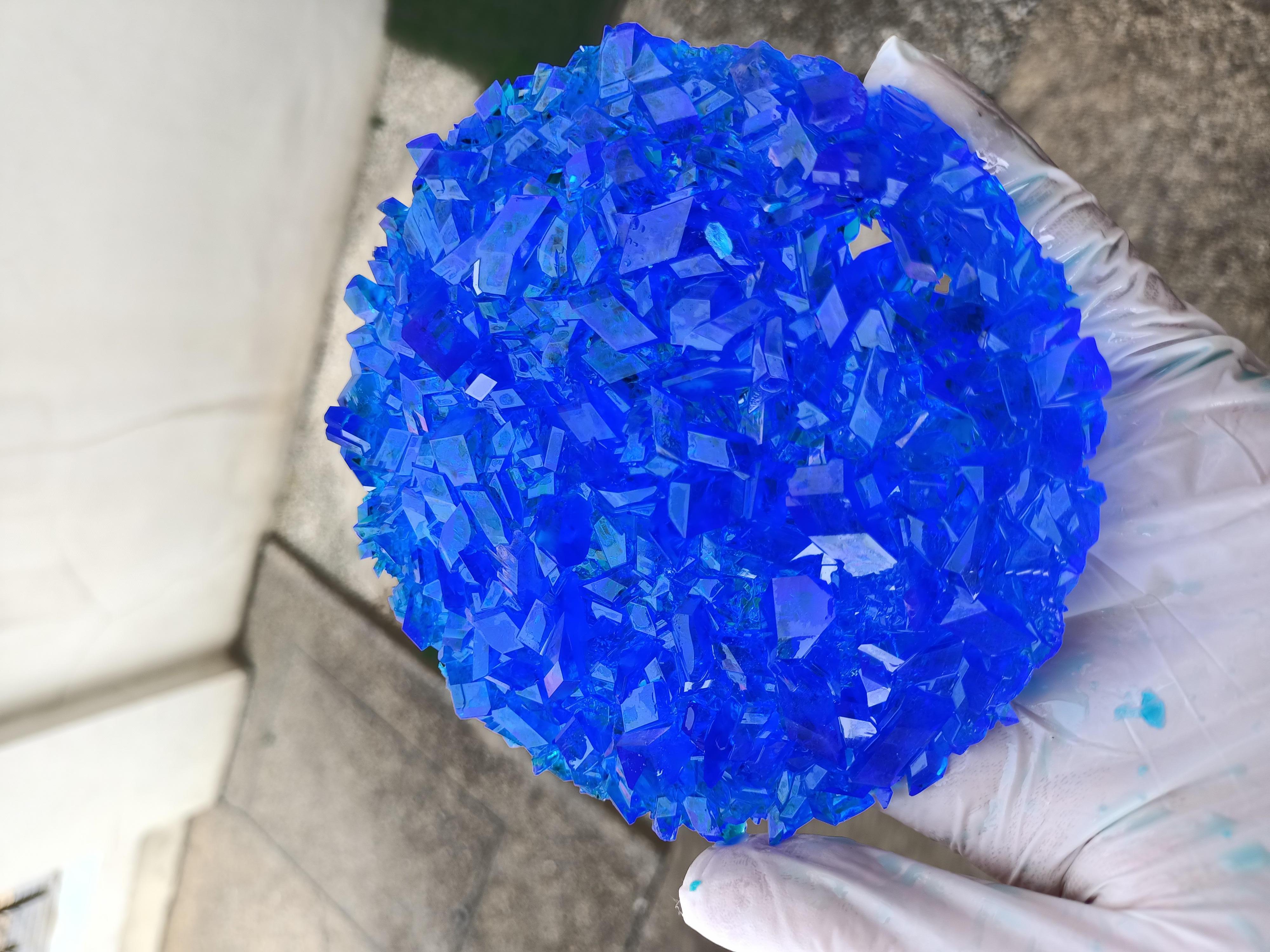

I accidentally grew a giant chunk of copper sulfate crystal
Some of you might have seen my previous posts on growing crystals at home.
This time, I was preparing some copper sulfate solution to grow large single crystals. But the solution was a little too concentrated. As a consequence, this huge mass decided the time was ripe to appear at the bottom of the container.
Anyway, I thought it was pretty cool.
