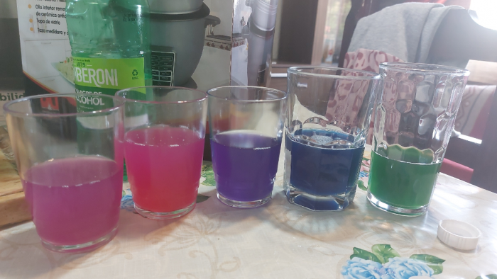

pH indicator using Red cabagge
From left to right: White vinegar, Lemon Juice, Nothing added, Sodium bicarbonate, Sodium Carbonate
