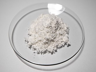

Found some old TCPO on the shelf and tested it. It worked!
TCPO, or bis(2,4,6-trichlorophenyl) oxalate, is used in some types of glow sticks.
Preparation
TCPO can be prepared from a solution of 2,4,6-trichlorophenol in a solution of dry toluene by reaction with oxalyl chloride in the presence of a base such as triethylamine. This method produces crude TCPO with a by-product of triethylamine hydrochloride. The triethylamine hydrochloride can be dissolved in water, methanol or ethanol, so the product is more purified. After washing it can be recrystallized from ethyl acetate.

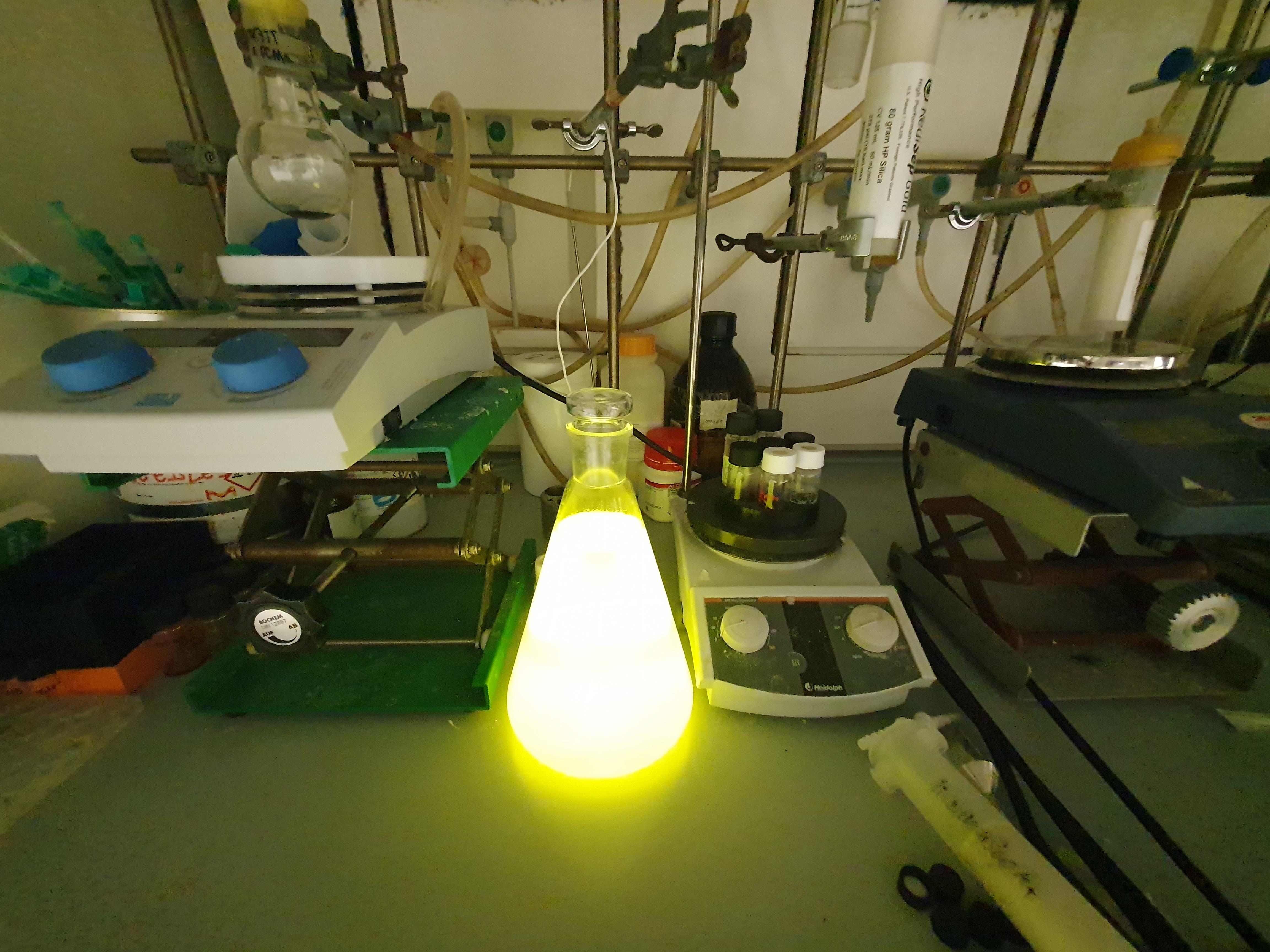

PostPosted: 30 Nov 2025 23:20
Posts: 69250
