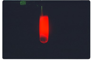

Методика есть, только уже не помню откуда ее "смыкнул"
Chemiluminescence and Singlet Oxygen.
Equipment:
large test tube
15 cm length of latex tubing
sintered glass gas dispersion tube or an 'air-stone' from an aquarium supply store (or simply a glass pipet)
Chemicals:
Cl2(g), 60-mL
10 mL of 30% hydrogen peroxide
10 mL 6 M NaOH(aq)
In this experiment you will observe the production of 'singlet oxygen,' a high energy variant of O2(g) and observe the energy release associated with its conversion to normal 'triplet oxygen.' The conversion produces a chemiluminescent red glow (photochemical emission) with approximate wavelength of 630 nm. For a full discussion, please see Volume 1 of Chemical Demonstrations (Vol 1., Shakhashiri, University of Wisconsin Press, 1983.)
Equip a 15 cm length of latex tubing with a sintered glass gas dispersion tube or an 'air-stone' from an aquarium supply store. Clamp a large test tube (15 x 180 mm) in a ring stand and fill with 10 mL of 30% hydrogen peroxide. Generate a syringeful of Cl2(g) and set it aside. Add 10 mL 6 M NaOH(aq) to the test tube containing the H2O2(aq). Hydrogen peroxide may start to decompose to O2(g) before you add the chlorine. If the reaction starts to proceed at too fast of a rate, it can be quenched by adding water from a squeeze bottle. Remove the latex cap from the syringe and equip the syringe with the latex tubing/gas dispersion apparatus as shown in Figure 3.
File comment: Figure 3
File comment: Синглетный кислород
A completely darkened room is required for best results.
To perform the demonstration, carefully bubble chlorine gas slowly through the solution. With the lights off (completely darkened room), you can observe the spectacular red chemiluminescent glow near the gas dispersion tube. The reactions are:
Cl2(g) + 2 NaOH(aq) + H2O2(aq) O2(g, singlet) + 2 NaCl(aq) + 2 H2O(l)
2 O2(g, singlet) 2 O2(g, triplet) + hn

Спасибо за методику! Сегодня проверю как работает, а там будет видно, хватит свечения или нет.

Во! Готово!
И даже видно без особых шумов (несмотря на слабое освещение).

Хорошо получилось :)
а главное, что реактивы для опыта самые доступные.
В свое время не стал делать этот эксперимент только потому, что старый Олимпус дает плохую картинку в темноте. Сейчас есть фотоаппарат получше - позже надо будет заняться люминесценцией.

Да, но придется работать с хлором. Суть проста: смешивают 30% перекись водорода и крепкую щелочь, потом через этот раствор пропускают хлор.

на том же ютубе есть ролик, где брали только конц. Н2О2 и гипохлорит кальция (как источника хлора). =)

У меня была мысль использовать гипохлорит натрия ("белизну").

думаю, что должно сработать.
