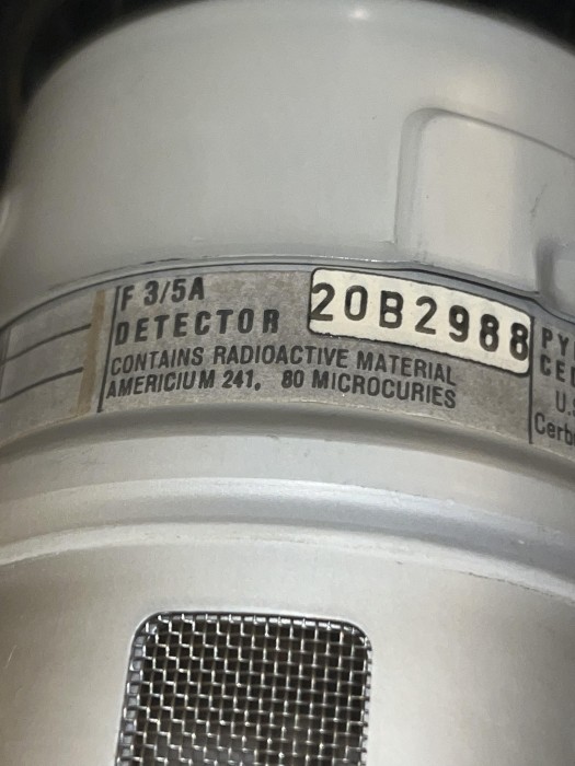

Smoke Detector Containing 80 Microcuries Of Americium-241

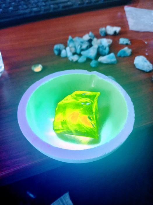

Uranium glass under UV

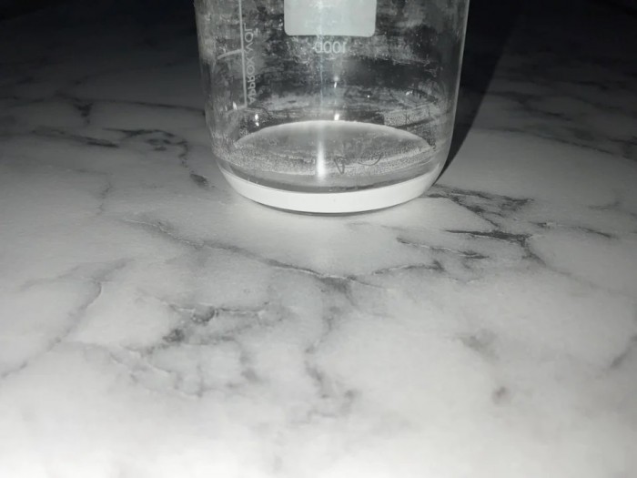

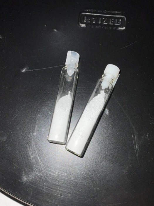

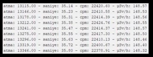

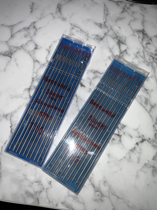

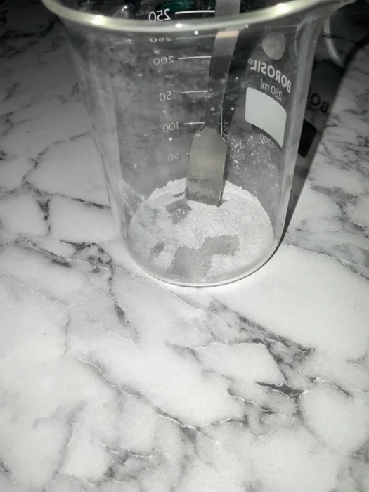

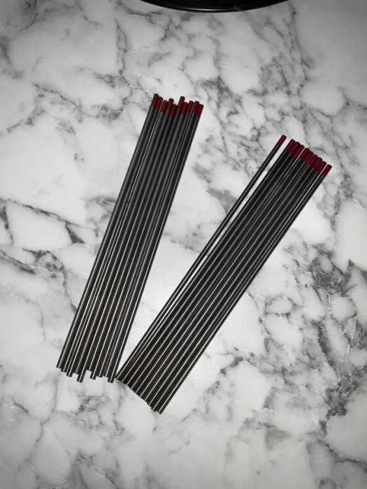

9.8 grams of ThO2 extracted from 485 grams 2% thoriated tungsten electrodes. The activity is 22400 cpm or 148 μSv/h beta and gamma.
Actually, I just used hydrogen peroxide. It forms water-soluble complexes with tungsten but doesn’t touch ThO2. The process is very slow though. It takes weeks especially if you use thich rods.
I bought 40 rods but processed half of them. Each rod, with a size of 3.2x175 mm, weights around 25 grams. It cost 175 USD in total. And I used 50% peroxide, occasionally changed the solution and poured fresh peroxide until reaction finished. used 1.5 liters in total.

А что дальше делать с торием? У меня когда - то было немного, с полграмма, двуокиси - так и не придумал ничего интересного.
 Post subject: Re: Actinides / Актиноиды: Th, Pa, U, Np, Pu...
PostPosted: 27 Aug 2023 15:53
Posts: 65401
Если это не эксперименты с радиоактивностью, мне тоже ничего не приходит в голову.

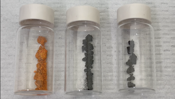

Uranium Oxides (Trioxide, Dioxide, and Triuranium Octoxide)

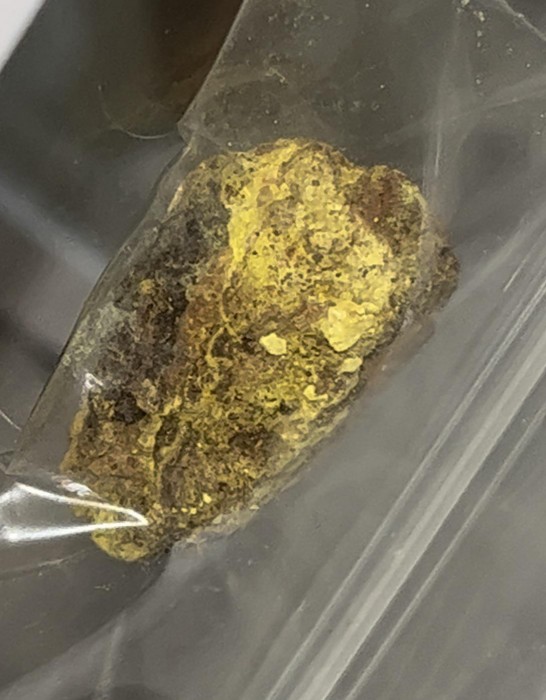

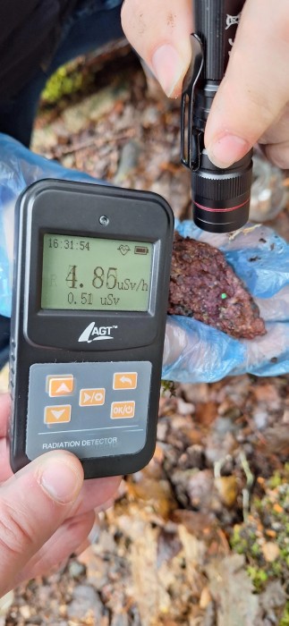

Found naturally occurring Uranium-Ore

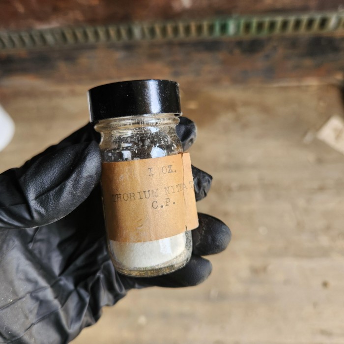

PostPosted: 15 May 2024 10:51

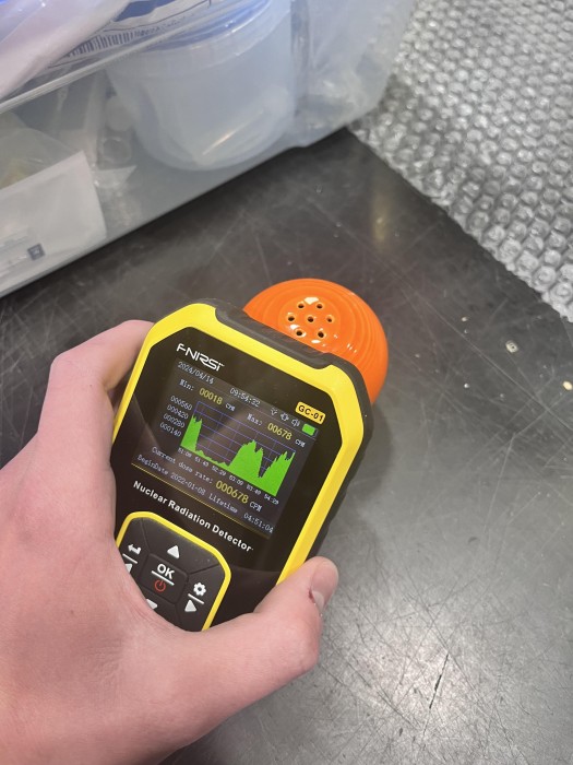

Never seen a thorium nitrate before. Measured radiation was 8.3 uSv / hr, so almost 3 times background in a plane.

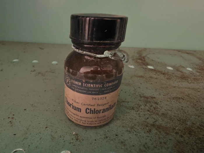

Thorium Chloranilate - реагент для определения фторидов
Reaction of Thorium Chloranilate with Fluoride
west1968.pdf [566.25 KiB]
Downloaded 50 times

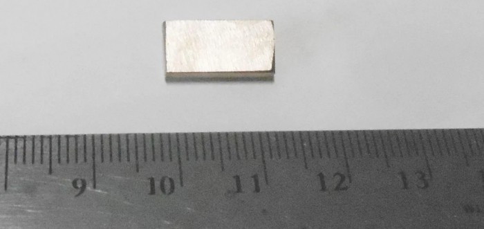

Uranium metal sample
