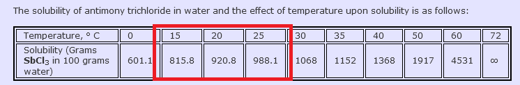

Hello. I saw the old antimony trichloride. The main quantity in the jar is large transparent crystals, but also a transparent liquid. Does it generally start to melt at room temperature? Is the melting temperature of Wikipedia wrong? If there was water in the jar, it would decompose into antimony trioxide. I put some of this liquid in a test tube and added water it immediately become white . I also put the jar in the freezer and the liquid froze and was just like the other crystals.

I found that is answer:

Posts: 69137
Концентрированные водные растворы устойчивы и называются «сурьмяное масло»
The strongly acidic environment inhibits the hydrolysis of antimony chloride / Сильнокислая среда подавляет гидролиз хлорида сурьмы.

Yes exactly. What you think what is percentage of this concentrated solution?
PostPosted: 20 Sep 2021 20:45
Posts: 69137
The solubility of antimony trichloride in water http://antimony.atomistry.com/antimony_trichloride.html
The solution is saturated - about 800-1000 g antimony (III) chloride/100 g water

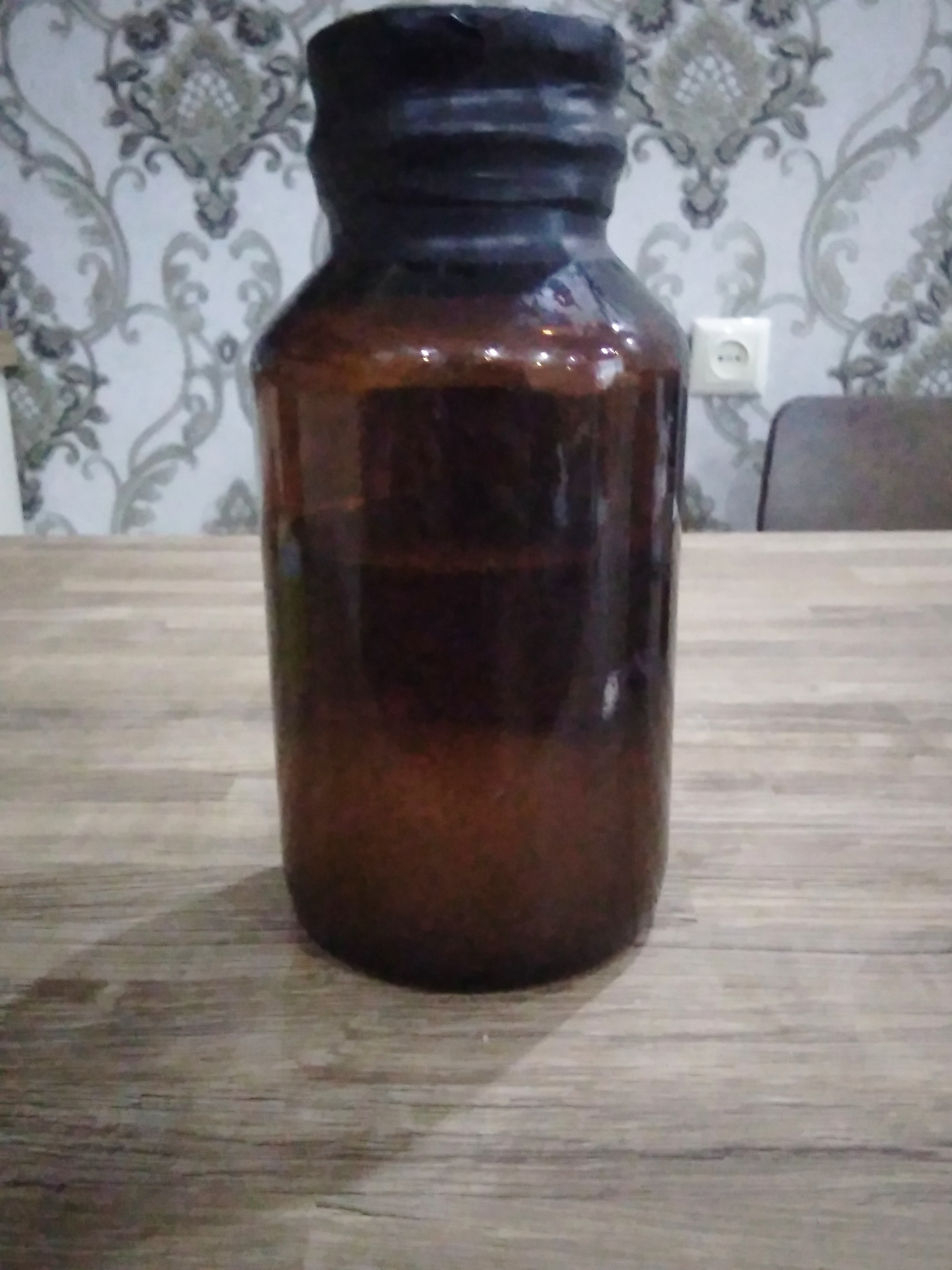

Hi this is a trichloroacetic acid. You can see that there's acid crystal bottom of the jar, but i want to dry this solution, it contains lots of acid and i don't want to waste it. What is best way? Or I can use that as a trichloroacetic solution, but i don't know percentage, so I can't do calculations. I think second idea is better because of smell of acid.

Posts: 69137
The solution is saturated. It is in equilibrium with the crystals.
The acid has a solubility in water at 25 °C of 1,000 g/100 ml;
https://pubchem.ncbi.nlm.nih.gov/compou ... creen=true
Trichloroacetic acid is toxic, it evaporates when heated (at room temperature - it also evaporates).

Thank Volodymyr! Yes it has awful smell and i used isolator scotch to avoid any vapour of acid and it works.
