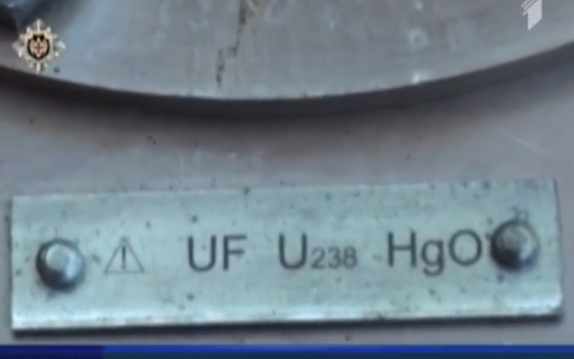

Why there are symbols UF and HgO on the uranium-238 box?
PostPosted: 05 Oct 2021 09:58
Posts: 69131
UF6/UF4?
PostPosted: 05 Oct 2021 13:22
Joined: 14 Jul 2021 12:13
Posts: 333
Location: Georgia
Inside was only uranium-238. I think too that this means fluoride, but why i dont know. Second one is definitely mercury oxide formula.

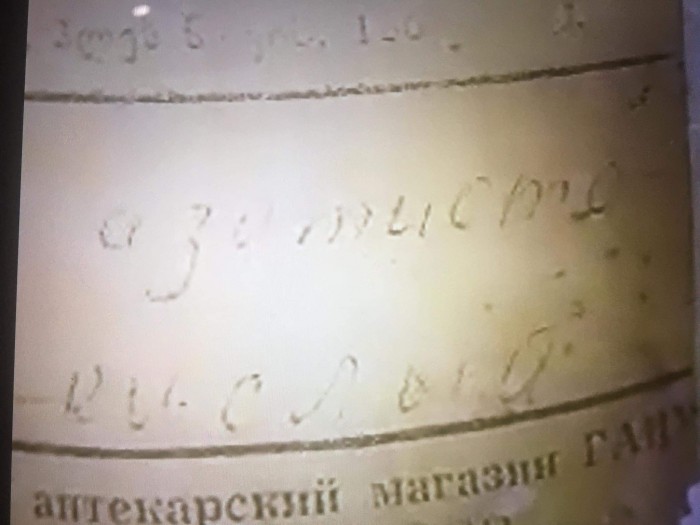

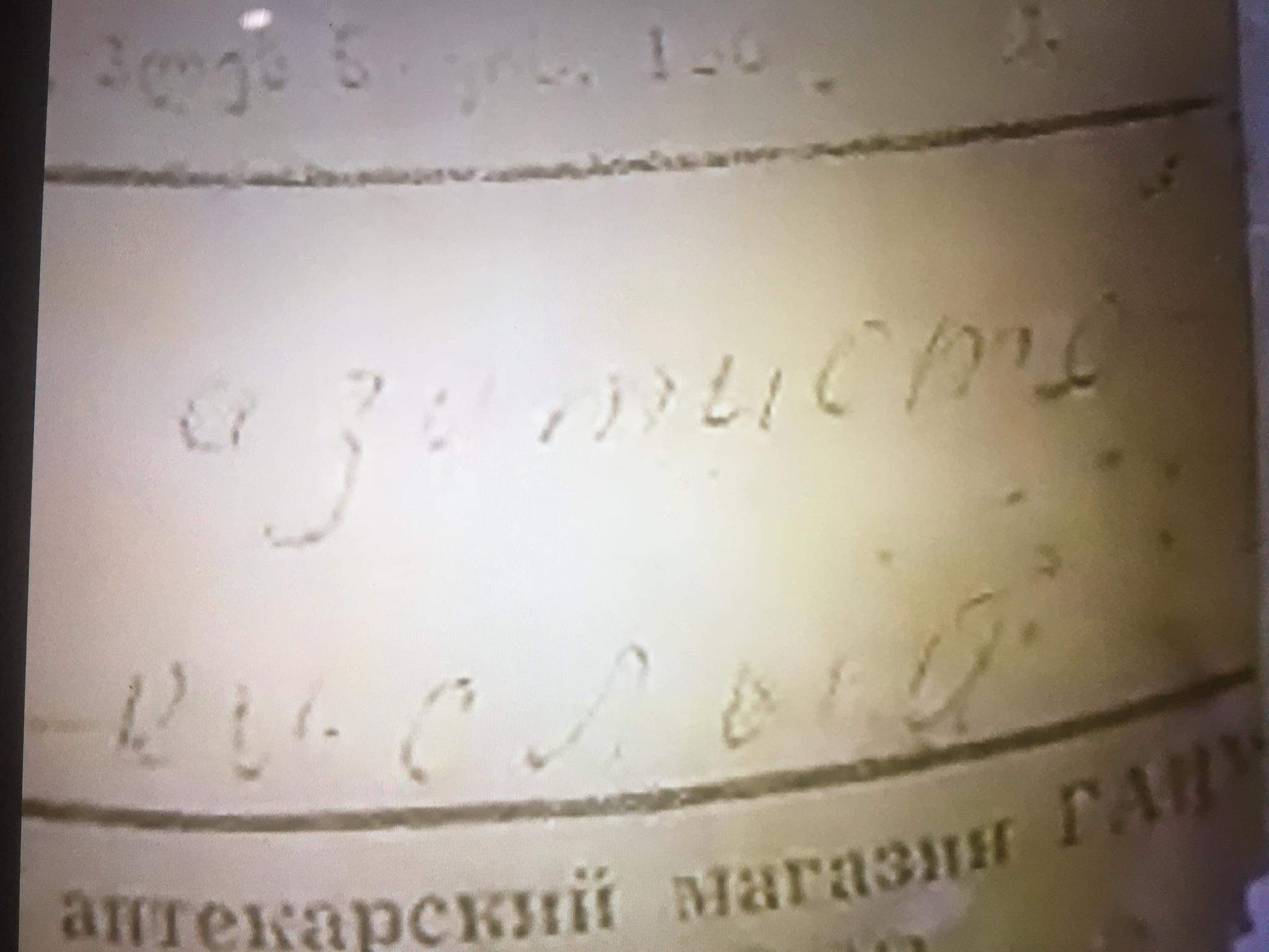

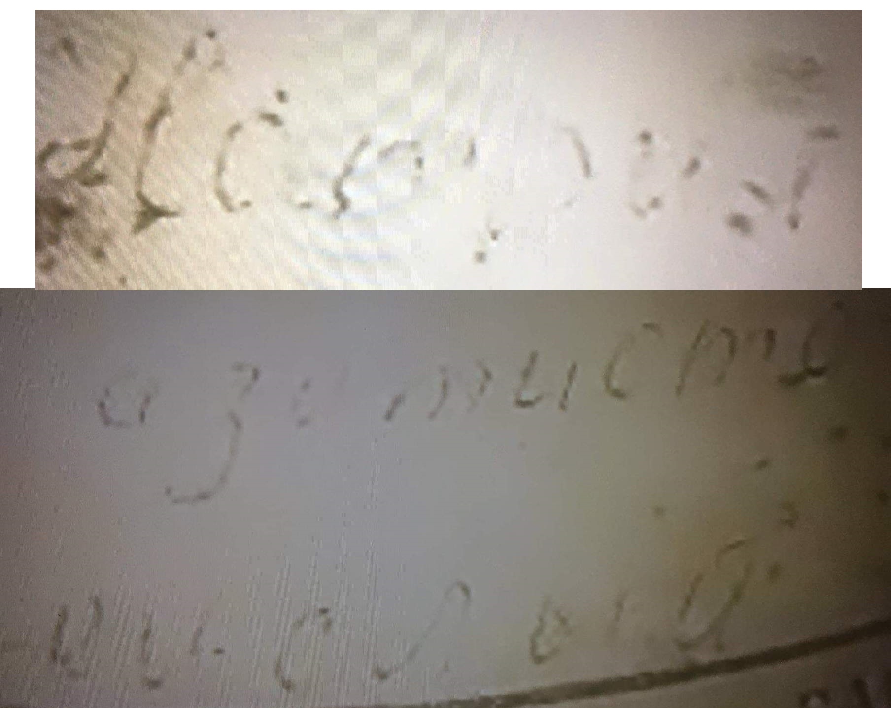

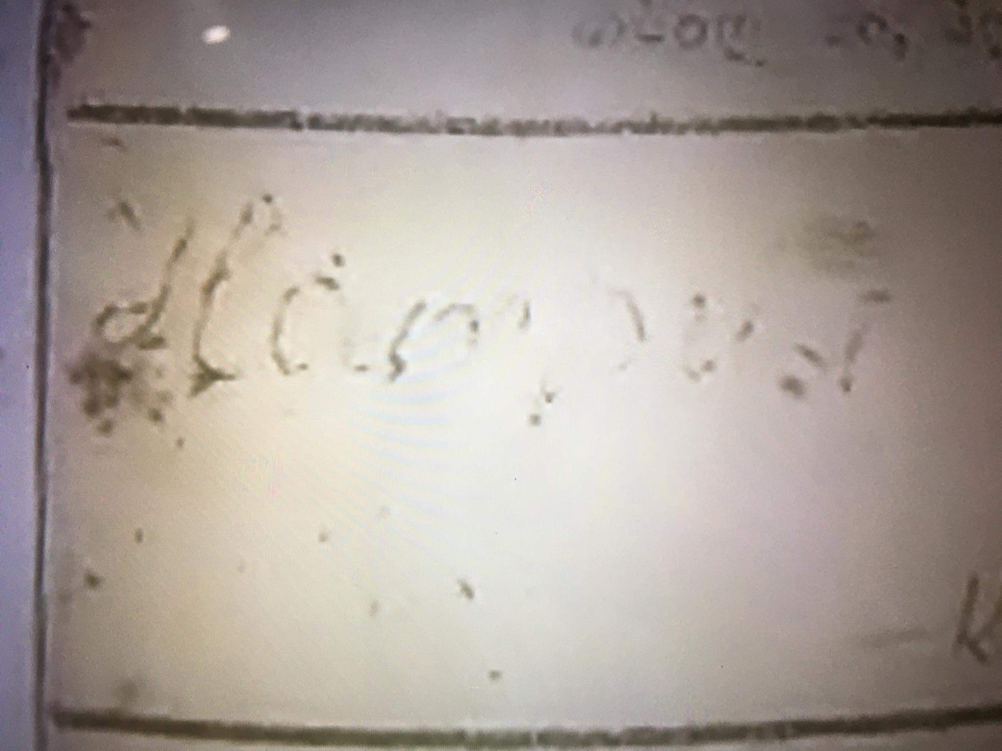

Can anyone read what it's?
PostPosted: 12 Oct 2021 21:16
Posts: 69131
"Натрий азотистокислый" - Sodium nitrite
PostPosted: 13 Oct 2021 07:00
Posts: 333
Location: Georgia
Thanks Volodymyr! Interesting, because it has white colour not yellowish like my other NaNO2
