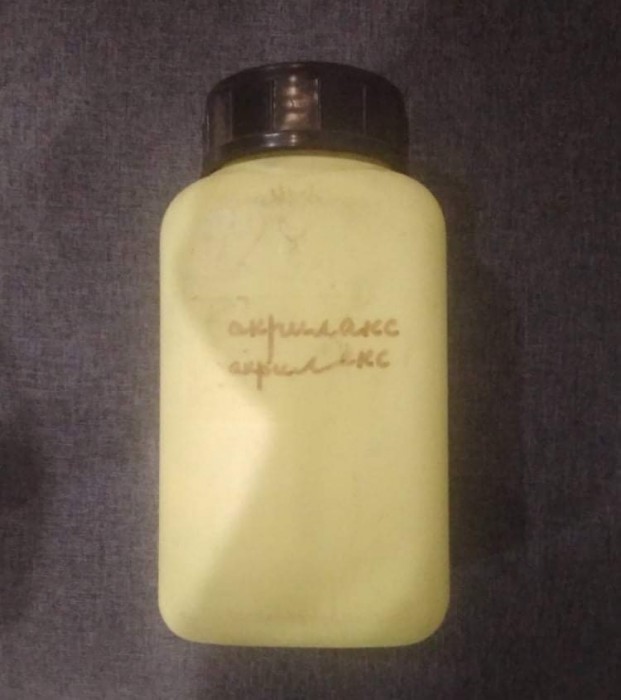

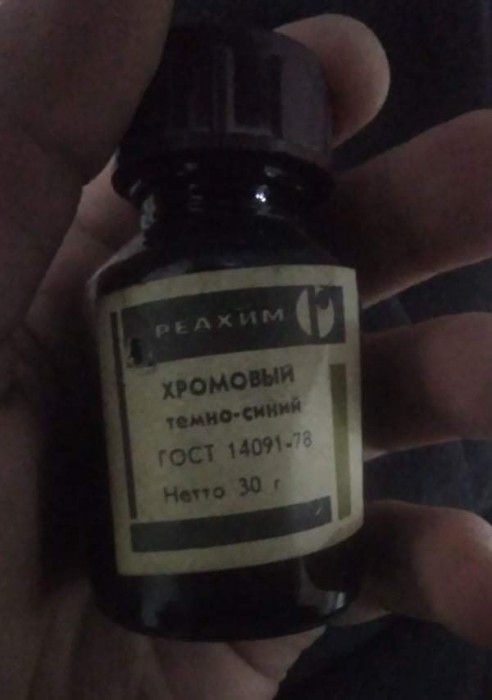

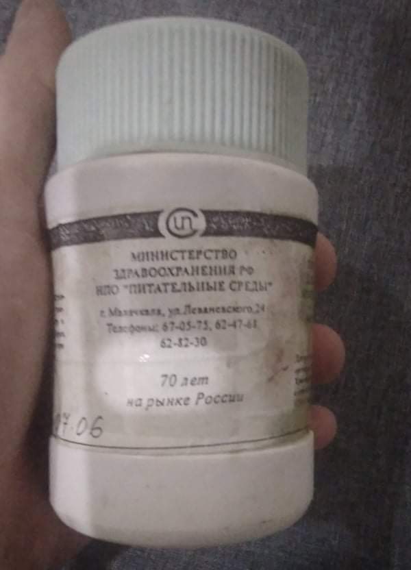

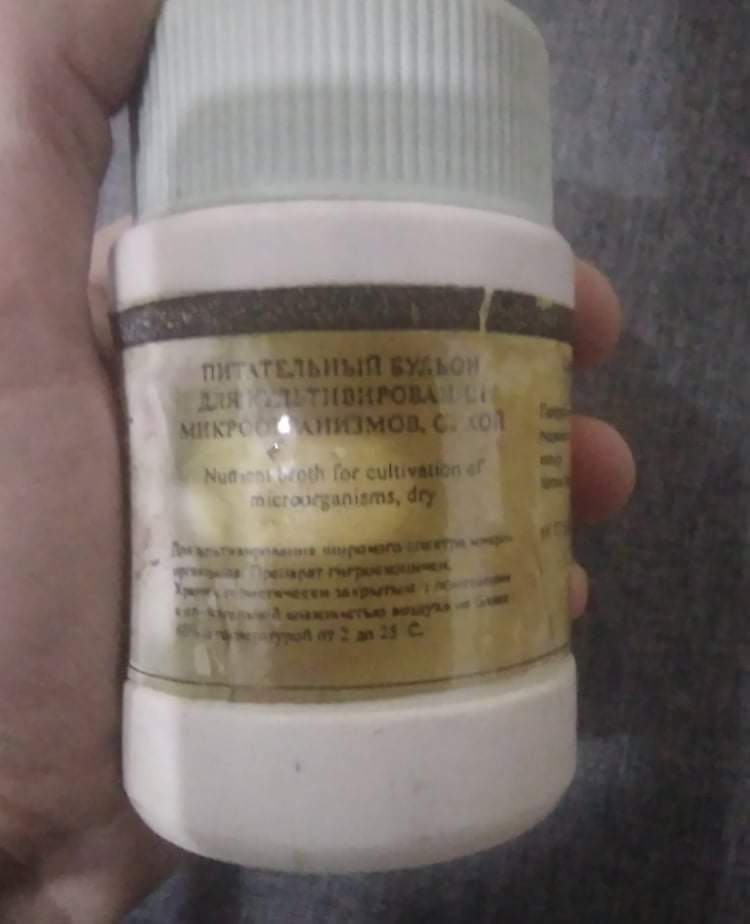

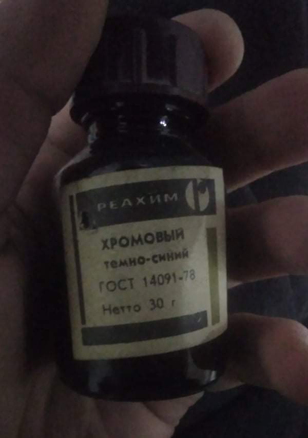

Hello! What are this chemicals?
PostPosted: 28 Jan 2022 11:48
Posts: 69131
#1
For the preparation of some microbiological growth medium

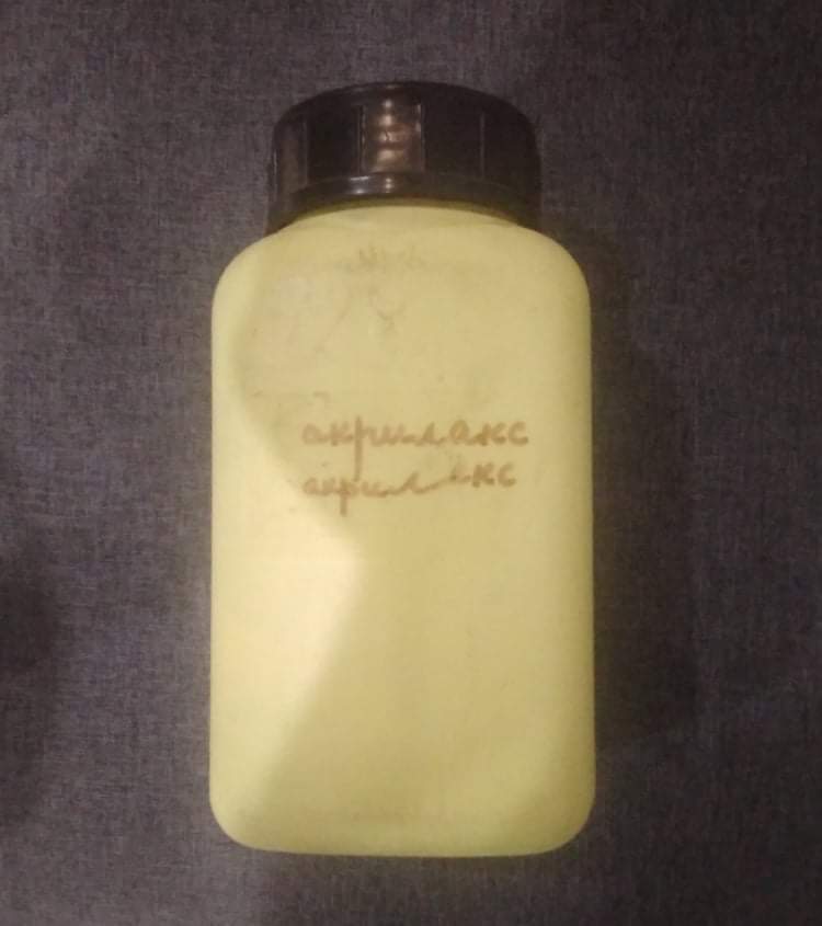

2#
3#
acrylic paint
https://vkraski.ru/akrilaks
