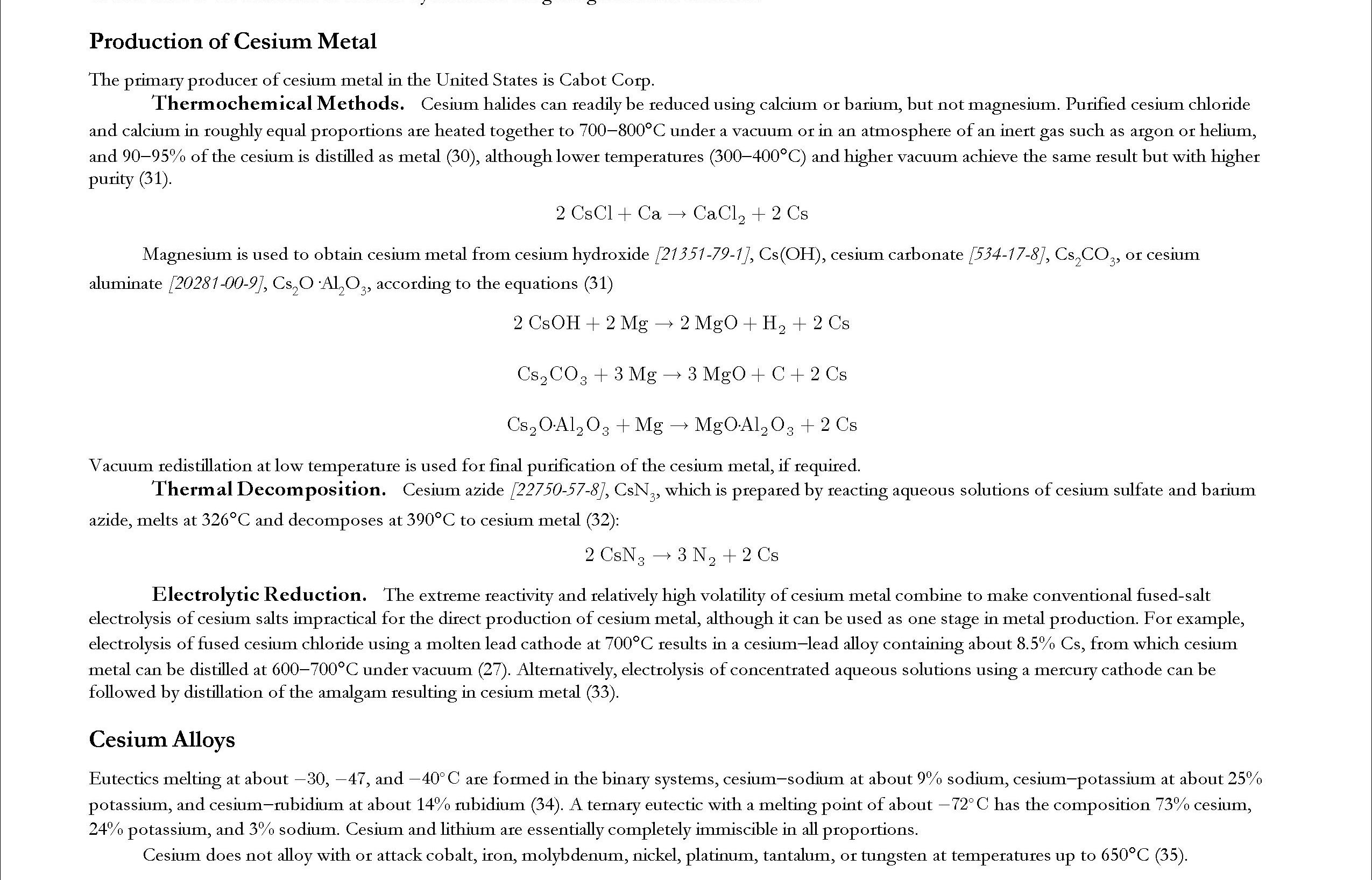

hello! how can I make cesium metal from its sulfate? I know CsCl and Li or Ca method, but now I cant make apparatus. also I don't like the azide method and I cant try the dichromate Zr method because I don't have a zirconium powder. is there another method?
PostPosted: 26 May 2022 10:09
Posts: 69131
Thermal Decomposition.
Cesium azide [22750-57-8], CsN3, which is prepared by reacting aqueous solutions of cesium sulfate and barium azide, melts at 326°C and decomposes at 390°C to cesium metal (32):
2 CsN3 => 3 N2 + 2 Cs
Kirk-Othmer encyclopedia of chemical technology, Vol.5, P.376

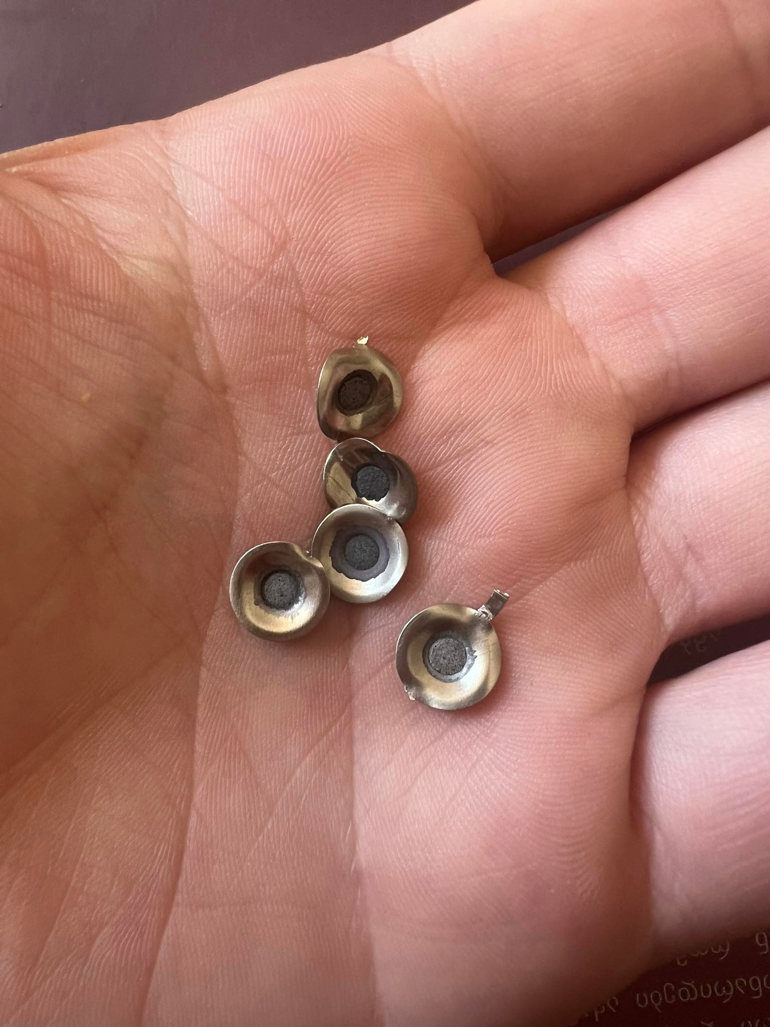

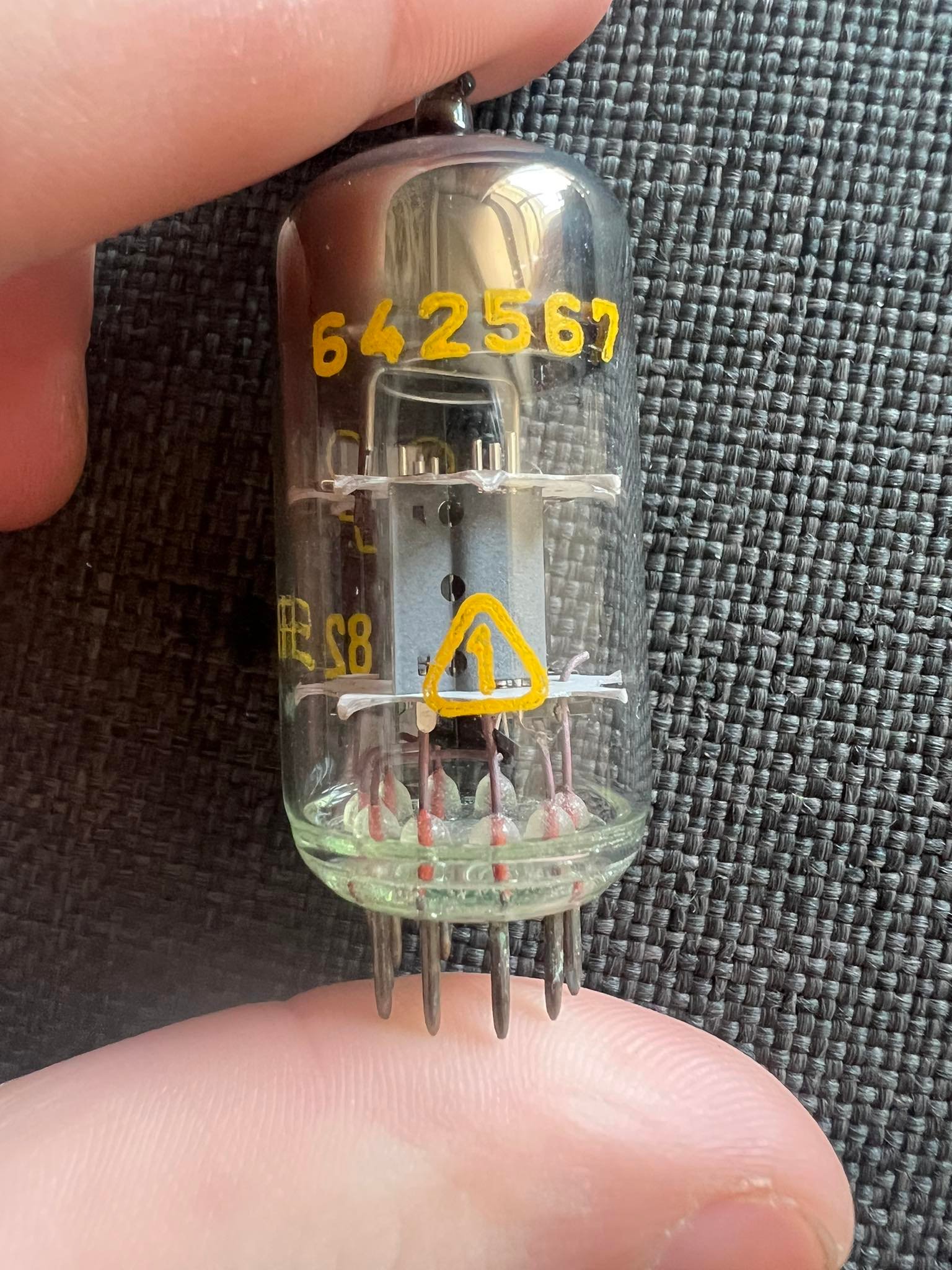

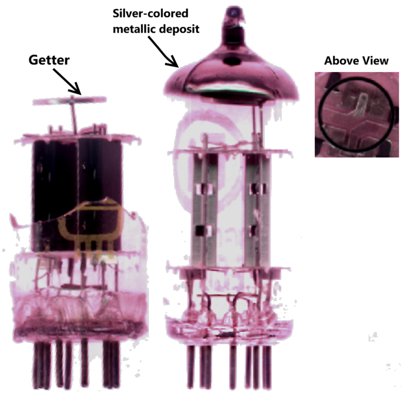

Location: Georgia

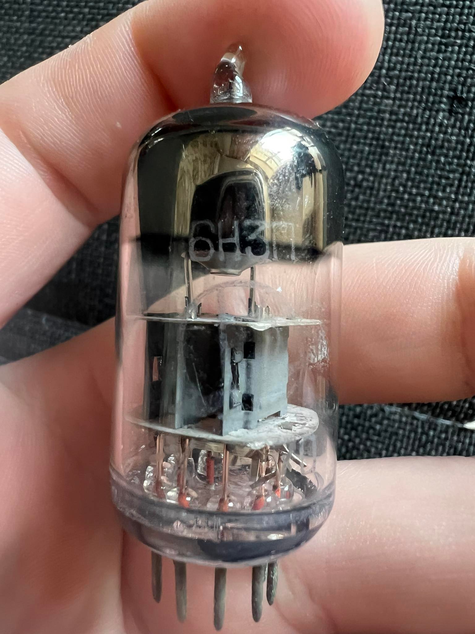

I'm just interested what is this grey metal or alloy inside the tube? also, can I find hafnium, zirconium, and such metals in these tubes. I don't care about gold and such metals.
283516767_1003026547239910_6347849416214767178_n.jpg [ 450.41 KiB | Viewed 8814 times ]
281225063_1140923076469769_3533411698823927809_n.jpg [ 307.41 KiB | Viewed 8814 times ]
PostPosted: 26 May 2022 15:57
Posts: 69131
The lamp anodes are coated with porous titanium. The white powder of the cathode is barium oxide (if removed, it will quickly become a hydroxide...)
Individual elements can be made of tantalum. Molybdenum grids of powerful generator lamps are gilded (anti-dynatron coating).
PostPosted: 26 May 2022 17:26
Joined: 14 Jul 2021 12:13
Posts: 333
Location: Georgia
thanks! interesting. Did I dissolve maybe anode? in nitric acid. I don't know exactly which is the anode. so I dissolved this metal piece in acid then I get nickel nitrate solution and white precipitate, probably nitric acid oxidize titanium to its dioxide. what do you think?
edited: precipitate was from dissolving spirals in acid, maybe it was Ni-Ti heating spiral?
PostPosted: 26 May 2022 17:55
Posts: 69131
Hard to say. Titanium metal is resistant to nitric acid. Nickel is very common in vacuum tubes.

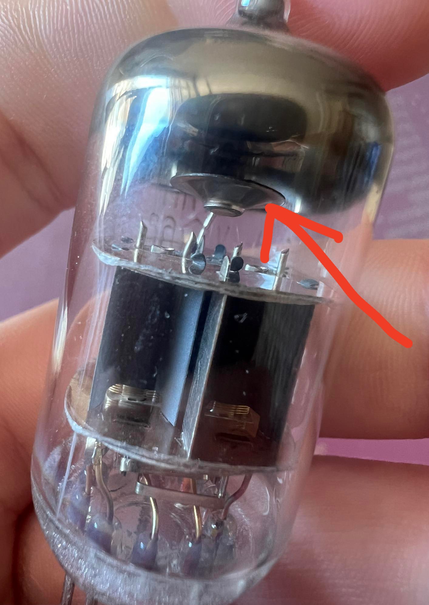

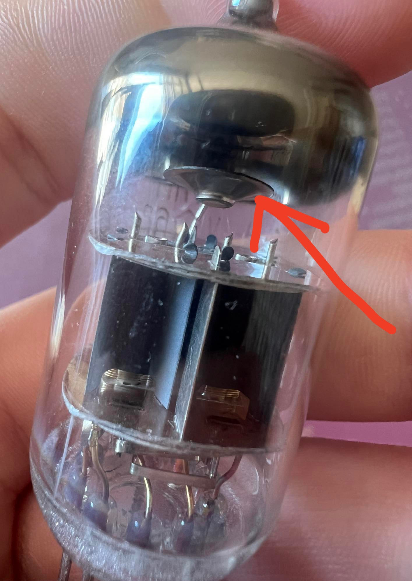

Titanium is not used in heating spirals. Titanium is used in getters
A getter is a deposit of reactive material that is placed inside a vacuum system to complete and maintain the vacuum.
PostPosted: 27 May 2022 10:07
Posts: 333
Location: Georgia

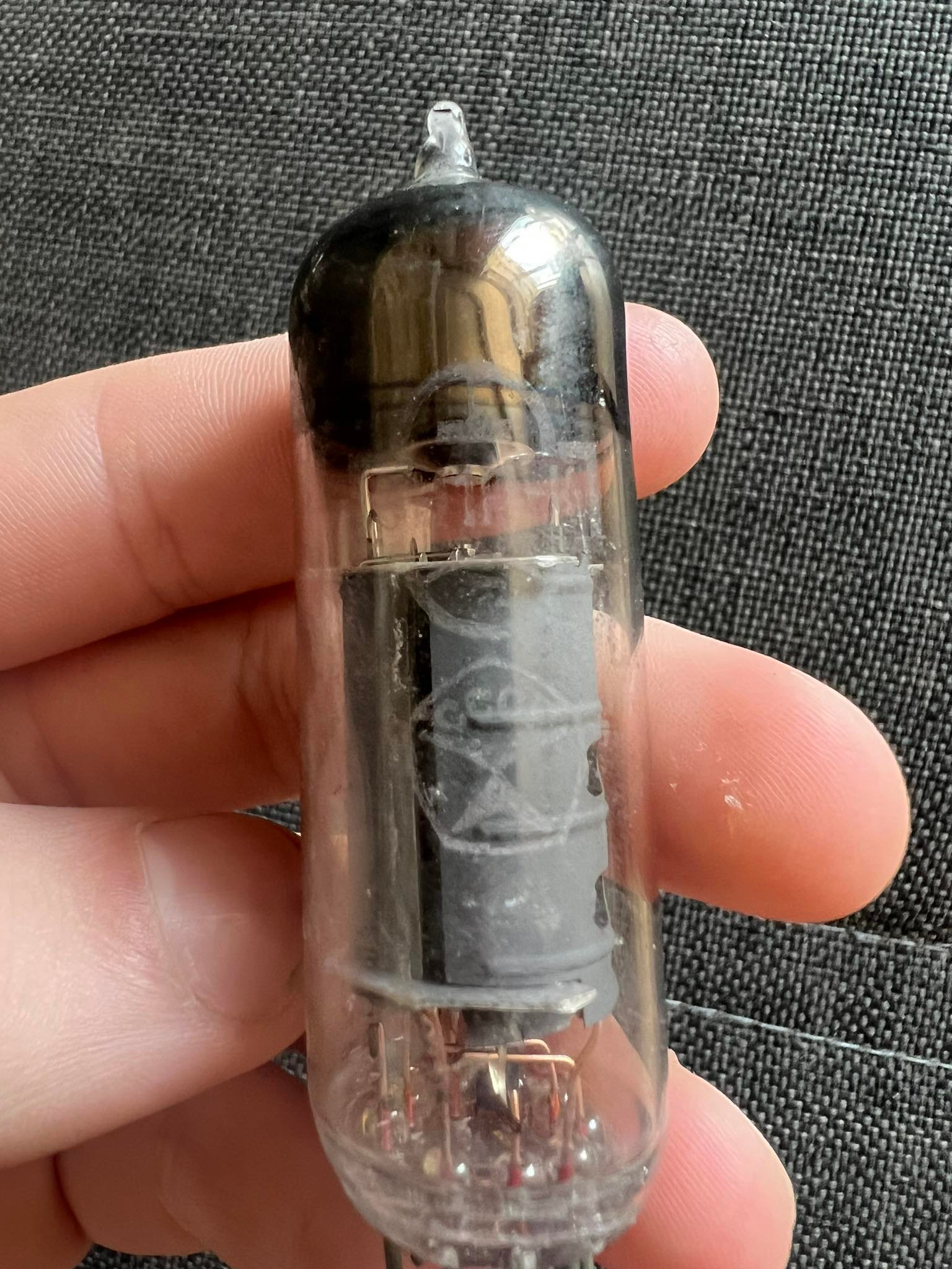

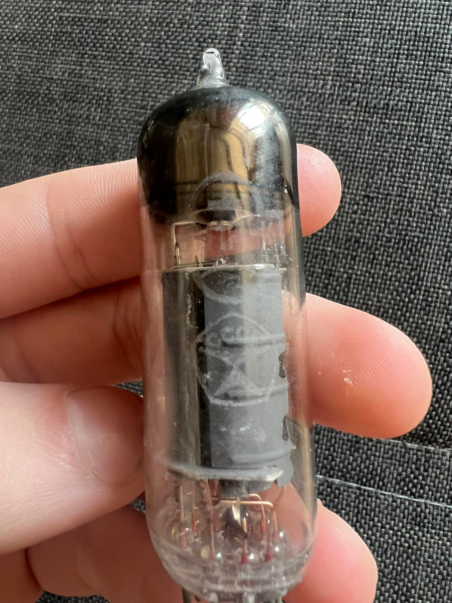

thanks for the help. on the photos are they also getters yes? when I dissolved spirals in nitric acid I got light white precipitate and green solution. I thought it was titanium and nitric acid oxidise it more easily because it was in alloy with nickel.
281822582_961850434496594_5105668647714527624_n.jpg [ 279.23 KiB | Viewed 8756 times ]
280715332_420181703287853_4541528570350611812_n.jpg [ 296.96 KiB | Viewed 8756 times ]
PostPosted: 27 May 2022 18:25
Posts: 69131
I think it's getters. Typically titanium, tantalum or barium is used.
PostPosted: 27 May 2022 19:25
Posts: 1931
Most common material for electron tube electrodes (especially anodes) is molybdenum and its alloys, so light white precipitate You got is probably molybdenic acid. Try to dissolve this precipitate in water ammonia and test it by "molybdenic blue" reaction. Heating filament ("spiral") is made usually of tungsten which reacts likewise. Control grids are coated sometimes with gold to decrease secondary emission.
PostPosted: 27 May 2022 20:01
Posts: 333
Location: Georgia
thanks friends! maybe it is a molybdic acid because of colour, it has white-bluish colour, it dissolved in ammonia solution and yes i will try to reduce it with atomic hydrogen.
