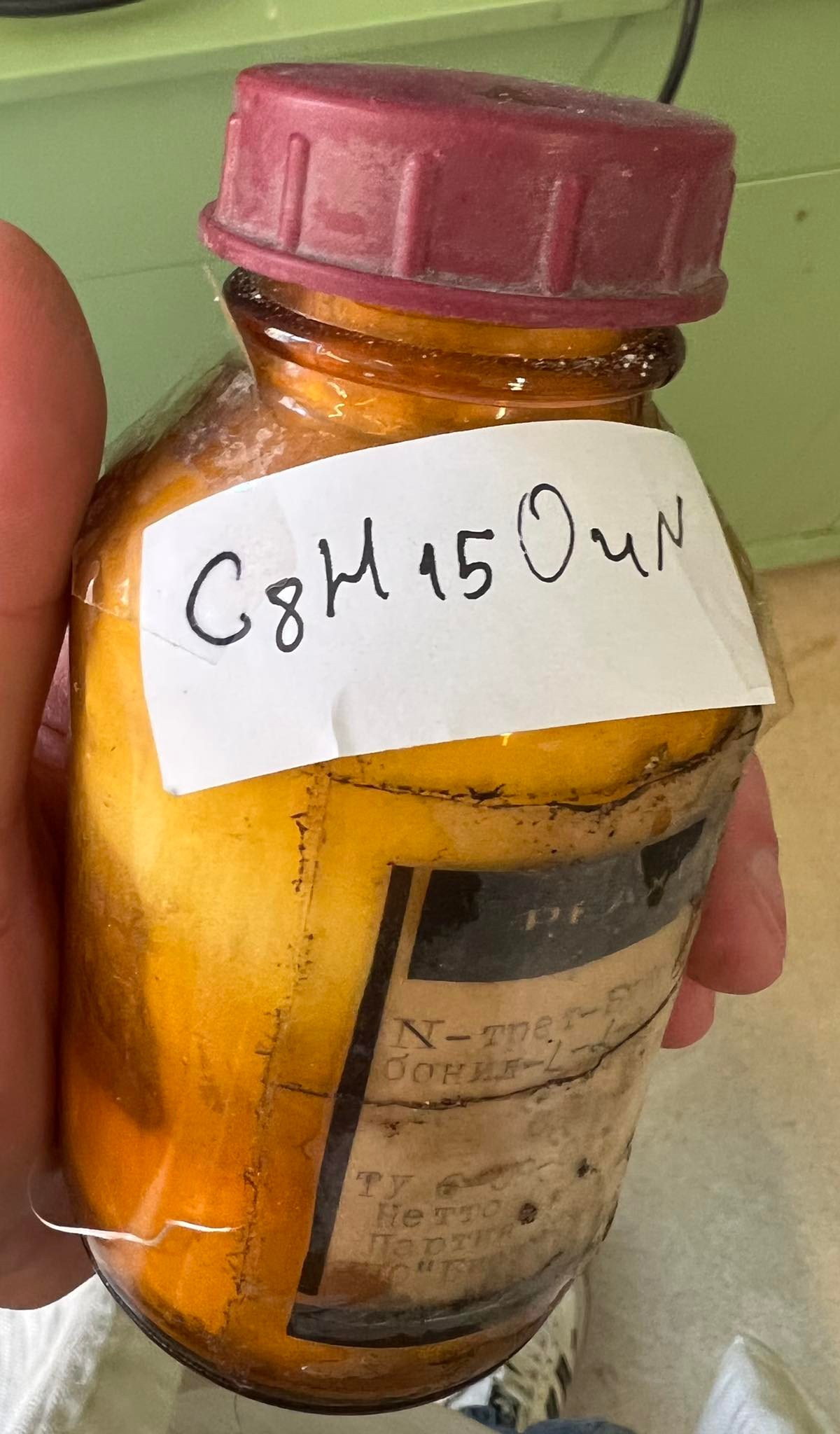

hello! what do you think it is? unfortunately, I don't have a label photo.
282804661_976283019724190_7687712637789638718_n.jpg [ 243.94 KiB | Viewed 10024 times ]
PostPosted: 28 May 2022 17:50
Joined: 17 Feb 2019 17:13
Posts: 225
Location: Latvija, Rīga
N-(tert-Butoxycarbonyl)-L-alanine?
CAS 15761-38-3
PostPosted: 28 May 2022 18:36
Joined: 14 Jul 2021 12:13
Posts: 333
Location: Georgia
thanks! maybe it is. I found isomers but they're a lot.

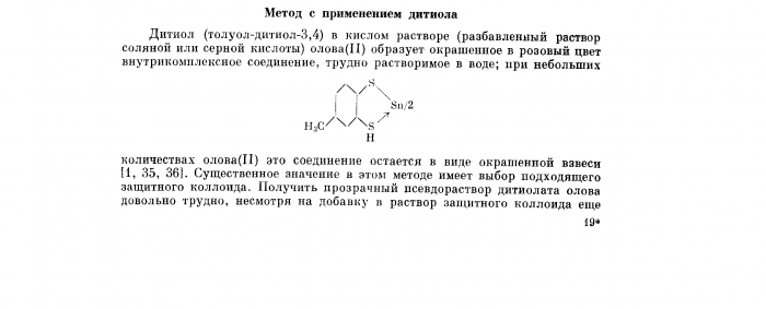

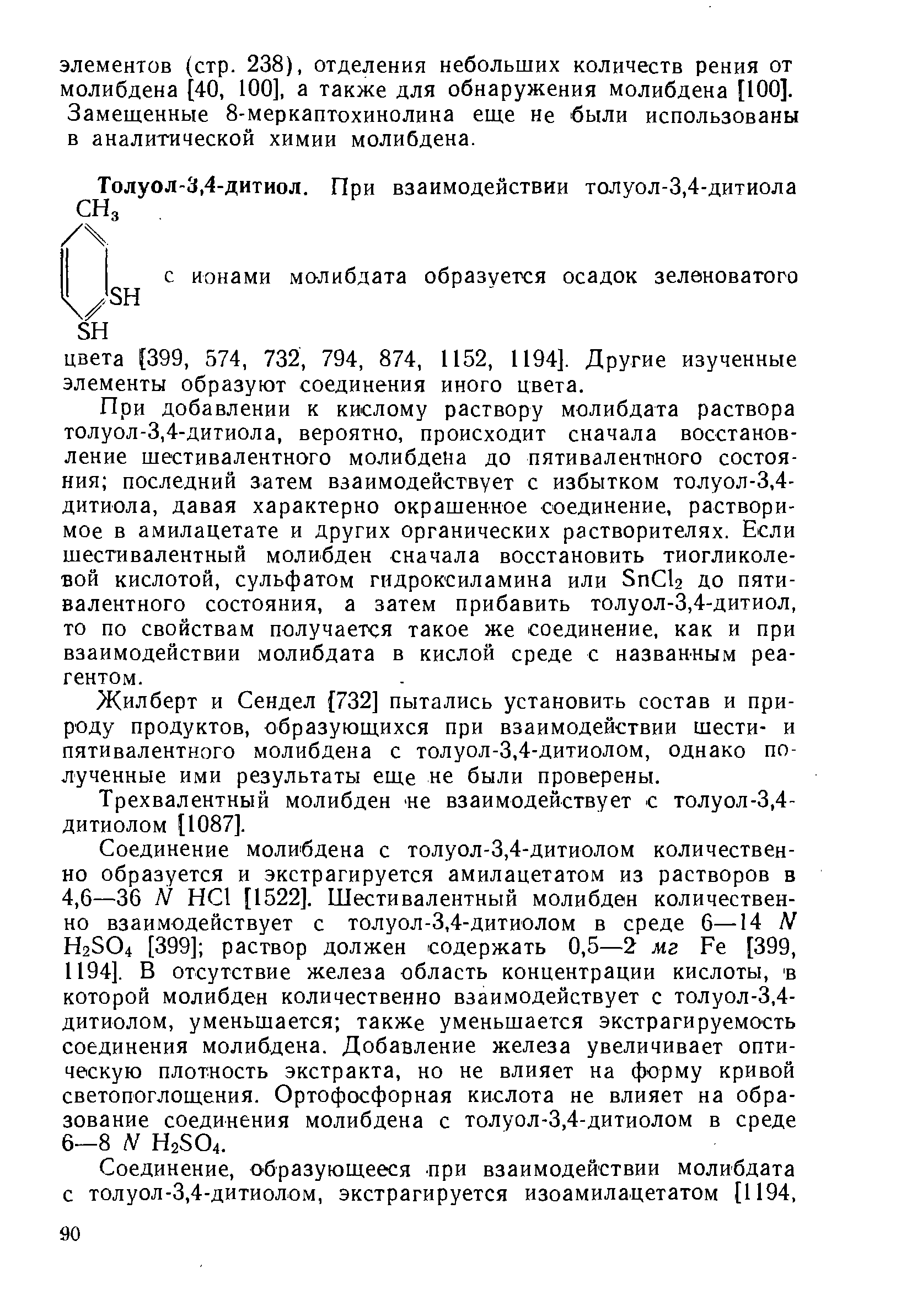

hello. what interesting things i can make with toluene-3,4- dithiol in organic synthesis, complexes, etc.?
PostPosted: 01 Jun 2022 10:19
Posts: 69131
This is an analytical reagent. For example, for tin and molybdenum.
Clark, R. E. D.; Neville, R. C. (1959). Toluene-3,4-dithiol and its derivatives as analytical reagents: A new approach to qualitative inorganic analysis. // Journal of Chemical Education, 36(8), 390–
File comment: Clark, R. E. D.; Neville, R. C. (1959). Toluene-3,4-dithiol and its derivatives as analytical reagents: A new approach to qualitative inorganic analysis. // Journal of Chemical Education
ed036p390.pdf [4.08 MiB]
Downloaded 327 times

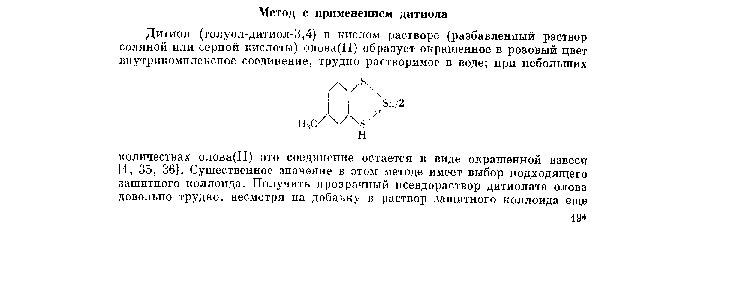

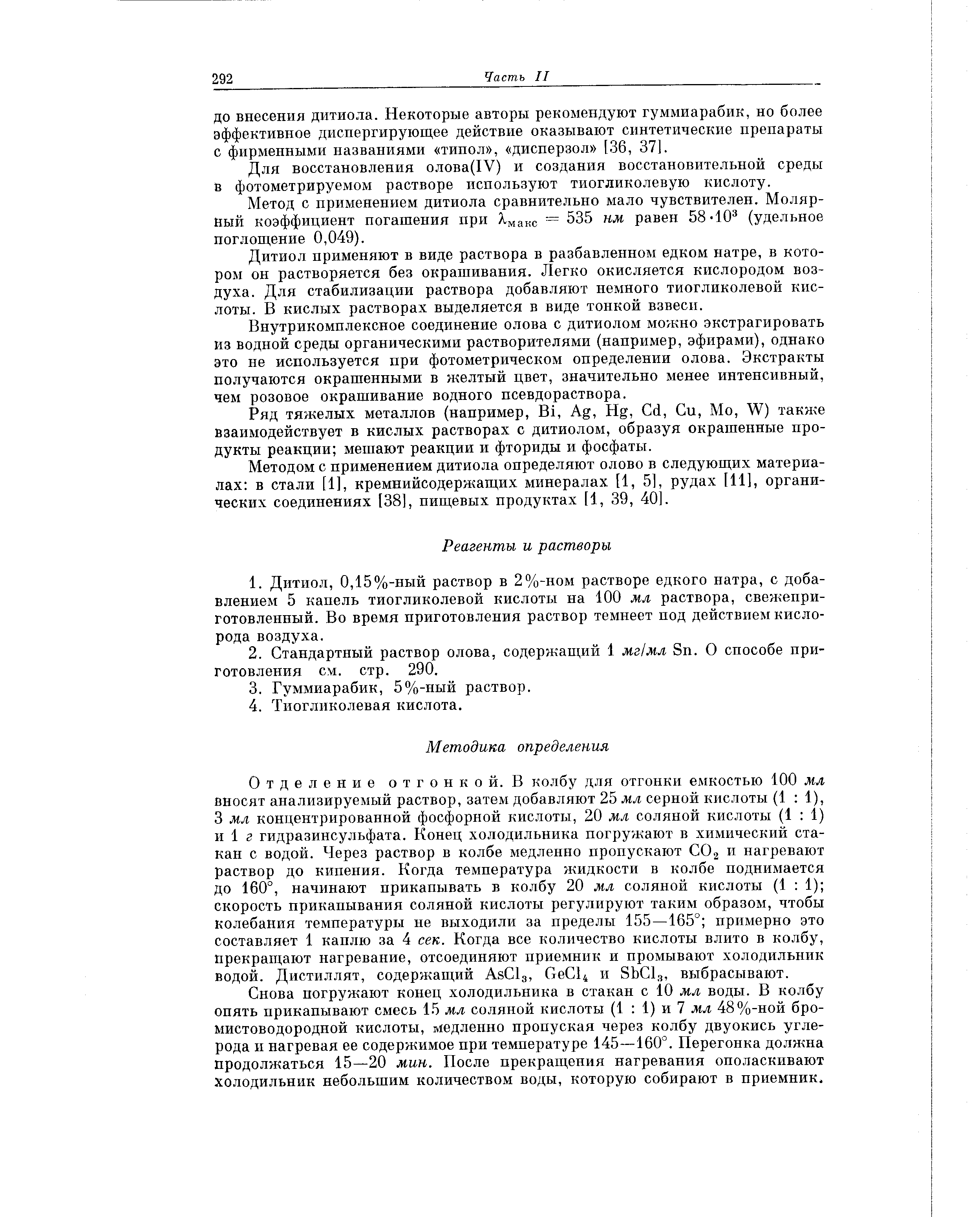

Sn -
Марченко З. Фотометрическое определение элементов (1971) viewtopic.php?p=27452#p27452

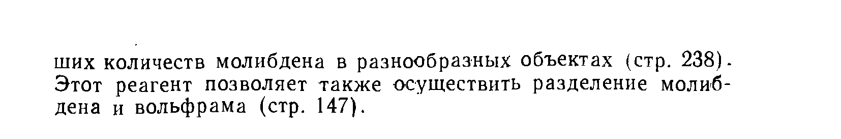

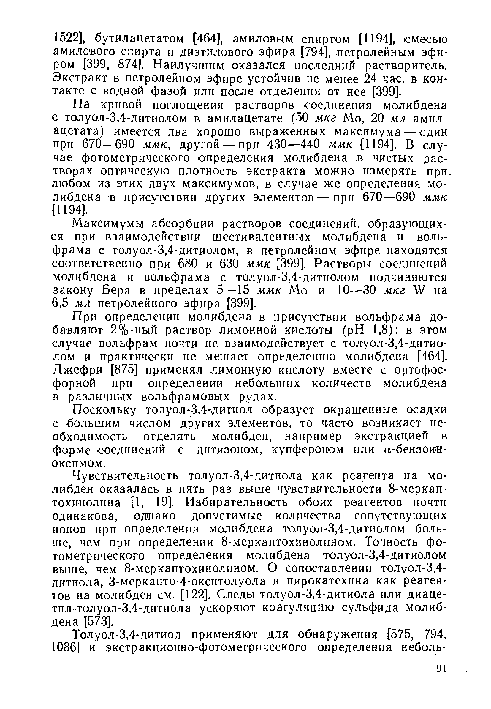

Mo -
Бусев А.И. - Аналитическая химия молибдена http://chemistry-chemists.com/book5/him ... ov/Mo.djvu

thanks! I just want a solid complex in the vial, can i make it easily what do you think?
PostPosted: 01 Jun 2022 18:55
Posts: 69131
The complex with tin is insoluble in water. Dithiol is used as a solution in 2% sodium hydroxide. The solution is oxidized by air - prepare before synthesis.
(the quote from the book is in the post above).

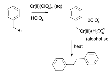

hello, I want to try this organic reaction. I have perchloric acid, but as I know it's hard to make chromium 2+ salts, I don't have chromium metal to make divalent salt from its amalgam. is there another way which worth to try?
PostPosted: 16 Jun 2022 18:50
Posts: 69131
Cr(III) or Cr(VI) + Zn + HCl (aq) => Cr(II) (blue)
Is it possible to use HClO4 (aq) instead of HCl (aq)? I don't know.
PostPosted: 16 Jun 2022 18:56
Posts: 333
Location: Georgia
thank you! I've seen an atomic reduction reaction, but I thought it would not be very stable in solution. I will try to use zinc to see what comes out.
PostPosted: 16 Jun 2022 19:15
Posts: 69131
Cr(II) is easily oxidized by air. It gradually reacts with water.
