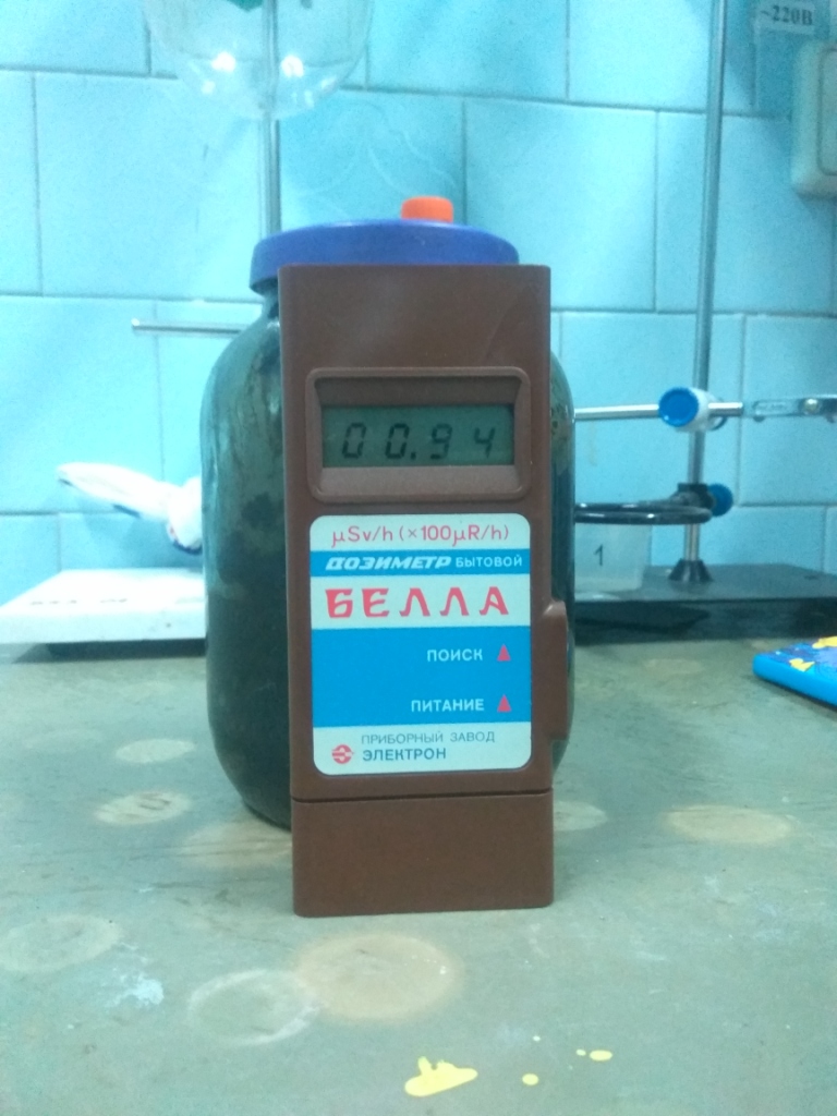

P.S. I had similar minerals at my last job - oil production sludge. But there was no laboratory to work with them.

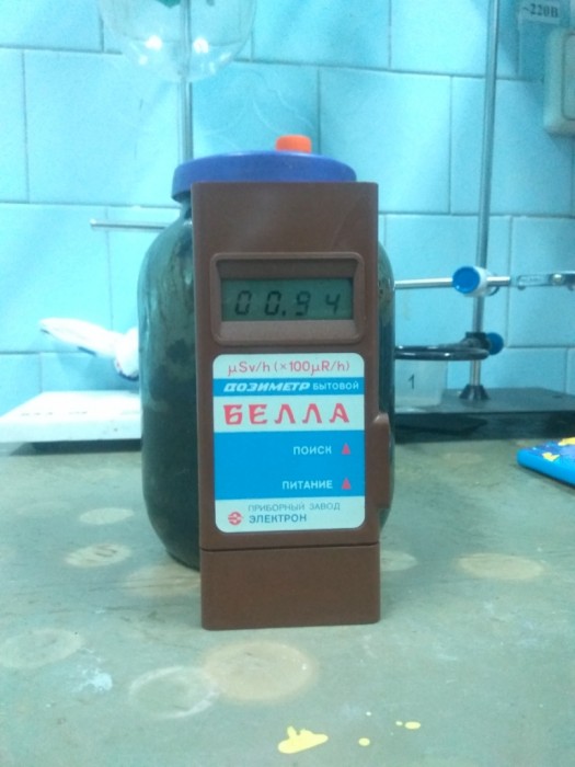

File comment: microsieverts

thanks for answers. If something interesting comes out, I will definitely post it here.

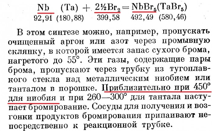

today I found some bromine in the vial, that was not useful for me, then I add some niobium (not powder). I know it needs a high temperature to make pentabromide, as the literature said, but I watched a video where one guy used a condenser also, so there was less than 100C. so maybe I'll get some niobium pentabromide? maybe weeks or months later?
PostPosted: 01 Sep 2022 21:48
Posts: 69131
It is most likely that the reaction will not occur at room temperature or at low heat.
Brauer recommends using a temperature of 450C (in steam).

yes. I love Brauer, good inorganic book. I just watched this video. so now I'm interested in how and if this reaction goes, let's try. ill write the result here. in my opinion, it's possible that ill get yellow niobium oxybromide.
PostPosted: 01 Sep 2022 22:03
Posts: 69131

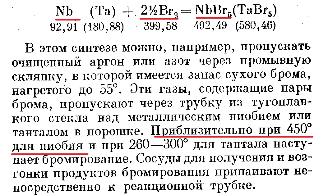

In the Russian edition - 450С,
Г. Брауер (ред.) Руководство по препаративной неорганической химии (однотомник)
Code:
http://chemistry-chemists.com/book5/himija/neorganicheskaja_i_analiticheskaja_himija/Brauer_Ruk_Preparat_Neorg_Chem.pdf

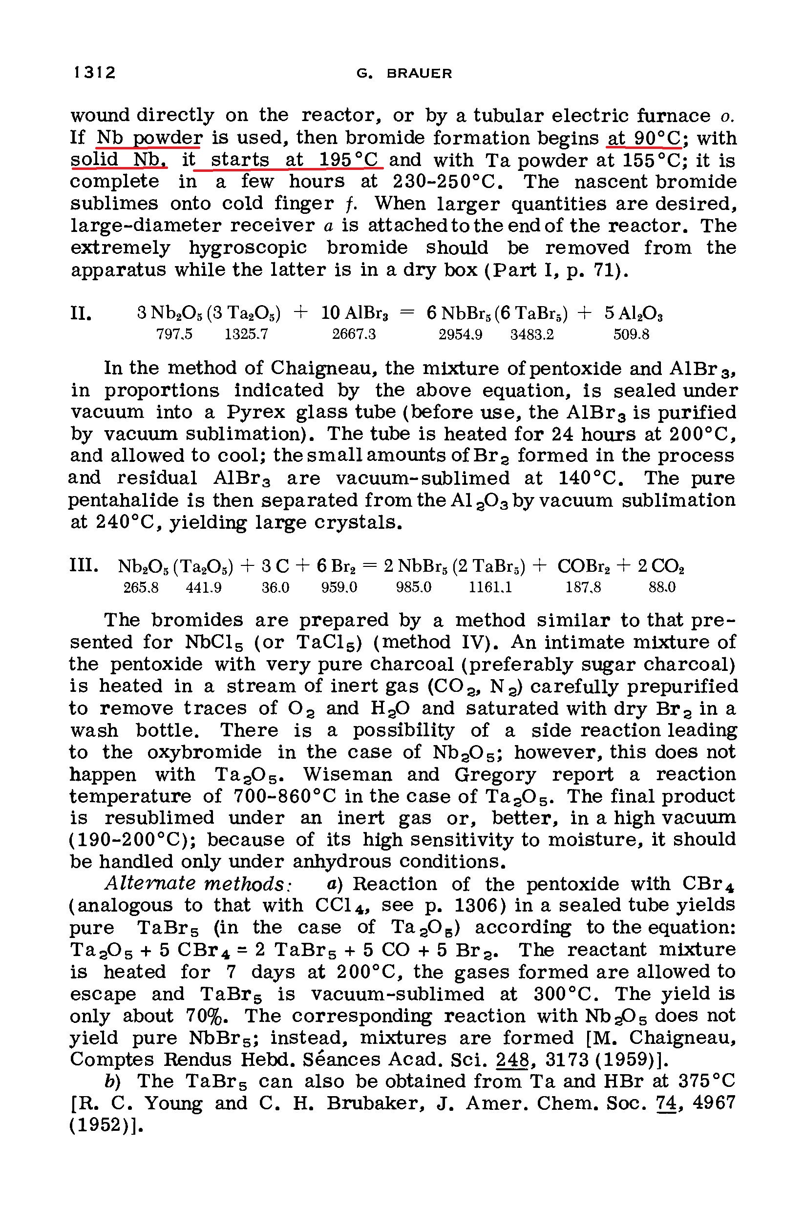

the English edition recommends lower temperatures (from 90C for powder and from 195C for compact niobium)
Brauer G. Handbook of preparative inorganic chemistry vol.2, 1965
http://chemistry-chemists.com/chemister ... 963-2.djvu

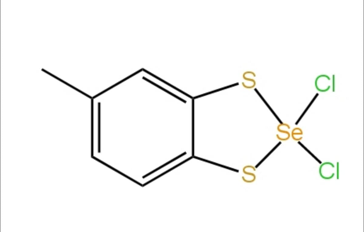

I have some SeCl4 dichloromethane solution, i want to make dithiol complex. as research said selenium produces yellow precipitate with toluene dithiol. so I made a structure, what do you think the structure will be like that? just i cant make an analysis right now.

In addition to this substance, related compounds (mixture) can be formed
