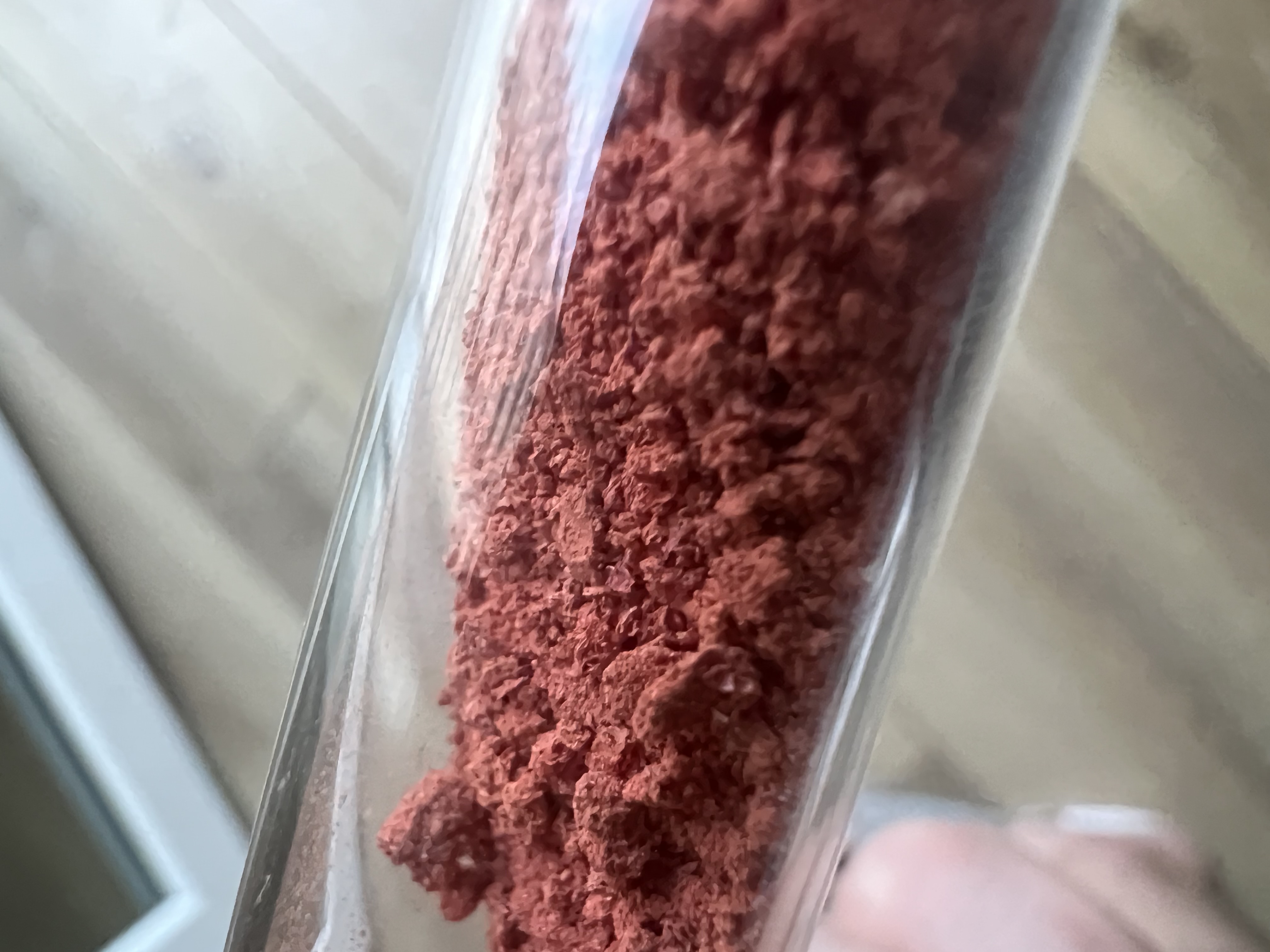

hello! does anyone has any information about Ti(III) inorganic complexes, I found only organic complexes. in m soviet books there are not complexes, only compounds. also, my starting material is titanium trichloride.
PostPosted: 20 Sep 2022 16:38
I think that such complexes are low stable. They can exist in dynamic equilibrium with ligangs
PostPosted: 20 Sep 2022 17:30
Joined: 14 Jul 2021 12:13
Posts: 333
Location: Georgia

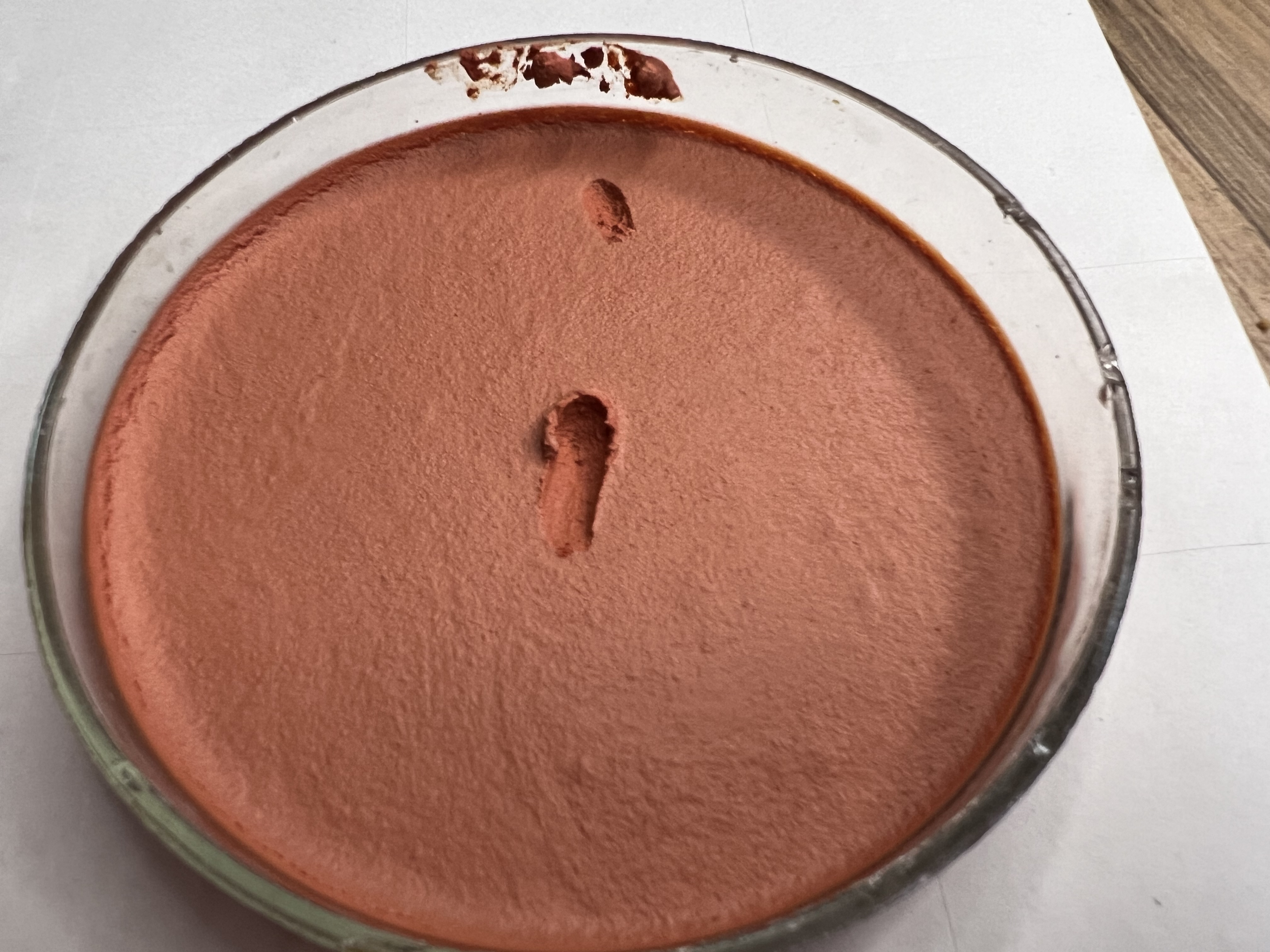

thanks! I want to make Ti(III) selenite, I made this reaction in a test tube, I added titanium trichloride solution in sodium selenite pentahydrate solution, and I saw colorful precipitate, ill make solid salt today. just i didn't find information about this salt. is it Ti2(SeO3)3, what do you think?
PostPosted: 20 Sep 2022 17:48
Posts: 69131
Ti(III) can reduce Se(IV) to Se(0).
PostPosted: 20 Sep 2022 17:57
Posts: 333
Location: Georgia
yes but, I have made red allotropy many times, from my experience the allotropy looks different. so ill dry this precipitate and put it under sunlight. if it turns black it is red allotropy, so if it isn't, then that is selenite.
PostPosted: 21 Sep 2022 14:01
Posts: 69131
I hope you are wright.
PostPosted: 21 Sep 2022 17:48
Posts: 333
Location: Georgia

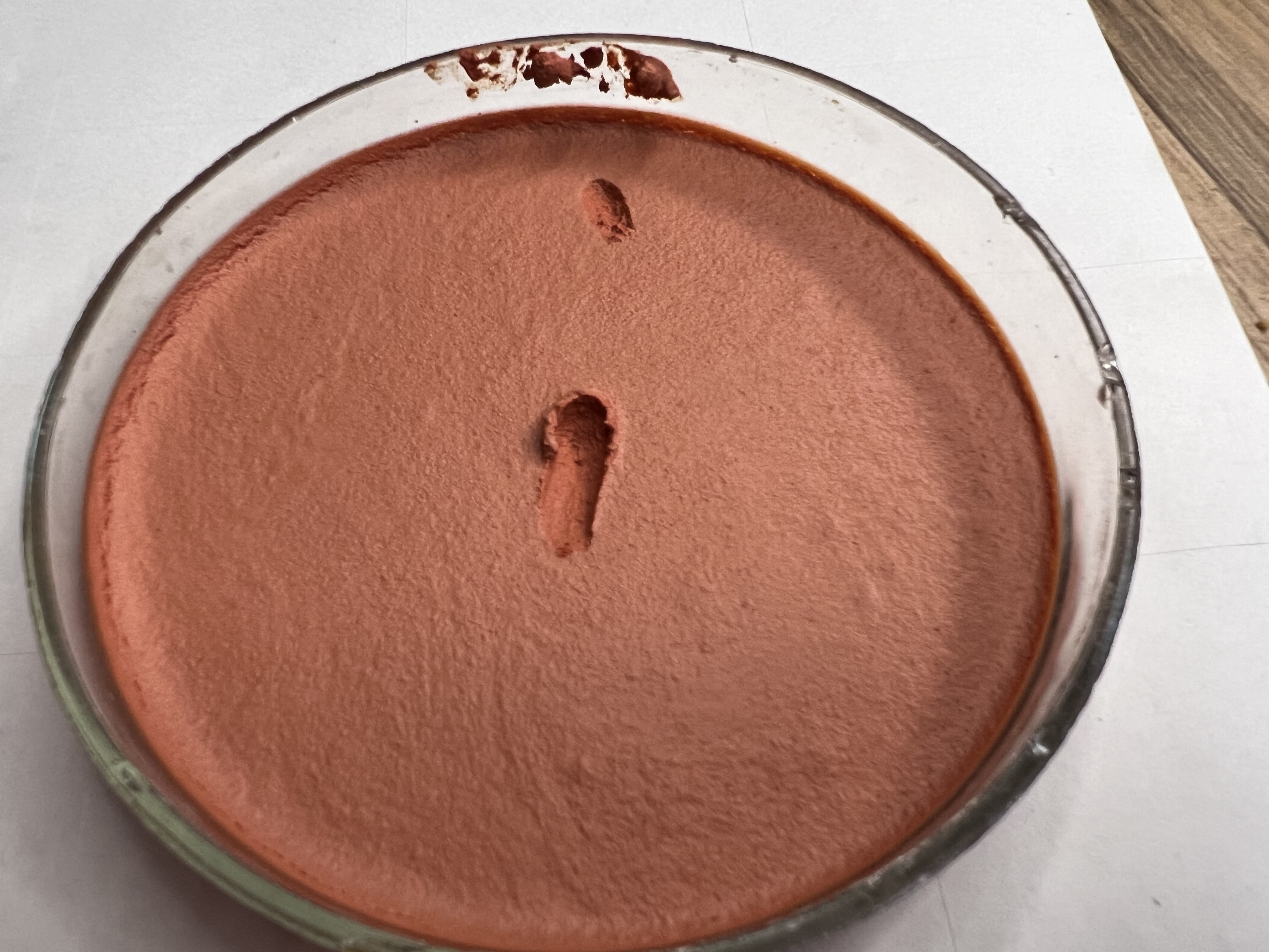

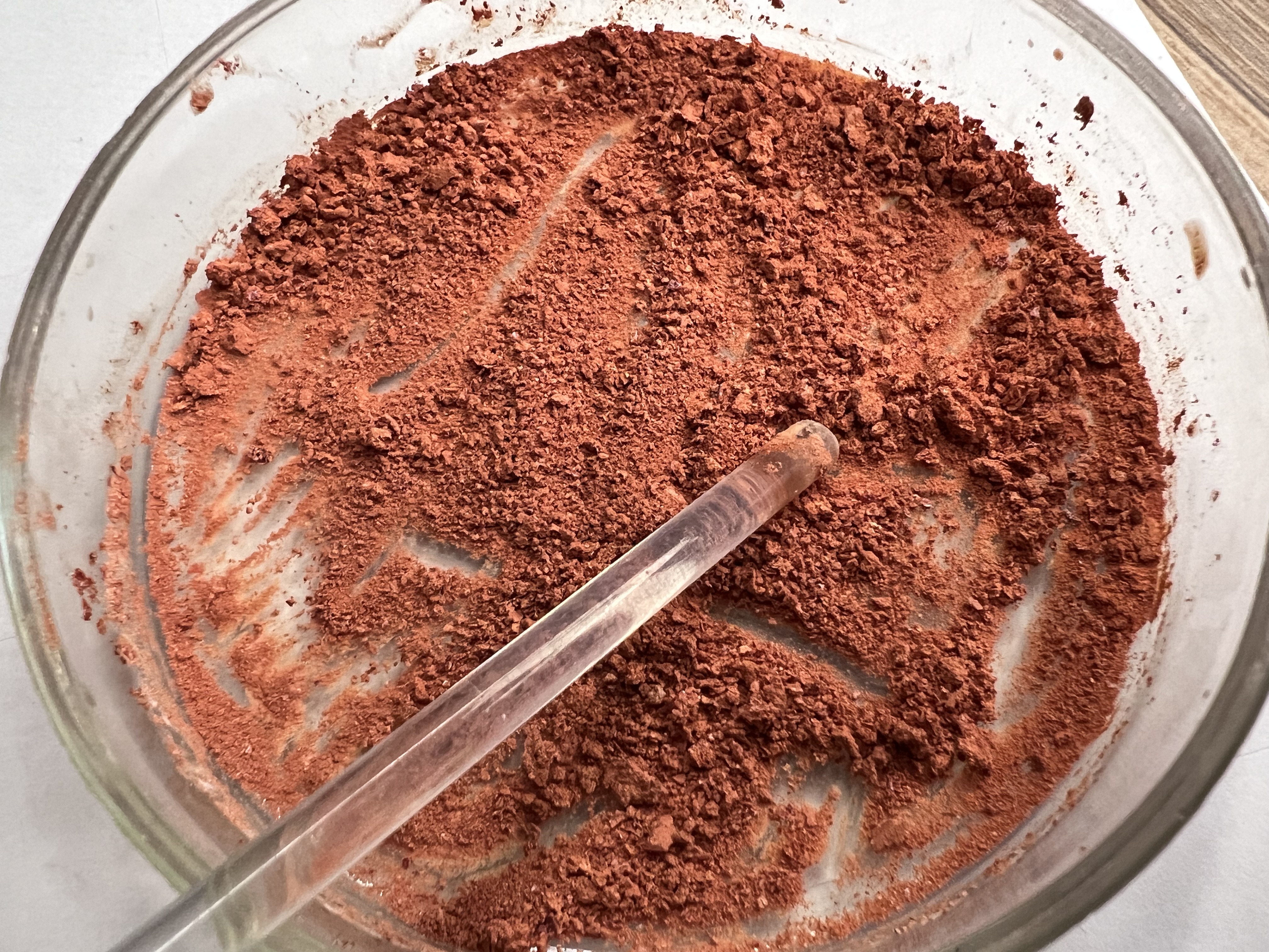

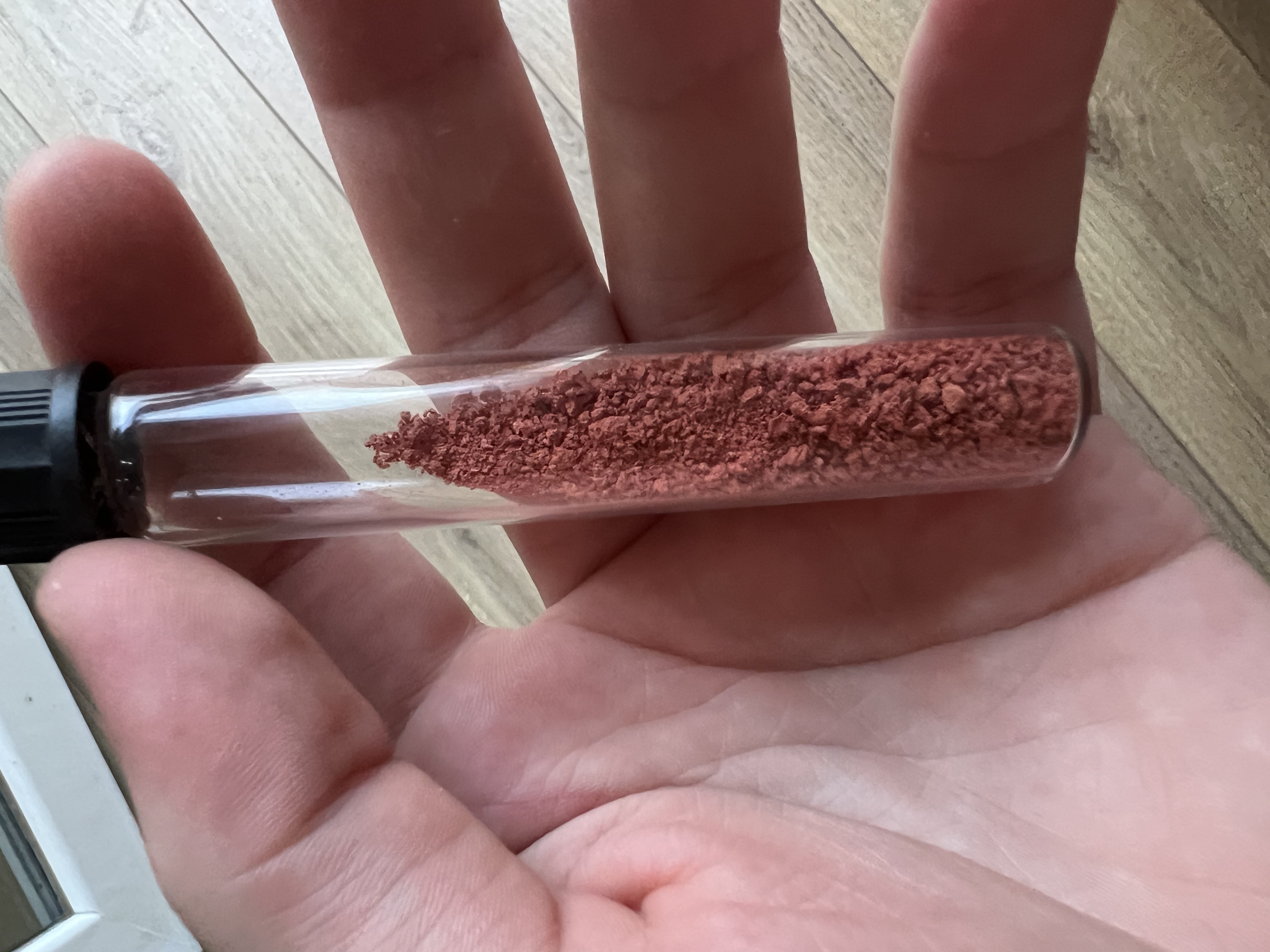

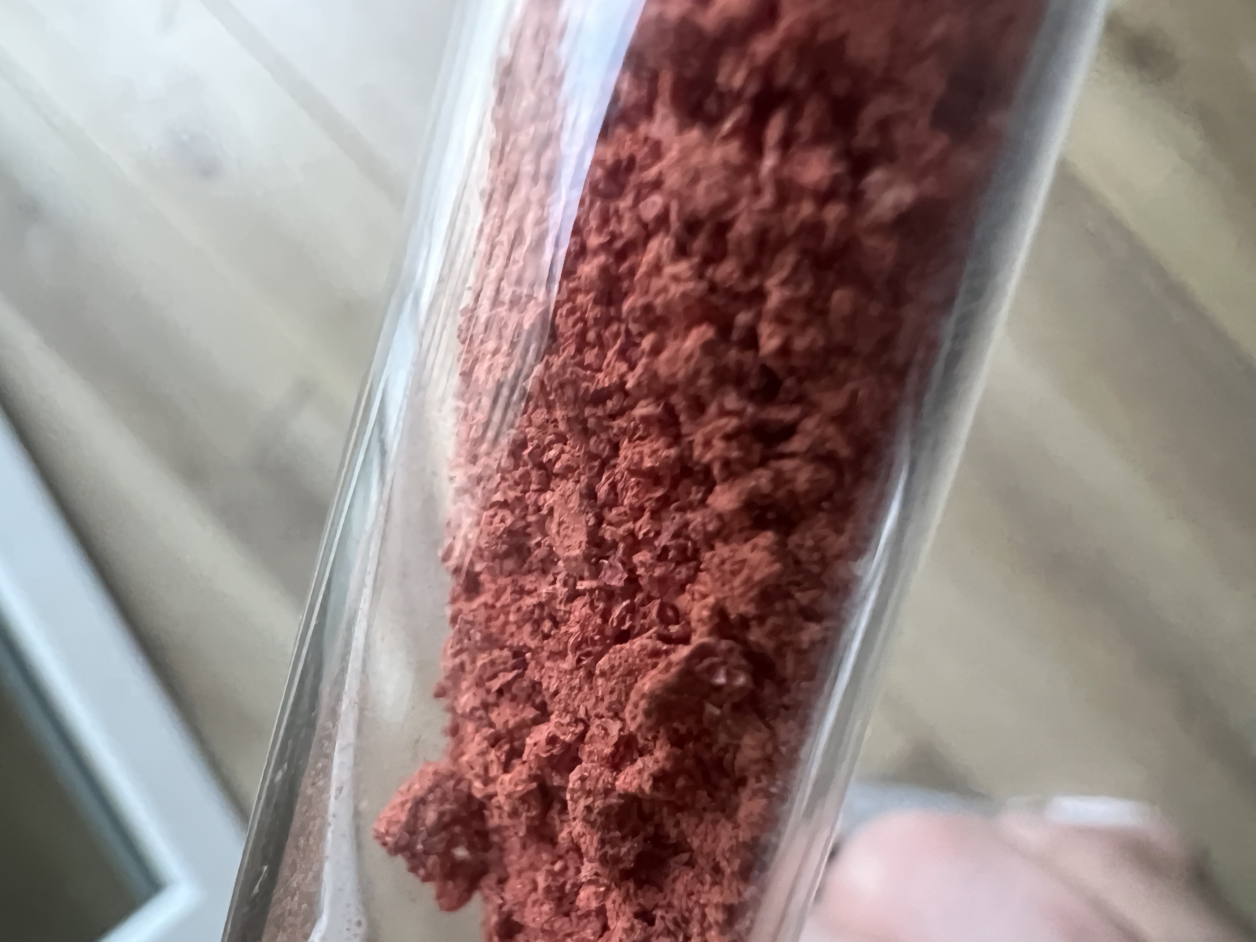

today I dryed it under sunlight, still red color. interesting is this selenite? but there is not red selenium I'm sure, today was a very sunny-hot day, the last time when I made red selenium, I dryed it under sunlight, and it turns black form in 30 minutes. just im surprised why nowhere is information about that compound.
PostPosted: 21 Sep 2022 19:16
Posts: 2372
Both titanium compounds and most selenites are colorless. It looks like a mixture of titanium hydroxides (4) and selenium (0) .

thank you! but red selenium turns black under sunlight it needs just minutes. I'm not sure as I said. I can't make any analysis now. also, I don't like when I have chemical and I don't know exactly what it is. I think the best idea now is to make some TiO2*nH2O, ill add nitric acid, the final product anyway will be oxide hydrate. also, I always wanted a hydrated form of the oxide, I have dioxide but because it is calcinated at high temperatures I can't make anything from it.
PostPosted: 21 Sep 2022 23:44
Posts: 2372
You can try to treat the substance with carbon disulfide or benzene. Selenium should dissolve.

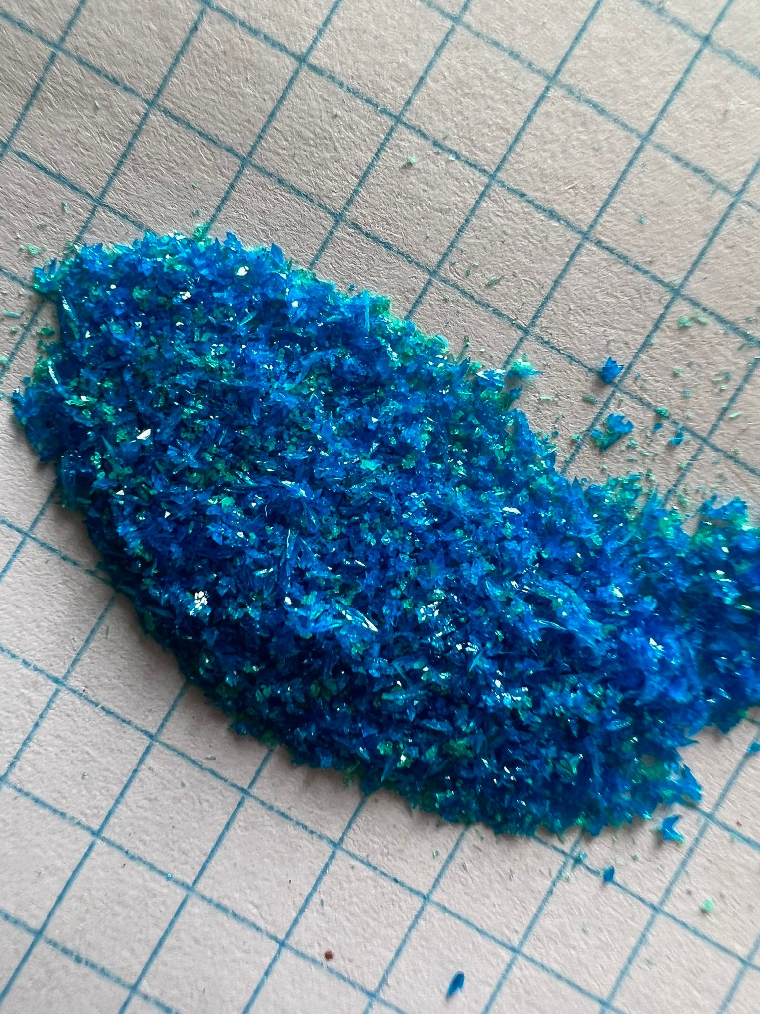

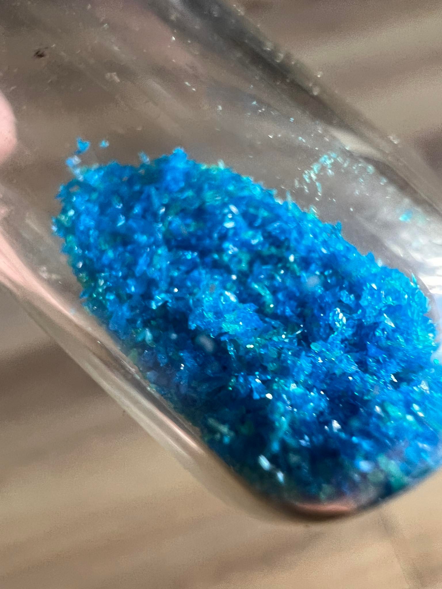

Hello! I tried to make europium sulfamate, but it was hard to remove the compound from the flask, so I dissolved Eu sulfamate in water and add sodium selenite (exec) to make Eu selenite. I added CuCl2*2H2O to the filtrate, it dissolved rapidly. the solution was clear, and after an hour I saw some blue crystals.
Then I made a sulfamic acid sodium selenite solution mixture added some copper chloride and I got the same crystals. copper selenite is very insoluble it forms powder instantly, I never saw Cu selenite crystals and copper sulfamate is soluble and has a darker color. I have no idea which compound it is, but when I burnt it with a flame torch, I saw the vapor of red selenium and smell its unpleasant odor. this fact means that it contains selenite anion.
crystals are insoluble in water, I also try boiling water.
here are photos.
308069646_508835437276527_7110591862003507157_n.jpg [ 361.51 KiB | Viewed 10733 times ]
308211740_1490529004761639_5176419558640225678_n.jpg [ 629.78 KiB | Viewed 10733 times ]
PostPosted: 01 Oct 2022 20:02
Posts: 69131
Sulfamic acid is strong. It may increase the solubility of copper selenite. More solubility - bigger crystals.

good idea. yes if we add sodium selenite in a copper salt solution, it precipitates instantly and when I added copper chloride to the mixture it was a blue clear solution. so insoluble copper selenite is more soluble in sulfamic acid solution and crystallizes slowly. ill try if I make bigger crystals.
