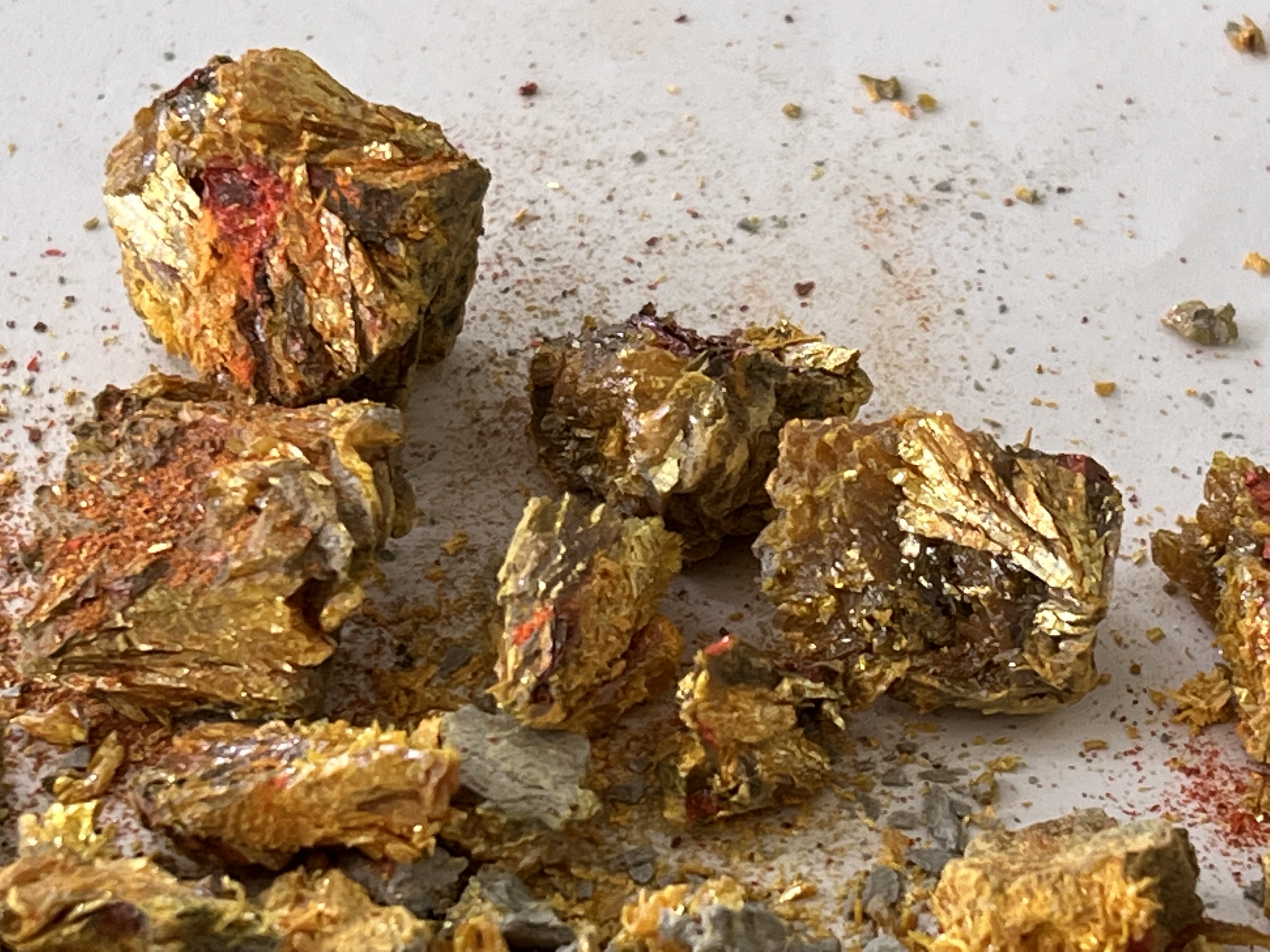

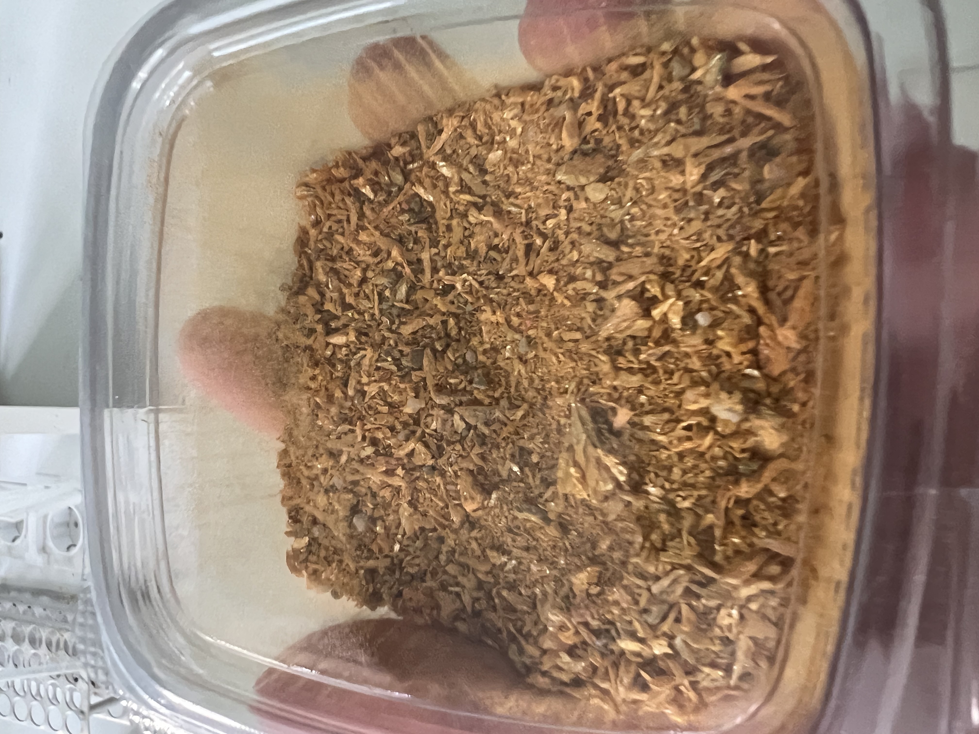

Hello! I have a question about arsenic. I have good ores of arsenic, I have orpiment. I made some powder from a few ores with a mortar and pestle. almost all were As2S3, I couldn't powderize just silicate rocks, they were hard, so then I separate them with tweezers. I want to make any arsenic compound or arsenic, but I want it in a beaker. now I can't make steel apparatus and distilled arsenic from sulfide iron mixture. I added conc. hydrochloric acid but sulfide didn't dissolve in it. what can I do?

I dissolved it in conc. nitric acid, I just thought that I don't have it but I found a few mls. ill buy the acid and make more H3AsO4 solution. I'll take any advice on what to do then with arsenic acid.
PostPosted: 04 Oct 2022 20:42
Posts: 69131
Sulfuric acid also forms.
As2S3 + 28 HNO3 → 2 H3AsO4 + 3 H2SO4 + 28 NO2 + 8 H2O
I think you should precipitate MgNH4AsO4 to separate AsO4(3-)

I read that sulfuric acid is also useful for this reaction, but I use 96% sulfuric acid, nothing happened, and no SO2 smell also of course. then I dilute it but also nothing happened.
good idea for separating 3&5 valency of arsenic, but if I use exec conc. nitric acid must form only arsenic(VI), isn't it?

I said about another.
Nitric acid reacts with As2S3 and gives mixture of arsenic acid and sulfuric acid. If sulfuric acid does not interfere it is OK.
If necessary, sulfate SO42- and arsenate AsO43- can be separated by precipitating of MgNH4AsO4.

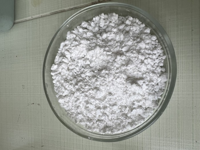

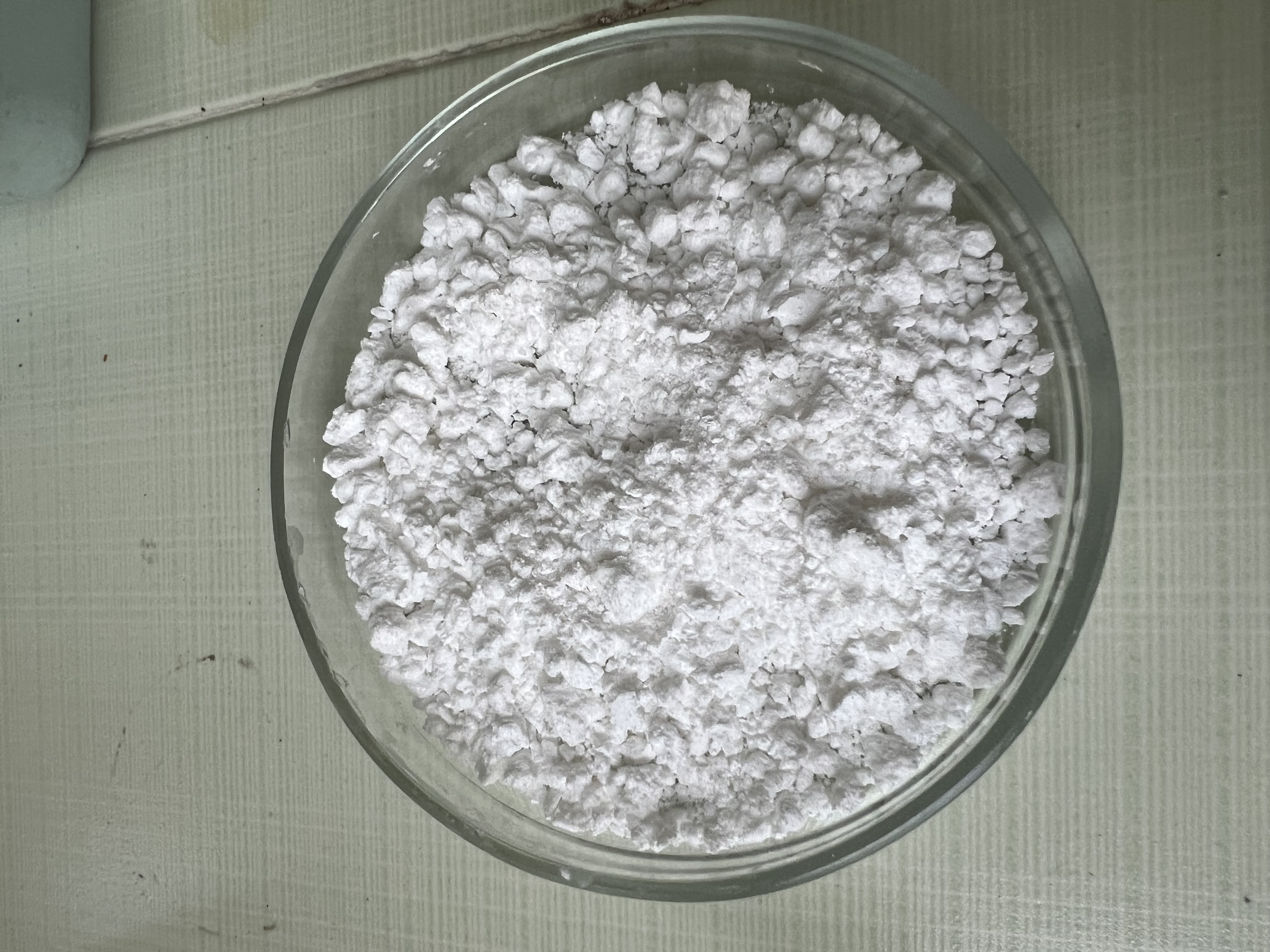

PostPosted: 12 Oct 2022 18:37
Joined: 14 Jul 2021 12:13
Posts: 333
Location: Georgia
thank you! that's interesting.
photo of magnesium-ammonium arsenate hydrate.

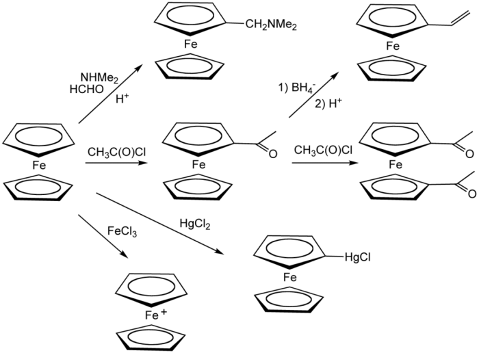

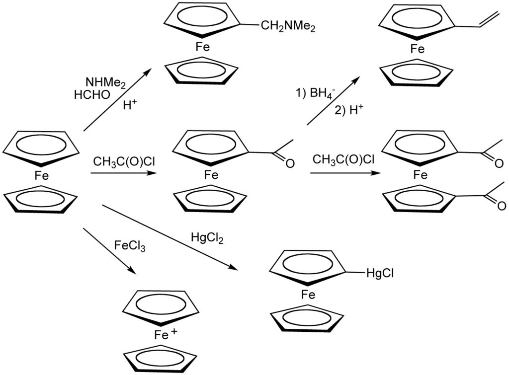

maybe acetylation and such reactions are better for practicing. I just requested a few hundred grams from the university warehouse, so I must use it for something.
PostPosted: 17 Oct 2022 21:29
Posts: 69131
For example, vacuum sublimation (purification).
More serious things are the reactions of substitution in the cyclopentadiene ring
File comment: https://en.wikipedia.org/wiki/Ferrocene#/media/File:FcGen'l.png

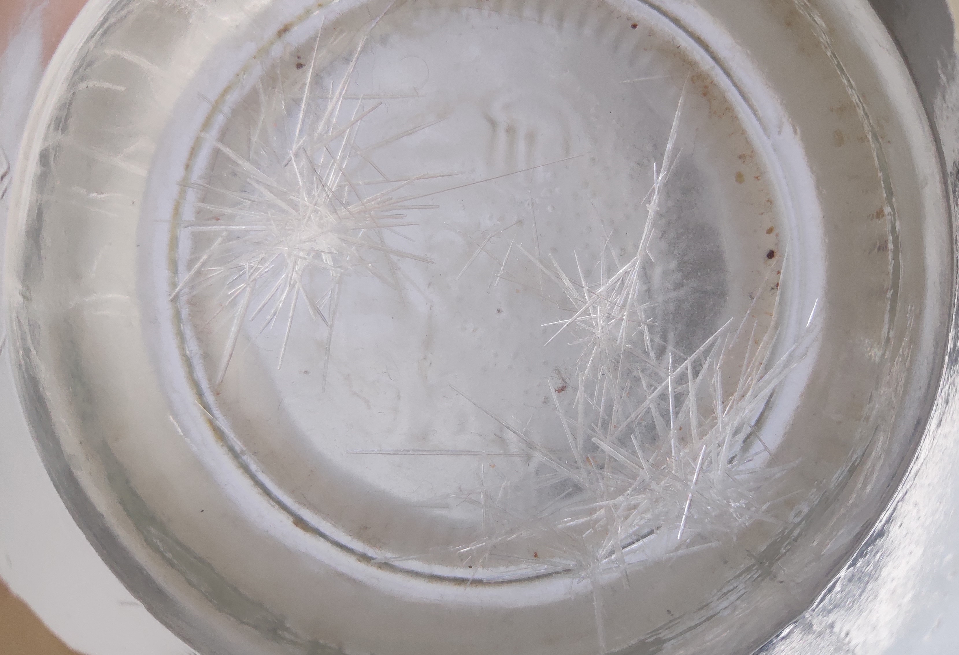

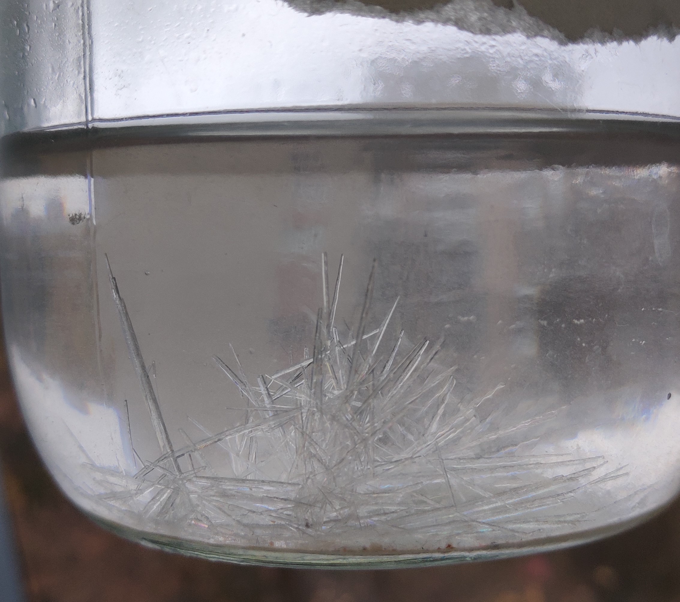

Всем привет, сегодня вспомнил о старой банке в которую сливались ненужные остатки этилового спирта и обнаружыл в ней кристаллы.
Разве для образования крислов не нужно большой концентрации соли? И есть идеи какая могла быть соль в спирте?
Спасибо!
Фото 1
Фото 2
p.s. я не химик :)
