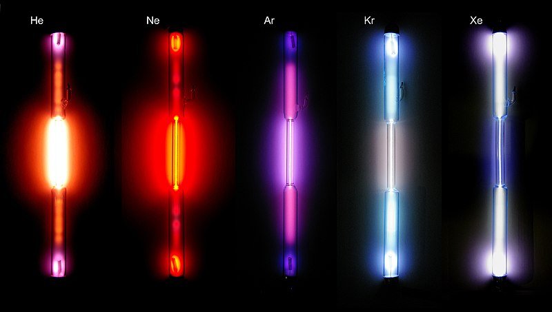

The Incredible Discovery of the LEAST Reactive Elements (The Noble Gases)
