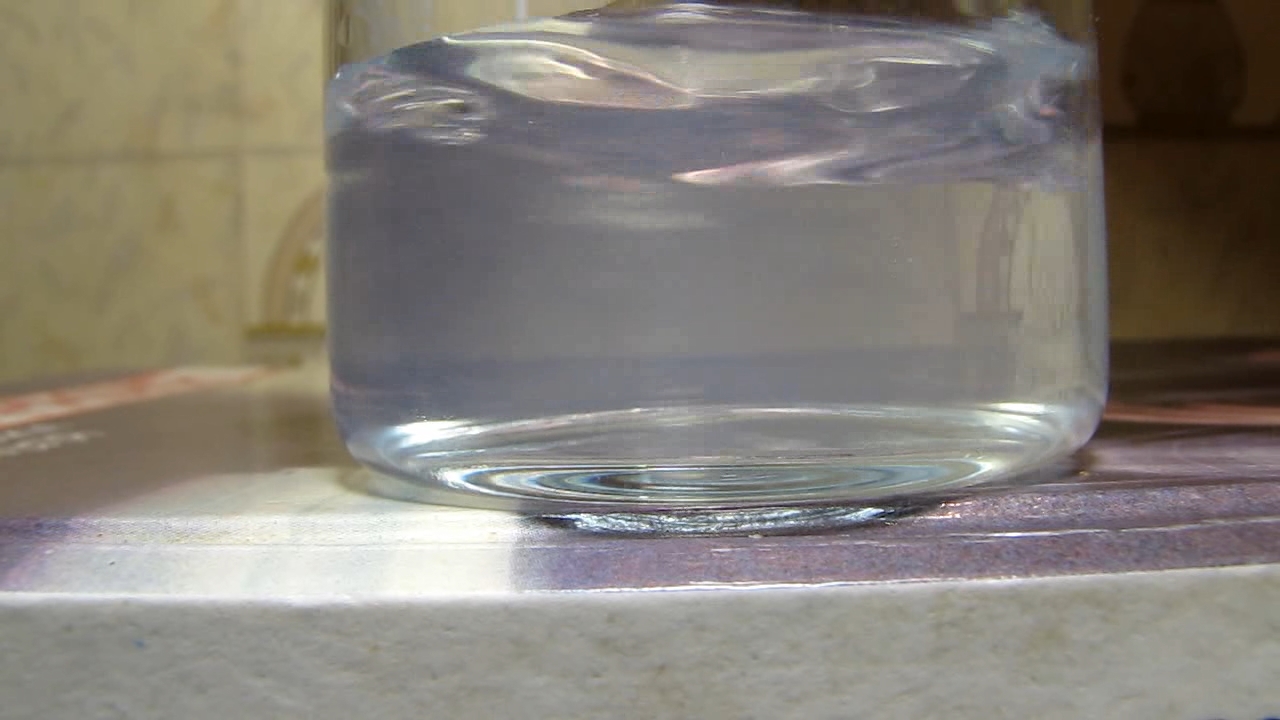

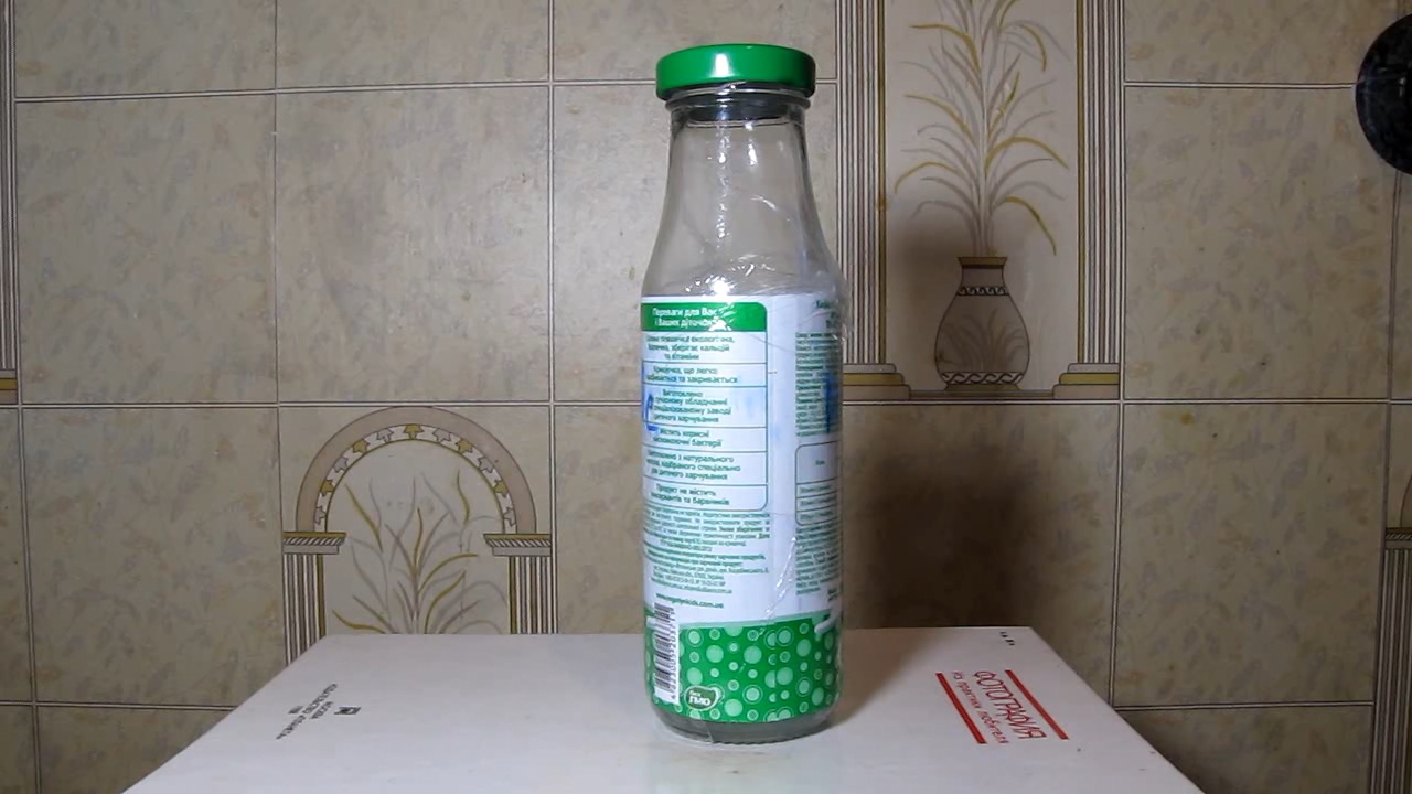

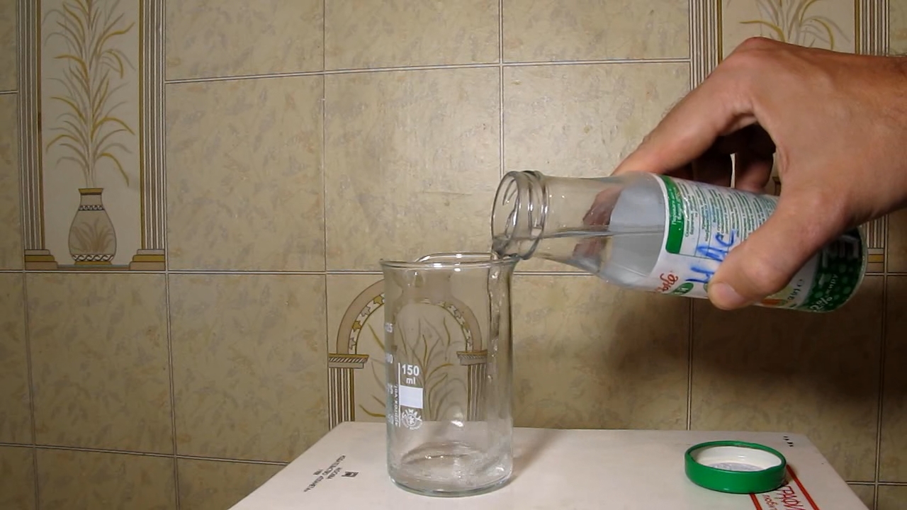

Glacial acetic acid became contaminated due to storage in glass bottle - pt.3
Glacial acetic acid became impure due to storage in a glass bottle. Is it possible? Yes, It is quite possible. Of course, glass is resistant to acetic acid, but... Ледяная уксусная кислота загрязнилась в результате хранения в стеклянной бутылке - ч.3 But let us not get ahead of ourselves and talk about everything in order. I planned to dissolve copper in dilute acetic acid to take photos/videos of the experiment. Some readers perhaps say that copper does not dissolve in acetic acid, won't they? Metallic copper dissolves in this acid if an oxidizing agent is present, such as hydrogen peroxide or atmospheric oxygen. I did not have acetic acid, so I asked a colleague. A colleague gave me glacial acetic acid, which was contained in a glass kefir bottle [5]. I took a flask, poured glacial acetic acid and distilled water into it and dipped stripped copper wire into the solution. I saw that the solution became cloudy! What is the reason for the appearance of turbidity in the liquid? The distilled water was without any traces of turbidity. The acetic acid was chemically pure, transparent and colourless in appearance. Could the flask be contaminated? The flask was brand new and visibly clean. Where did I acquire this flask? At work. In theory, the flask was intended to distil water samples before analysis. But in reality, my neighbour (the same one discussed in the last part of the article) does not use distillation flasks. He does not need them. My neighbour invented a new method of water distillation, unknown to science. The method could be termed "Direct distillation" and does not include boiling, evaporation, or condensation. How is it possible? The neighbour takes the original sample of water (that needs to be distilled) and pours it into a receiving flask designed for the already distilled sample. In other words, he does not need the distillation flask, condenser, electric stove/heater and other parts of the distillation unit. All this equipment lies idle in a safe. Does this impact the analysis results? Undoubtedly, yes. However, there is no one to verify the accuracy of his analysis. This is how the laboratory works... Perhaps there was a contamination invisible to the eye on the walls of the flask? Just because the flask is new does not necessarily mean it is clean. After the problem occurred, I washed the flask thoroughly. Again, I added acetic acid into it - the liquid was transparent and colourless. Then, I added water, and the solution became cloudy. Therefore, the acetic acid was contaminated. This acetic acid contained a compound soluble in it but insoluble in water (or several compounds). Consequently, when water is added, the compound is released as a distinct phase, forming a suspension/emulsion or colloidal solution. This phenomenon is well known. In particular, it is observed if a solution of pine rosin in alcohol is added to water [4]. The described procedure can be used to demonstrate the Tyndall effect during lectures. Instead of a solution of rosin in alcohol, cheap cologne or similar liquids are suitable. But how did the unknown compound(s) get into the acetic acid? The acid was initially pure and was stored in a glass bottle. I guessed right away: the bottle has... a cap! The cap was metallic, coated with a layer of plastic. The cap must be chemically resistant to food in an acidic medium (kefir contains organic acids and has a sour taste). An examination showed clear signs of destruction of the protective plastic coating on the inner surface of the bottle cap. Glacial acetic acid extracted the components of the plastic. This solution looks no different from glacial acetic acid until we add water. Compounds extracted from plastic are soluble in acetic acid but not soluble in water, so a suspension (emulsion or colloidal solution) is formed when water is added. Kefir is primarily composed of water, so the bottle cap material must not contain water-soluble compounds (but it does not necessarily have to be resistant to pure acetic acid or other organic solvents). The experiment with acetic acid and copper had to be postponed. Instead, I filmed another experiment. It demonstrates how storage in a glass bottle with a plastic-coated cap changed the properties of acetic acid. I poured glacial acetic acid (from our bottle) into a glass and placed a glass with distilled water next to it. Both liquids were clear and colourless (without traces of turbidity). I added distilled water to acetic acid and mixed them. The solution became cloudy. When a green laser beam passed through the solution, the Tyndall effect was clearly visible. The result was clear. If the colleague had placed a polythene film between the bottle and the cap, the described problem would not have arisen. Luckily, acetic acid is cheap, and the colleague gave me another bottle of acetic acid. As I write these lines, the experiment on the interaction of acetic acid and copper has already been completed. __________________________________________________ 4 See the article Tyndall Effect (Solution of Rosin in Ethanol was Added to Water) / Конус Тиндаля (раствор канифоли в этаноле добавили в воду) [link]. 5 Kefir is a sour drink made from fermented milk, originally from Central Asia. In our country, this beverage is popular. |
![]() Glacial acetic acid became contaminated due to storage in glass bottle |
Ледяная уксусная кислота загрязнилась во время хранения в стеклянной бутылке. Это возможно? Вполне возможно. Разумеется, стекло устойчиво к уксусной кислоте, но... Но не будем забегать наперед. Теперь - обо всем по порядку. Я запланировал эксперимент по растворению меди в разбавленной уксусной кислоте. Некоторые читатели скажут, что медь в уксусной кислоте не растворяется? Растворяется, если присутствует окислитель, например, перекись водорода или кислород воздуха. Уксусной кислоты у меня не было, я попросил у коллеги. Коллега дал ледяную уксусную кислоту, которая была в стеклянной бутылке из-под кефира. Я взял колбу, налил туда ледяную уксусную кислоту, дистиллированную воду и опустил в раствор зачищенную медную проволоку. Смотрю, а раствор - мутный! В чем причина появления мути в жидкости? Вода была дистиллированной, без следов мути. Уксусная кислота была химически чистой, на вид - прозрачной и бесцветной. Вероятно, колба было грязной? Колба была новой, визуально чистой. Где я взял эту колбу? На работе. Теоретически она предназначалась для перегонки образцов воды перед анализом. Но реально мой сосед (тот самый, речь о нем шла в прошлой части статьи) перегонными колбами не пользуется. А зачем? Он изобрел новый, неизвестный науке метод перегонки воды. Какой? Его можно назвать "Прямая перегонка", данный метод не требует кипения, испарения и конденсации жидкости. Сосед берет исходный образец воды (который необходимо перегнать) и переливает его в колбу-приемник, предназначенную для уже перегнанного образца. Другими словами, перегонная колба, холодильник, электроплитка/нагреватель (и прочие детали перегонной установки) ему не нужны. Перегонное оборудование просто лежат без дела в сейфе. Влияет ли это на результаты анализа? Разумеется, да. Но проверить достоверность его анализов некому. Так лаборатория и работает... Возможно, невидимое глазу загрязнение таки было на стенках колбы? Если колба новая, это не обязательно означает, что она чистая. После возникновения проблемы я тщательно вымыл колбу. Снова добавляю в нее уксусную кислоту - жидкость прозрачная и бесцветная. Добавляю воду - жидкость стала мутной. Все понятно. Уксусная кислота была загрязнена. В ней было растворено вещество, которое растворимо в уксусной кислоте, но не растворимо в воде (возможно, не одно, а несколько веществ). Поэтому при добавлении воды, вещество выделяется в отдельную фазу, которая образует суспензию/эмульсию или коллоидный раствор. Данное явление хорошо известно, в частности, оно наблюдается, если раствор сосновой канифоли в спирте добавить в воду [4]. Описанную процедуру можно использовать для демонстрации эффекта Тиндаля во время лекций. Вместо раствора канифоли в спирте подойдут дешевый одеколон или аналогичные жидкости. Но как неизвестное вещество (вещества) попало в уксусную кислоту? Кислота изначально была чистой и хранилась она в стеклянной бутылке. Я догадался сразу: у бутылки есть... пробка! Крышка была металлической, покрытой слоем пластика. Крышка должна быть химически устойчивой к пищевым продуктам в кислой среде (кефир содержит органические кислоты и имеет кислый вкус). Осмотр показал, что на внутренней поверхности крышки были явные признаки разрушения защитного пластикового покрытия. Ледяная уксусная кислота экстрагировала компоненты пластика. Этот раствор внешне не отличается от ледяной уксусной кислоты до тех пор, пока мы не добавим воду. Экстрагированные из пластика вещества растворимы в уксусной кислоте, но не растворимы в воде, поэтому при добавлении воды образуется суспензия (эмульсия или коллоидный раствор). Кефир состоит в основном из воды, поэтому материал крышки бутылки не должен содержать веществ, растворимых в воде (но он не обязательно должен иметь устойчивость к чистой уксусной кислоте или другим органическим растворителям). Эксперимент с уксусной кислотой и медью пришлось отложить. Вместо него я снял на видео другой эксперимент. Он наглядно демонстрирует, как хранение в стеклянной бутылке с покрытой пластиком крышкой изменило свойства уксусной кислоты. В стакан налил ледяную уксусную кислоту (из нашей бутылки), рядом поставил стакан с дистиллированной водой. Обе жидкости были прозрачные и бесцветные (без следов мути). К уксусной кислоте добавил дистиллированную воду, перемешал. Раствор стал мутным. При прохождении сквозь раствор зеленого луча лазера был четко виден эффект Тиндаля. Результат получился наглядный. Уверен, что, если бы между бутылкой и крышкой коллега проложил полиэтиленовую пленку, описанной проблемы не возникло бы. К счастью, уксусная кислота - небольшая ценность, коллега просто дал мне другую бутылку с уксусной кислотой. Когда я пишу эти строки, эксперимент с уксусной кислотой и медью уже завершен. __________________________________________________ 4 See the article Tyndall Effect (Solution of Rosin in Ethanol was Added to Water) / Конус Тиндаля (раствор канифоли в этаноле добавили в воду) [link]. |
