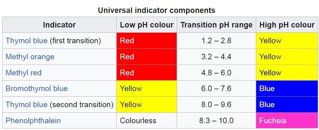

A universal indicator is a mixture of several organic dyes, each of which changes color over a different pH range. Unlike individual acid-base indicators, a universal indicator changes color over a wide pH range (e.g., from 1 to 12 or from 1 to 14), allowing not only the qualitative detection of acids or alkalis in a solution but also an approximate determination of hydrogen ion concentration by comparing the indicator color with a standard scale.
For example, a universal indicator may contain thymol blue, methyl red, methyl orange, bromothymol blue, and phenolphthalein. The indicator can be used in the form of paper strips (universal indicator paper) or as a solution.

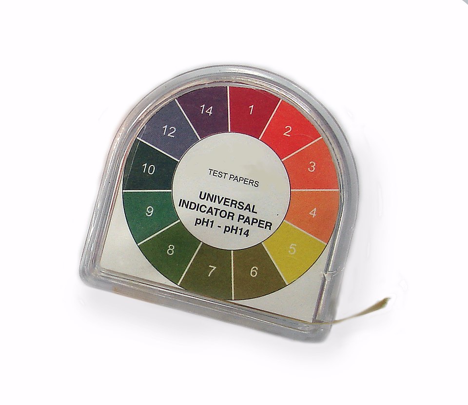

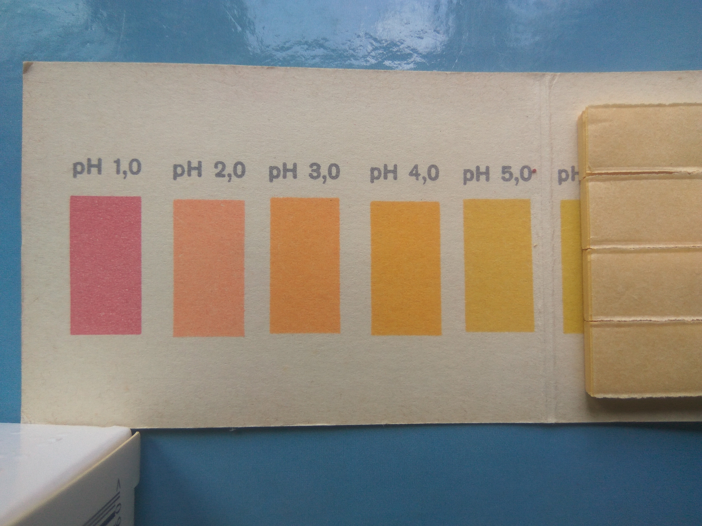

The reference scale of universal indicator paper may differ between manufacturers depending on the composition of the indicator mixture. Below are photographs from Wikipedia provided as an example.
Universal Indicator
Universal Indicator

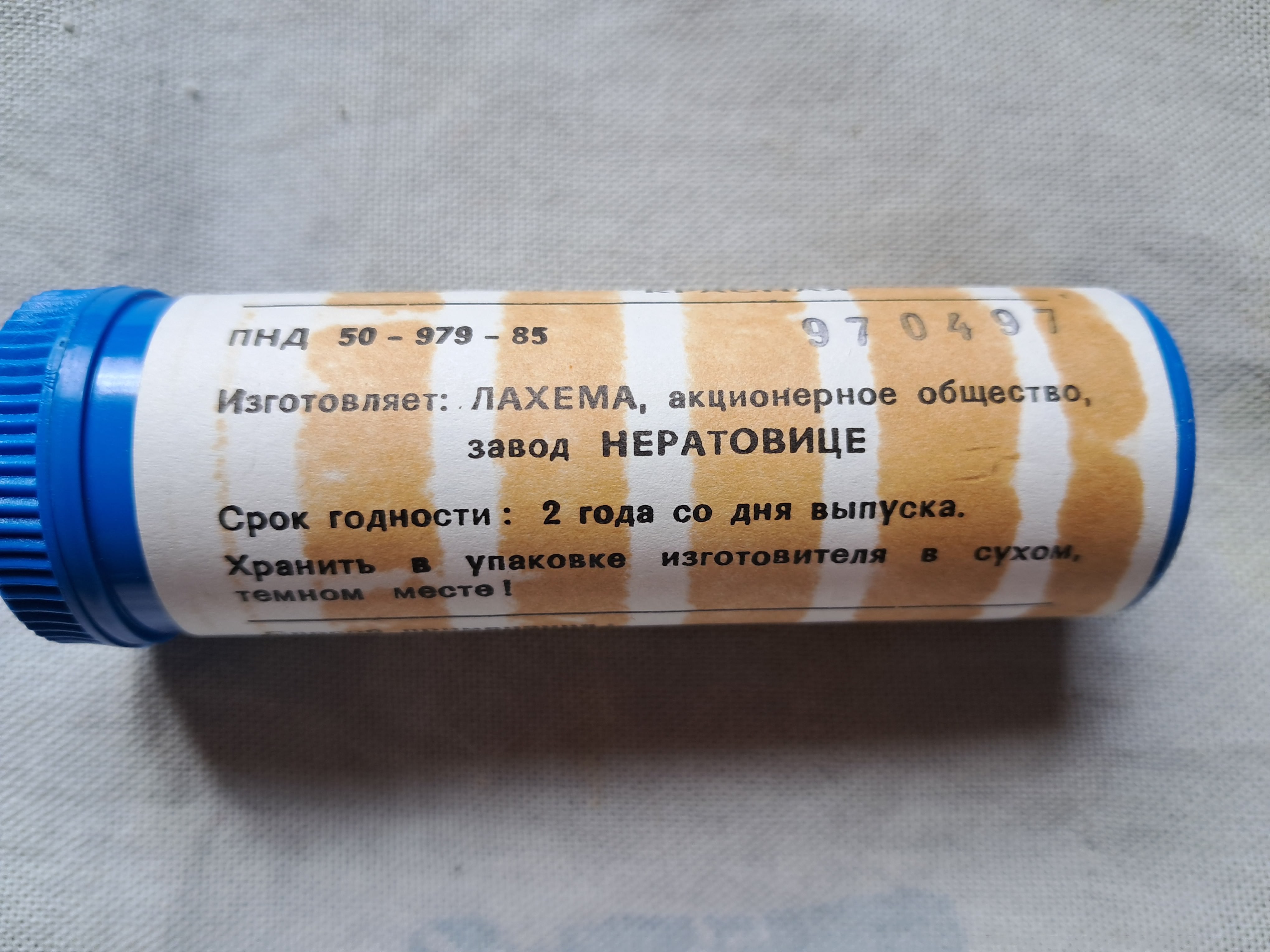

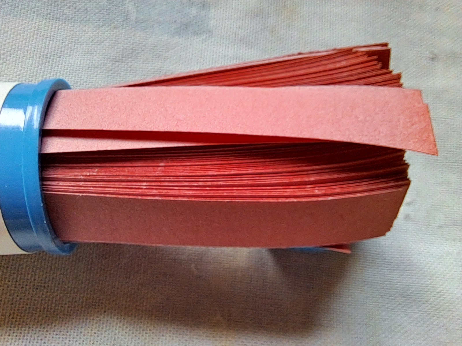

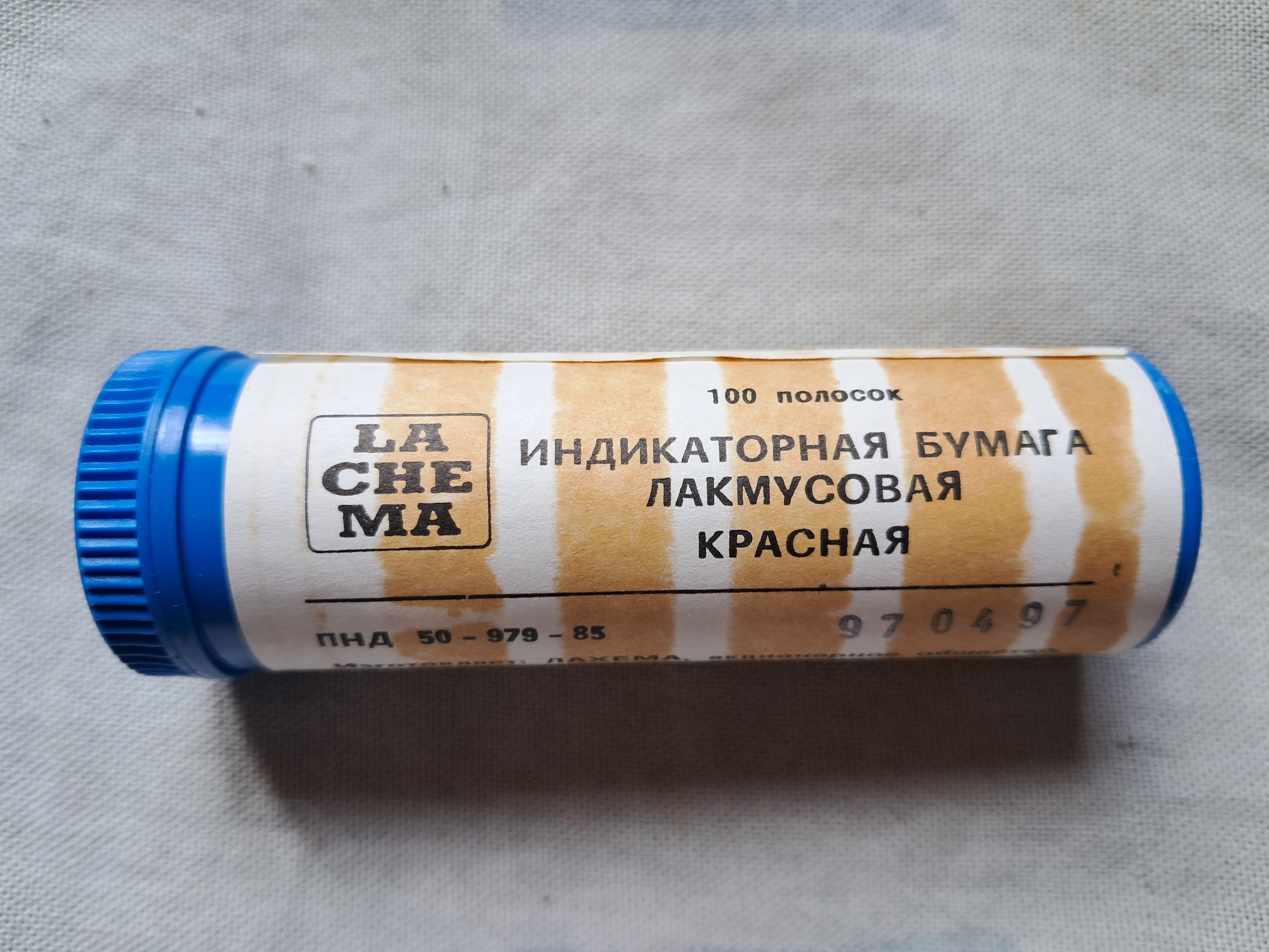

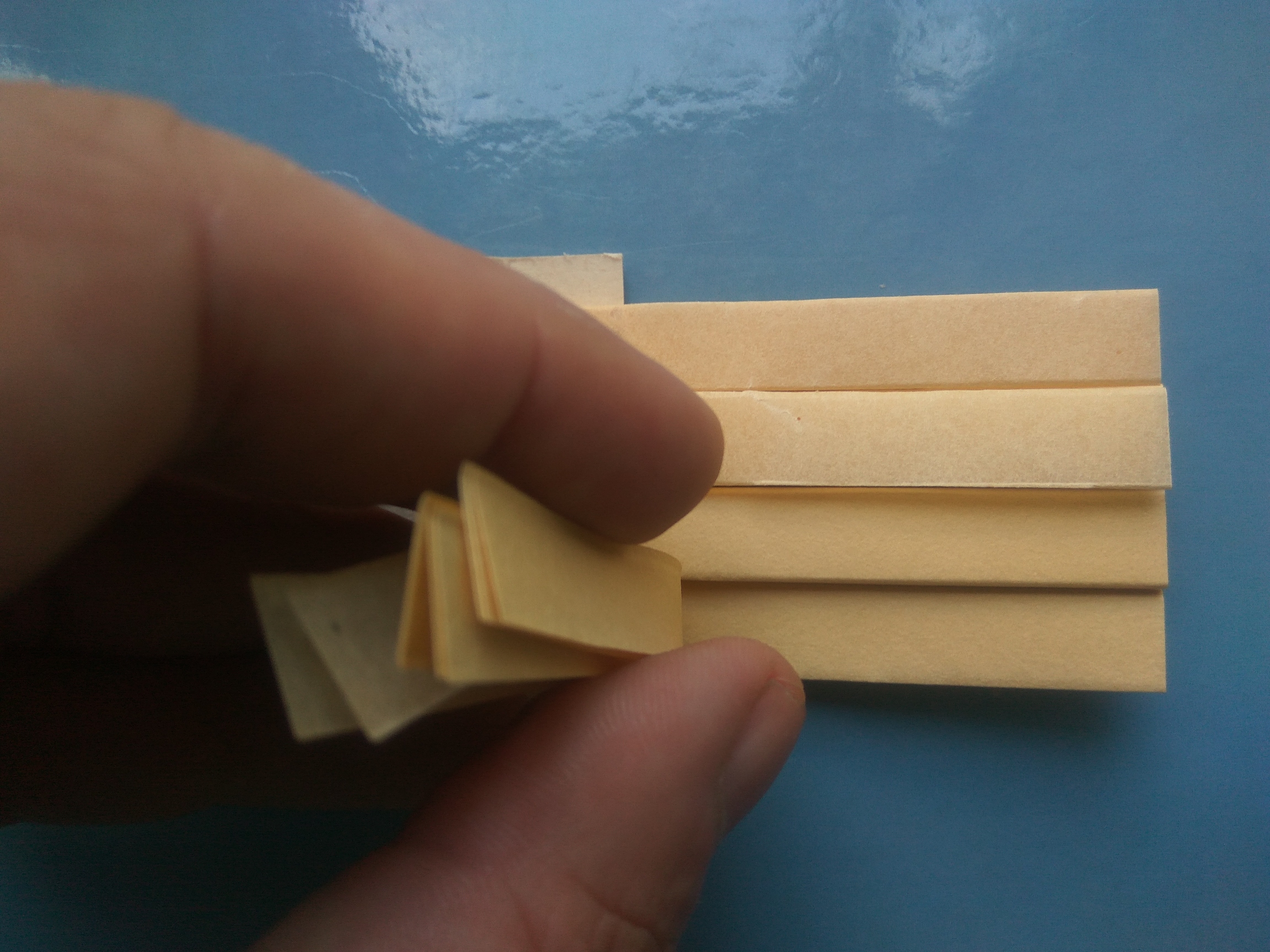

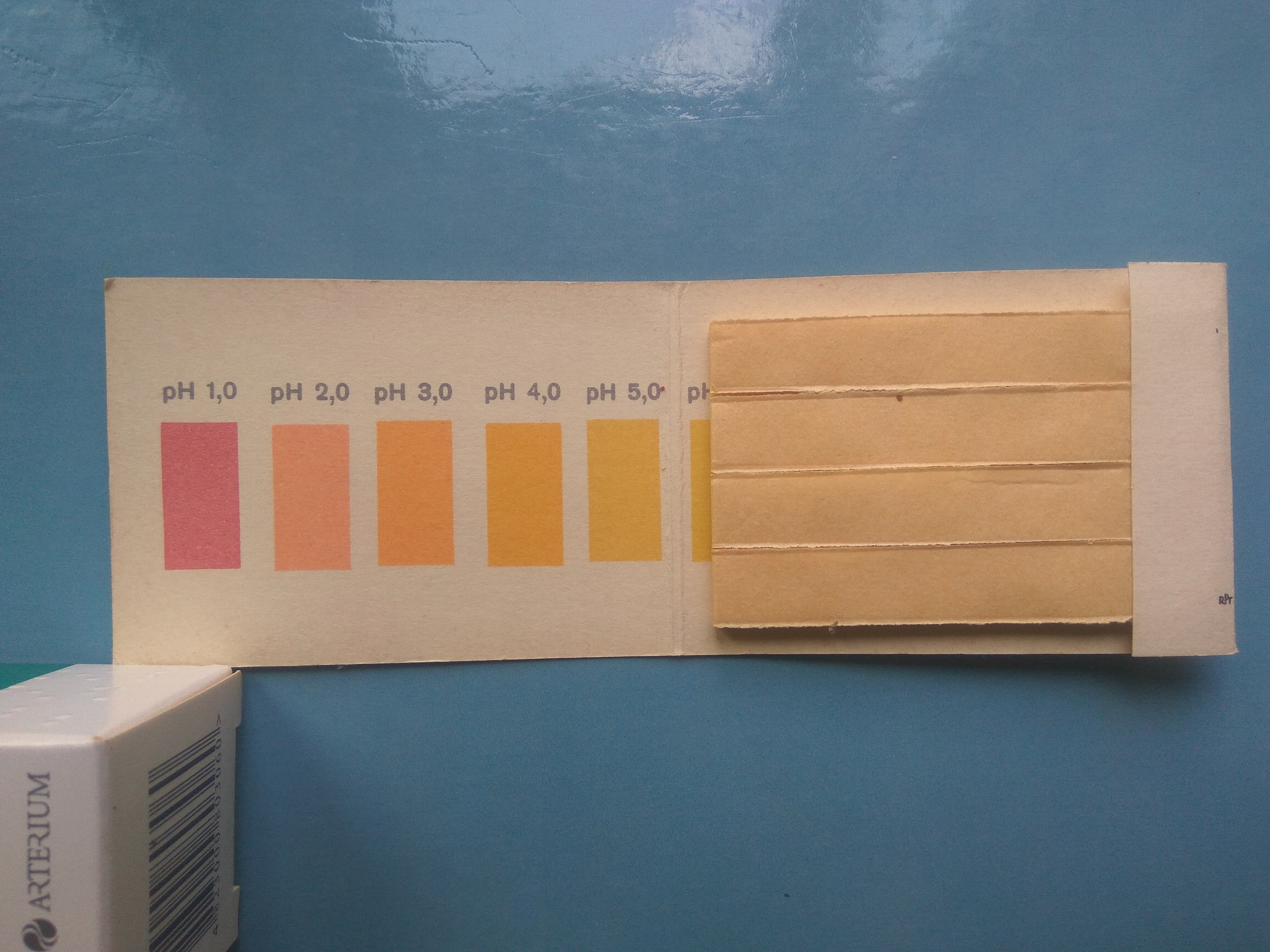

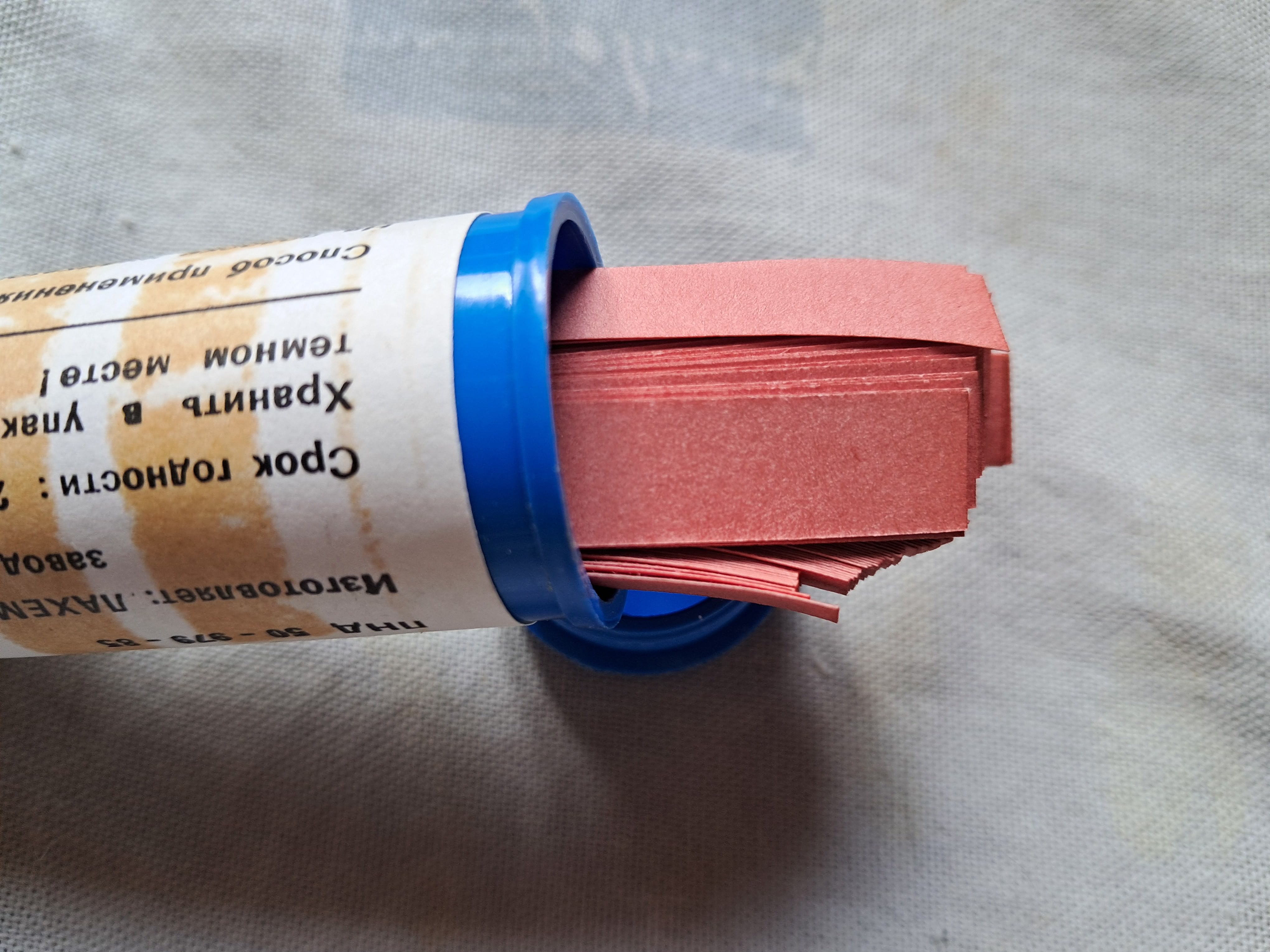

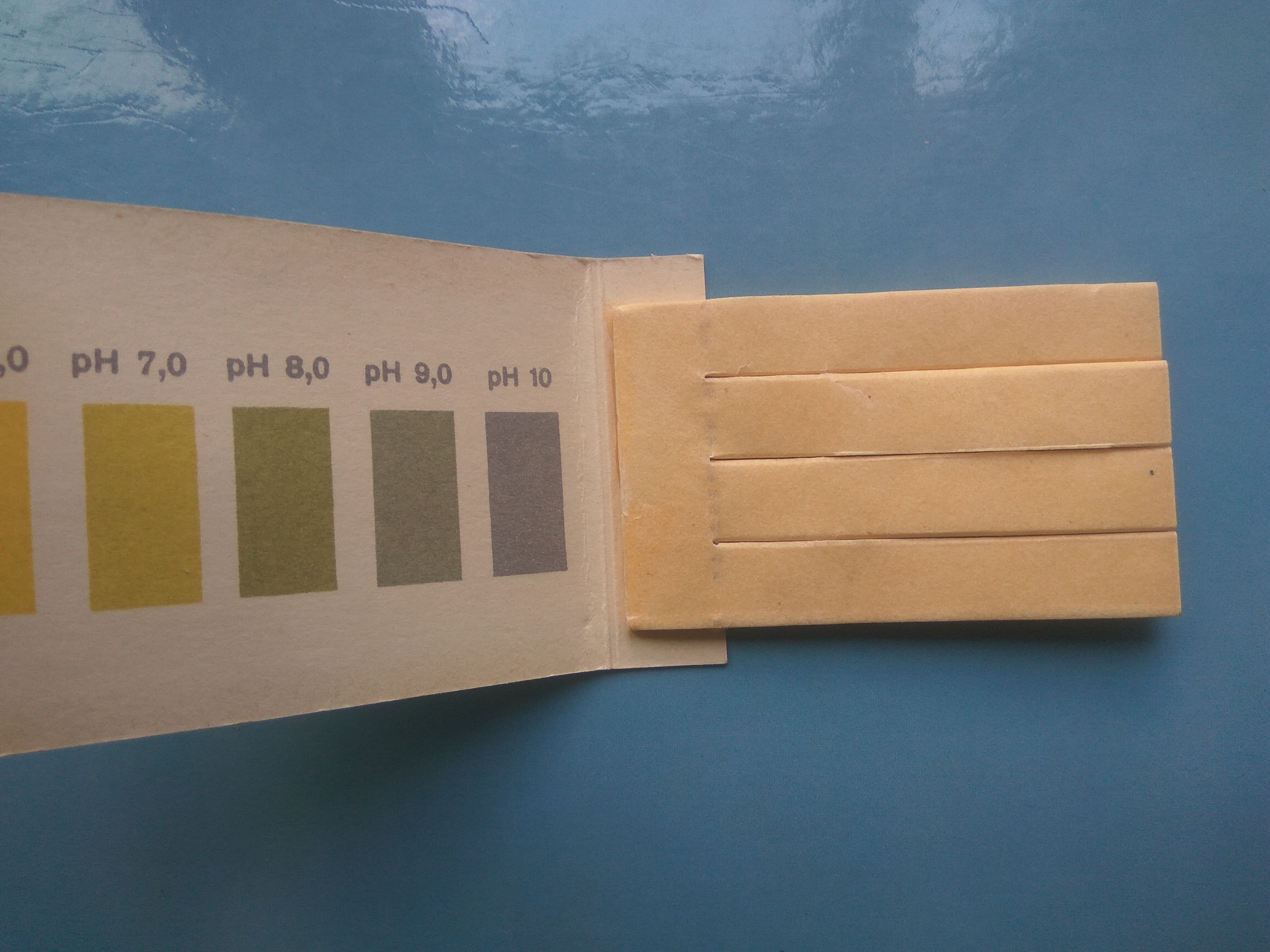

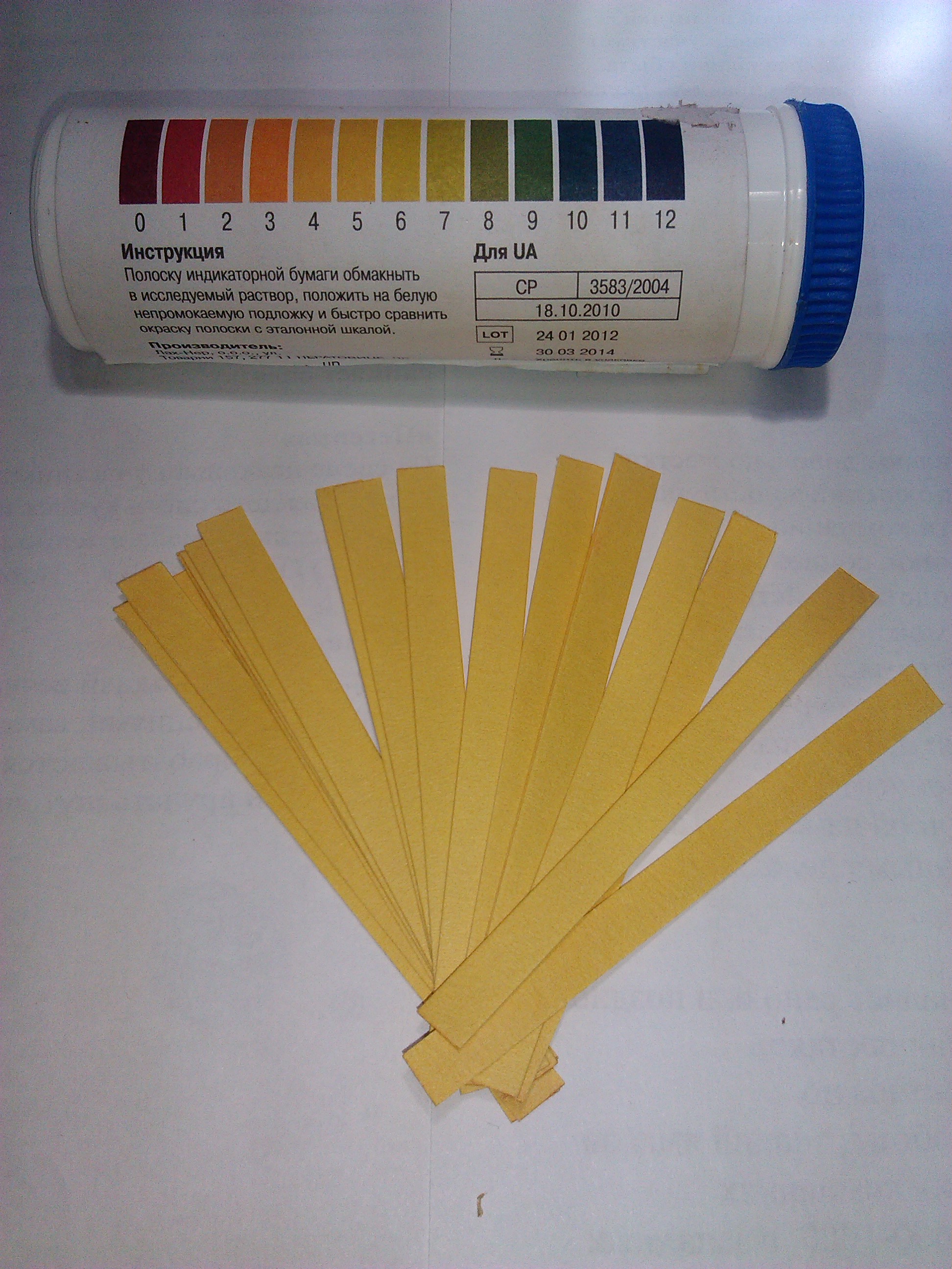

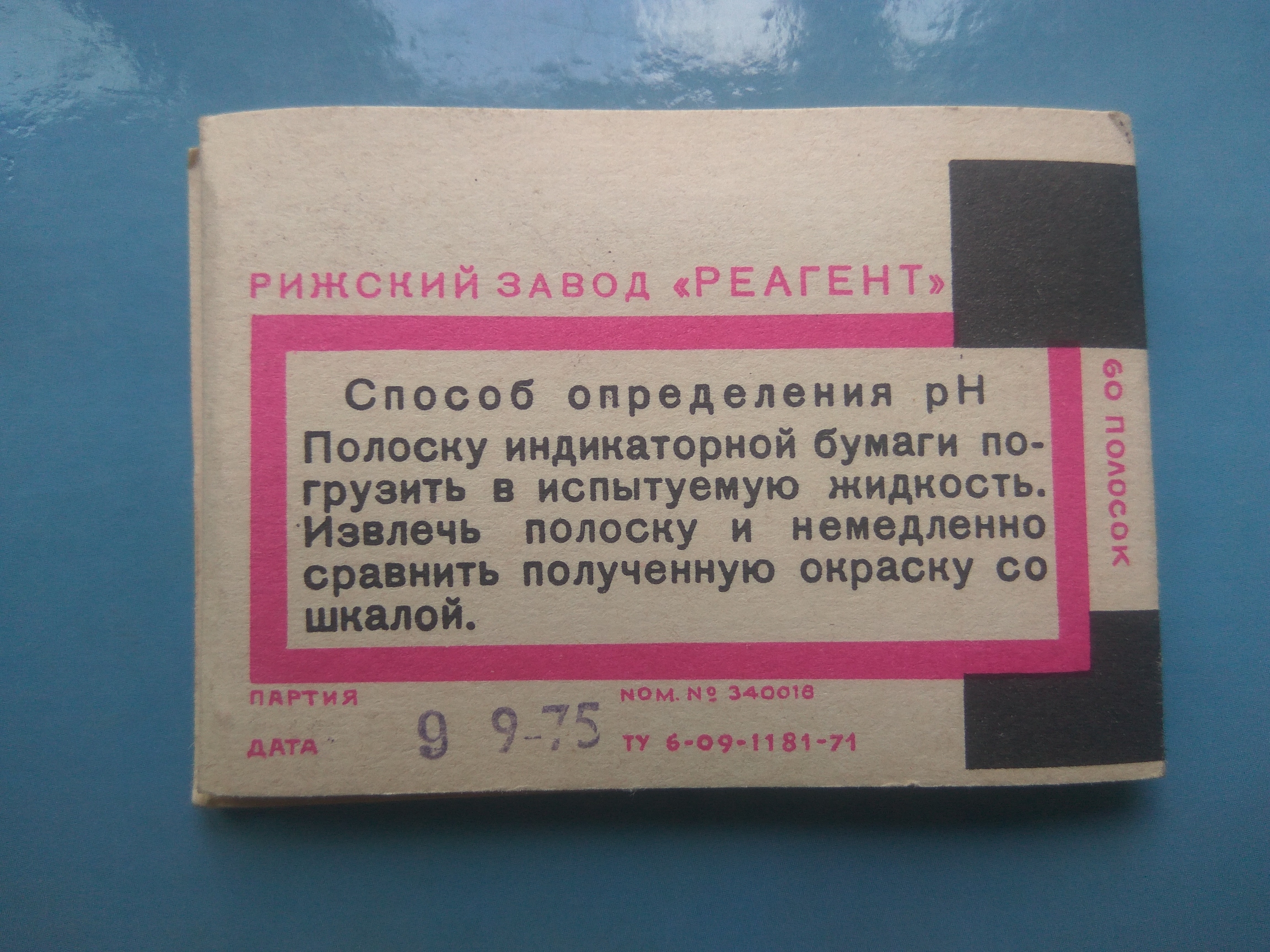

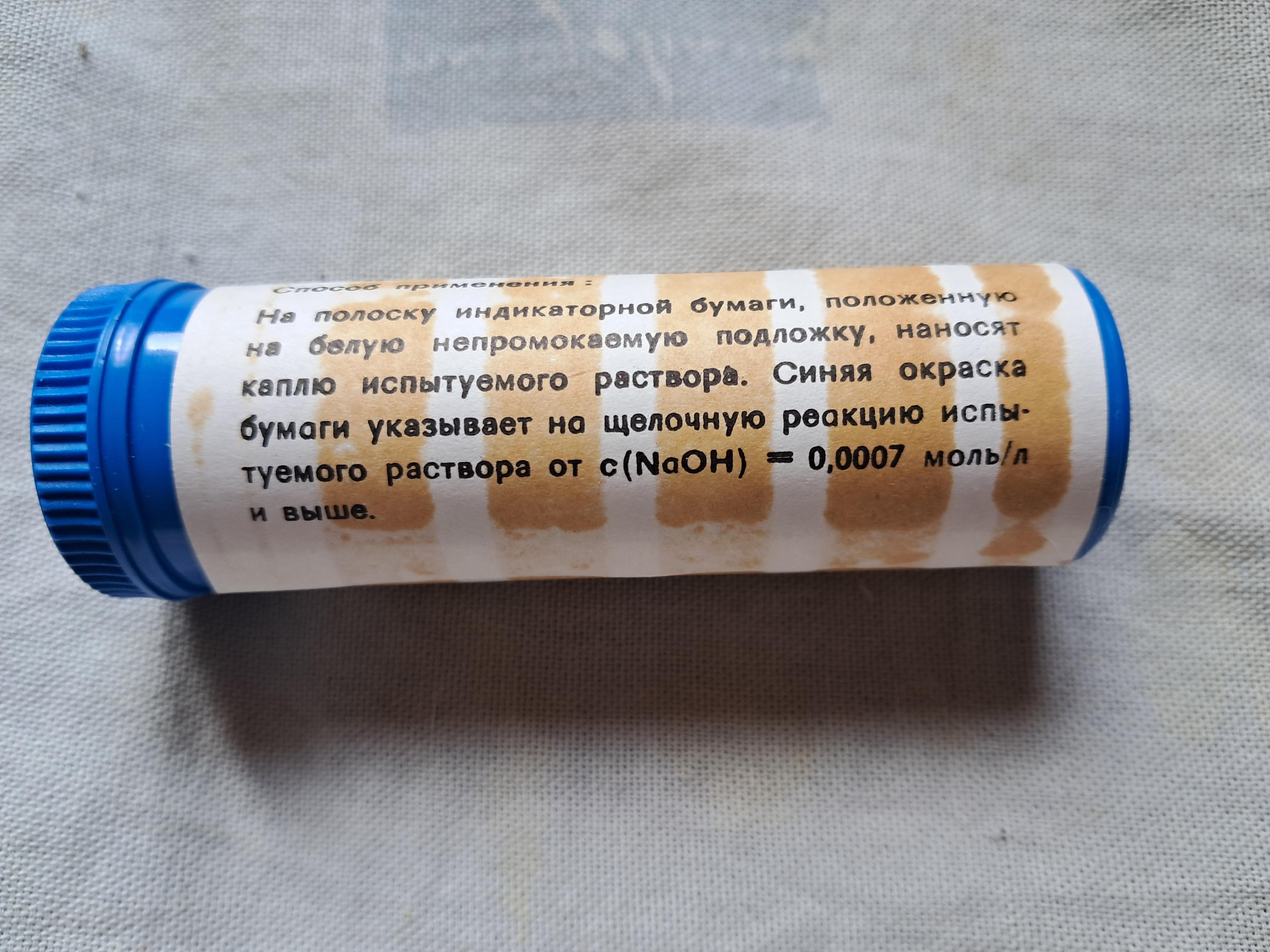

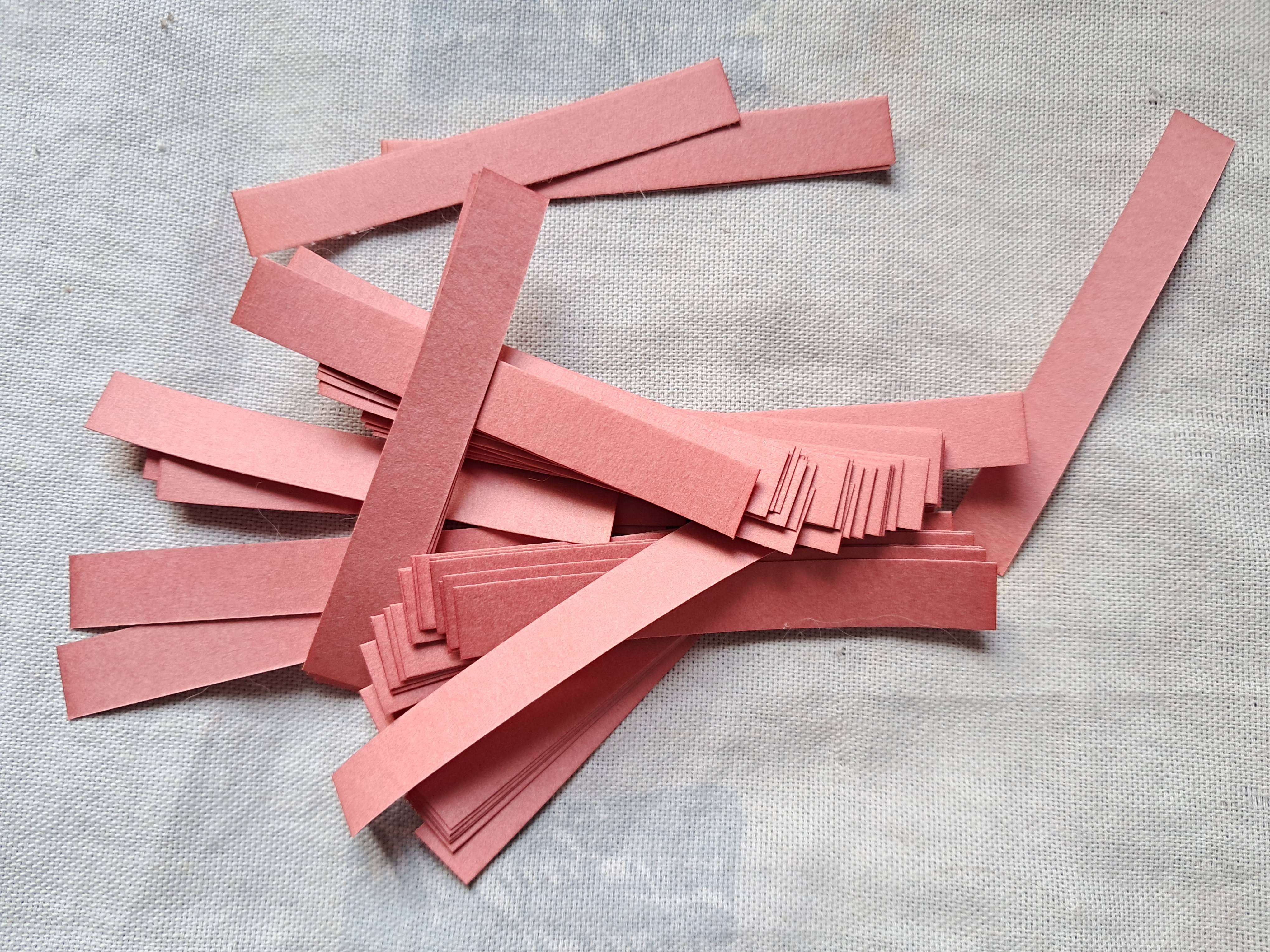

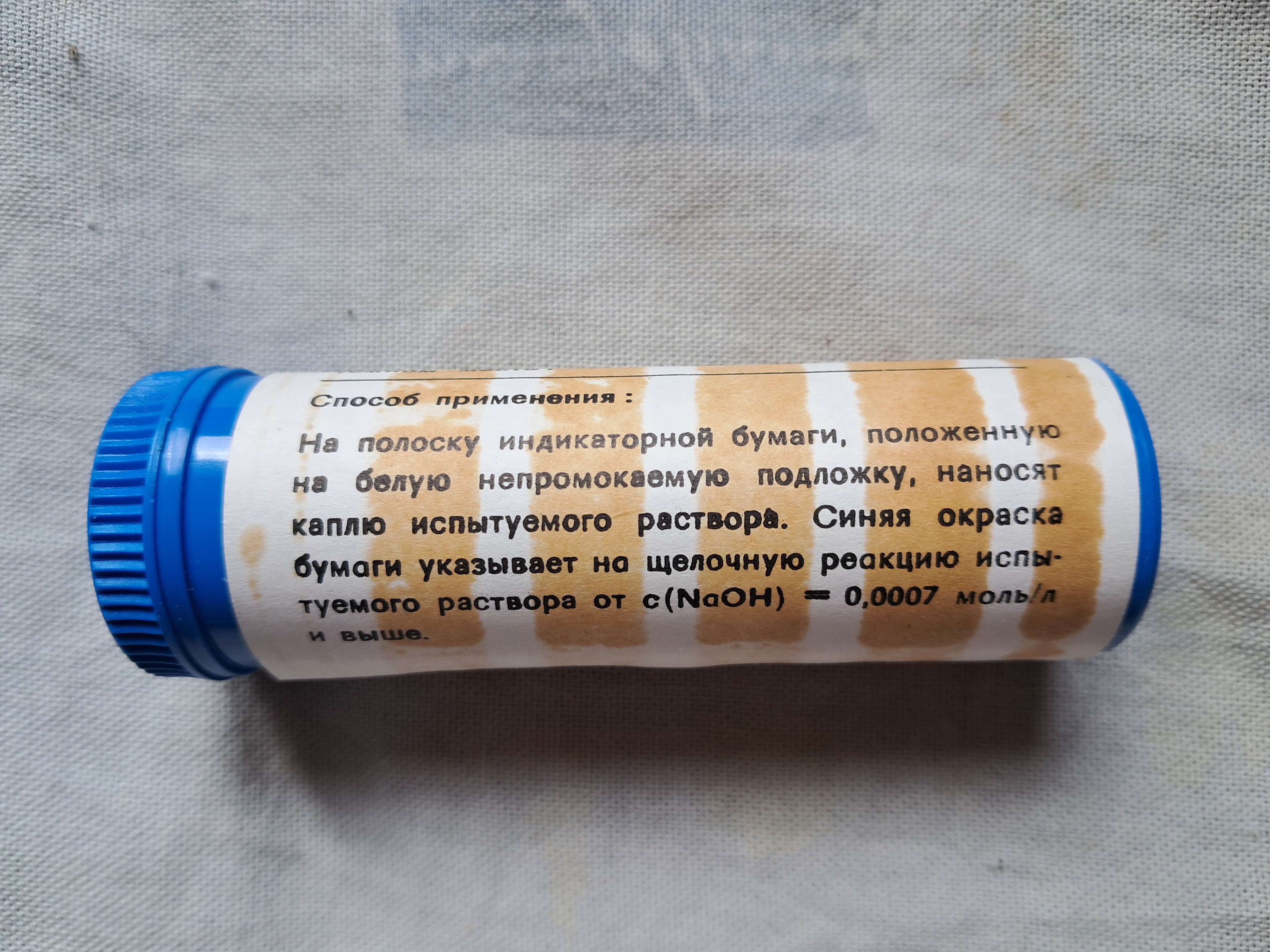

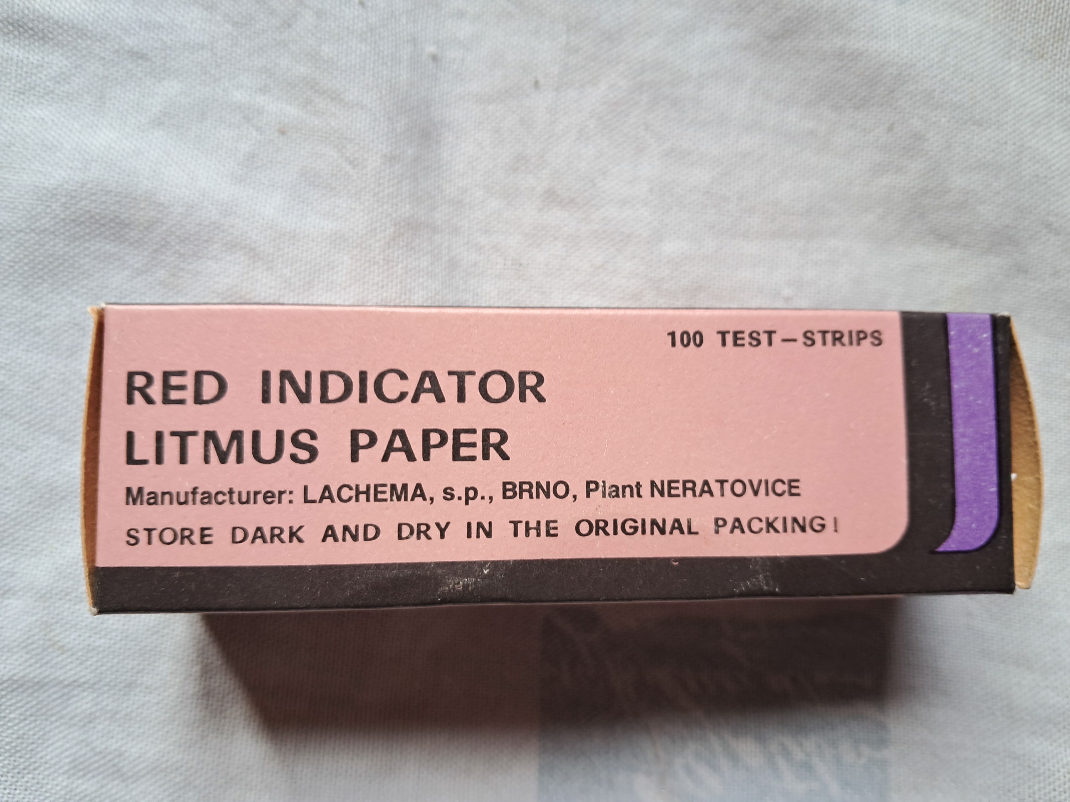

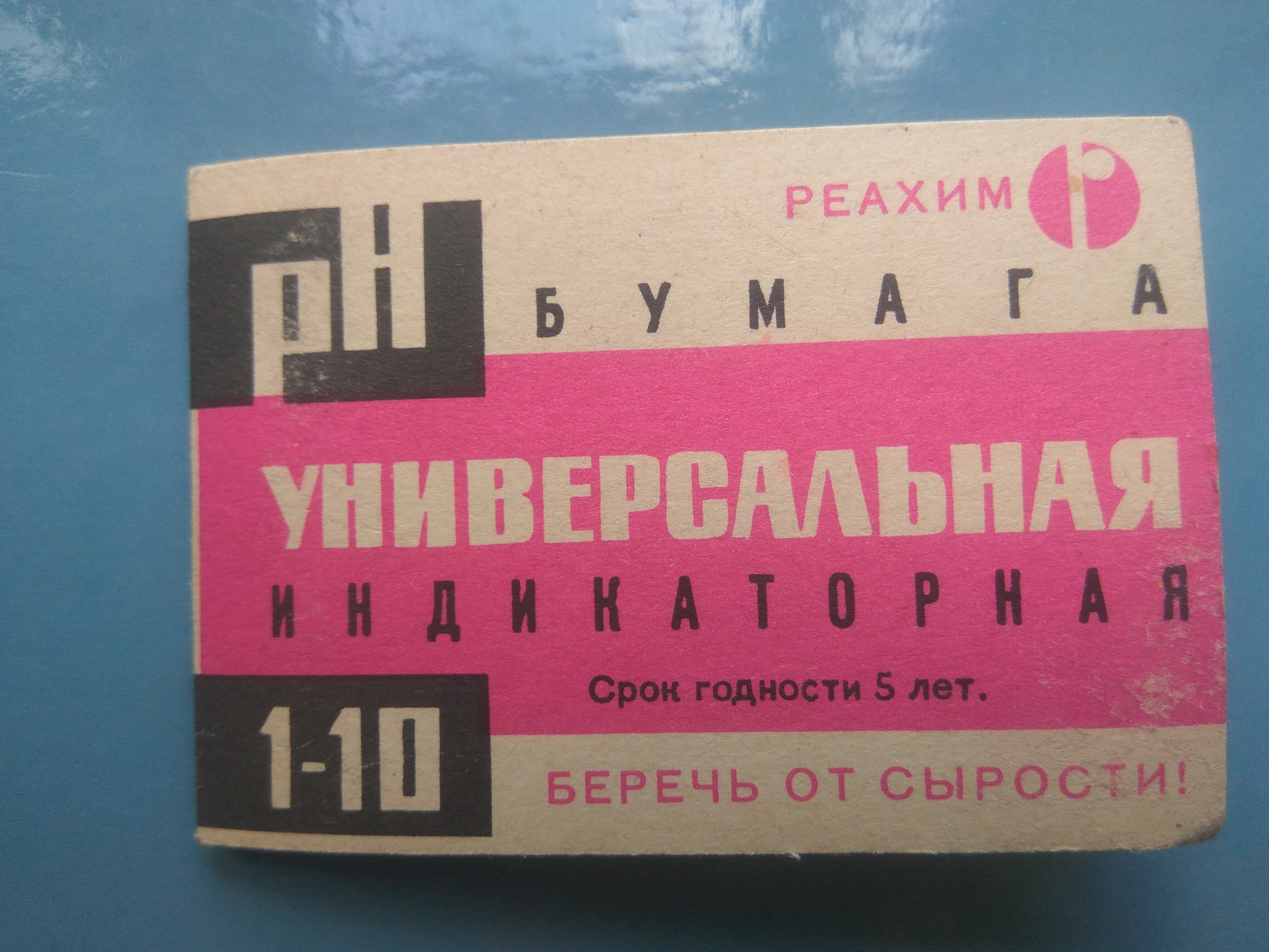

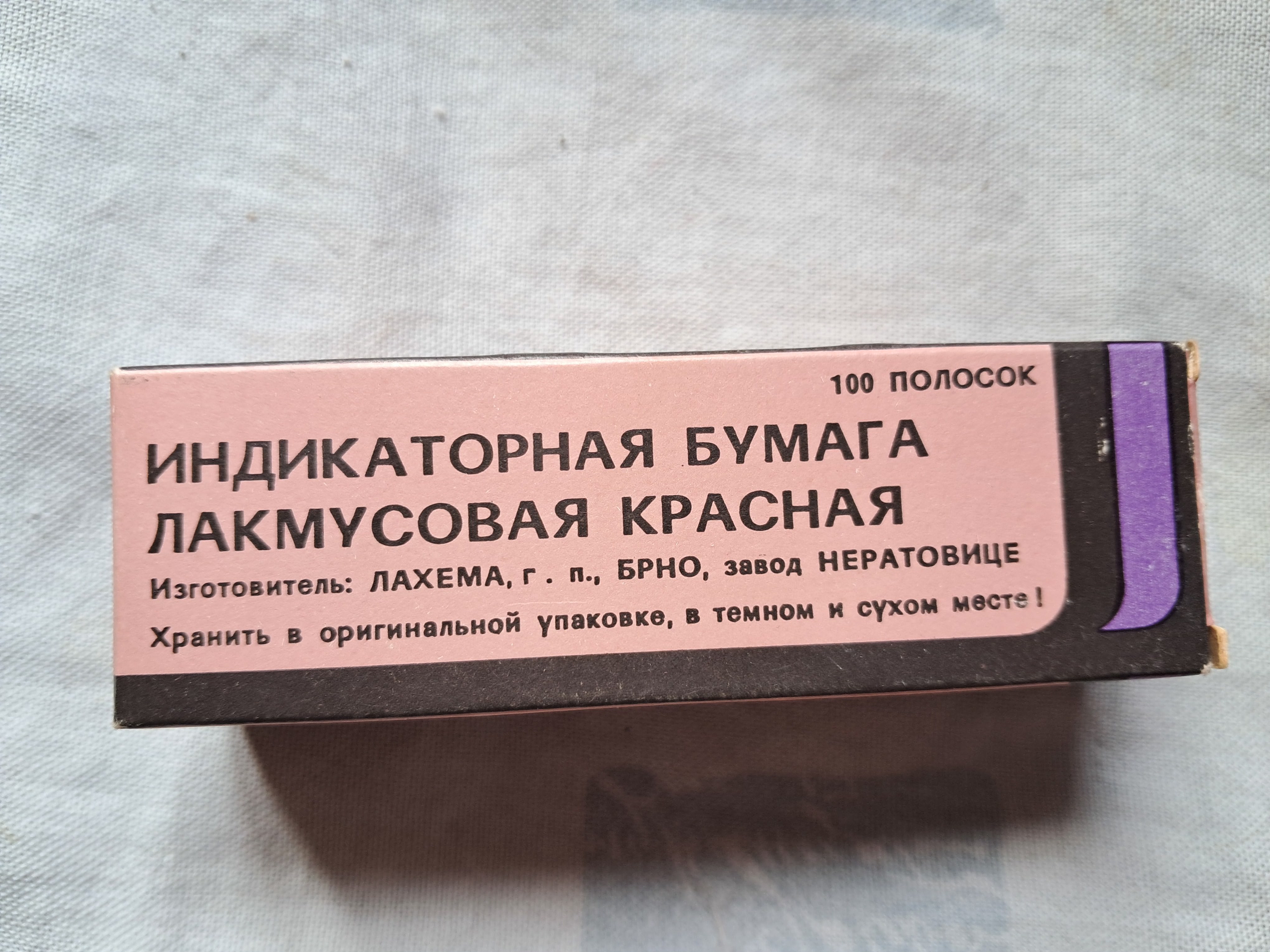

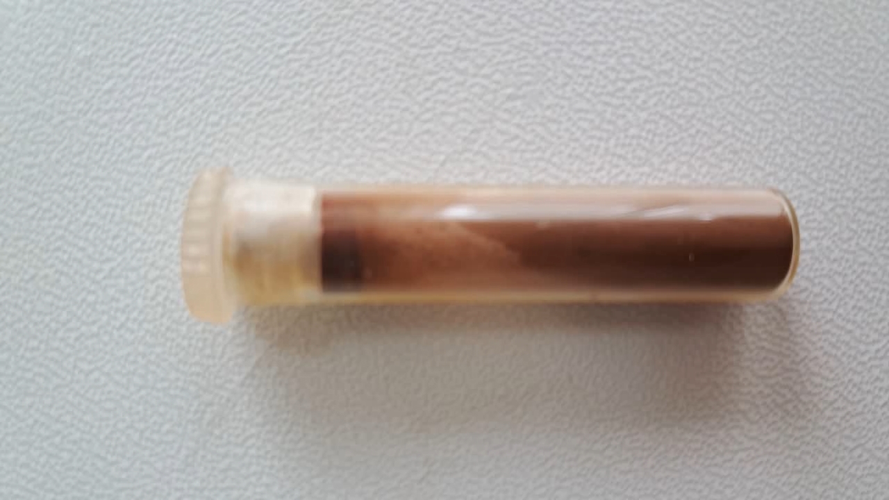

Below are photographs of universal indicator paper that I found in a radiochemical laboratory. This paper is 51 years old - slightly older than I am. Photographs of red litmus paper that is 29 years old are also shown.

Эталонная шкала универсальной индикаторной бумаги разных производителей может отличаться, в зависимости от состава универсального индикатора. Для примера ниже приведены фото из Википедии.
Universal Indicator
Universal Indicator
Ниже показаны фотографии универсальной индикаторной бумаги, которую я нашел в радиохимической лаборатории. Возраст этой бумаги 51 год - она немного старше меня. Также показаны фото красной лакмусовой бумаги возрастом 29 лет.

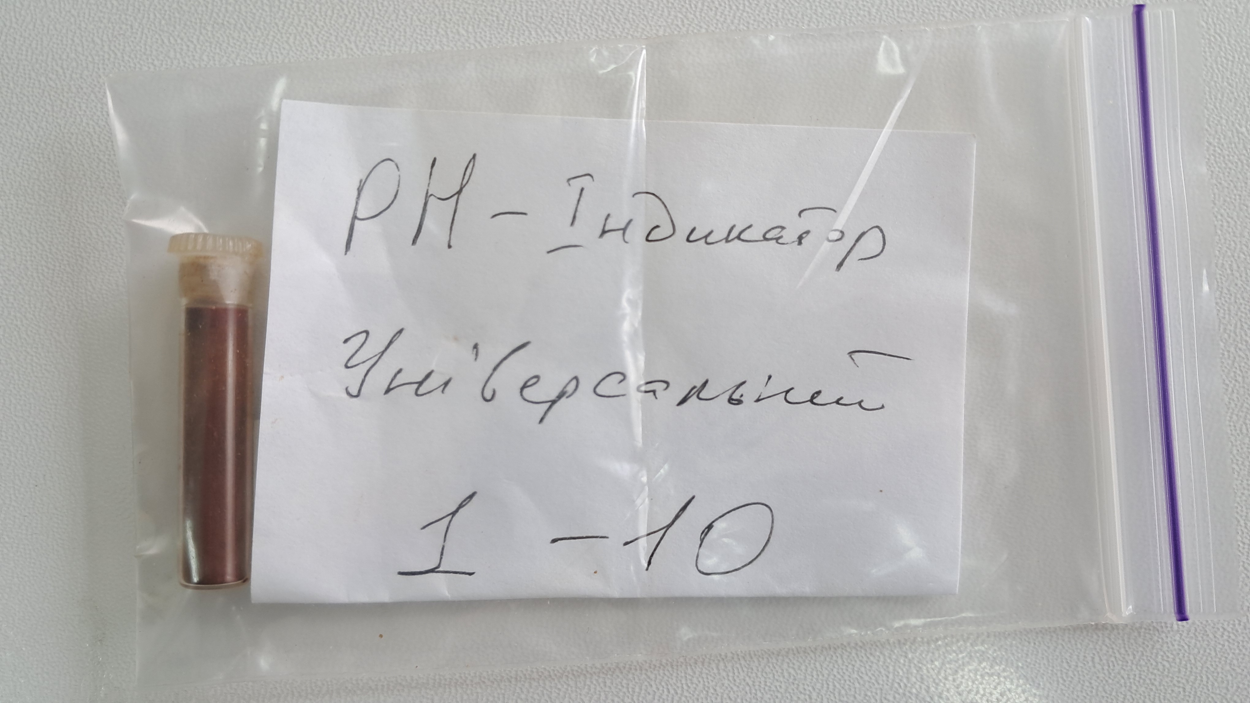

A brief digression. I have been working in chemistry for about 38 years. Since childhood, I have used universal indicator paper - exactly the type shown in the photographs in Part 1. However, I have encountered a universal indicator in powdered form in a bottle only a few times. Although the components of a universal indicator are relatively inexpensive and readily available, it is most commonly sold as indicator paper.
Last year, a colleague gave me a bottle of this universal indicator. I put it in my desk drawer to avoid losing it and planned to experiment with it. However, due to the winter cold, I had to move to another laboratory, as my original lab had no heating. I worked on other projects in the new room. When I finally had time to begin experiments with the universal indicator, I could not find the small bottle for quite a while. Over the course of six months, I had forgotten where many things were in my old laboratory. When I eventually found the bottle, I was overjoyed.

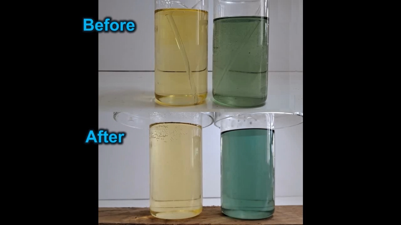

Water and Universal Indicator

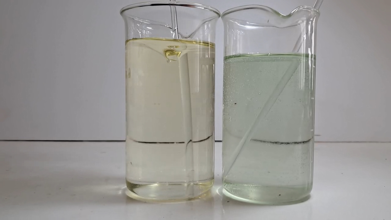

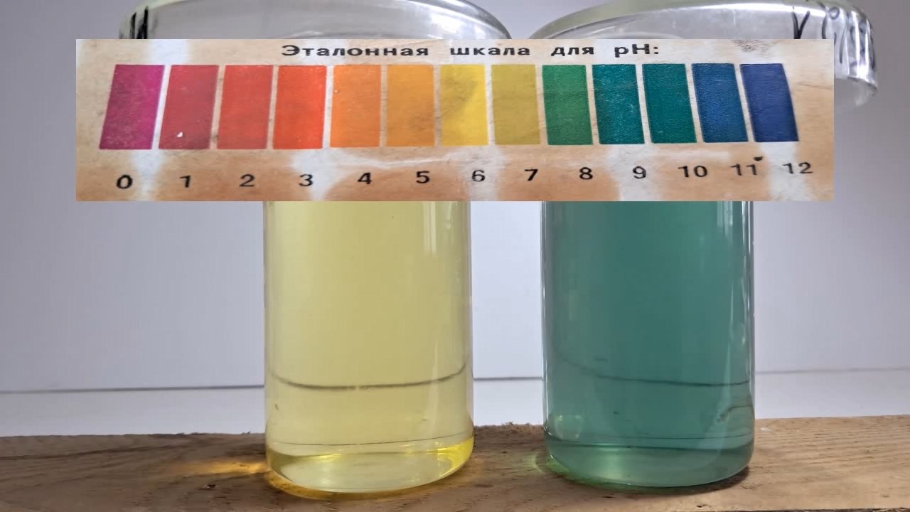

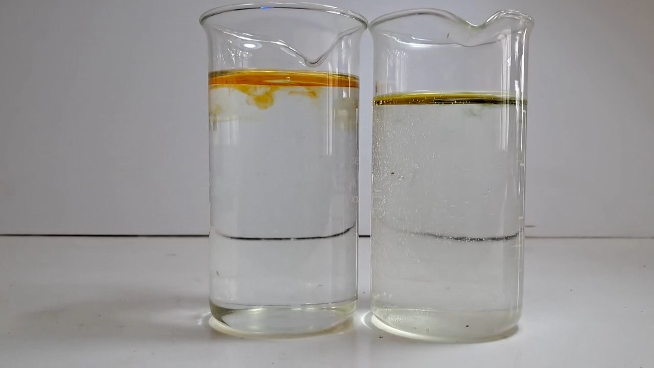

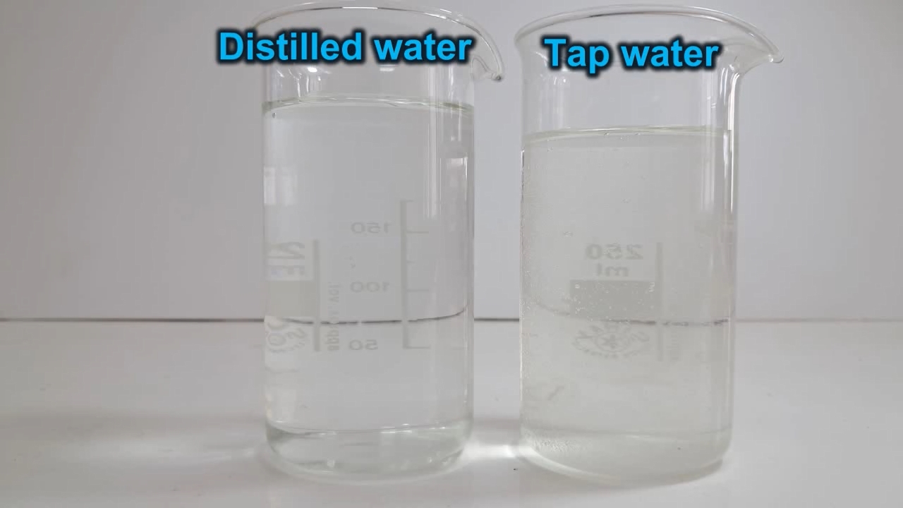

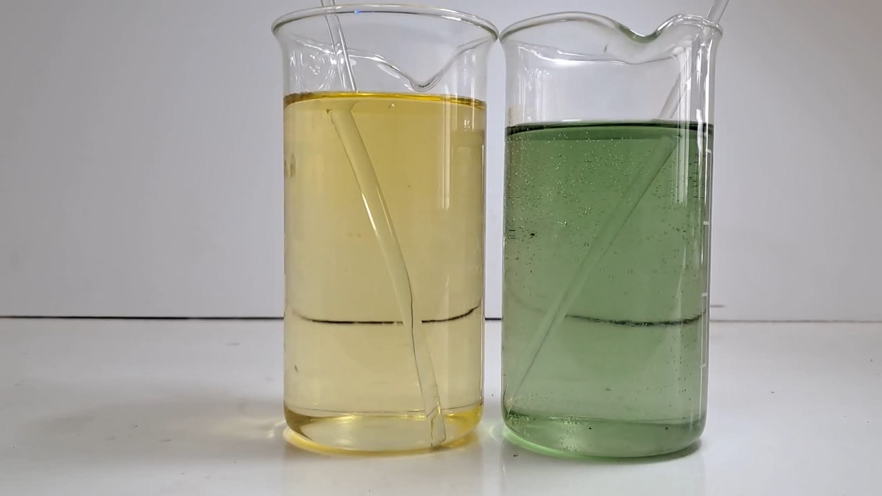

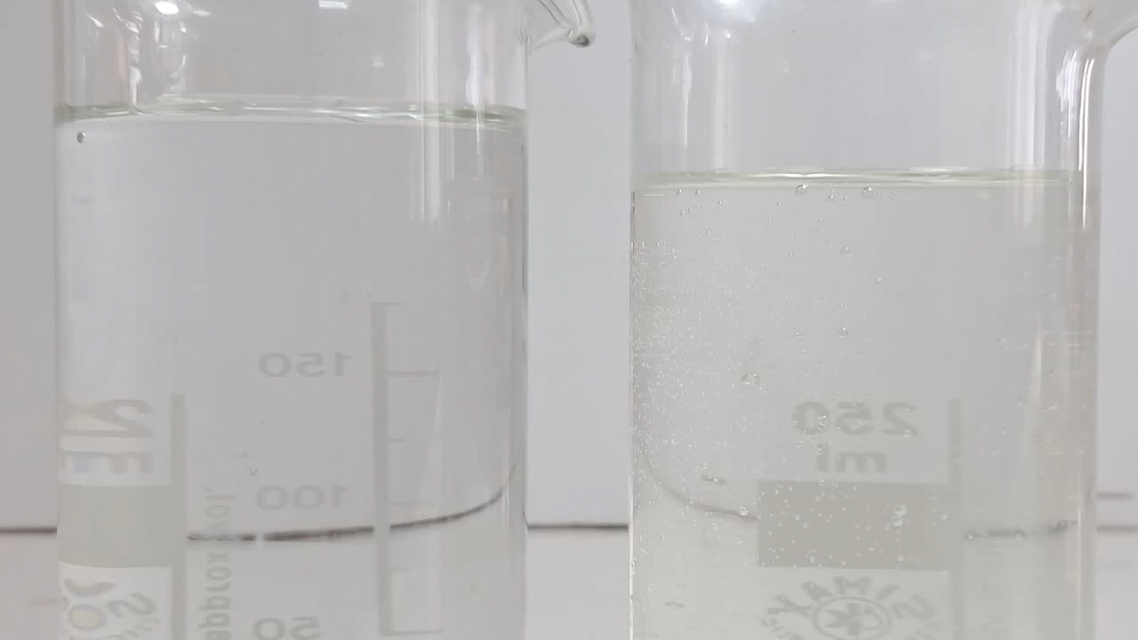

I placed two 300 mL beakers on the table. I poured distilled water into the first and tap water into the second. Upon close inspection against a white background, a difference between the two was noticeable even without testing. The tap water appeared slightly yellowish, likely due to iron impurities. In addition, a few solid particles had entered the beaker from the tap.
If larger beakers had been used (for example, 1 or 3 liters), the color difference between the two samples would have been more pronounced, but this was not the purpose of the experiment.
I planned to add a small amount of universal indicator powder to each beaker. At that moment, a colleague entered the room. Taking the opportunity, I showed him the beakers and asked whether he noticed any difference in color between the liquids. He did not know what they contained. After some thought, he remarked that the liquid in the second beaker was slightly yellowish, while the first was colorless. Thus, he independently confirmed the observation.
Incidentally, this was the same colleague who had given me the universal indicator six months earlier. I explained my intended procedure. He objected, noting that the solid indicator should first be dissolved in alcohol before being added to water; otherwise, the experiment would fail.

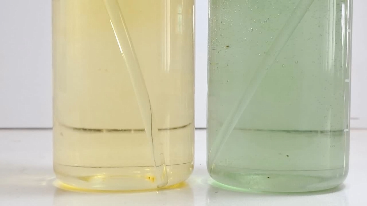

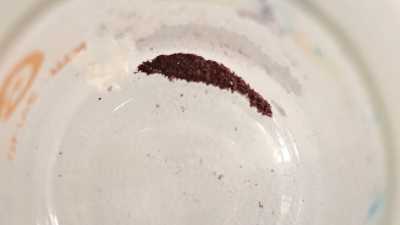

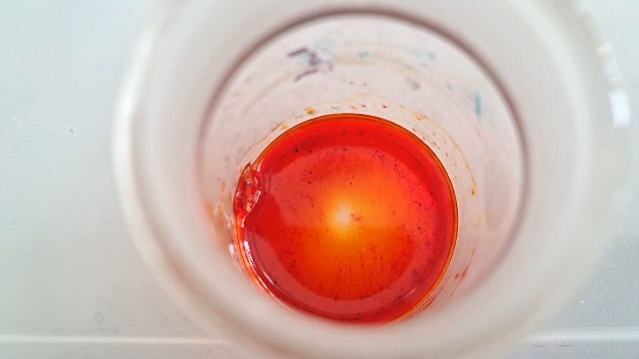

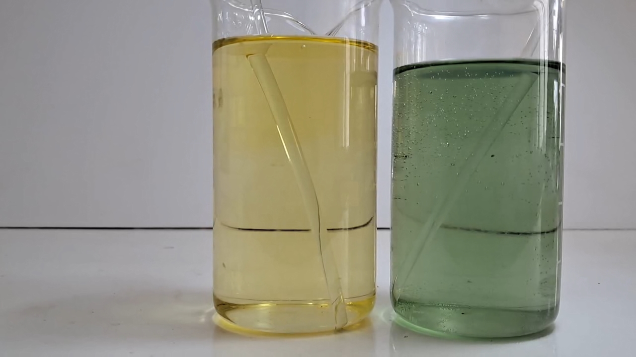

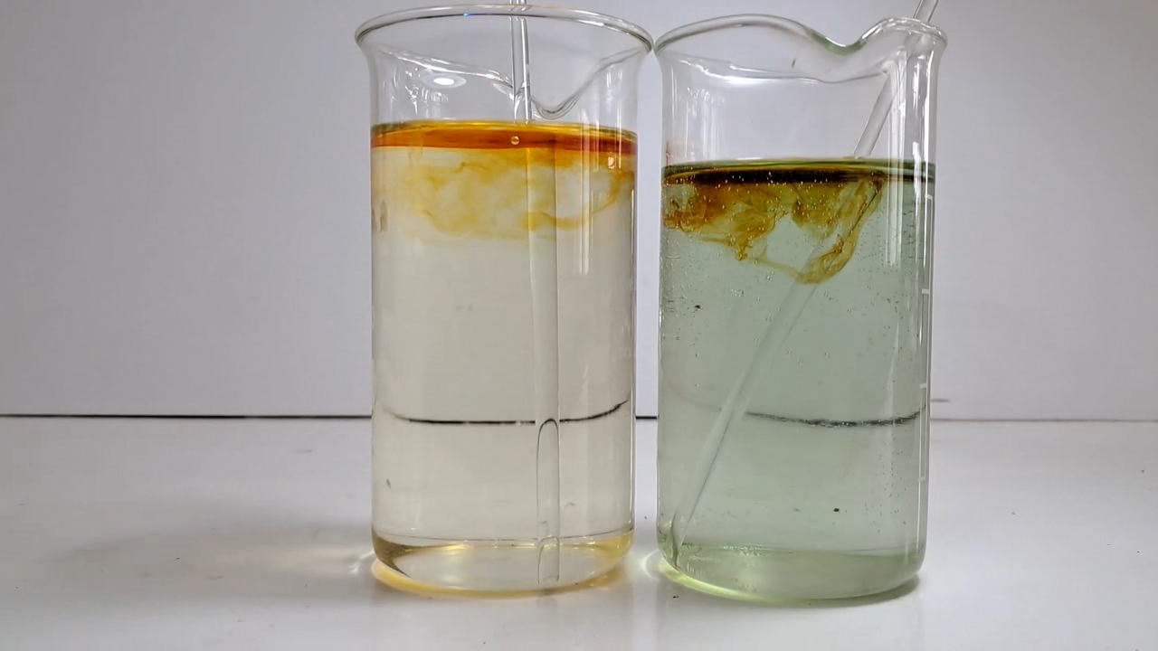

I thanked him and followed his advice. I placed a small amount of universal indicator powder into a glass and added a few milliliters of alcohol. A reddish-brown solution formed. I then added a few drops of this solution to each beaker and stirred.

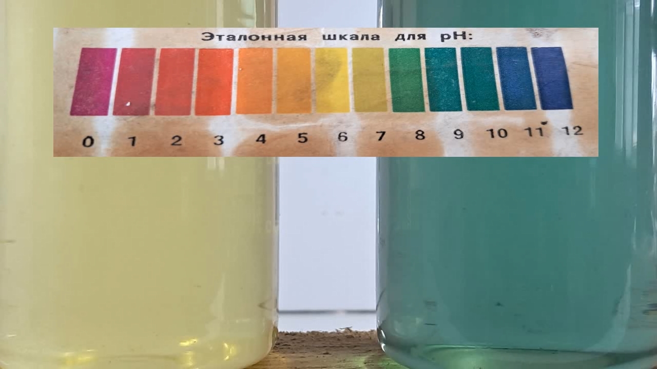

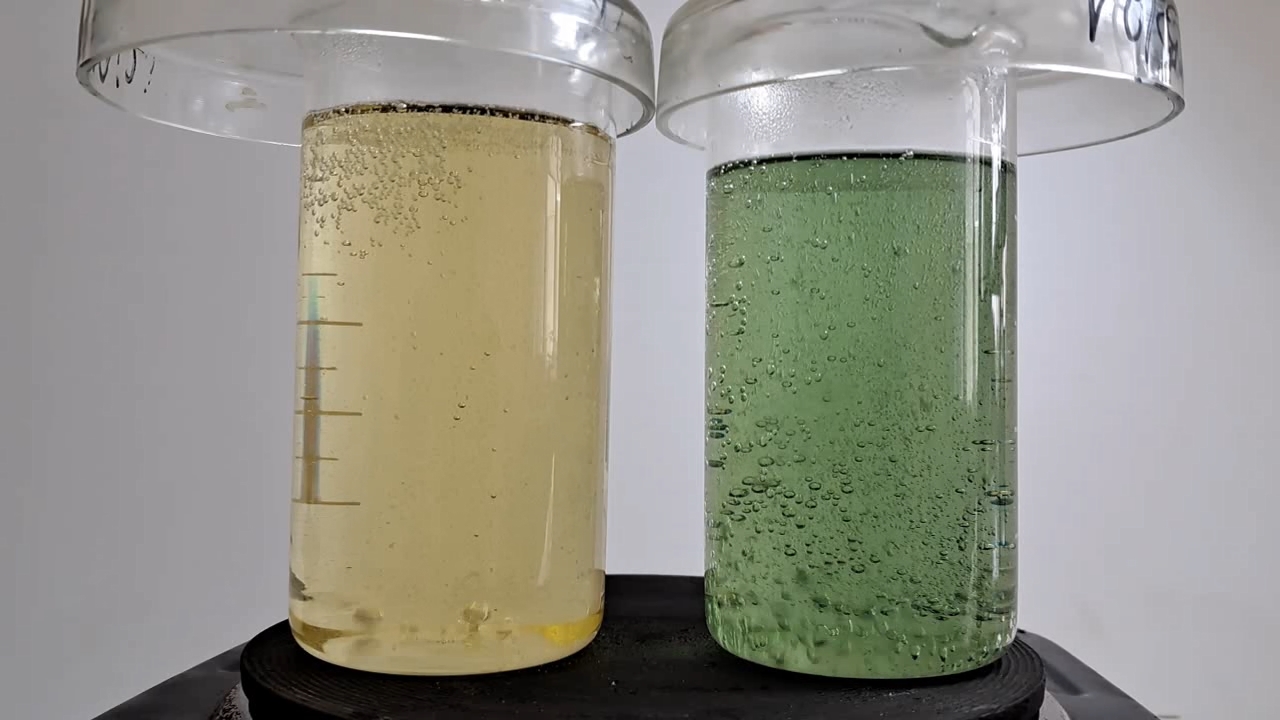

The distilled water turned yellow, while the tap water turned green. A faint yellow tint is visible in the video, although I did not notice it during direct observation. According to the comparison scale, the pH of the distilled water was approximately 6, while that of the tap water was around 8.

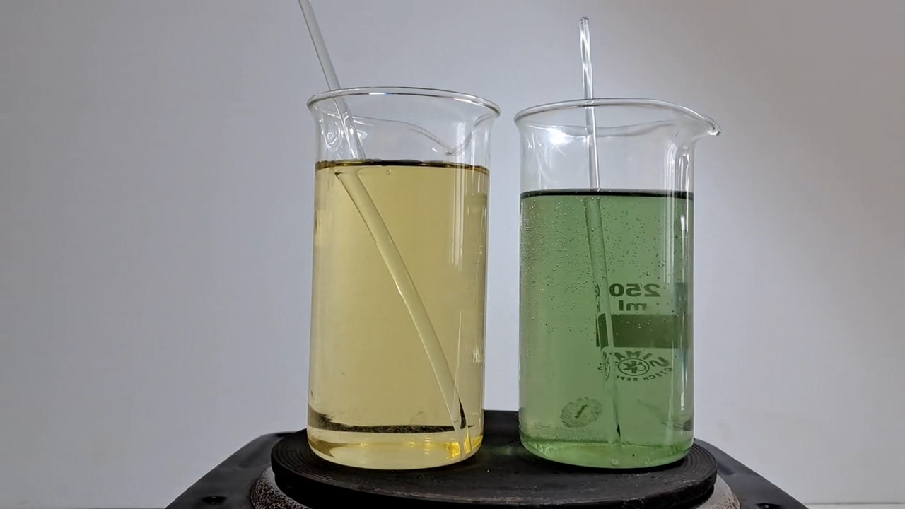

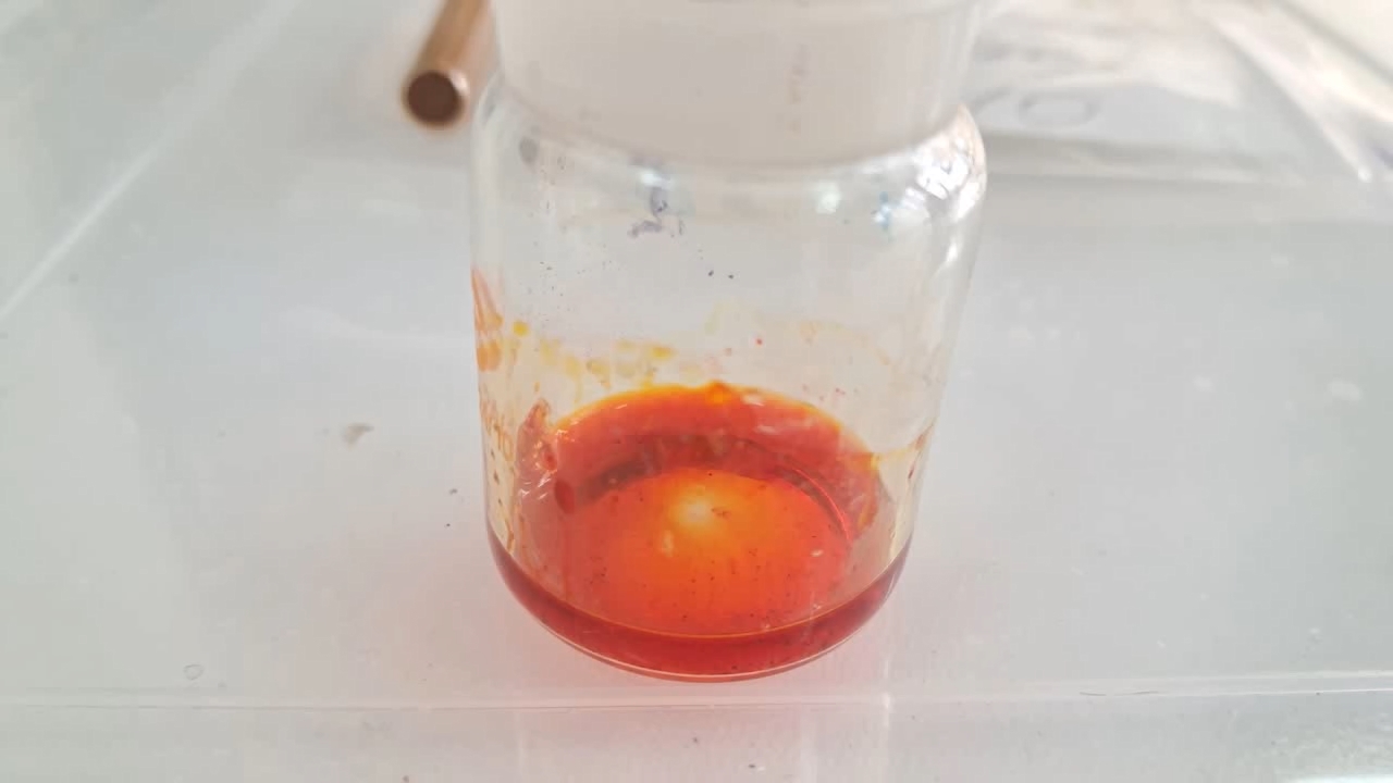

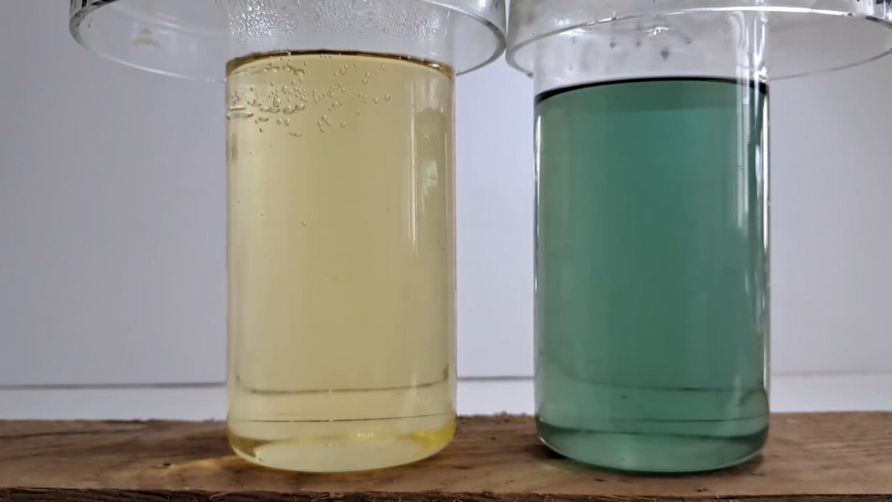

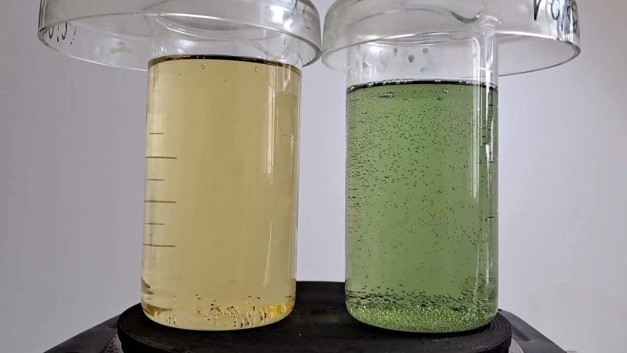

Both beakers were then placed on an electric hotplate and heated to boiling for several minutes. The color of the distilled water did not change significantly, whereas the yellowish-green color of the tap water became clear green. According to the comparison scale, this corresponded to a pH of about 9. In other words, the pH increased by approximately one unit, although the color change was far less pronounced than in the phenolphthalein experiment. After several days, the color of the solutions in both beakers remained unchanged.

Лирическое отступление. Я занимаюсь химией примерно 38 лет. Еще с детства мне приходилось иметь дело с универсальной индикаторной бумагой - точно с такой, какая показана на фотографиях выше (см. первую часть статьи). Однако, универсальный индикатор в виде порошка в бутылочке я встречал всего несколько раз. Компоненты универсального индикатора pH сравнительно недорогие и доступные, но обычно его выпускают в форме индикаторной бумаги.
В прошлом году коллега подарил мне одну такую бутылочку с универсальным индикатором. Я положил ее в ящик стола, чтобы не потерять, и запланировал провести с индикатором эксперимент. Однако, из-за зимних холодов мне пришлось перейти в другую лабораторию, поскольку моя тогдашняя лаборатория не имеет отопления. В новой комнате я занимался другими работами. Когда появилось время, чтобы начать эксперименты с универсальным индикатором, я долго не мог найти крохотную бутылочку. За полгода я успел забыть, где что лежит в старой лаборатории. Когда таки нашел бутылочку - сильно обрадовался.
Поставил на стол два 300 мл стакана, в первый налил дистиллированную воду, во второй - воду из-под крана. Если присмотреться внимательно, то на белом фоне разница между двумя стаканами была заметна безо всяких исследований. Водопроводная вода выглядела чуть желтоватой, вероятно, из-за наличия примеси железа. Кроме того, в стакан из крана попало несколько твердых частиц.
Если использовать стаканы большего объема, например, 1 или 3 л, то разница окраски двух образцов воды станет более заметной, но такой цели не было.
В каждый из стаканов я собирался добавить немного порошка универсального индикатора. Неожиданно зашел коллега. Пользуясь случаем, я показал ему стаканы и спросил, заметил ли он разницу между цветом жидкостей? Коллега не знал, что в них находится. После раздумий коллега сказал, что жидкость во втором стакане чуть желтоватая, а в первом - бесцветная. Таким образом, он независимо подтвердил мое наблюдение.
Кстати, это был тот самый коллега, который подарил мне универсальный индикатор полгода назад. Я объяснил ему, что собираюсь делать. Коллега возразил, что твердый индикатор нужно сначала растворить в спирте, а только потом добавлять в воду, в противном случае эксперимент не получится.
Я поблагодарил коллегу и сделал, как он порекомендовал. Насыпал в стакан минимальное количество порошка универсального индикатора и добавил несколько миллилитров спирта. Образовался красно-коричневый раствор. Добавил несколько капель этого раствора в каждый из стаканов, перемешал воду.
Дистиллированная вода окрасилась в желтый цвет. Водопроводная вода приобрела зеленый цвет, причем на видео заметен слабый желтый оттенок, а при непосредственном наблюдении я его не наблюдал. Согласно шкале сравнения, pH раствора дистиллированной воды составлял около 6, а водопроводной воды - около 8.
Поставил оба стакана на электрическую плитку, включил нагрев. Кипятил растворы несколько минут. Цвет первого стакана (дистиллированная вода) существенно не изменился, во втором стакане (водопроводная вода) желтовато-зеленый раствор стал зеленым. Согласно шкале сравнения, цвет стакана с водопроводной водой теперь соответствовал рН около 9. Другими словами, рН воды увеличился примерно на 1, но изменение окраски выглядело далеко не так наглядно, как в эксперименте с фенолфталеином. После нескольких дней стояния цвет воды в стаканах не изменился.

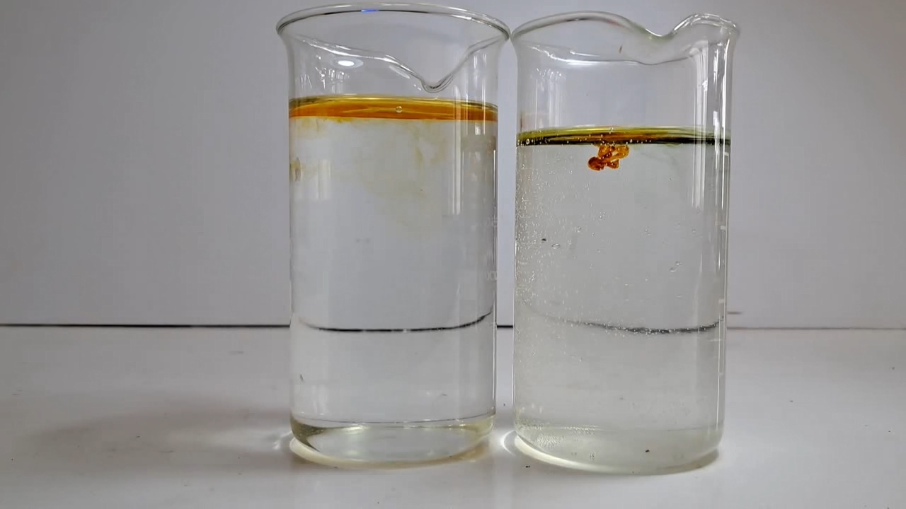

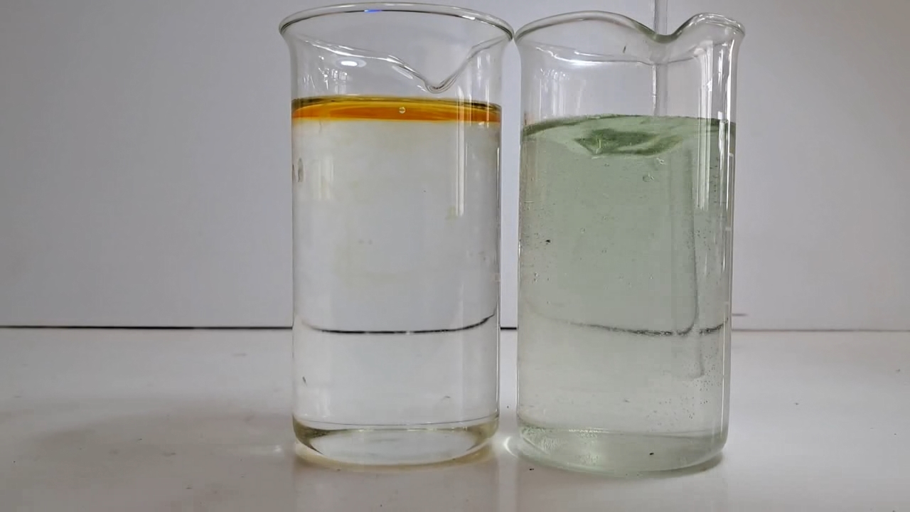

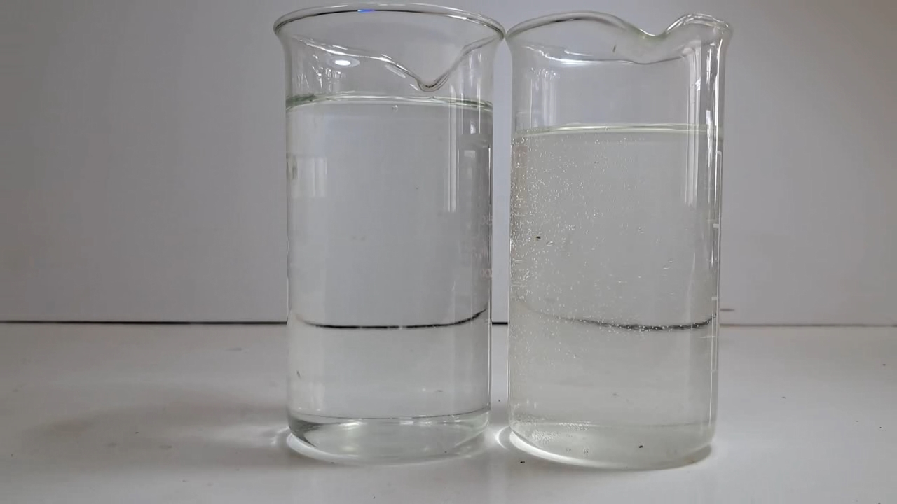

After the previous experiment, two beakers containing water with added universal indicator remained on the table. The distilled water had turned yellow, while the tap water had turned green.
I intended to quickly describe the experiment and proceed to the next steps. The plan was to gradually add an acid to one beaker and an alkaline solution to the other, observing the indicator's color change. The procedure itself was elementary. However, a chemistry laboratory is not an isolated system - we all live within a broader human environment.
A considerable amount of organizational work arose, which for a long time disrupted all my experiments, from simple demonstrations to scientific research. As a result, I was unable to return to the two beakers for quite some time.
The idea was as follows: to add a weak acid solution drop by drop to the right beaker, gradually lowering the pH and producing a smooth color transition of the universal indicator. Then, to add a strong acid to achieve the minimum pH (maximum hydrogen ion concentration) and induce the color change that a weak acid alone could not produce.
Next, a weak base would be added to the left beaker, also gradually and dropwise, to produce a slow increase in pH. This would be followed by the addition of an excess of a strong base to reach the maximum pH of the solution (minimum hydrogen ion concentration).

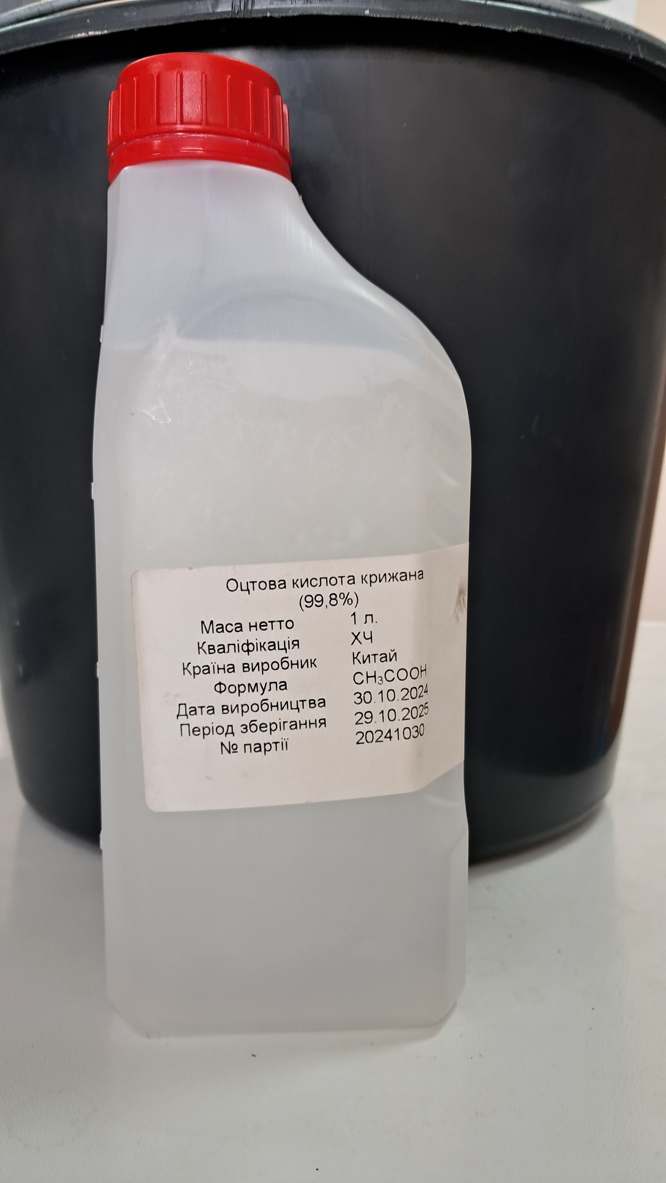

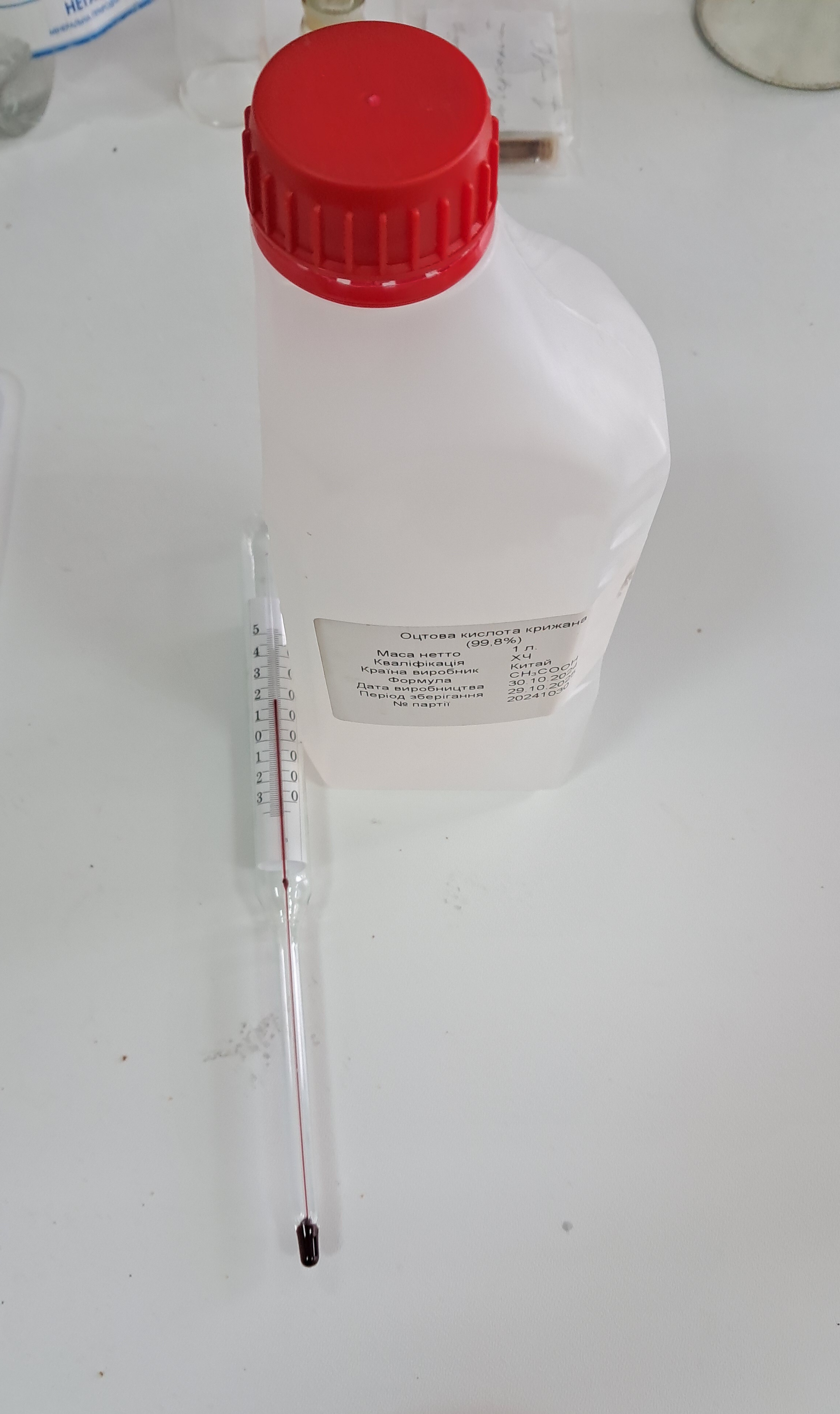

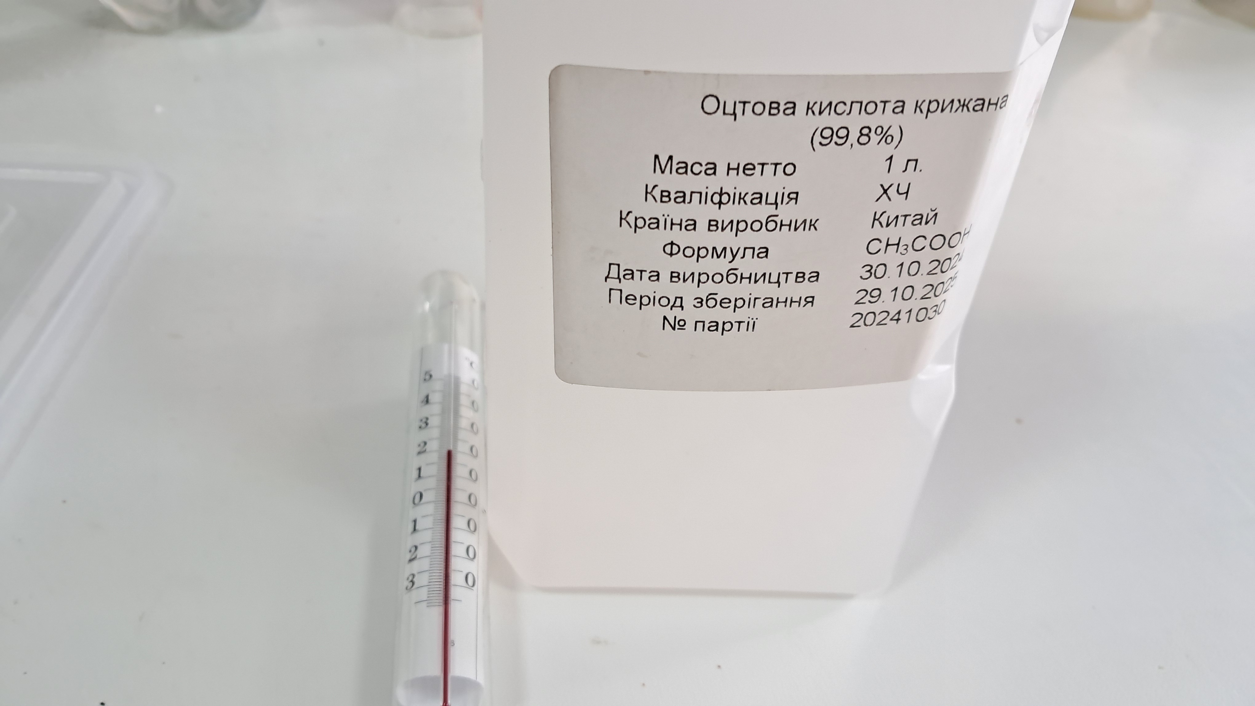

I chose acetic acid as the weak acid. However, it turned out that the glacial acetic acid in the bottle was in a solid state. During the winter, the acid had frozen in the unheated laboratory. The melting point of acetic acid is 16.6°C, and the room temperature had dropped below 0°С. Despite this, the acid had remained liquid for several months - until I picked up the bottle. At that moment, the acetic acid began to crystallize rapidly.
Now the opposite situation was observed: the room temperature was close to 20°C, yet the glacial acetic acid remained solid. Pipetting a solid acid is not particularly convenient. It seemed that not only administrative interruptions but even the reagents themselves were interfering with the experiment.

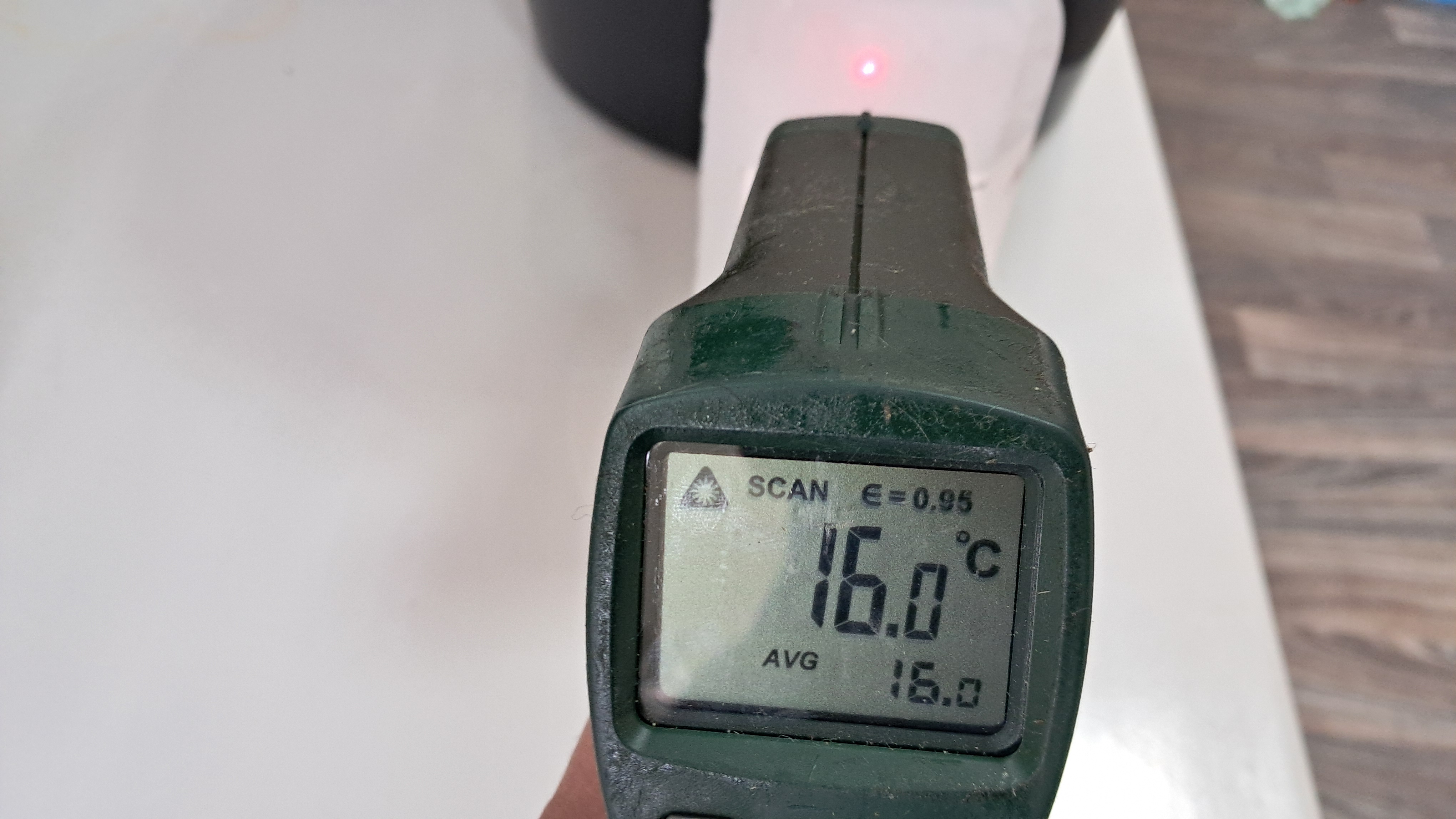

At this point, an interesting hypothesis occurred to me. Since the laboratory temperature was about 20°C, yet the acetic acid remained solid, perhaps it was a superheated solid.
To test this idea, I measured the temperature of the bottle containing the frozen acetic acid using an IR thermometer. The temperature was 16.0°C, slightly below the melting point of glacial acetic acid. The bottle simply had not yet warmed up. No miracle had occurred.
Incidentally, my encounter with ice did not end there. On my way home from work, I was caught in a hailstorm; the hailstones were about the size of peas. A few minutes later, the spring sun was shining brightly.

После прошлого эксперимента на столе стояли два стакана с водой, в которую был добавлен универсальный индикатор. Дистиллированная вода окрасилась в желтый цвет, а водопроводная вода - в зеленый.
Я хотел побыстрее описать выполненный эксперимент и продолжить экспериментировать дальше. В один из стаканов следовало постепенно добавить кислоту, в другой - раствор щелочи, чтобы наблюдать изменение цвета индикатора. Процедура элементарная - казалось бы, что может быть проще? Однако, химическая лаборатория не является изолированной системой - все мы живем в человеческом обществе.
Появилось много организационной работы, которая надолго дезорганизовала любые мои эксперименты: начиная от элементарных химических демонстраций, заканчивая научными исследованиями. Поэтому я не скоро смог вернуться к двум стаканам.
Замысел был следующий: в правый стакан по капле добавлять раствор слабой кислоты, чтобы происходило медленное падение pH - это вызовет плавный переход окраски универсального индикатора. Затем в этот стакан добавить сильную кислоту, чтобы добиться минимального значения pH (максимальная концентрация ионов водорода в растворе) и вызвать переход окраски, который не может обеспечить слабая кислота.
Потом в левый стакан добавить слабое основание, также медленно, по капле, чтобы сначала вызывать плавное увеличение значения pH. Затем добавить избыток сильного основания, чтобы добиться максимального значения pH раствора (минимальной концентрации ионов водорода).
В качестве слабой кислоты я выбрал уксусную. Однако, оказалось, что ледяная уксусная кислота внутри бутылки была в твердом состоянии. Зимой кислота замерзла, поскольку она находилась в неотапливаемой лаборатории. Температура плавления уксусной кислоты равна 16.6°C, а температура в комнате упала ниже нуля. Несмотря на это, кислота несколько месяцев оставалась жидкой, пока я не взял бутылку в руки. В этот момент уксусная кислота начала быстро кристаллизоваться.
Сейчас наблюдалось обратное явление: в комнате было почти 20°С, но ледяная уксусная кислота оставалась твердой. Набирать в пипетку твердую кислоту не очень удобно. Мало того, что клерки мешают ученым работать, так еще и кислота замерзла!
Неожиданно, у меня возникло интересное предположение. Поскольку температура в лаборатории 20С, но уксусная кислота остается твердой, значит, кислота является перегретым твердым телом.
Чтобы проверить данное предположение, измерил температуру бутылки с замерзшей уксусной кислотой с помощью IR термометра. Температура оказалась равной 16.0°С, что чуть ниже точки плавления ледяной уксусной кислоты. Бутылка просто не успела нагреться. Чуда не случилось.

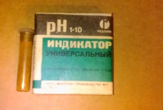

К3 Мне встречалась еще как минимум один вариант выпуска универсального индикатора- готовый спиртовой раствор в бутылочке. В детсве мне достался набор Н.И. Алямовского, он предназначался для определения кислотности почвы. набор состоял из эталонов окраски индикатора в запаянных пробирках, визуального колориметра, баночки с индикатором и еще некоторых мелочей. Самое класное, что было в этом наборе, - карболитовый клевый ящик
И еще в догонку фотография оригинальной упаковки индикатора из статьи.
