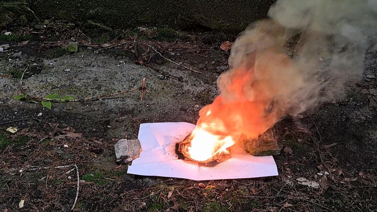

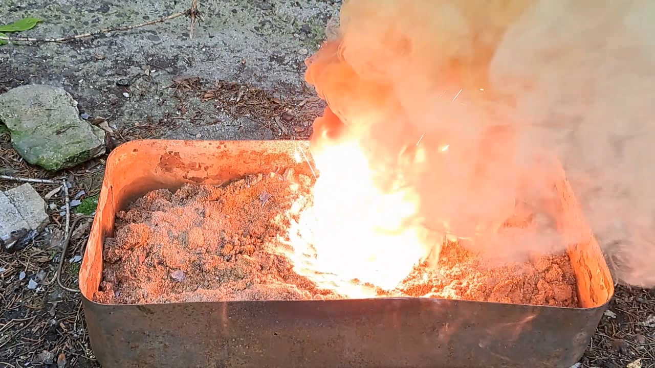

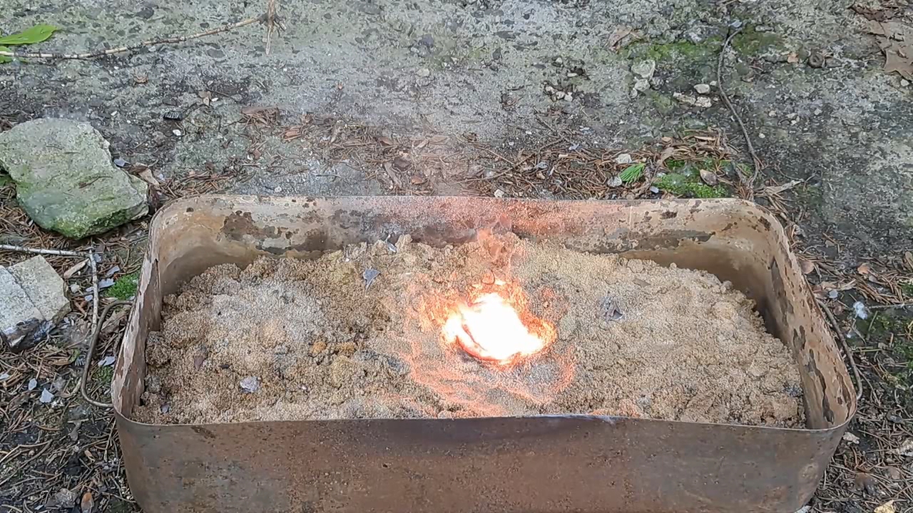

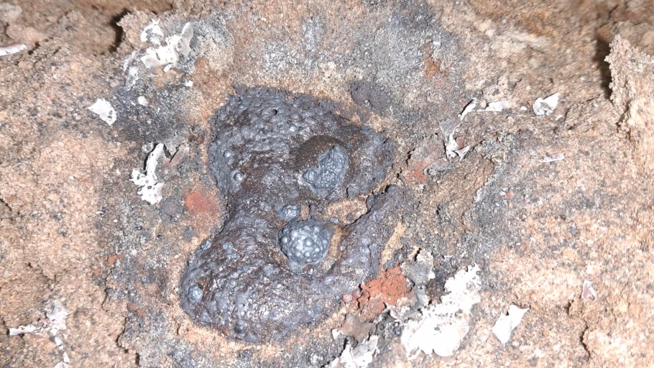

Combustion of Mixture: Lead(II, IV) Oxide/Aluminum (Pb3O4/Al) - Part 24
Горение смеси: оксид свинца (II, IV)/алюминий (Al/ Pb3O4) - часть 24

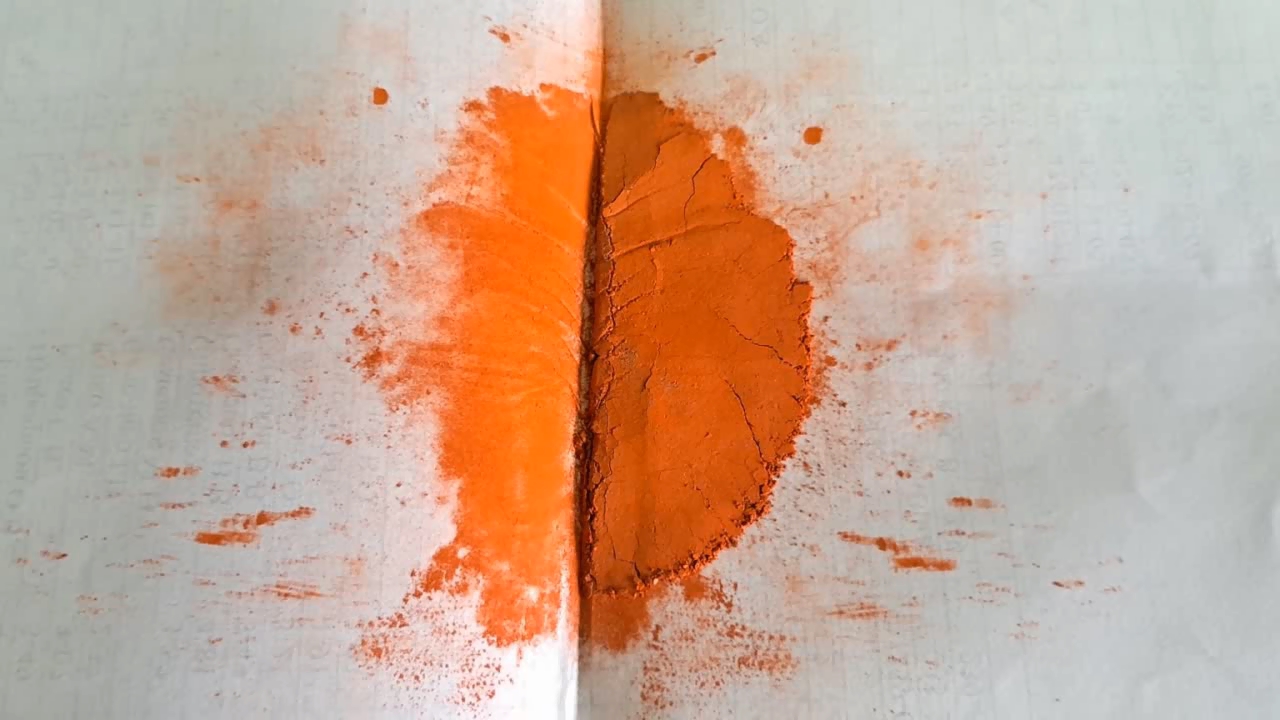

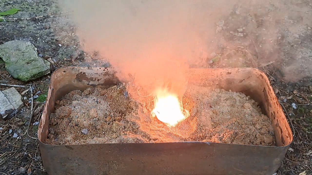

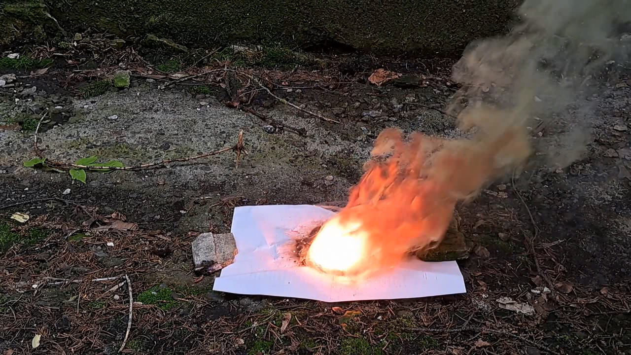

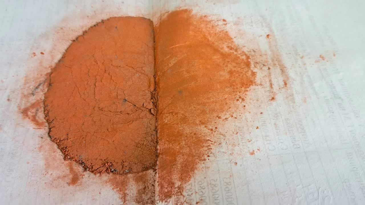

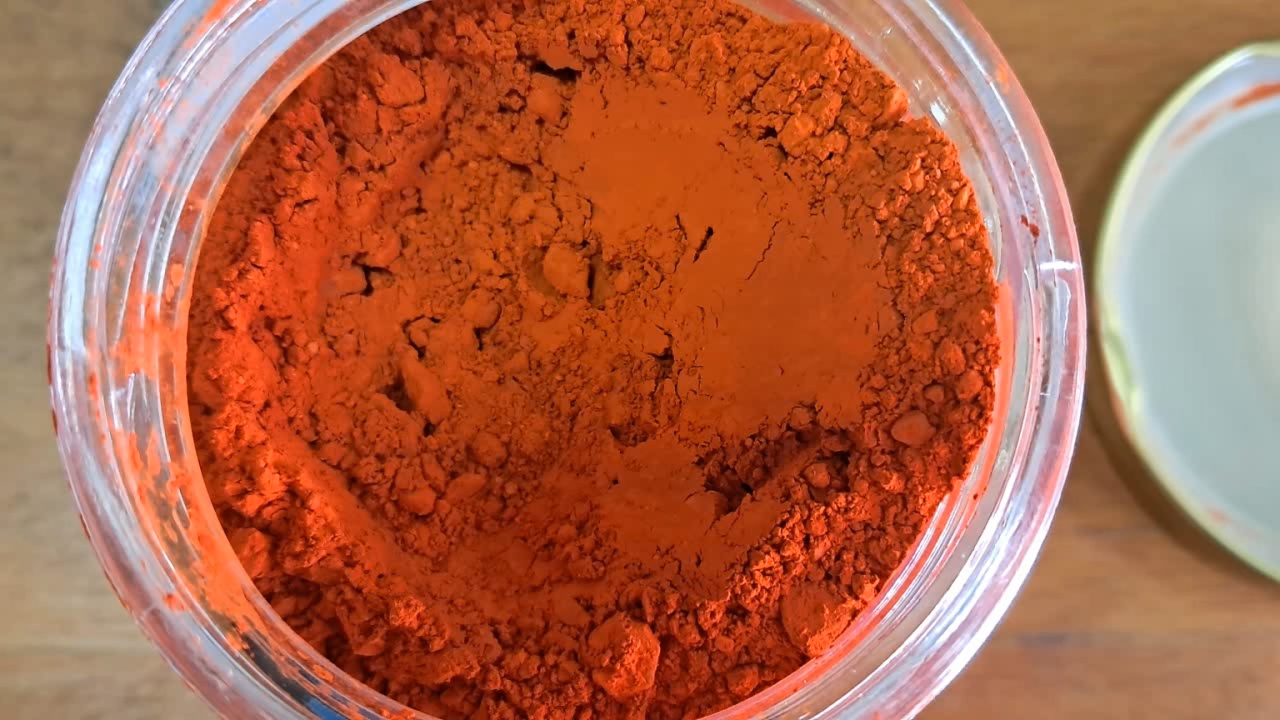

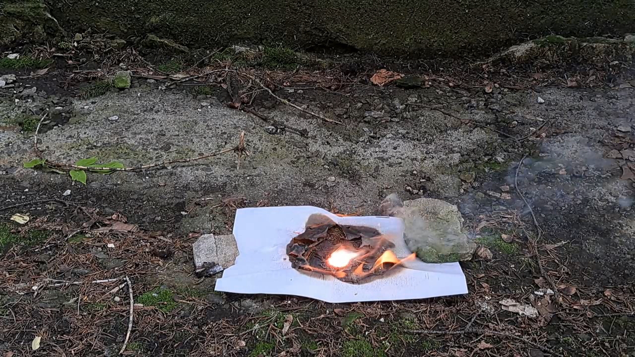

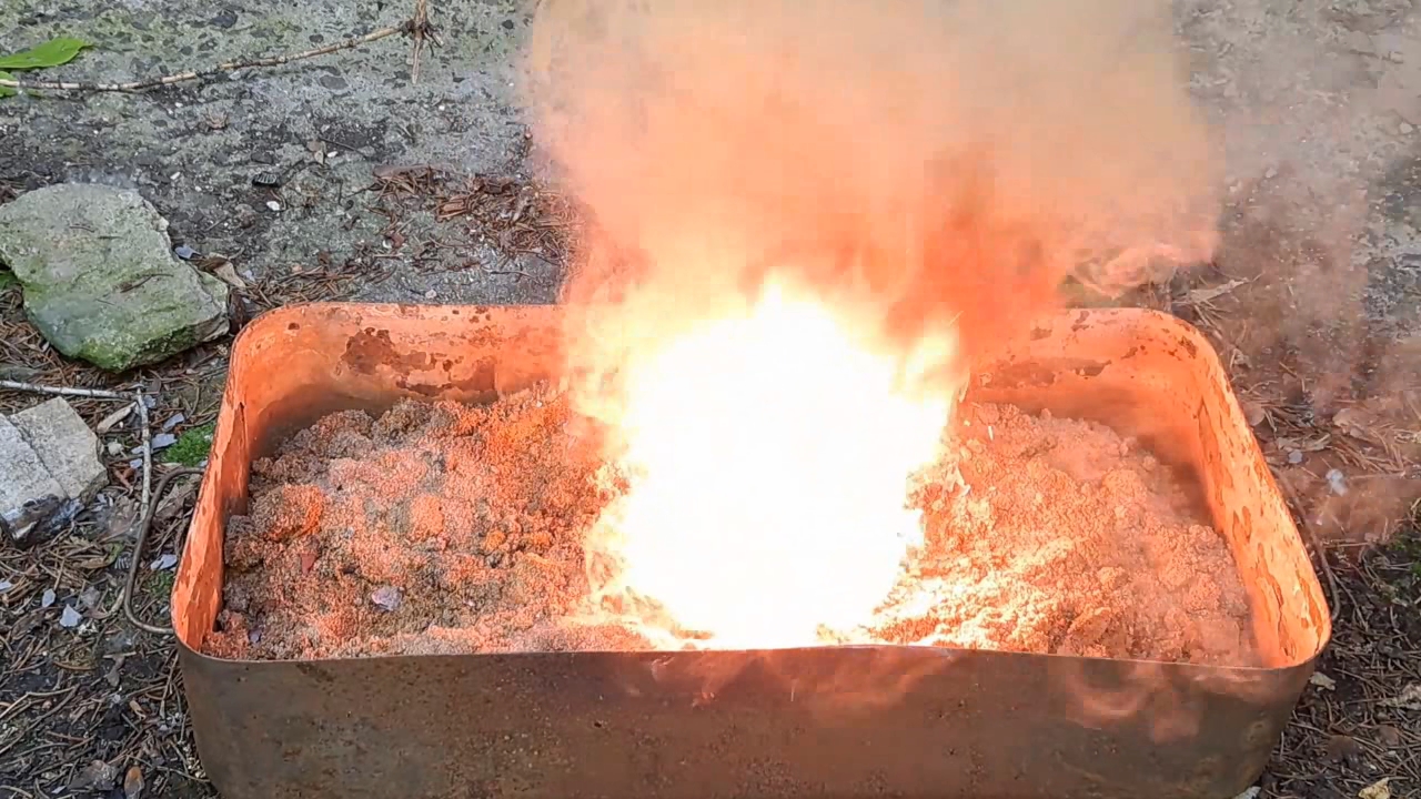

In previous experiments, the thermite mixtures contained iron oxide (Fe3O4), copper oxide (CuO), and calcium sulfate (CaSO4). I had another oxide available—lead(II, IV) oxide (Pb3O4), also known as red lead. Its formula is similar to that of iron(II, III) oxide (Fe3O4). Like iron oxides, Pb3O4 is used as an inorganic pigment. However, this is where the similarity between Fe3O4 and Pb3O4 ends.
Despite their similar formulas, Fe3O4 contains iron in the +2 and +3 oxidation states, while Pb3O4 contains lead in the +2 and +4 oxidation states. The oxidizing properties of Pb(IV) are much stronger than those of Fe(III). Similarly, Pb(II) is a stronger oxidizer than Fe(II). Therefore, a mixture of Pb3O4 and finely dispersed aluminum can explode when exposed to flame or mechanical shock. It is not surprising that in the reference table listing various thermite compositions, not a single mixture includes lead oxides [1]. Pb3O4 does appear in some compositions intended for thermite ignition, but even in these, it is not combined with aluminum or magnesium.

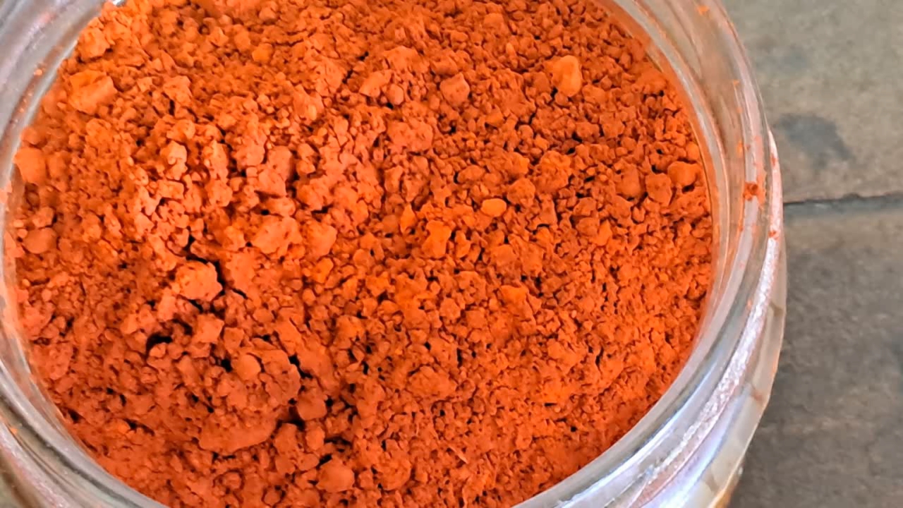

I learned that a mixture of red lead and aluminum powder can explode when ignited or struck from a chemist friend of mine, who at the time worked as a forensic expert for the police. He prepared a mixture of Pb3O4 and aluminum pigment powder to demonstrate to his supervisor that it was indeed capable of exploding. Thus, an explosive device can be made simply by mixing two common pigments.
Aluminum pigment powder ("silver paint") is a pigment consisting of small aluminum flakes with an average length of no more than 30 microns and a thickness of 0.2-0.5 microns. I planned to use aluminum powder with significantly larger particles (100-140 microns), so I expected the reaction to be violent, but not explosive.
Another important difference between Fe3O4 and Pb3O4 is that lead is extremely toxic. Inhaling aerosols and vapors of lead compounds is unacceptable. Therefore, I decided to use only minimal amounts of the Pb3O4-Al mixture and to wear a respirator. The experiments were conducted outdoors.

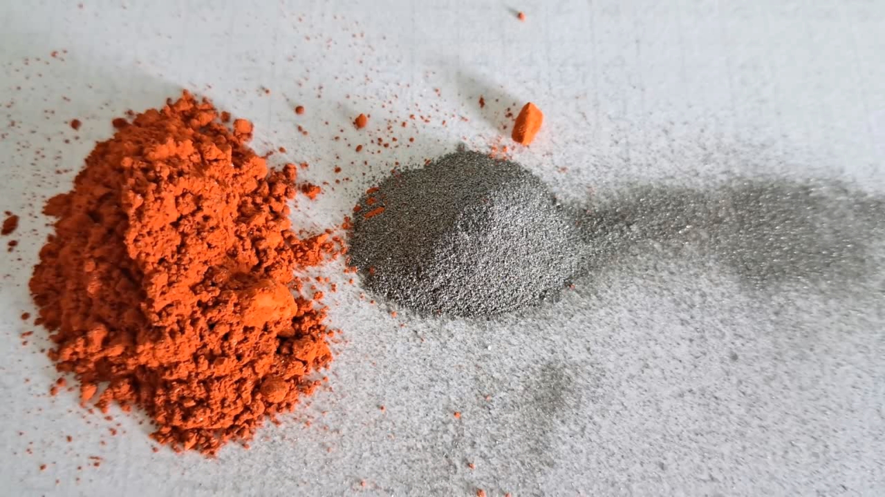

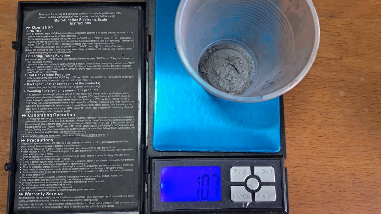

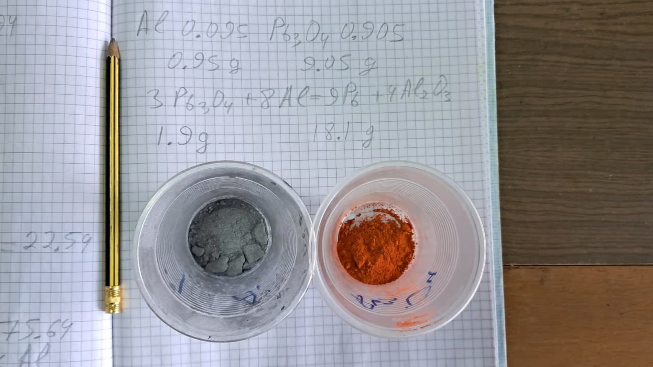

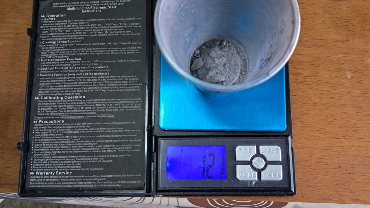

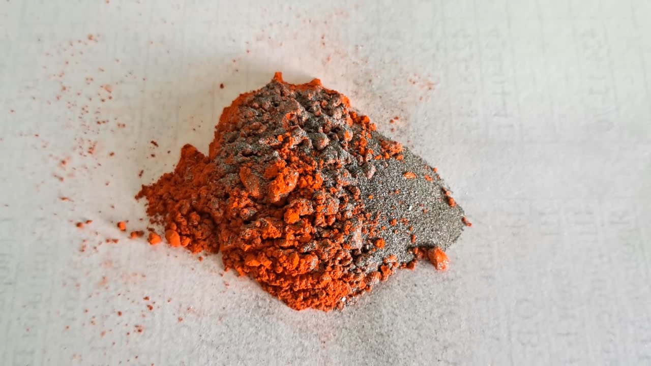

I calculated the stoichiometric ratio for the Pb3O4/Al mixture. Initially, I determined that 0.50 g of aluminum should be added to 9.50 g of lead oxide. However, these numbers seemed implausible, so I rechecked my calculations and discovered an error. The correct ratio is 9.05 g of Pb3O4 to 0.95 g of aluminum. Even so, the result felt counterintuitive—almost ten grams of lead oxide for every gram of aluminum.
I searched for more information online and unexpectedly came across an article in our journal [2] that described experiments conducted by colleagues. It confirmed that my calculated Pb3O4/Al ratio was accurate. In their experiment, the colleagues placed a mixture of lead oxide and aluminum pigment powder in a plastic syringe, which exploded loudly and released a cloud of toxic smoke. Their test was conducted in a deserted area during peacetime. However, due to the ongoing war, loud noises can frighten people, as they are now associated with danger.

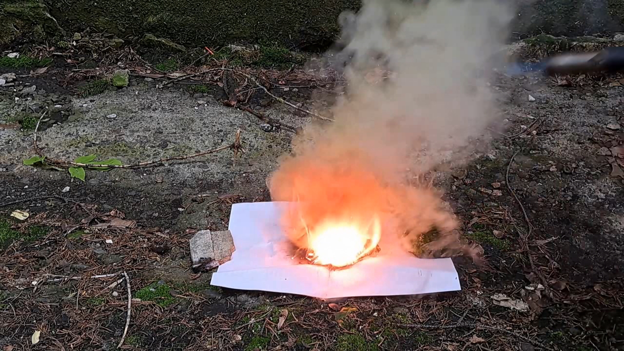

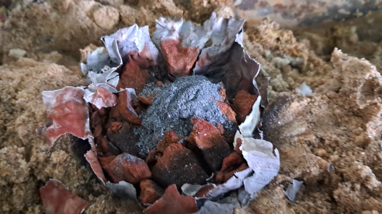

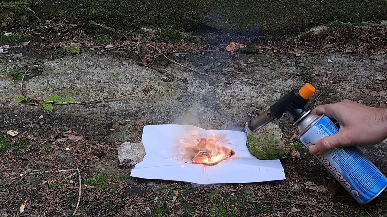

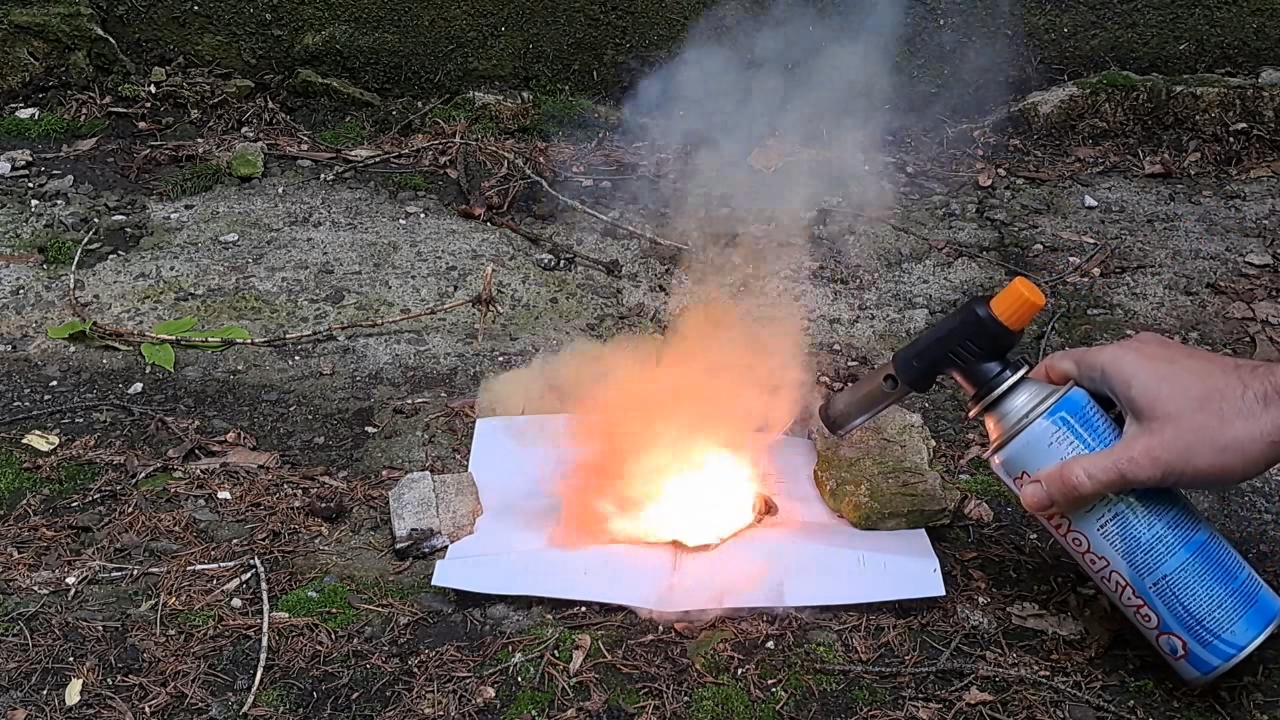

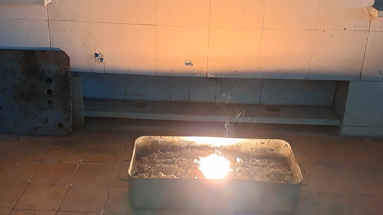

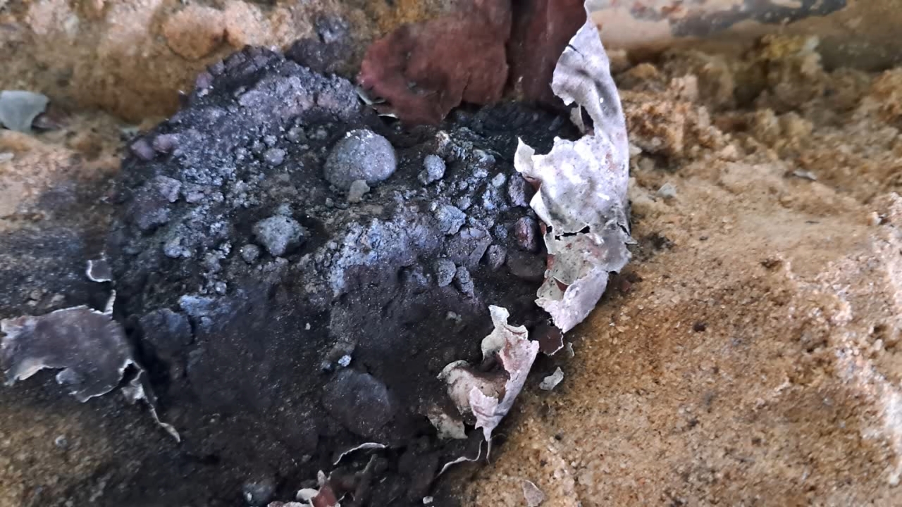

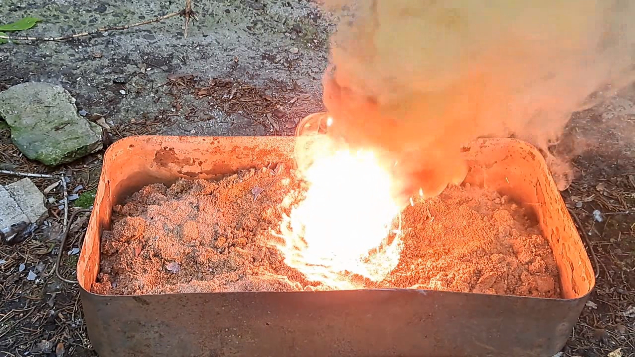

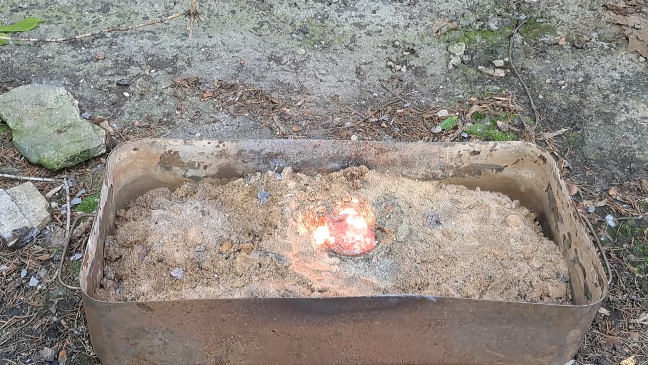

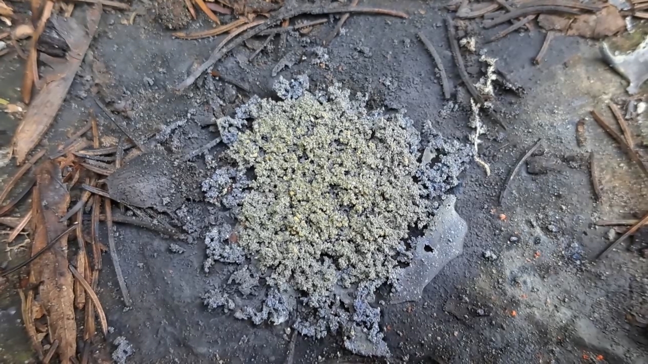

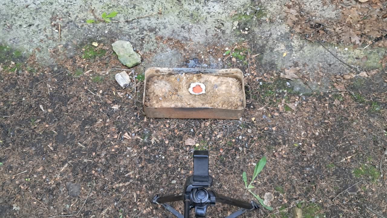

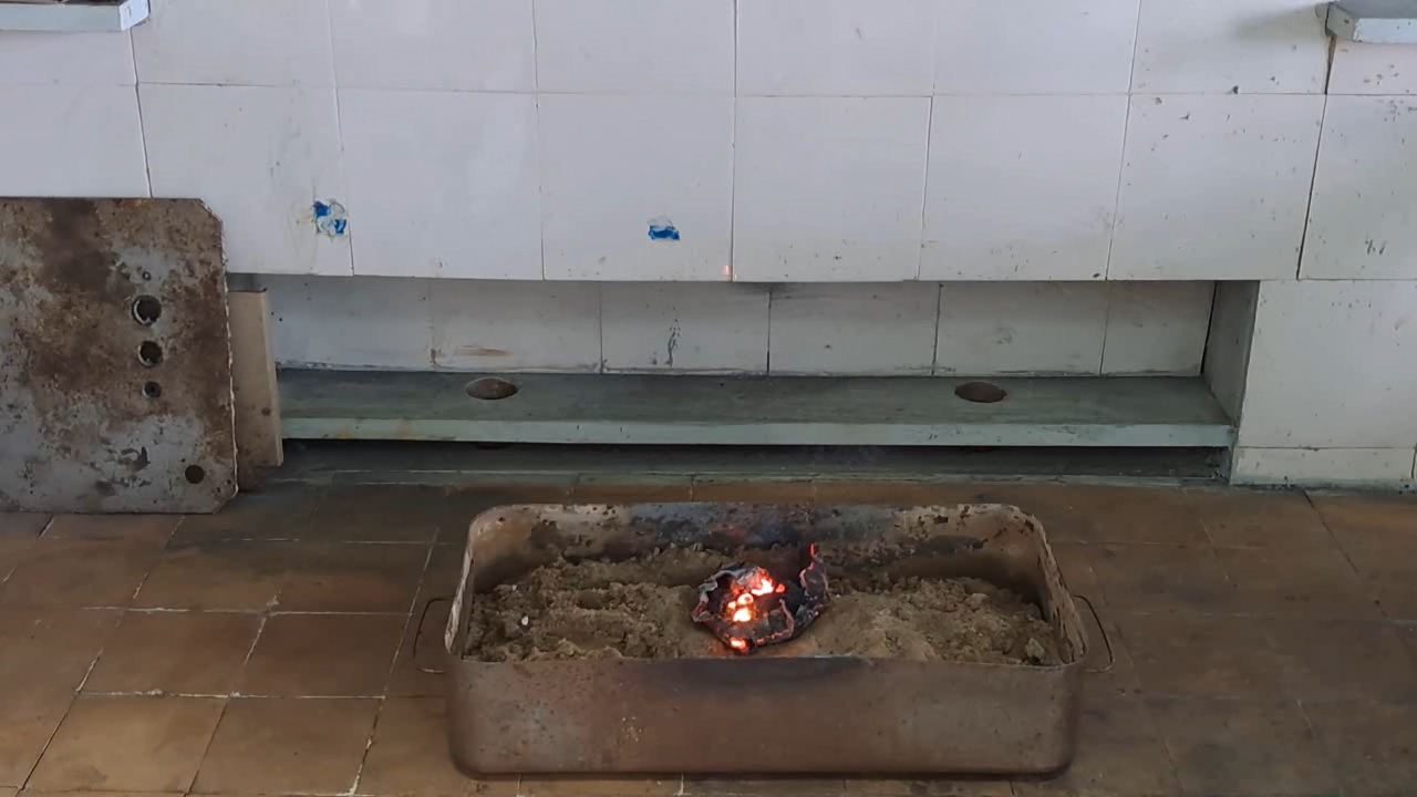

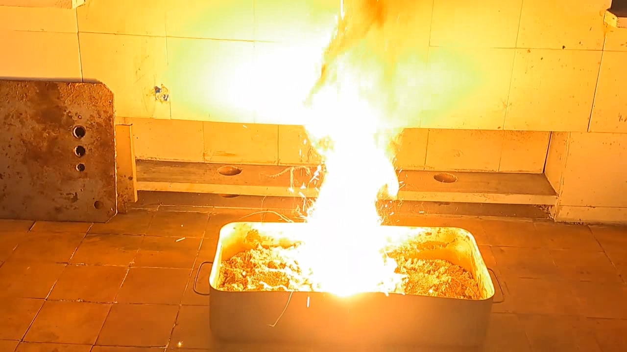

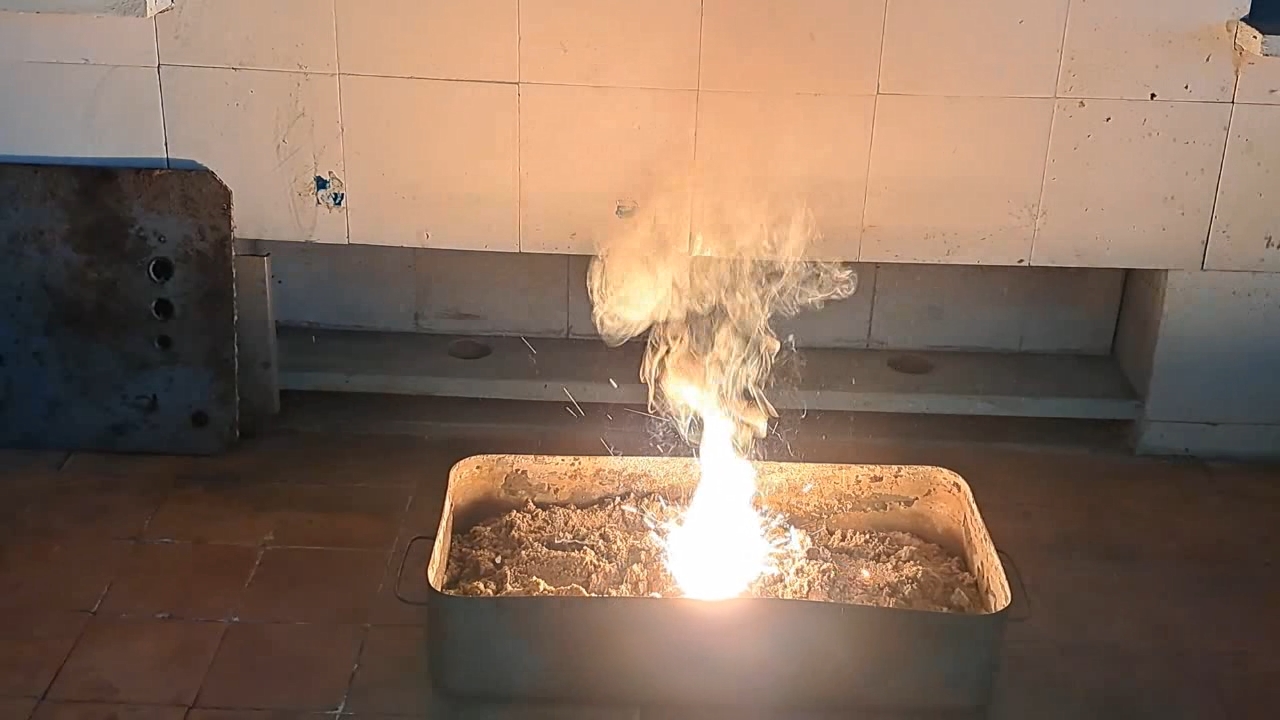

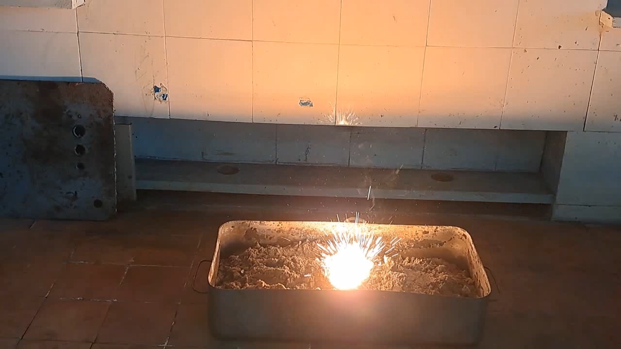

To avoid the risk of an explosion, I decided not to place the mixture in a confined container. Additionally, I conducted the experiments outdoors due to the formation of toxic aerosols of lead compounds. To avoid inhaling these aerosols, I wore a respirator during the experiments.

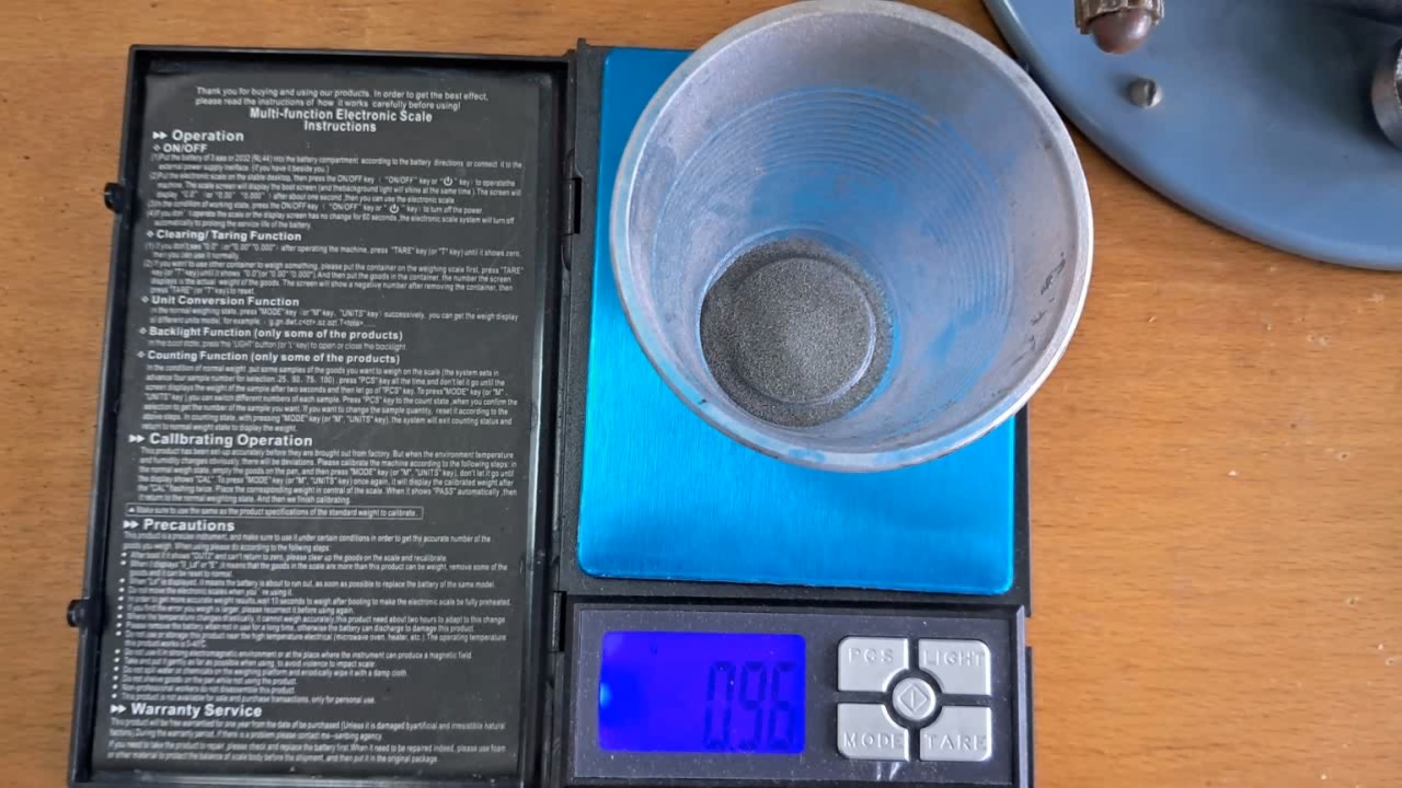

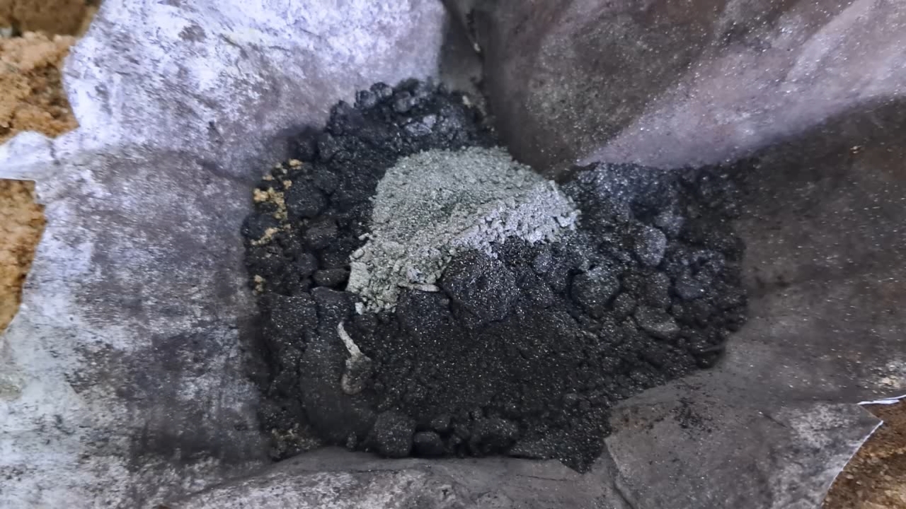

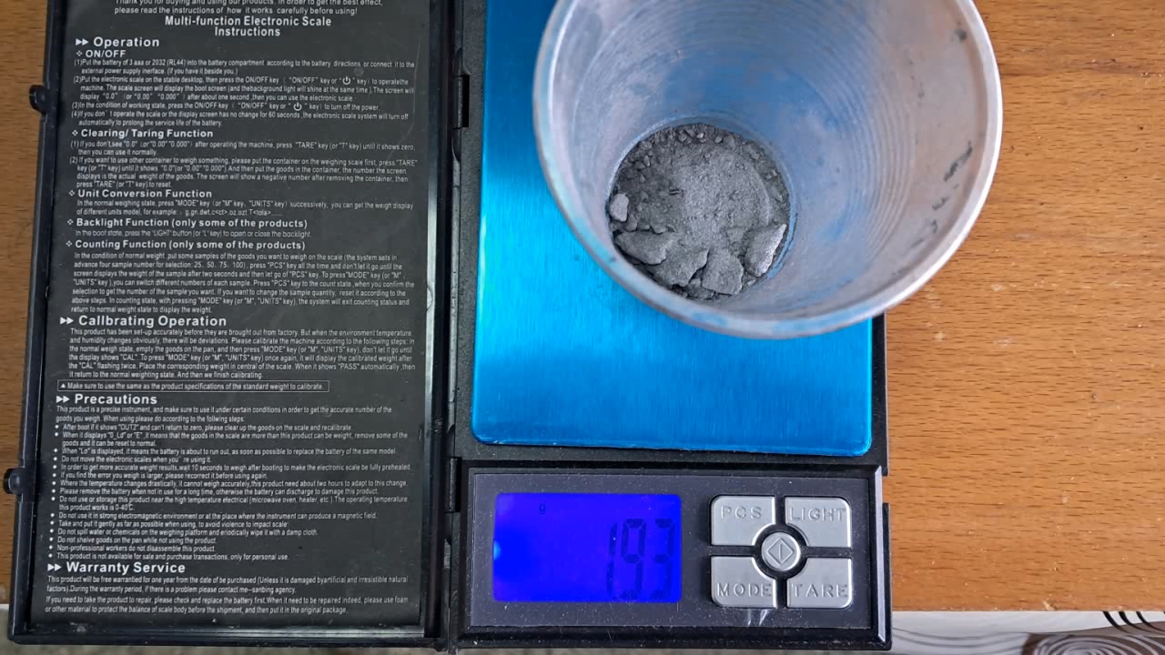

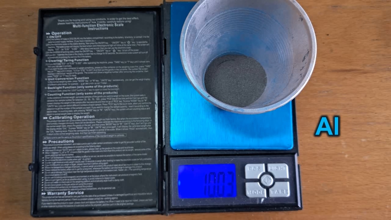

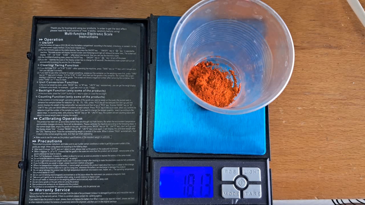

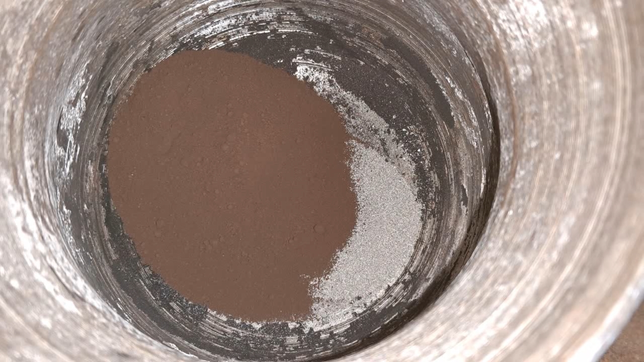

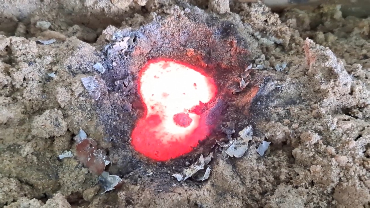

I weighed out 0.95 g of aluminum and 9.05 g of Pb3O4. The aluminum particles were 100-140 microns in size. I thoroughly mixed the powders on a sheet of paper, placed it on the ground, and ignited the mixture using a gas burner. It burned with a yellow flame and released a large amount of yellowish-gray smoke. The combustion was not vigorous. After the reaction, a yellowish-gray mass remained. The main products were metallic lead (gray) and aluminum oxide (white). The yellowish color was due to the formation of a small amount of lead(II) oxide (PbO).

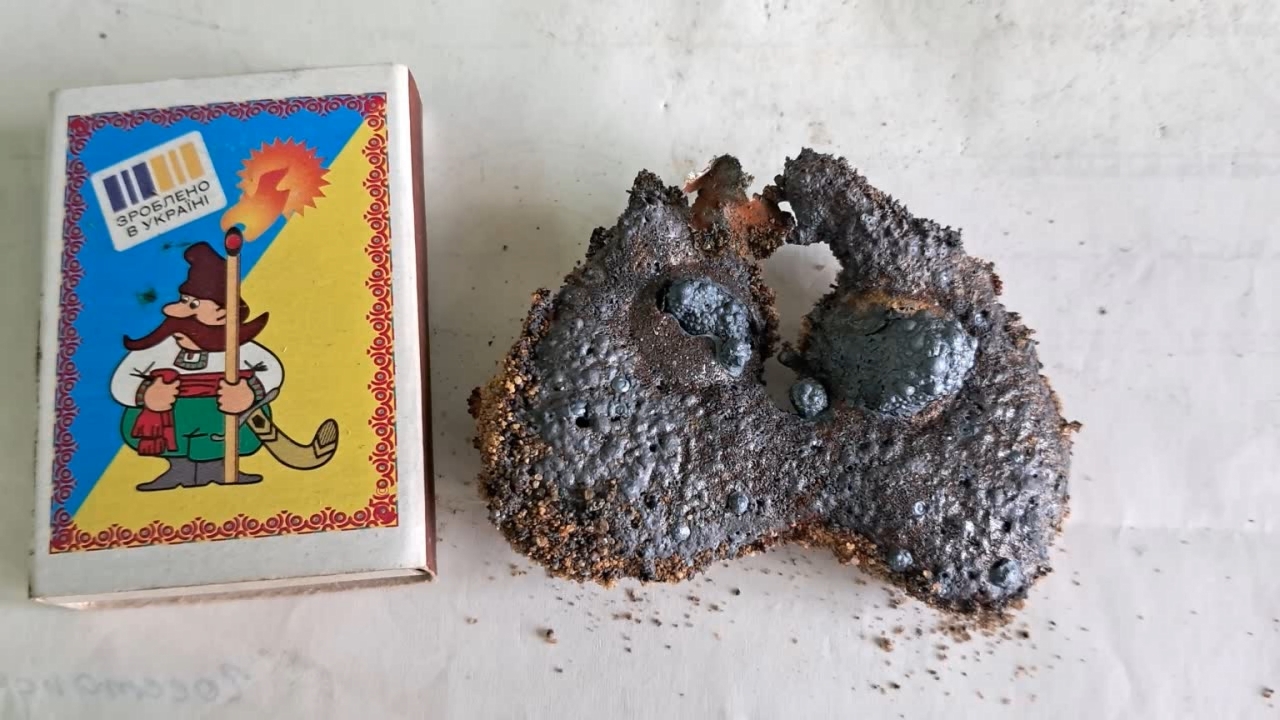

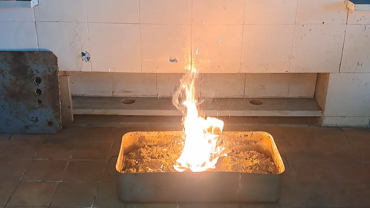

I repeated the experiment, this time doubling the quantities (1.9 g of aluminum and 18.1 g of Pb3O4). I poured the mixture into an open aluminum foil container and placed it in a sand-filled tray. The burner ignited the mixture, which again burned with a yellow flame, producing a large volume of yellowish-gray toxic smoke. Fortunately, the smoke quickly rose and dispersed. The combustion was again not violent and seemed less impressive than the Fe3O4/Al thermite reaction.

Провел расчет стехиометрического состава смеси Pb3O4/Al. Получилось, что к 9.50 г оксида свинца необходимо добавить 0.50 г алюминия. Свинец имеет большую атомную массу, а алюминий - маленькую, но цифры все равно выглядели неправдоподобно. Проверил расчет, нашел ошибку. Правильное соотношение: 9.05 г оксида свинца - 0.95 г алюминия. Все равно цифры выглядели нереалистично - на каждый грамм алюминия необходимо добавить около десяти грамм оксида свинца.

Чтобы избежать взрыва, решил не помещать смесь закрытую оболочку. Кроме того, эксперименты с данной смесью проводил на открытом воздухе ввиду образования токсичного аэрозоля соединений свинца. Чтобы не вдыхать данный аэрозоль, во время экспериментов я надевал респиратор.
Взвесил 0.95 г алюминия и 9.05 г оксида свинца (II, IV). Размер частиц алюминия был 100-140 мкм. Вещества тщательно смешал на листе бумаги. Бумагу поместил на землю и направил на смесь пламя газовой горелки. Смесь загорелась желтым пламенем, образуя много желтовато-серого дыма. Горение не было бурным. После сгорания смеси осталась желтовато-серая масса. Основные продукты реакции - металлический свинец (серый) и оксид алюминия (белый). Желтоватый цвет обусловлен образованием небольшого количества оксида свинца (II) PbO.
Повторил эксперимент, увеличив количество веществ вдвое [1.9 г алюминия и 18.1 г оксида свинца (II, IV)]. Смесь насыпал в открытый контейнер из алюминиевой фольги, которую поместил в лоток с сухим песком. Направил пламя горелки на смесь. Смесь воспламенилась и сгорела желтым пламенем, образуя много желтовато-серого токсичного дыма. К счастью, дым быстро поднялся вверх и рассеялся. Взаимодействие также не было бурным и выглядело менее эффектно, чем горение термита Fe3O4/Al.

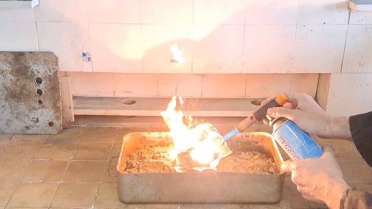

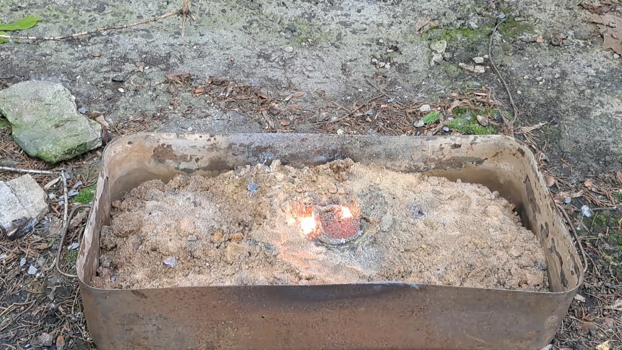

Fe3O4/Al Thermite: Soot in Iron Oxide Iron(II, III) - Part 25
Термит Fe3O4/Al: сажа в оксиде железа (II, III) - часть 25

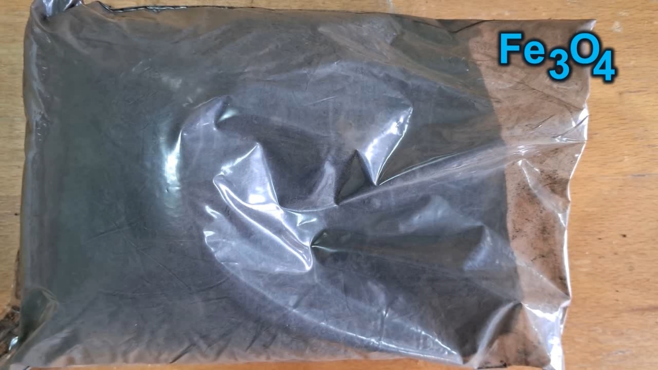

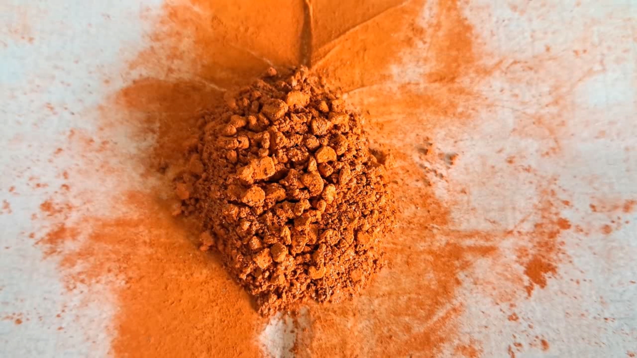

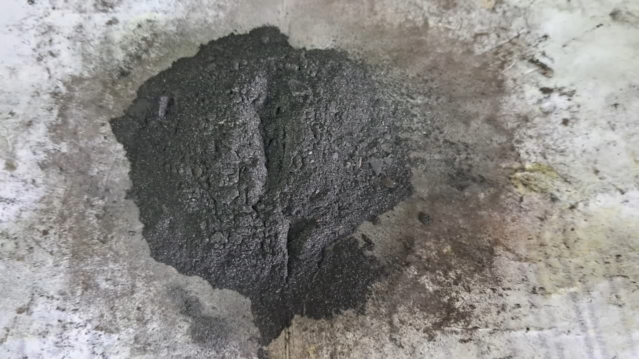

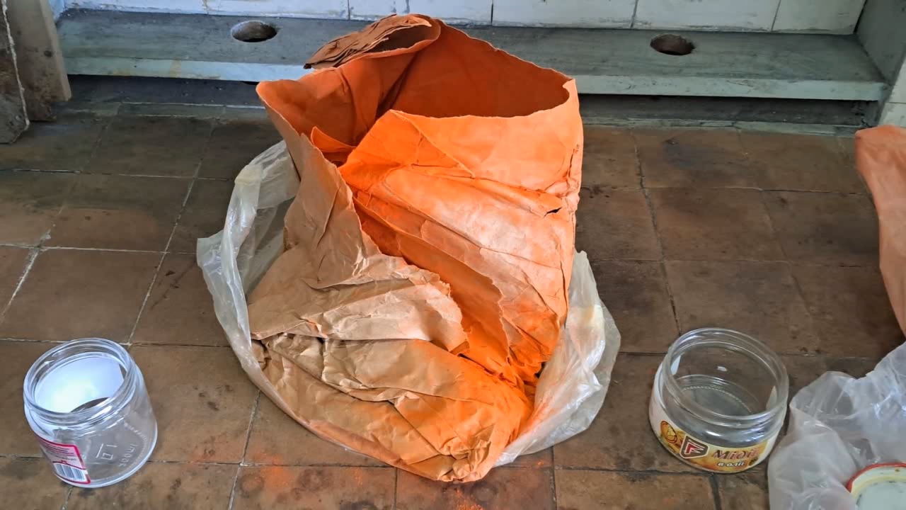

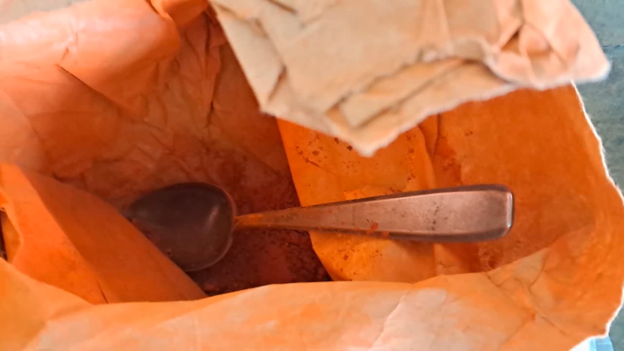

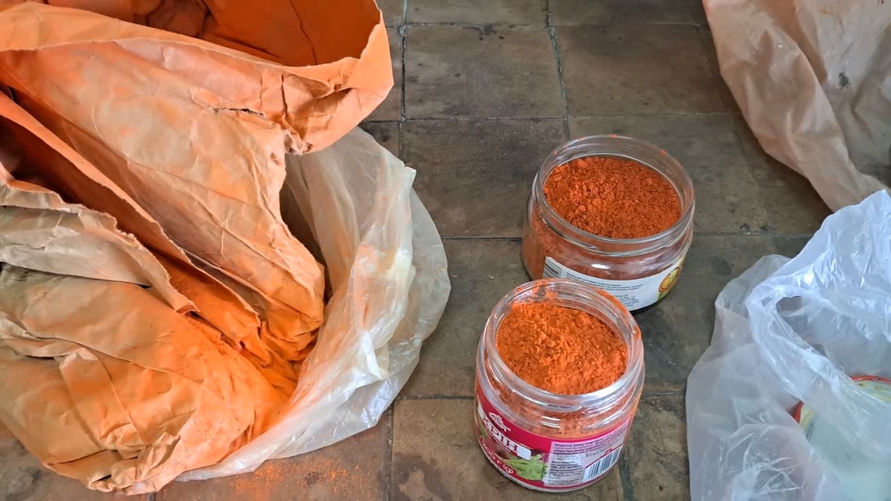

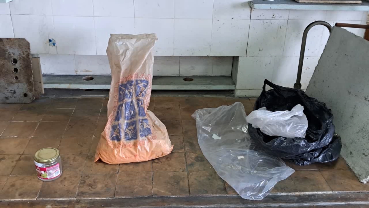

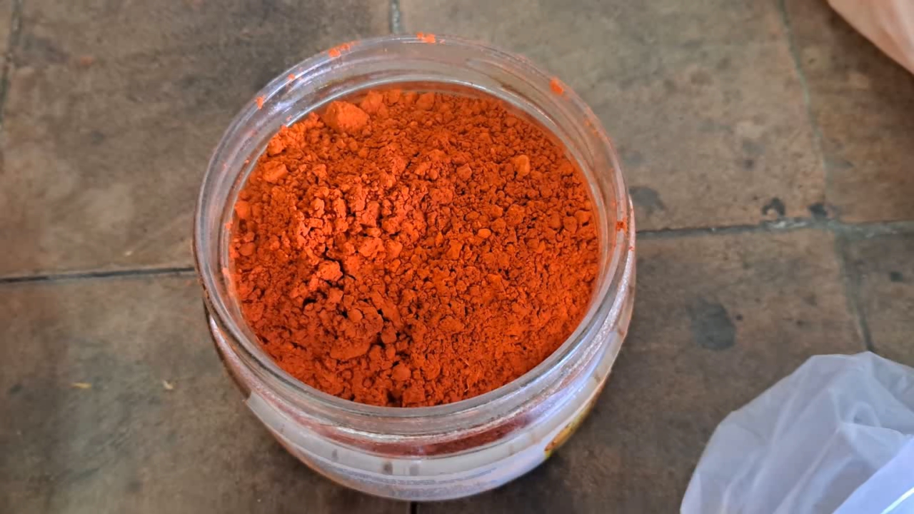

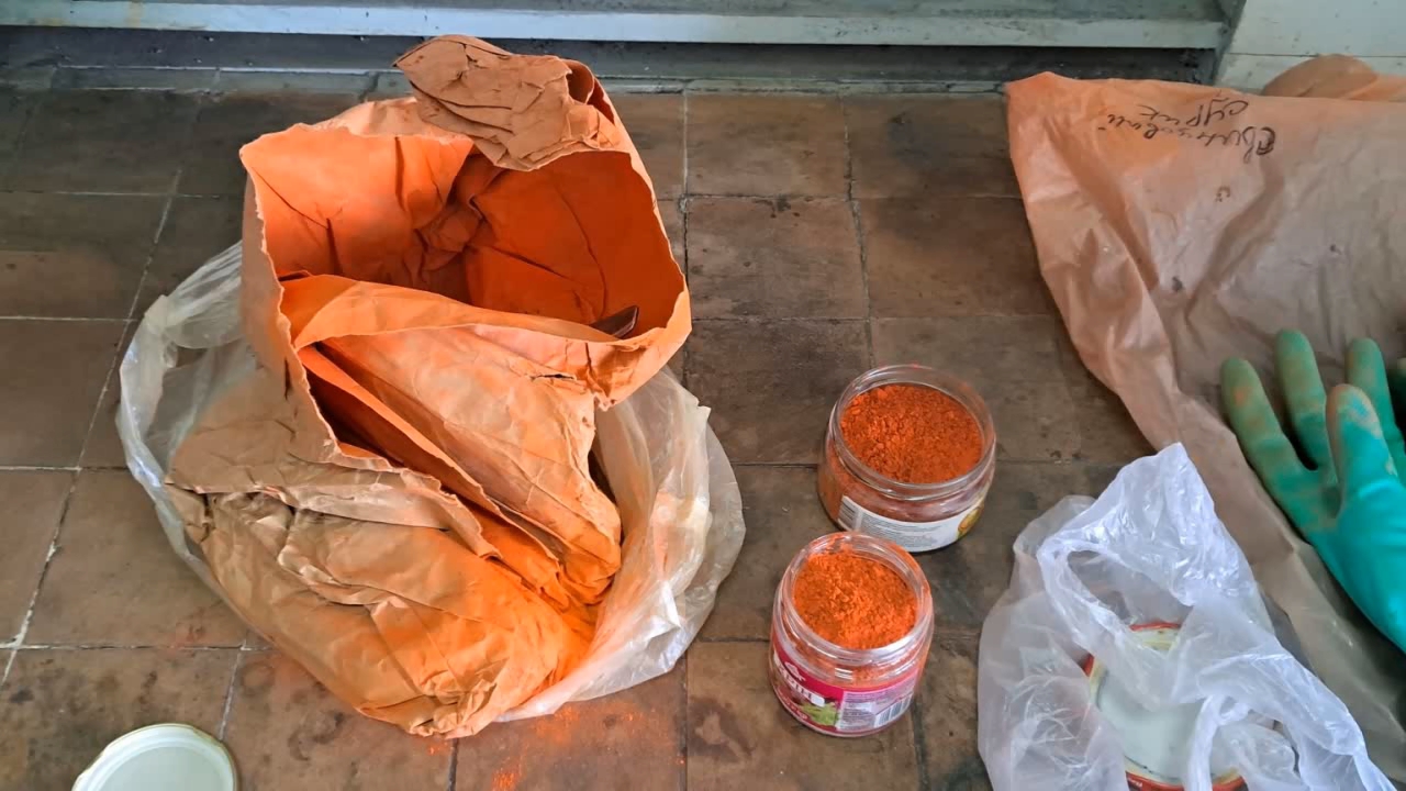

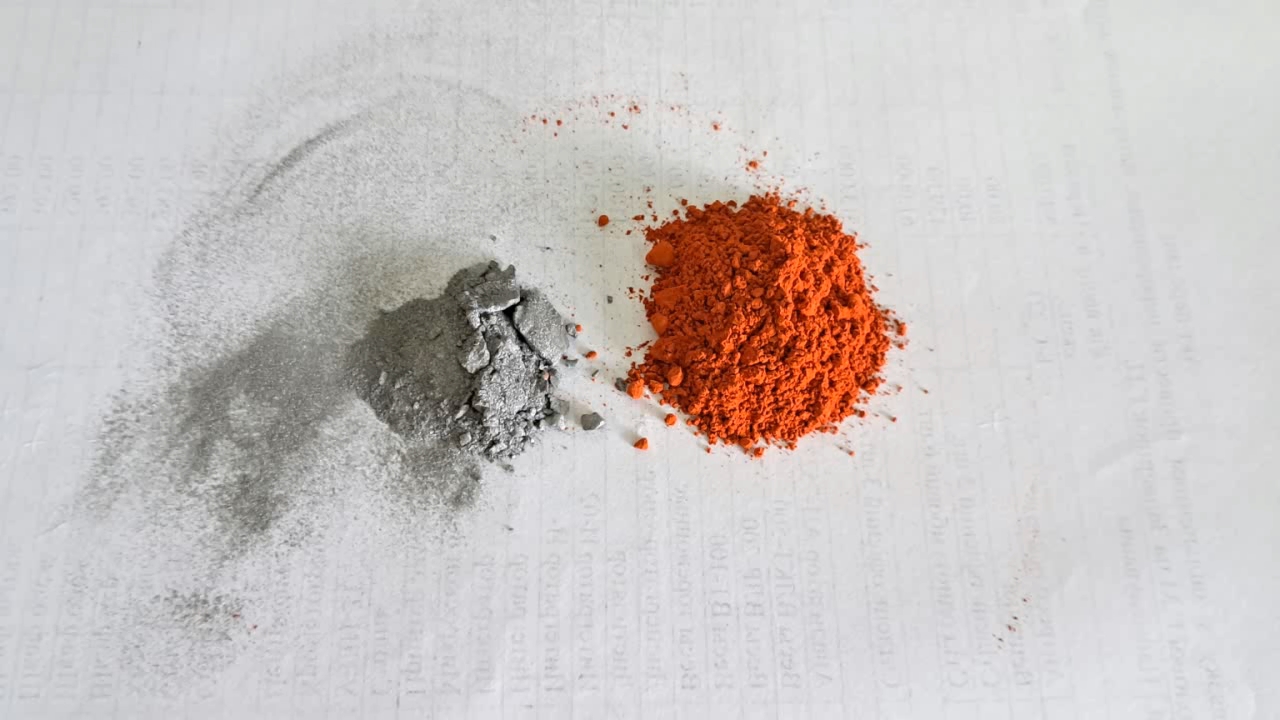

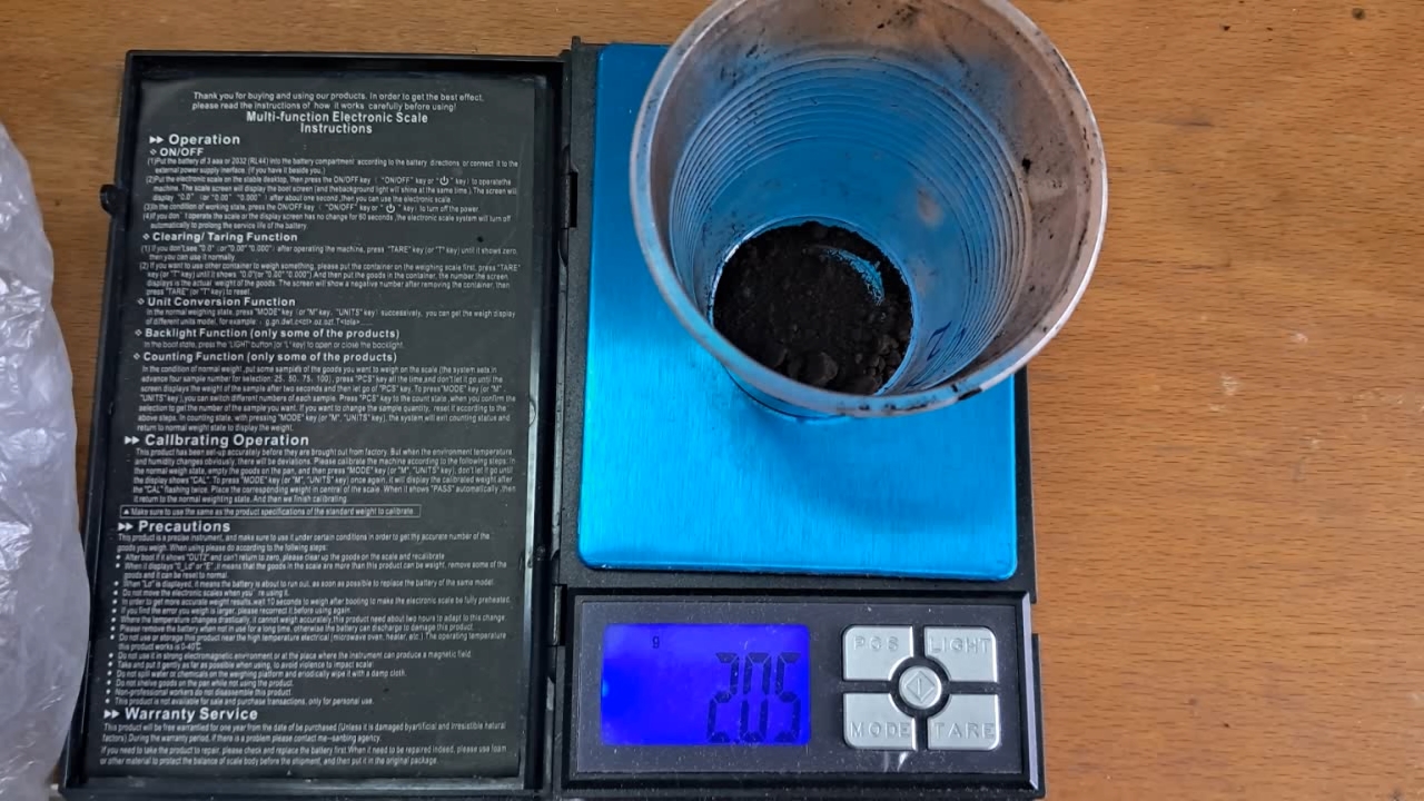

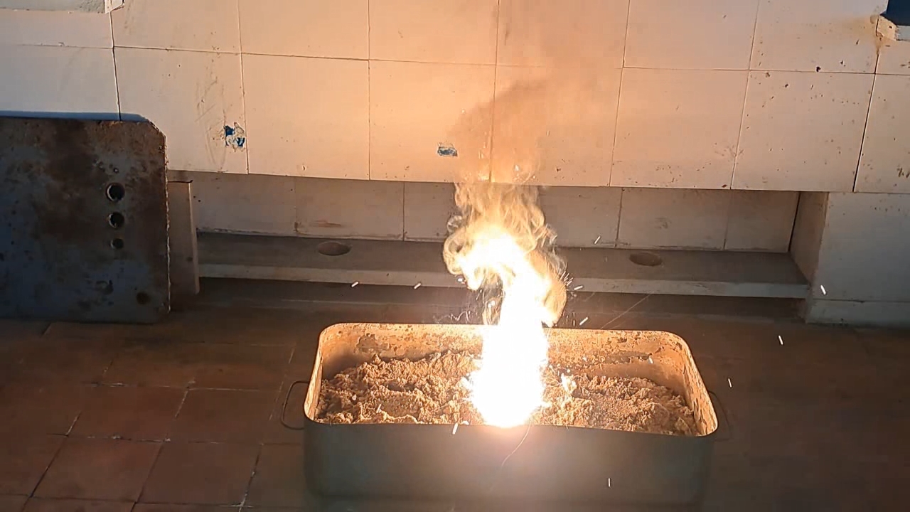

After conducting a series of experiments with thermite mixtures containing aluminum and iron oxide, I planned to test compositions using other metal oxides, as well as calcium and barium sulfates, as oxidizers. However, a colleague unexpectedly brought a kilogram of iron oxide pigment (Fe3O4) to the lab.
— I bought it on sale! There's a discount on this at the supermarket right now! Check if this iron oxide is suitable for thermite—if it is, I'll buy more. Three more packages are on sale!
— Thanks, but there's no need to buy more. We're not a thermite research lab, so we don't need such a large amount of iron oxide.

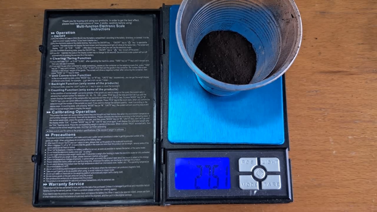

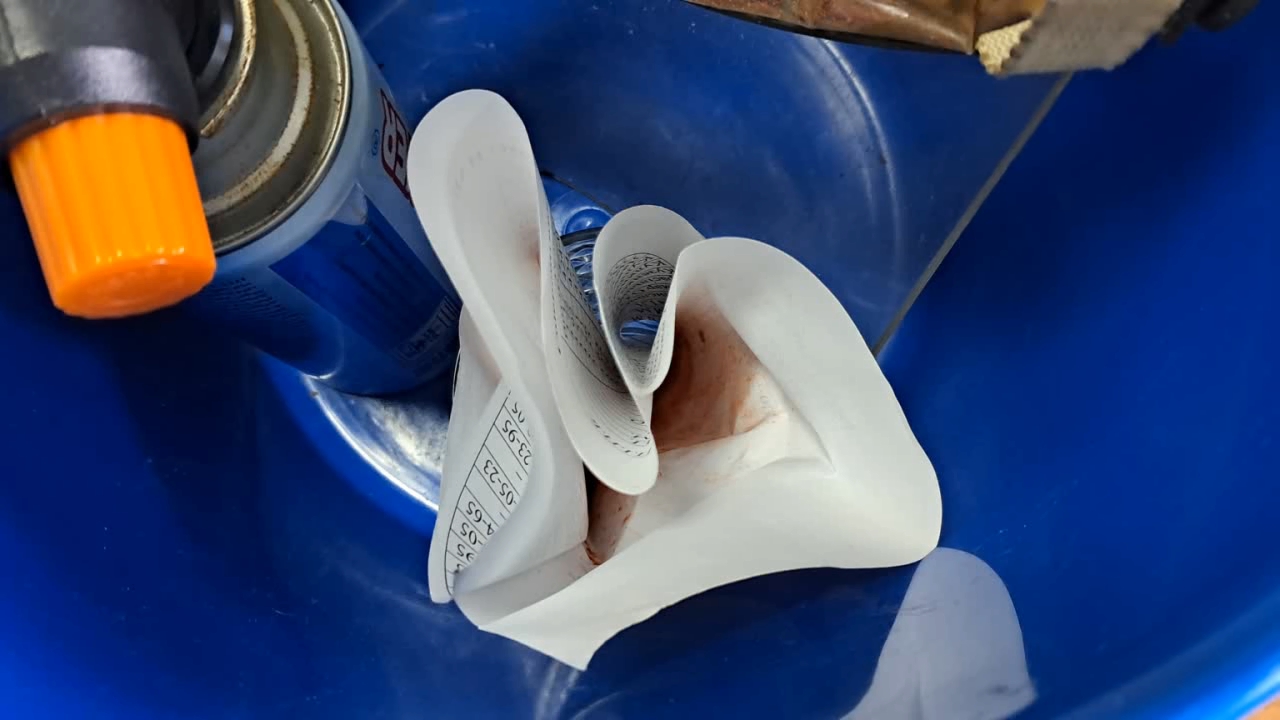

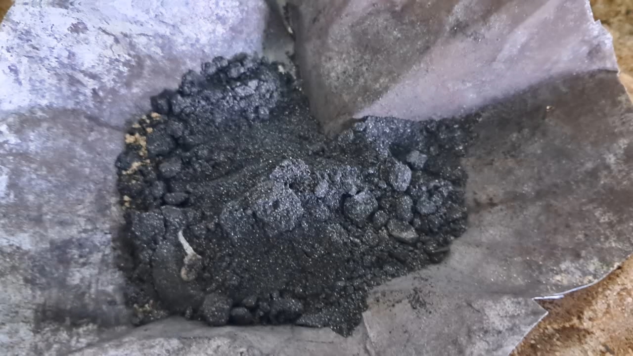

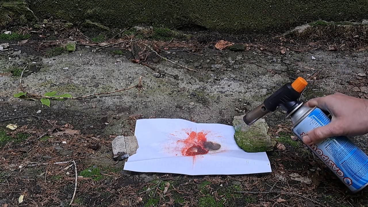

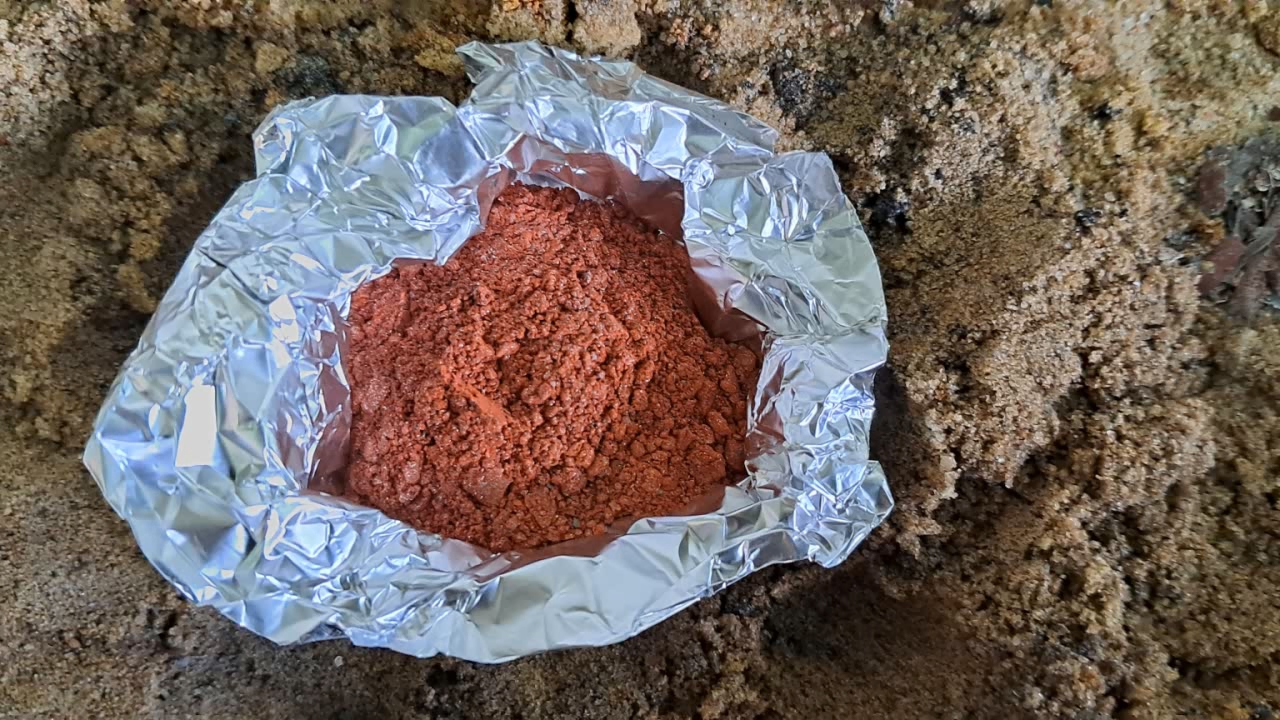

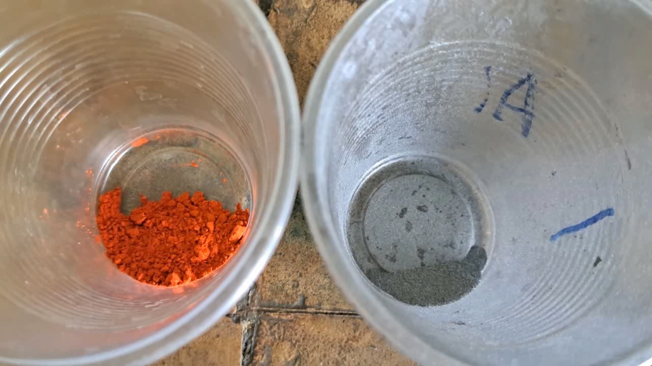

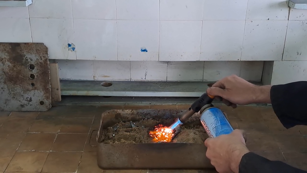

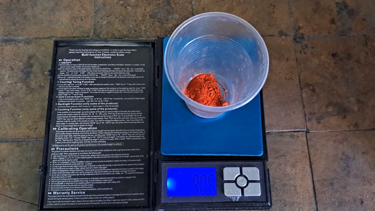

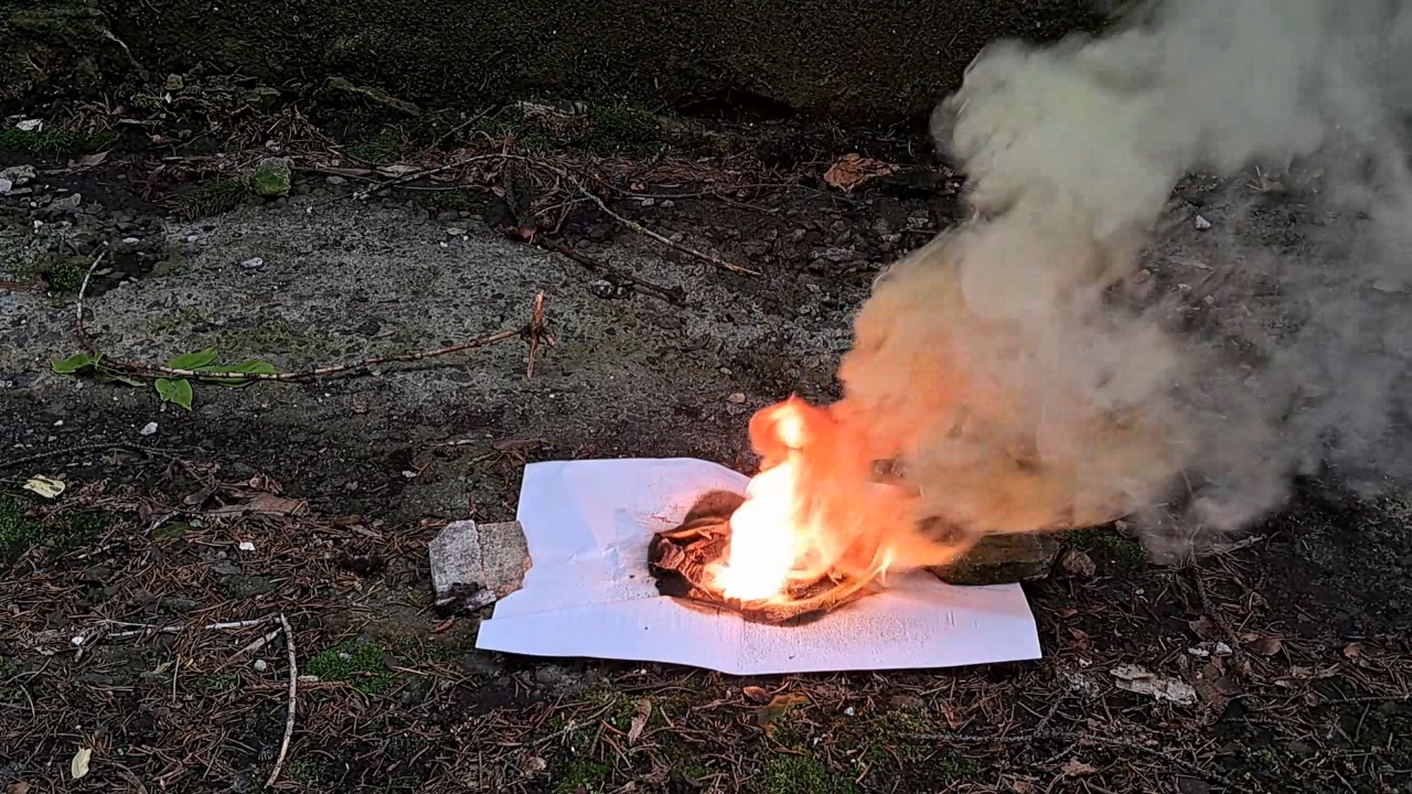

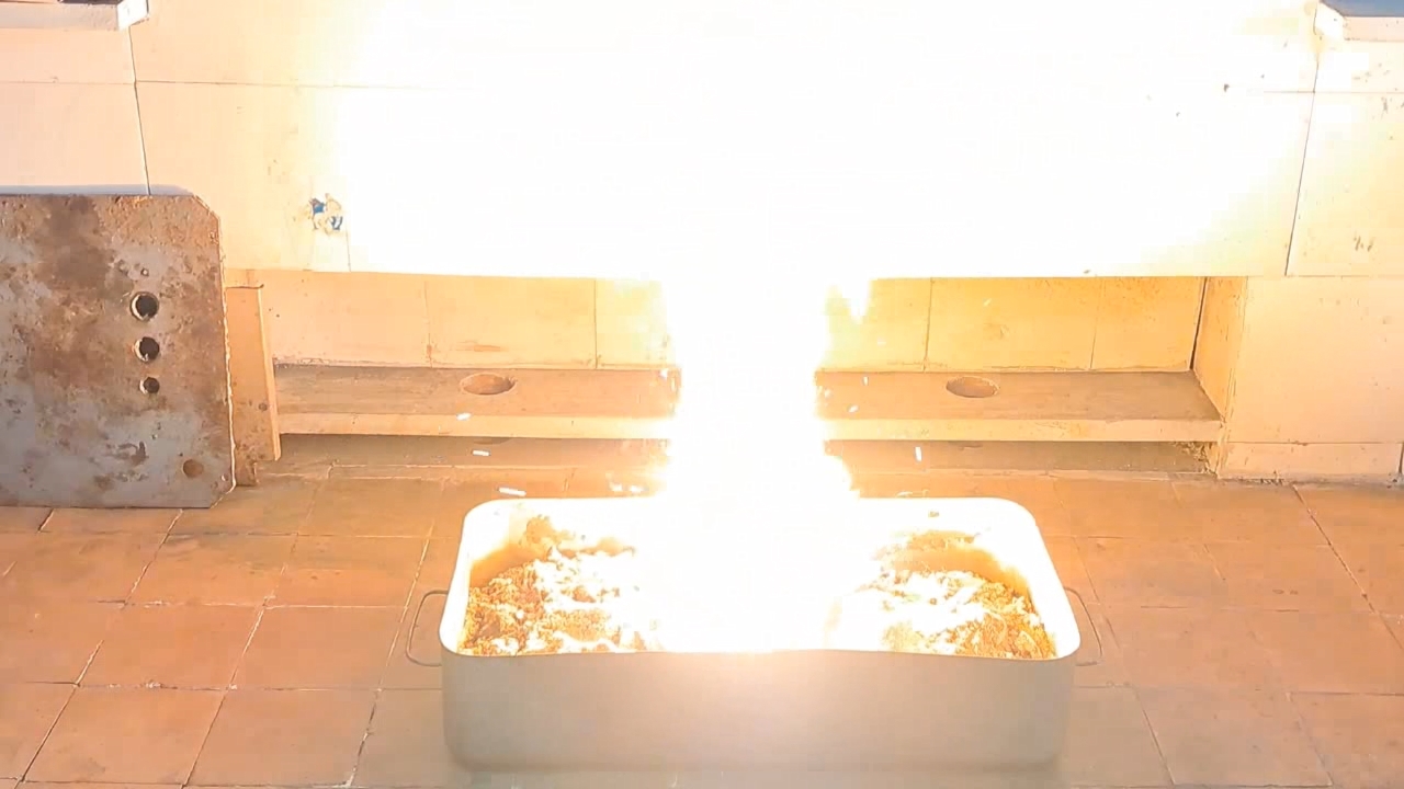

Since my colleague had already purchased the oxide, I decided to test whether it was suitable for thermite preparation. I weighed out and thoroughly mixed 10 g of aluminum (particle size: 100-140 microns) with 27.5 g of the oxide. The mixture was placed in a paper bag and compacted tightly in the palm of my hand.

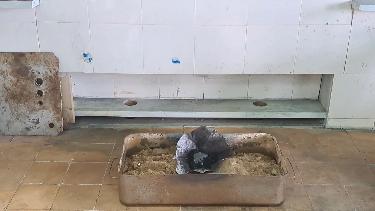

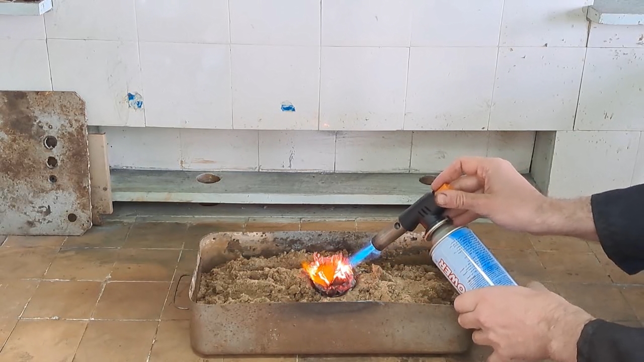

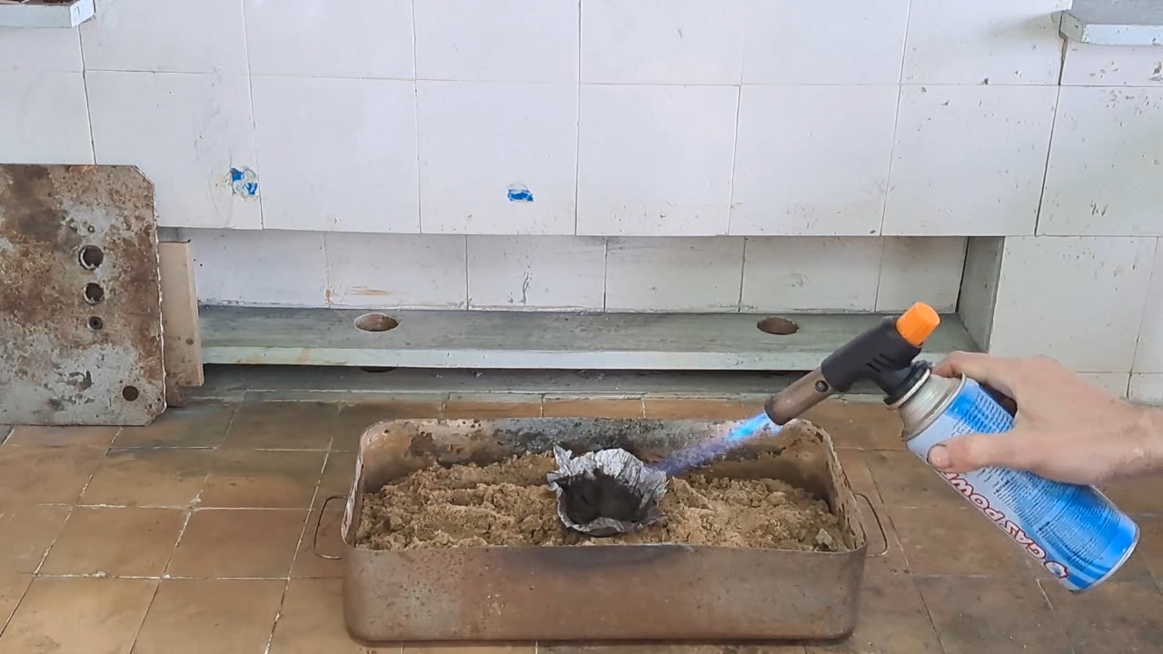

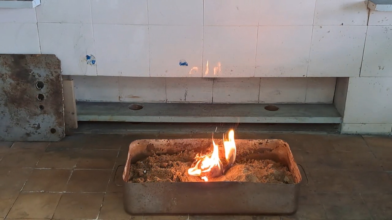

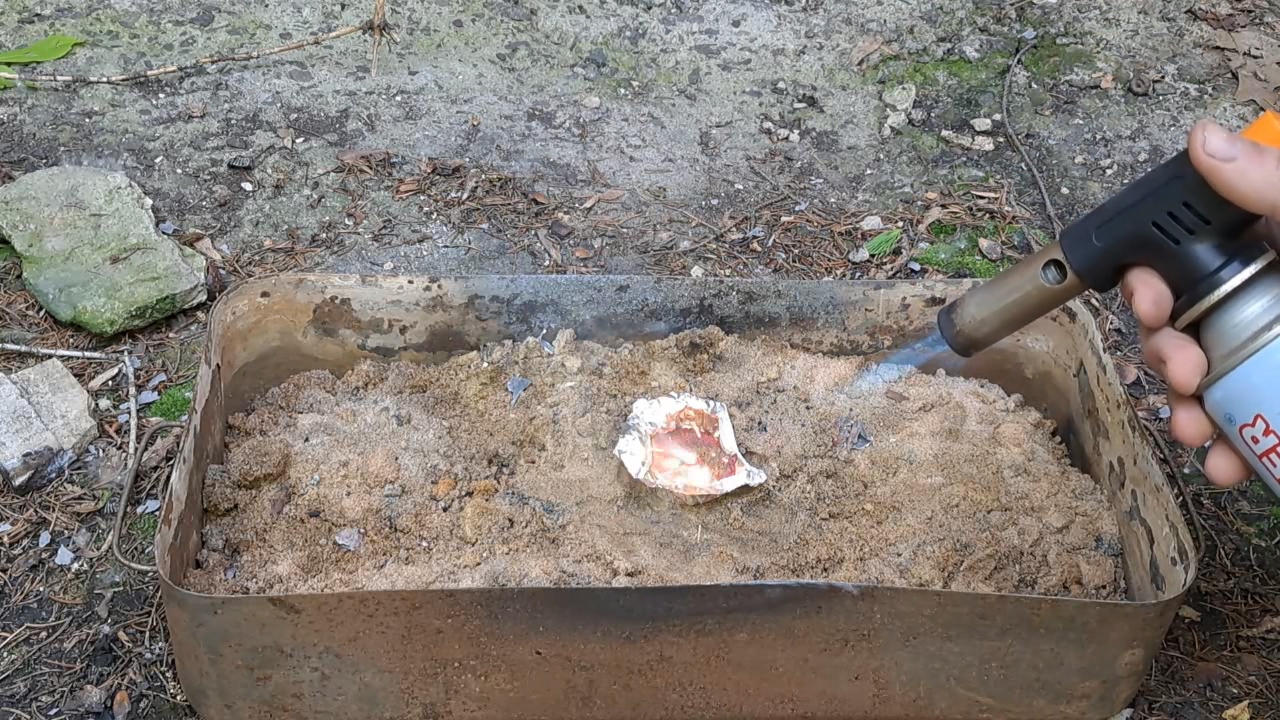

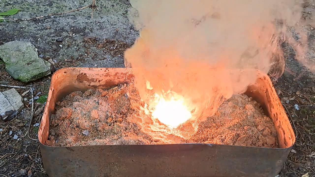

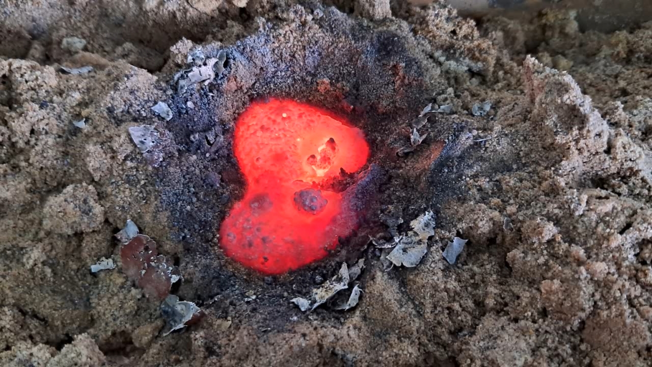

The bag was then placed on a tray with dry sand. I did not add an incendiary mixture, as I was confident the thermite would ignite from a gas burner flame. I directed the burner's strong flame at the thermite. The paper ignited and burned away, the thermite glowed red and then yellow—but it did not ignite. The dark gray surface of the thermite turned brown due to surface oxidation of Fe3O4 to Fe2O3.

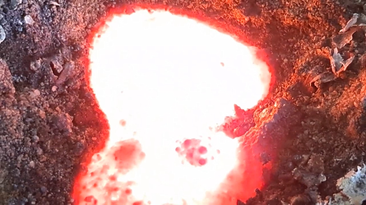

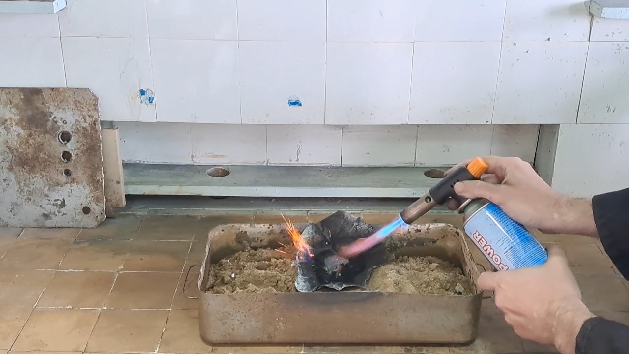

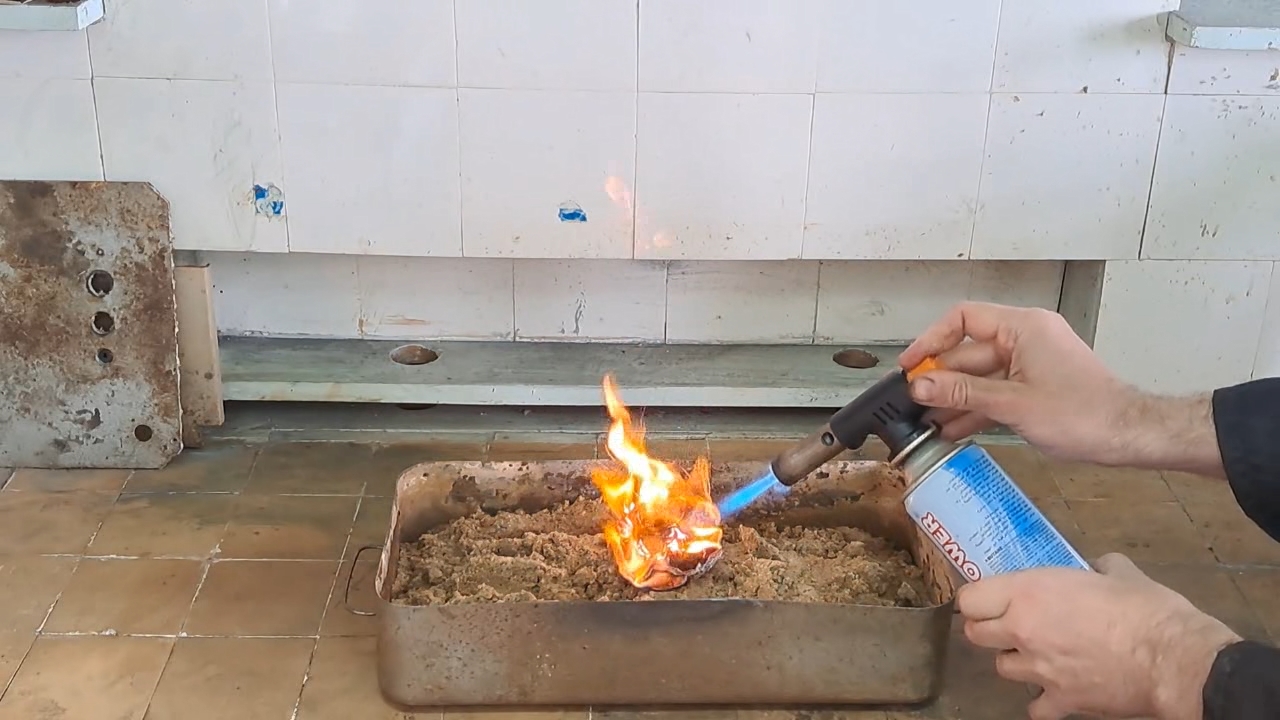

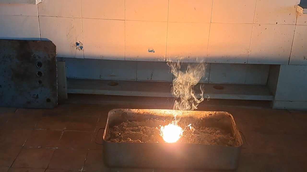

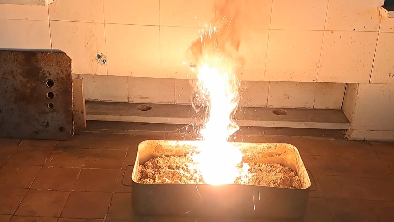

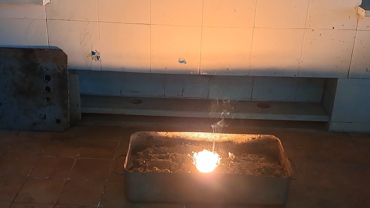

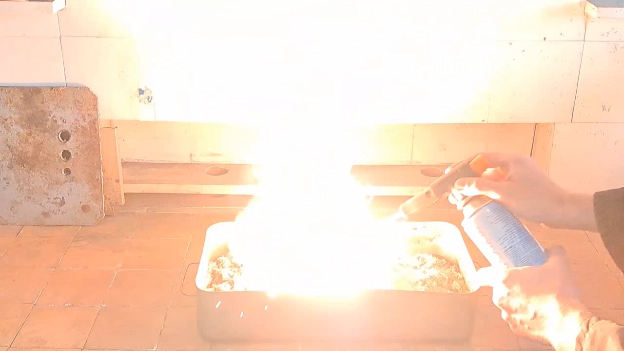

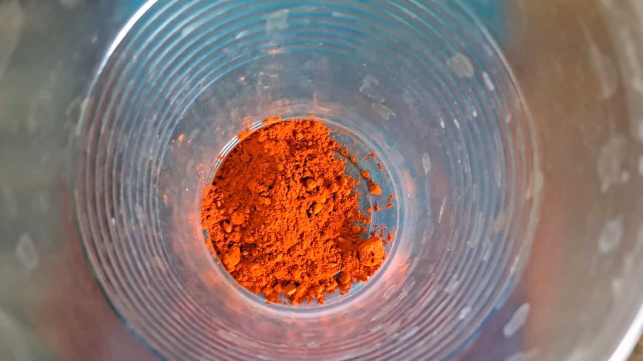

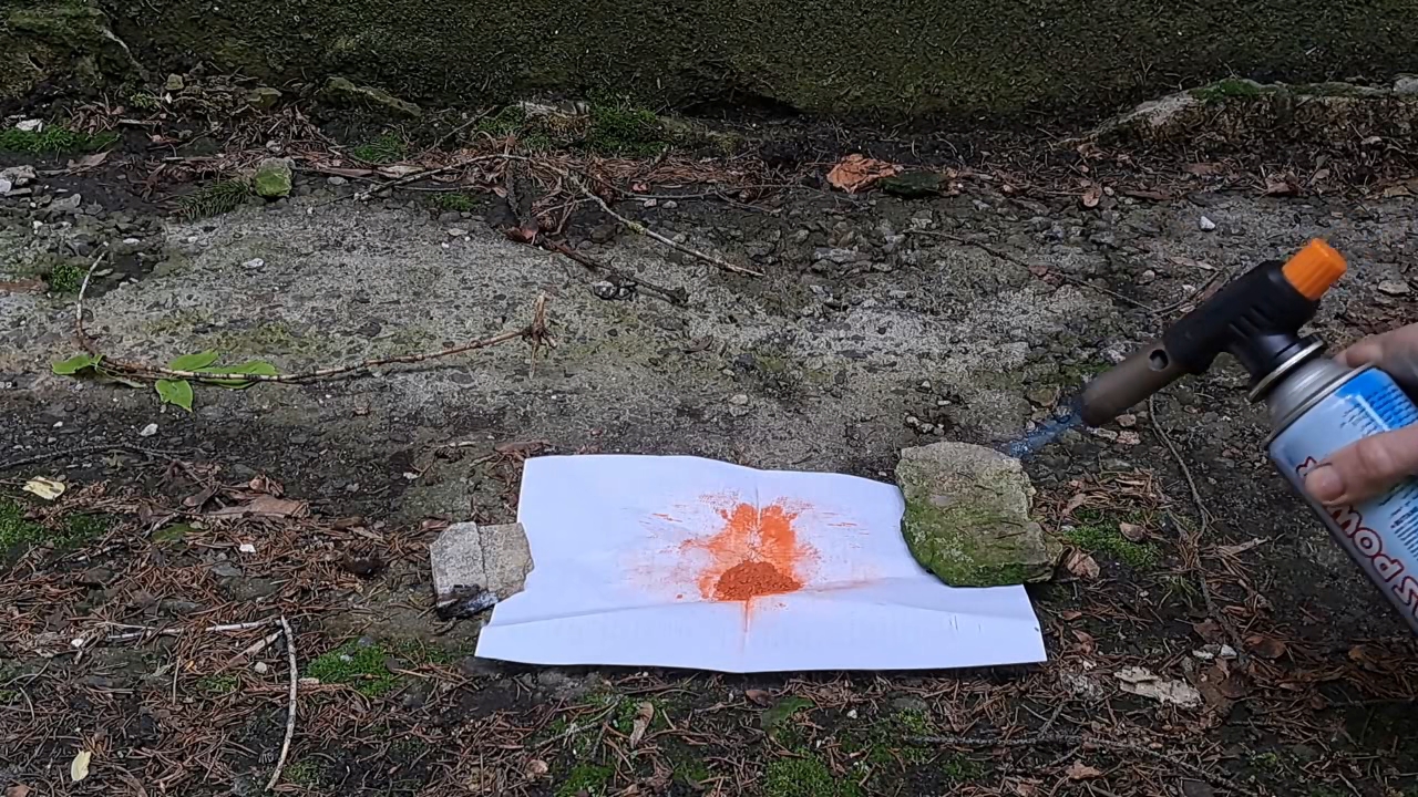

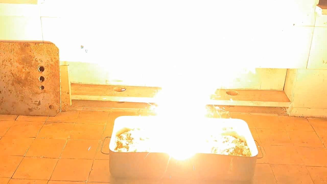

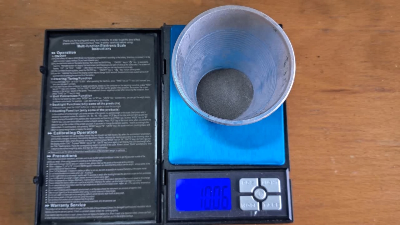

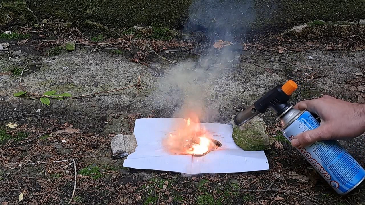

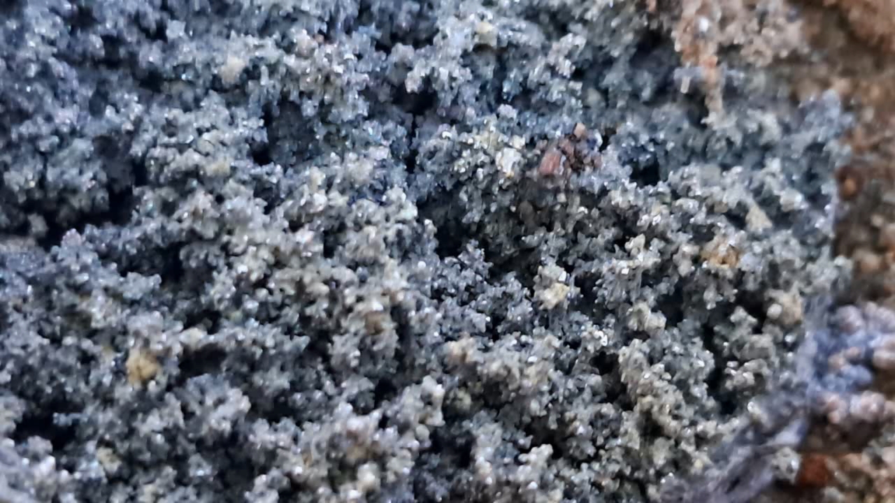

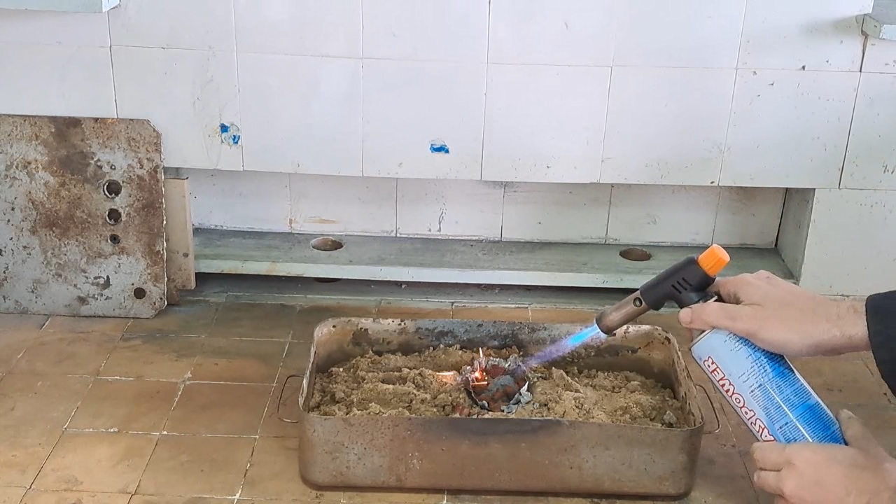

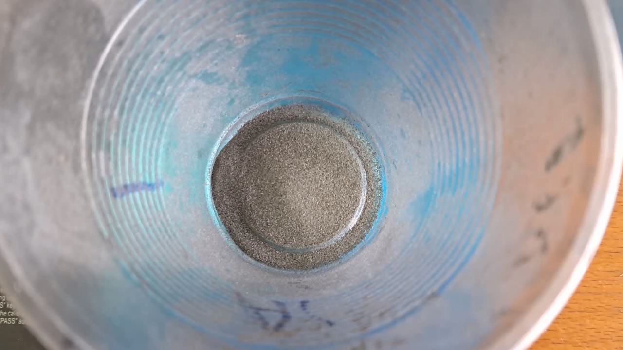

Next, I prepared an incendiary mixture consisting of 1 g of finely dispersed aluminum and 2.75 g of iron oxide (from a previously tested batch). I poured this mixture on top of the thermite and ignited it using the burner flame. A bright flash occurred, sparks flew, and smoke was released. The thermite burned completely in under 10 seconds, leaving behind a glowing yellow "lake" of molten material that gradually cooled on the sand.

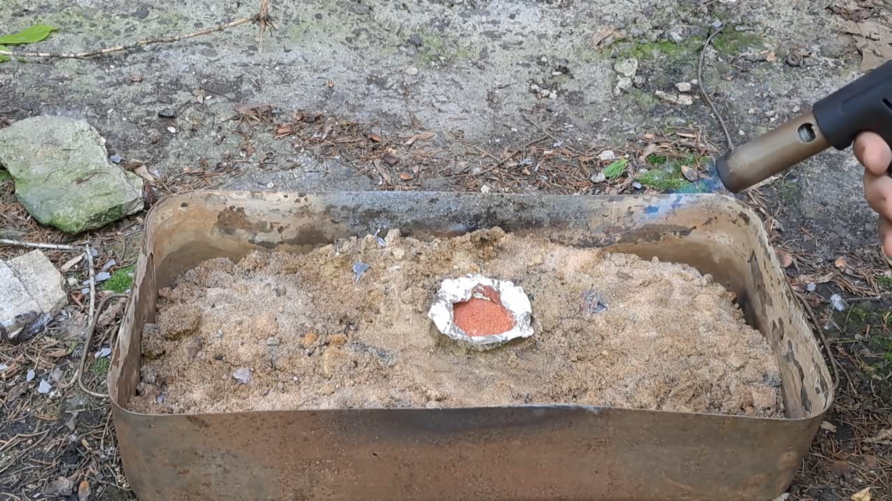

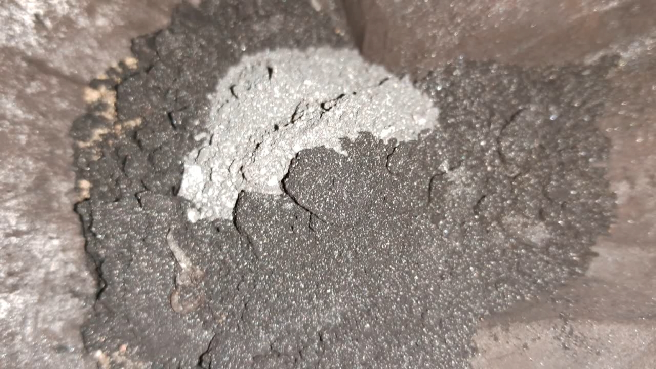

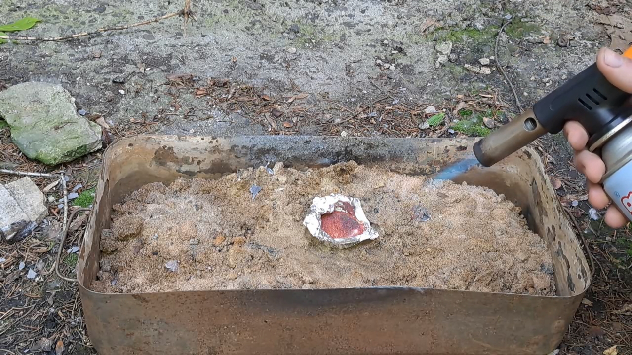

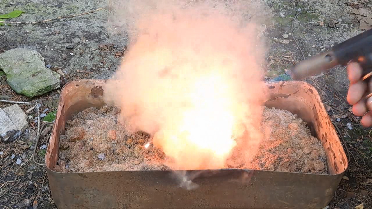

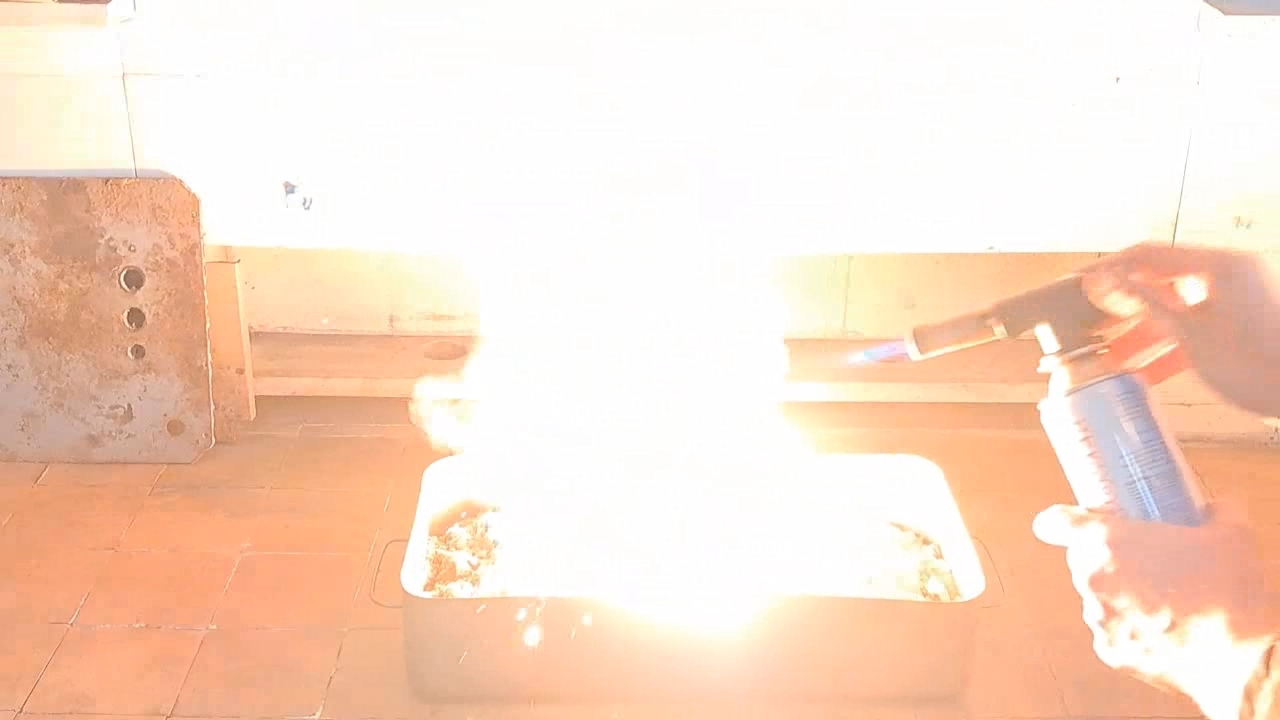

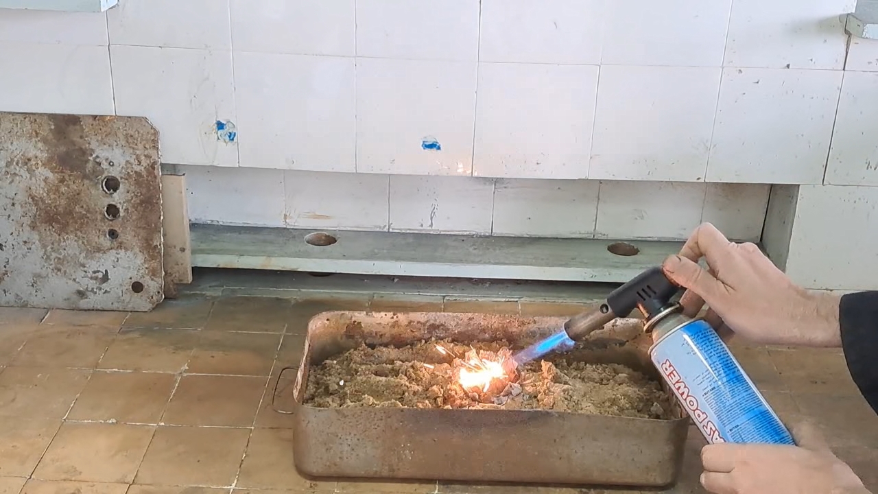

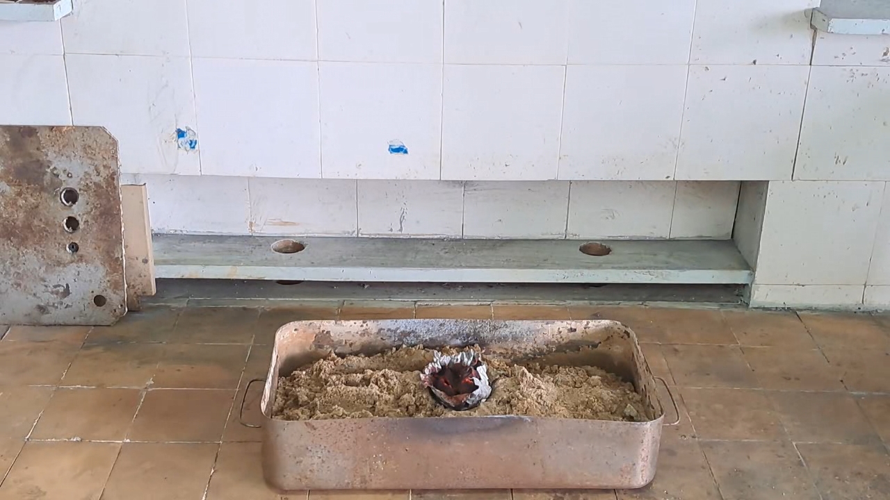

Much later, I realized I had never attempted to ignite Fe3O4/Al thermite (made with 100-140 micron aluminum particles) using just a gas burner flame. I had always used an incendiary mixture of iron oxide and finely dispersed aluminum for ignition.

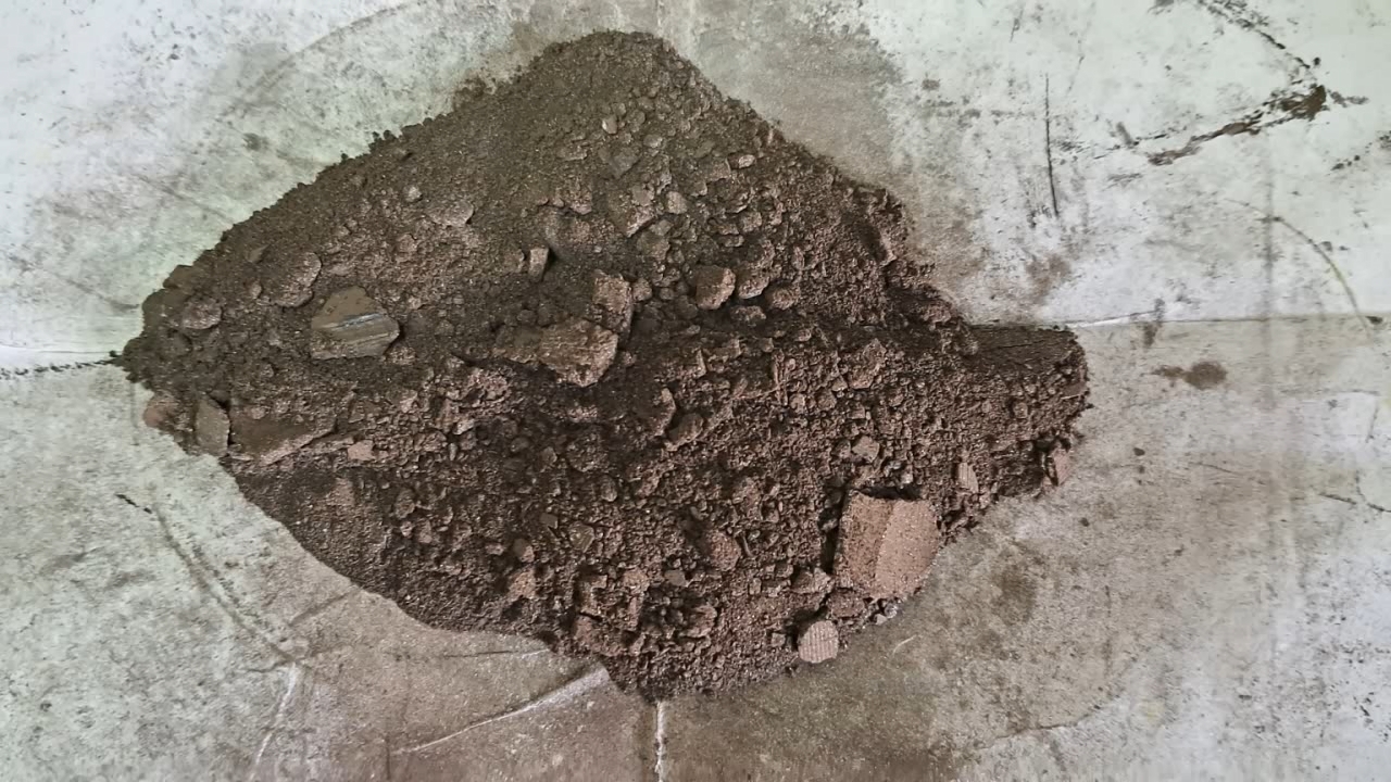

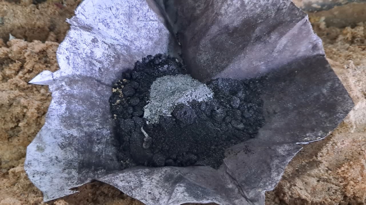

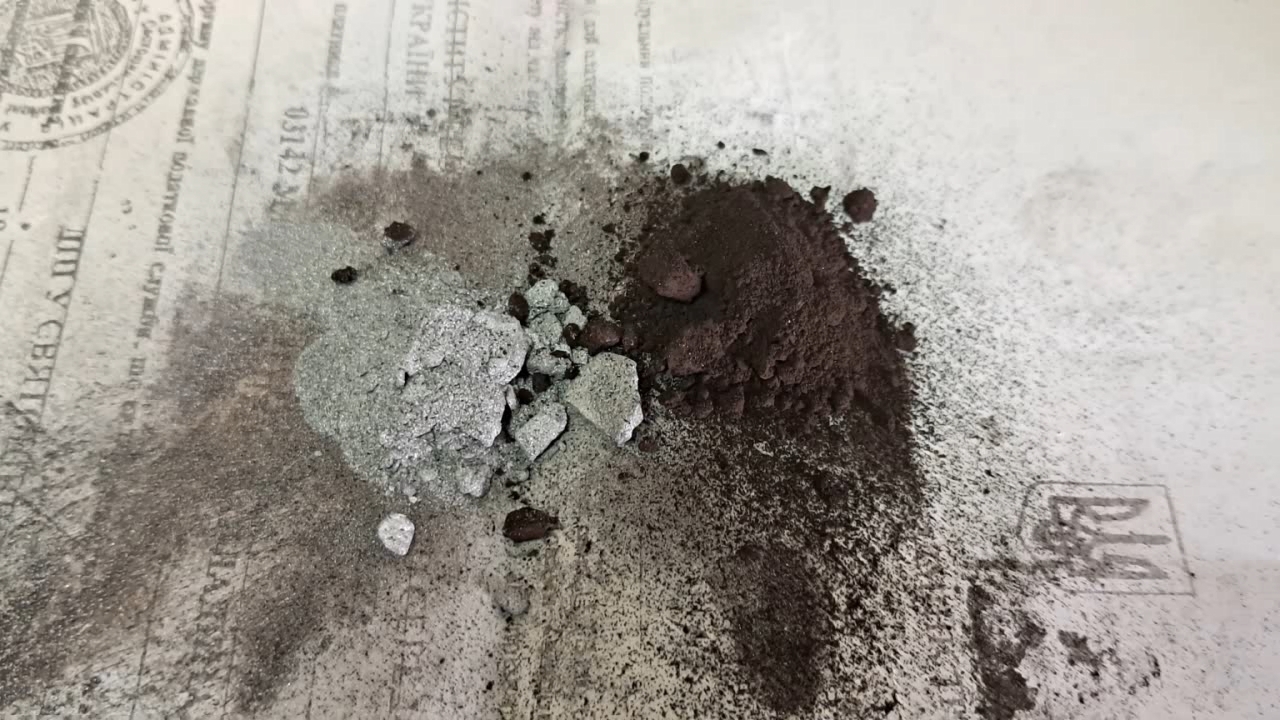

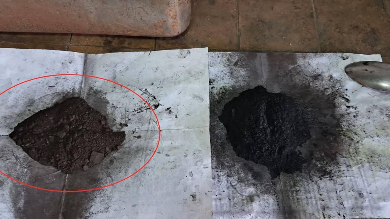

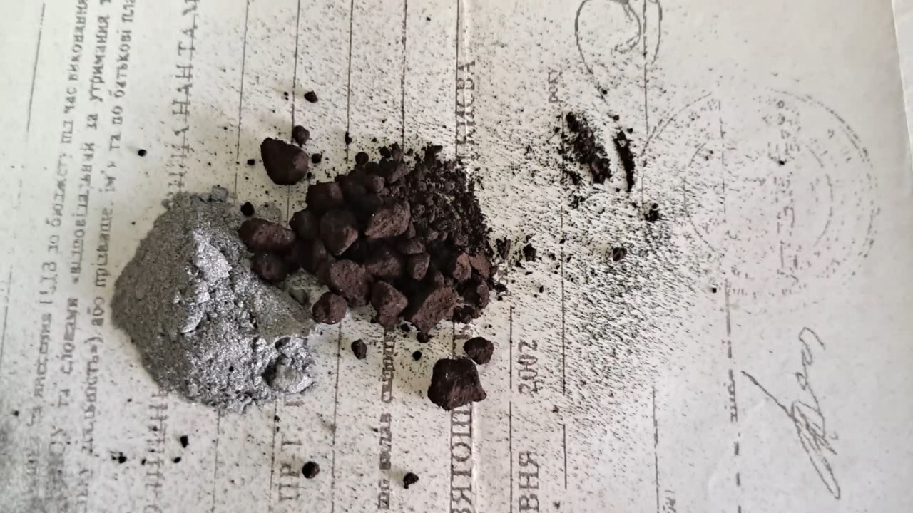

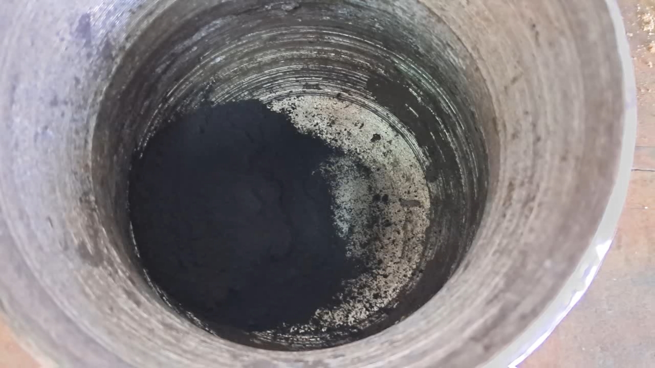

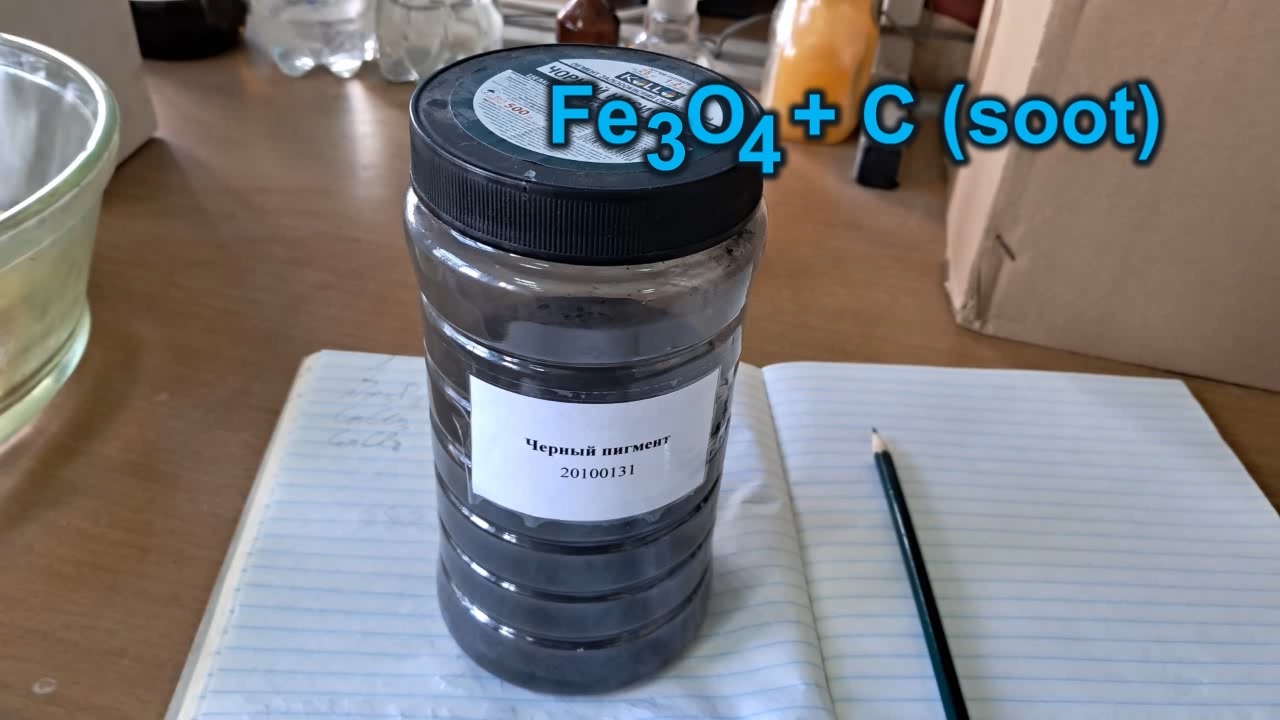

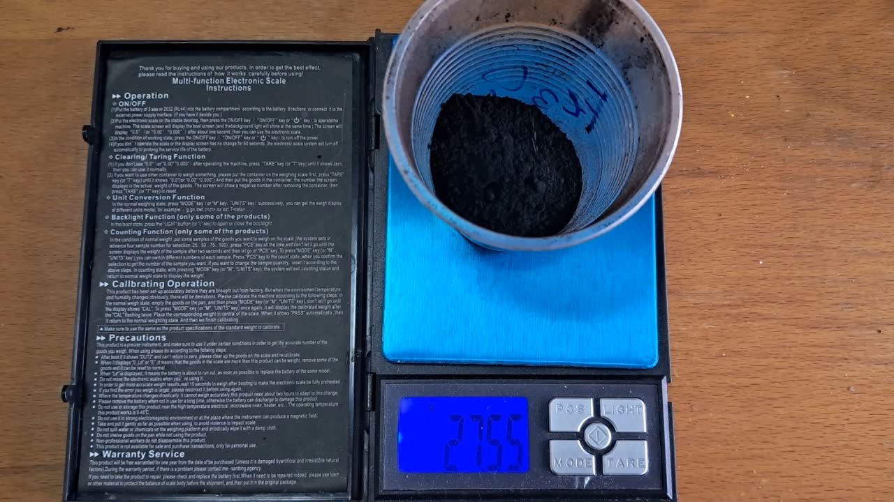

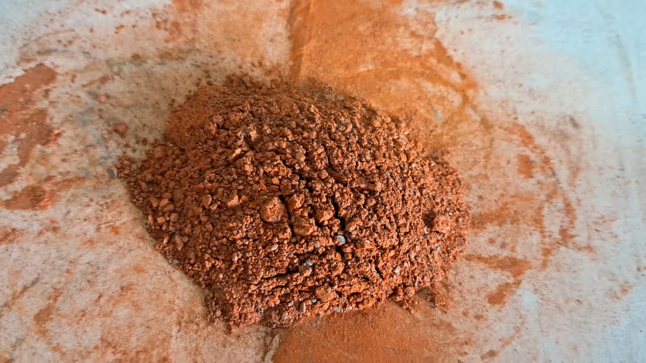

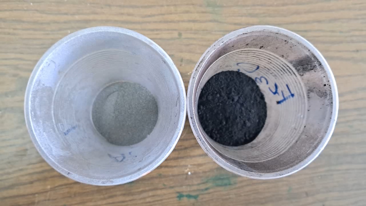

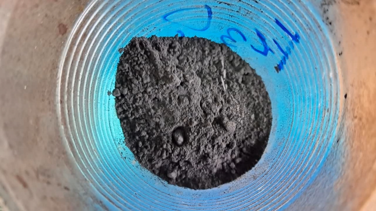

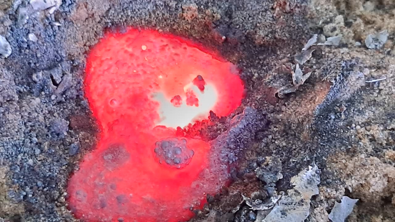

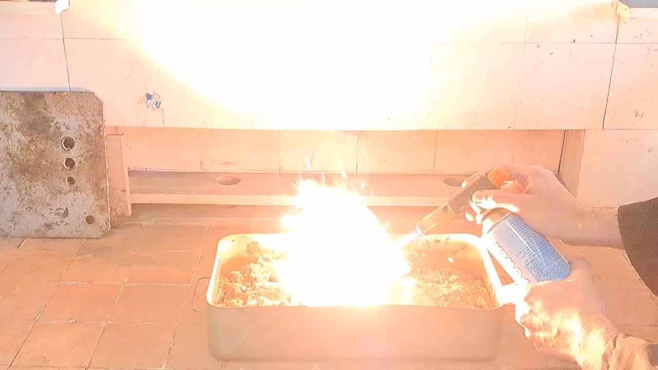

At the same time, I decided to test whether iron oxide containing soot would be suitable for thermite preparation. I had previously attempted to ignite Fe3O4/Al thermite made from soot-containing oxide, but it had failed to ignite—neither with a burner flame nor with incendiary mixtures of two different compositions. Perhaps I would have better luck this time?

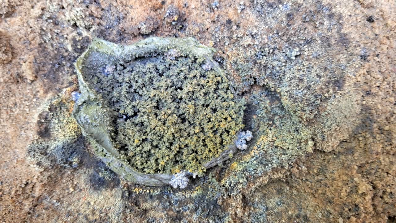

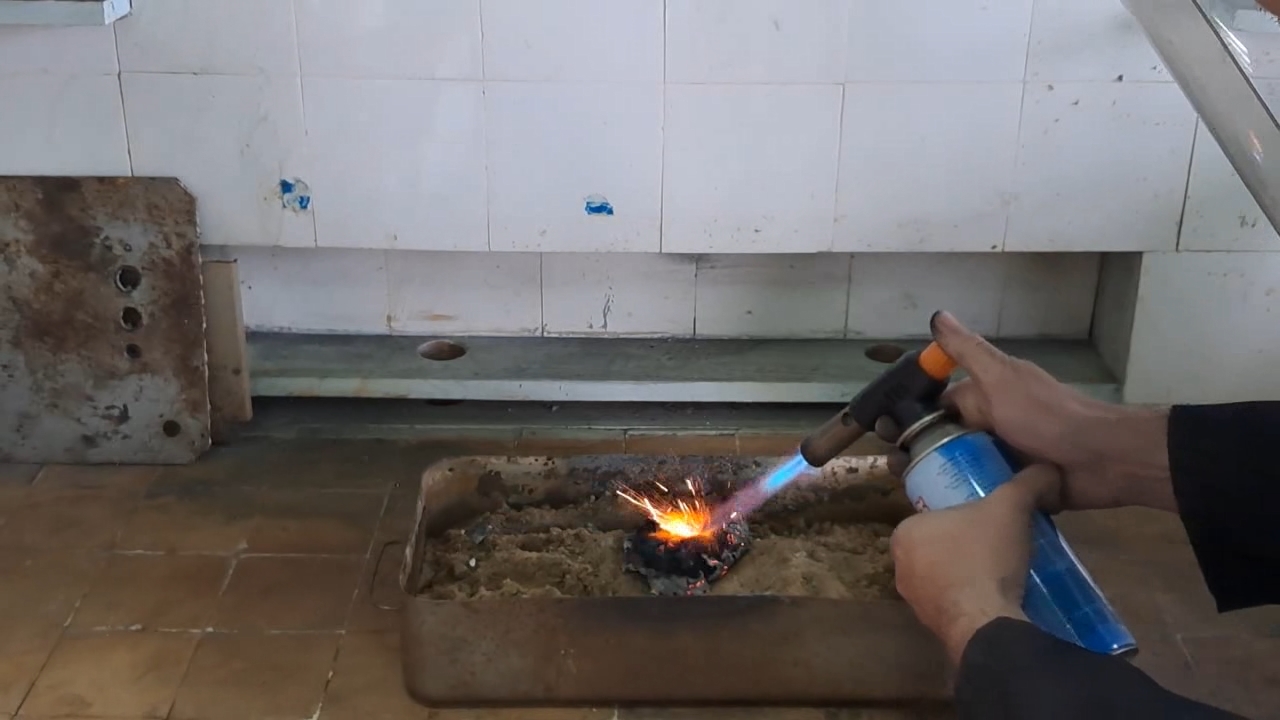

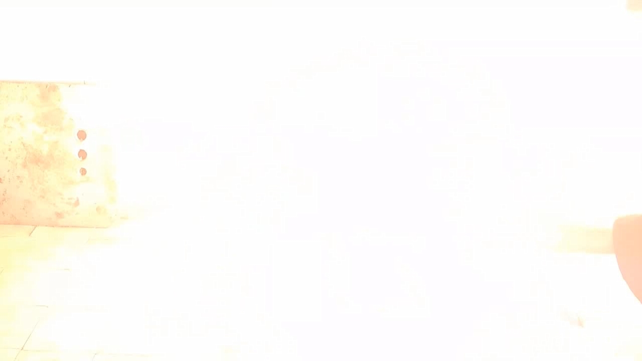

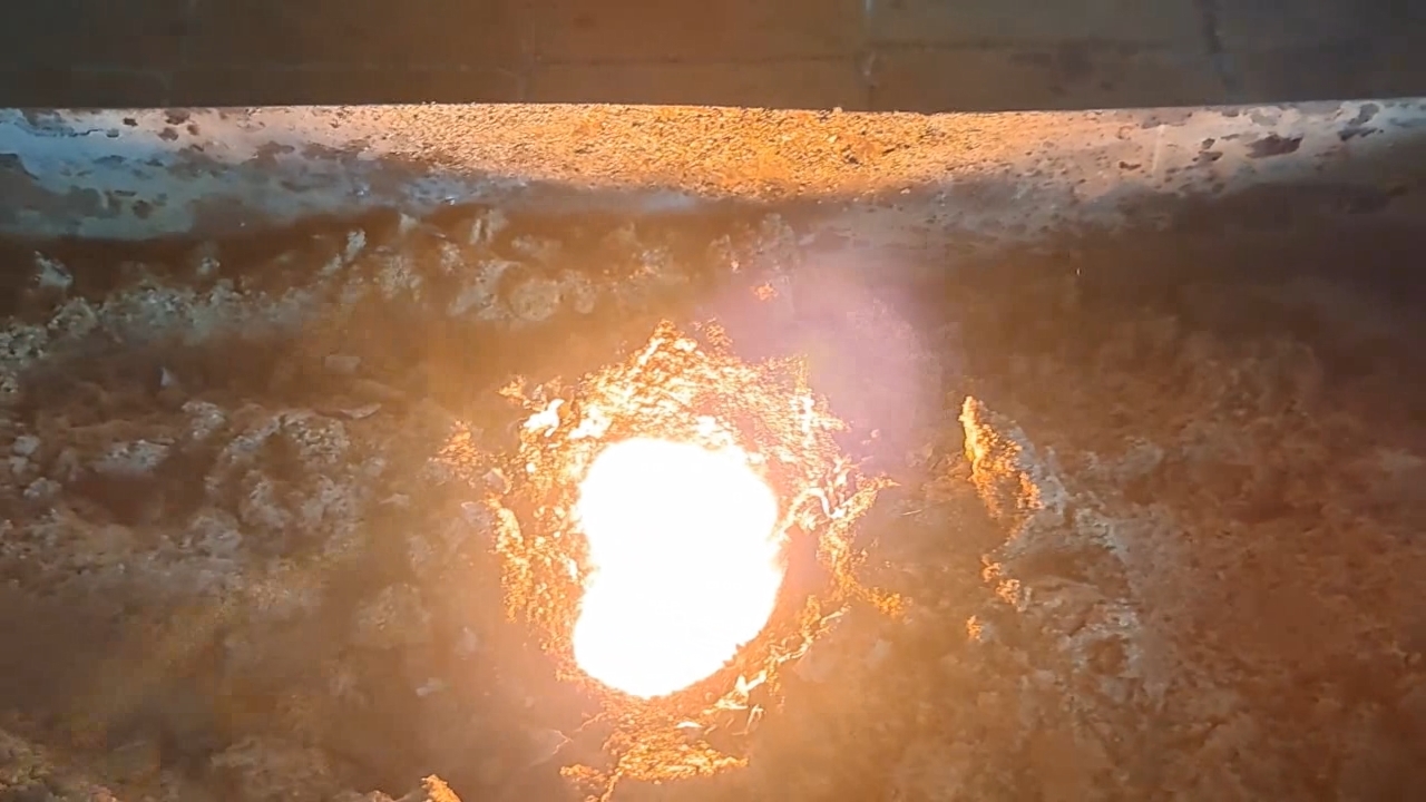

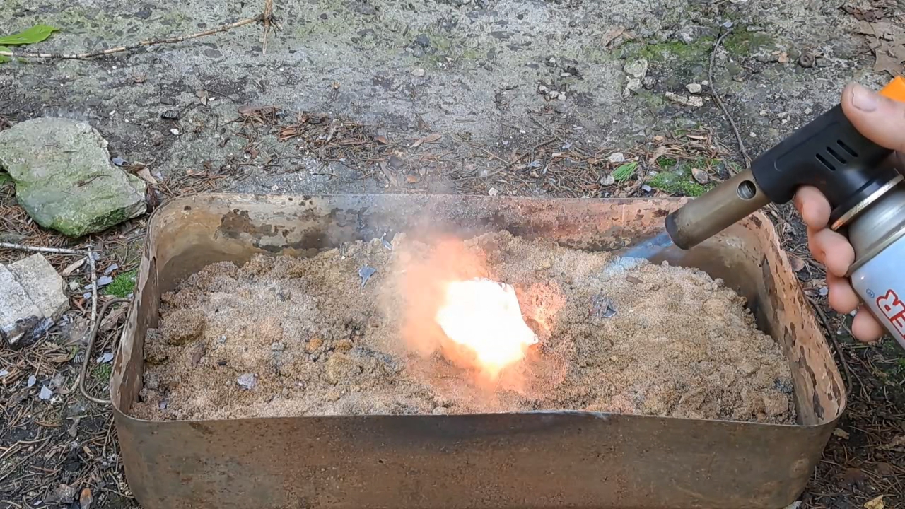

I repeated the procedure described earlier, but this time used Fe3O4 with added soot instead of the technical-grade iron oxide. I didn't even attempt to ignite the thermite directly with the burner. Instead, I placed an incendiary mixture on top and directed the gas burner flame at it. The incendiary mixture flared up, but the thermite did not ignite. After the incendiary mixture burned out, I directed a strong flame at the thermite and continued heating for a long time. As expected, the thermite still did not ignite.
My hypothesis is as follows: soot particles coat the Fe3O4 particles, preventing them from reacting with the metallic aluminum.
In the past, I had successfully ignited a loose mixture of finely dispersed aluminum and soot-containing iron oxide using a burner flame. However, in this experiment, the aluminum particles were larger, and the thermite was compacted. As a result, the thermite made with soot-containing iron oxide failed to ignite.

После серии экспериментов с термитами, содержащими алюминий и оксид железа, я планировал поэкспериментировать с термитными составами, в которых роль окислителя играют оксиды других металлов, а также сульфаты кальция и бария. Однако, коллега неожиданно принес в лабораторию килограммовый пакет с железооксидным пигментом (Fe3O4).
- Я купил его на распродаже! Сейчас в супермаркете на этот товар скидка! Проверь, подходит ли этот оксид железа для термита. Если подходит, я куплю еще - в продаже осталось три пакета!
- Спасибо, конечно, но не надо больше покупать. У нас - не лаборатория исследования термитов. Следовательно, такое количество оксида железа не понадобится.
Поскольку коллега уже купил оксид железа, я решил приготовить небольшое количество термита из этого оксида, чтобы проверить, пригоден ли он для термита. Взвесил и тщательно смешал 10 г алюминия (размер частиц 100-140 микрон) и 27.5 г оксида. Смесь поместил в пакет из листа бумаги и сильно сжал в ладони.
Пакет поместил в лоток с сухим песком. Зажигательную смесь не добавлял, поскольку был уверен, что термит загорится от пламени газовой горелки. Направил сильное пламя горелки на термит. Бумага загорелась и сгорела, термит раскалился до красного, потом до желтого свечения. Однако, термит не загорелся. Темно-серая поверхность термита стала коричневой, поскольку оксид железа (II, III) Fe3O4 окислился на поверхности до коричневого оксида железа (III) Fe2O3
Приготовил зажигательную смесь из 1 г мелкодисперсного алюминия и 2.75 г оксида железа (оксид был из проверенной партии). Насыпал зажигательную смесь сверху термита. Направил на смесь пламя горелки. Произошла яркая вспышка, образовались искры, выделился дым. Термит сгорел менее чем за 10 секунд. На песке осталось "озеро" расплава, которое светилось желтым и постепенно остывало.
Значительно позже я вспомнил, что никогда не пытался зажечь газовой горелкой термит Fe3O4/Al, приготовленный из частиц металлического алюминия размером 100-140 микрон. Для этой цели я всегда использовал зажигательную смесь оксида железа с мелкодисперсным алюминием.
Параллельно я решил испытать, пригоден ли для приготовления термита оксид железа с добавкой сажи. Ранее я уже приготовил термит Fe3O4/Al из такого оксида железа. Термит не удалось зажечь, ни пламенем газовой горелки, ни зажигательными смесями двух разных составов. Возможно, мне удастся в этот раз?
Повторил процедуру, описанную выше, только вместо технического оксида железа Fe3O4 использовал оксид Fe3O4 с добавкой сажи. Поджечь термит непосредственно газовой горелкой я даже не пытался. Вместо этого поместил на термит зажигательную смесь и направил на нее пламя газовой горелки. Зажигательная смесь вспыхнула, однако, термит не загорелся. После сгорания зажигательной смеси направил сильное пламя горелки на термит, нагревал продолжительное время. Разумеется, термит не загорелся.
Моя гипотеза следующая. Частицы сажи обволакивают частицы оксида железа Fe3O4, препятствуя его реакции с металлическим алюминием.
Ранее мне удалось зажечь пламенем горелки разрыхленную смесь мелкодисперсного алюминия и оксида железа, содержащего сажу. Однако, в текущем эксперименте термит содержал более крупные частицы алюминия и был уплотнен. В результате термит, приготовленный из содержащего сажу оксида железа, инициировать не удалось.

The thermite failed to ignite
The incendiary mixture was added

The thermite made with soot-containing iron oxide failed to ignite (only the incendiary mixture flared)
