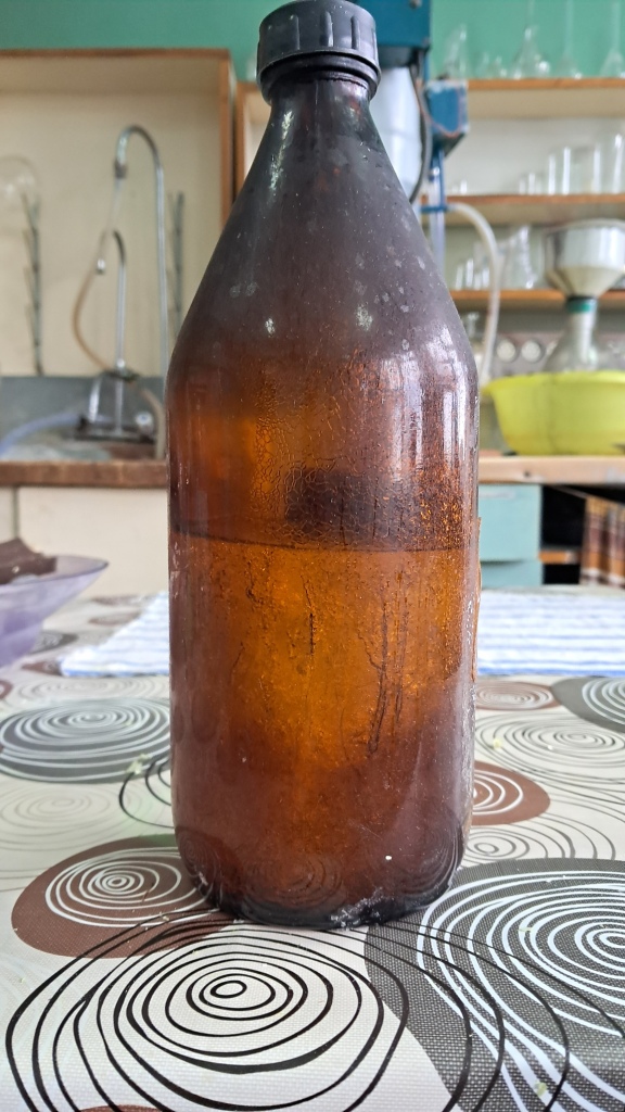

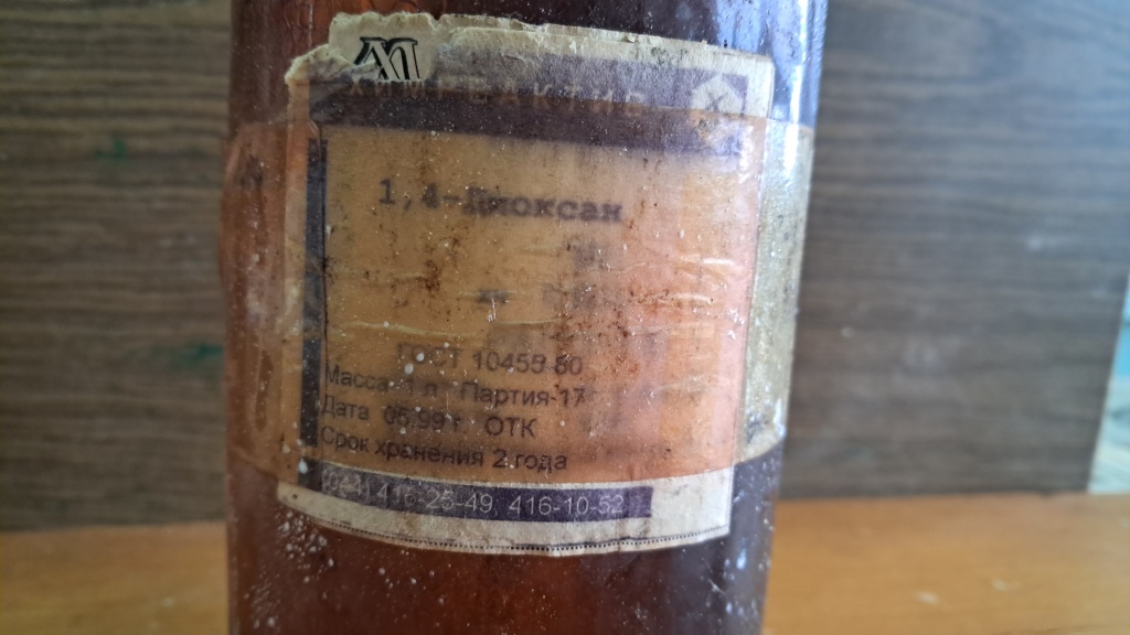

![]() 1,4-Dioxane |

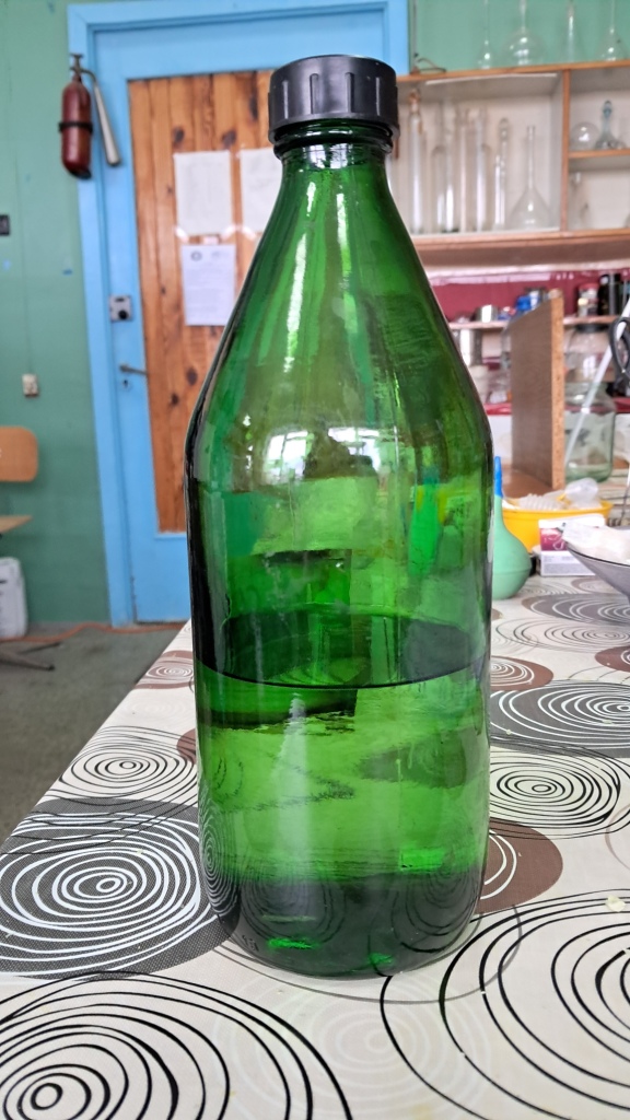

![]() The Bottle Containing Acetic Acid |
