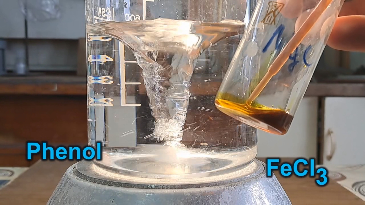

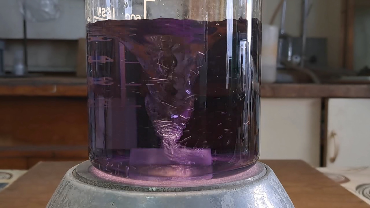

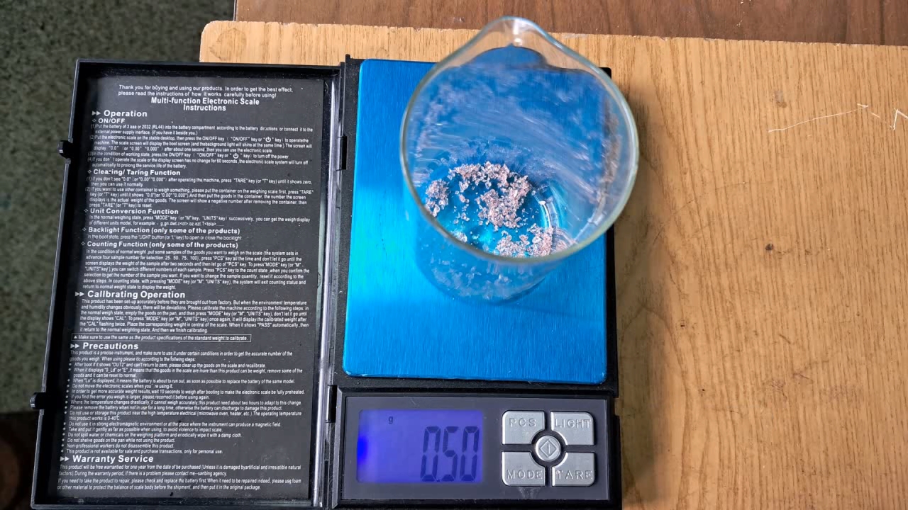

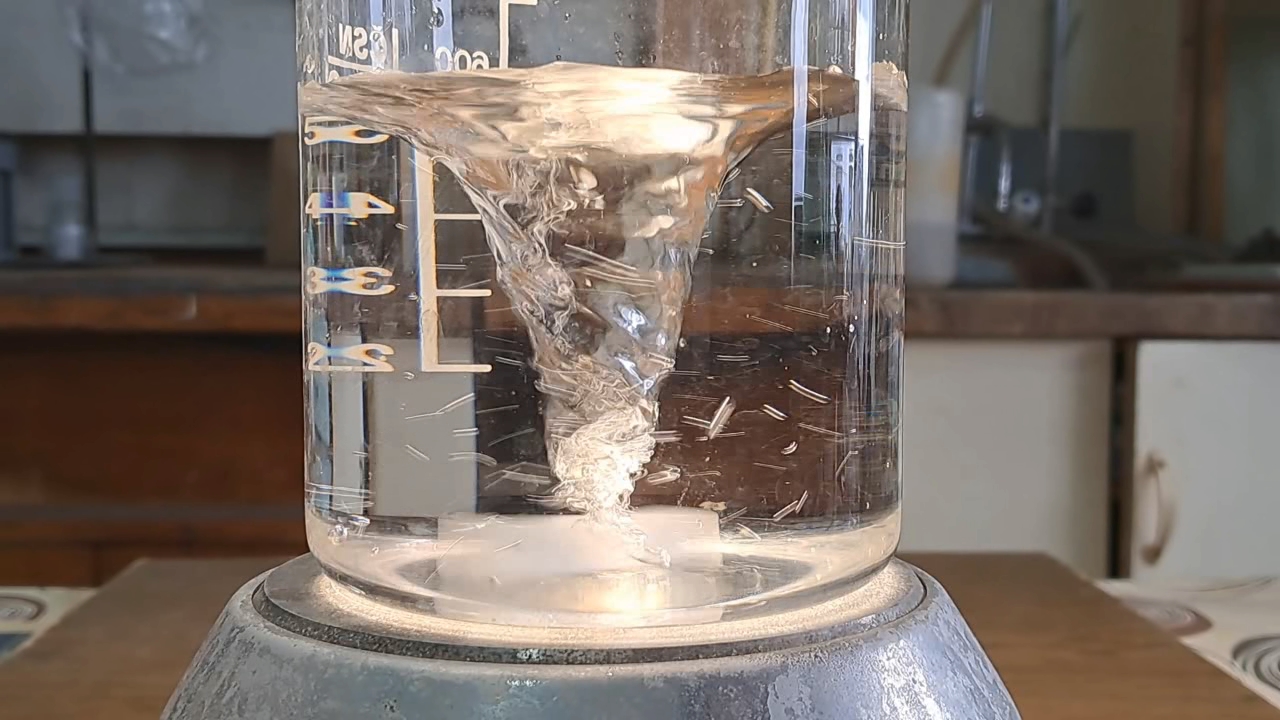

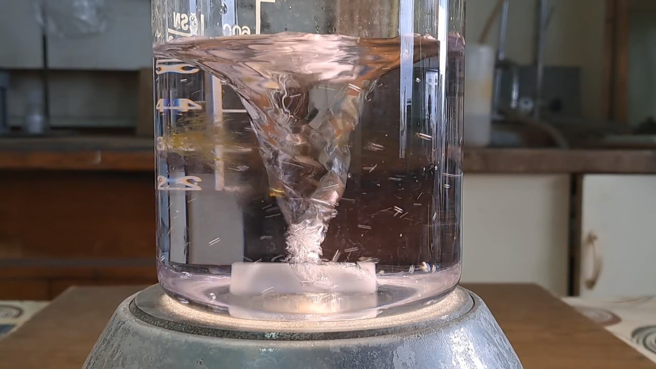

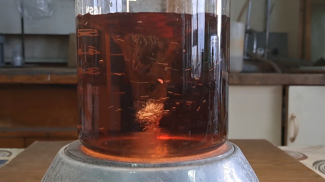

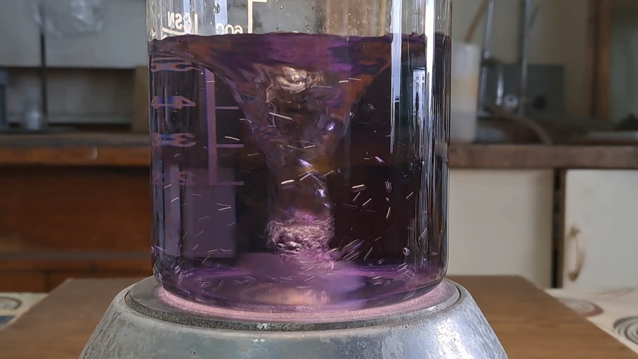

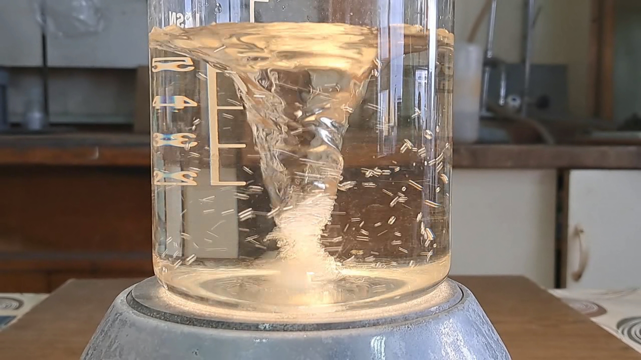

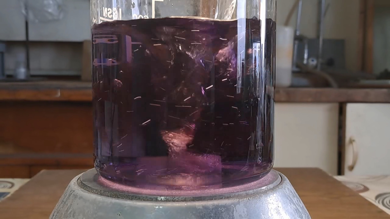

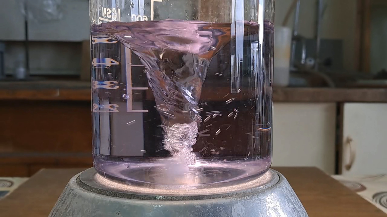

I weighed 0.5 g of phenol and dissolved it in 500 mL of distilled water. I placed the beaker on a magnetic stirrer and turned on vigorous stirring. Then I began adding a nearly saturated solution of iron(III) chloride drop by drop. The very first drop produced a violet color that gradually intensified. When the solution turned dark violet, I stopped adding iron(III). The color of the solution remained stable over time.

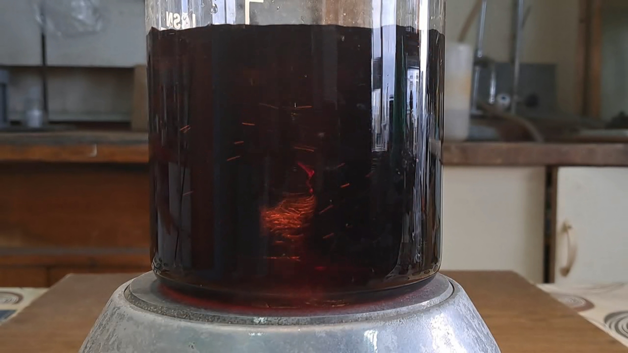

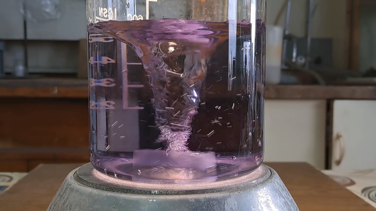

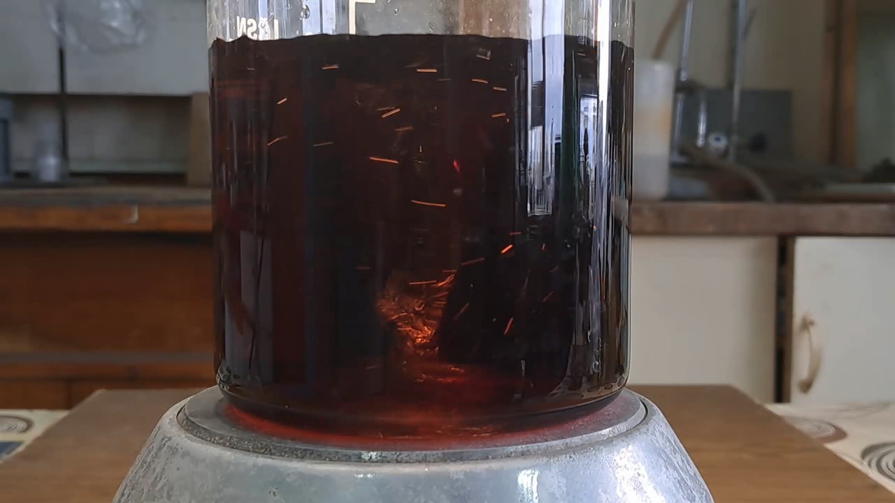

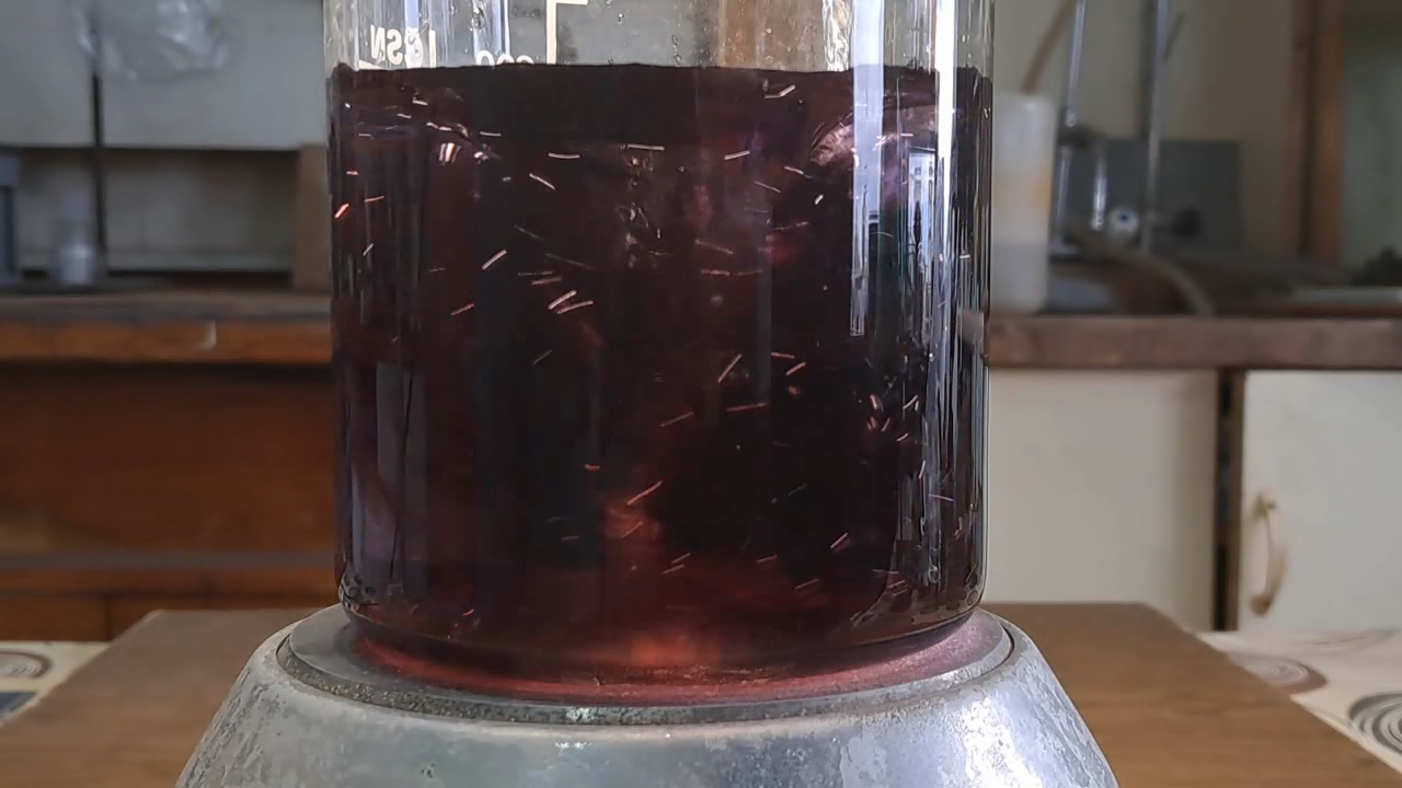

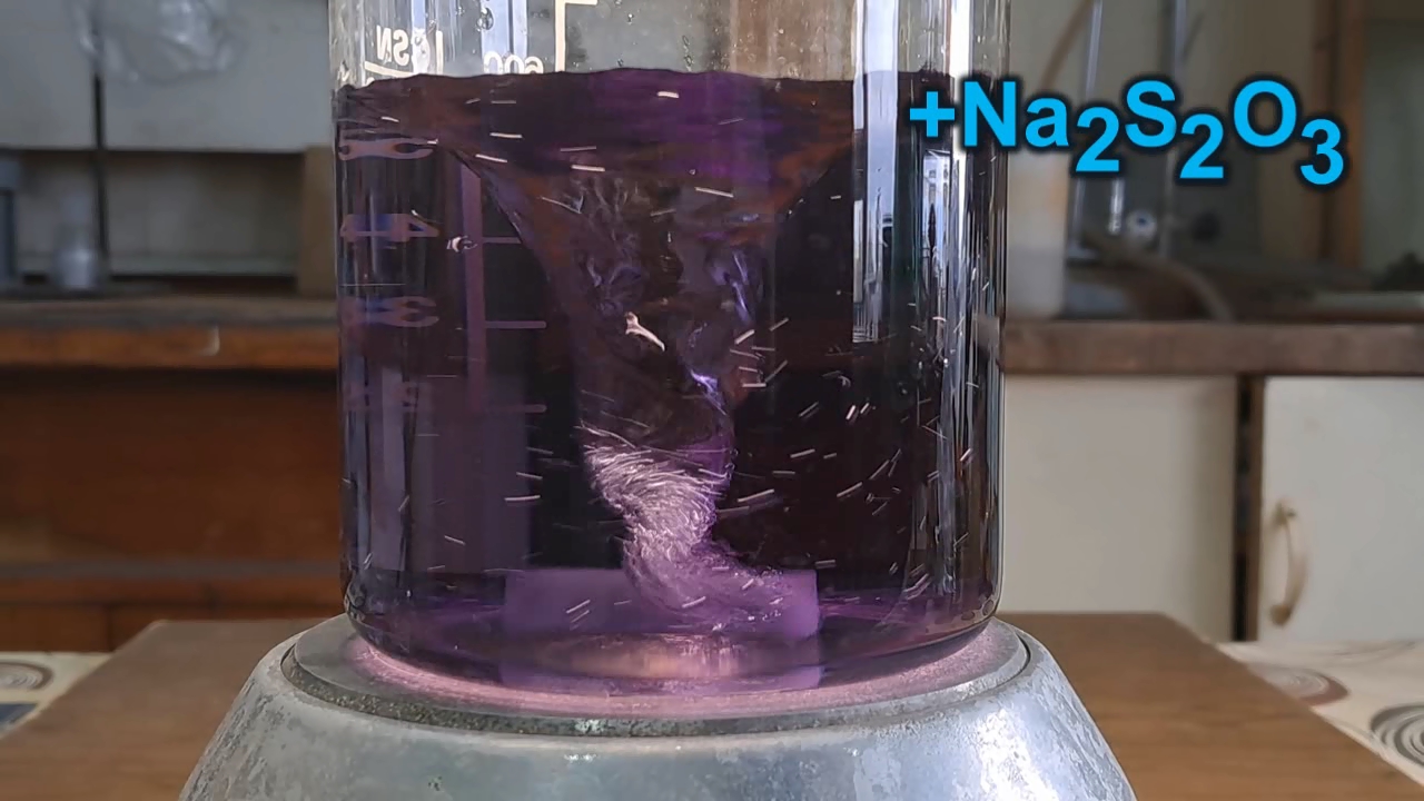

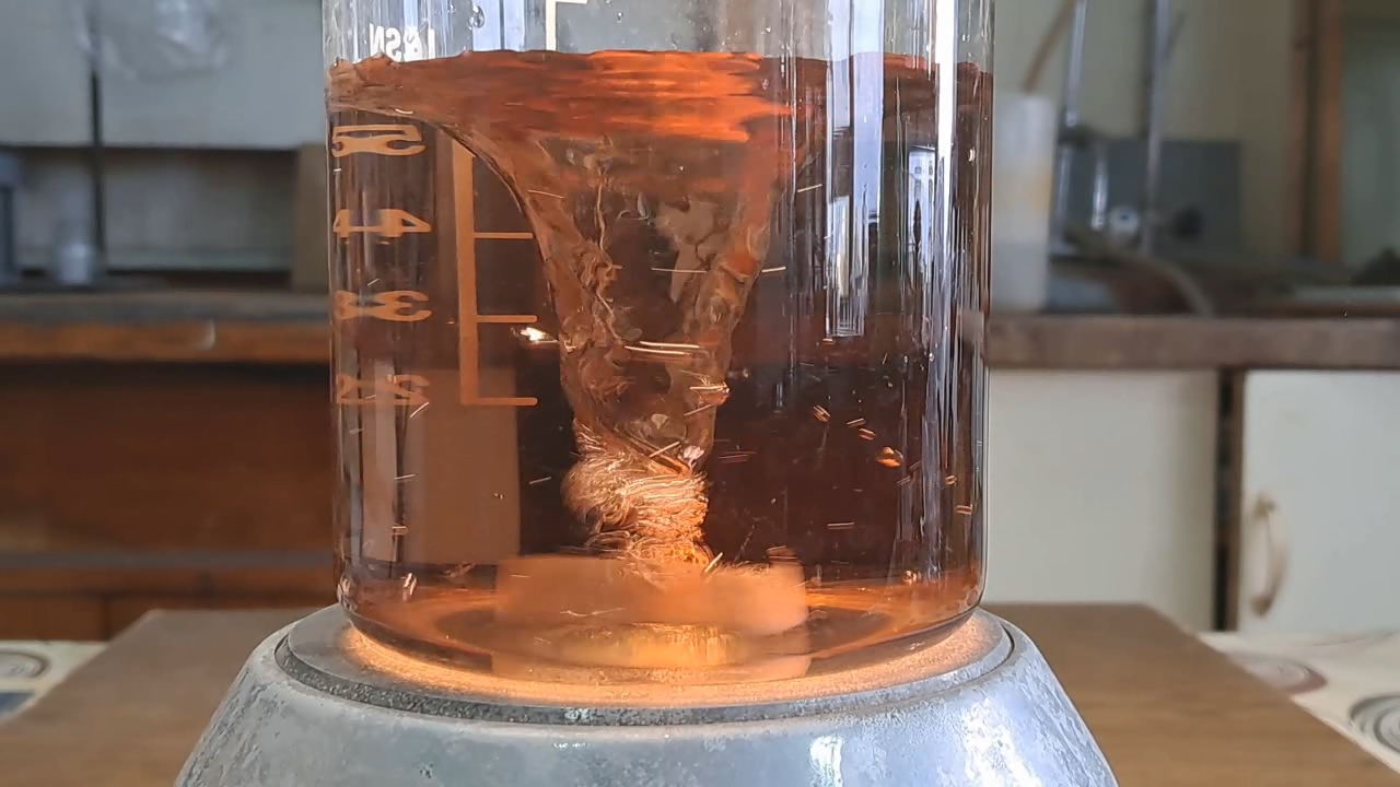

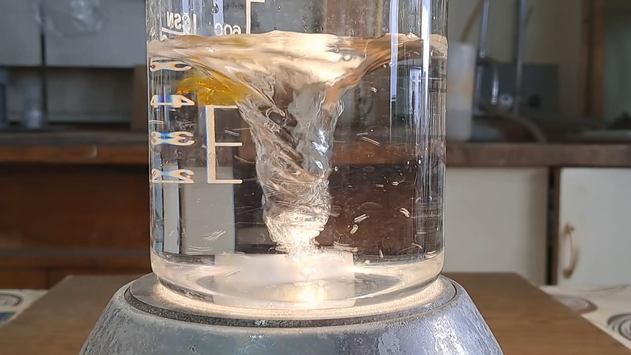

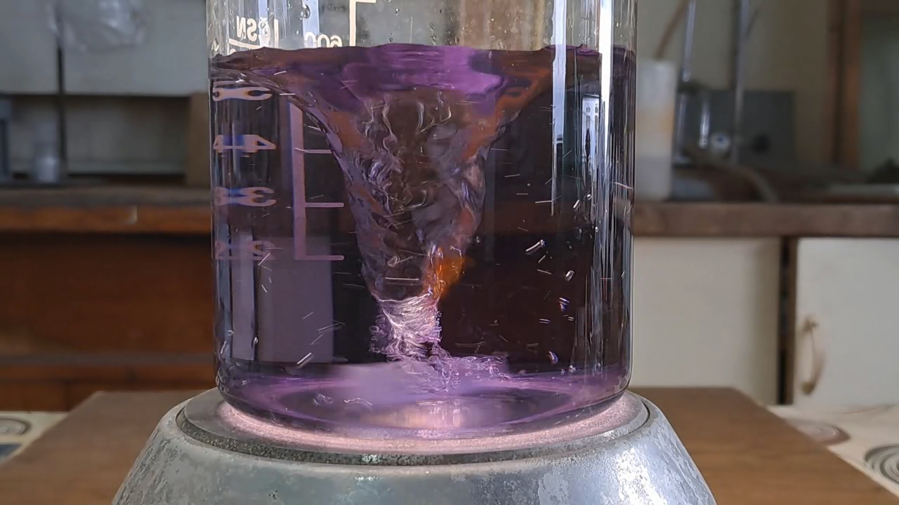

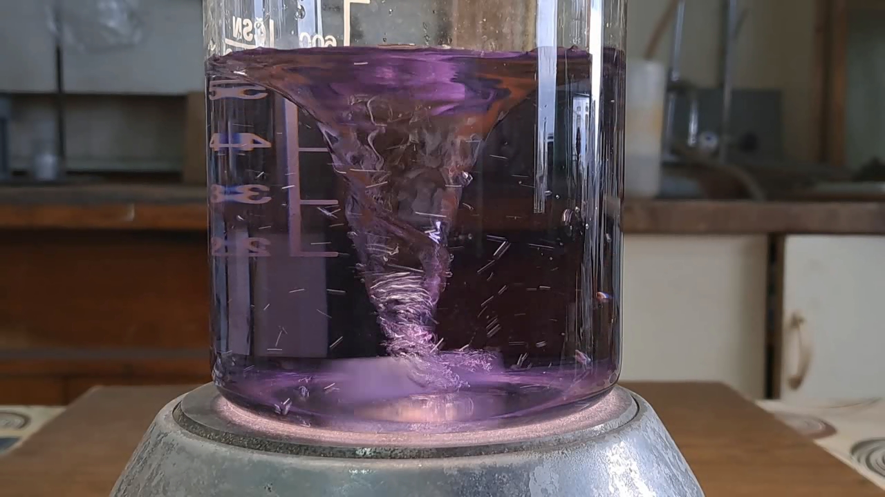

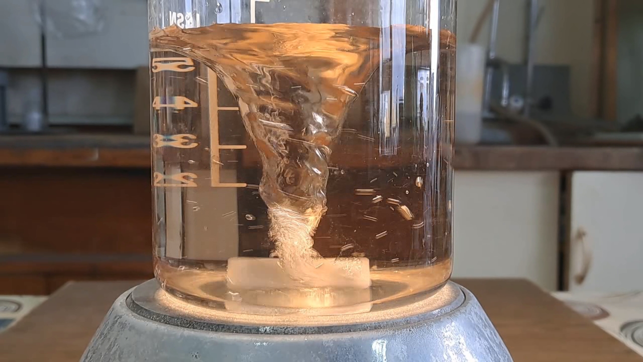

Next, I added an excess of saturated sodium thiosulfate solution to the beaker. The solution turned dark purple due to the formation of a complex of Fe(III) with thiosulfate. The reaction mixture then slowly began to fade as the complex decomposed. After a few minutes, the solution became light yellow.
In the absence of phenol, the decolorization of the iron-thiosulfate complex took tens of seconds, but with the addition of copper(II) sulfate, the colored complex decomposed in just a few seconds [1]. In the presence of phenol, however, the disappearance of the purple iron(III)-thiosulfate complex color was significantly slower. Thus, phenol has a stabilizing effect on the complex.

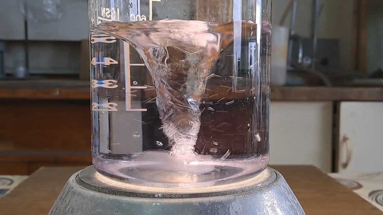

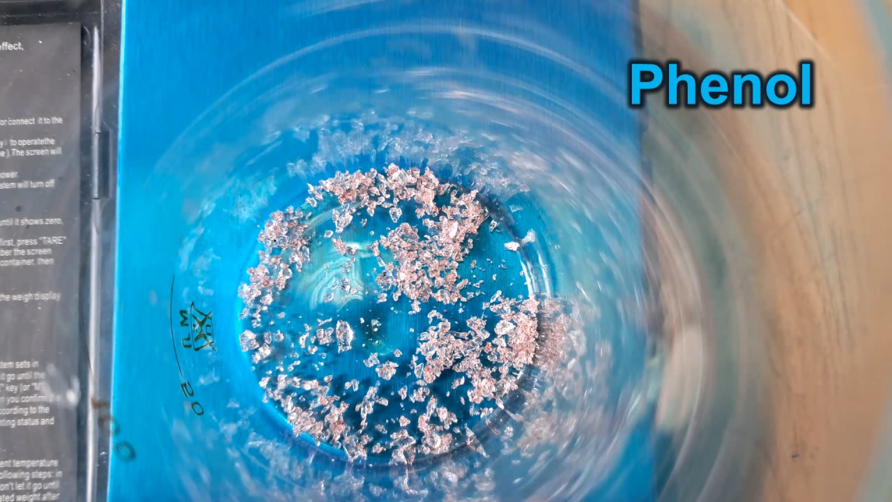

After the solution turned pale, I added solid phenol to the reaction mixture. The violet color of the iron-phenol complex did not reappear.
