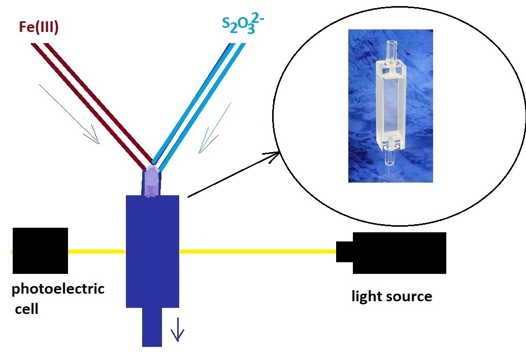

How can one determine the composition of an unstable complex? In much the same way as for a stable one. For a stable complex, one mixes a solution of the metal salt M with a solution of the ligand L in a volumetric flask, then adds solvent to the specified volume. The solution is poured into a spectrophotometer cuvette. A typical cuvette is a small rectangular cell made of optical quartz glass. The cuvette is placed in the photometer, and the optical density of the solution is measured.
For unstable complexes, however, mixing the reagents and measuring the optical density must be done in a flowing liquid. For example, in determining the composition of the Fe3+-thiosulfate complex, reagent solutions of specified concentrations were first prepared. The solutions of iron salt and thiosulfate were then fed through two parallel tubes at a controlled flow rate that ensured the desired ratio of substances. The tubes were connected in a Y-shape (or a T-shape), so that the two streams mixed and then passed into a flow cell. In the cell, iron(III) and thiosulfate formed a complex, and the solution then exited the cell through another tube.
Spectrophotometry
It was found that the maximum optical density occurs at the ratio:
1Fe3+ : 1S2O32-.
Therefore, the composition of the complex is [Fe(S2O3)]+:
Fe3+(aq) + S2O32-(aq) => [Fe(S2O3)(H2O)2]+(aq)
This complex is unstable because thiosulfate reduces iron(III) to iron(II), producing tetrathionate ions (S4O62-). This reaction leads to the decomposition of the complex.
