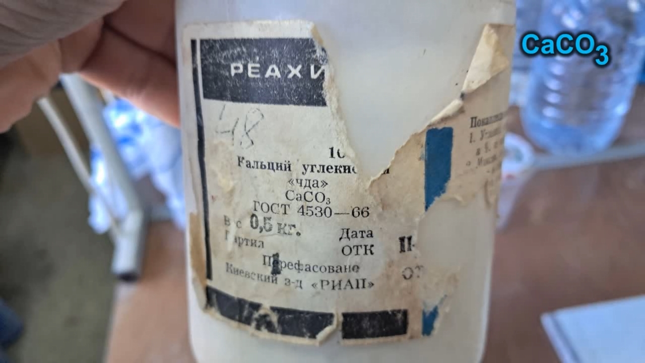

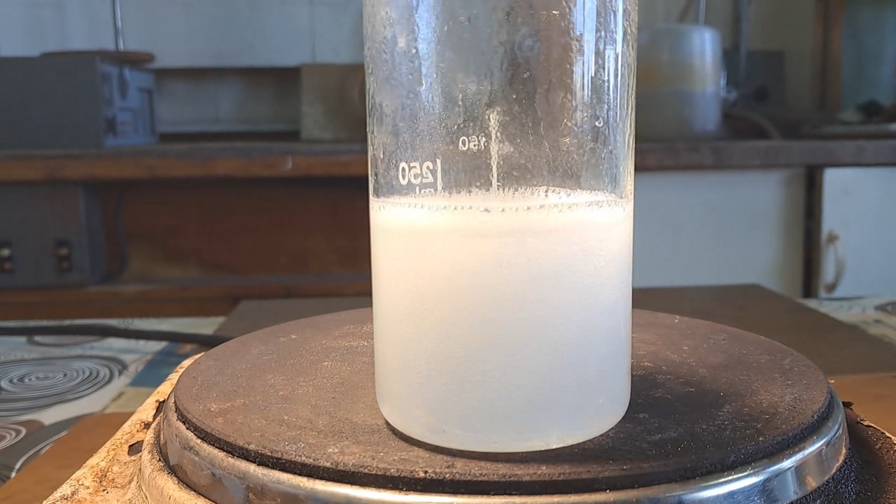

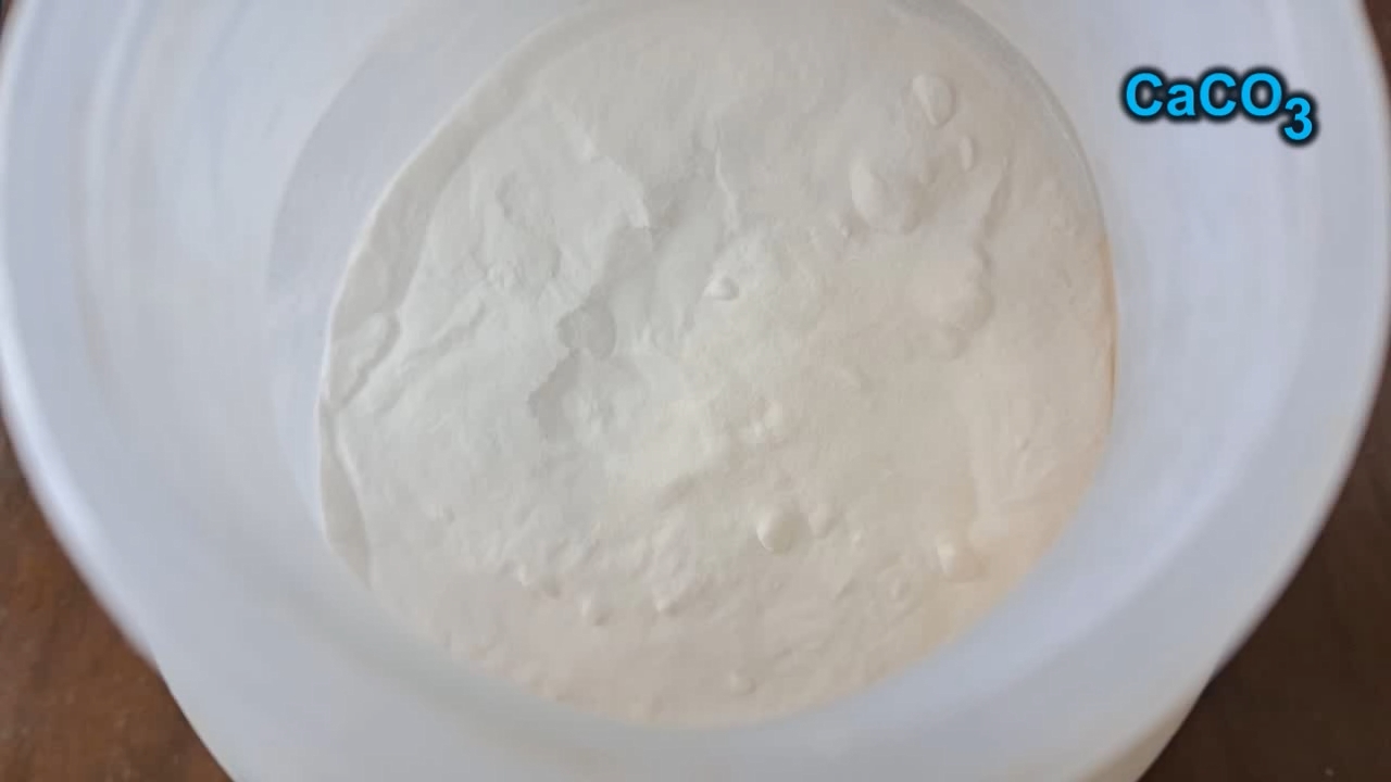

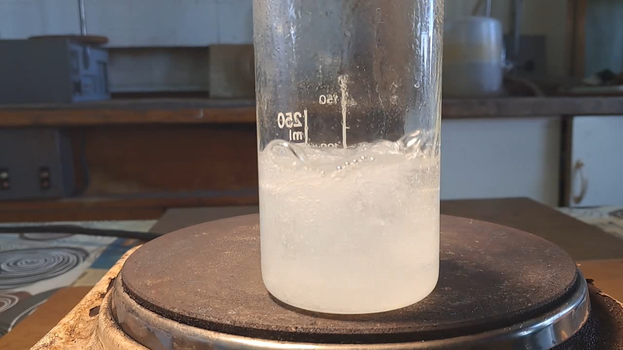

To obtain a more demonstrative result, I decided to study the reaction between a disodium EDTA solution and calcium carbonate powder of analytical grade.

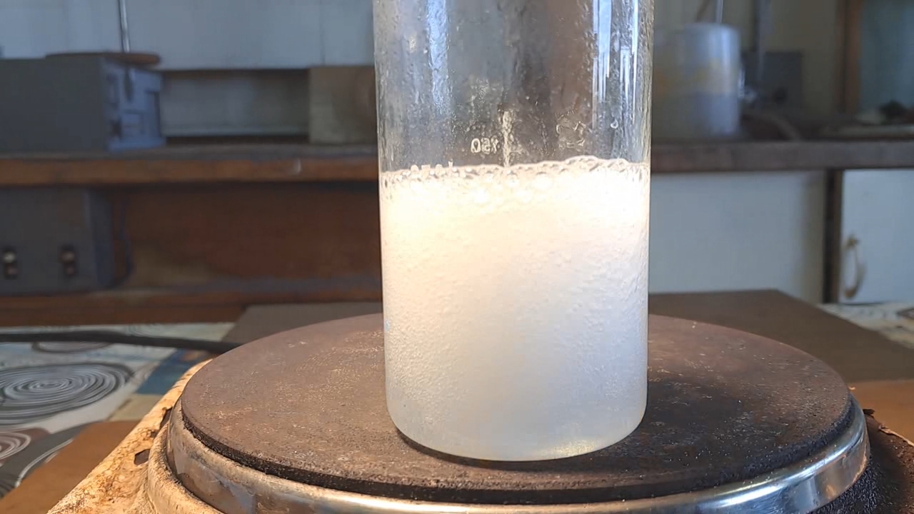

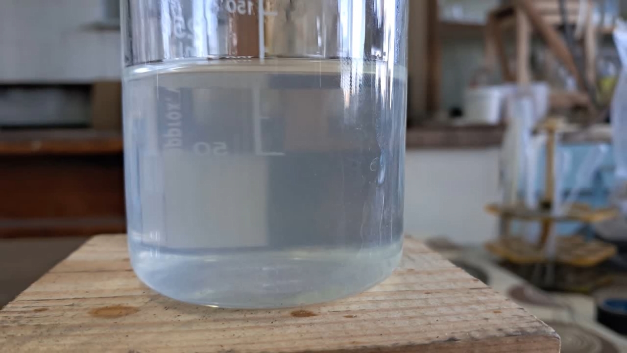

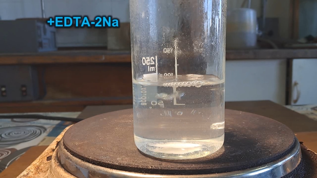

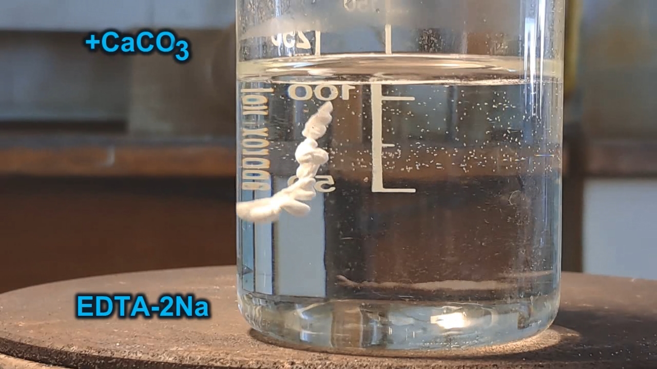

I weighed 2 g of EDTA-2Na, added it to a beaker containing 100 ml of water, and heated it on a hot plate until it dissolved. Then I added 0.2 g of calcium carbonate. The calcium carbonate powder formed clumps that had to be broken up with a glass rod. A suspension formed, and carbon dioxide bubbles began to appear. The release of carbon dioxide indicated a reaction between EDTA-2Na and calcium carbonate, accompanied by the dissolution of the latter. As the solution was heated, bubbles of water vapor also appeared.

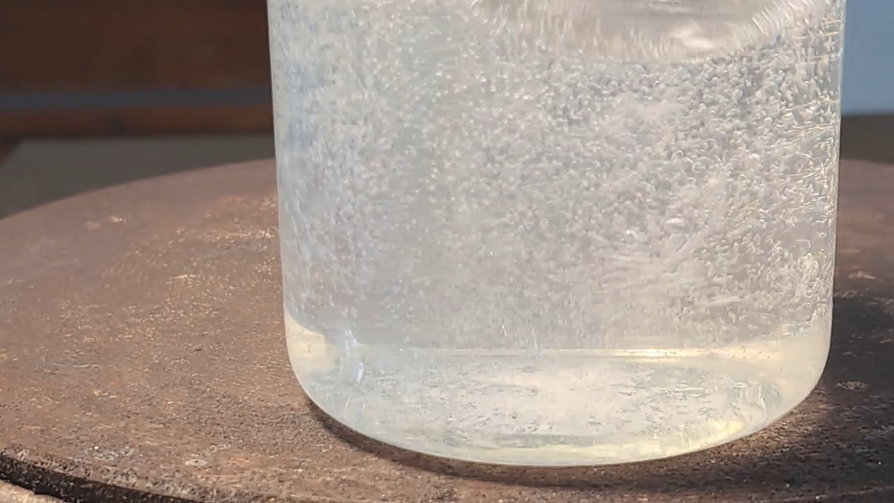

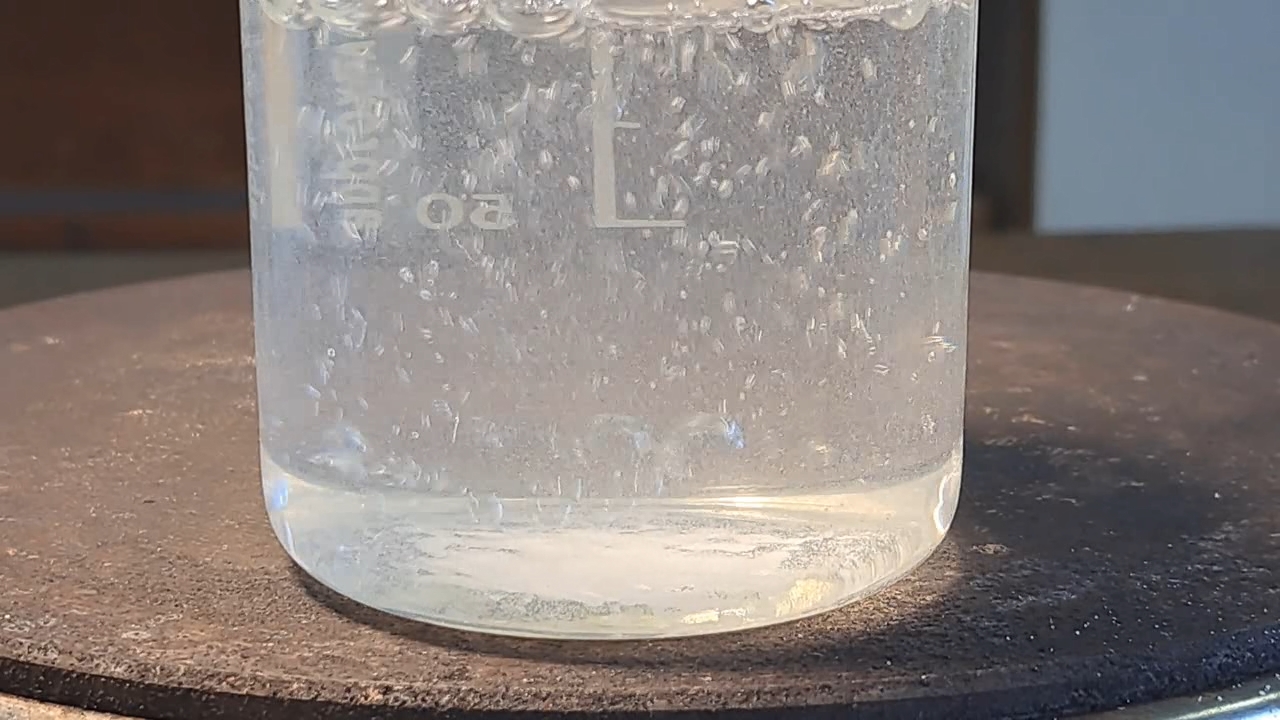

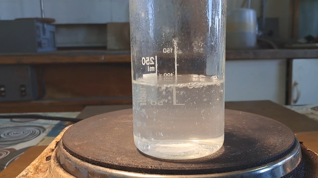

However, the calcium carbonate particles soon settled at the bottom. Visually, no further dissolution of the precipitate occurred. For comparison, nitric, hydrochloric, or acetic acid dissolves calcium carbonate powder within minutes or even seconds under suitable experimental conditions.

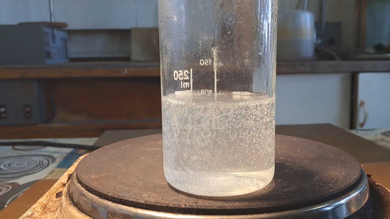

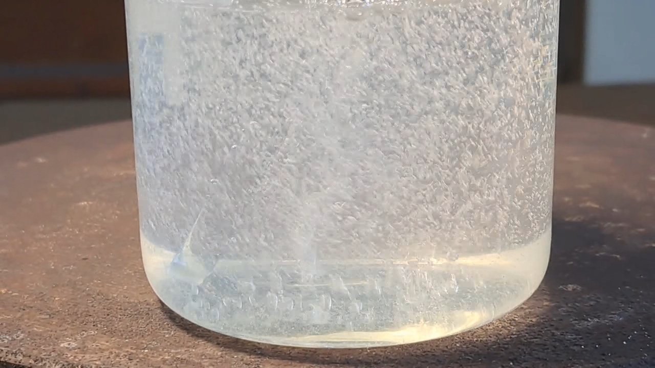

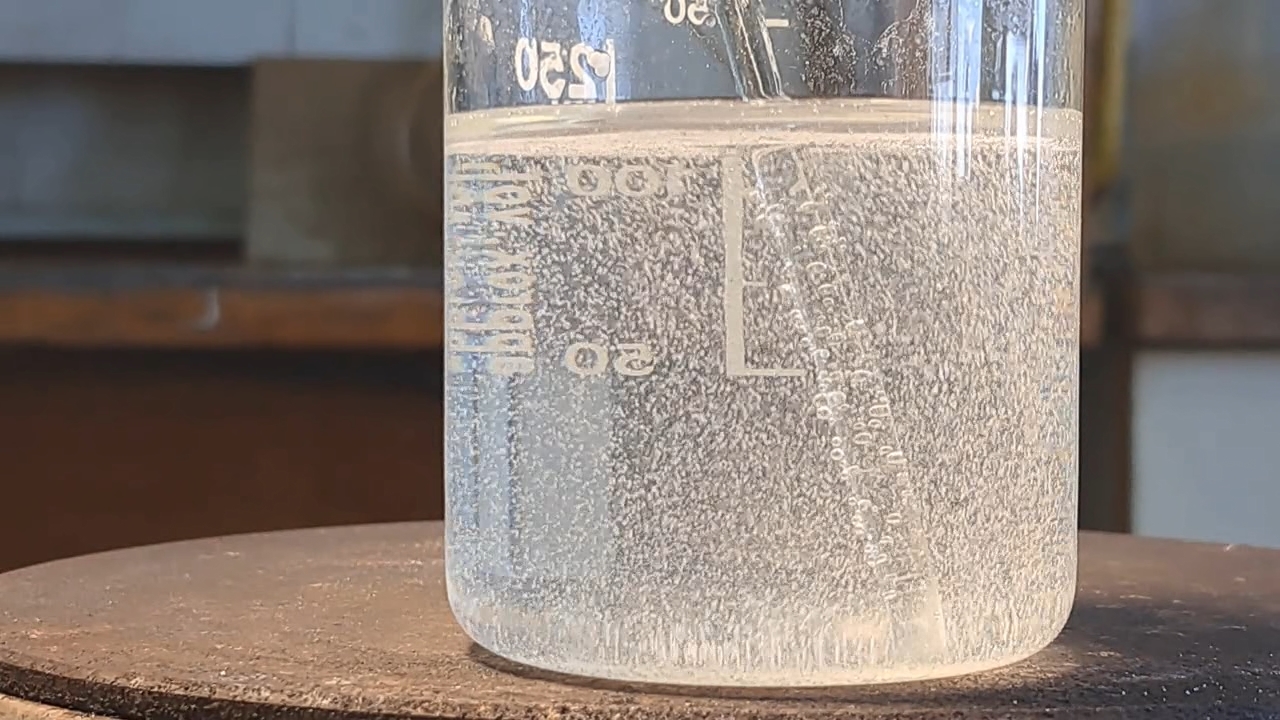

I then added another 4 g of solid EDTA-2Na. Gas was released vigorously, and the carbonate precipitate dissolved within about one minute. The solution, however, remained slightly cloudy.
At the beginning of the experiment, the EDTA/Ca molar ratio was 2.64. Under these conditions, most of the calcium carbonate remained undissolved. After adding the second portion of EDTA-2Na, the ratio increased to 7.80, and under these conditions, the precipitate dissolved completely. It should be noted that, theoretically, EDTA-2Na and CaCO3 react in a 1:1 molar ratio.
This experiment confirmed the conclusion drawn from the previous one: disodium EDTA does dissolve calcium carbonate, but only in the presence of a substantial excess of EDTA-2Na, which makes this process impractical.

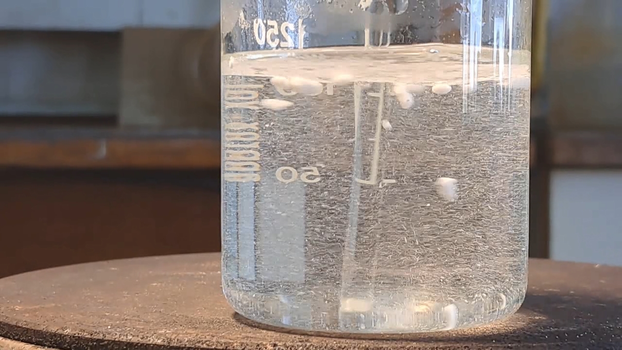

I decided to test whether calcium sulfate would dissolve in EDTA-2Na or EDTA-4Na solution.

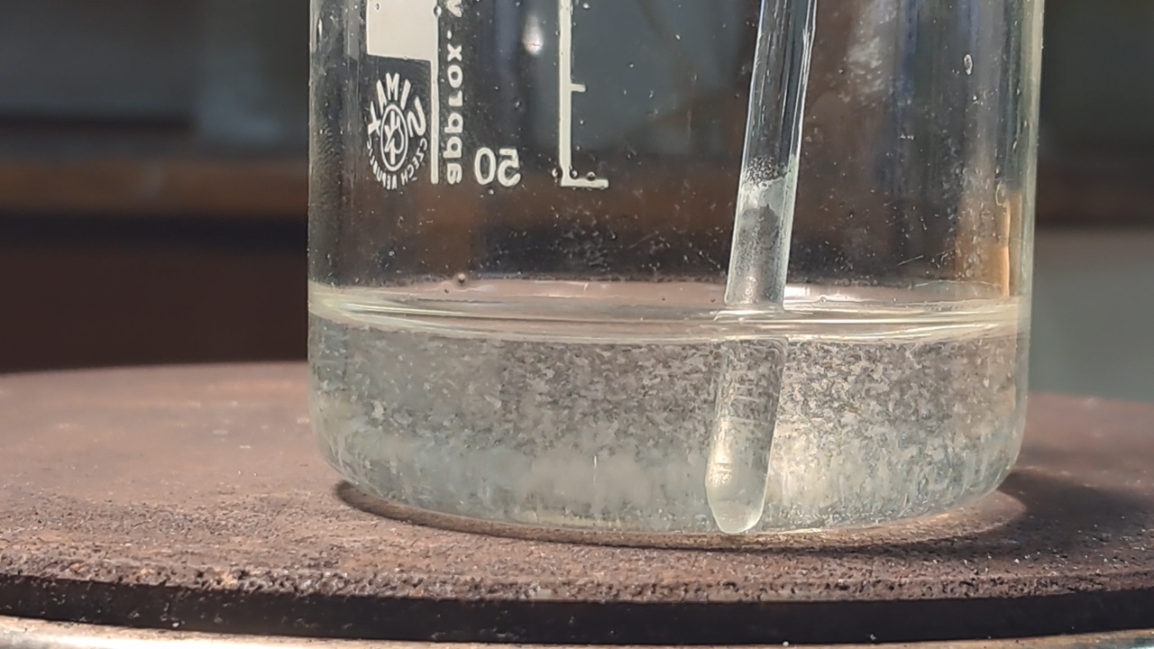

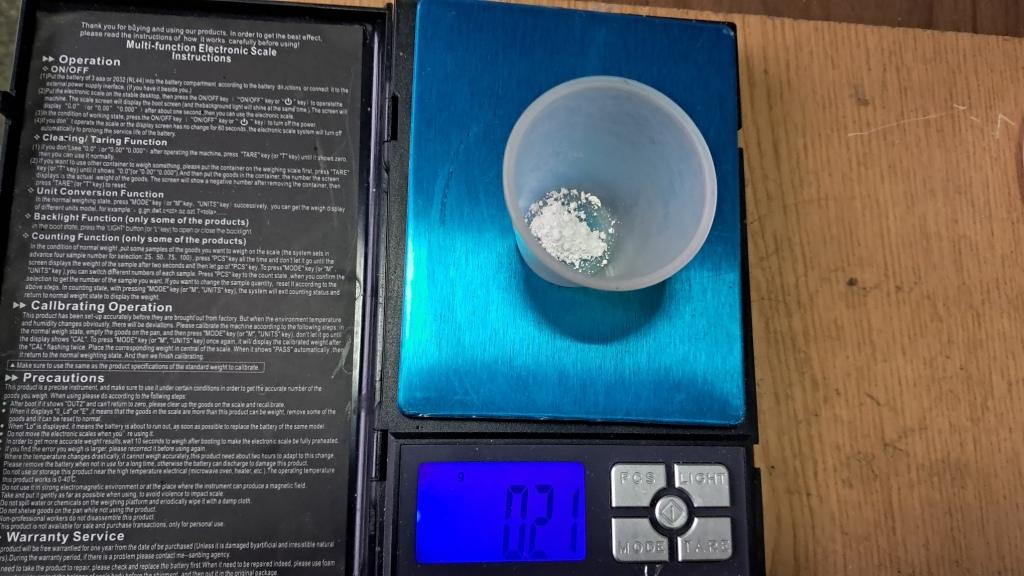

I poured approximately 50 ml of water into a beaker, added 2.64 g of EDTA-2Na, and heated the mixture until the salt dissolved. Then I added 0.21 g of anhydrous calcium sulfate and stirred thoroughly. The calcium sulfate did not dissolve.

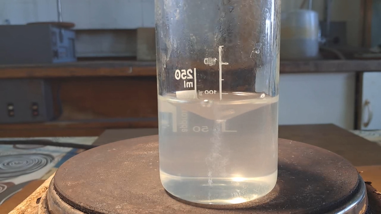

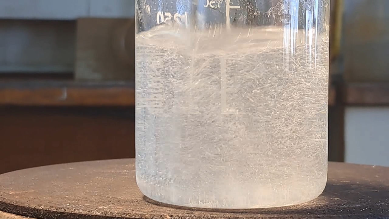

I added another 2.00 g of EDTA-2Na, continued heating, and stirred again. The precipitate still did not dissolve.
Next, I added 1.03 g of sodium hydroxide to the beaker to convert the EDTA-2Na into the tetrasodium form (EDTA-4Na). The precipitate dissolved only partially.
Thus, the use of EDTA-2Na or EDTA-4Na to dissolve calcium sulfate precipitate proved ineffective. Fortunately, in practice, scale formed from hard water usually consists not of pure calcium sulfate but of a mixture of calcium carbonate, magnesium carbonate, and calcium sulfate. Such mixed deposits can be effectively removed with hydrochloric acid. Although calcium sulfate itself is poorly soluble in hydrochloric acid, it is removed mechanically due to the dissolution of the surrounding calcium and magnesium carbonates.
