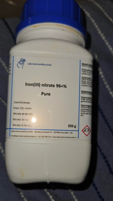

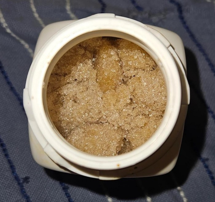

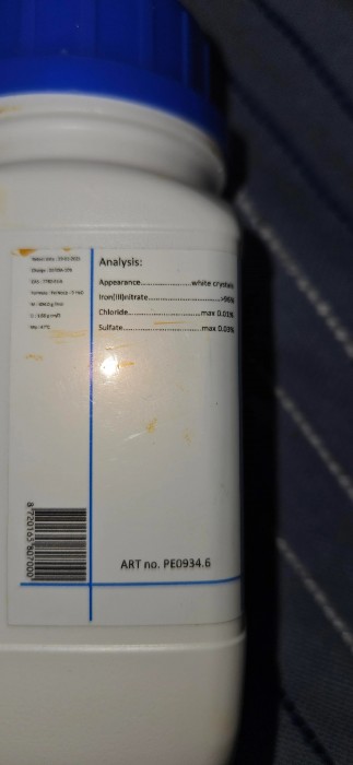

- I just received some iron nitrate and was wondering if this color is normal, because in the pictures on the internet it appears more purple-pink than white-brown.
- That's fairly normal after air/water exposure. I've gone through many kilos of iron nitrate, if you were to pour out the entire bottle (or split a larger chunk open) it would have a more pink/purple shade.
