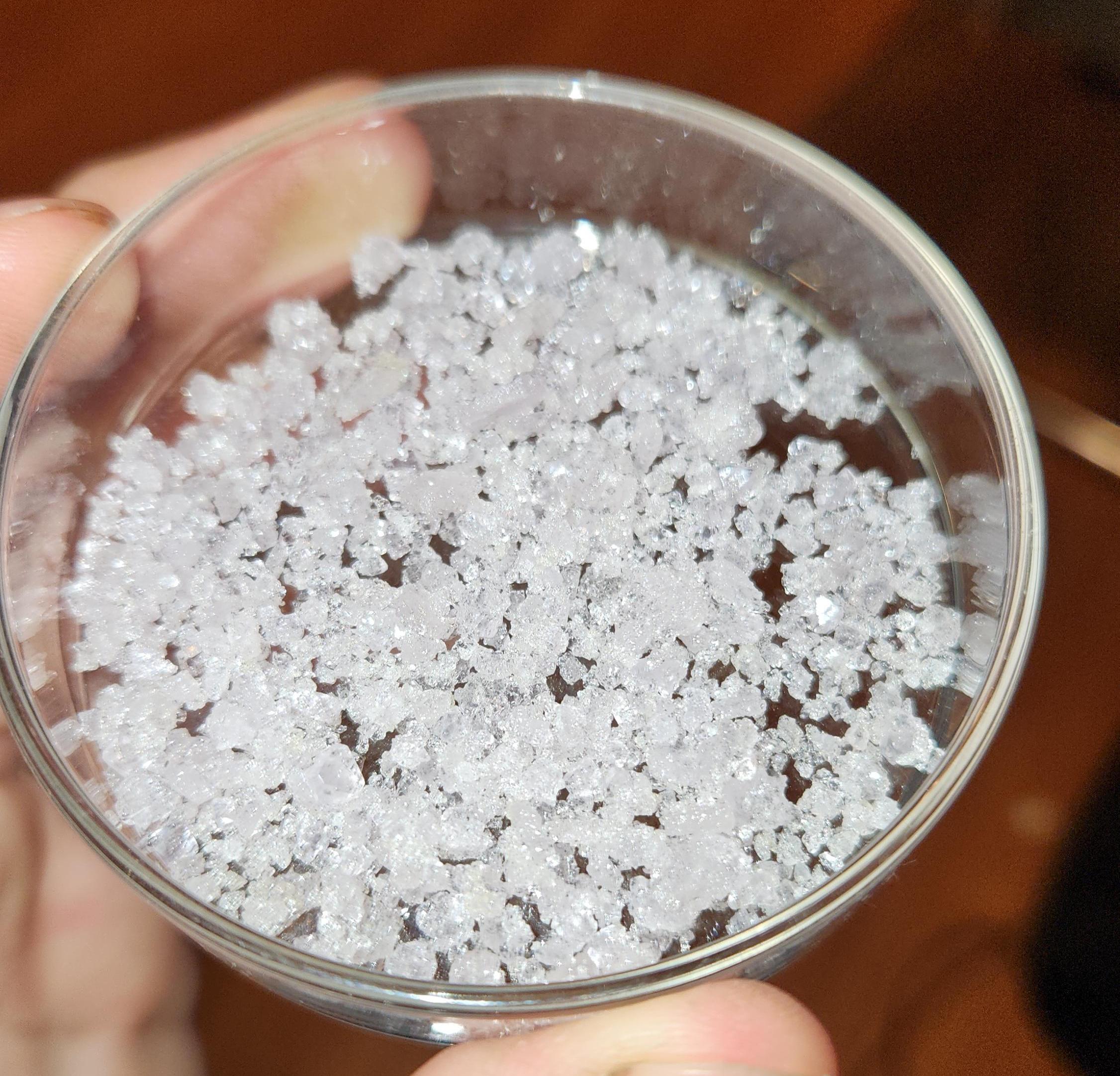

Dodecahydrate double salt of ammonium and ferric sulfate
