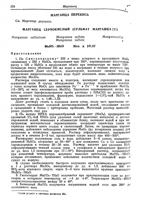

Посмотрел Карякина
Ю.В. Карякин Чистые химические реактивы. Руководство по лабораторному приготовлению неорганических препаратов
viewtopic.php?f=15&t=35&p=1750#p1750
Там предлагается просто пропускать сернистый ангидрид сквозь водную суспензию диоксида марганца - даже без гидротермальных условий. Вспомнил, что одна аспирантка в нашей лаборатории решила это реализовать на практике, но мы ее отговорили.

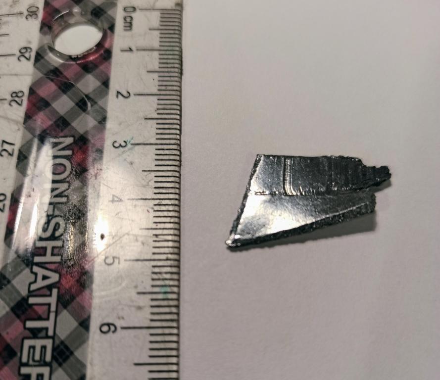

Металлический рений

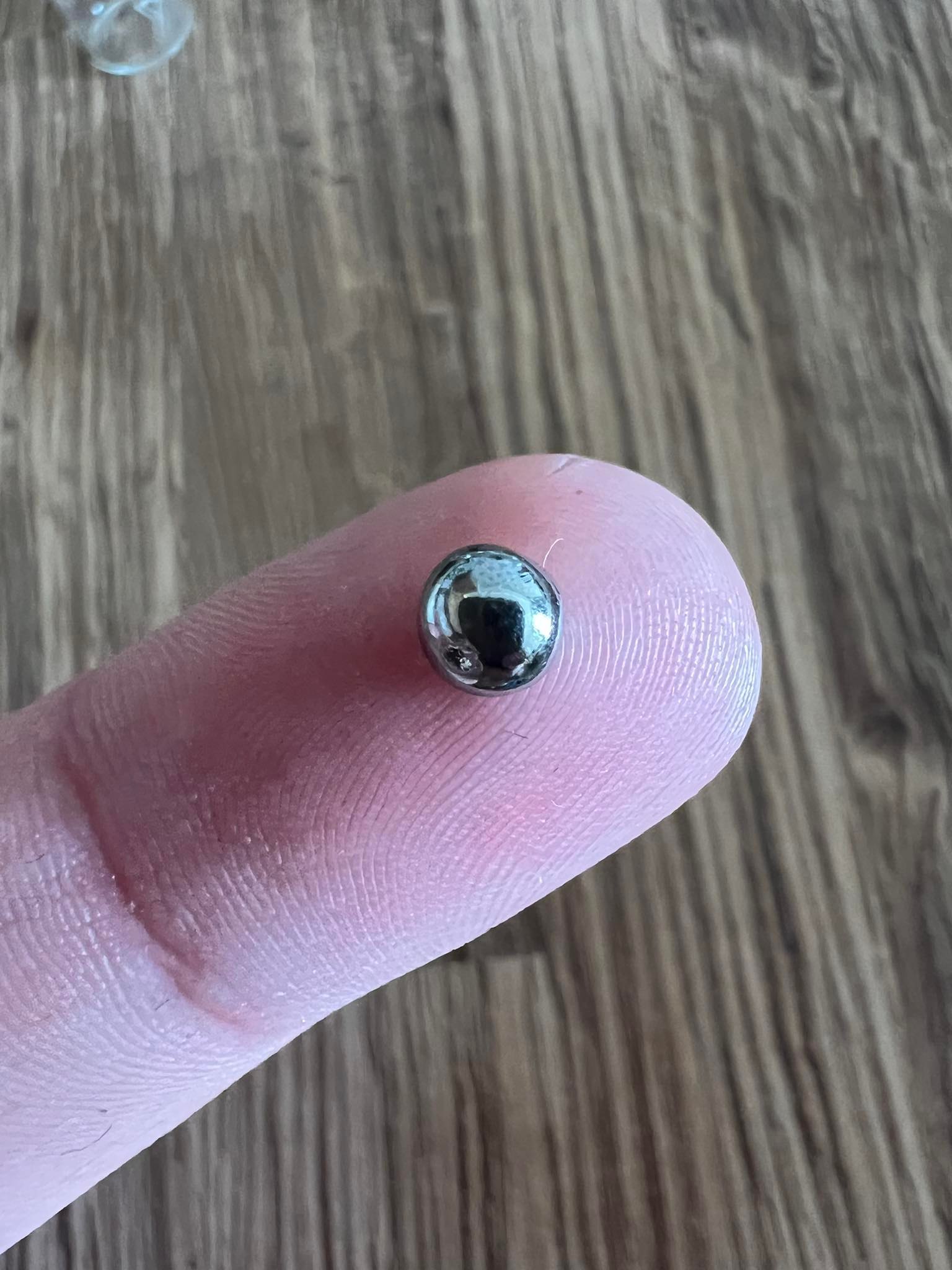

I bought 1.3g of Rhenium metal.
288629150_1253350085472234_1892002155087237990_n.jpg [ 262.87 KiB | Viewed 15563 times ]

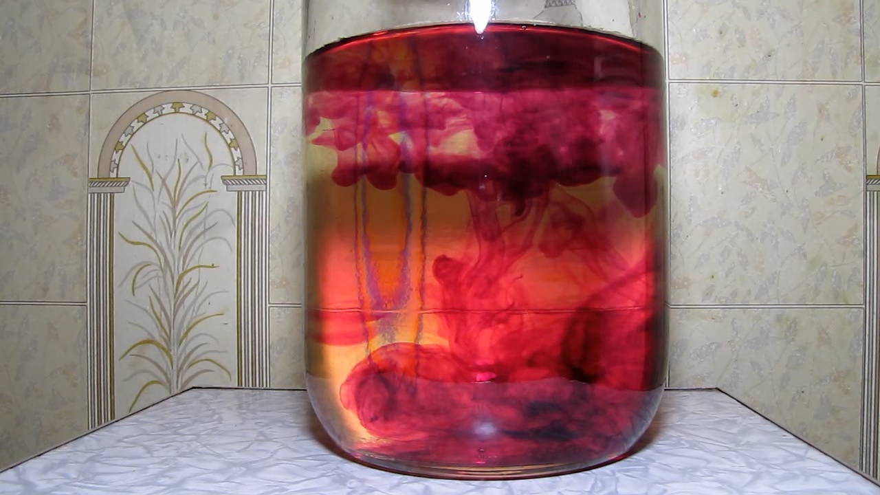

Lake water, potassium permanganate and sulfuric acid
http://chemistry-chemists.com/N1_2024/C ... -P2-1.html
Lake_water-potassium_permanganate-sulfuric_acid-23.jpg [ 470.14 KiB | Viewed 13142 times ]

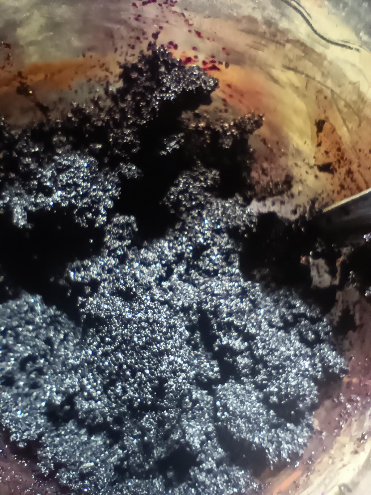

Potassium Permanganate supported on silica gel
I'm working a project that's oxidatively cleaving an Enamine at the double bond. Read a few papers about solid supported KMnO4 cleaving alkenes. Read further and found a paper about silica as the solid support instead of alumina. It was selective towards enamines in anhydrous conditions in high yield.
So I made some. It's cool looking stuff. KMnO4 has brilliant purple crystals alone but when silica is thrown in the mix they are a lot vibrant.
Looking forward to working with this reagent. I read some interesting things about it.

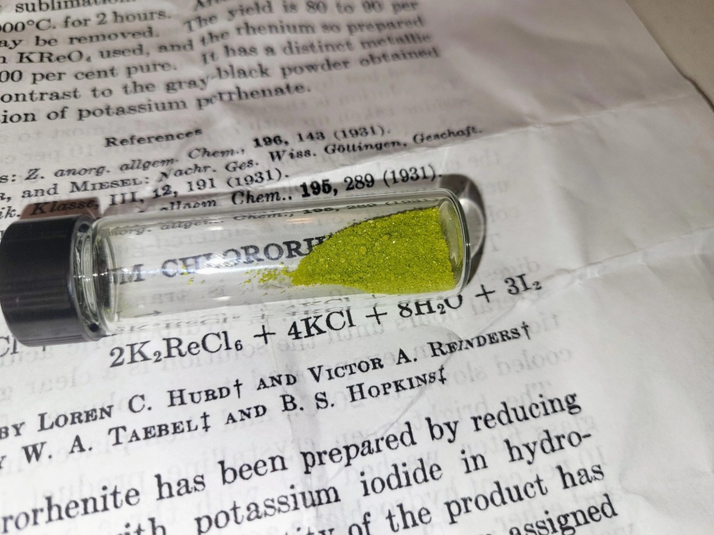

Posts: 69138
Potassium hexachlororhenate (K2ReCl6)

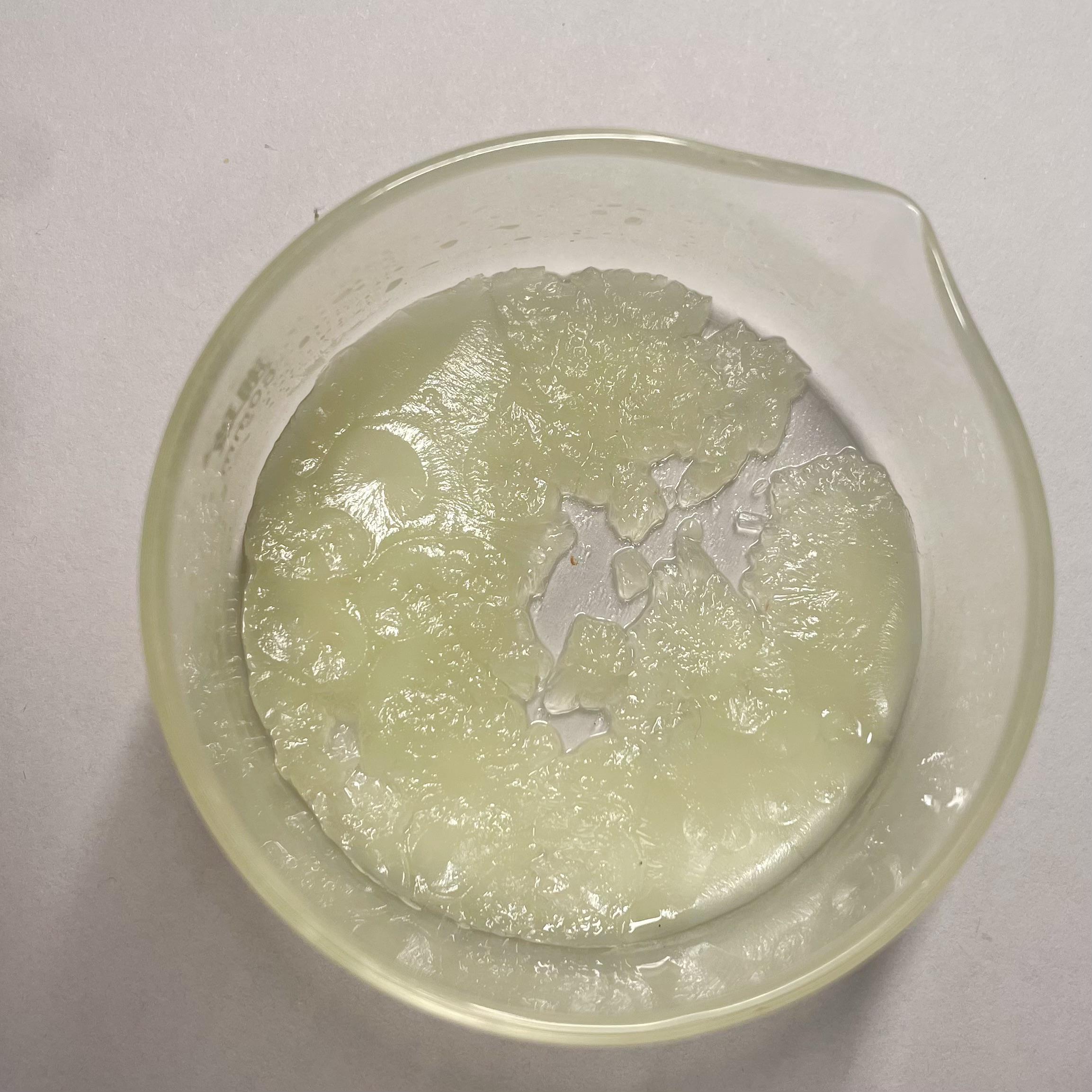

Perrhenic Acid Monohydrate
Got 13g of it here, made it by dissolving rhenium metal in nitric acid and concentrating the solution. It’s very deliquescent and turns into a puddle very fast.
