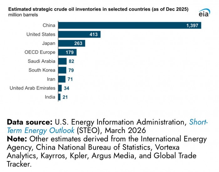

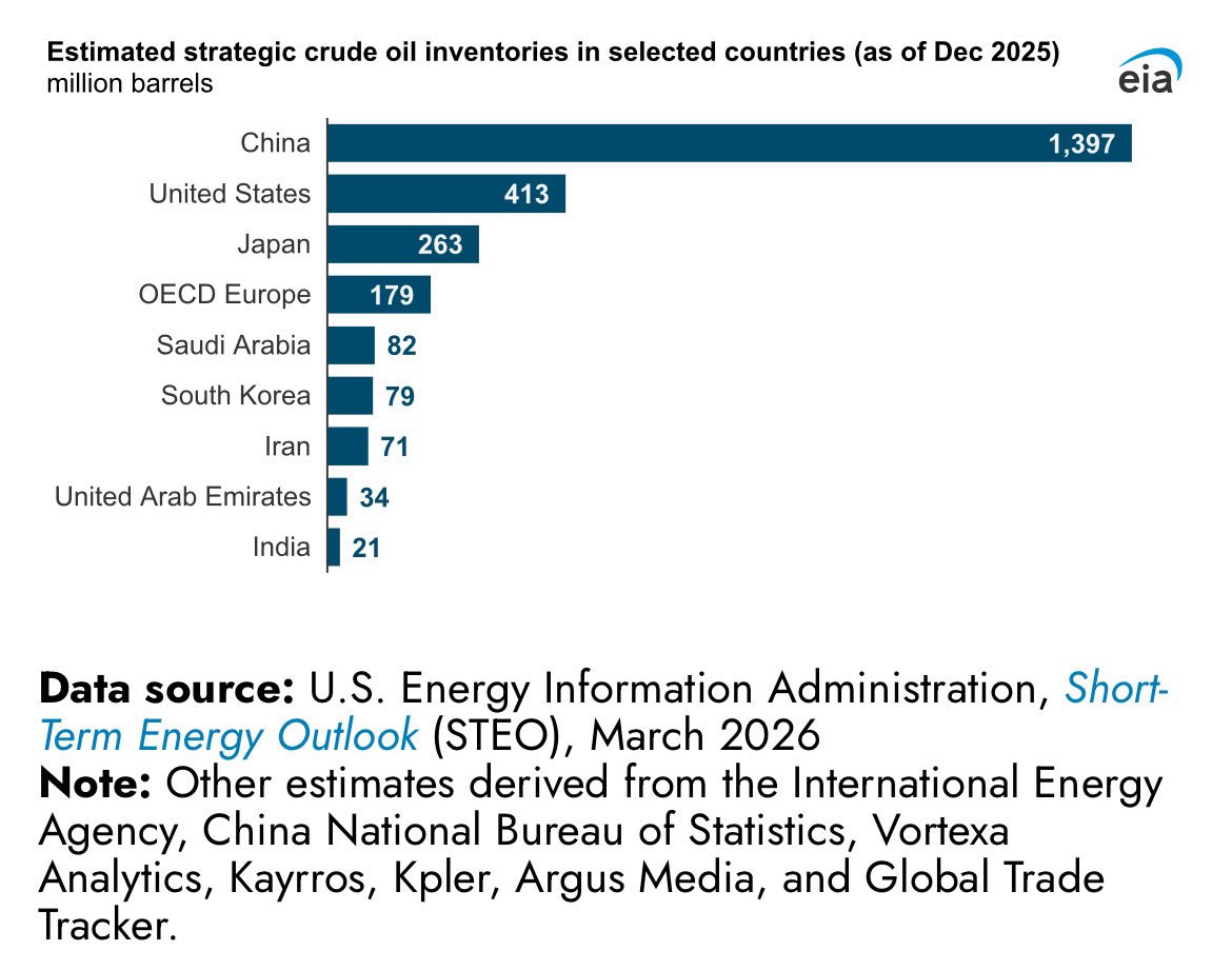

 Post subject: Re: Источники энергии
PostPosted: 23 Apr 2026 23:41
Posts: 69151
China has more strategic oil reserves saved up (for a war or crisis) than the rest of the world combined.
