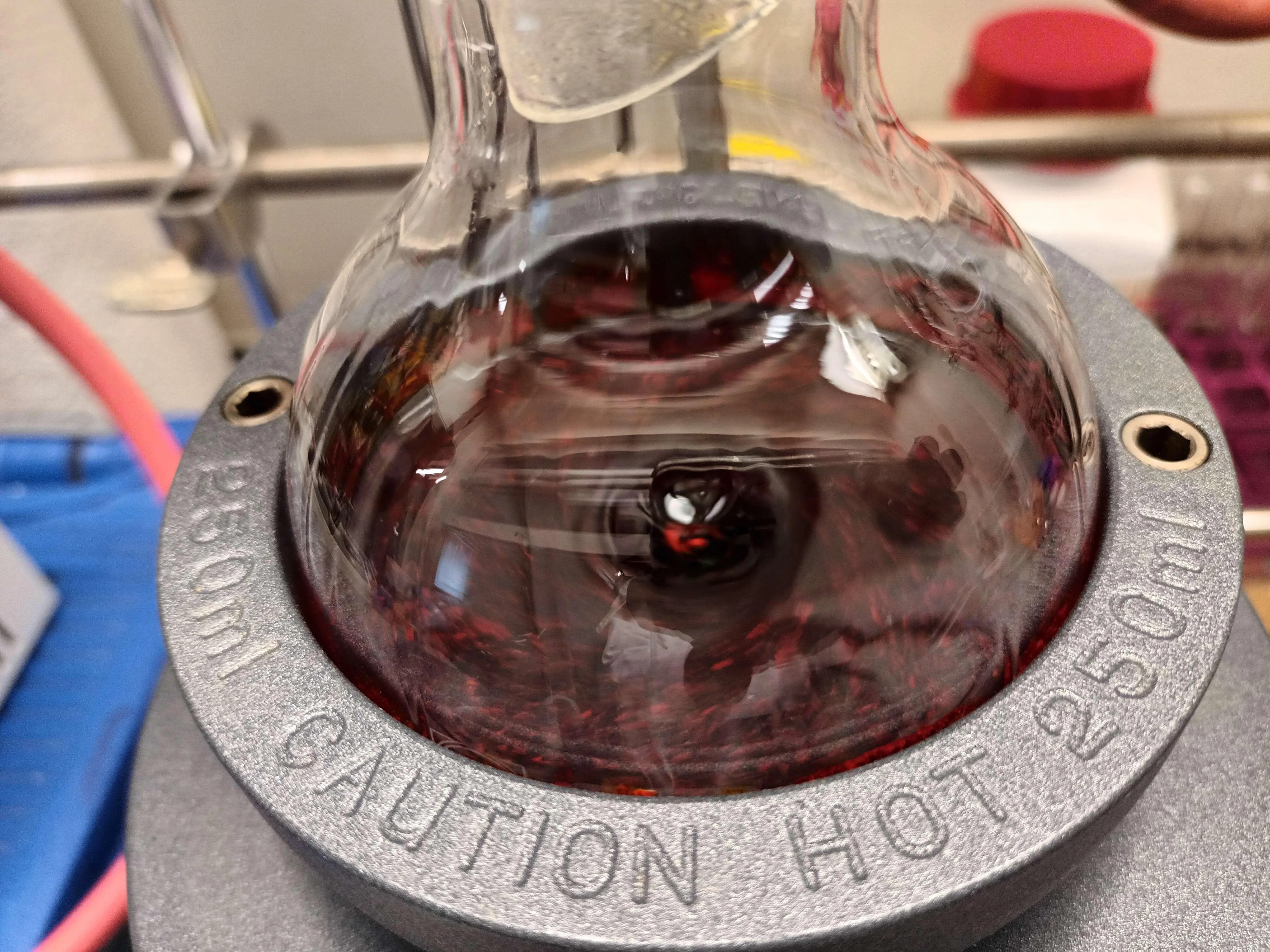

PostPosted: 04 Apr 2024 13:50
Synthesis of quinizarin
https://www.sciencemadness.org/whisper/viewthread.php?tid=160269
