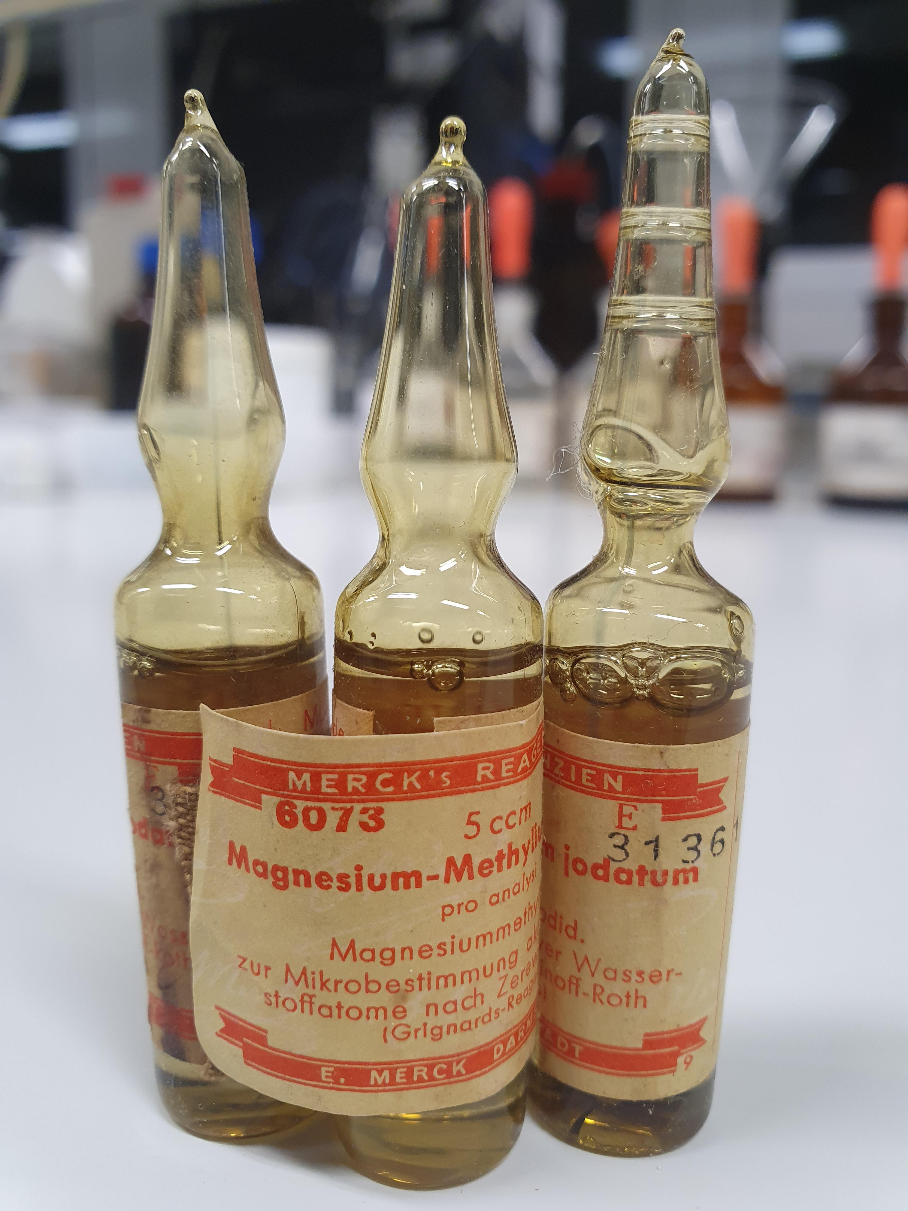

Posts: 69201

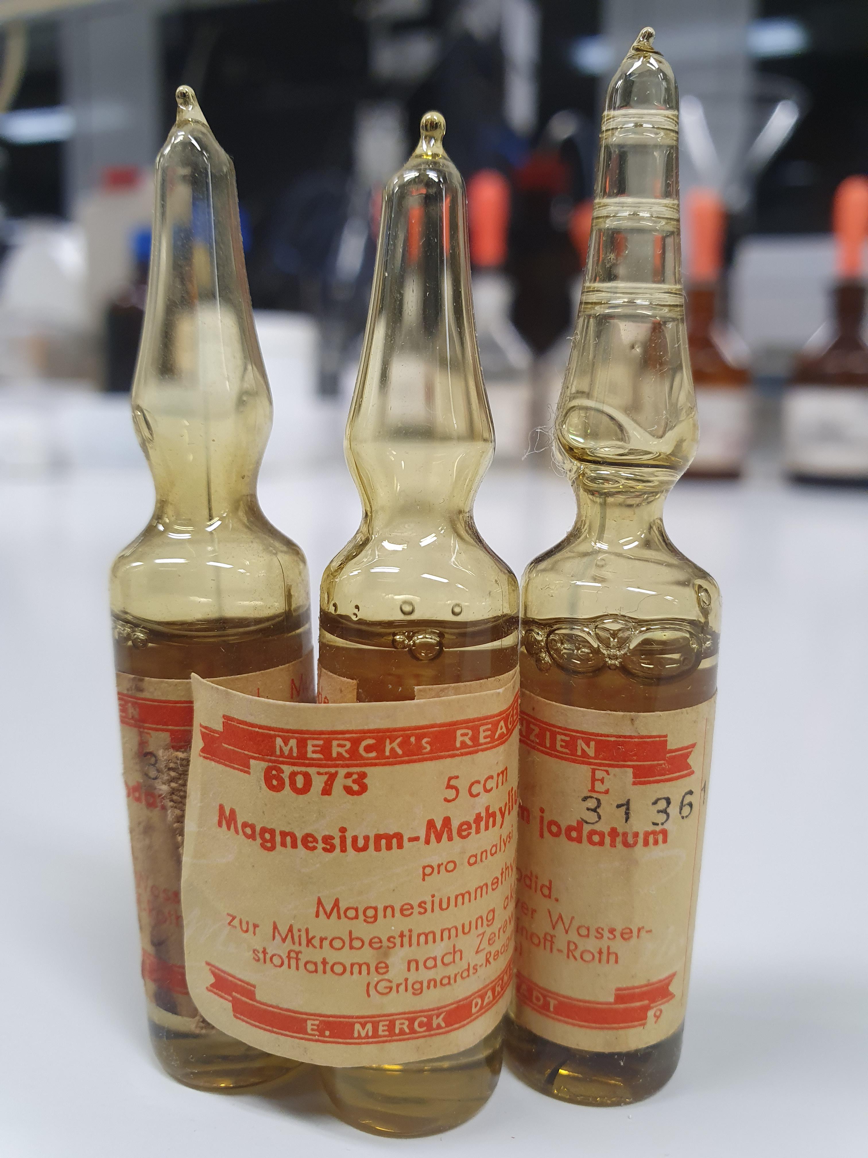

Just used these +50 year old Grignard solutions and they worked perfectly!

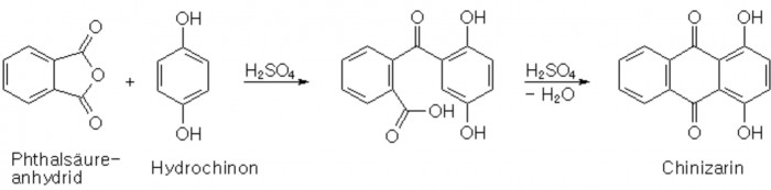

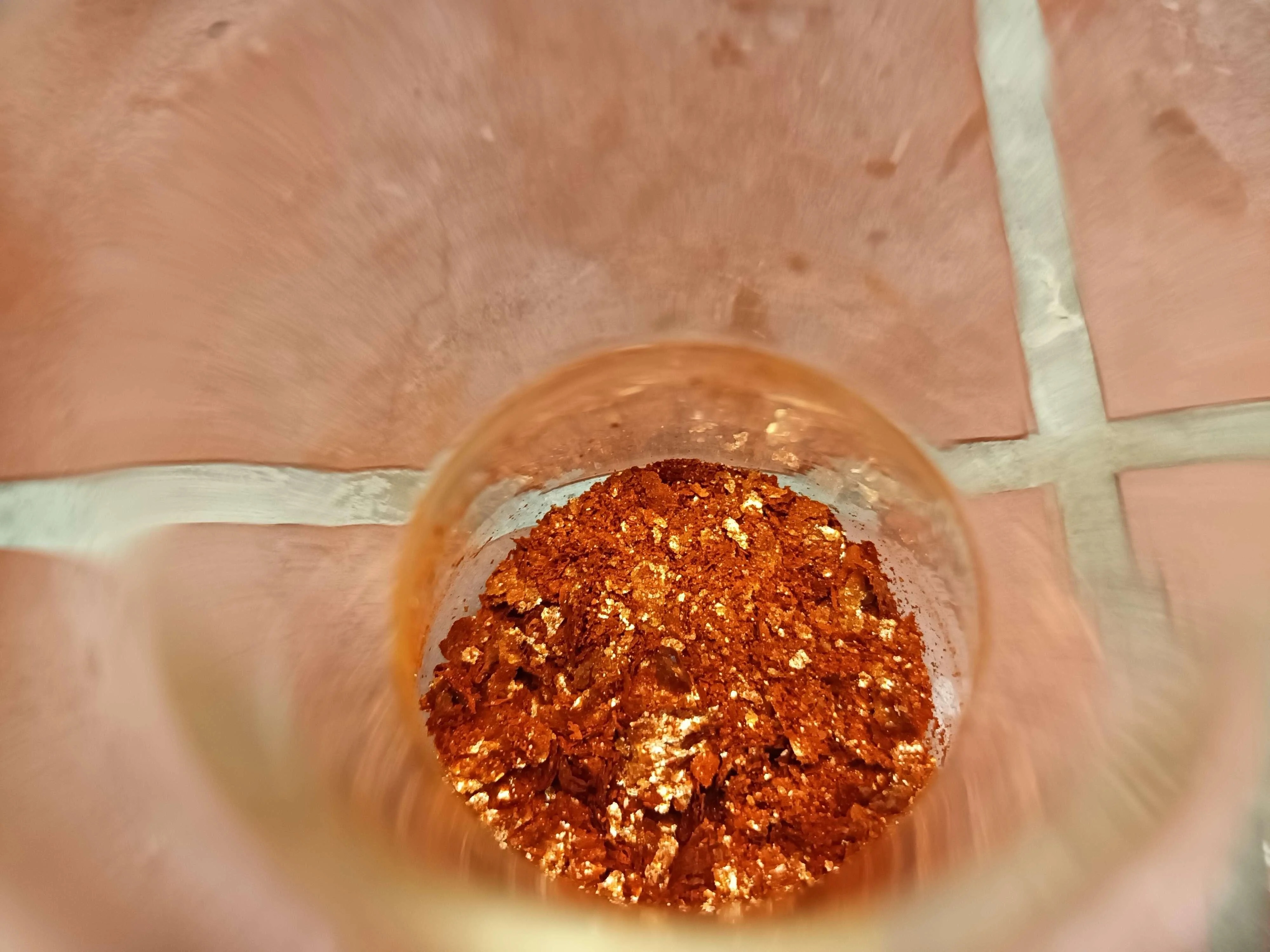

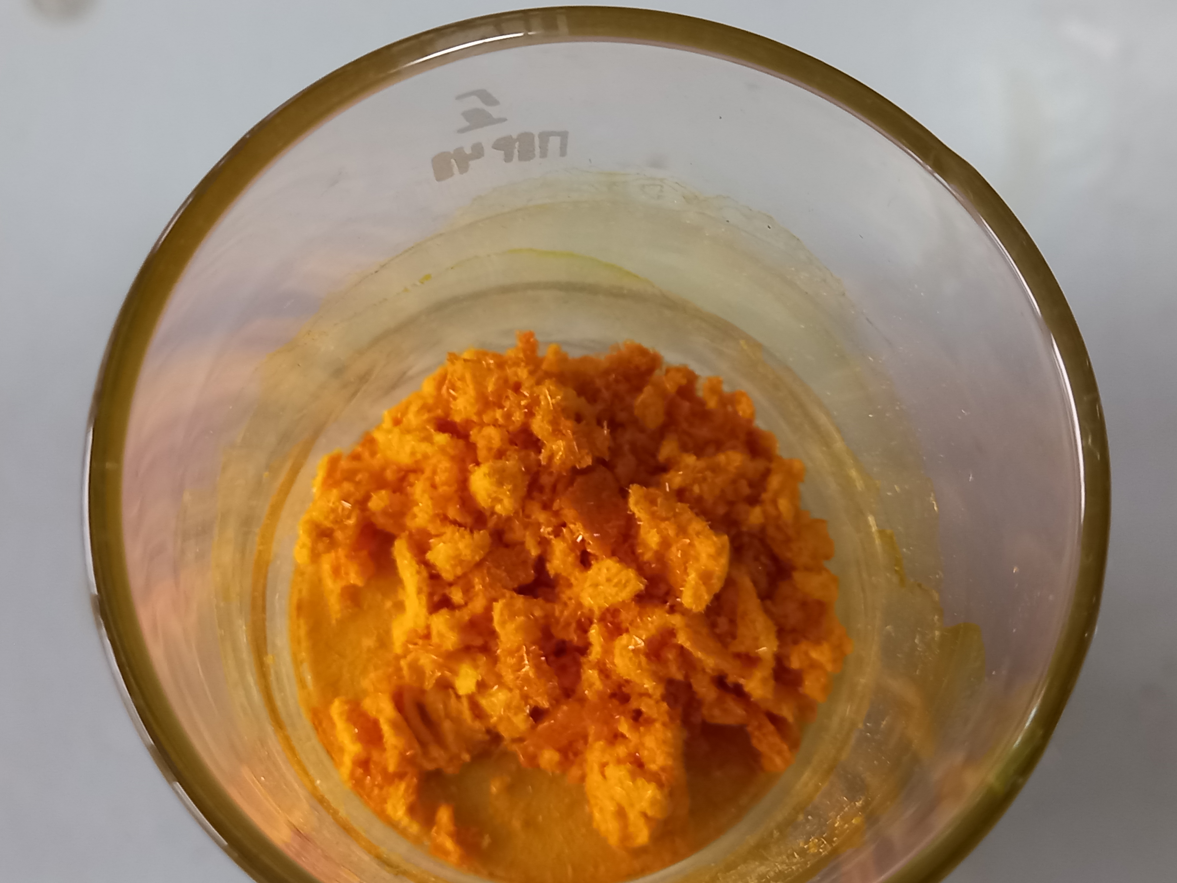

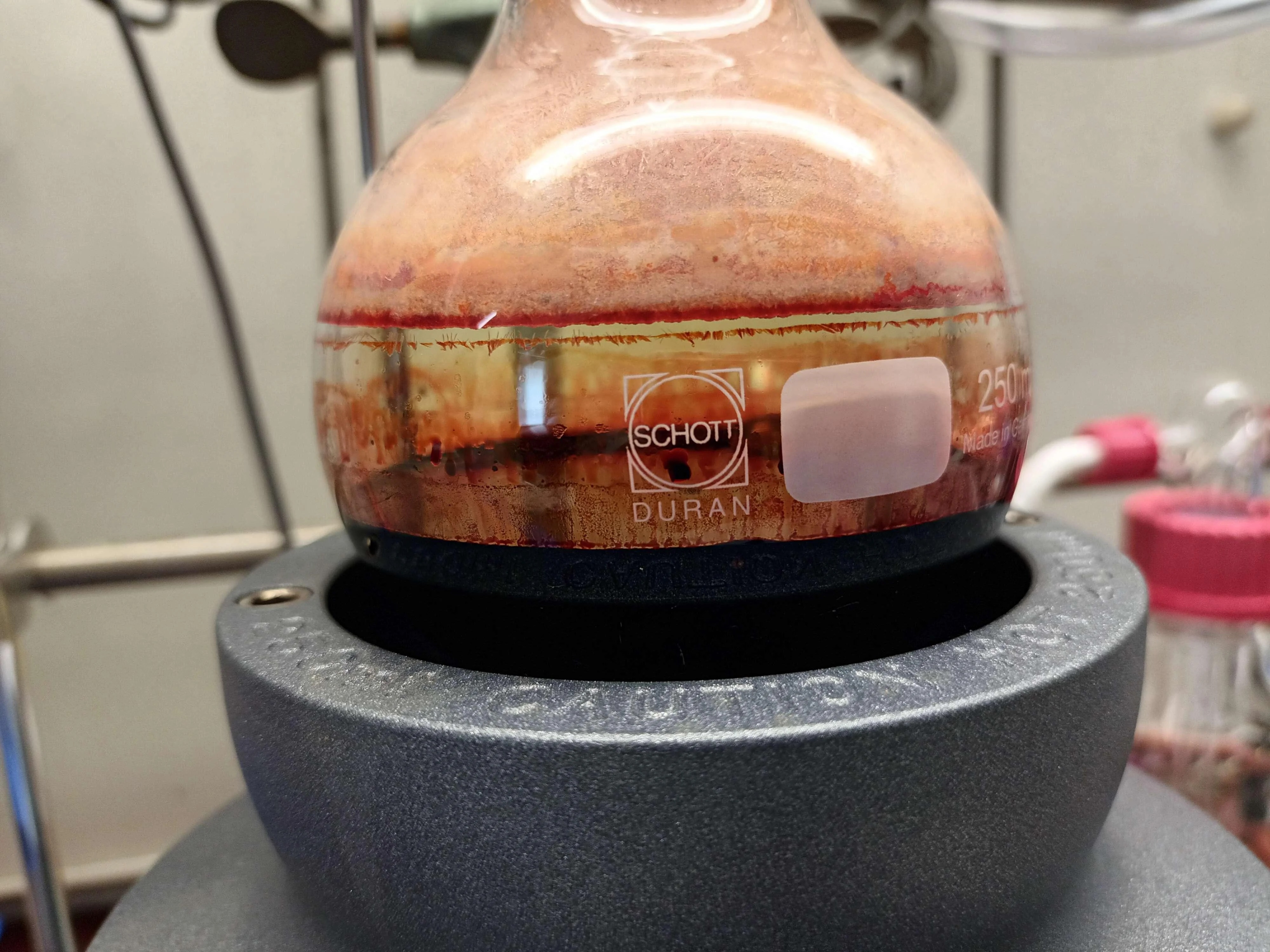

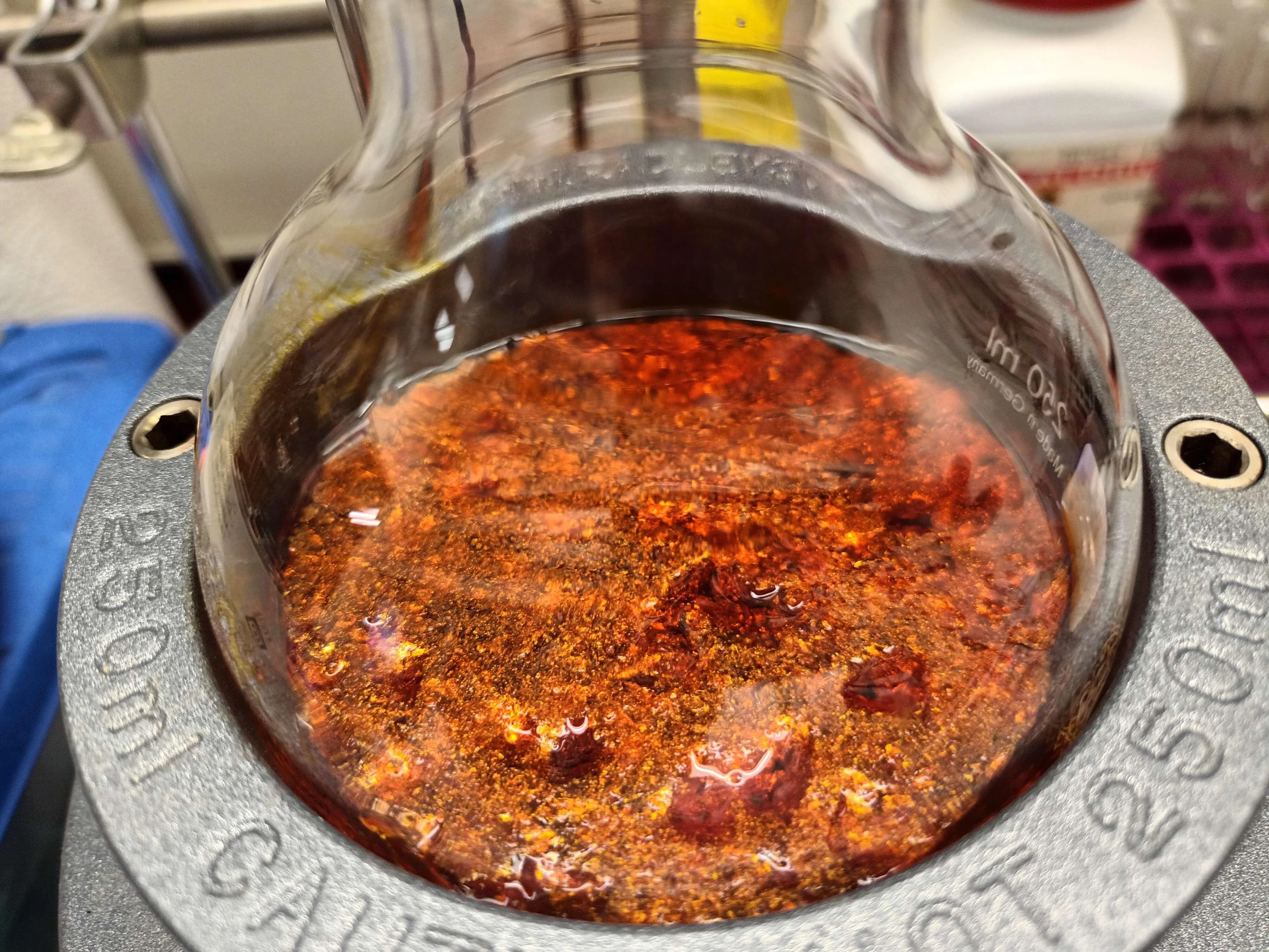

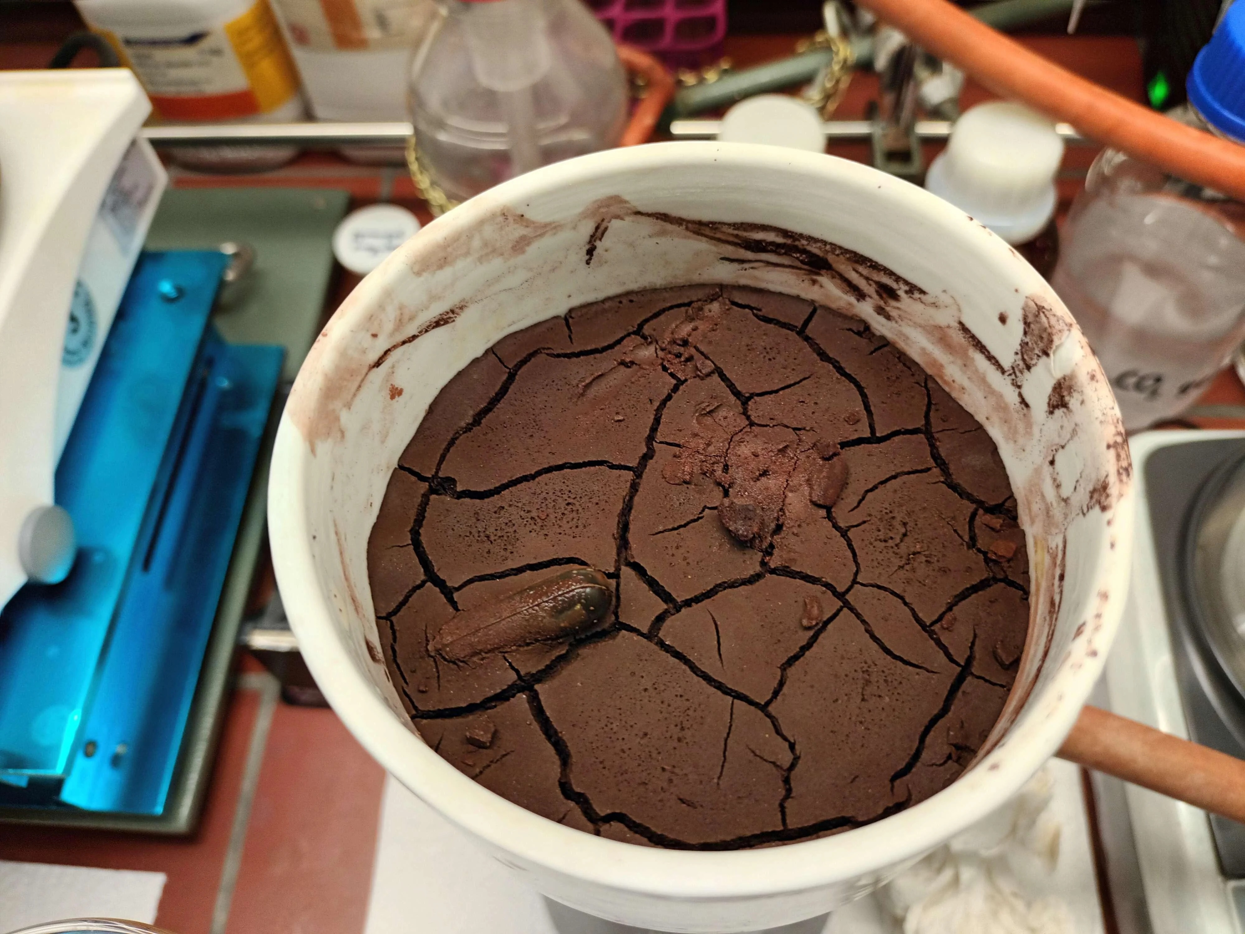

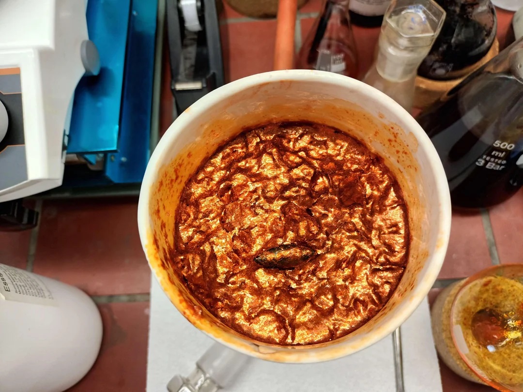

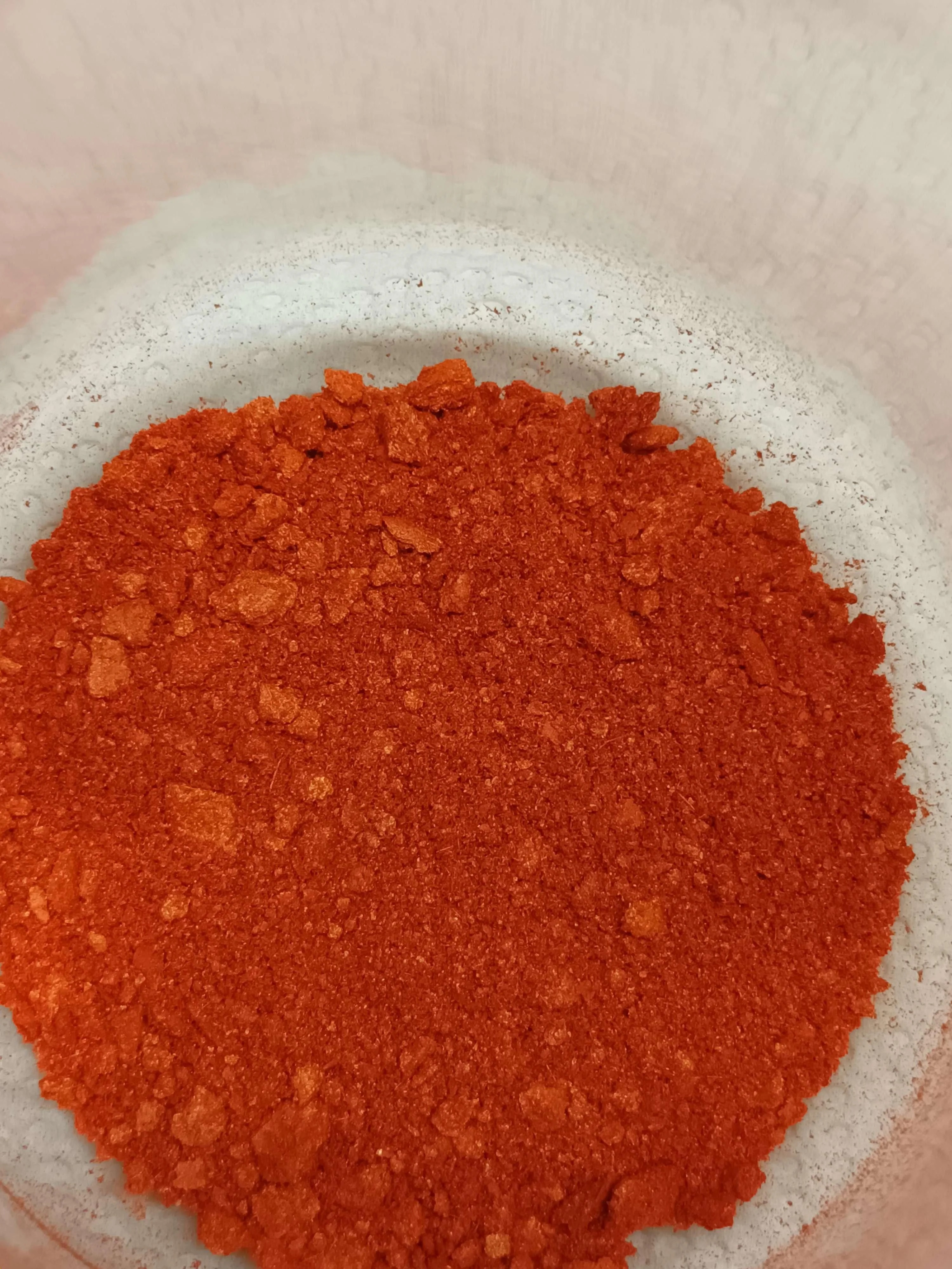

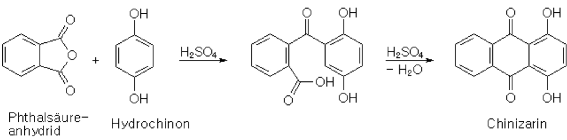

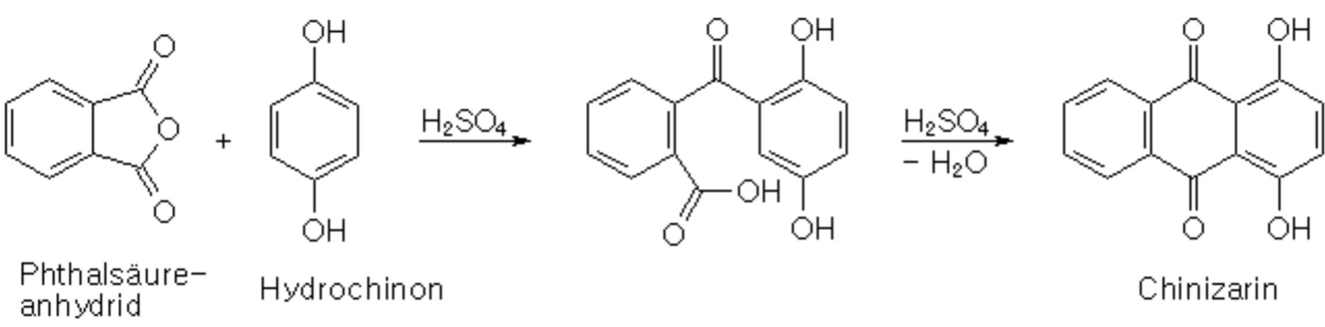

Synthesis of quinizarin
https://www.sciencemadness.org/whisper/viewthread.php?tid=160269

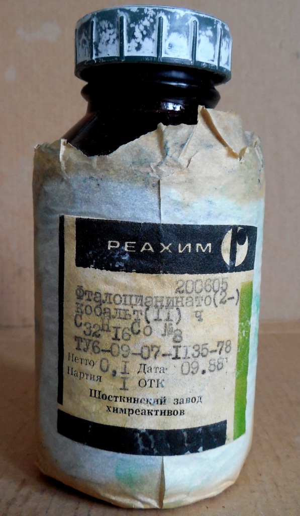

Потрібен водорозчинний sulfonated cobalt phthalocyanine (CAS 1098-91-1). Прошу порадити у кого і як його купити в Україні (в Укроргсинтезі немає). Або як краще його синтезувати маючи cobalt phthalocyanine (CAS 3317-67-2). Можливо порадите де така методика синтезу опублікована. Дякую.

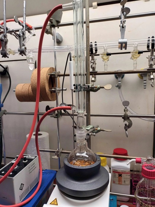

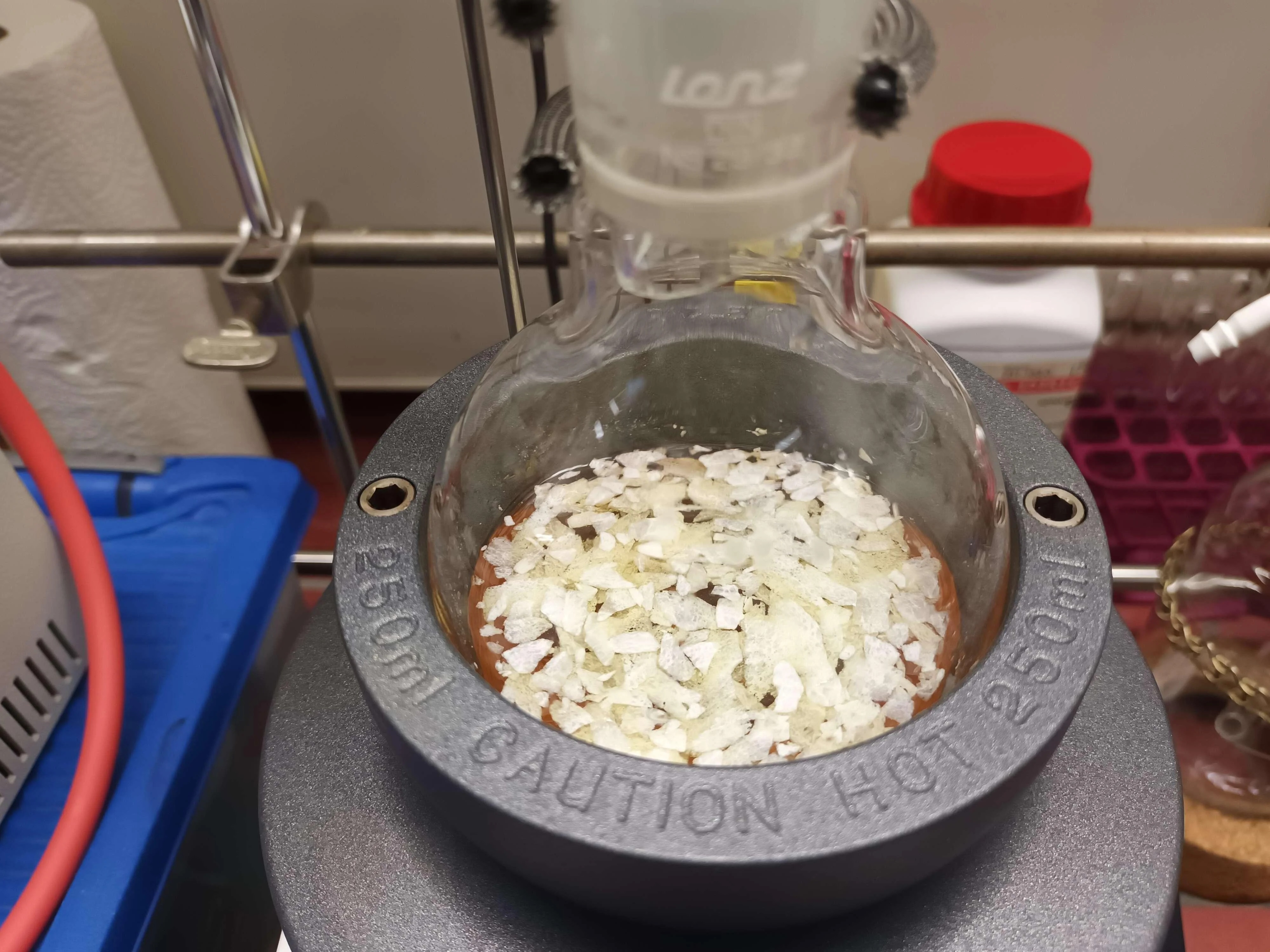

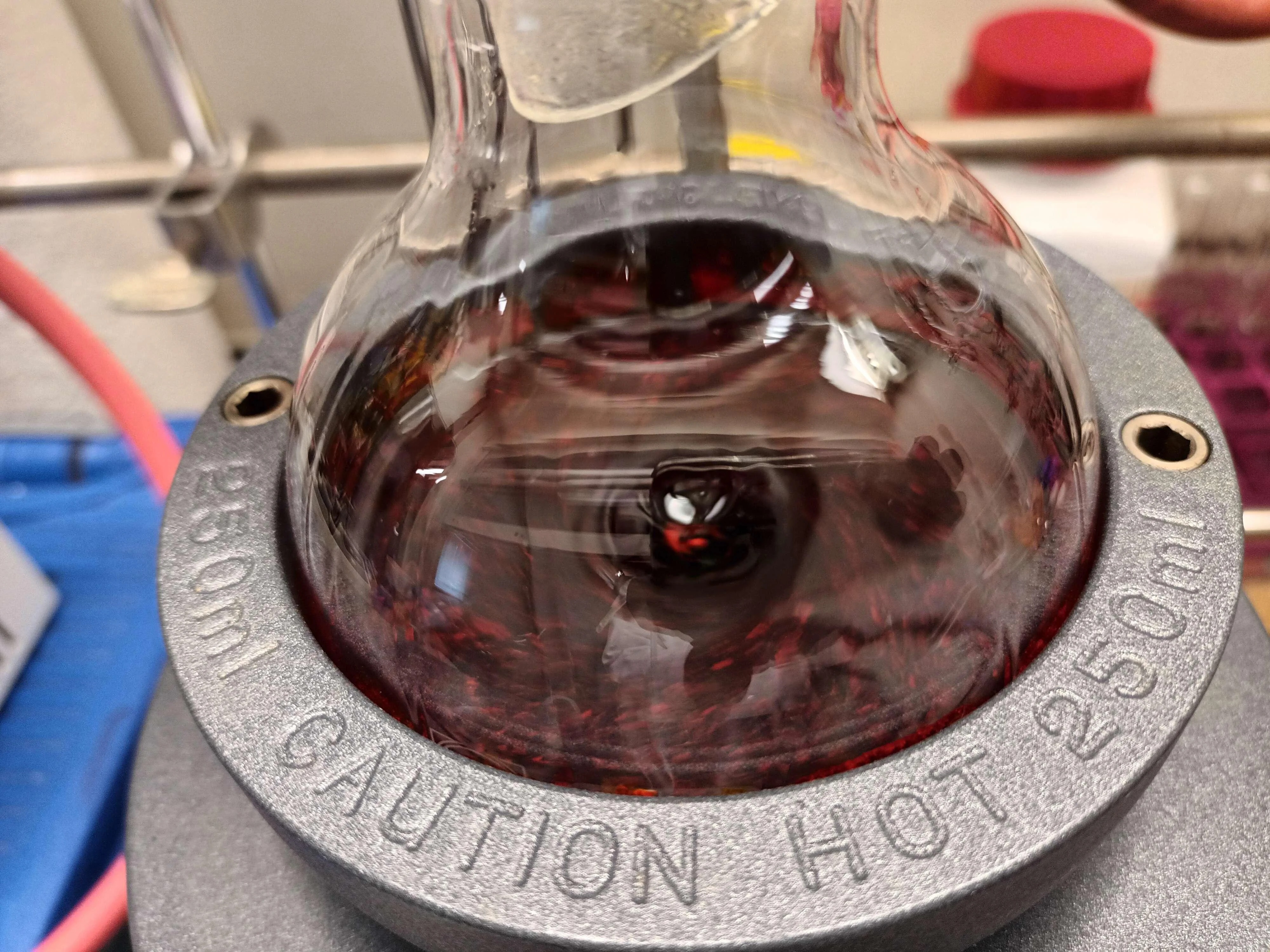

Carrot reduction
I am really looking forward to the results of this experiment. We're reducing 4mmol of 2,6-dimethylcyclohexanone to 2,6-dimethylcyclohexanol using carrot reduction
It is an enzyme based reduction indeed. I used J. S. Yadav, S. Nanda, P. T. Reddy, A. Bhaskar, Rao, J. Org. Chem., 2002, 67, 3900-3903. and R. Lacheretz, D. G. Pardo, J. Cossy, Org. Lett., 2009, 11, 1245-1248. For inspiration, if you want to read up on it a bit more. Basically, you cut up your carrots, add them in water with your reagent, and stir it for a few days
https://www.reddit.com/r/chemistry/comments/1qxkrkc/carrot_reduction/

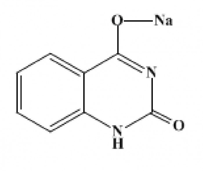

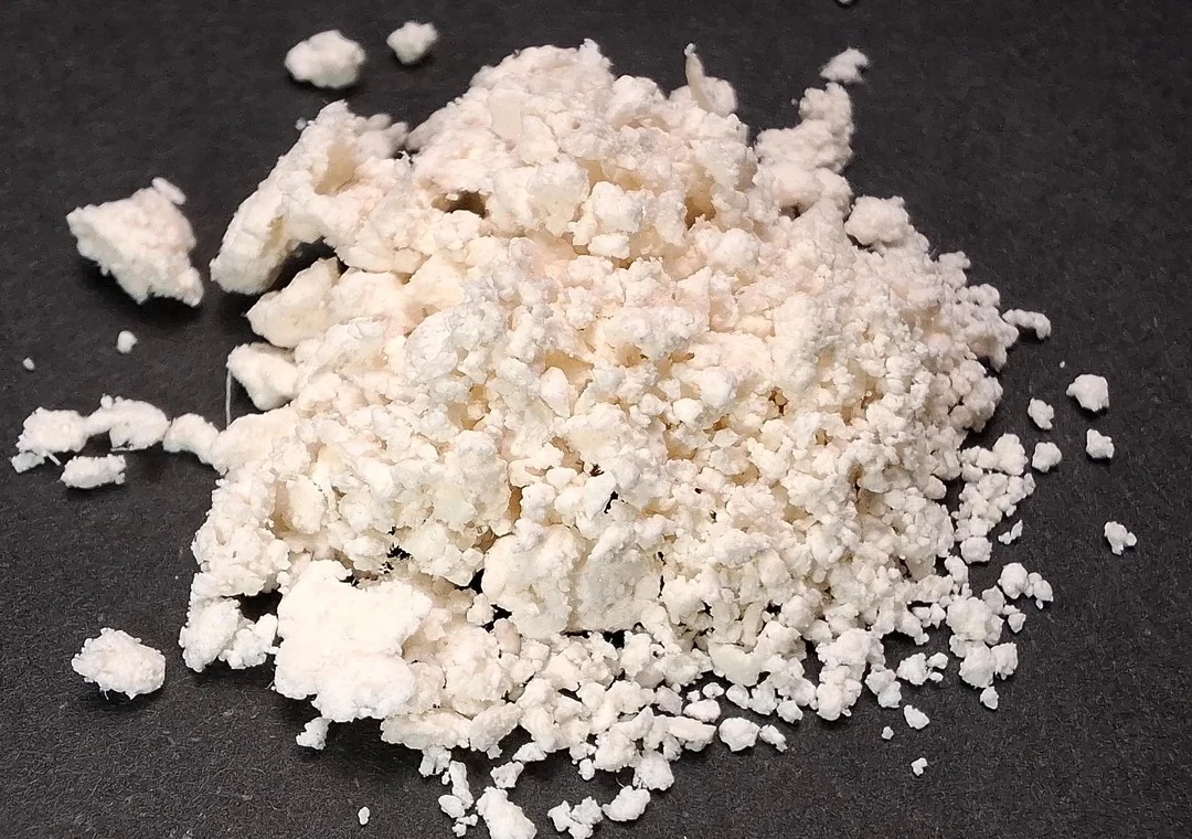

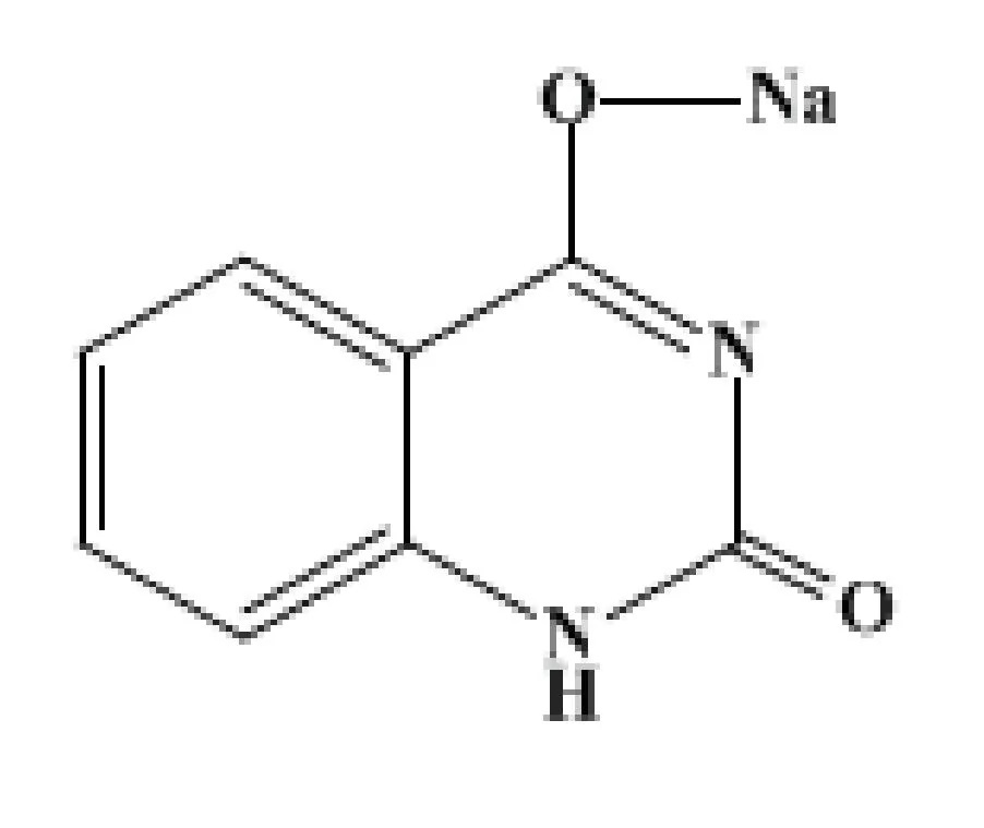

Benzoylene Urea Monosodium salt
https://www.orgsyn.org/demo.aspx?prep=CV2P0079
